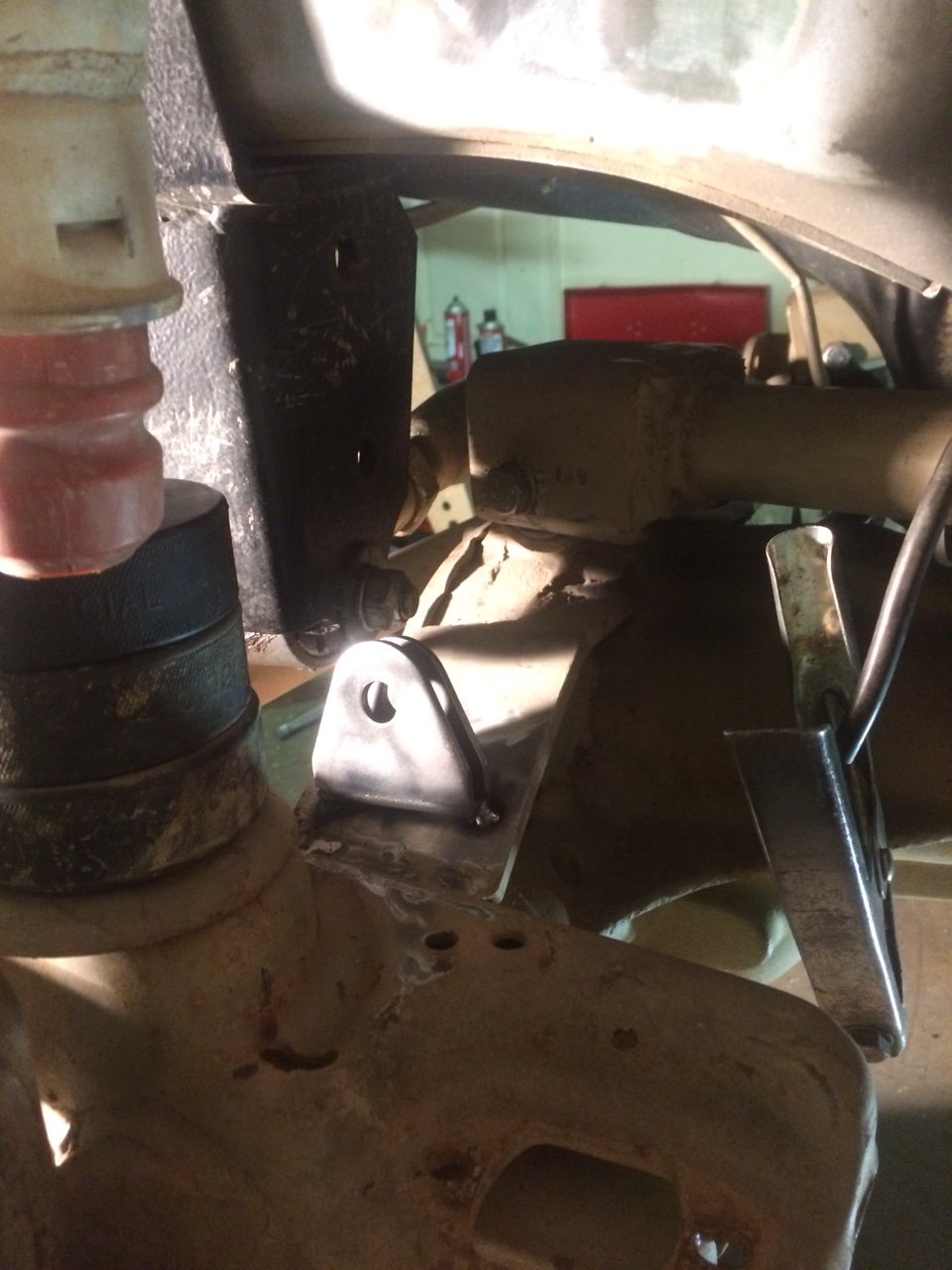

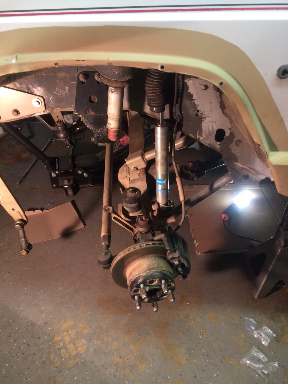

I have put about 3 coats of primer on the frame stiffeners now. I sprayed the weld areas very thick so that should fill in any gaps that might have been created.

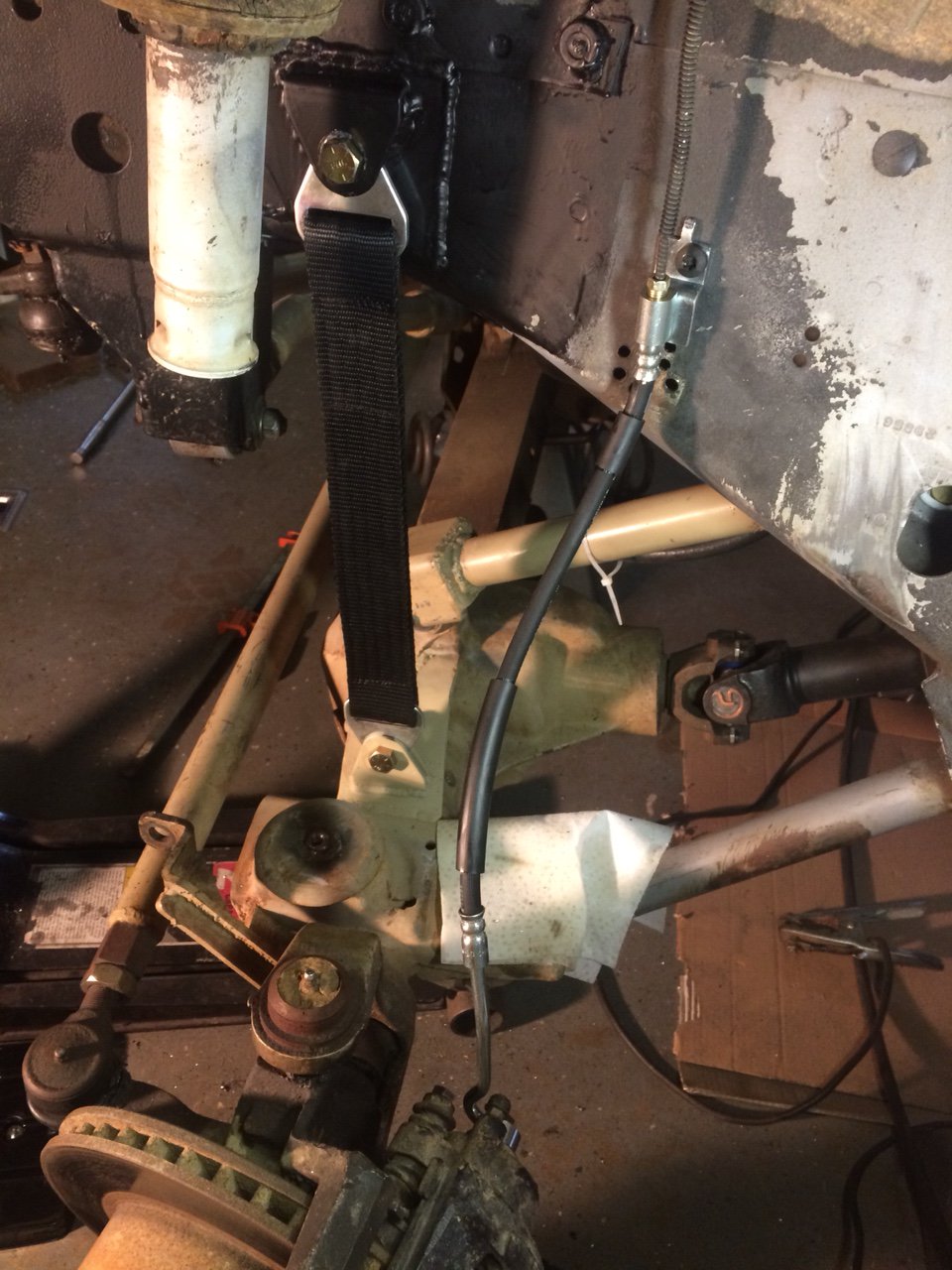

I have also prepped for the limit strap which is for the front driveline because of a short driveshaft. Luckily I found that the shocks max out right where the driveshaft begins to bind. Get that fully welded in and things will be on their way :)
That's the one downside to the 300 in an xj. I would kill U joints almost monthly in mine. :lol:
The limit straps are a very good idea!

Limit strap is in. While I was checking articulation I figured some new longer brake lines are appropriate. YJ lines work great. However my tube flaring skills suck and now I am trying to remove the front drivers side like from the prop valve body.
Let’s say as horrible it is and ass old the fittings are it’s been pulling teeth to try and get out. The fitting is all gummed up and there is hardly room for vise grips to sit in that area.

Lol. This strap (1) saves my Driveshaft from exploding and (2) only limits my suspension from an inch or two more of droop.

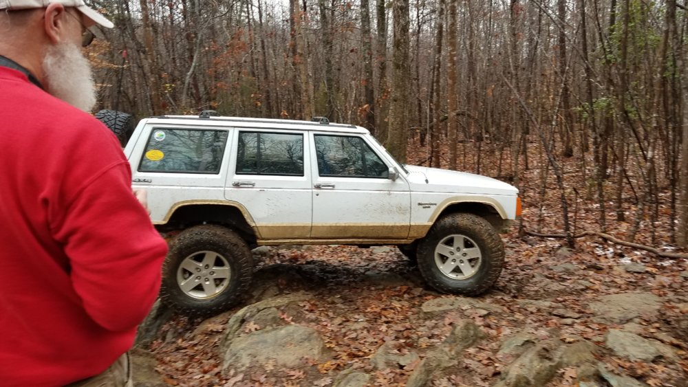

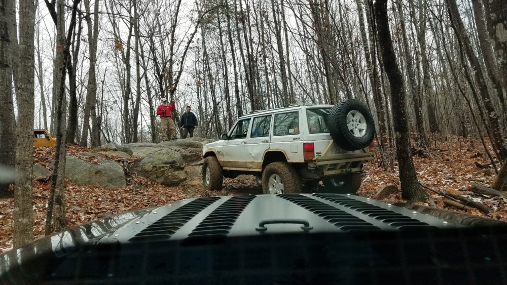

I had my first shakedown at big creek with CTB last weekend. I drove down on state highways at 55 mph to keep any unnecessary stress off of the Dana 300 until I knew how it handled highway duty. Some seepage out of the front output and shift rails. Nothing significant though.
Get to big creek and opt to ride around in 4lo all day in hopes to officially break in the bearings/gears. The twin sticks were wonderful navigating through all of the trees there. 1st gear was too slow for anything since it was mucky and slippery.
Shocks through the floor in the back were noticeable. Still have a little clearance job to do. And the traction bar was invisible. Didn’t even scrape any paint off of it.
I return to Greensboro and notice the front output shaft has more end play in it. I imagine this is from bearings and gears officially breaking in. Oddly enough there was zero oil seepage after the ride. I’ll play it safe and reset the bearing preload on the front output (simple).
No strange noises or vibrations. I beat on it a little on a pretty slick obstacle I eventually had to winch over.

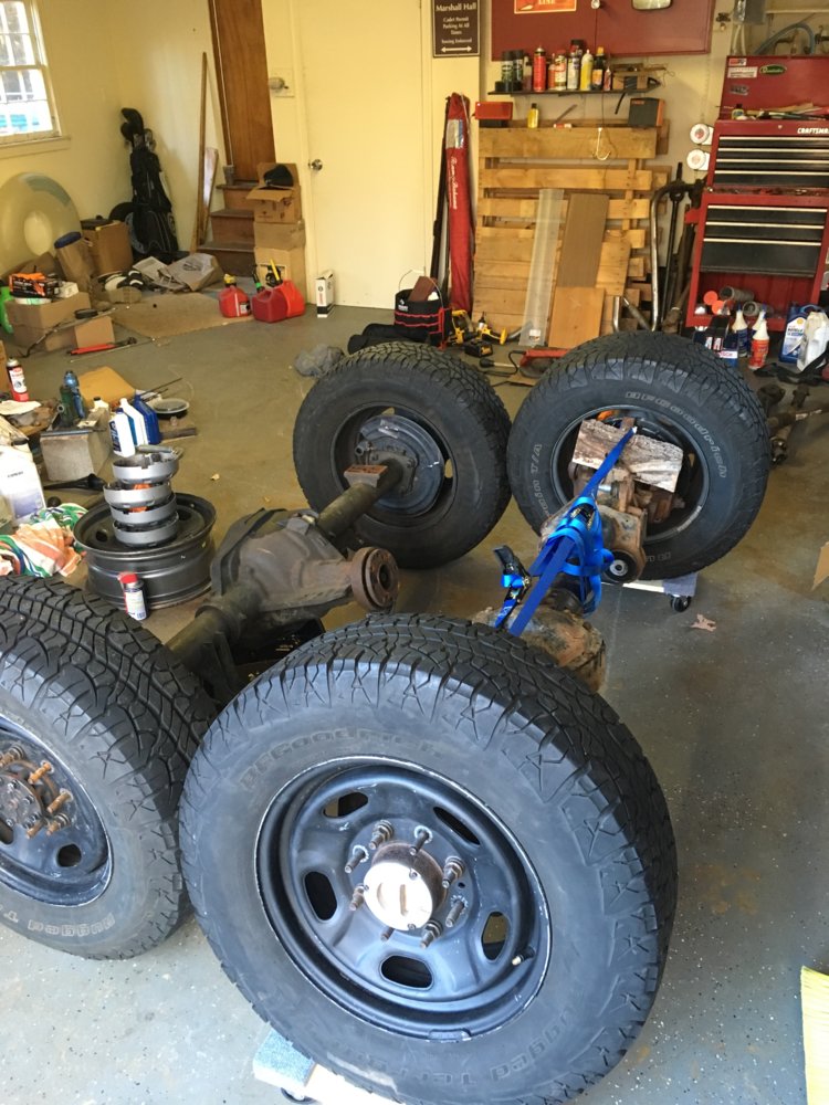

Let the new year begin. I thought I was going to be nimble and let the lockers and high ground clearance do the hard work. After wheeling for two years on some trails I would consider hard it was always ledges and undercuts that stopped me. I researched and projected costs and a tow rig and trailer won't be realistic for the next two years. I figure if I make my axles bombproof and keep a simple fuse (1310 u joints) I won't have any issues on a drive home from where ever.
Plans are 5.38 gears/detroits front and rear. I have until August to gear these myself then they have to go under the jeep. 3 link the front and keep the leaf springs in the back. I plan on bumping my 3.5" coils to 4.5" coils. I'll retain my 35s :eek: until I can afford new tars, hopefully a nice radial 37-40.

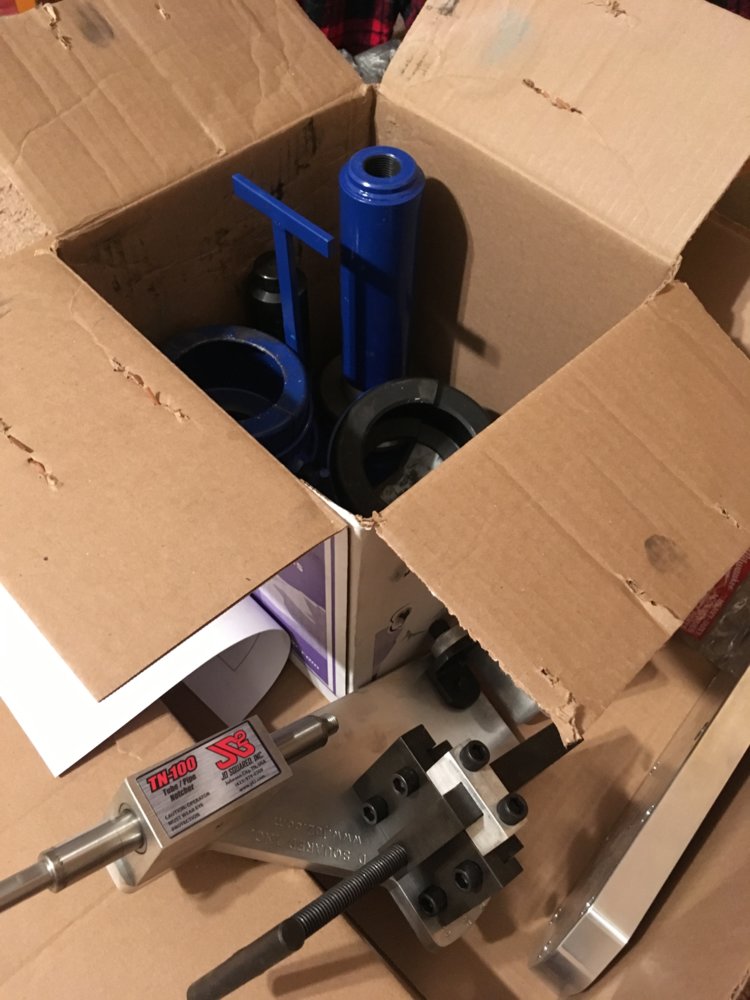

The front 60 is a little intimidating. I am already saving bookmarks of the special tools people need to take these apart and put them back together. To remove the awful brackets that SD 60s have I will use a porta band and my trusty angle grinder.
