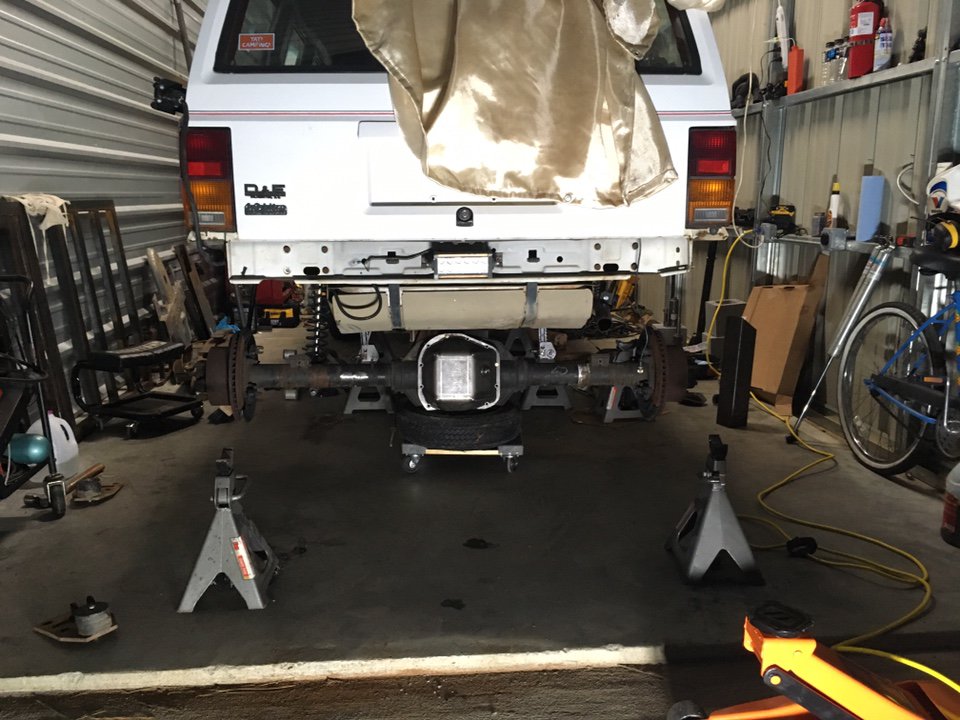

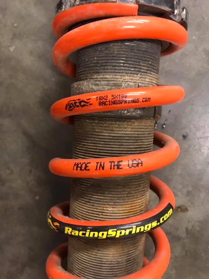

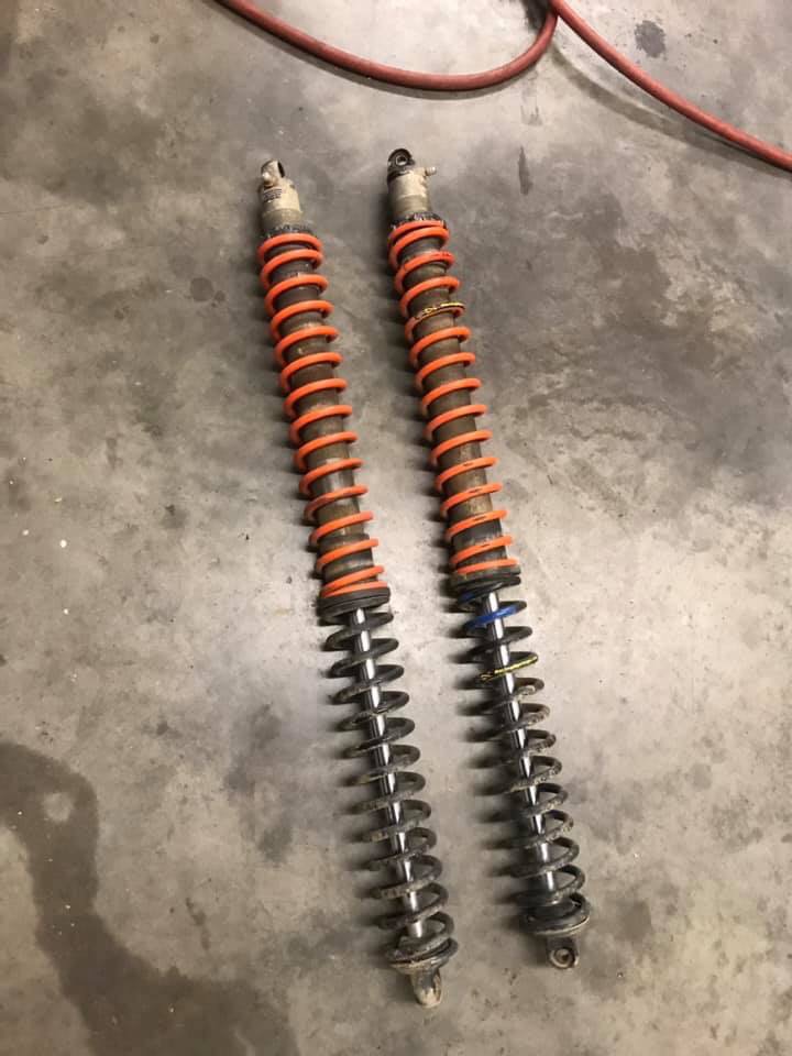

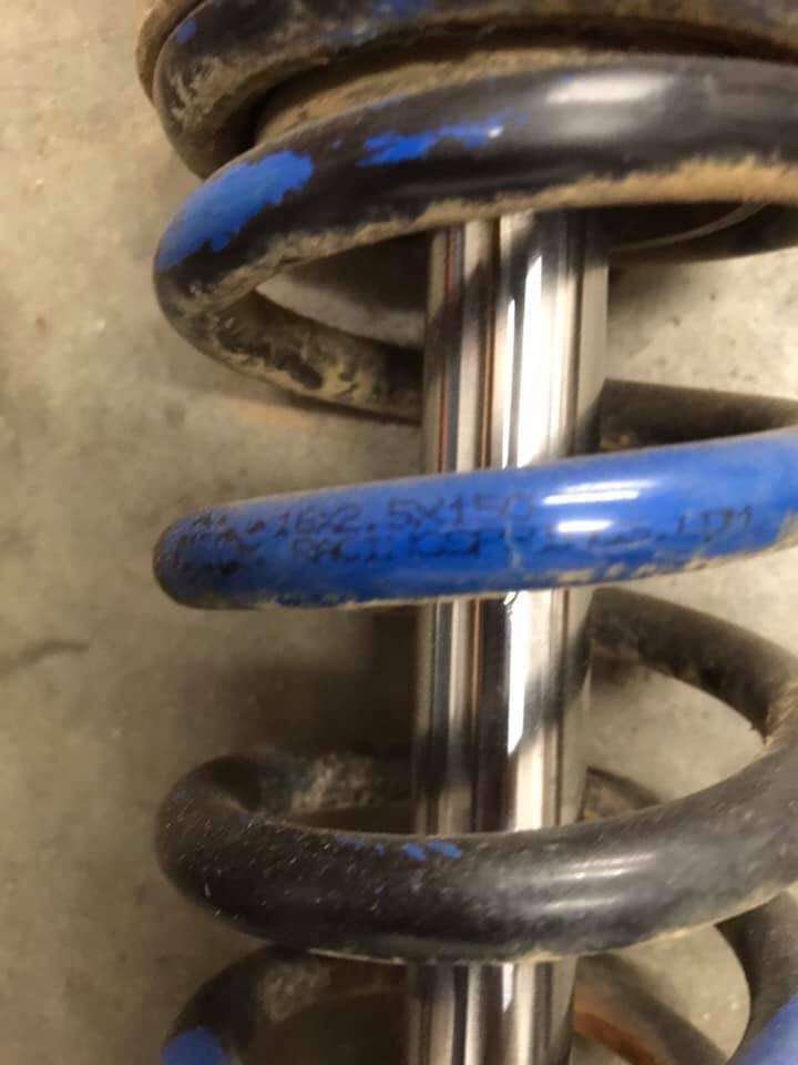

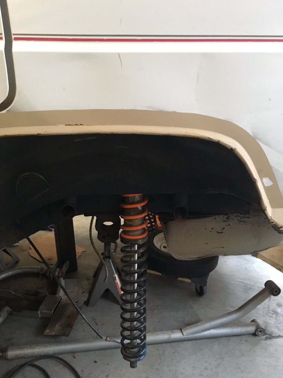

Shit box Cherokee here we come. 16” fox coilovers. Came off of a V8 wrangler crawler, rear springs, so I think the coils will most likely need changed but we’ll see.
Plan is to put these up front. I realize 16” is way too much but I don’t mind cutting a hole in the hood for the hoops to make room for them.
They won't work for you but those rates would work for my jeep. Just send them to me so they'll see use this year :flipoff2: Honestly though I'd buy those if you wanna find some 14s.
Maybe, that would be assuming that said shop had all brackets in stock.
Chris was right. The coilovers won’t work on the front so I guess we better put them out back :flipoff2: these are only 2.0 coil overs. I was reading for a Cherokee rig 2.5s are better on the front. Figure 2.0s will do fine in the rear.
Trying to place the sterling. I think it is time to relocate the gas tank up even with the frame rails. Can’t promise there will be enough clearance.

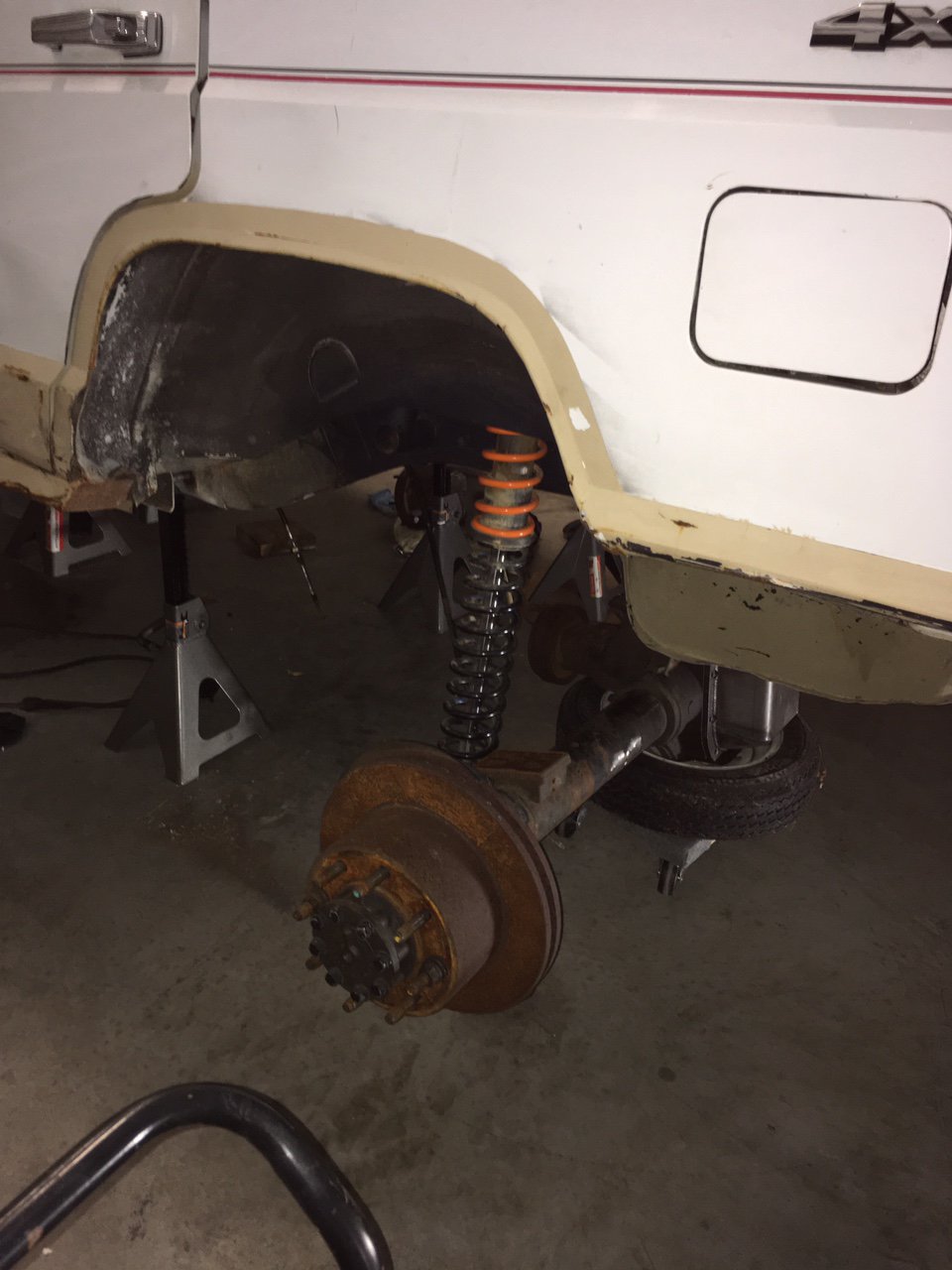

Front stiffeners are here. After that it’s time to redo the rock sliders then redo the rear wheel wells for the stretch.

Unless you plan to race in some form, 2.0’s will be plenty sufficient.
A bigger issue is when you need super light spring rates ( <100lbs coils) they tend to bow badly when over 12” long.
This is sometimes the reason to go to a 2.5” to run a larger 3.0 spring.
One down fall to bigger shocks mounted on the axle, is that the ride quality can become quite harsh, just getting the valving to start working. The 2.5s require more force than the 2.0.

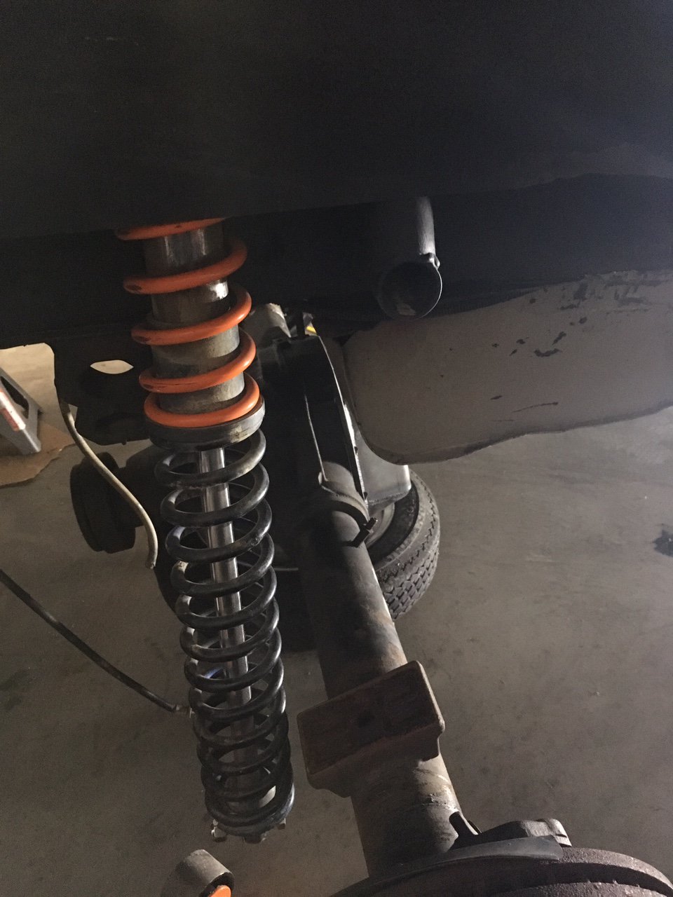

Thanks for the insight. I’ve got a lot of reading to do. I’ve already digested most of the pirate information. Only to get the idea that I’ll just need to get rough estimates and try something.
I don’t plan to try any sort of racing but I do want to be able to ride down the interstate from time to time with some sort of peace of mind that the suspension will be manageable in the event of a high speed maneuver.
Should I plan on having at least one anti rock swaybar with coilovers?

I actually quoted some high quality leaf springs and thought let’s just triangulate the rear with coils for a little bit more.
Do some more digging and because I am lazy I look up Ironman4x4 rear coil conversion brackets. Almost $400. Add coils to that cost. Shit. I already have the coilovers and hoops.
