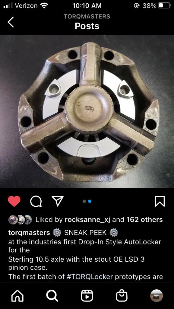

Got drivetrain on my mind. So I bought the sterling 10.5 rear from a guy that chipped a tooth on one of the spider gears. It is a LSD carrier and for some reason I can’t find any new spider gears out there other then find one in a pick and pull. However I came across this on Insta the other day
A company is prototyping a drop in ratchet locker for the OE LSD carrier. I thought that was pretty cool. Might have to message them about pricing. I was really considering the Yukon auto locker but this looks pretty neat if it saves me a couple hundo.
A drop in ratchet for a 10.5 would be the ticket! Why there's not more options out there for Sterling's is beyond me, considering the 10.25 and 10.5 share the same internals. ARB, full case Detroit, Grizzly and Trutrac are all I'm aware of. None of them are cheap either.
I ended up opting for the Grizzly for mine. I can tell you first hand, there is nothing gentle about a Grizzly locker at all. My wheelbase is still hovering around 100", which has a lot to do with it. It bites hard as hell going into even the mildest turn. It wouldn't be as noticable with a longer wheelbase like you've got. Part of me almost regrets not going Trutrac in a way.
I've got one in a 14 bolt and I agree. Mine is in a longer wheelbase than yours but still pretty violent. I also don't much care for the "slack" in it either. When you park it will roll enough to catch you off guard. It also gets "slack" in it in driving where your on and off the throttle quickly (like a parking lot).
Another option that I think gets often overlooked for the sterling is the factory electric locker. It's a selectable locker that pretty strong and becoming pretty cheap also. Probably about as much as the drop in locker would be.

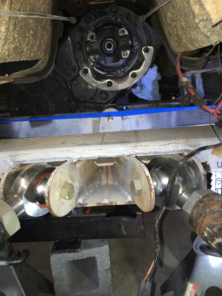

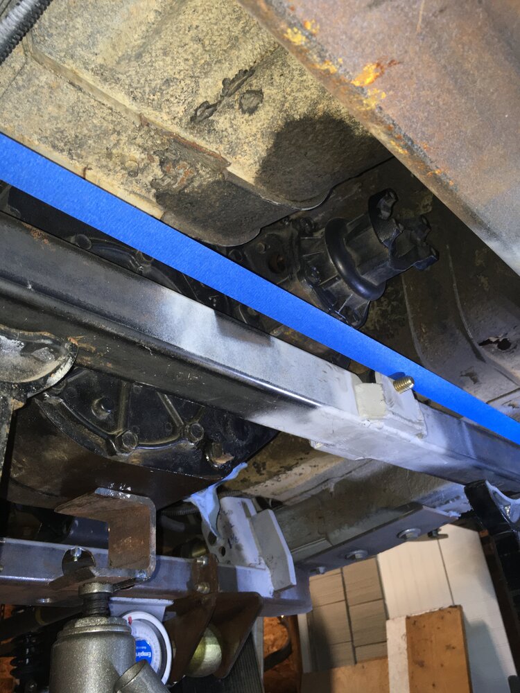

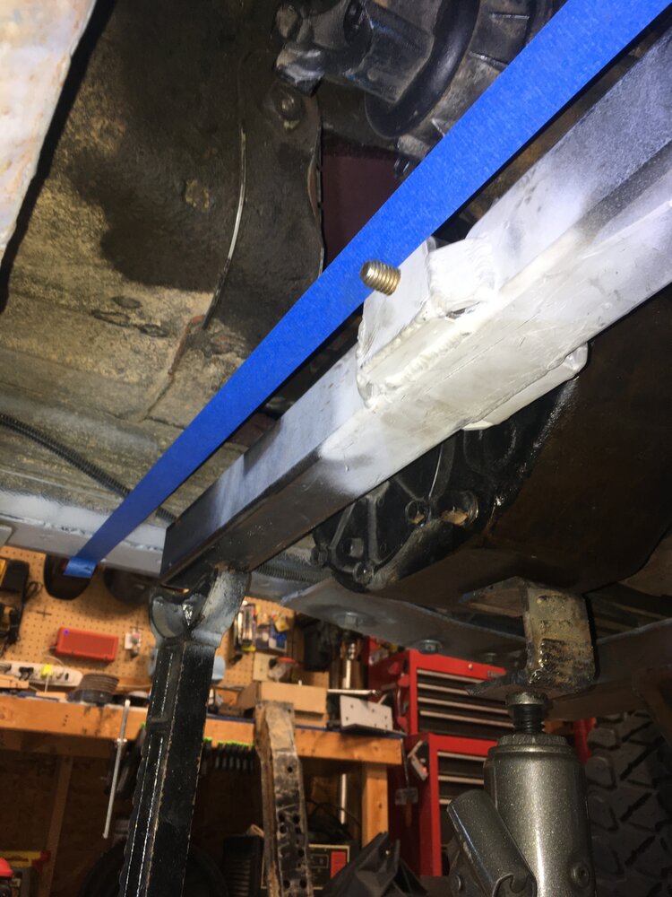

Back at the crossmember work. Want something low profile and simple. Flange tube connection will be welded to the stiffeners. Center section will drop out similar to the forward crossmember. Single bushing mounted in the same direction as the AX15 mount.
Probably going to chop out the entire trans tunnel after finishing this.
