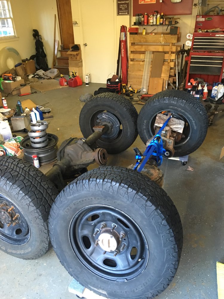

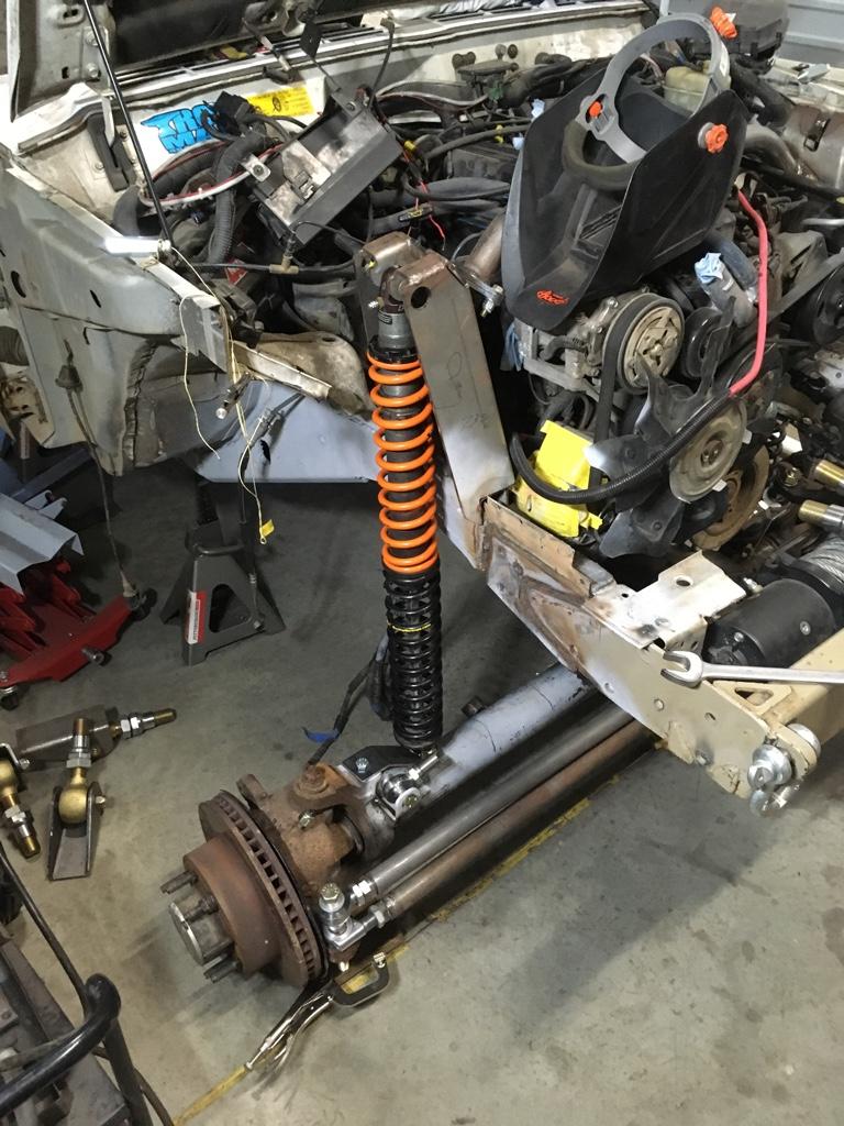

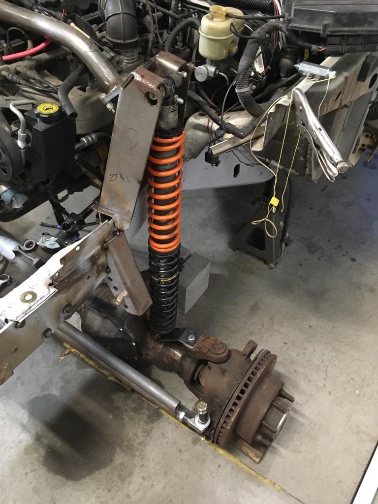

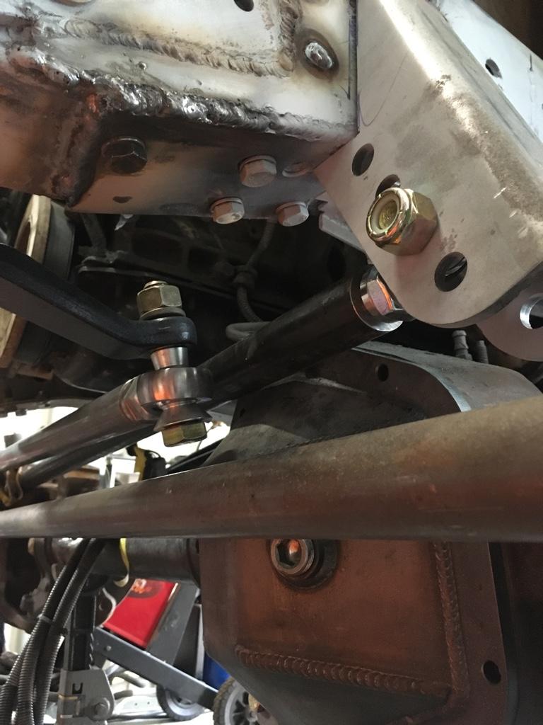

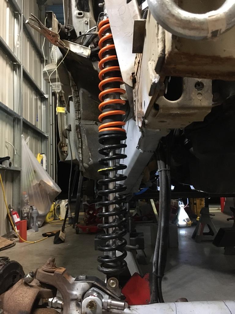

Let the new year begin. I thought I was going to be nimble and let the lockers and high ground clearance do the hard work. After wheeling for two years on some trails I would consider hard it was always ledges and undercuts that stopped me. I researched and projected costs and a tow rig and trailer won't be realistic for the next two years. I figure if I make my axles bombproof and keep a simple fuse (1310 u joints) I won't have any issues on a drive home from where ever.
Plans are 5.38 gears/detroits front and rear. I have until August to gear these myself then they have to go under the jeep. 3 link the front and keep the leaf springs in the back. I plan on bumping my 3.5" coils to 4.5" coils. I'll retain my 35suntil I can afford new tars, hopefully a nice radial 37-40.

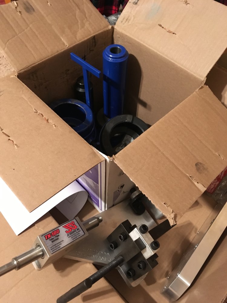

The front 60 is a little intimidating. I am already saving bookmarks of the special tools people need to take these apart and put them back together. To remove the awful brackets that SD 60s have I will use a porta band and my trusty angle grinder.
Let's see how long it takes before I am broke and single
