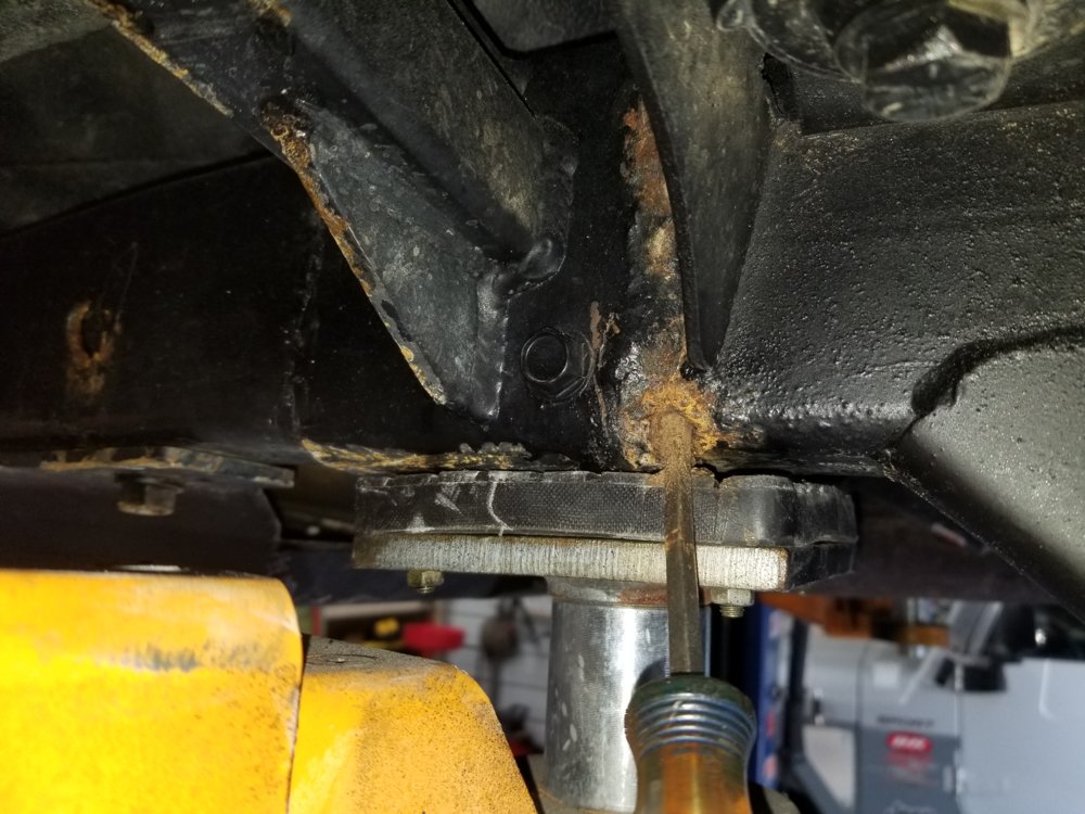

With a screw driver check the rear control arm mounts at the frame.

Yeah my shit lookeded great..till the screwdriver from hell
So try to stick the screwdriver through the frame in that area?
yup....like you're tryin to reach that last 2" her baby daddy never could
