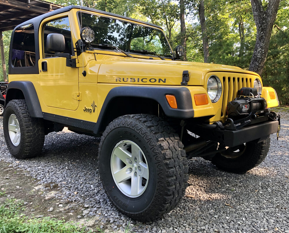

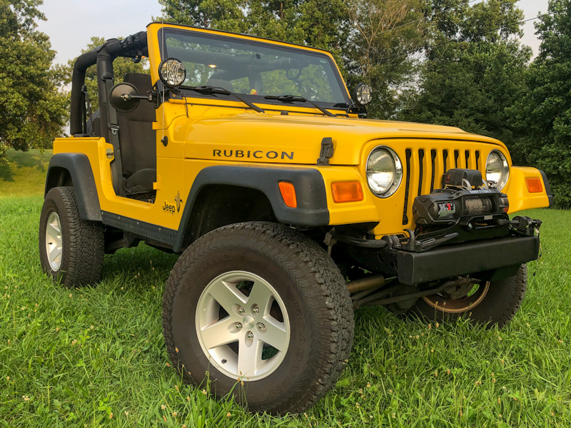

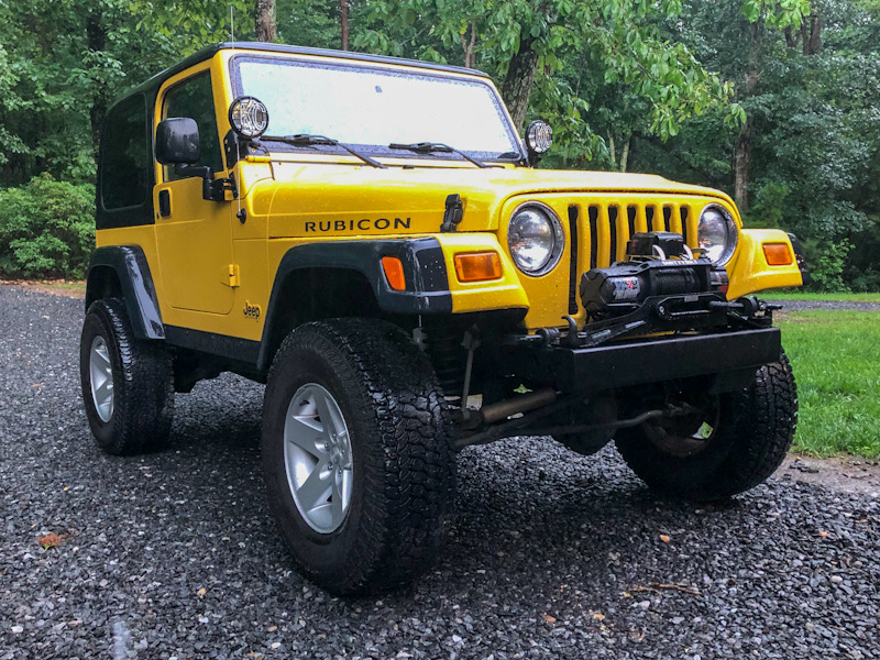

You need to use a scan tool back and tell you if the PCM is seeing the cruise control request. If it is not seeing the request you very likely have a bad clock spring.Measured for bumpstops. Rear is good, front needs 2”. Ordered Rubicon Express front lower 2” kit, comes with pads that have a countersunk hole and self tapping bolts. Easier than hockey pucks.
I realized that the rear brake hose runs down the left upper link along with the locker hose and harness so only front need the extended hoses.
I see a little ATF slung from the Tcase rear output so I have a seal coming.
@Jody Treadway I measure 5v at the cruise on/off switch on one of the 2 wires. The switch is switching according to my multi-meter (random ohm readings but change when pressed) and I see resistors on the back of the switch. I assume depending on what button is pressed, a different signal is sent back to the PCM.
Would a good next step be to secure a scan tool somehow and see if the PCM shows the switch as working? If it doesn’t I would think clock spring. If it does maybe cruise servo.
I approve of this messageBrake hoses for the front are here. I also have 3” front lower bumpstops and 1” rear upper cup spacers.
I added an inch to what I needed so when I switch to 35s I have the room. It should have 5”+ up and more down.
As an occasional wheeler, I don’t want any more lift. It drives so nice and has zero bumpsteer or DW. Being able to cruise the parkway and backroads without drama are more important than ultimate wheel travel and I won’t be happy until it has 35s.
I’ll cut the front 3” lower bumps to 2” to use for now and save the extra inch for use later. Won’t install the rear til later.
