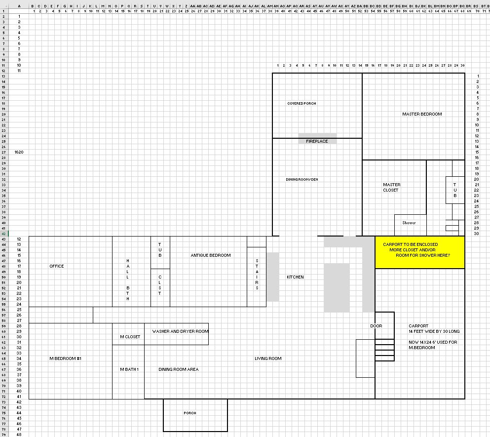

Wanted to get another series of input here from our builders and renovators! Sold our "vinyl village" home back in January, currently living in a 1600sf brick ranch with full basement, 3 bedrooms, 2 bath. I have the option of buying it from our family biz, we just finished 6 month renov on the house, looks fantastic, but even then the master bedroom bath / closet are still on the small side.
Still fighting with the city about sewer/easement stuff so no idea if/when that will really happen, could be tomorrow, could be another 8-10 years!? So not sure if/when we will ever get to build our 'forever' home so just thinking about other options.
After just moving in...we are a bit tired and LOTS of temptation to make this house fit our needs instead of moving again. Would not be perfect but would check a lot of the boxes.
I will upload a couple pictures, but basically thinking of a 30x30 addition on the back to be a 4th bedroom and Den/Living rm (or Dining) and covered porch. What I am sorta hoping for is somewhat educated guesses on this is a $100k project, 50k, whatever!?
Original house built in 1968, has septic system (cleaned out / working) so my guess is a major hurdle will be if I can even add another bedroom/full bath? Assuming I can, probably adds to current field, maybe $5k to the price here?
House is all red brick, looking at Hardie board / brick / stack stone for siding? Roof is decent shingle (all new roof on renov/house), flooring will be 100% Luxury Vinyl plank to match current house.
Gas Fireplace
Master Bath with huge tub/jets, walk/ROLL in shower (handicap accessible), vanity/sink on each side of tub. I am thinking this is the biggest $$$ part of the project!
Current sliding glass door to rear deck removed / entryway to den/LR/Dining room. Window in kitchen becomes 'pass through' window.
Rear covered porch, not much to say, columns, stack stone / timber (craftsman style) and quite possibly wired in here for hot tub!
Current house is over full basement so add-on would be built over 'crawlspace' to be consistent level with home.

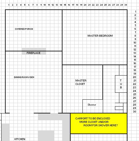

14'x30' single carport, to be enclosed, single car garage. Rear 6' or so possibly stolen/used as more closet for Master bedroom/bath? Could see putting shower there instead so all plumbing shares same outside/wall?
So what say ye? My plans are in Excel because "accountant" and all things are done in Excel...

You should be able to pull up the septic permit which will tell you the number of bedrooms allowed.
What I am sorta hoping for is somewhat educated guesses on this is $100k
Rob would be more of an expert, as would cyd and shawn. Your trim level and expectations will set the budget, but I wouldn't even consider it reasonable UNDER $100k if you're looking for turnkey construction doing absolutely nothing yourself. (For budget purposes)
IF additions to septic are even allowed. Pull the permit at the health dept to determine what your lot perks for and see
I would say if you touched almost every room and did the addition 100K to 150K
but this all depends on if you just hire a contractor and get nice fixture counter tops etc. granite/quartz etc
I don’t know that stealing space from the carport will help the layout you have planned. It could give you a larger closet and larger master but is it necessary? That new wall will potentially need a new footer cut through the concrete floor. You may could span the 14’ across but you still need a rim joist and footer added. With now it being a 1 car garage, you will likely want that garage space for storage.
Short answer, yeah the area in the carport can be used but what’s the ROI? Is it worth it? It’s probably cheaper to extend the addition a few more feet to get the extra space you want.
The big wild card is septic. Your lot may have been at its limits to be sized for a 3bdrm septic; a 4th edtoom May put you beyond your available leechfield area. Most AHJs won’t let you just add a line to an existing system. Requirements have changed and a modification likely wouldn’t be adaptable to an older system. Tank size is also determined by the gpd usage for a 3bdrm house. Adding a 4th bedroom increases the estimated usage by about 30%; an older tank may not be sufficient. At that point, you would be better to put a whole new system in to suit your needs. Remember, the addition may encroach on the current system or repair area, so it’s key to get that permit info, if available. If it’s original, it’s likely the county doesn’t have records of the system. At that point you’ll likely have to get an evaluation by the county and go from there.
With the house being a ranch, framing should be fairly easy. You can get pre made trusses for the simple roof lines and save some costs.
In Greenville, I’d probably budget $75k for that project until I decided on specific fixtures, septic, etc. enclosing the carport isn’t hard but there are code requirements which would likely need to be considered and adds to the cost. That estimate is purely based on square footage costs for average finishes and no major surprises. I added 10% to account for the carport enclosure. Price would go up or down based on actual scope, etc.

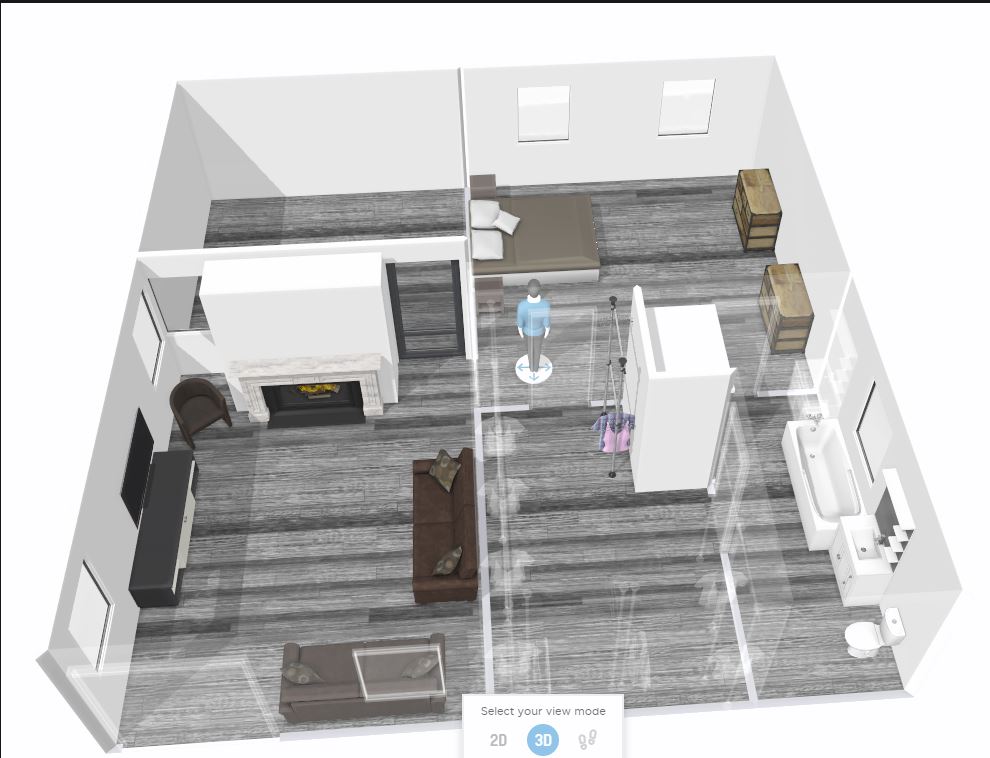

3D perspective of the add on, wife needed to "see" it instead of drawings. Moved the shower back to entrance of bathroom from bedroom, otherwise pretty much the same.

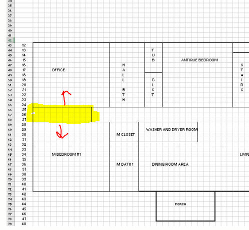

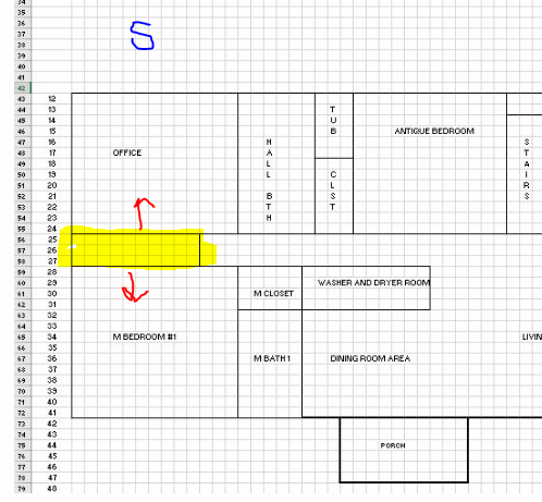

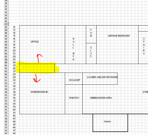

Here is the closet in question, current it opens into my office / 3rd bedroom.
In theory I could reverse this, create a 2nd closet into the current Master Bedroom#1 and build the addition and not have to get sewer folks involved?
Plumber will still have to run everythign down hill to the (S)ewer junction there...but would save $4500ish?!
I suspect that assuming it will perk, it is worth the extra $4500 to have a true, legit / permitted 4 bedroom, 3 bath home if I ever sell it. (Vs 3 legit bedrooms and an office)
