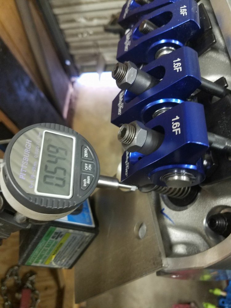

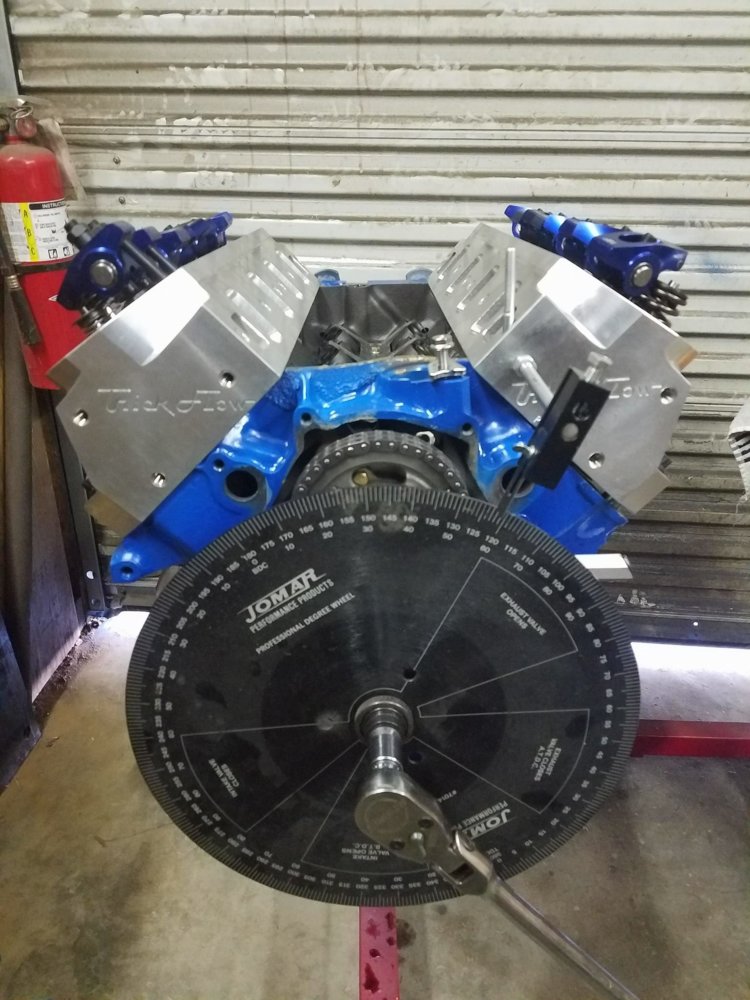

All the degrees...

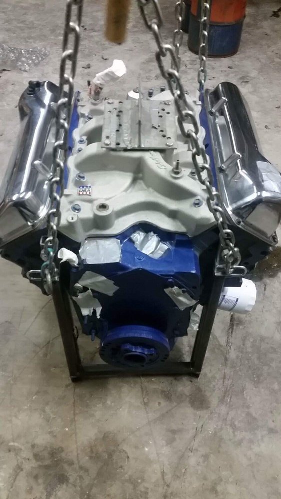

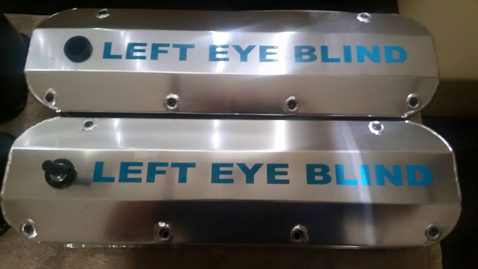

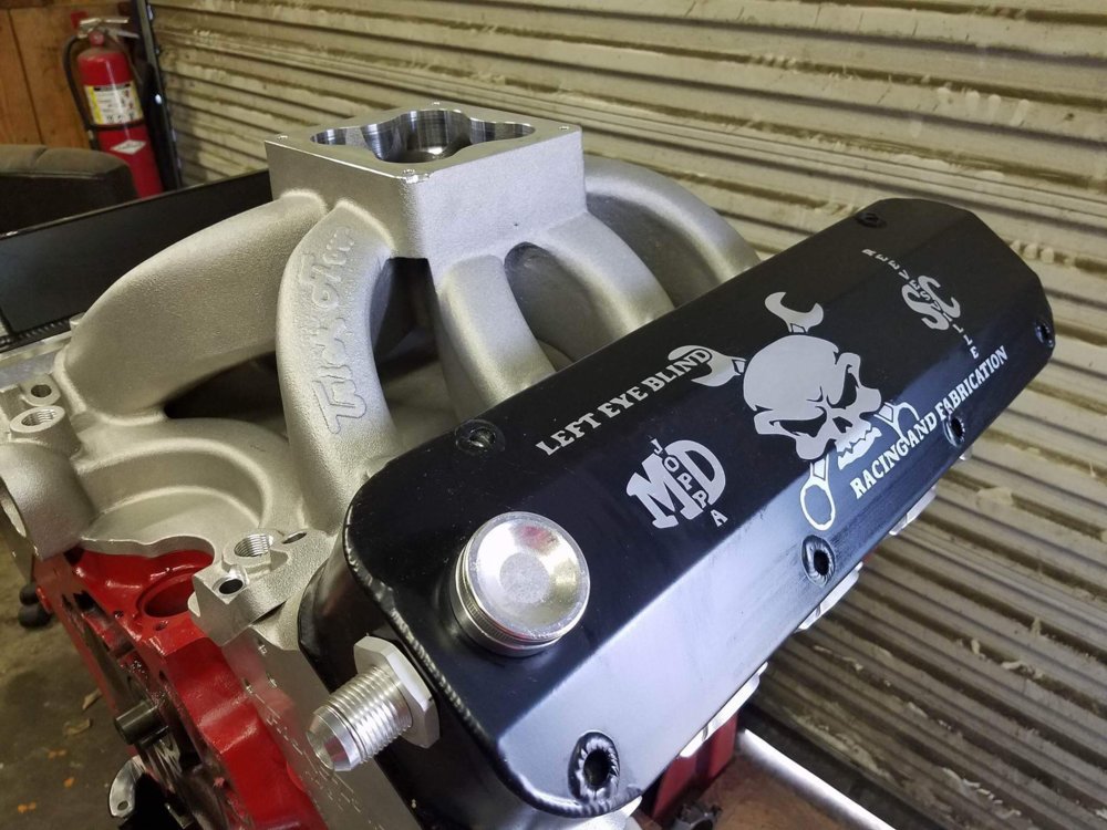

Do you guys fabricate your own valve covers in house? Those look titties!
Thanks...first few were done in house, more economical to send them out now to another shop better equipped to handle the demand. Still to our specs though. These are mine that were done in house. Probably the 7-8th set done.

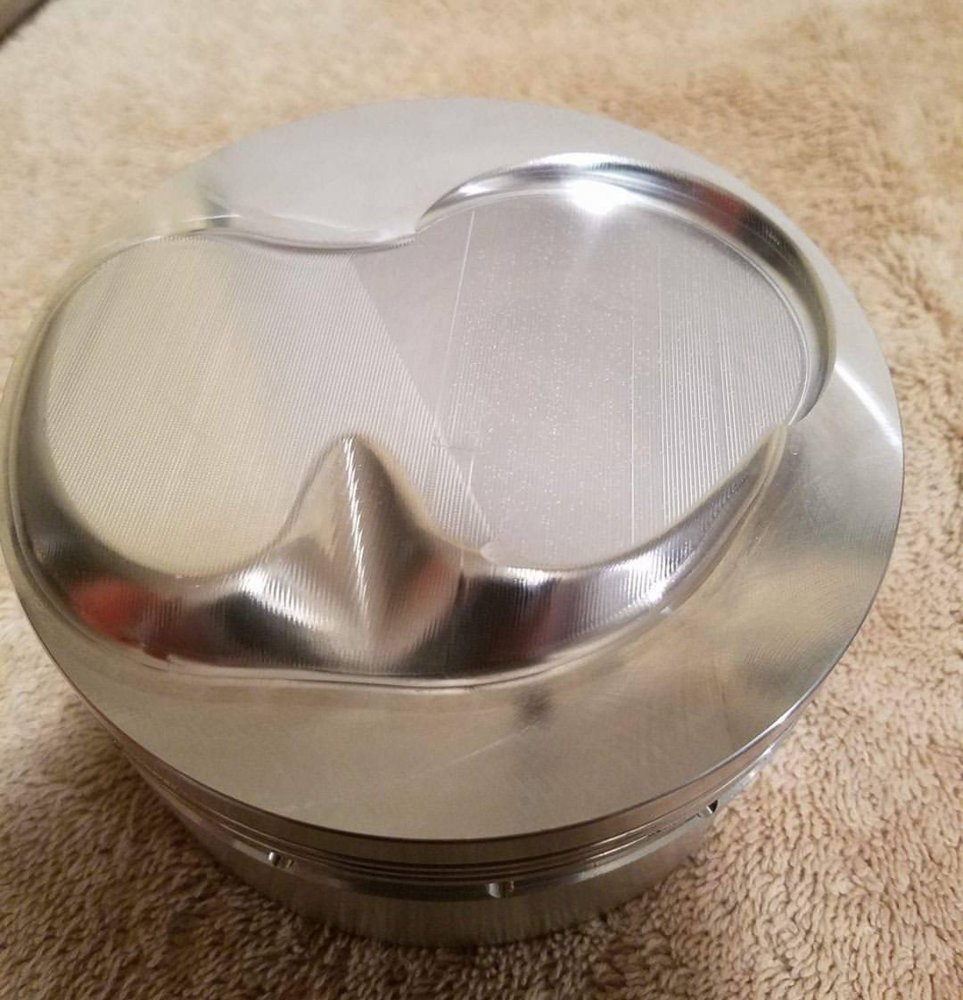

Not every day you see pistons like these. Project: Pumpkin Spice's pistons.
They're diamond forged, with 4.440 bore, 1.285 comp height, 7.8cc dome, adding up to 15:1 compression. Will go on Ohio 7.100" H-beam rods and a 3.890 stroke crank to make a 480ci...turning 8000 rpm, for a truck pull motor.

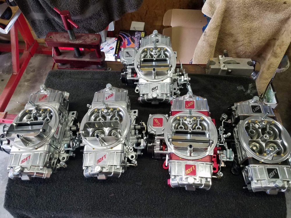

That's cool and all, but what's a carburetor?
:D
It's tough convincing guys they need to spend another $2500-5000 on an appropriate injection system when they've already dropped $15k on a 600-1000hp build.
But we are jonesing hard for someone to write that $25k check so we can do a 600ci efi 1000+hp street build.
Stay tuned though...my personal build will be evolving...I'll be going roller cam/aluminum heads/forged pistons first, but after that I'll be testing out a couple different aftermarket efi units from fitech to quickfuel and a couple in between. Make some Dyno pulls and see if they make any difference.

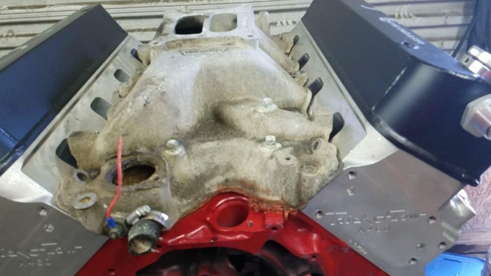

Thanks man...most of our base engine builds start at $4500, that would get you about 300hp out of an M. I understand that sounds like a lot since every build thread on the Internet has a buddy that gets free parts and machine work, but that's not much more than a Jasper, with twice the power and a better warranty.
That's exactly what this M turned out to be.

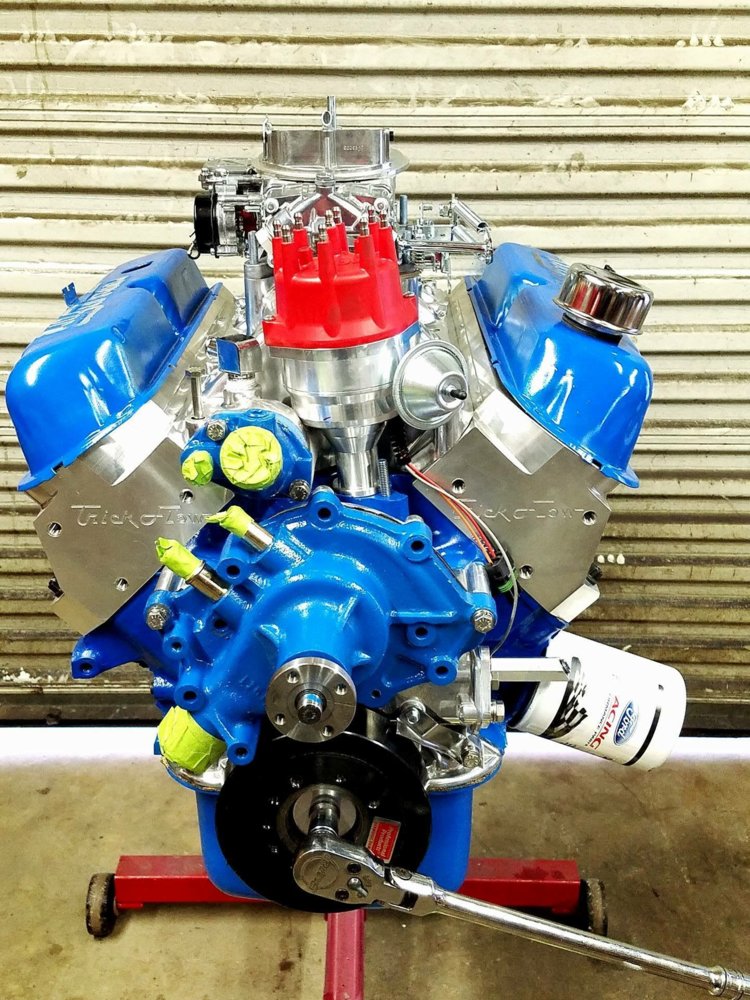

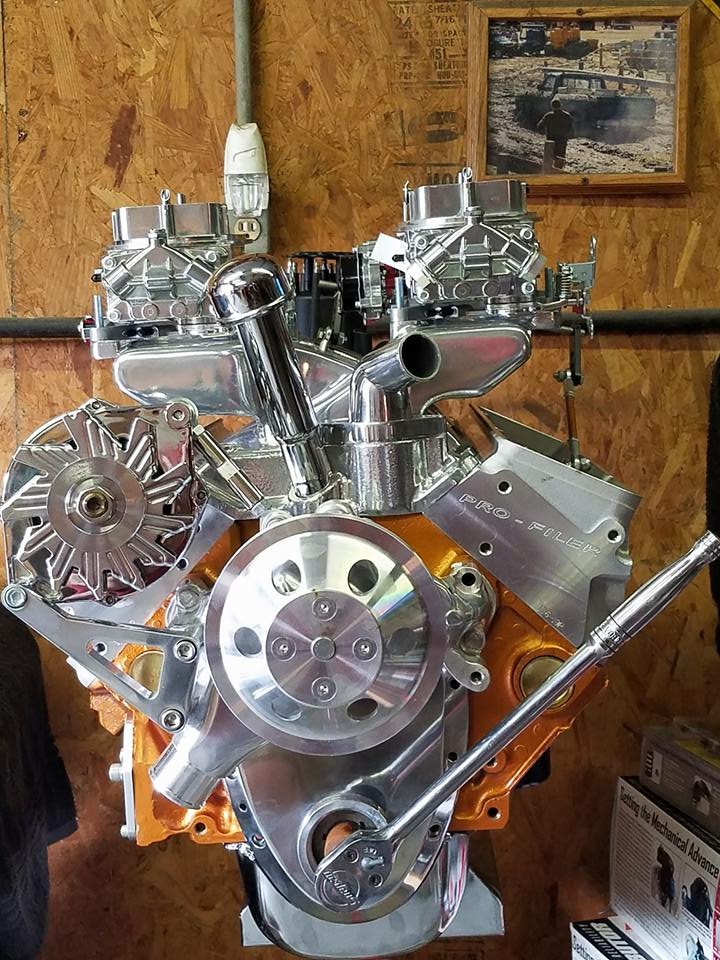

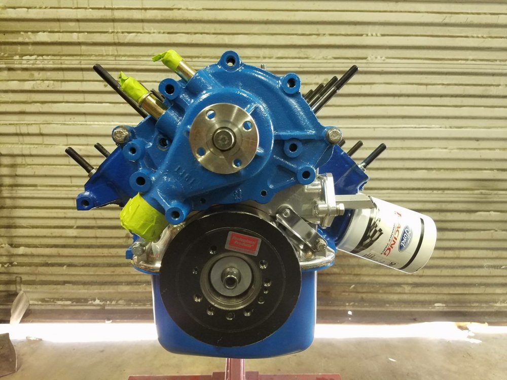

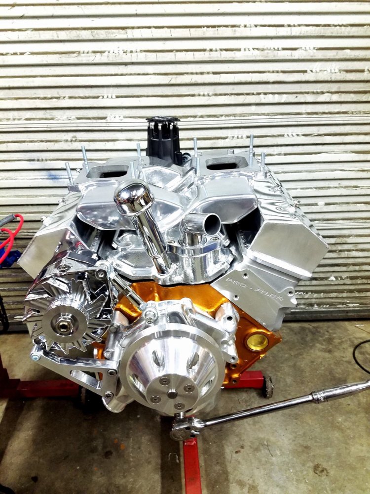

Personal opinion...this is the prettiest mota to leave the shop...
