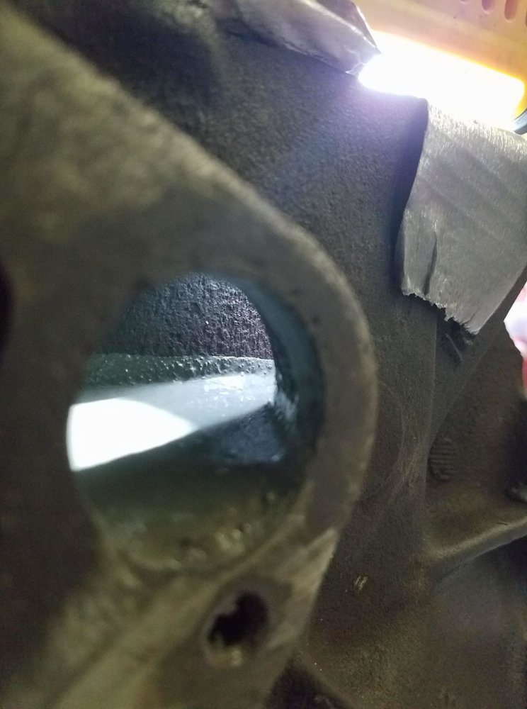

Alright...for the rest of the class...why in the hell would you fill a motor with concrete!?:confused:
Not actual concrete. Hardblok, it's an engine block filler to fill up water passages. It adds rigidity to the block. Same principle as not having an alternator on a drag car...since it's not running long enough to need an alt, it doesn't really need it. Since this engine will only be running a max of 30 seconds at a time, it doesn't really require standard coolant Flow.

With a partial epoxy fill, you can still get a decent amount of cooling flow at the top of the bore where most of the heat generation is.
That stuff scares me though, it never has the same coefficient of thermal expansion as the block metal, and it doesn't take much to shift bores or push them out of round when the block and epoxy start heating up at all. Expansion is geometry based and not only dependent on bulk material properties, so you're not going to just shrink a circle into a smaller circle, it's going to change shape instead. Less of a problem with iron blocks than aluminum, as the coeff of expansion of something like hard blok is closer to the c-of-e of iron.
Again, if you don't run it very long, you never build enough heat to create problems.
I've seen it done before, and I understand the theory behind it, but I'm still not really a fan. What I know about it, I'd typically advise against...but the class rules combined with power requirements, this build requires some creative and extensive machining to the block. Like I said, this is the first one I've been a part of and the first to go through the shop.
I haven't used it before myself, but I'm a big materials and composites guy so I've been fascinated by it for many years. I've had some past friends that have used it, with mixed results. It really seems like one of the modern high power block designs is the way to go, but only if the class rules allow it. There's just too many downsides and risks, I agree. If you have to wait too long to stage, all of a sudden you scuff a piston or 3 (or worse) during the run because you built too much heat, etc.

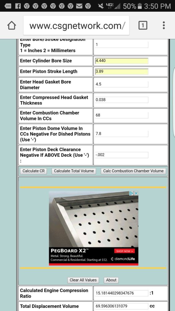

Top secret build...should end up with around a 15.2:1 compression ratio. This might require premium, or an octane booster from autozone.

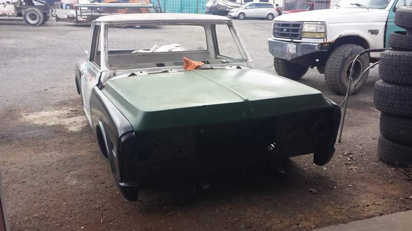

Are those wipers for a 2 or 4wd...haha. And a full size strip truck.

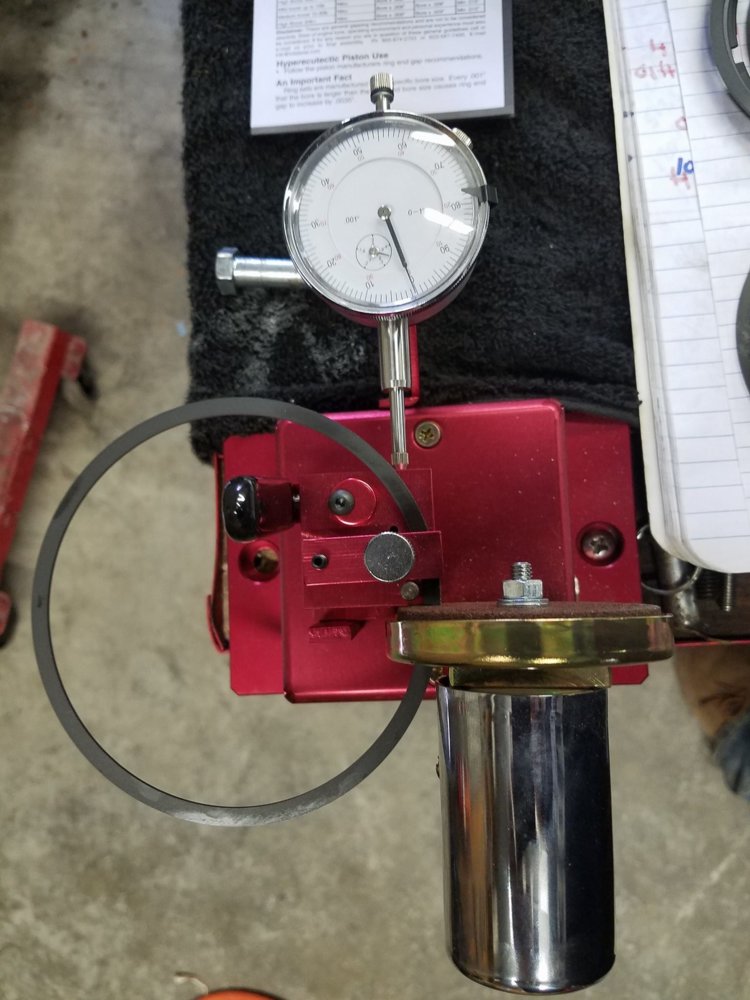

How did you get along this long with that many engines builds without an electric ring filer?
Power block says I just needed sand paper and a dremel. We had one...this is just a new one.
