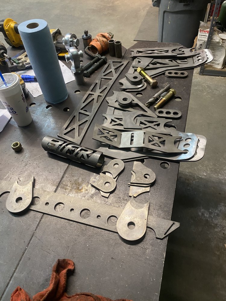

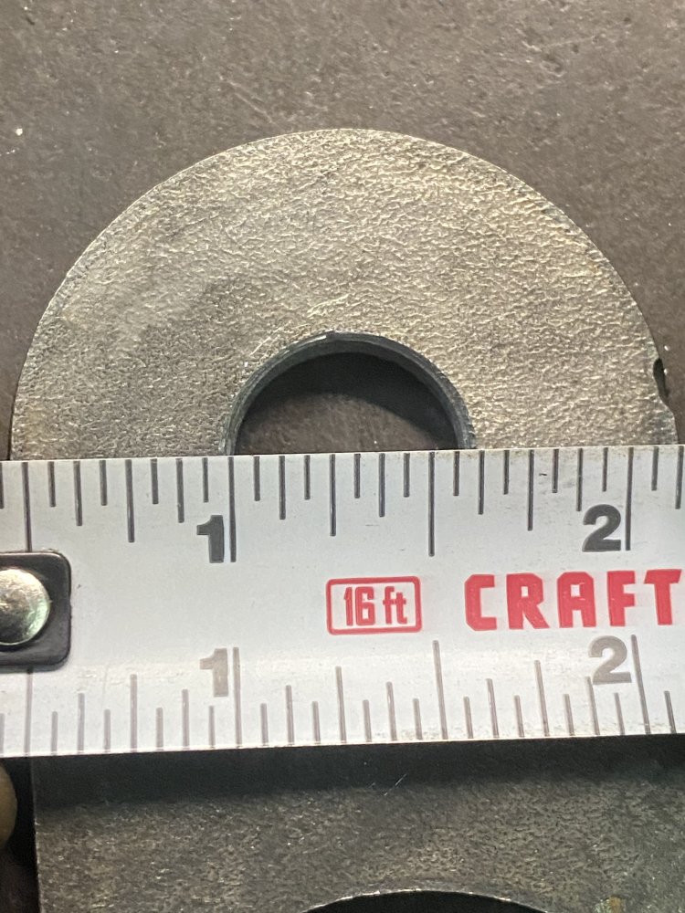

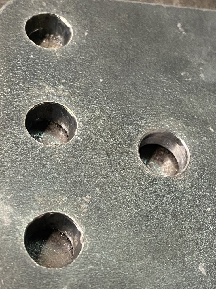

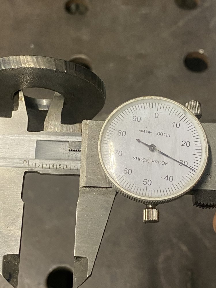

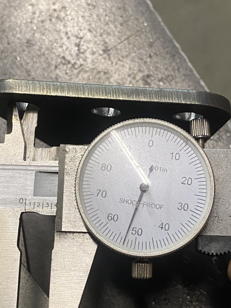

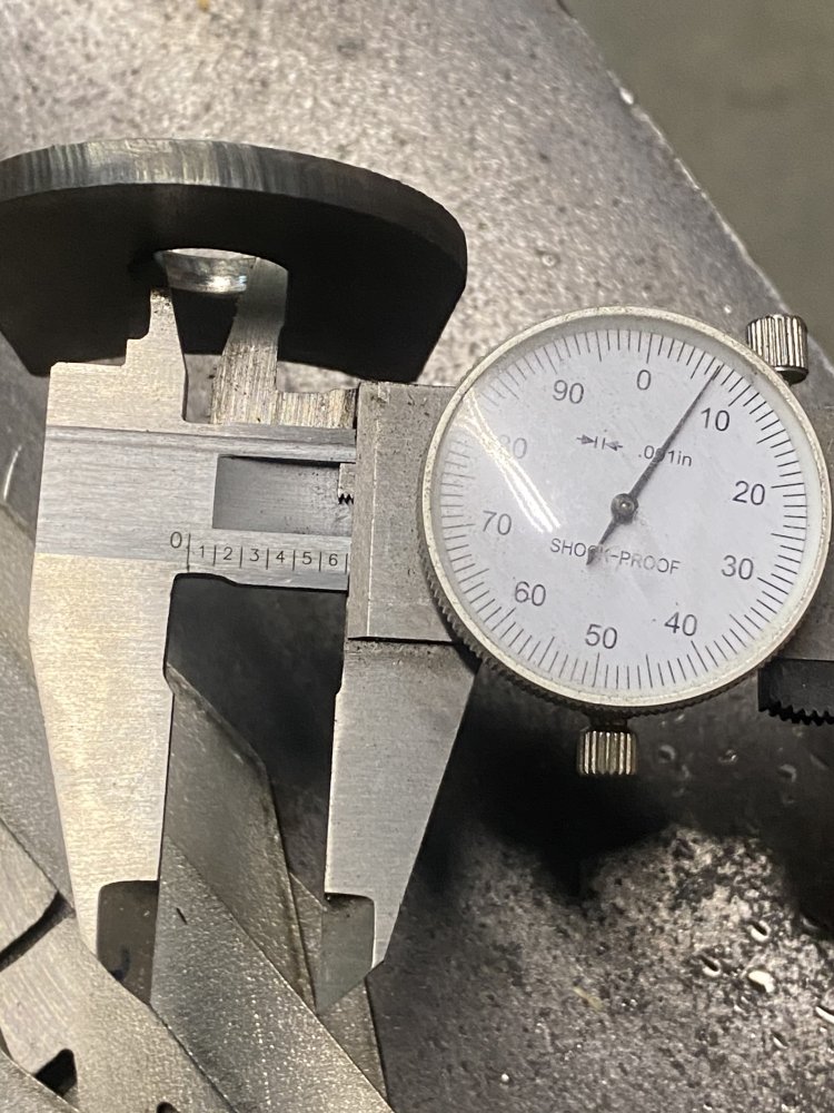

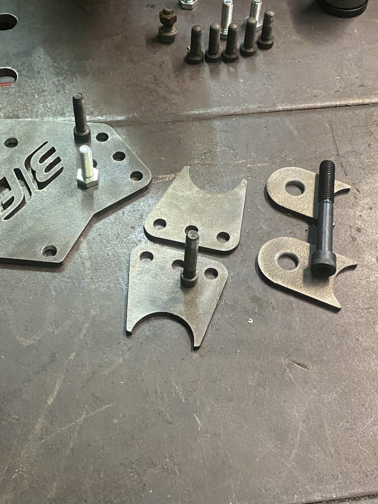

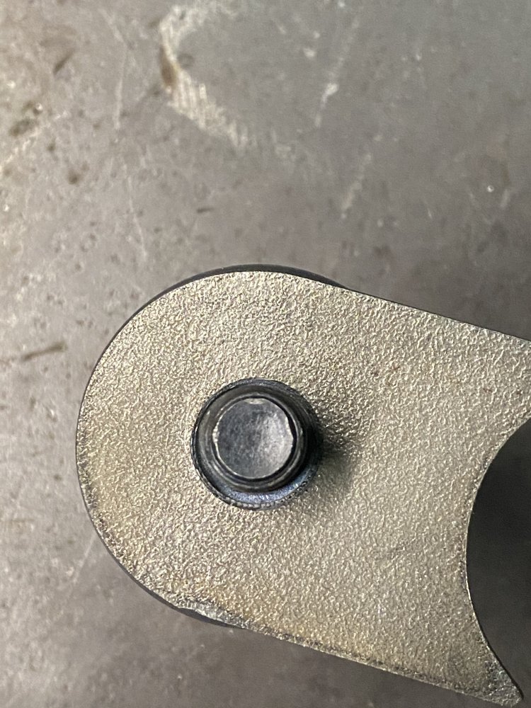

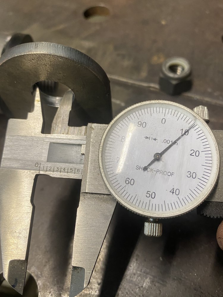

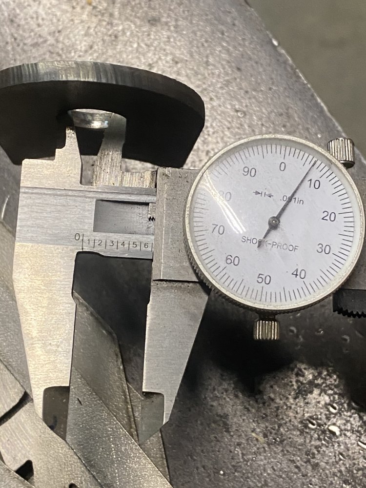

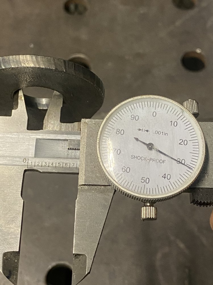

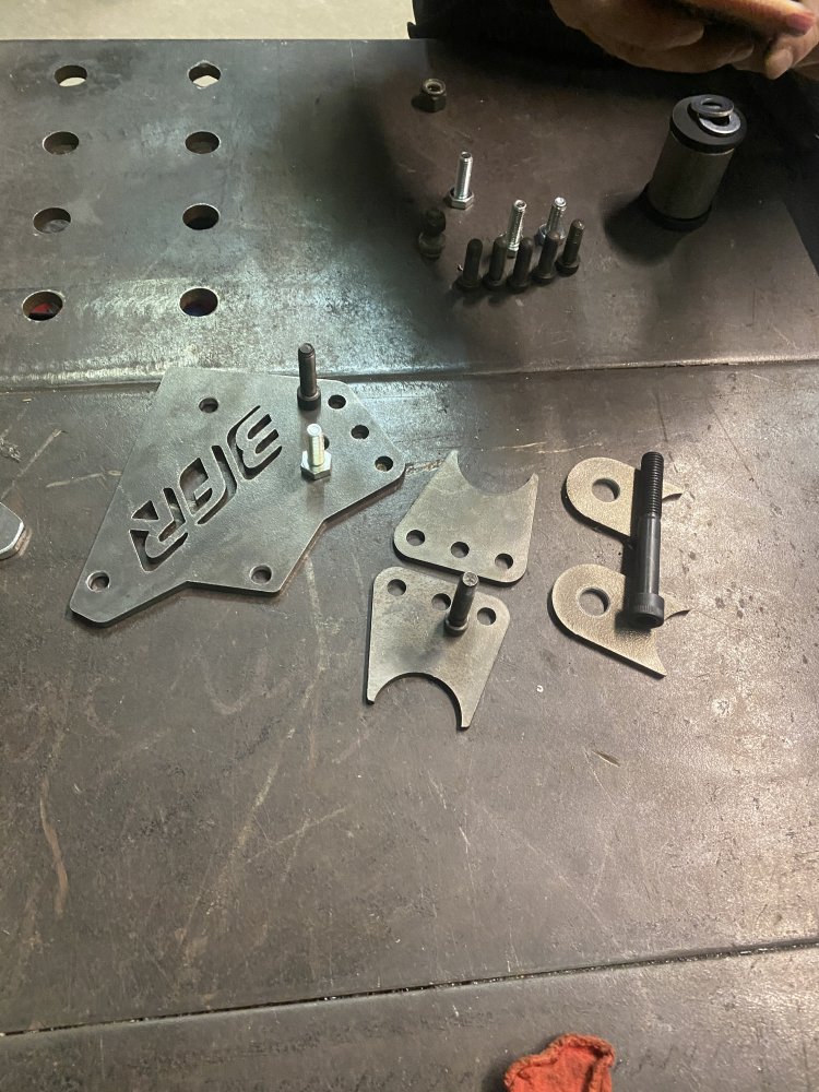

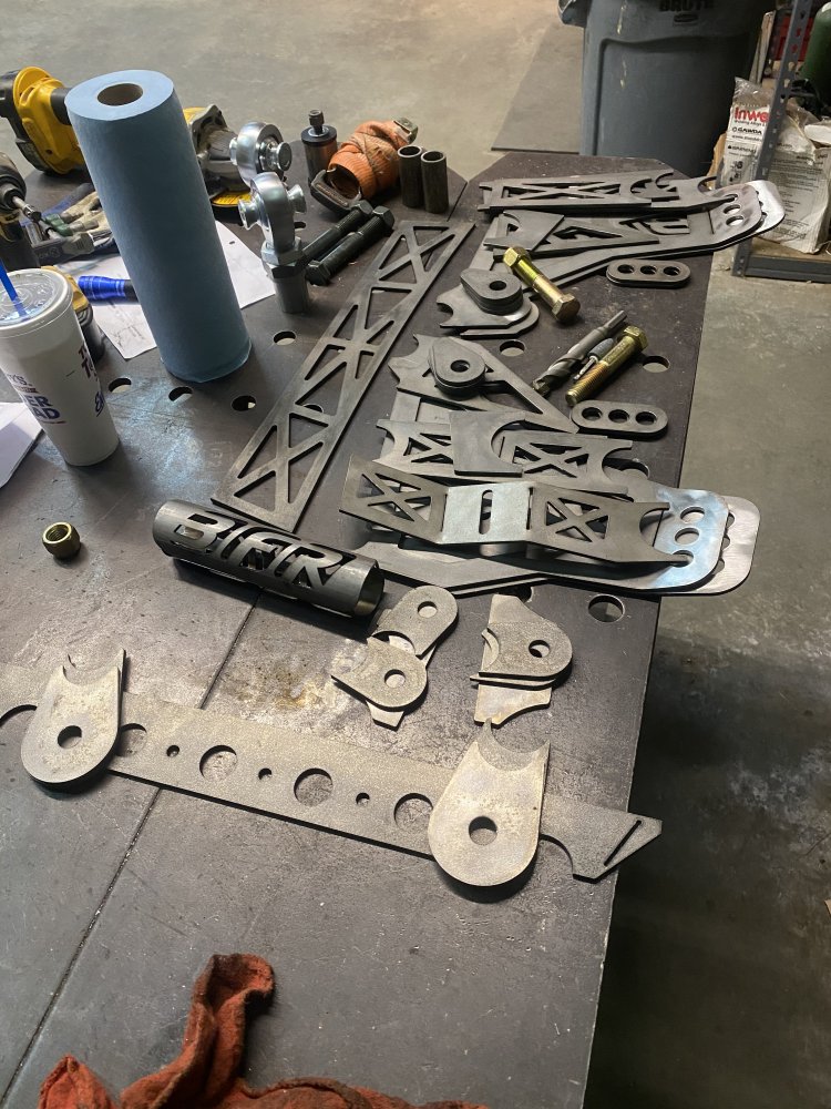

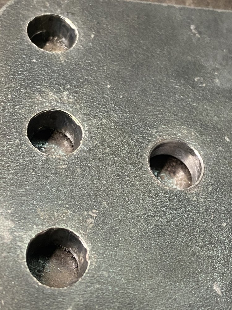

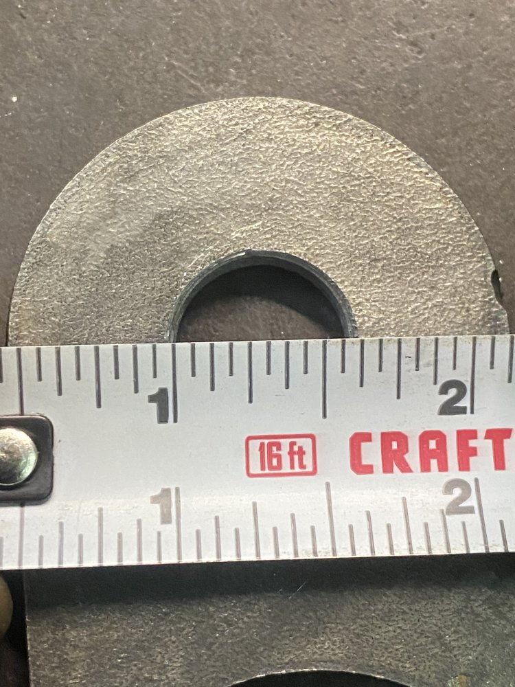

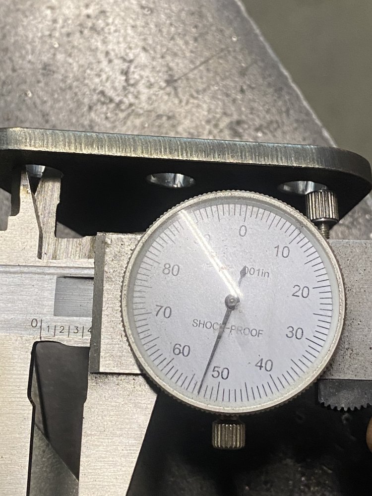

this is when we discovered, that all Tim’s plasma cut holes are all under size. Looking at the holes, he hit several with some type of wheel, as 1/4 to 1/2 the plasma cut edge shows signs of drilling/cutting etc. However a 3/4” bolt will not fit through the holes.
This is 56 or so holes through all the tabs, brackets, and reinforcing plates need to be drilled out to 3/4 to allow the bolts to pass thru.
so we checked some more 3/8 plasma holes for the motor mount package, and half the holes are drilled for the correct size (10mm for head mounting) yet the 3/8 plasma holes barely allow a 5/16 bolt to pass thru. 😠

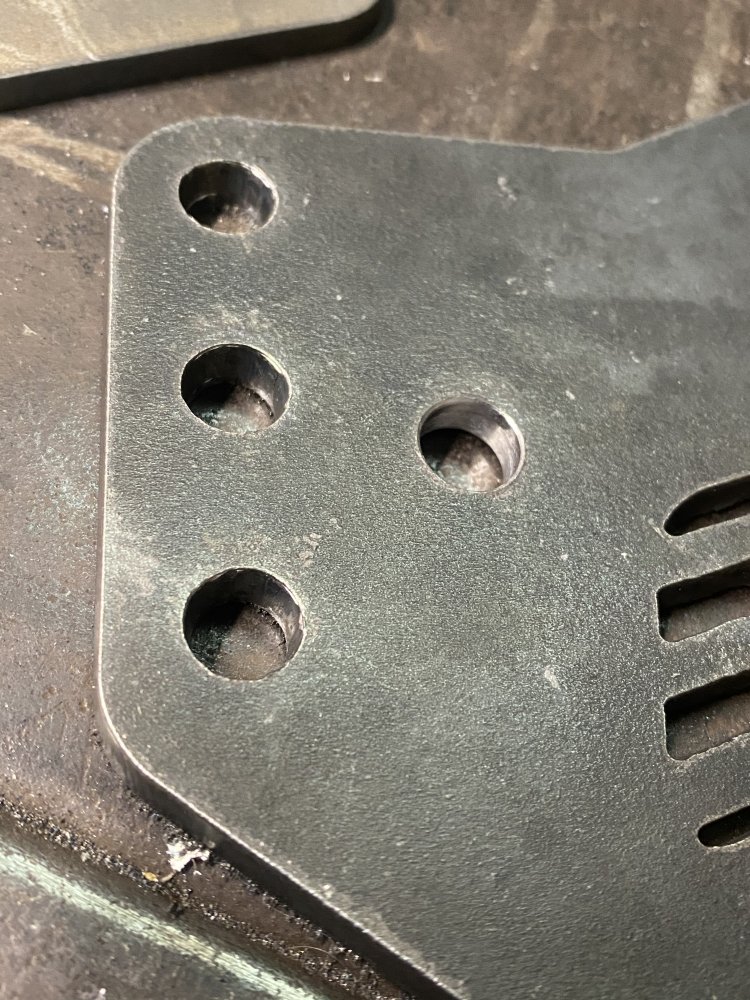

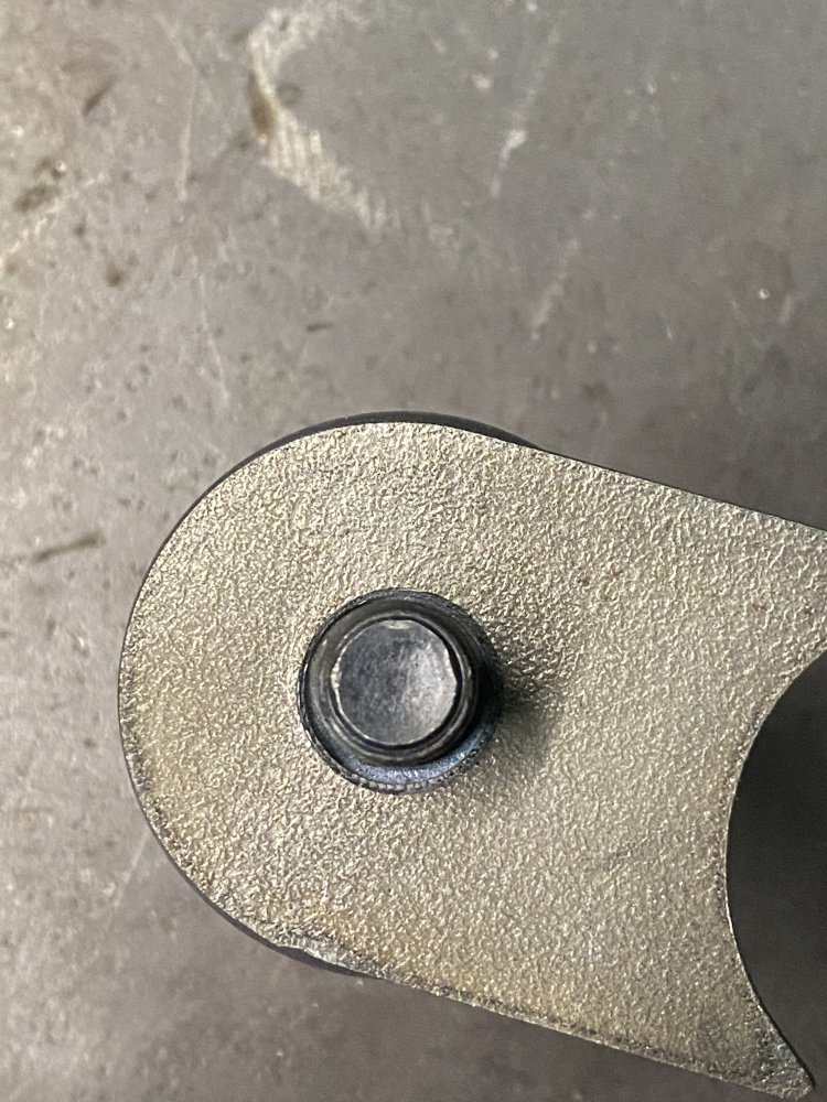

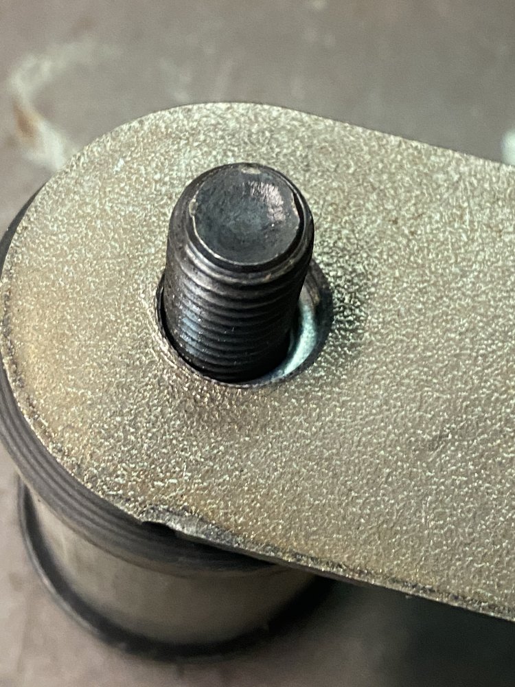

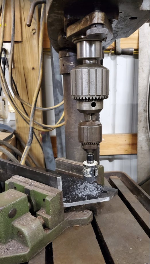

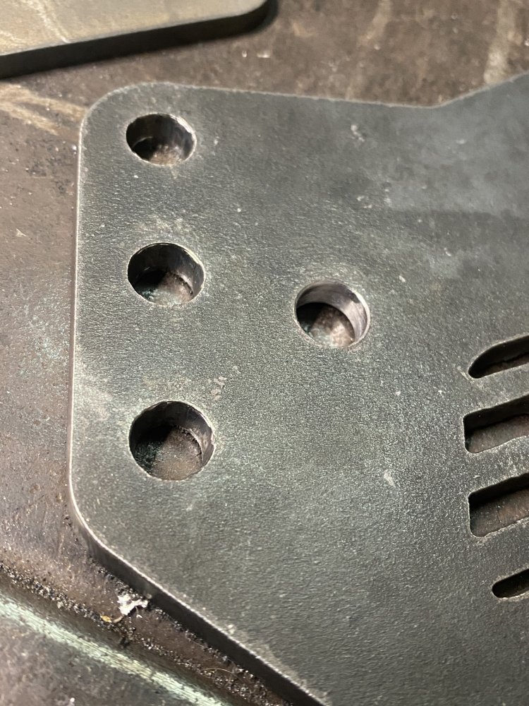

drilling a plasma cut hole is terrible. The plasma cutting operation leaves an oxide layer that is also hardened due to the extreme heat (45000-55000°F). This will kill a high speed steel or TiN coated HSS bit in seconds. The oxide and plasma hardened area is harder that the HSS.
Now when I cut holes on my crossfire pro table, I cut a test hole in scrap, check for bolt pass thru, and adjust my hole sizing before I cut the final part. OR I cut a .250” hole for location knowing I have to drill out larger. Typically I then use a stone wheel in a die grinder to remove just tiny amount of this hardened area and then hit with normal HSS or step bits.
Another option is to use a drill that is harder than the oxide and heat hardened area. Carbide.
So Steve went a grabbed a 3/4” masonry carbide tipped drill, chucked it up in the drill press and started drilling. I touched up the carbide to bring the OD down a little, and to increase the rake on the carbide cutting edge. It works, and makes a nice hole, but takes a lot of cutting pressure.
Going to take a while to do all 56ish remaining holes.

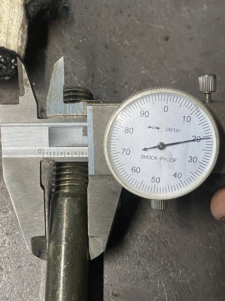

It’s also such a pain bc the holes are currently about the same size as the minor diameter of the 3/4” thread on the bolts. So it’s not like we have to remove a lot of material, but it’s all that oxide and hardened area.
It would be easier to take the hole from 1/8 or 1/4 up to 3/4, than what we need to do.
Steve is maybe calling Tim in the morning when cools off some haha.

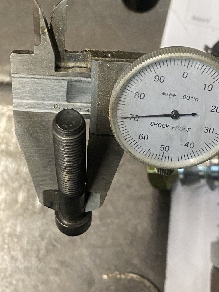

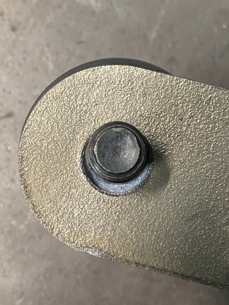

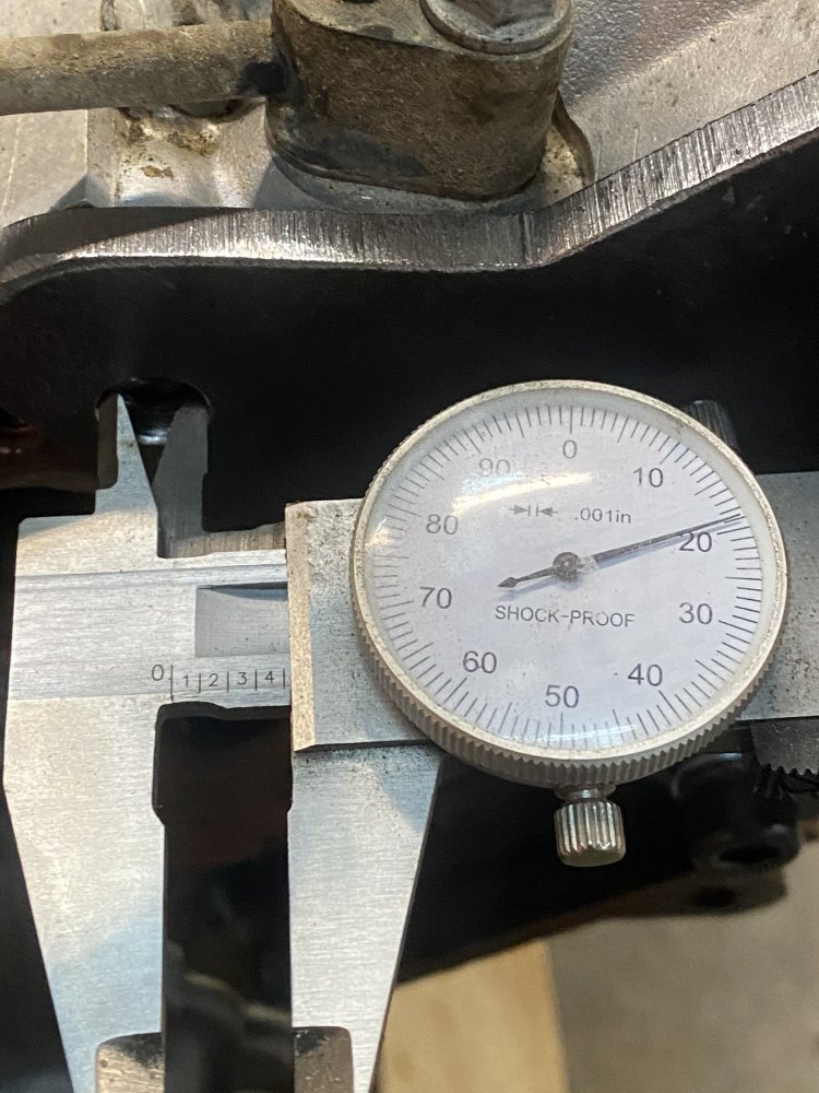

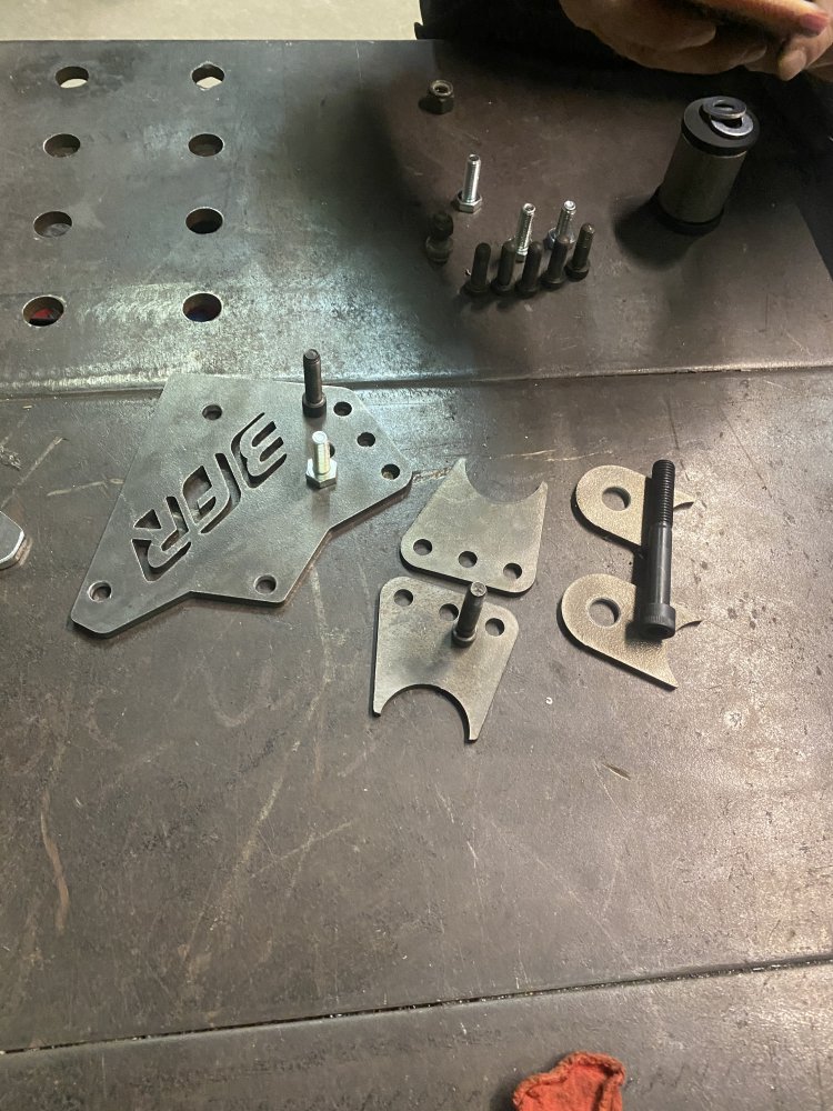

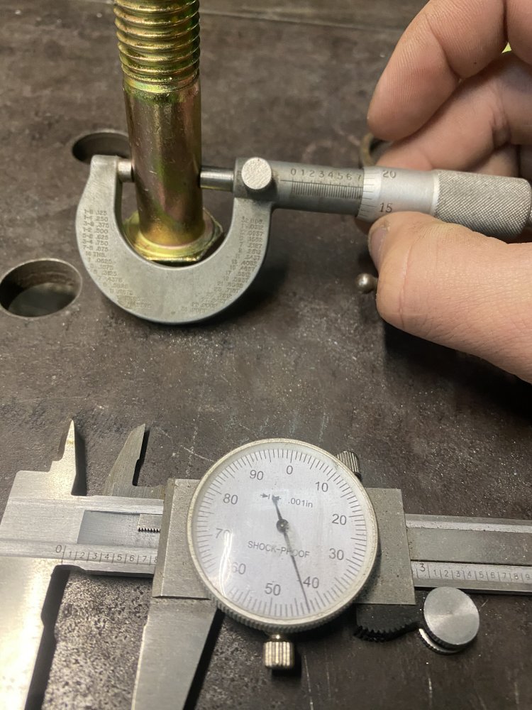

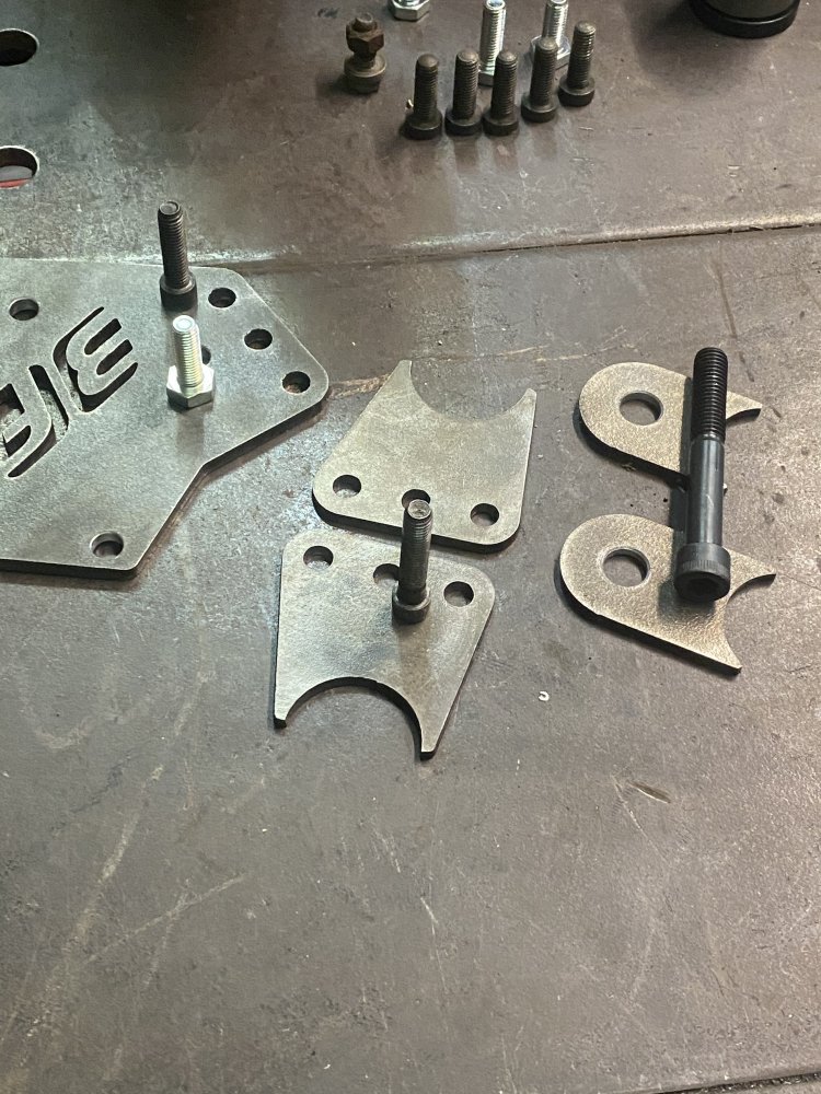

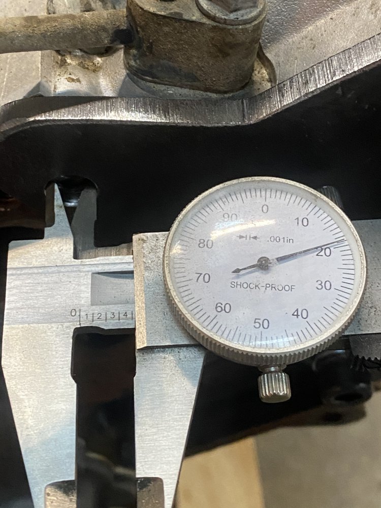

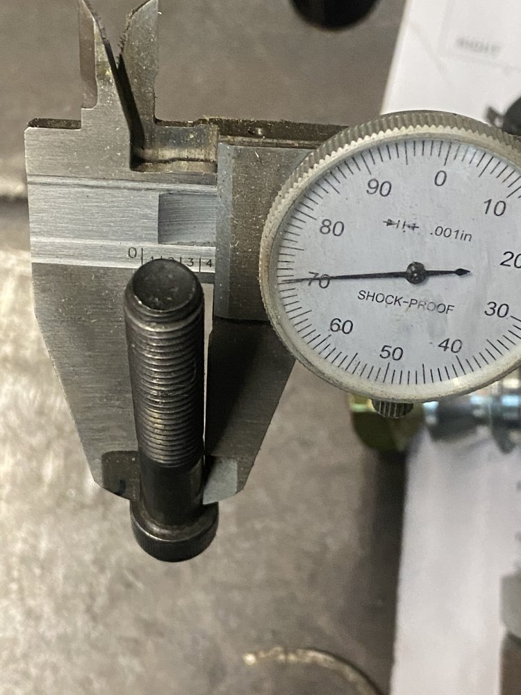

View attachment 338998View attachment 339001View attachment 339002View attachment 339003View attachment 339000

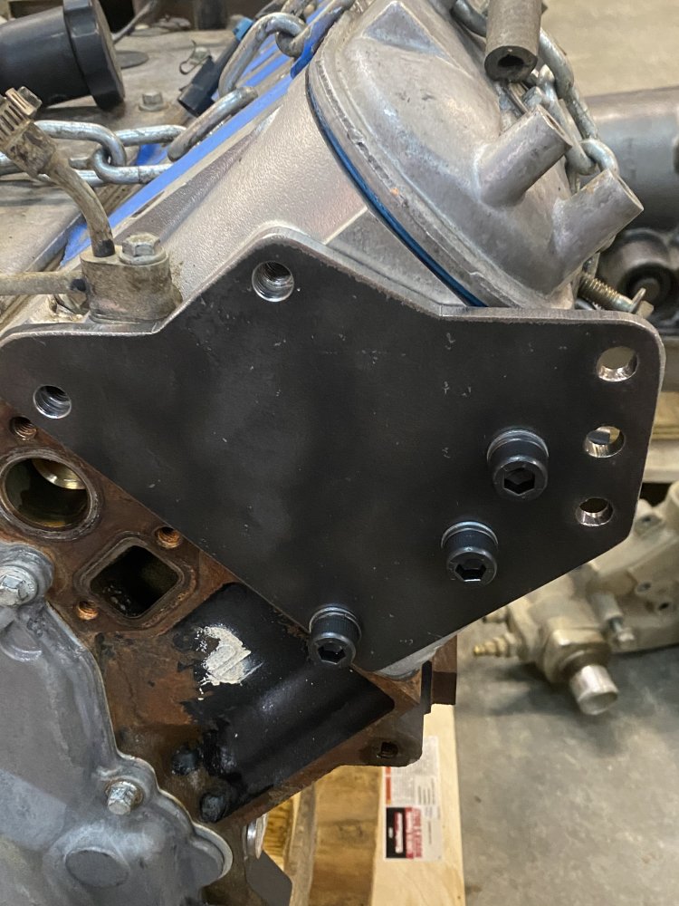

we also discovered that the poly bushings as part of the kits to mount the motor and tcase use a 1/2” bolt but have tabs with 5/8” holes. :facepalm: Looks like I’ll have to fire up the crossfire pro, and make new tabs for these with the correct hole sizes.
View attachment 339004View attachment 339005View attachment 339006View attachment 339007

time wise, the current winner is a stone followed by the harbor freight Hercules twist step drill.
The stone removes enough hardened oxide to allow the step bit to actually cut, and is faster/easier than dragging the carbide chisel through it.

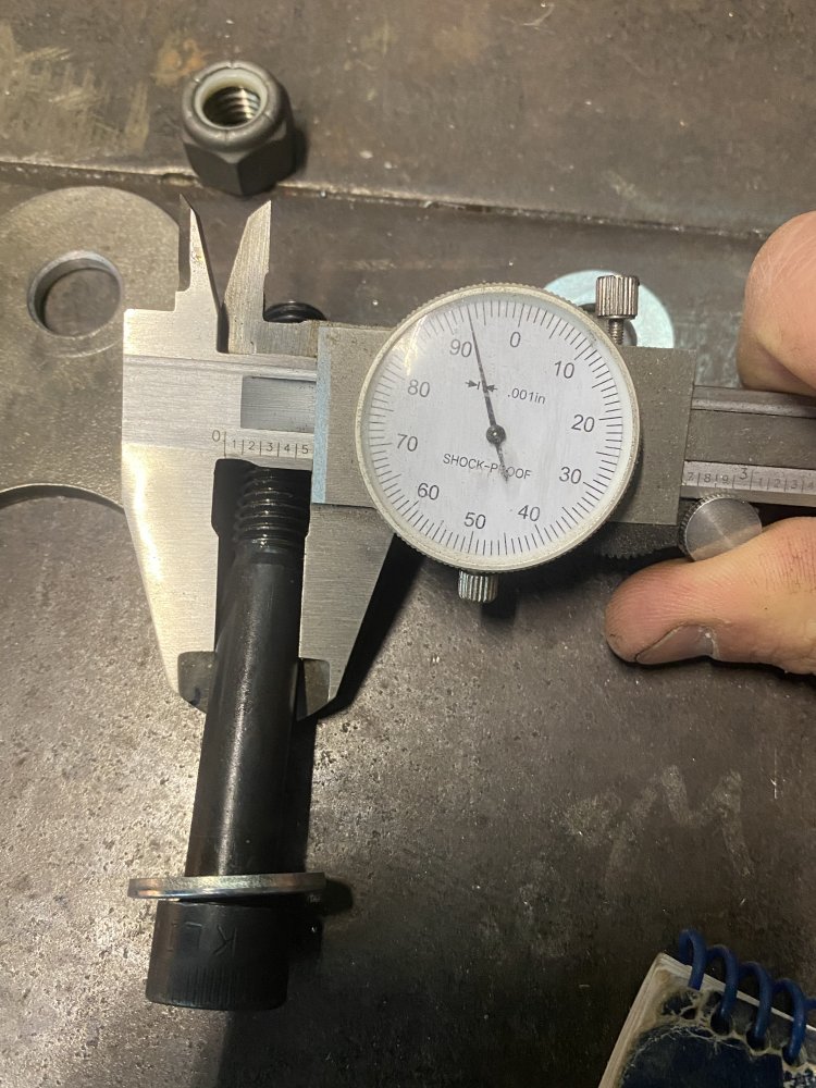

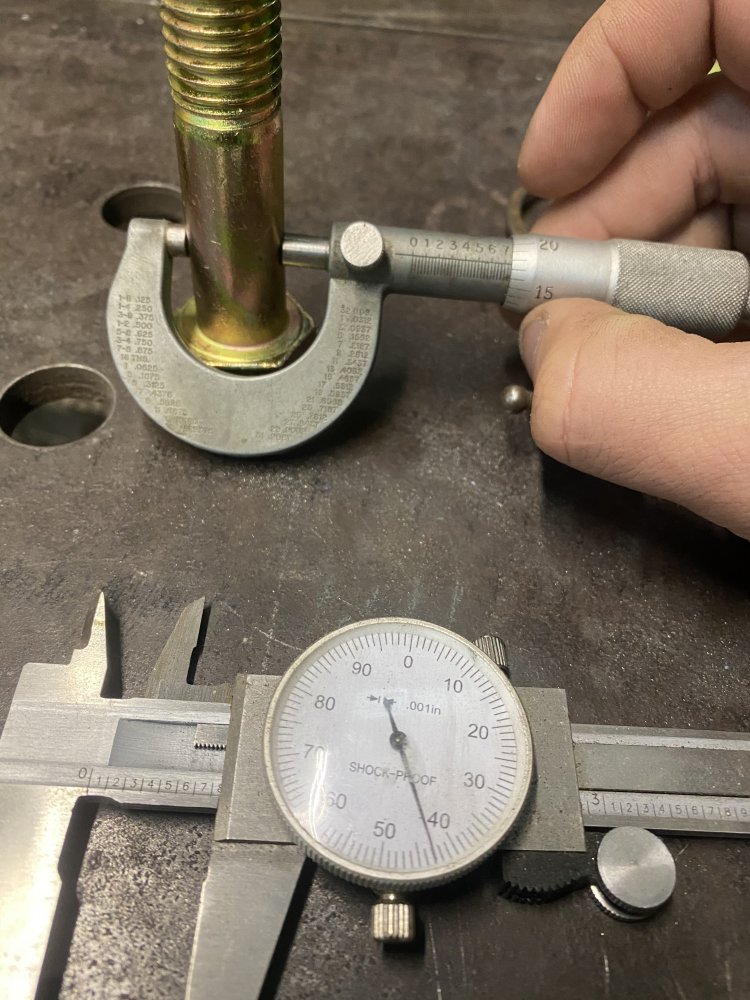

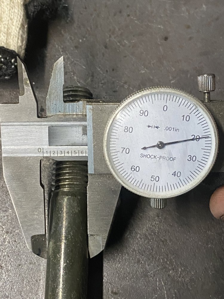

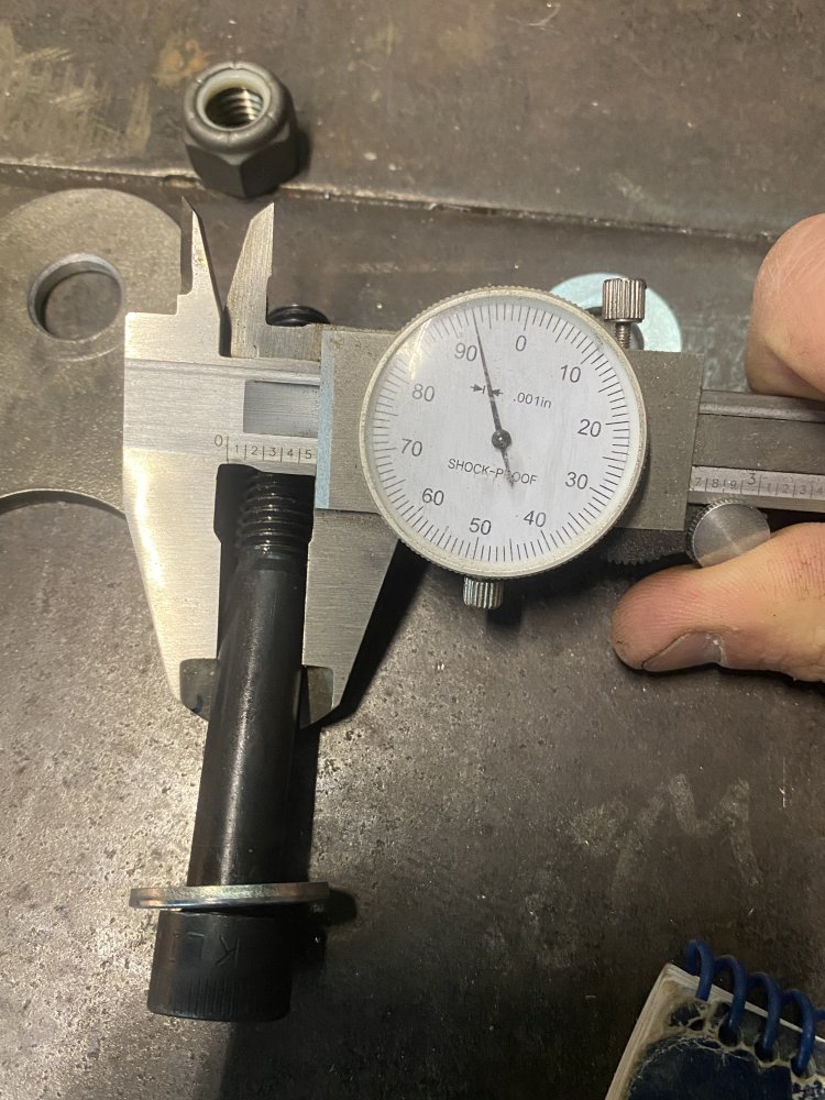

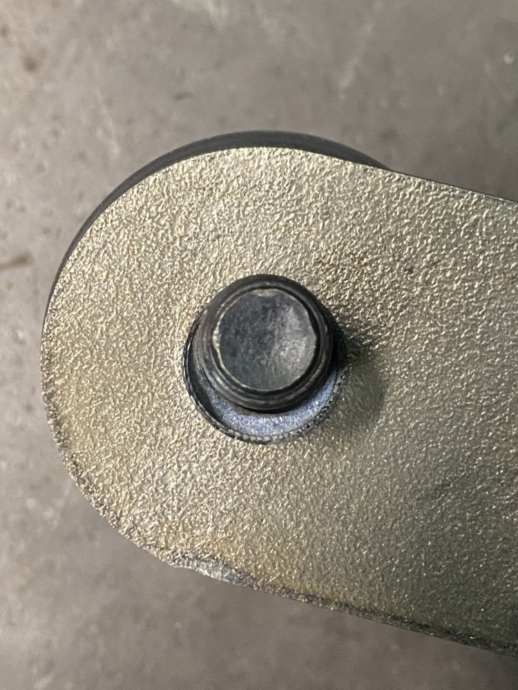

The bolts fit inside the heims perfect.

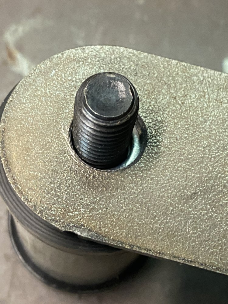

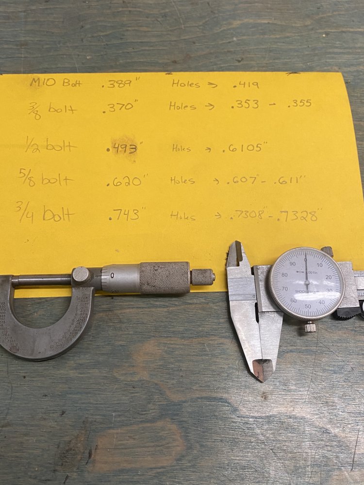

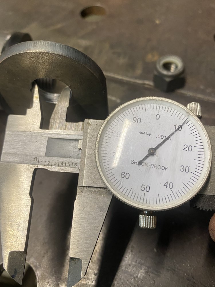

the Minor diameter of the 3/4 coarse won’t fit thru the hole. Fine thread would be worse, and that’s not including the shank of the bolt, which should fit through both tabs and reinforcing plates, if we shank the bolts correctly.
I’ll get some better measurements later today. Didn’t want to yesterday bc I knew it would only make me more frustrated.

If I counted correctly, 69 holes have to be drilled out. Most to 3/4, the rest to 3/8. Mostly in 3/16 plate, six 3/8 are in 1/4 plate.
Steve already drilled out I think 12 or 18, in about 2 hr time span. This was to hopefully be able to bolt the bracket kits together to tack them before fitting and final welding.
he stopped once we discovered that’s it’s nearly every hole in every bracket minus about 18 or so ish.
the worst part is we were hoping to get these brackets kits assembled and tacked and fitted so we could build links this Friday with hopes of having a roller with drivetrain next weekend.....
the time loss over hole sizing is frustrating
You should be able to drill them with regular HSS drills, cutting oil, and a nice slow RPM on a drill press, something around 100-200rpm. Do you have access to a beefy geared head drill press with a quick vise? Key is to not let it get too hot, and feed it hard enough that the metal is splitting ahead of the cutting edge instead of dragging across it. And you will take the edge off of the drill every few holes. You know how to sharpen a drill on a grinder or belt sander? This is a great learning opportunity with low consequences, and 3/4" is a pretty good size to learn on or practice with.

So far, the response we received was “maybe the zinc coated g8 bolts are oversized”.
That is a Bullshit answer, WTF?

I can and do sharpen my HSS stuff but I’ve never had good results with that oxide & hardened area.
I agree should be able do, but I don’t think my drill press runs slow enough or can generate the feed pressure to make it happen. That’s what led me to start with stone to remove the oxide and then finish.
Cool video and makes sense/ reinforces why the cheap Hercules step bit can cut it once we get some bare steel no oxide to the cutting edge itself.

I've done this on a mill however it's very easy to break the tips off of your not careful. I never ran that slow on rpms, I did light pressure with maybe ~500 rpms or so. Really can't remember.

3/4" drill should be plugging along around 400-500rpm (80-100SFM) in average steel. Throw in some rough, hard edge and you'll want to slow it WAAAY down and it'll still probably die, just less fast :D
3/8" bolt should be just under 3/8" (0.375") and the hole should be larger than 0.375". Same for every other size. Theres a whole nother discussion we could get into about ISO limits and fits and hole sizes and tolerance classes and such, but bottom line is the hole should freely accommodate a nominal size bolt unless it was intentionally designed with an interference fit.

I’m not complaining that he doesn’t/can’t plasma cut holes to drop a bolt thru.
my complaint is that he cut the holes, and cleaned them up 15 to 20% of the thickness by some means of cutting. And after doing such the holes are still .010” to .020” undersize, while some holes are completely drilled/milled and fit their fasteners, while some have. .610” hole for a 1/2” bolt.
it’s one thing to sell a kit that’s ready to bolt together, weld, install vs having to drill out 69/80ish holes before assembly, welding, and installation.
another big issue are the poly bushings for motor and trans mount. These are all bushed and sleeved for 1/2” (.493”) bolts while the tabs have a .610 hole.
just a major let down and time waster.
Looks like the current solution is to drill out the holes in the main brackets, and then I’m going to cut new tabs/brackets for all the laminated bolt reinforcement plates, and tabs that the holes are too big for the supplied bolts.
