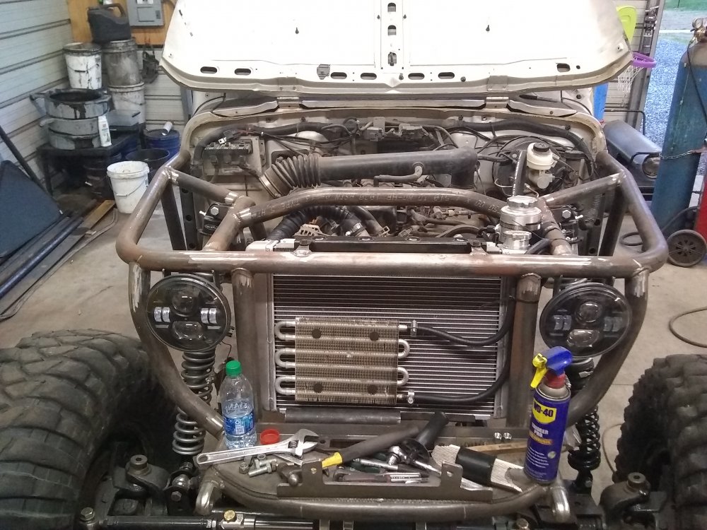

And some updates.

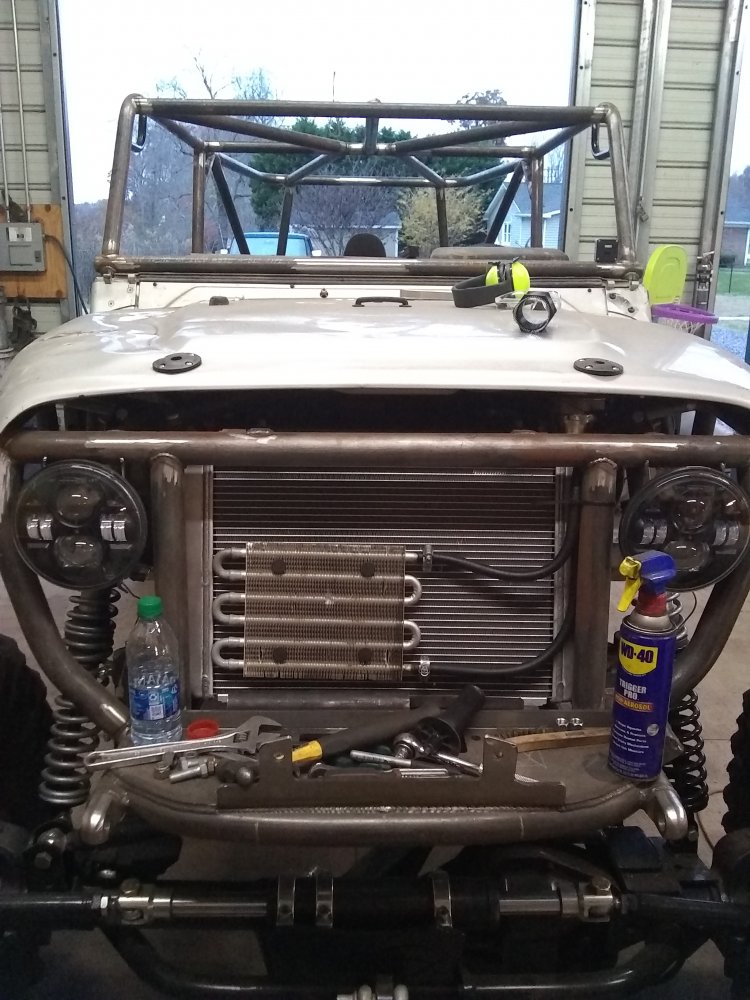

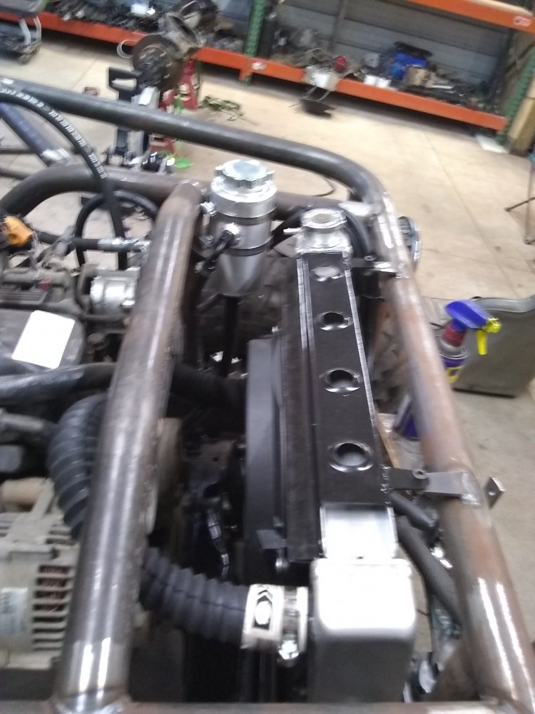

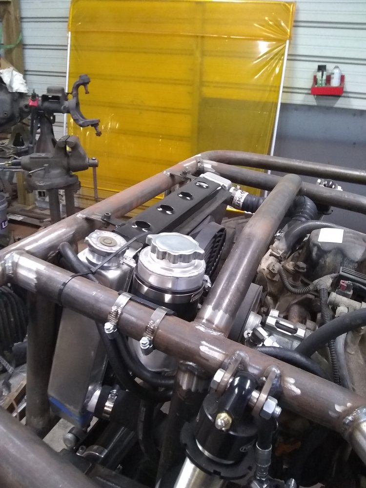

Fan shroud made.
k9UYkhMGiSnHfujTU0hcveMergV-8ov8JZdZCYC3tleehrCDOiOS420lZCyI9OoB3SmU_PNZc30zOvYNWoyBUo0tuLwWfna1l2QYewihffSmqwoBmu1sdNDLgCoQHOGidc2hcqi9Ua7joL91pCS-YzaOY3BdU6nIK-h-lm5F6FJzp0IBsGBR1n9BMKCLveNBdZg69Q_H81G09QuzHZaKw4GdzZt79oud4_1i0tka46kauXslthibWaXKXj3AtIyVoBXALVzXLyscB1G4ayWBcJhj93YGcITwc24zSlqo2DuPjJ72vGvcaE3wtY5yw0VMPAak0_t3IaUw4sFRv6WB9UQXxAO_UlqBZleSRui30pPZcDtHowUyRqkeEuCX9BfkuTsXaQVmFT_6BaZLaa4gSTQBqei7Rp3o_J3TqT7LAer9VK8AHwcQtB0OdVyp85m7qzyPOFBzMcxELLMdPBL8gErfzrXAJAP5fC6eG0LwQQPBXX3klSyVZiXqc8d7w8fl6iZV_p1EkJcGDd38JKEc20KVPPskzFCb4wwpeTjfJcrCU1JvrG_pDWWym0tKQCumZ_ZFpz9zRChDfEVbK7CdLhrbRrme0lJMcQq9WIMfqtgizeWLPubXDG_LhUyWrzv4AJrFzZ5GIl7jNQaYyqZ1kmv8M2PEVyHiRJ-22TQJZS4UB8Tf_bndEB_7or4OPQ=w1680-h757-no
These headlight hoops tested my patience ALOT.
Siqjcnur87GeFskwOSra-vPckW2dRmF_p_Zj4hCq-pXX-C3ozWDXC-_Py2JupcoExVxSBGMNipZg6cyej6294OQNdhXlJMTGUeyhD0LuGnS1DrRUPxEXOn5O54qBvxL_9316Nm1EMpW9ZyKyM92YOC9Qa0ZNNIwn5mEBYnJkP3Uofy7cmSTRRf7mCOrdoGSNR41AbUrH4j5Qe7W1t9E4PdKpjdzurmNr8Q0XMb6Wlh4O5xrRSgFCUWKGUaISCmPk6gNB4fLxwpuCDIsWngA-FmqBA9N6ARt4Eind42B0t-YaQXvF_NOBPhWM9jJJ7LGcFP0B9-jHK1s2OUea7eW5h2VkDIiIQEP3hLJDSSkB42_-WZRePk7GsWbgKQrgH1CzhtV9KNxNFV1wOZVVI5ExgEjJZkjnPMjNmhQ4iVDvN7c0k7FMjXw8X98b8Im_2QZwQPTSFoLng3b3r_vQUtQIPgy4nv_DYbaoN52mY5ohh0zNvmDTtaFIt-JtcPoC9JlV8bFgjDu5BTQYmJLM-P83GqY6zr0KSpK_-CrwedkxMl4Vrgqfnc6xOY9NbOs70xdzxfsM2xo3VBBF8q4ouKJxcpCJBo_4krgIyn1HR8rms6YDs0wOjK6WFaS9EgsABD4-I5YunbpDeCuisythcPfVNmiCZz6DAFT3taAkmMrEJLQkvuQNTV-3c_lxCB4sbQ=w1680-h757-no

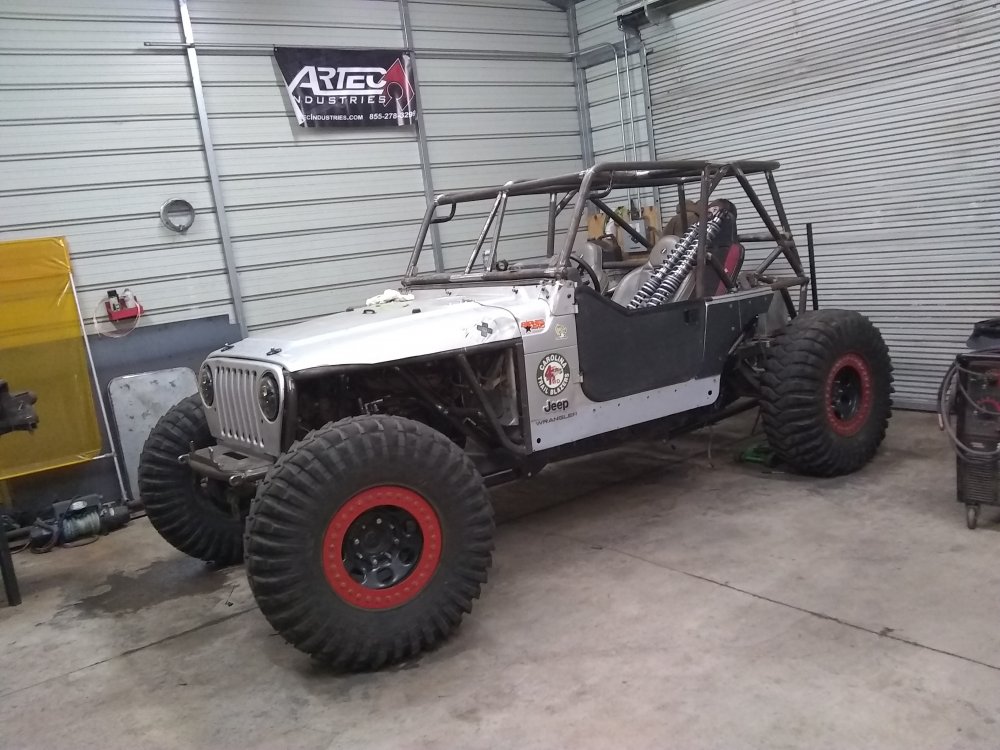

Headlights tab mounted, grille is...ahem...zip tie atm. (drift car style)
ara9Sxtf81fbtKJ2Ws_XuGNwIcmrrl_nPnf4J4Ysf7qta9vE4Jpr-FYJvrXXcf10I6PdgntLL6mhGHtVu7x4vWGAz1BwEf1sQSHSzg9EzlcqOL_eQr6HhweMAd6StsaKAxfSIk5jFdBhcfHIoIDzrqyjUUUA0viG3IZ-aaanwQ4tnmuXbZCbXNH3gJJg4WElAVzrBTem4SmphLgrNZol_2Z5HIe4ppb9O47hyJm5hWVb7YfHlIXkah4KCHV4GmroQkvzk4hYQQXK6l9XE0eH69qpVA7as9oyHqxddFe1rNNmAG8jK2sdH1mkbyXOzvp5qTVeivi7TSc63ookc54Yj3y7t40GpzNCCjHhYGHrH4QUybsDWjFD6FZCvj_4yIFbj_k1DGjn8DKO1iVtrNuH3wJdkBZpsdmSEqB9wojWyqE5a6cWcaJ1u07MYcK2zNTE6l_f61HZ0YzF7KVO_8ITQJB_01cV6yAp-cxSXvaV9SLOCrH-kKQ3UO9B3zwfC5ICur1LN-M5J0ySG33QVBWLBhAqYqeAMWXp-YD1jnv2TINK0cwopzLu93p-KDEB0iyox9003zRQ-HQeWOujAZFp0ZJjzDuJ3qt0GcTD-WQUH6DhpxhSIqR-uVZotGzwAx7FurjpudbgJ17AHEjJp6FG_96FkQYfEeJTDdIB5kx6srBs2JuDiu8zpgxGja8CrQ=w424-h940-no

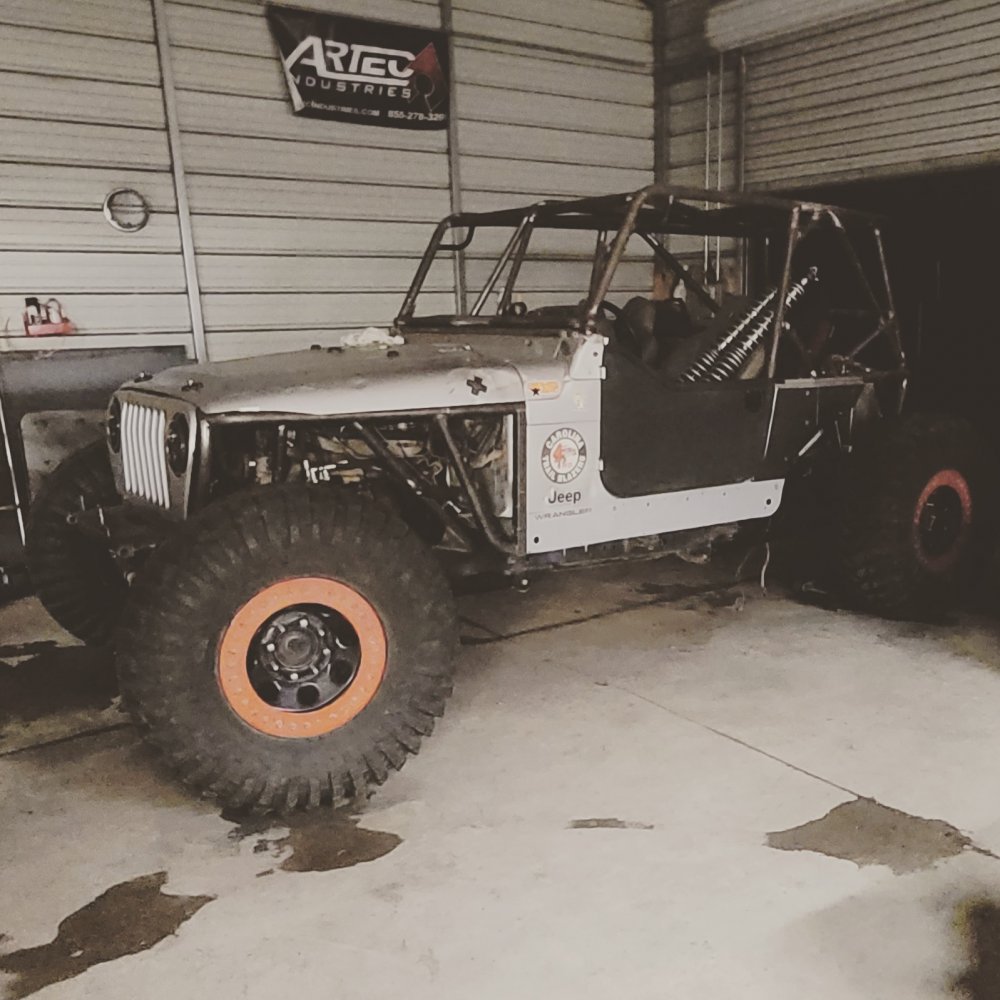

Joe found a good deal on a set of 40" Sticky Treps. He had already traded @Crunchy for his 17" TMI Beadlocks I did awhile back. Him and Adam got them mounted up yesterday. I torqued a few bolts to say I helped while I was working on another rig.
oRkGRr_wOYQRNB0fikctsqfIDsllelfY1FsCpZ7e9h0fNjZ1BfeYI-PS1_XNakZFFN3jVIL7uDbyNt9lNgfbAtlySPfvqG1SC8sYNTtJaJioRLe6bGb--xE7EfZA1Mqgw7NApNUYv2ttdLQOG2RHsXN-RJI43TZ67i8MYP7jAeL1PxXMoQN1XknMzqHmNt5OMMQ8LmGDU-xQMEOdGlfvOu0l8WLREuX1ukBMmlApygnAHJMwP1yVa_RpDMnWXagJGIrzzuKRX3I4pj0LegRitwSiQkP7ZFabpka5NzuTz2JLRHf-NrAsmJJrZ75vvap_T9MO2RlezCWzNm8Vj96t3SQi0lOgJgMyK78Y4KOaPIkenvnValDCbvh3MUI484uqMoekBgdB3X_lInXjUiYW8Yei-MqTVcNEPwnXPfSPfSEZkx2eesvoPozWxwbgxfNjggCVXvuYDoCjhAvld3nRLLy3zBHWeQ63l7LJtmH4duQo_ETv418zooN0n154NW7NYoLvGpCY4-OOYTuBsf9DRybw4_9xvzzkzaLSAybdI2BOiattYlbt6VrEWAG9NbwveZS2_W3NNTlwA9nhCV3I3f6zUe_wgYnWm7Dgks3BslUsoHXx68SEPIGocAqICVmAvvJ-XCNqSaBJ0g2O2N3ebPPp93BpKcs-YlWV-Ka_rzNAAGxMXkVru2_bEvzQAA=w749-h940-no
Mounted on bumps, she's low. ~17.5" belly at bump.

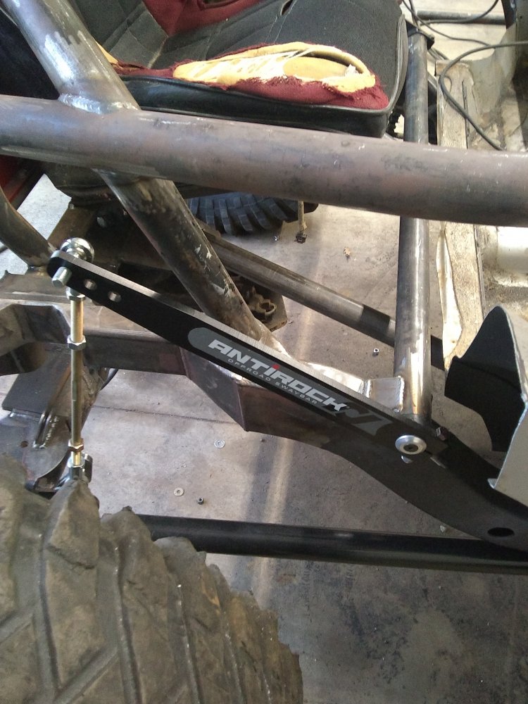

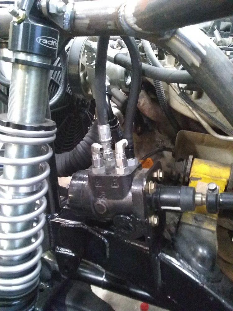

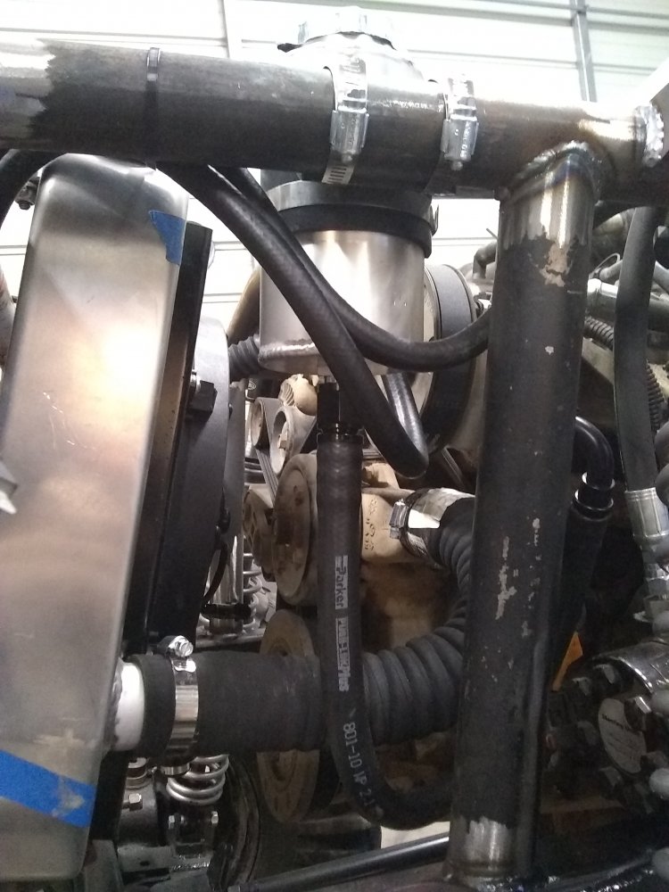

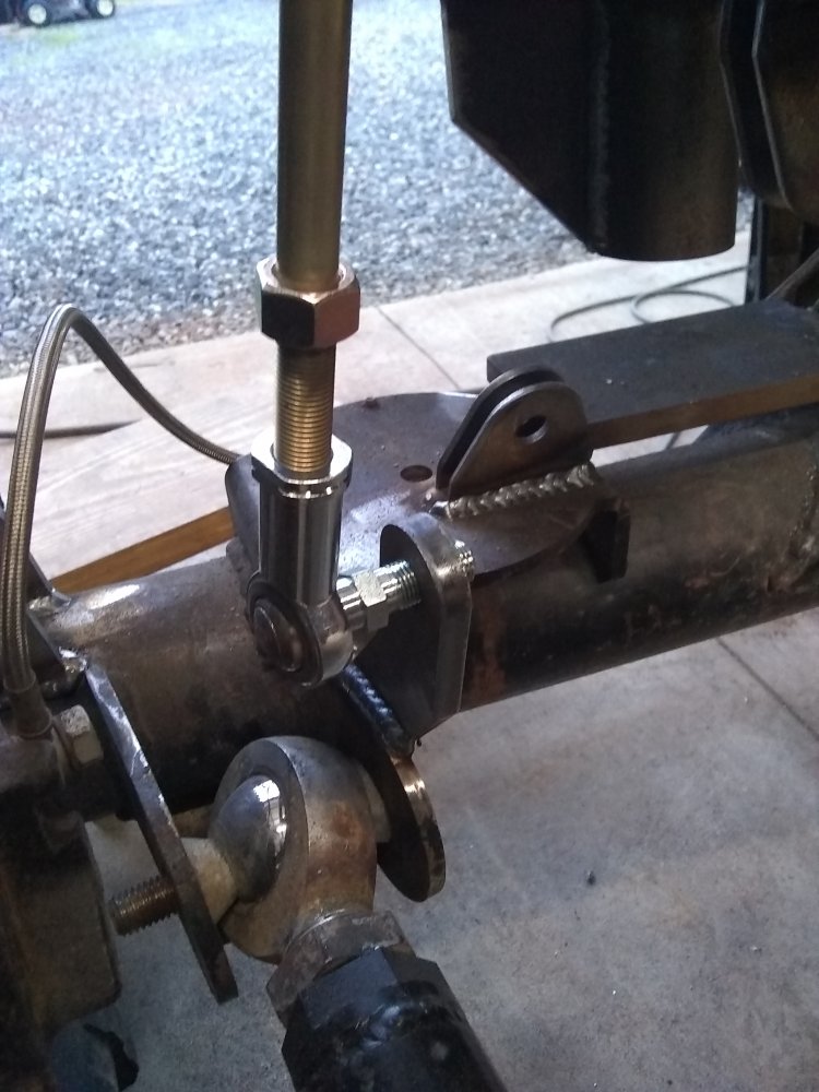

We've made more progress in the past couple weeks. Got most of the plumbing from Alliance in Greensboro, did more tube work (thanks to @adamk for the help!), Lower coils came in and limit straps were figured out, sway bar is in and a whole lot of welding wire was burned.

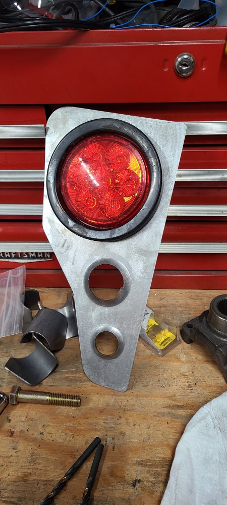

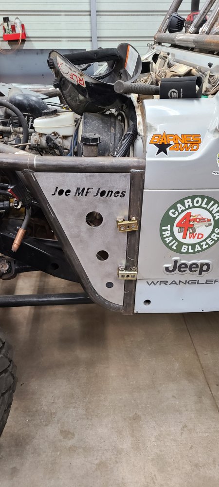

Cut out some taillight mounts yesterday at work for it. I'm digging them, can't wait to get a plasma at home for more stuff like this.
Also here's a cooler shot (imo) of Joe's in the shop.

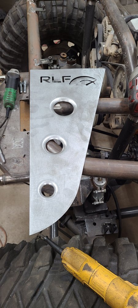

I can’t decide if I want to see the RLF logo in those fenders, or more dimple dies to match the tail lights. Or both.
What say everyone else?

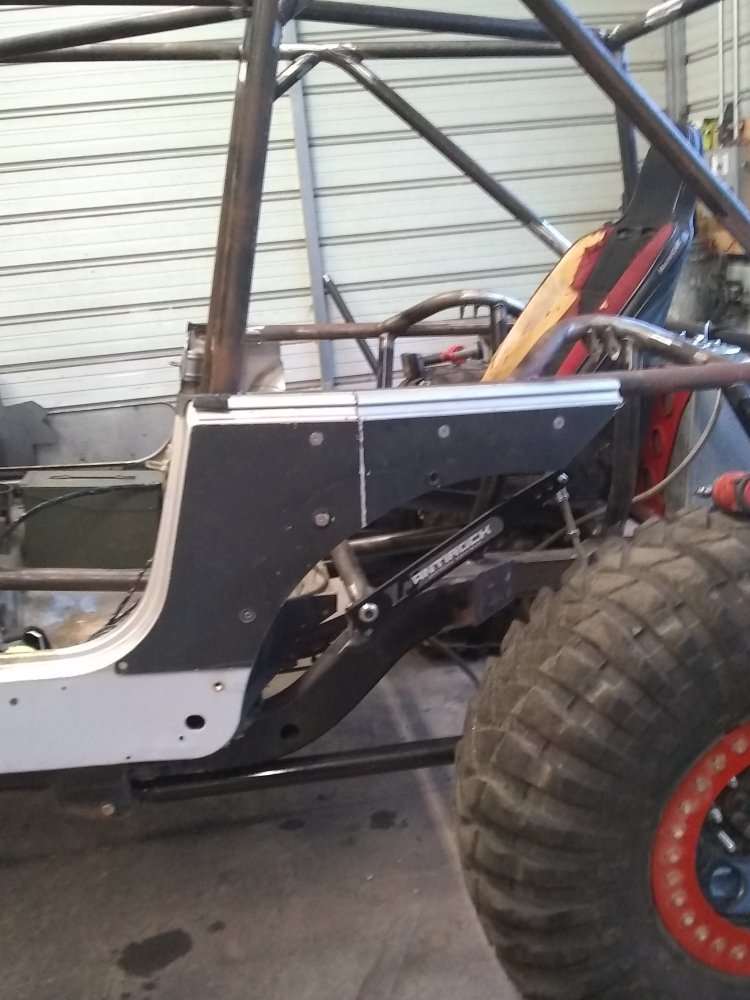

I think both would fit. Small logo at the top with 3 dimples going down from the top. 2", 1.5" and 1"
How about this?
The other side has my logo in it. Some how we missed the mark and the panels ended up being a little different shape. Thinking the tub is slightly twisted on the frame. It'll be something I pay better attention to next time but you'll never know unless you know to look for it. Just part of learning, still happy with how they turned out.
