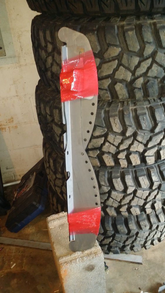

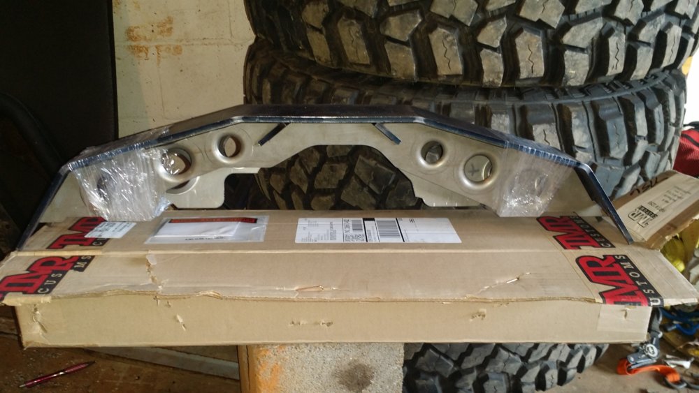

X2 good to see this project keep going. What plans for the rear suspension setup and what are you going to do about the fuel tank? I assume your going to use Barnes brackets too?
Genright stretch tank the 11 gallon one. TMR TRUSS, FOX coilovers, and what ever Chris uses for brackets and mounts from Barnes.
Going with the 11 gallon so I can do a 7in stretch and have room for a one ton axle one day
I'd rather stick with 6" and get the extra 5 gallons, *especially* if you're planning on the Moab trip.
Does yours have the charcoal canister behind the right rear tire? If so what are you going to do with it?
It does and at the moment I have no idea what I'm going to do with it.im still reading up on it and Chris at Buckeye said not to worry about it so we will have to wait and see what happens
