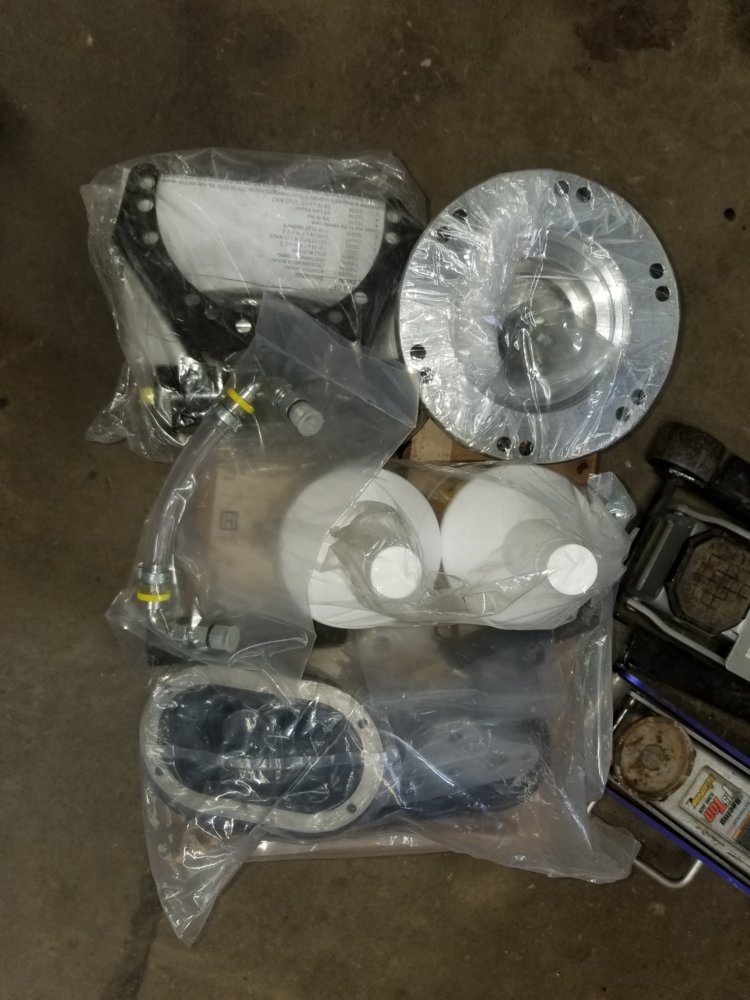

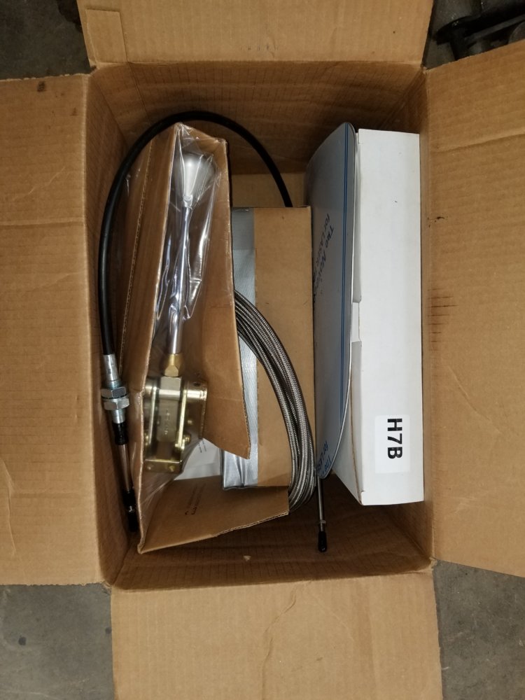

All the parts showed up this week:burnout::driver::beer:

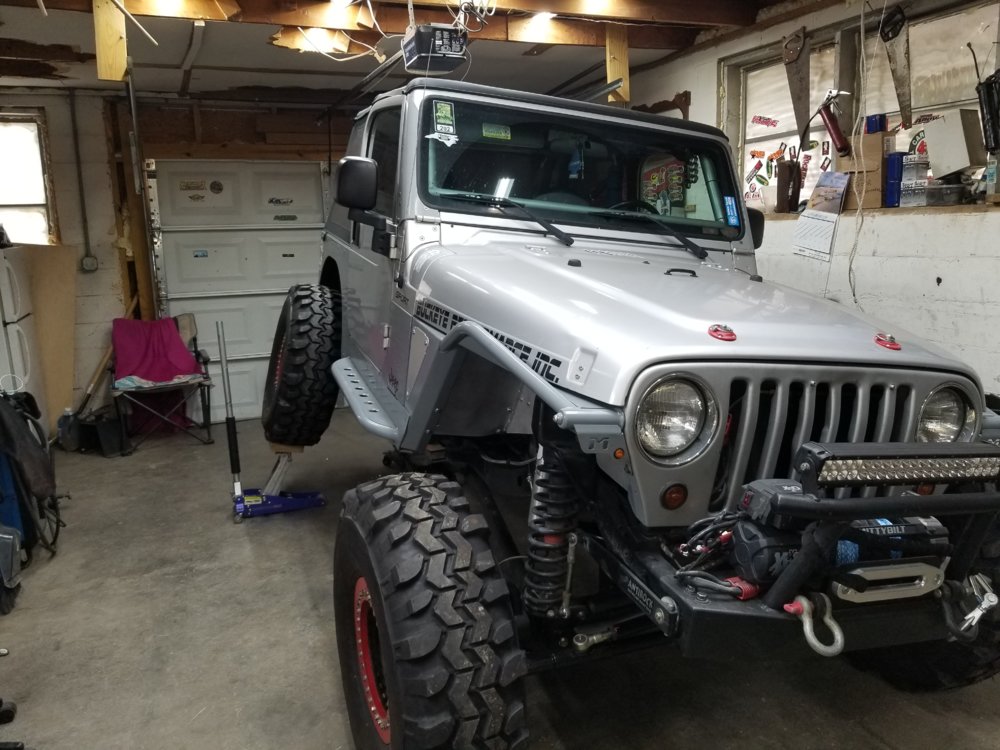

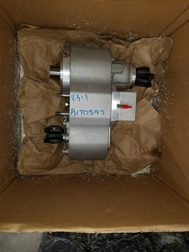

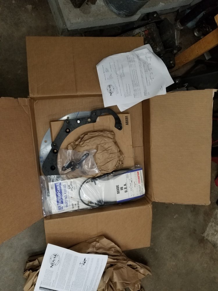

Went by to check on my tj today. And she is about 90% completed the 700r4 is in the Atlas is in trans shifter and t-case shifters are in. From what David Minton has told me it has been some kind of experience getting everything to work like it should. But since i had streched the wheel base last year it helped with this swap. Rear drive shaft was perfect no need to have it shortened or lengthened. Front drive shaft was 2in to short so David sent it out and had it shortened. More pice will come as i can get them. There is alot of information im missing from posting up but to honest ive just forgotten alot of it lol.
After a long wait for parts and mo ey to pay for recent upgrades she is ready to wheel again.

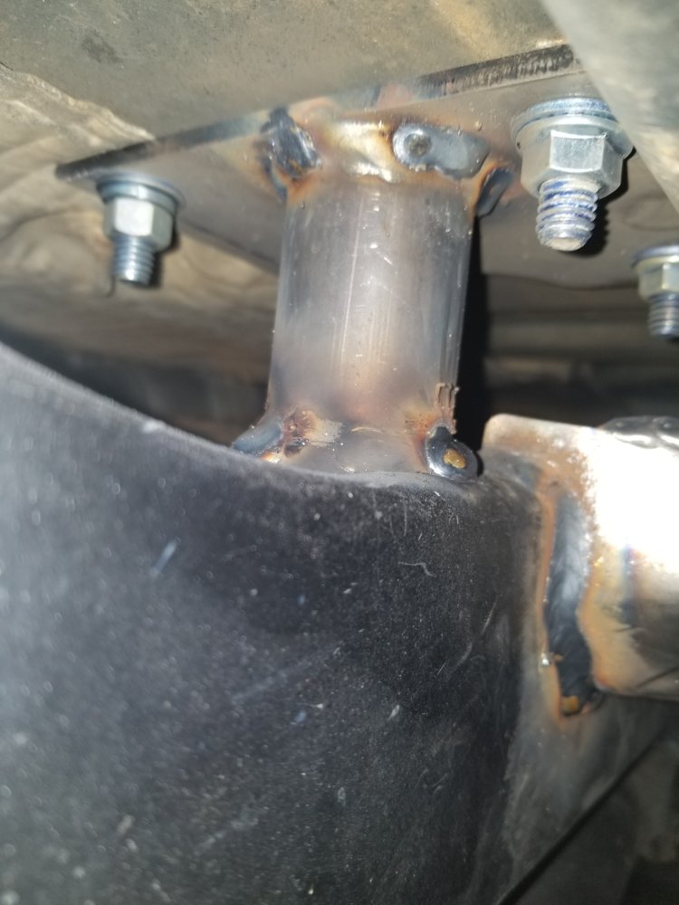

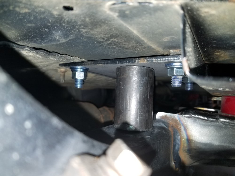

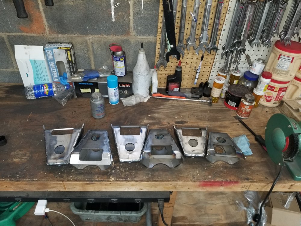

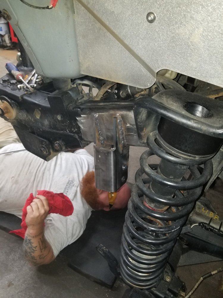

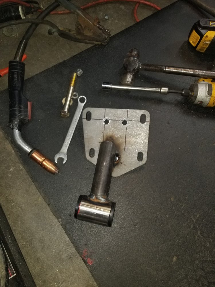

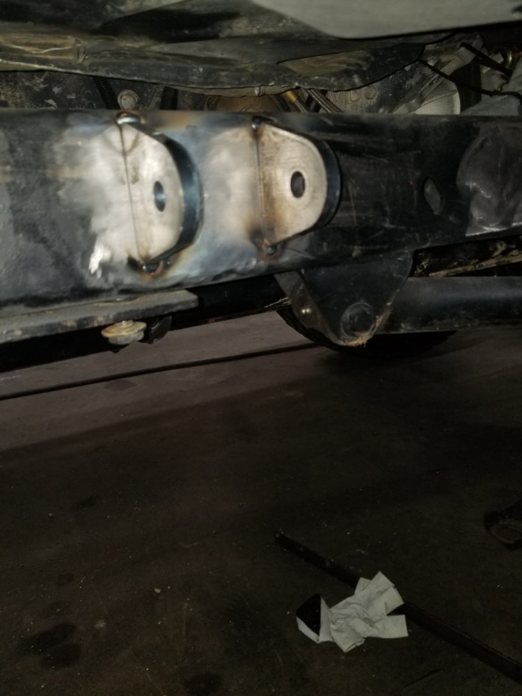

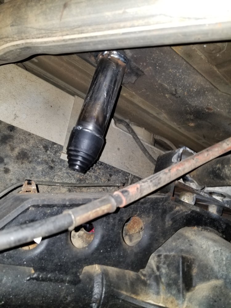

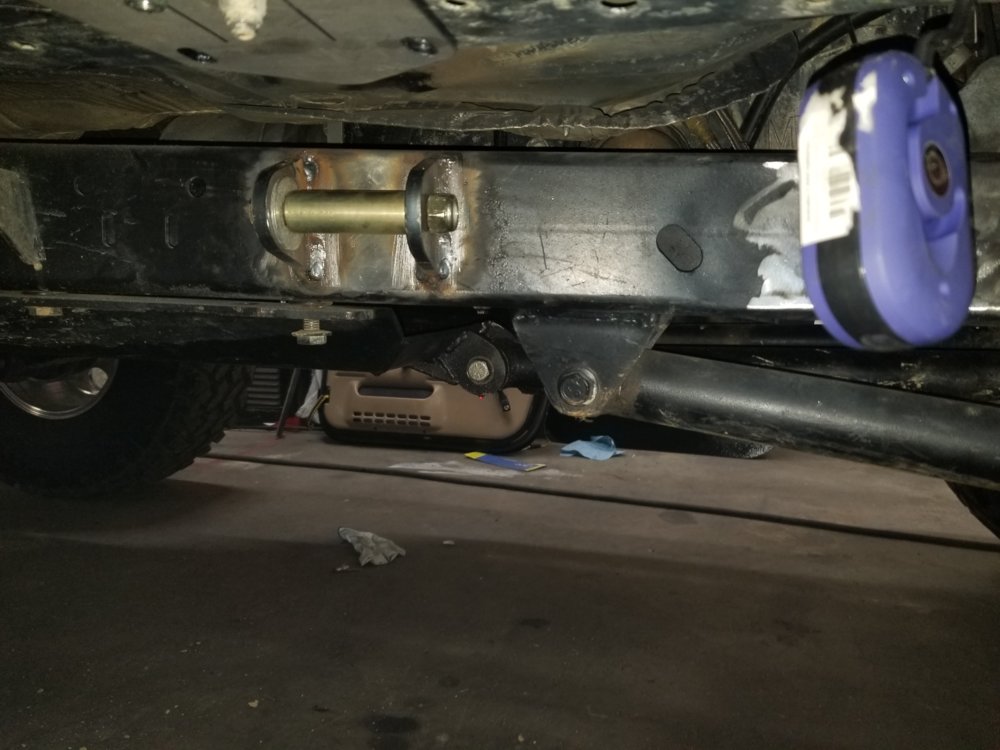

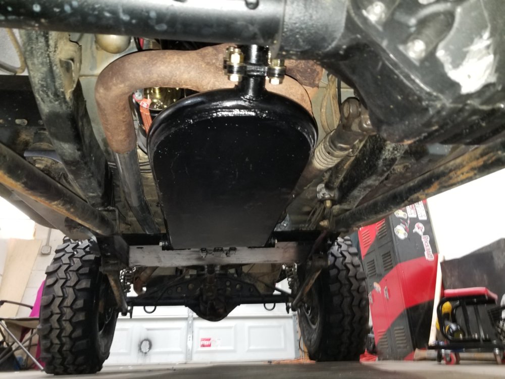

Shout out to David Minton at Mintons Automotive in Granite Falls NC for doing the automatic transmission swap and insalling tge Atlas 4.7 t-case for me. You and your guys did an out standing job! David also built me a trans/oil pan skid for protection and since mall crawling isnt for the faint of heart i had crushed my factory oil pan and he replaced too. So now she can hold her full capacity of oil again. Ive got about 300 miles street driven on the 700R4 and she shifts up and down no problem. I still try to push the non existent clutch but guess i will stop that after awhile. After getting her home she had her new 36tsl's mounted to check for clearance issues. Had to trim the rear quarters about 1/2" back. Then to the issue of bump stops. While i had her flexed out checking for clearances i was able to get some measurements and used some off the shelf part store bump stops. Cut some D.O.M. Pipe to the lengths i needed then capped them off with some plate. After some drilling and tapping i now have bump stops. Then i used the rear cross member for the mounting cleaned up paint dirt and gunk. Tacked them into place and then burned them in.

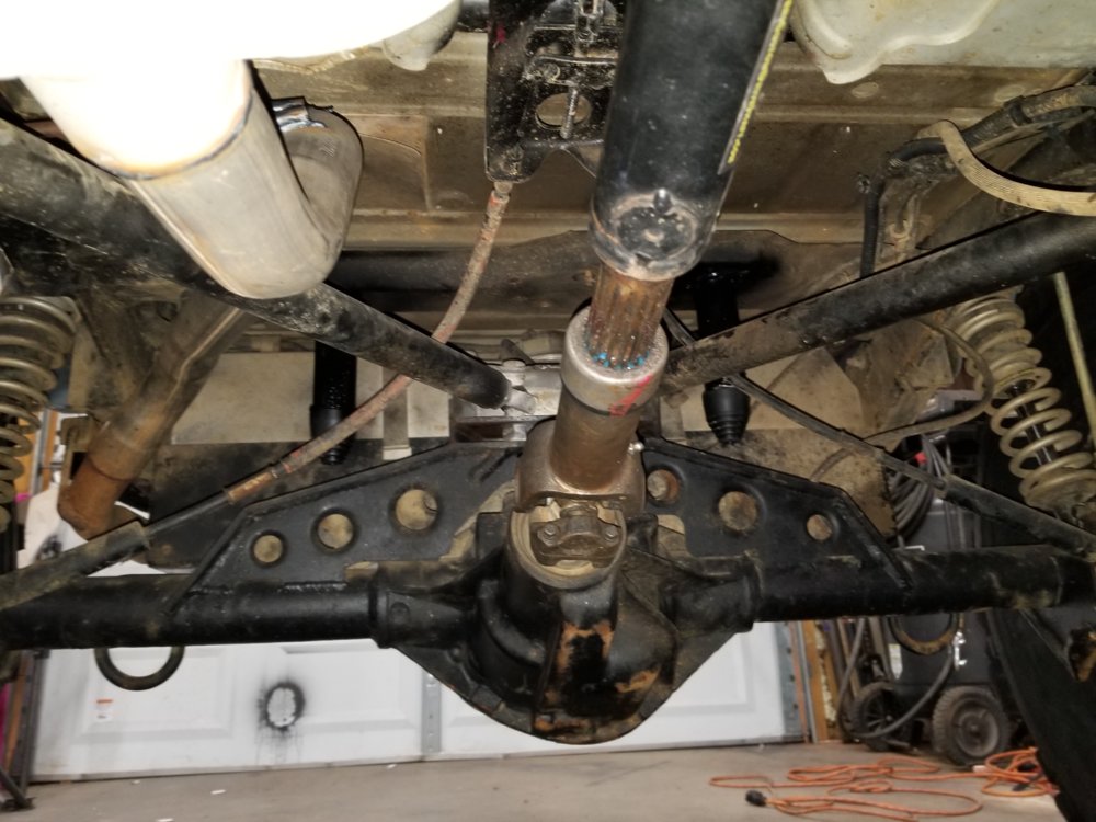

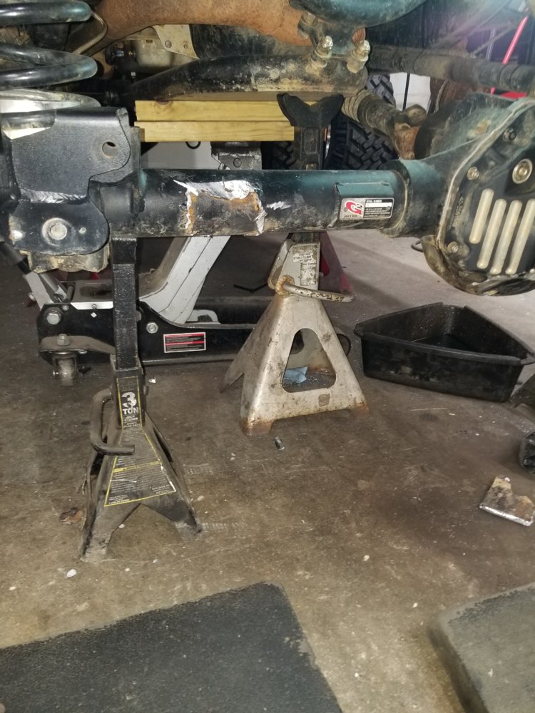

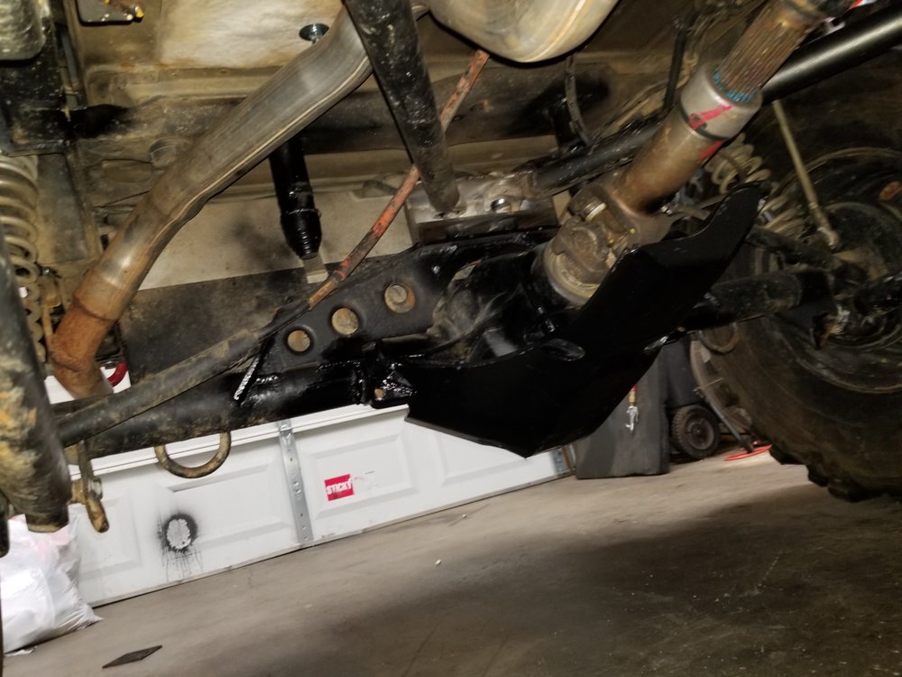

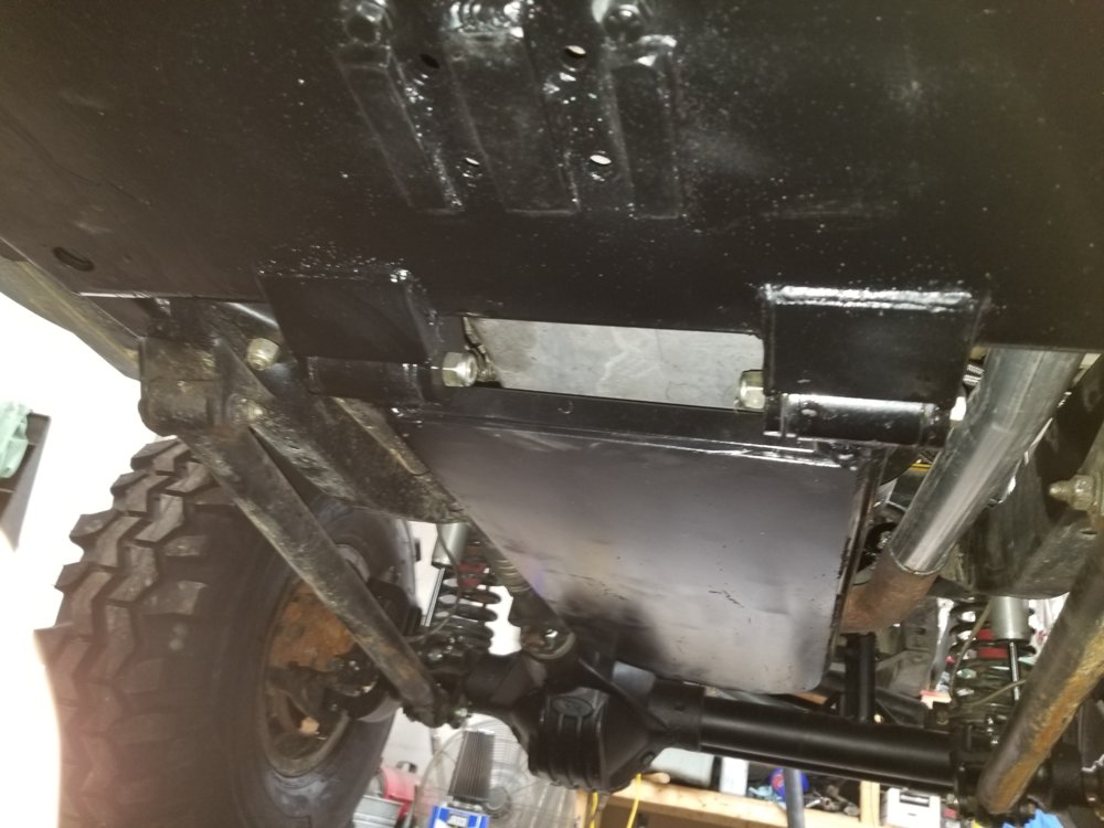

Just because I have an awesome friends @Jason W. And his wife @deb who gave me her old AEV rear Dana 44 skid to help prevent me from busting my yokes all the time. And since this had Previously been on a jk 44 we had to do some mods and weld it to my axle tubes so it works as a skid, yoke protector, and a bottom truss lol let's us see how long it takes me to mangle it up.
The addition of a flange yoke with an adapter at the driveshaft can add to a bit of protection as well. Little extra diameter can keep the edges of the yoke from twisting over rocks.

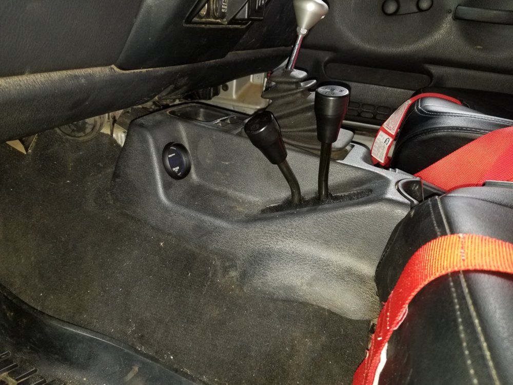

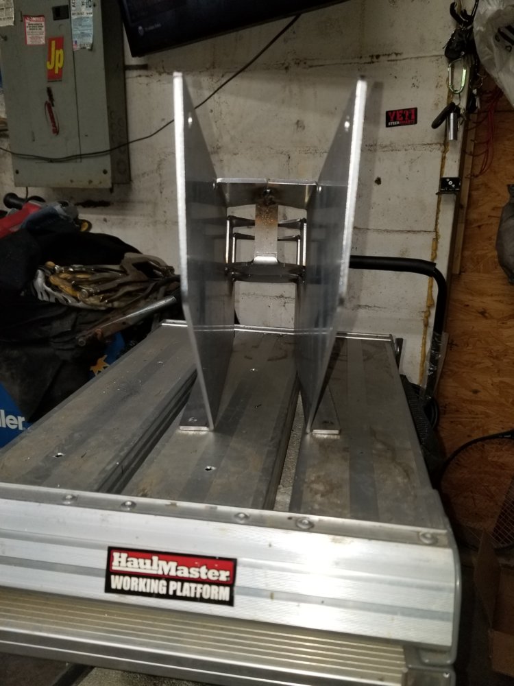

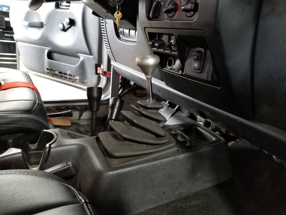

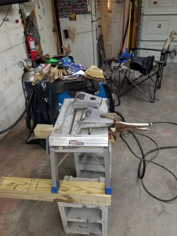

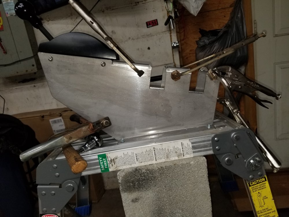

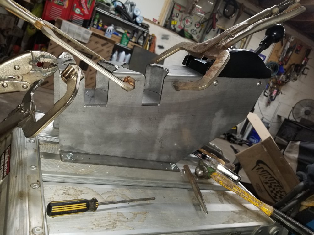

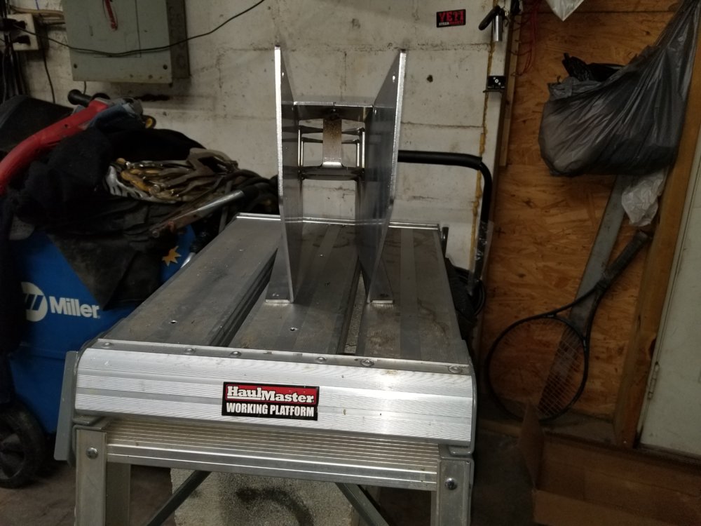

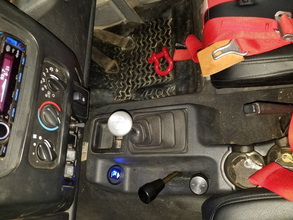

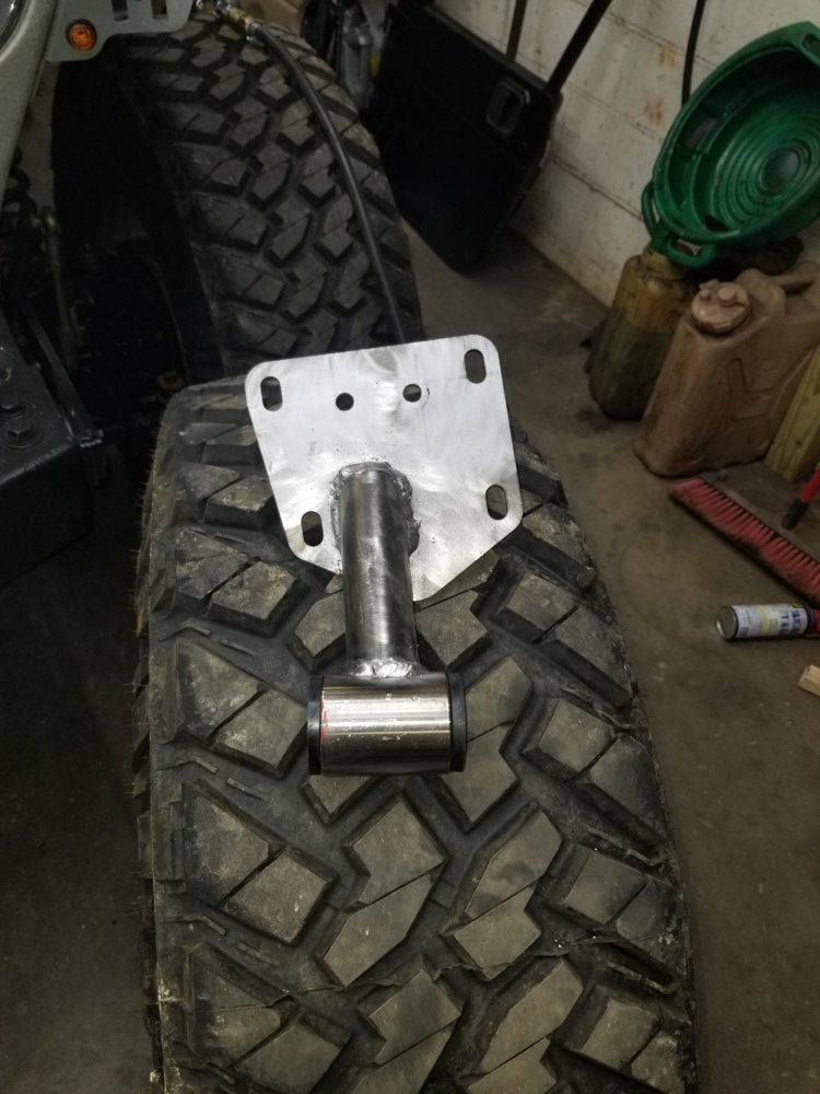

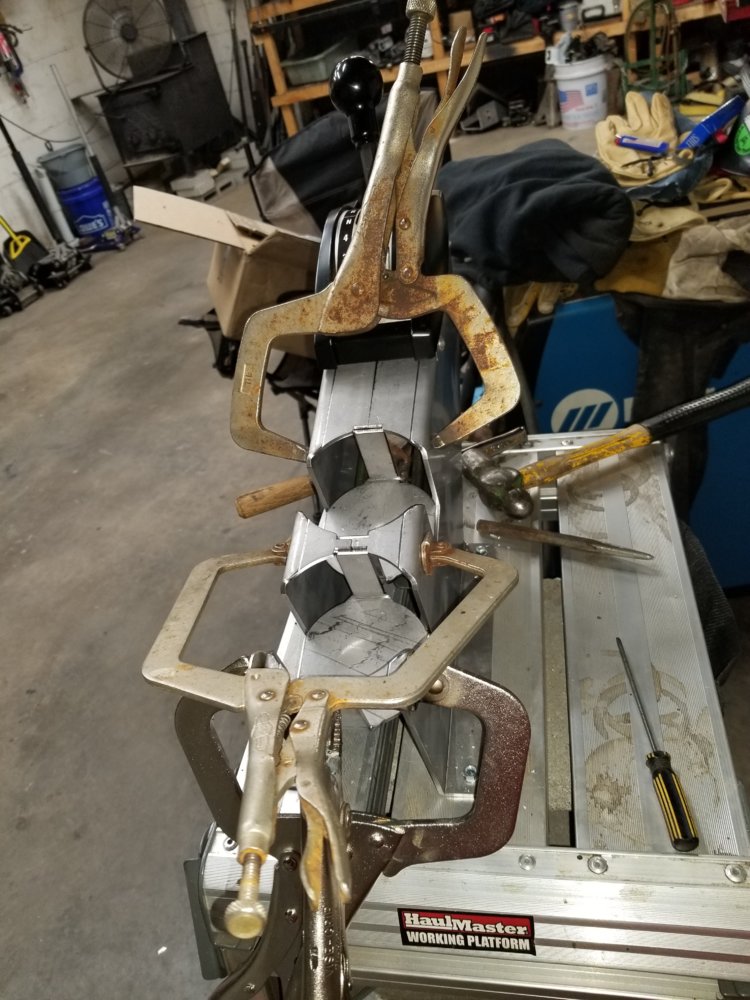

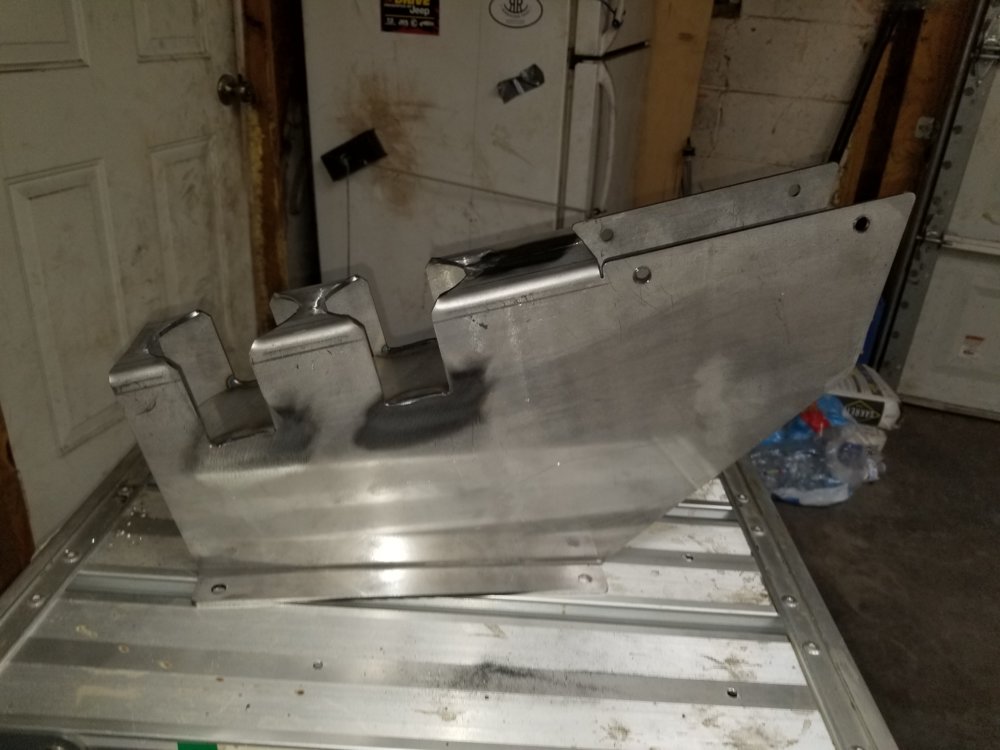

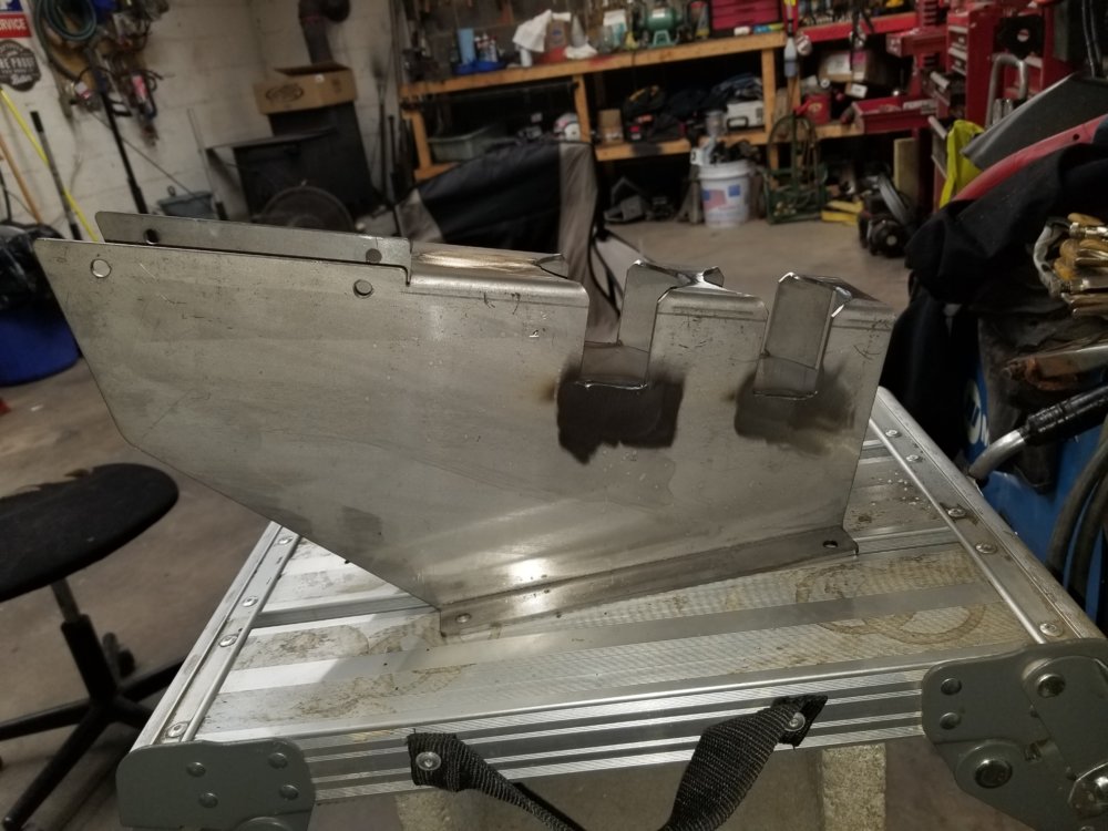

Love the new 700r4 automatic transmission swap and atlas transfer case but the lowcar shifter I do not like. Went with it dew to it being the one that comes with the kit. So I oppted for a artcar shifter but it wouldn't work with the factory console so after lots of research finally found a mount that will work with what I wanted. The mount is from goatbuilt.com. I got the mount put together and welded it up. Next will be installing it

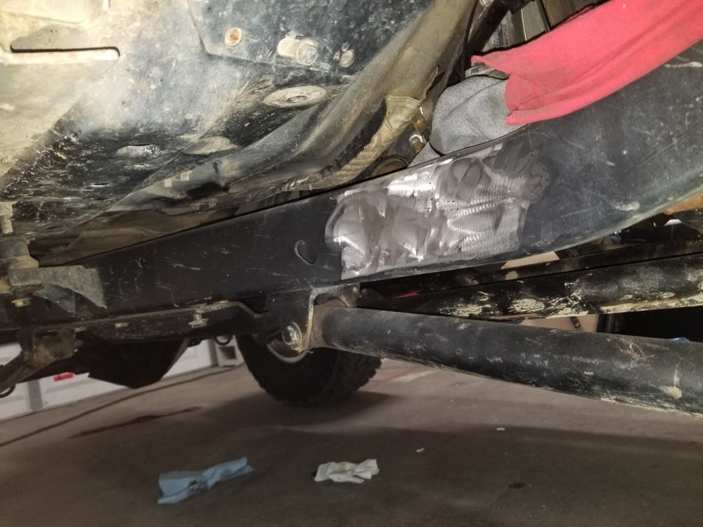

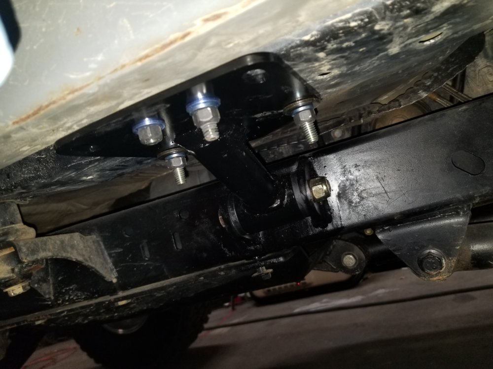

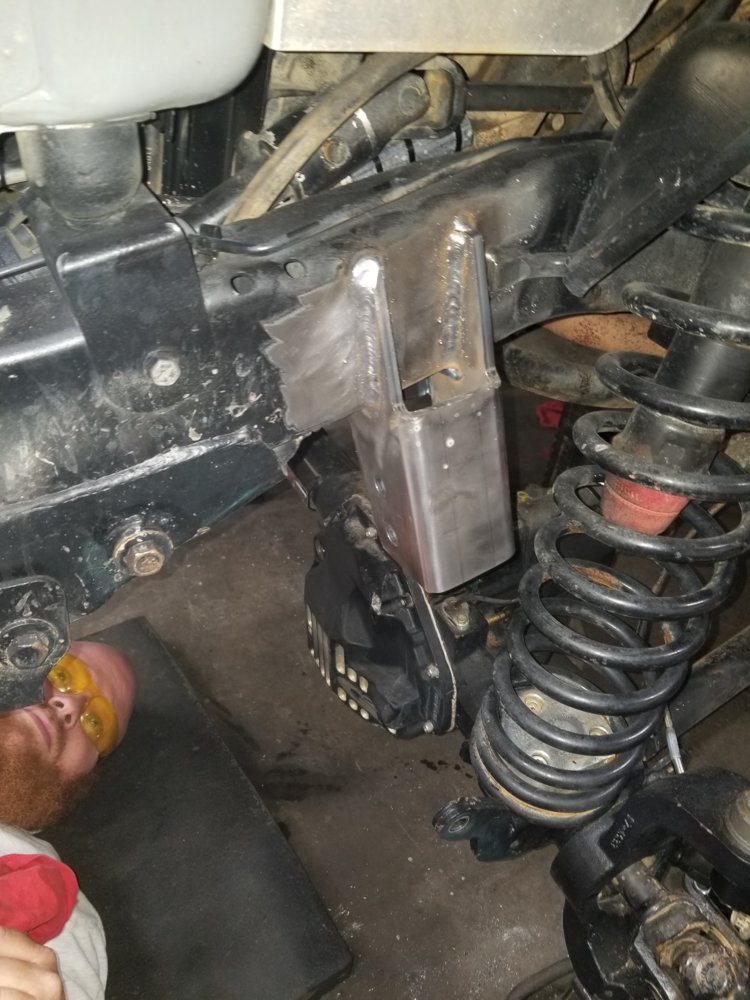

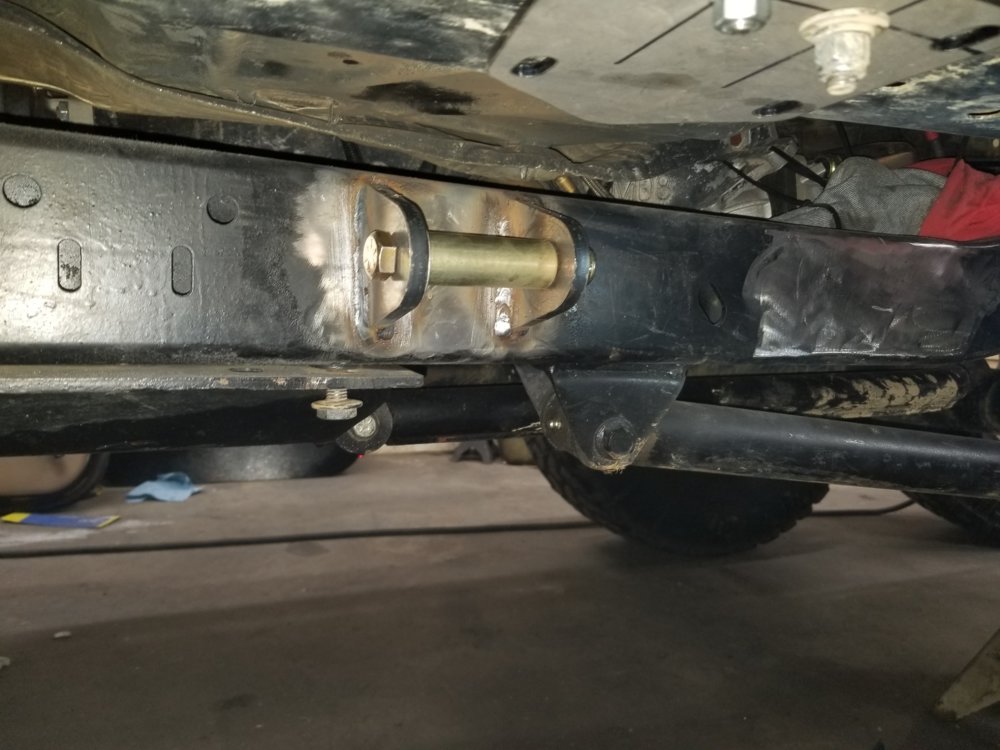

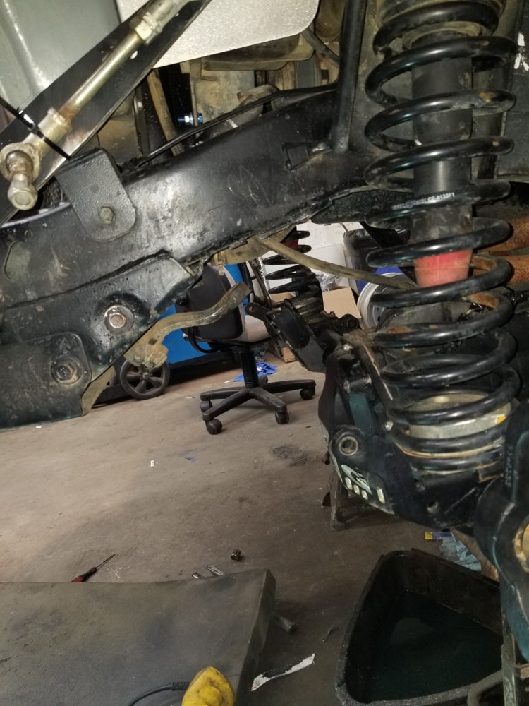

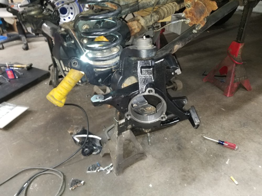

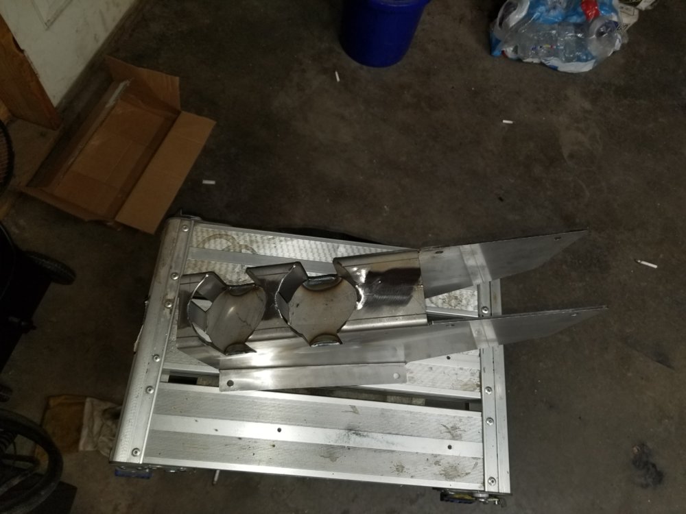

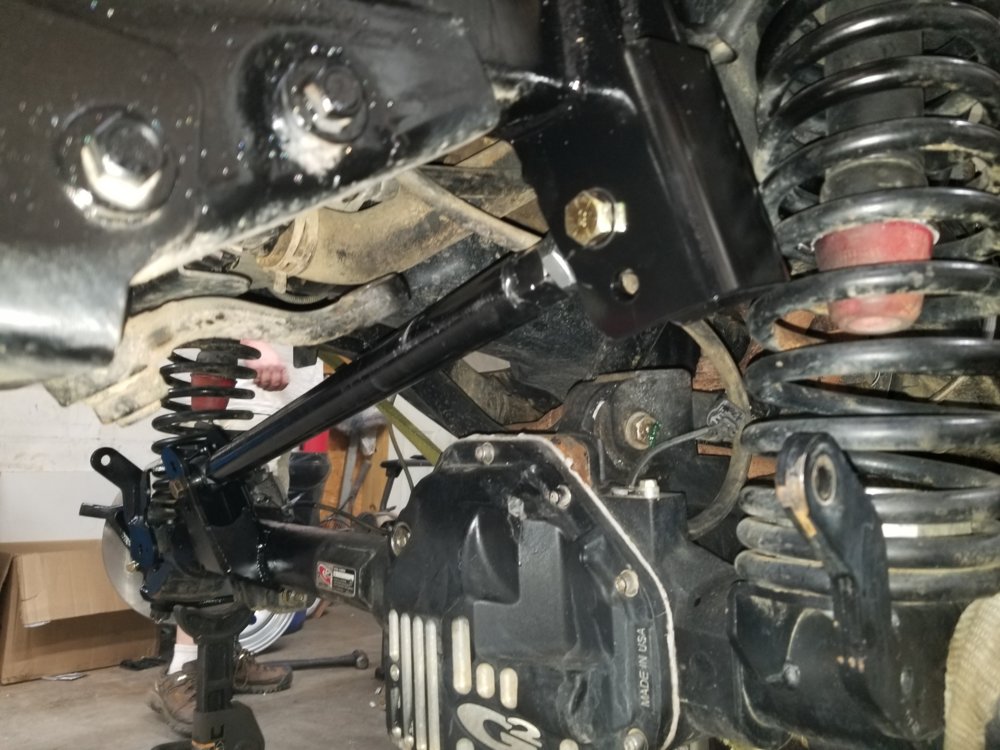

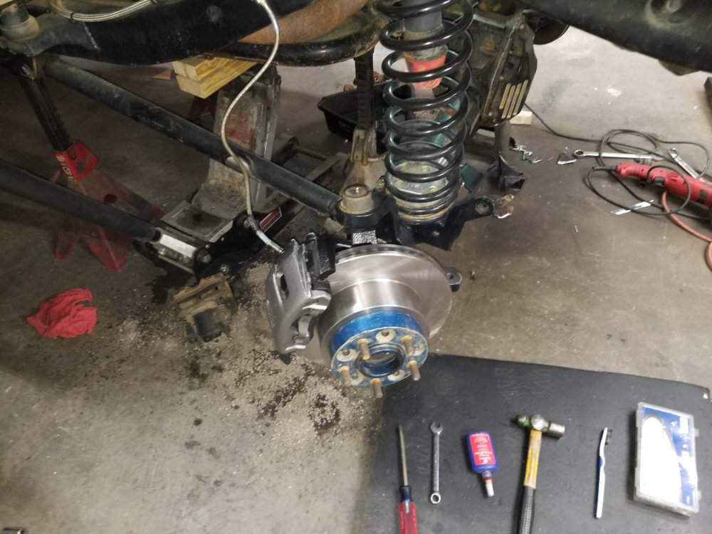

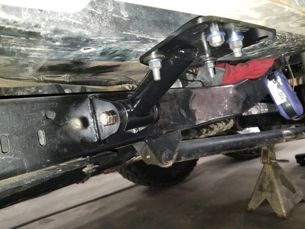

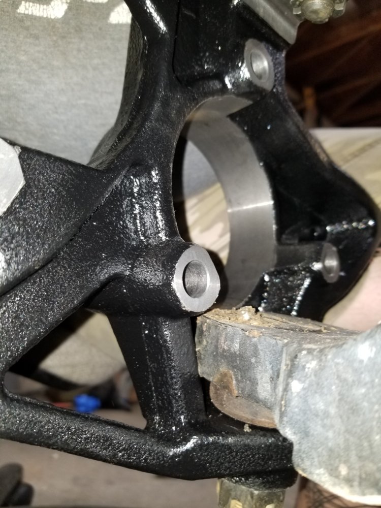

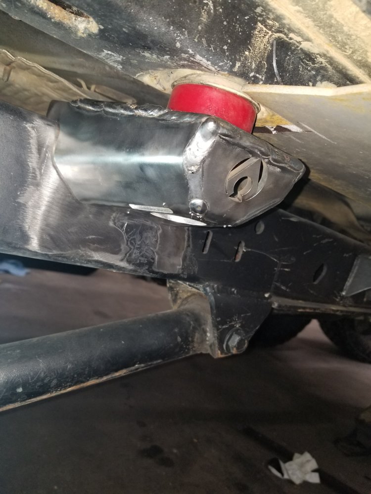

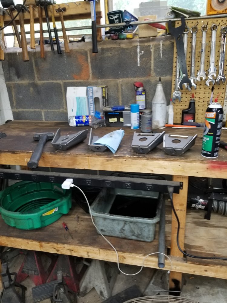

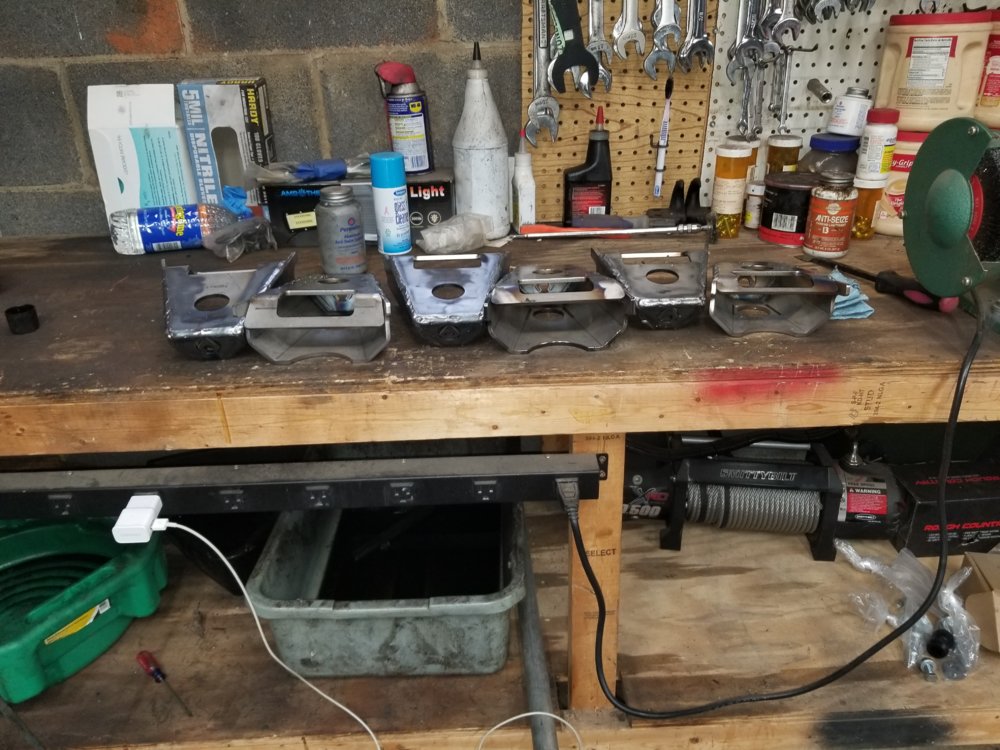

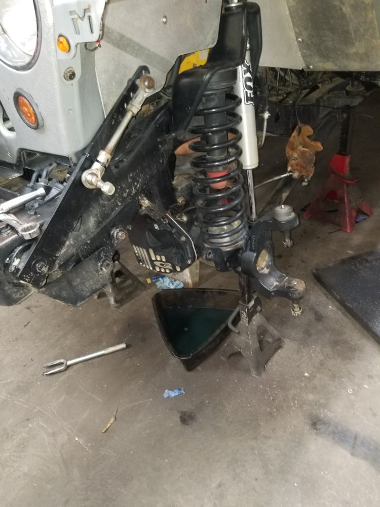

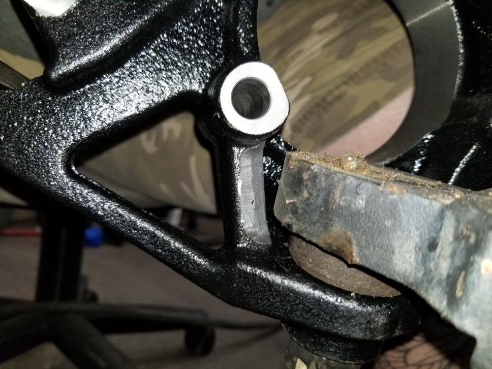

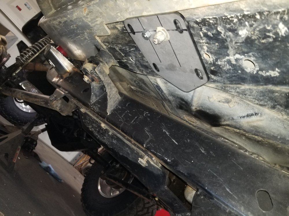

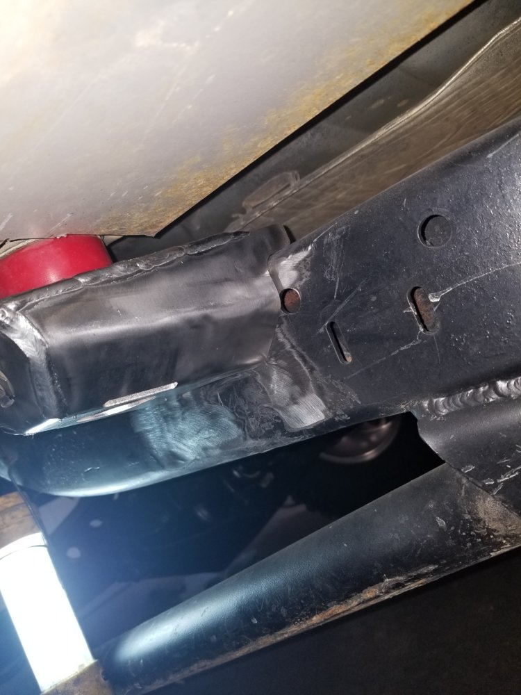

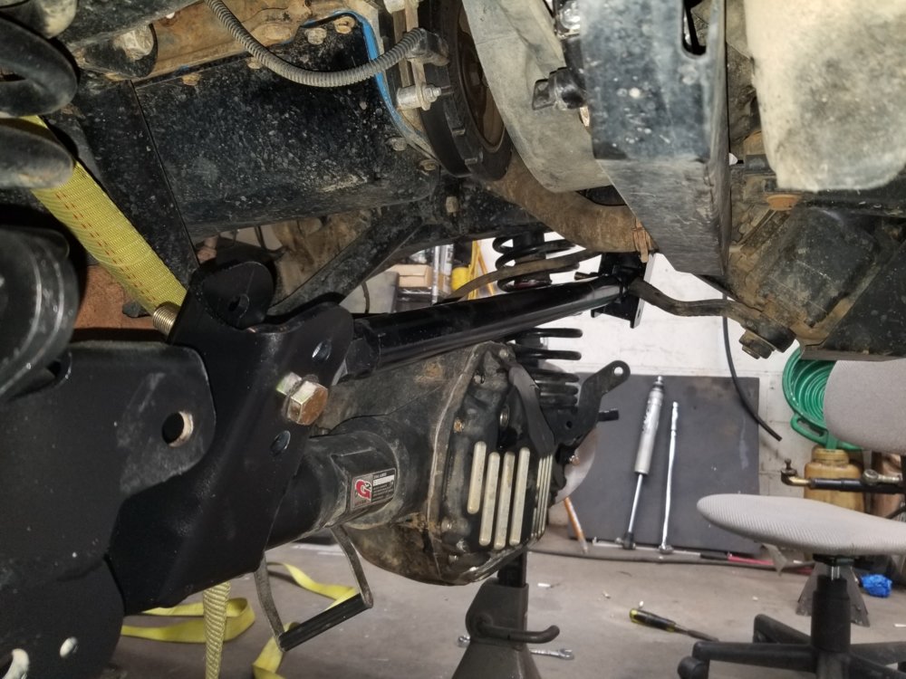

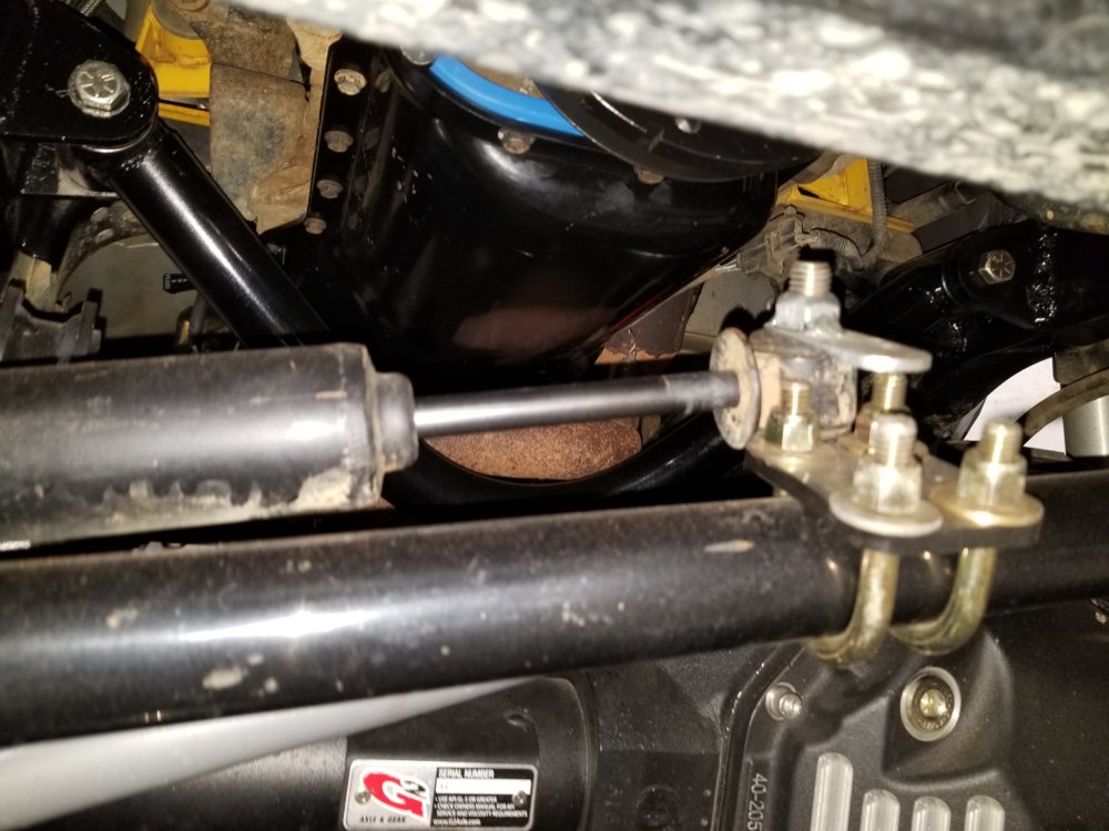

New Artec body mounts are welded in along with A&B pillar roll cage mounts. And new track bar/panhard bar mounts on the front axle and frame, a little trimming on the frame side mount and adjusting to the antirock arm for clearance. Also all new brakes front and rear with knew knuckles(witch it had to be clearanced) had to add 2inch spacers in the rear to clear the rear anti rock arms and coilovers.
