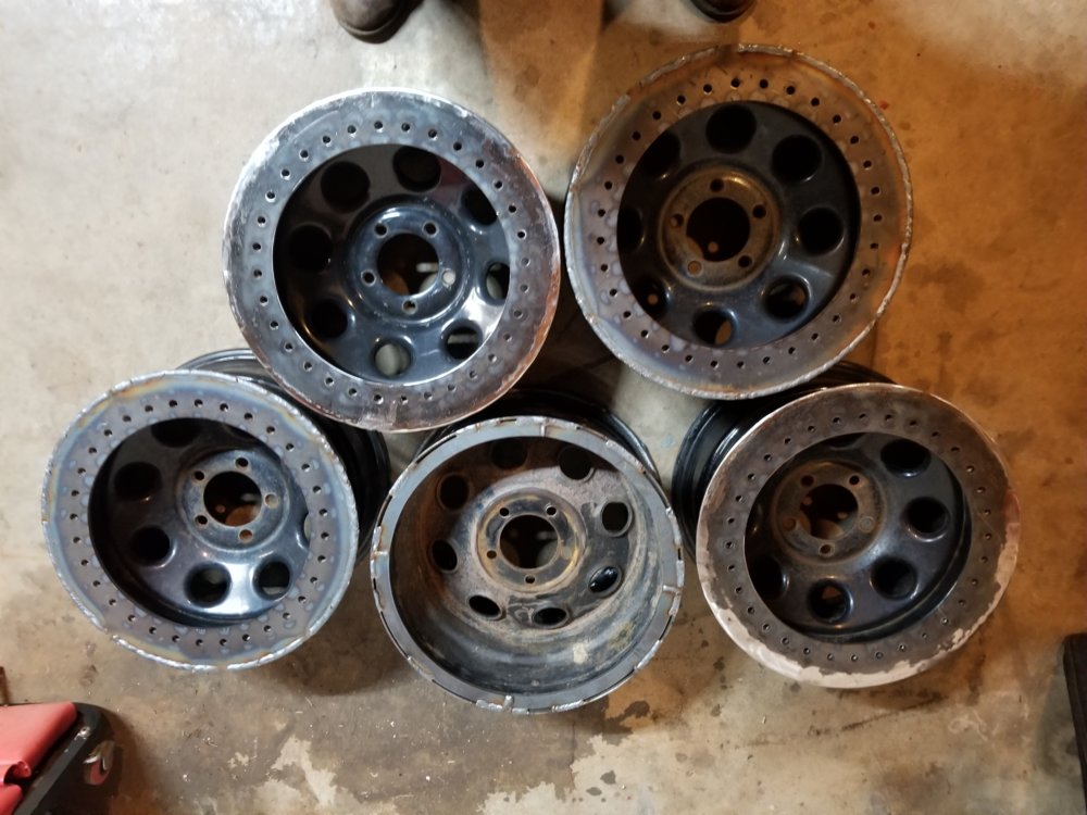

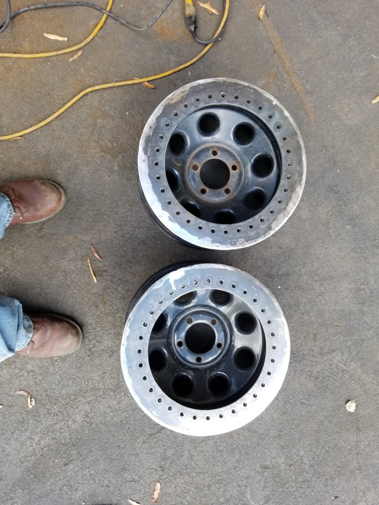

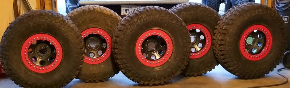

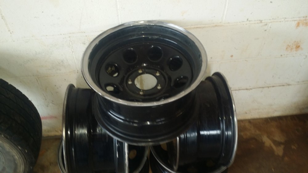

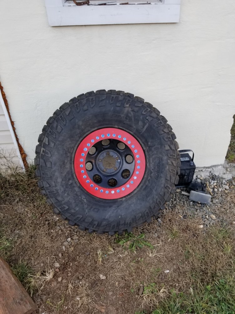

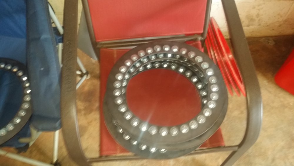

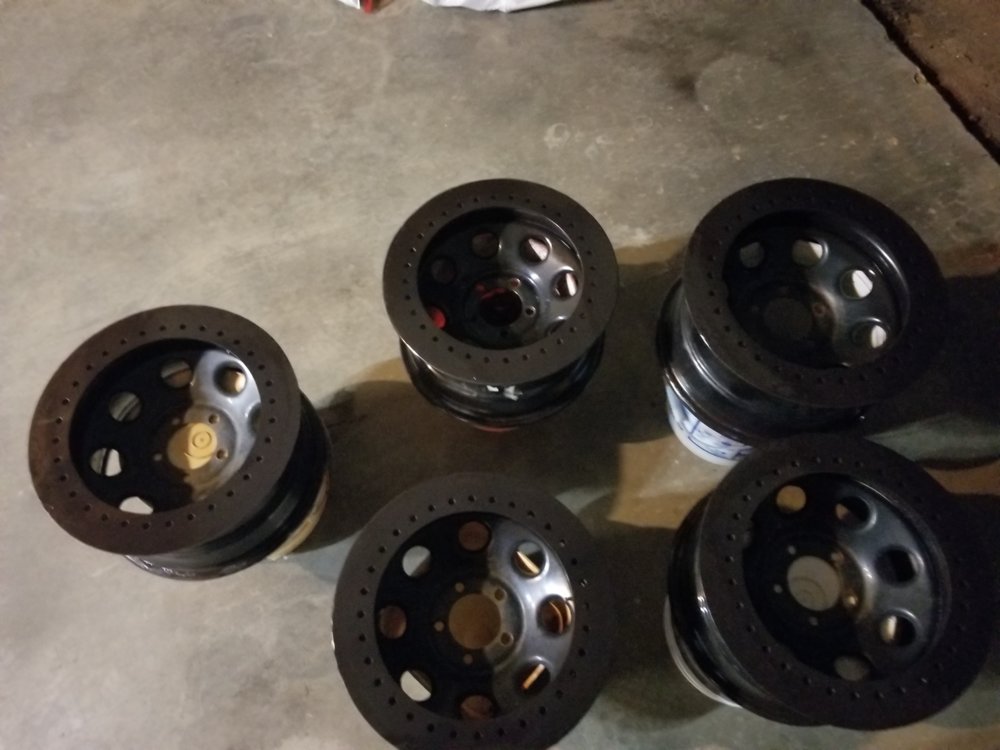

After many bent wheels while wheeling and one very bent wheel that about ripped the bead. So after that I bought some outer beadlocks and then had Mudpro cut me out the inner weld on beads plus another set for a spate tire. I also got a fellow student that's taking the cnc-plasma course to cut me out 1/4 thick and 3/4 of inch wide inner bead to strengthen up the bead so I don't bend thoses too. I was able to weld up one and 3/4 of another . I did this to make installation easier when all is said and done. Wheels and inner weld on beads prepared for welding.

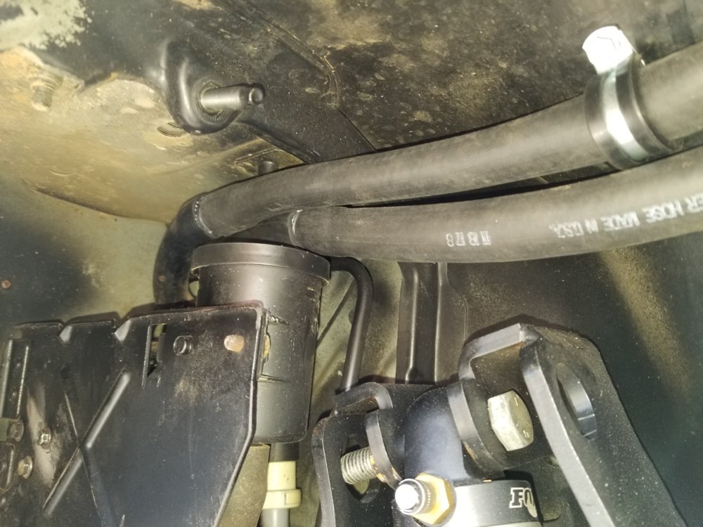

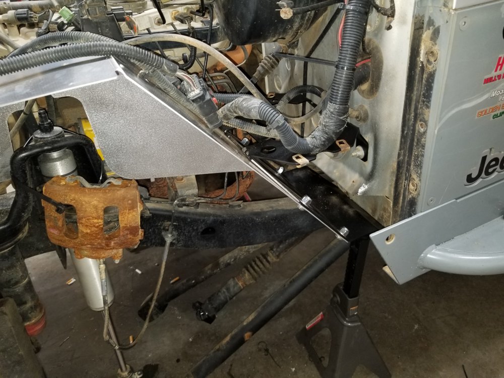

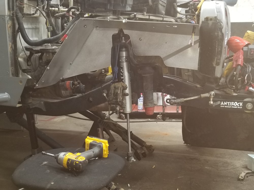

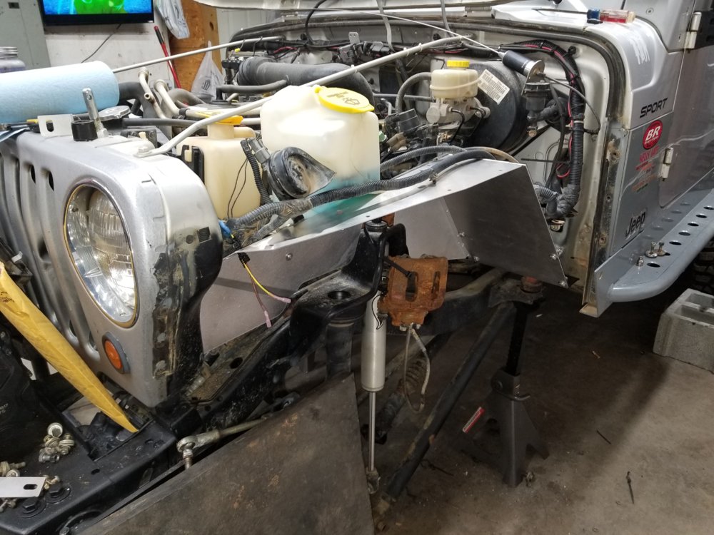

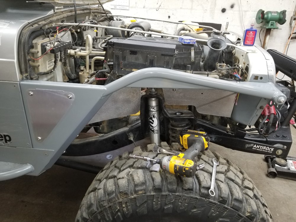

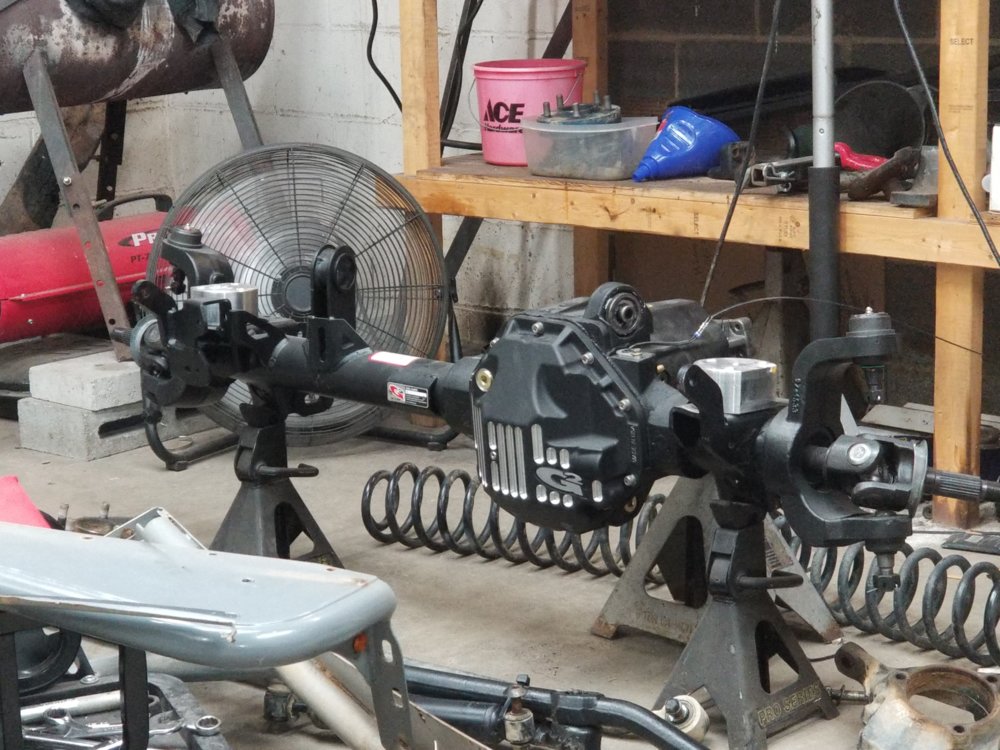

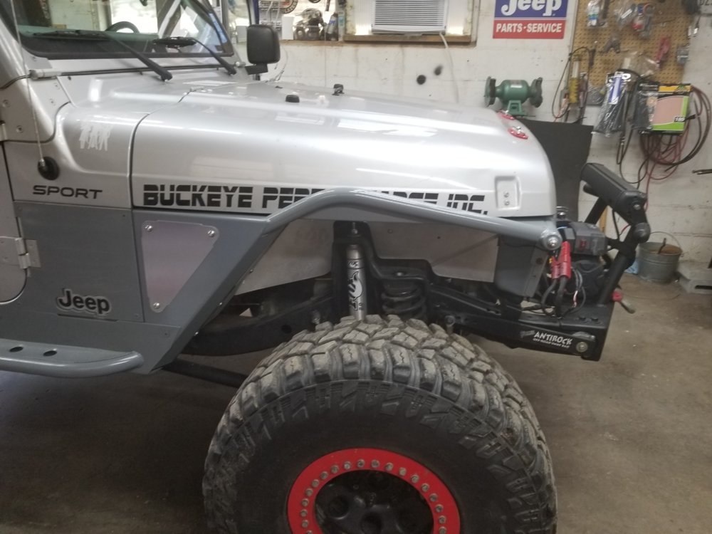

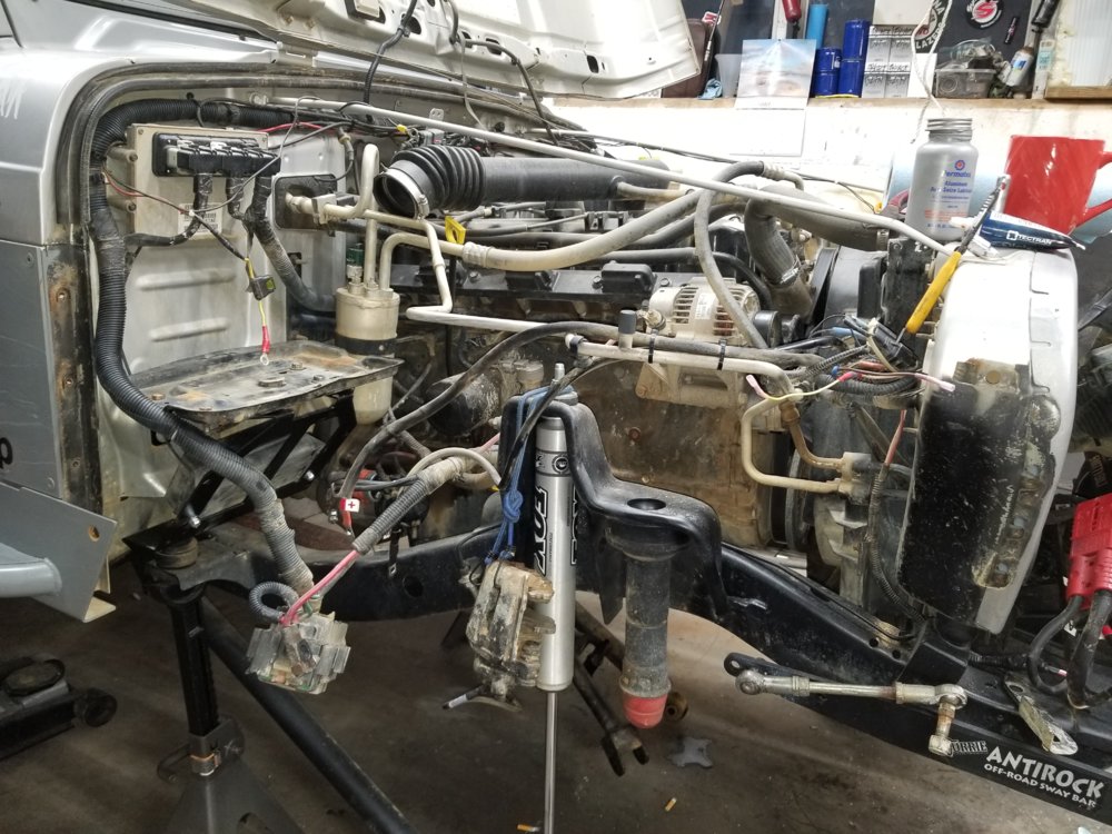

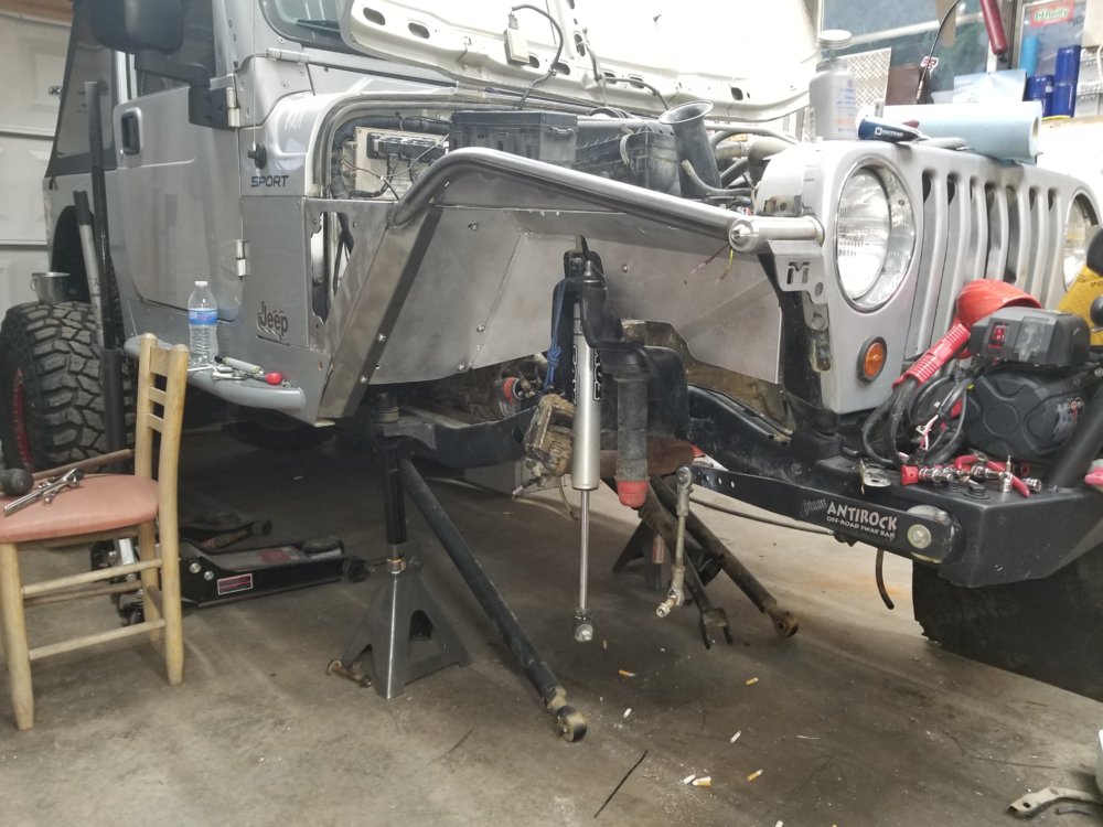

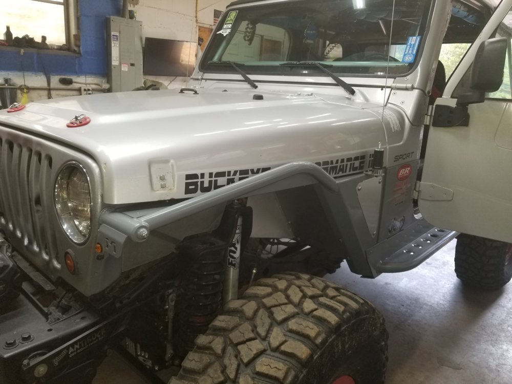

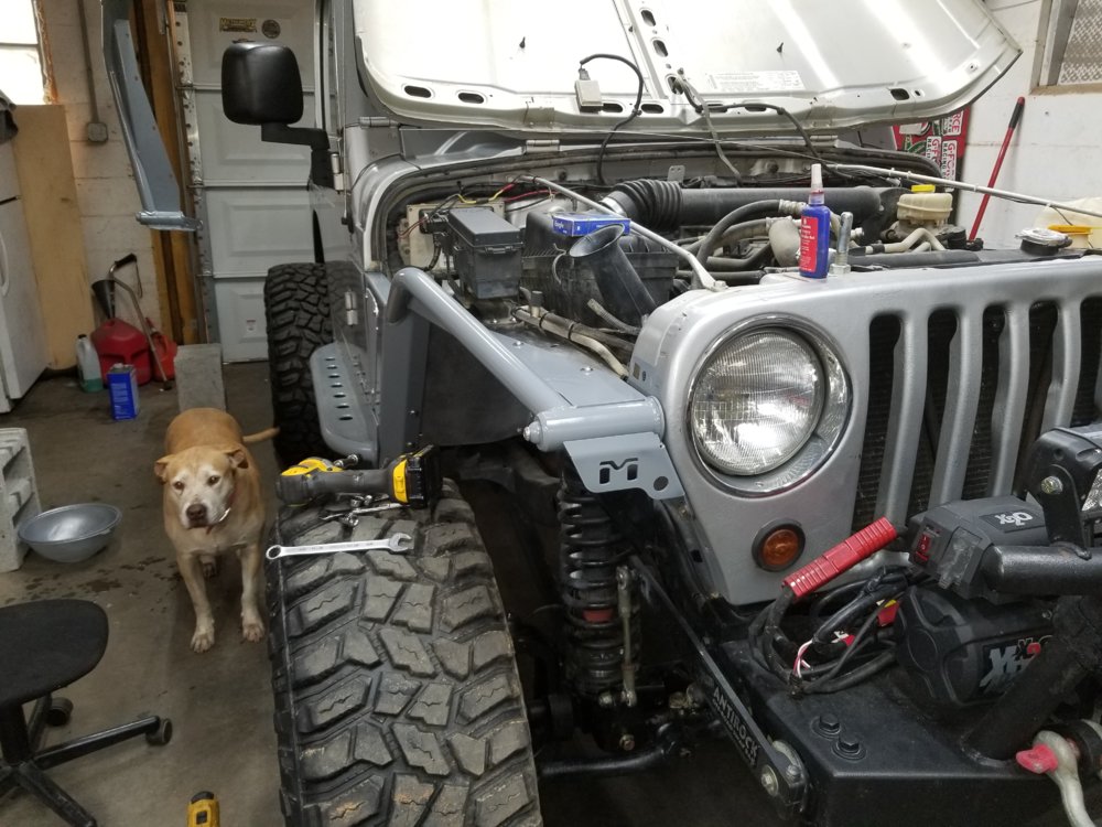

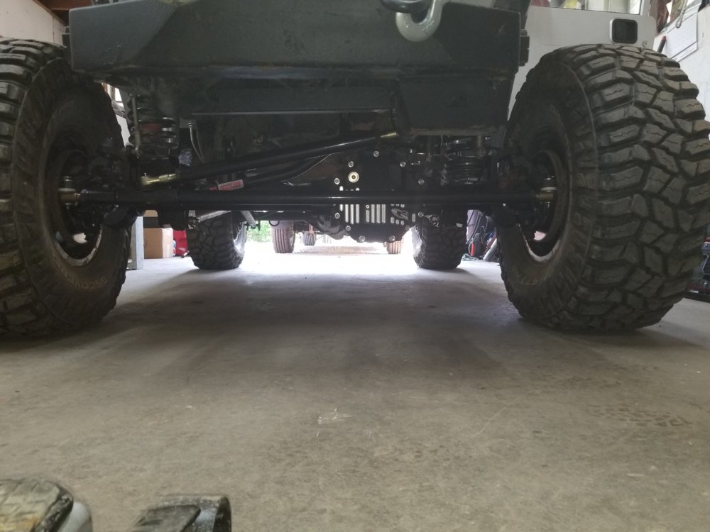

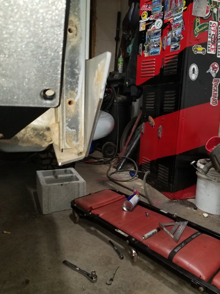

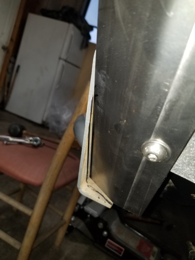

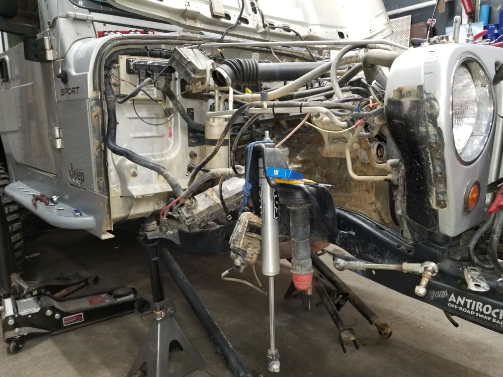

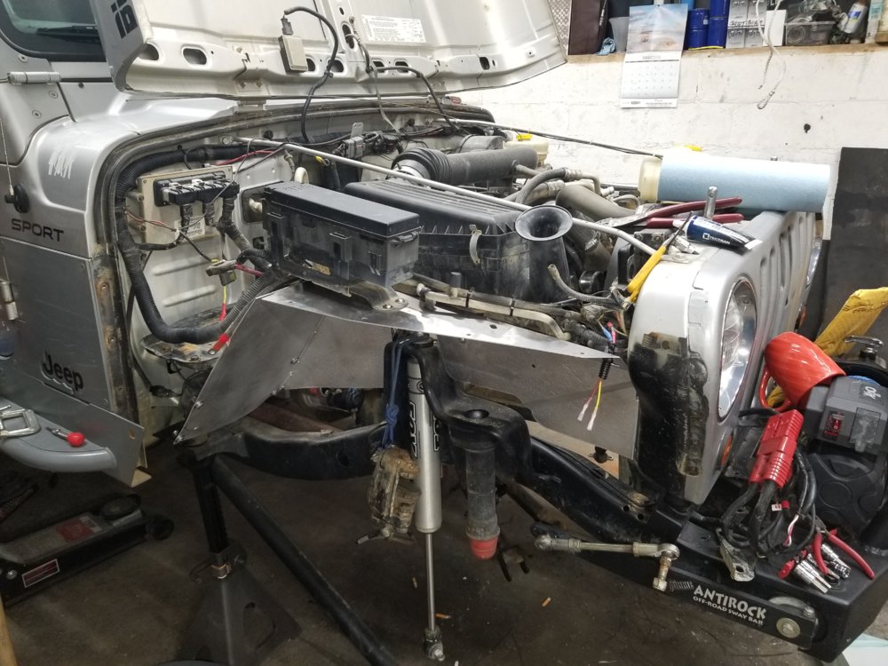

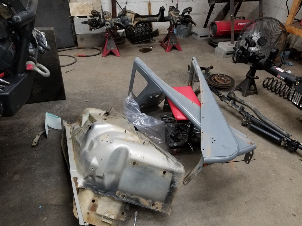

Upgrades as of late. I went with Metalcloak arched front fenders the destructions said a 4hr install but in reality it was more like 20hrs of prep and install time. Then i upgraded the front axle assembly from a high pinion dana 30 to a G2 high pinion dana 44 (jk center section) it has 4.88 gears with cromos shafts, and a eaton E-locker.. ran into clearance issues with my steering and my brand new track bar. So we had to find someting that would work. So now u have a offset steering from rustys offroad and a hiem style track bar.
