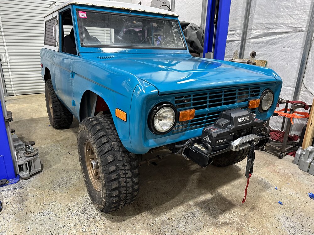

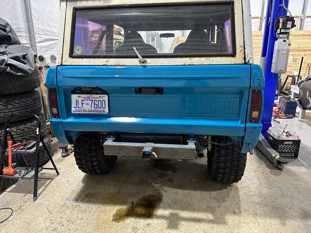

That’s why I didn’t want to get it professionally done. At this point I know I can always touch it up myself for $30 to do an entire panel. Looks good unmasked for the first time in a couple weeks. There’s a few runs and a rough spot or 2 but overall not bad for what it was.
Looks good you need to paint the grill back to white for the old school look!:beer:
We were debating that, ended up doing the solid color because there was going to be no other white on the truck so I felt it would look out of place. Black headlight bezels and trim pieces though to tie everything together.

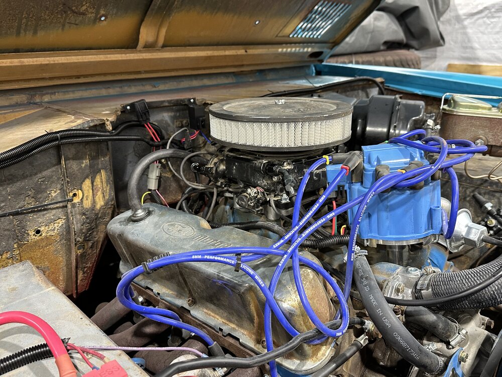

Worked on the bronco the other day with a buddy. He ended up with an extra sniper EFI setup and is cutting me a hell of a deal on it so we spent the day getting it all installed and wired up. Was told over and over that I would have RFI issues with my HEI distributor but after getting it all setup, everything works great, no RFI no weird signals. Just gotta put some miles on it and let it learn now. I will probably still keep everything to switch over to carb in a box when I go out so that I'm not stranded if anything funky happens. No extra cost to me just 30-45 minutes to get it swapped over. Went on my first cruise with it to learn some and it did really well, handheld isn't reading correct though so just got a new one in today and will work on swapping that out tomorrow to see what its actually doing. But time to cruise it some until uwharrie for veterans day.
Got any pics of the install?
Plan to have it tuned. It will run good enough, but never run great without having someone, who knows what they are doing, to tune it.
This is the only photo I have right now. It was pretty straightforward though. I have the coil wire triggering a relay for clean switched ignition. I know I’ll probably need someone to do the finishing tuning but for now it runs as good if not better than the carb so I’m pretty damn happy. Going to start transferring the learn tables today and keep plenty of backups. Depending on how it acts on the trails I may end up resetting the wizard and have it learn crawling as a separate tune I can swap out when on the trails.

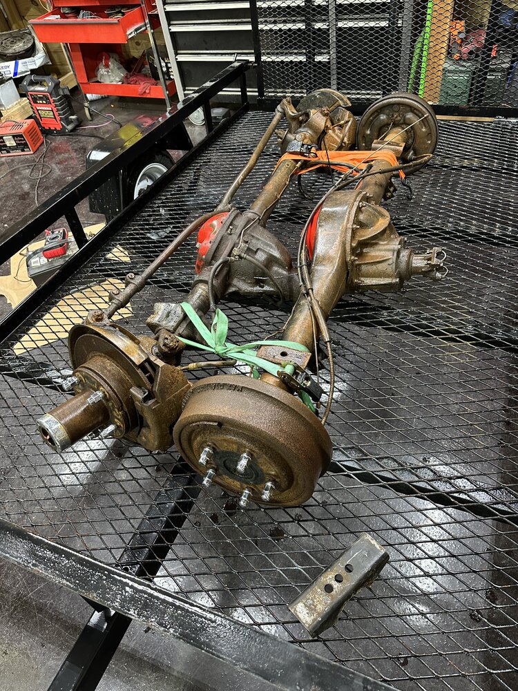

Picked up my full widths today, thanks @RoosterRash ! Now to start sourcing the parts needed to swap these in, adjustable track bar, radius arm cap spacer, 1 ton tie rod kit, etc. might not get it done before uwharrie in November but going to do my best.

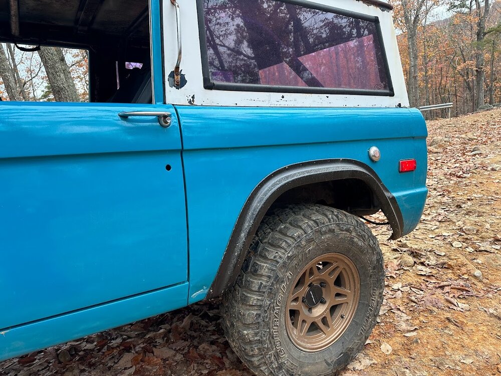

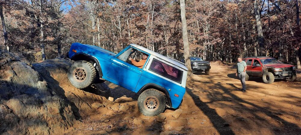

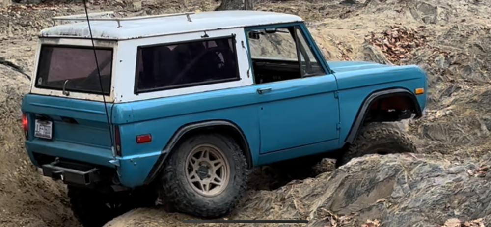

Went wheeling again this weekend in URE for veterans day. Had some good old friends meet us out there. Not much had changed since last time except the sniper honestly. Truck ran great, had a few weird spots where the sniper would surge when the truck was close to stalling but other than that everything worked well. Smacked the rear quarter rocker on a rock and scratched it pretty good, not too worried though as we will be doing a 2x6 rock slider there in the near future. Definitely found some shortcomings and needs that will be addressed soon. All in all a good weekend with great friends and some plans for the future. Wish I had been able to go out with all the bronco guys the week before, but this was the weekend we've had planned for almost a year so it's how it worked out. Hoping to sell my big bronco soon so I can do the long arms, 37s, new rear suspension before the next trip. Didn't make it out to the event unfortunately as we were on backside for most of saturday night, but heard it went off great and i'm glad to hear it! Hopefully next year we will have an early enough start to make it off the trails in time. I think I recognized a few rigs from here out there this weekend, but unfortunately don't know many personally to have flagged anyone down to talk but it was a great trip!

Hate I missed seeing this in person.
I believe you came up Dickey bell just before me. I was parked down at the bottom on the right with the big group. I saw yours just walk up it! Looked great! Here’s a video one of our guys got of you at the top of Dickey bell. Also have a short video of the fj behind you.
  • PXL_20231111_180019786.TS.mov
    14.3 MB
Oh man I guess I need to pay better attention. I was oggling over the flatty at the bottom.
Yeah we had a bit of a fight getting him up but he walked it up like a champ!

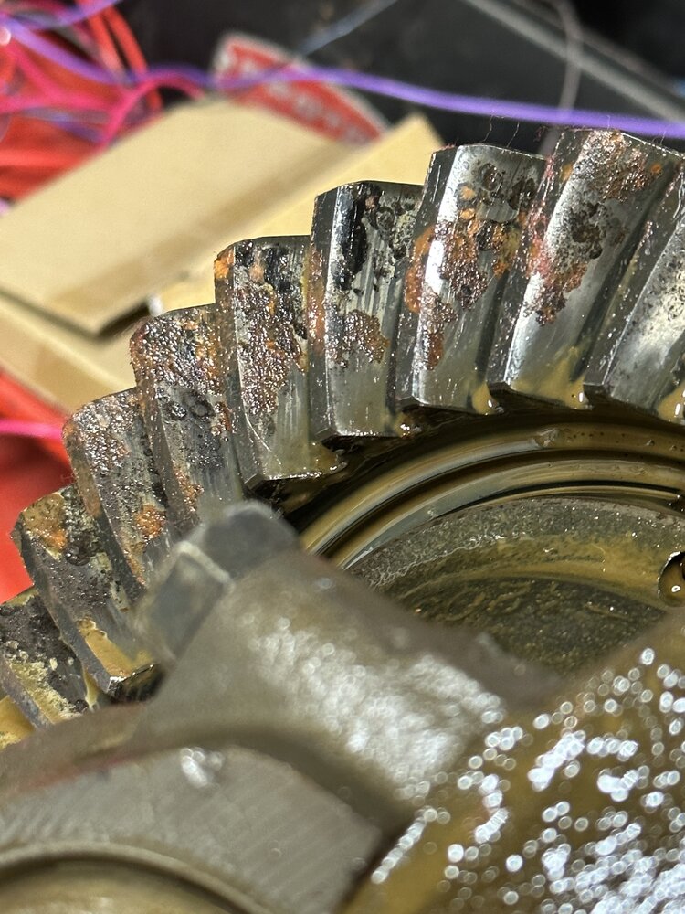

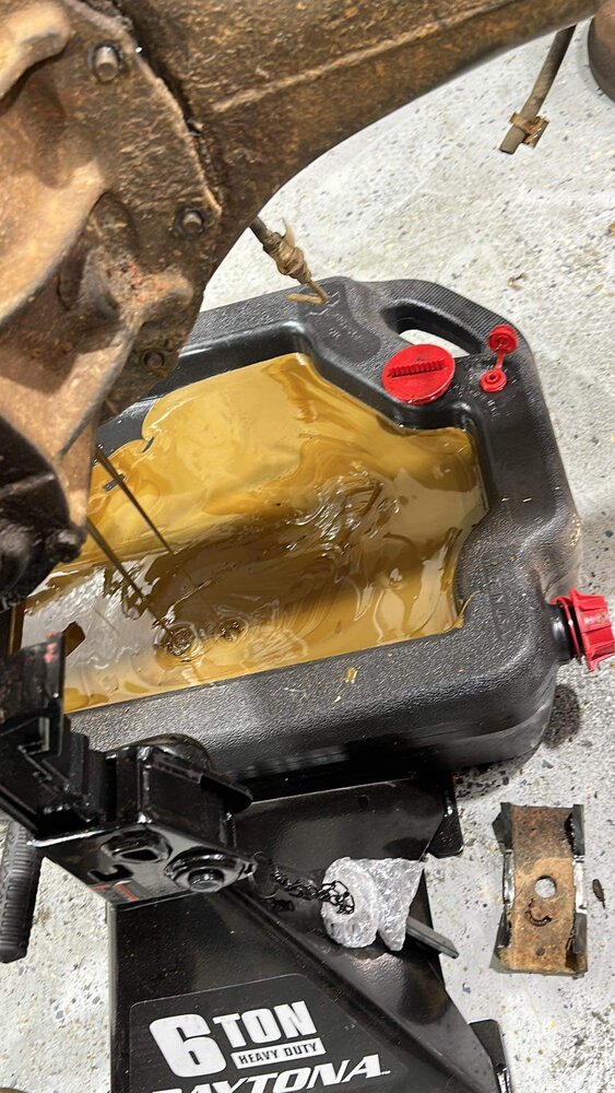

Pulling the full width 9 apart to get it cleaned up to put in, and found plenty of water inside it from where it was stored outside I believe. Found this surface rust and some light pitting on the ring gear. Is this beyond usable or will this get me by with just some noise?
Here’s a video running through the ring really quickly if it gives a better idea of condition. I did but the major rust spots with a brass brush to clean them up a hair.
  • IMG_5807.mov
    33.1 MB
I would flood the heck out of everything with cleaner button it up and run it!
(I’m not a pro)
Kind of where I’m at with it. Intention down the line will be to step up gear size and go to 35 spline eventually so don’t want to pour too much into these to run in this configuration. But that could be a few years away so don’t want to be kicking myself in my own ass in the meantime
I would definitely get a for sure answer from better brains than I don’t have but if it’s just a toy the worst thing would be the bearings being pitted and at that point idk.
