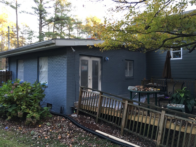

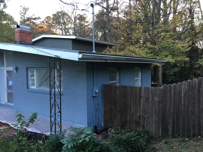

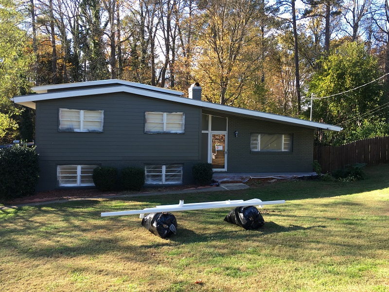

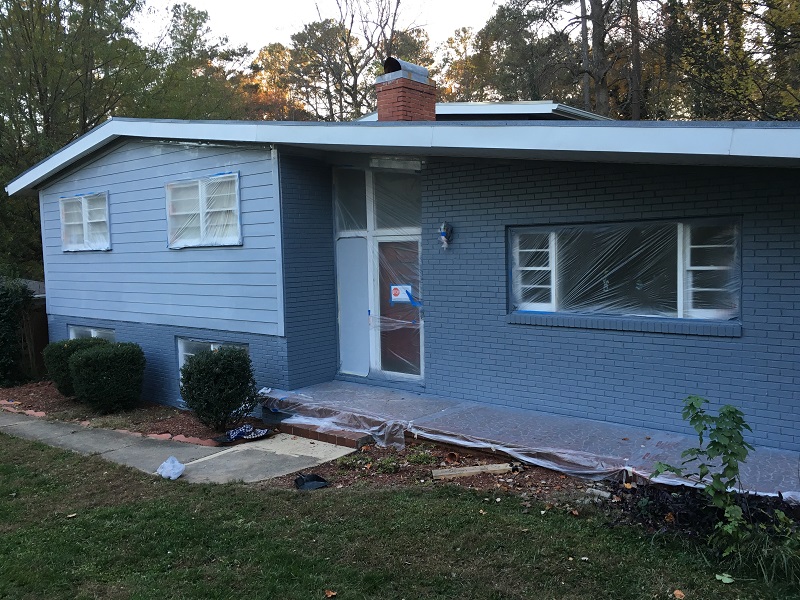

been a good week.. all the floors got sanded and stained and we primed and painted the outside of the house.. this week all depends on electrician if we can get CO by end of the week ( keeping fingers crossed)

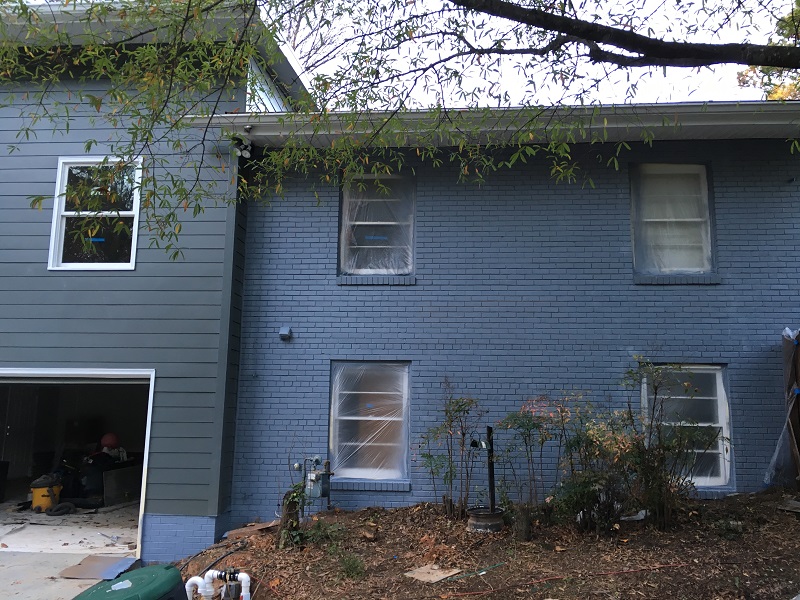

house primed
and painted

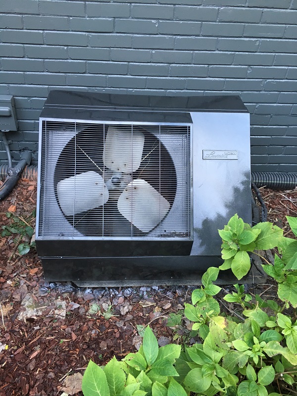

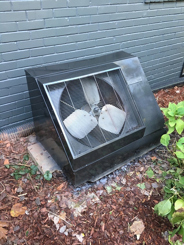

and I painted the old AC unit so it would look a little better next to the new one :)

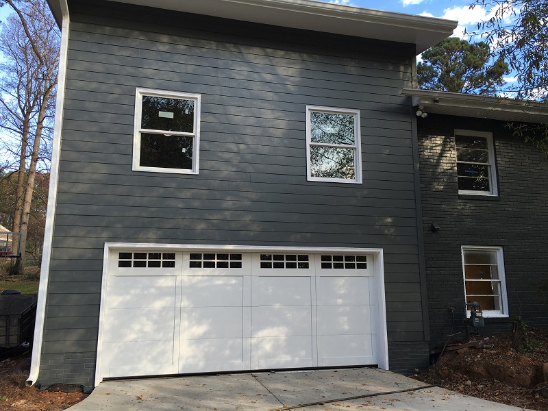

Here is a picture will all new windows also installed (except for two that they measured wrong)

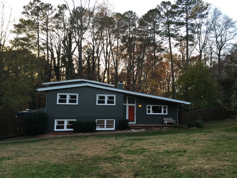

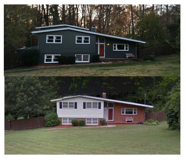

I will have to take better pics int he spring after I take down all the Christmas decorations and complete the yard but for now here is the front before and after.
now that the house is done I can finally starting organizing the shipping container and shop to what I always wanted.. so more to come on the good stuff in the next few months

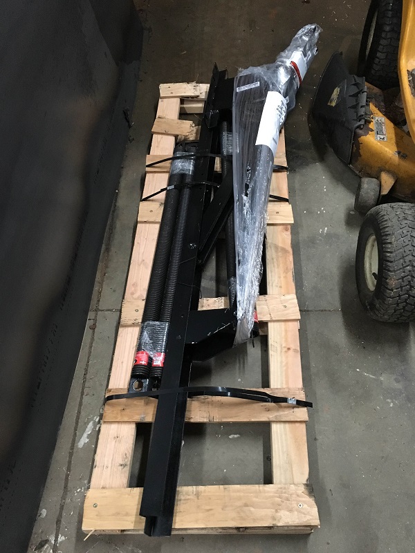

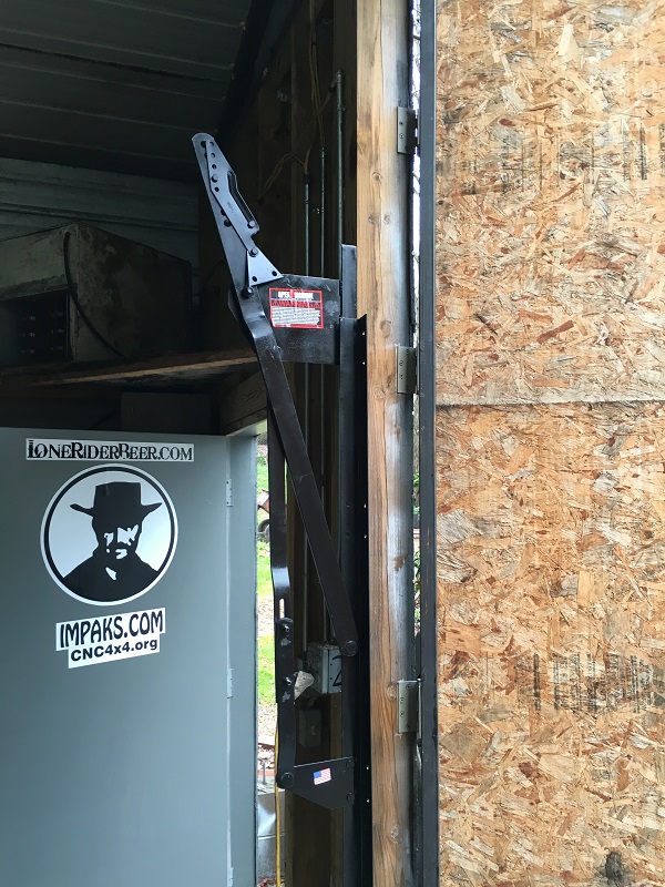

took a few weeks but my door hinges came in..
hopefully this weekend I can get these mounted and see how the work.. keeping fingers crossed
Getting further along on the new garage door opener

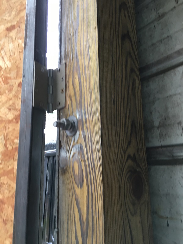

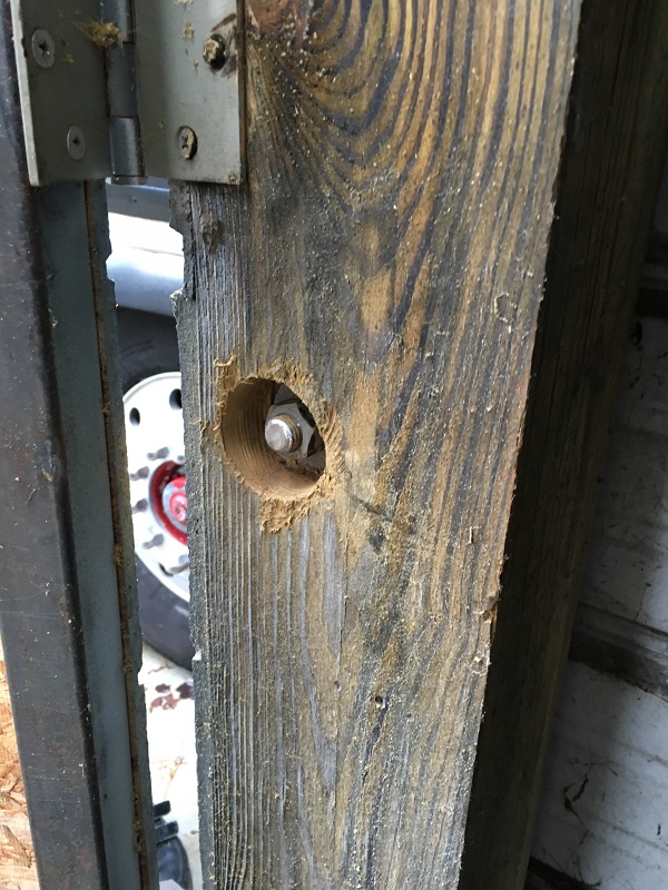

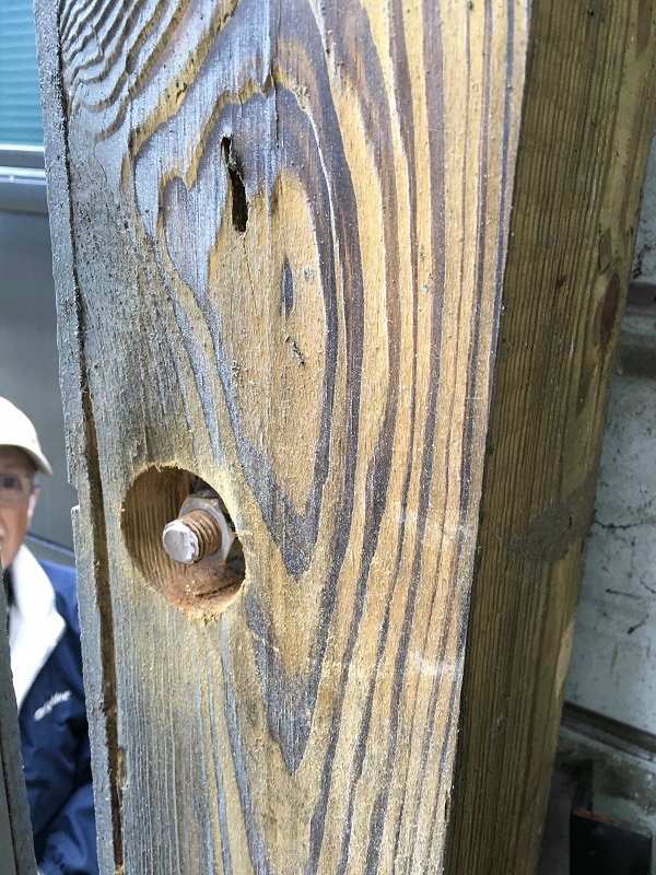

Here you can see the bolts that hold the wood beam to the outside metal building
had to cut and recess them into the wood so door would clear when opening
Hinges mounted
and doors taken off old hinges and then recessed back so the new hinges will work corectly

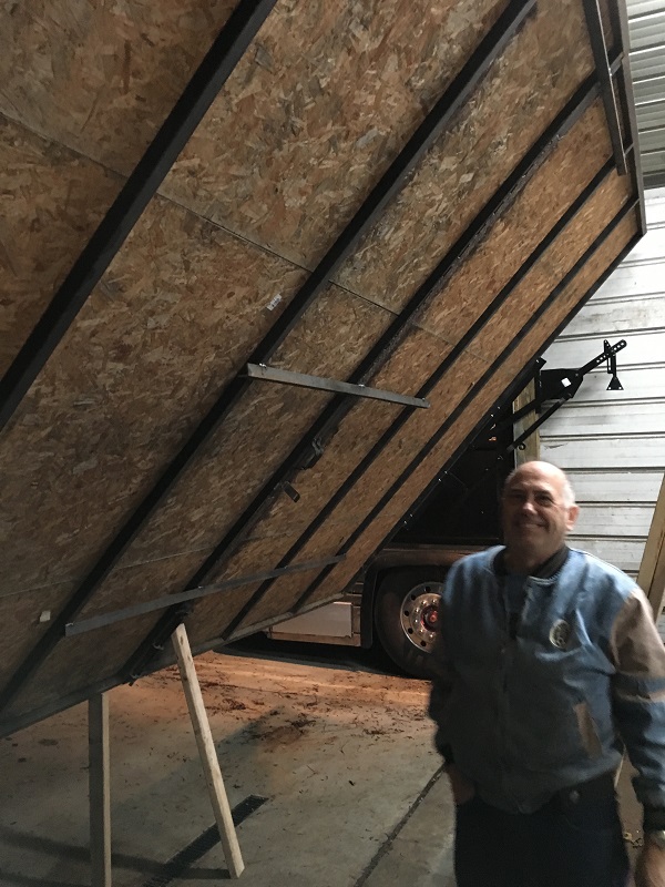

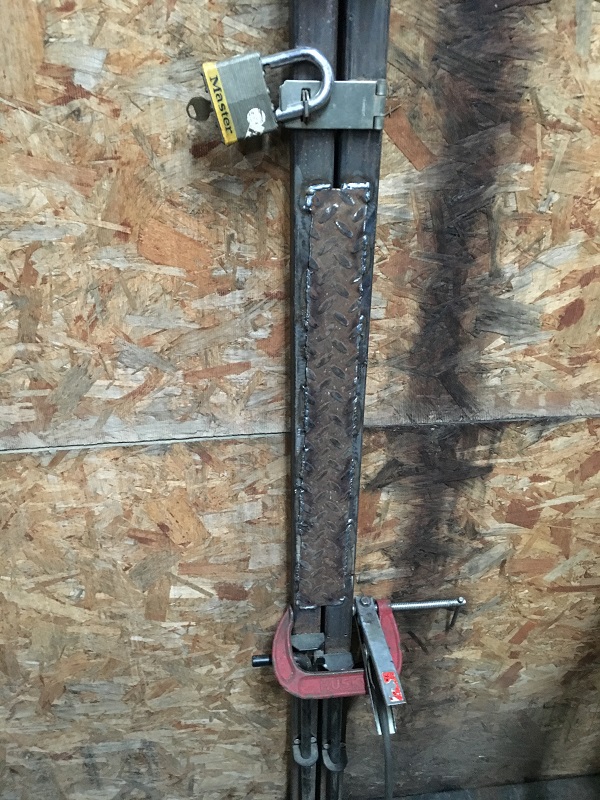

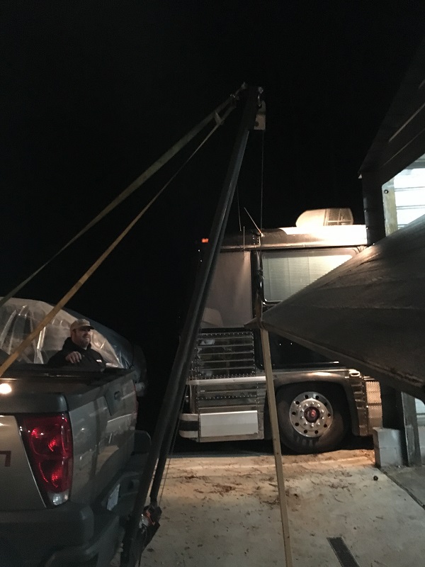

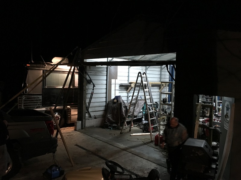

had to weld some bracing to connect both doors together so it will swing up as one large doors

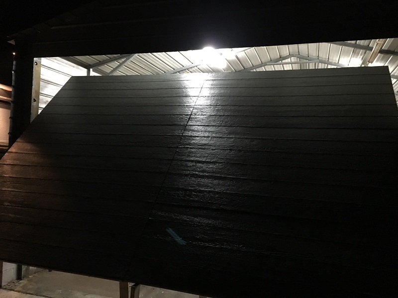

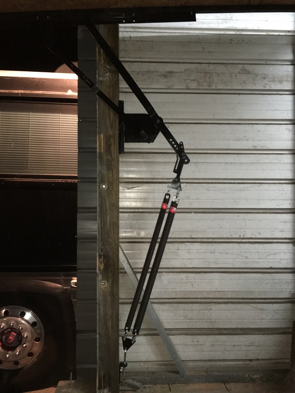

once we got it to this point we realized this is way to heavy to lift all the way up so we rigged up a hoist off the back of my truck..it worked great and we were able to lift door all the way open and then attach the springs..

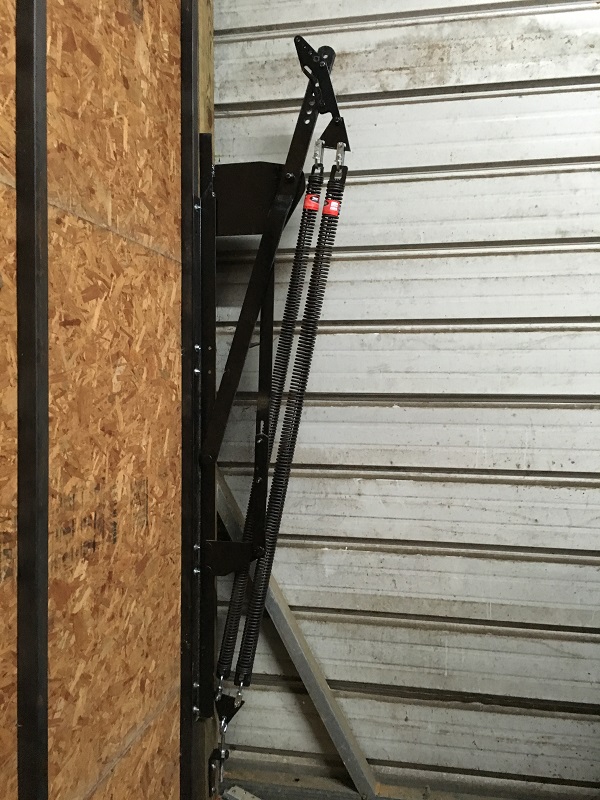

once springs were attached I could lift and close the door by myself but no matter how much I adjusted the springs I can not get it to stay open by itself.. so now I need to call the company and figure out what I am doing wrong
Why the switch from swinging doors?
Typically you either need to have some tension still on the spring or they cam past center.

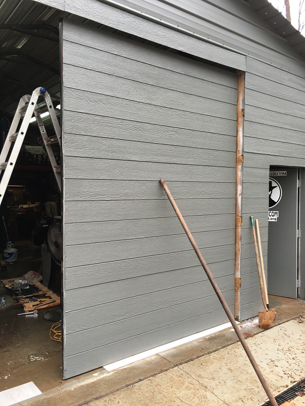

when we made the entire driveway concrete we could not get the slope correct for doors to open all the way without it being a steep slope which I did not want.. so I had him make a nice smooth slope with the plan to change the doors.. I could still get a vehicle in and out but I decided I would rather have one large door that can open and make it easier to get stuff in and out..
I did have a phone call with the hinge guy and he suggested I moved the bottom spring mount down closer to floor to get more tension on the springs. so that is my next step

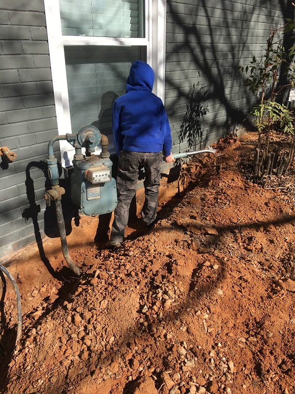

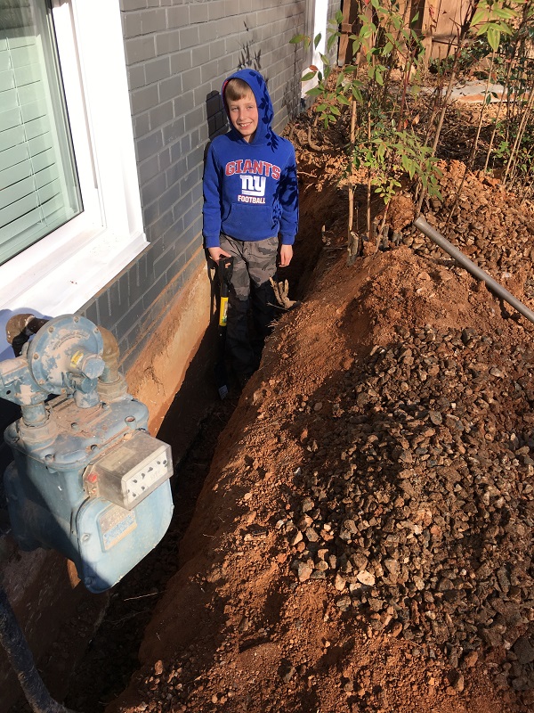

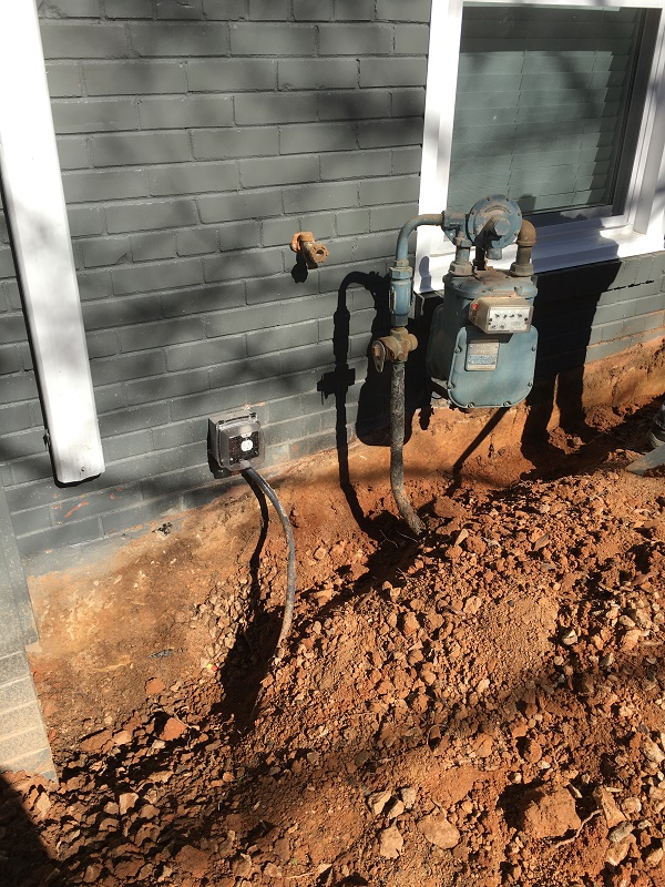

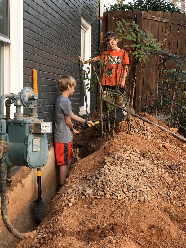

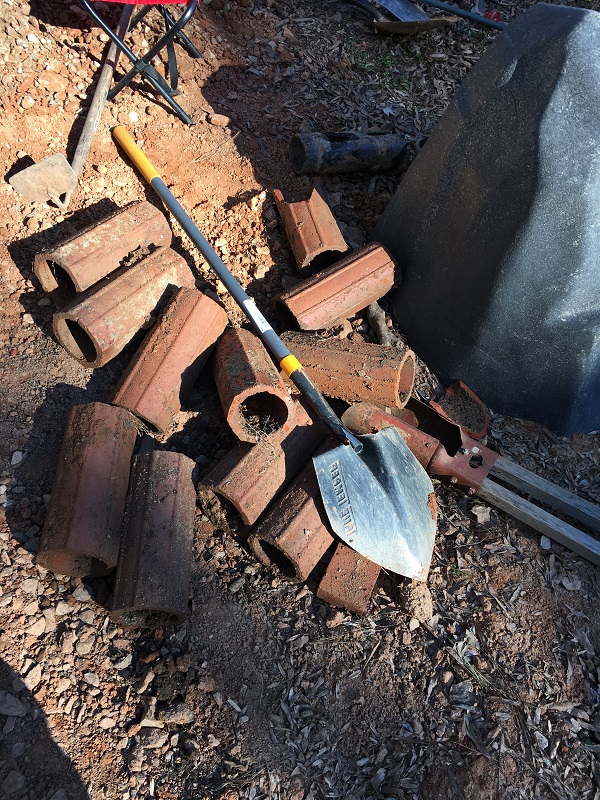

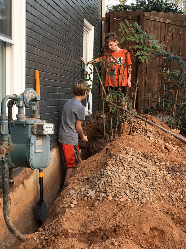

had some water drain issues after new addition was done so here I am trying to fix it.. have to dig out the side of foundation rip up old piping and lay new pipe down.
Getting started
having a helper is always good
old clay pipe
son had a friend over so I put them both to work :)

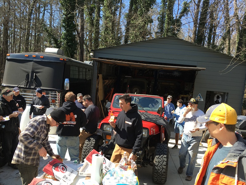

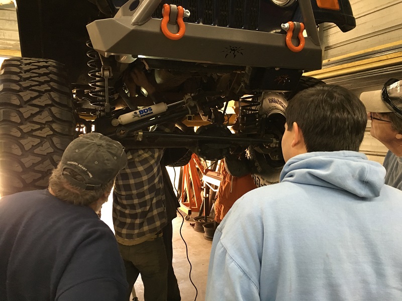

well I volunteered my shop to my 4x4 club wrenching day.. it is a day we help club members get projects done on there rigs
so my son and I had to do some cleaning up before this past saturday. here he is helping me
