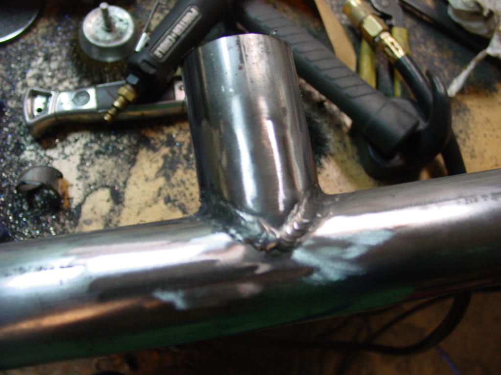

Made some more progress on the slider this evening,

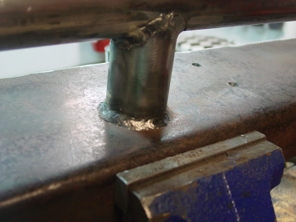

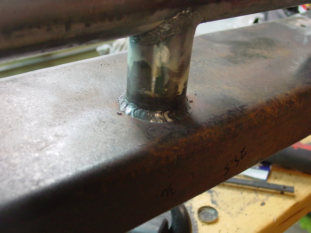

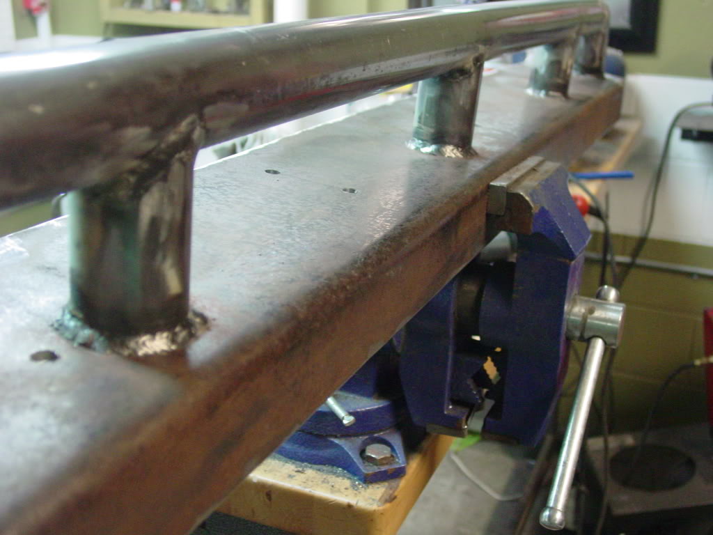

Got the tube welded up for the driver side
Welded it up to the plate, Mocked it up to the Jeep

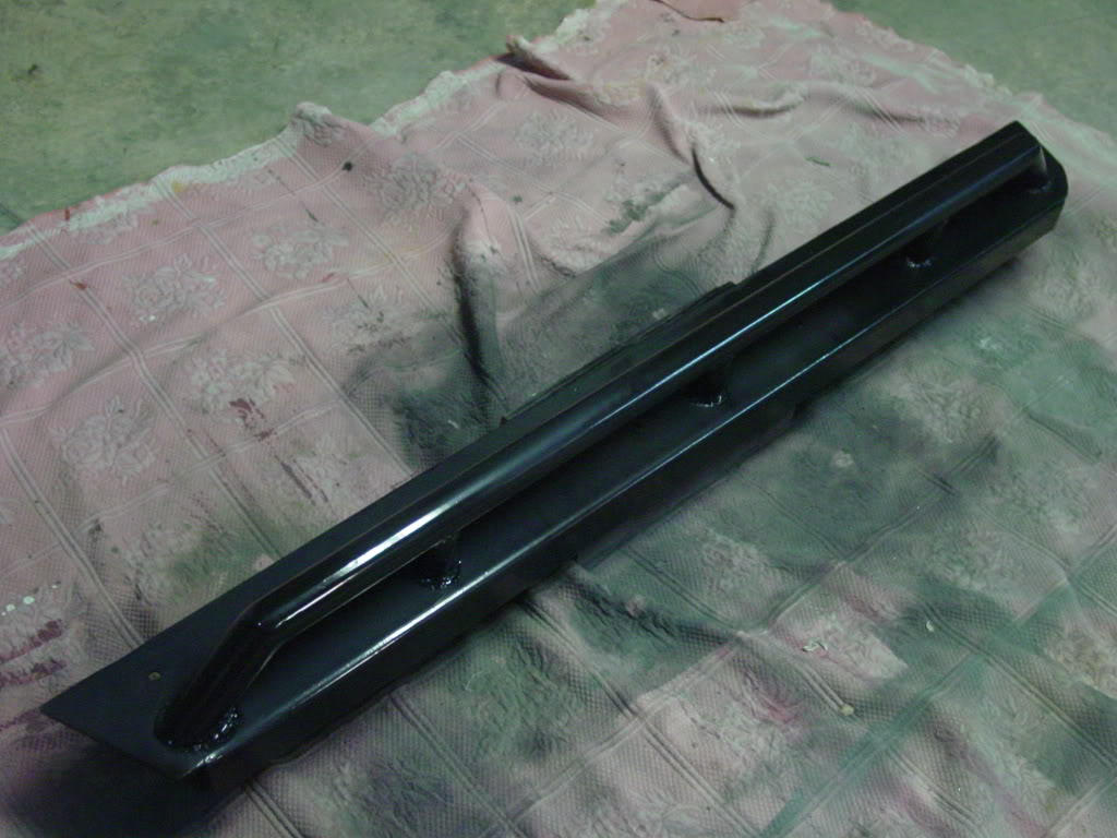

And a coat of paint on it

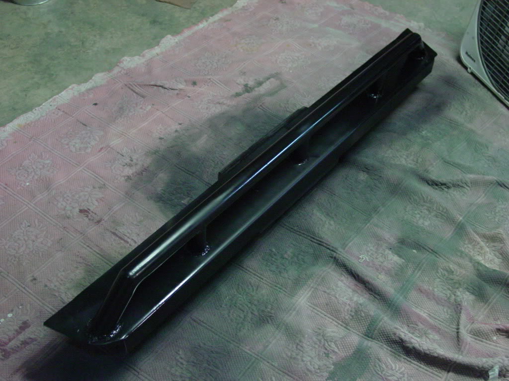

So the driver side is done, Got to build the passenger side tomorrow evening, and bolt them up.

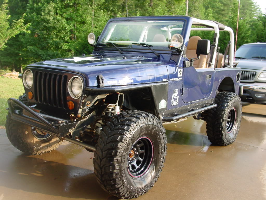

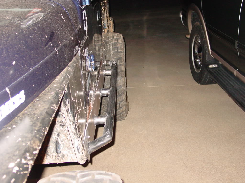

Finished both sliders
Well I got both the sliders done last night.
After I built the first one the second one wasn't near as tough. Still there is a ton of work that goes into building parts, Makes you respect the saying "Built not Bought" a little more. I enjoy building my parts, But its not for every one.

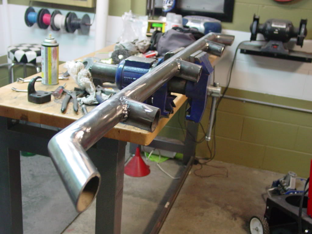

Same as the first one, I started by extending the material that I got that was just right on the bent piece, Just wanted to extend it to the edge of the wheel wells. Then I worked on the tube. I have to say that with the amount of welding I am doing, Its great practice. There starting to look decent :lol:

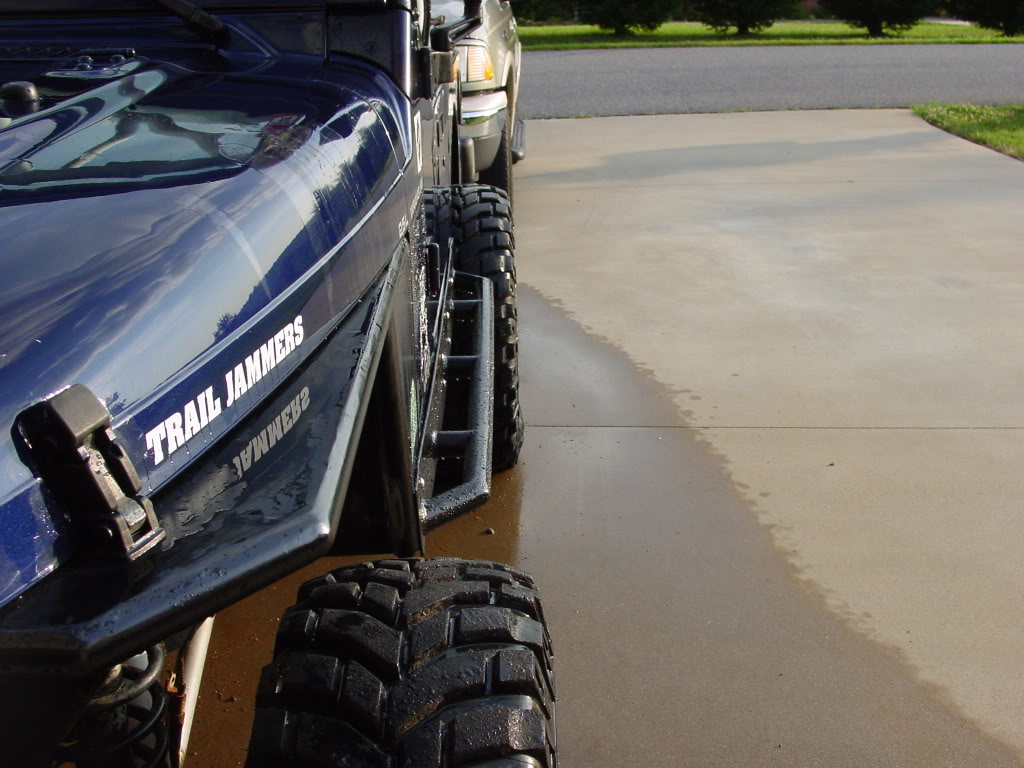

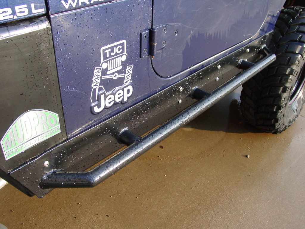

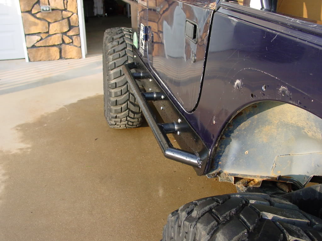

Passenger side with paint on it.

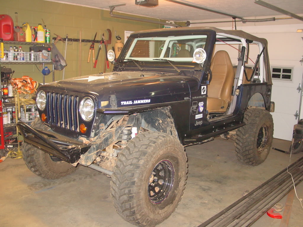

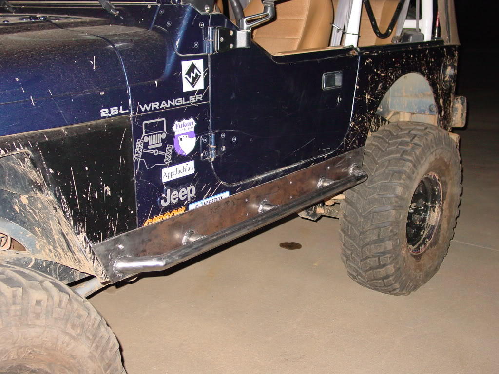

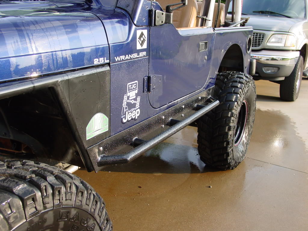

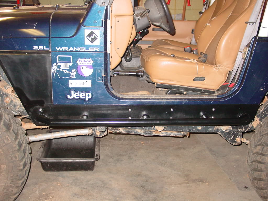

Driver side mounted
I will bolt the passenger side up this evening, That should give the paint a while to harden. Then clean up the ton of metal shavings that covers my garage, before the family returns Friday.
nice sliders!! Ive been wanting to add some tube to mine for a long time now. Keep up the good work!!
Great Job Mike. I really like how it turned out.
One word of warning. you not only created a working slider, but you also created a step. With the nice slick paint job, and a muddy wet boot, someone will surely step, pull slide, and maybe even hurt them self getting in. Traction tape works good, until it's gets muddy. A small piece of expanded metal tacked right on top of it will really help keep from you sliding off and stretching muscles you forgot you had.

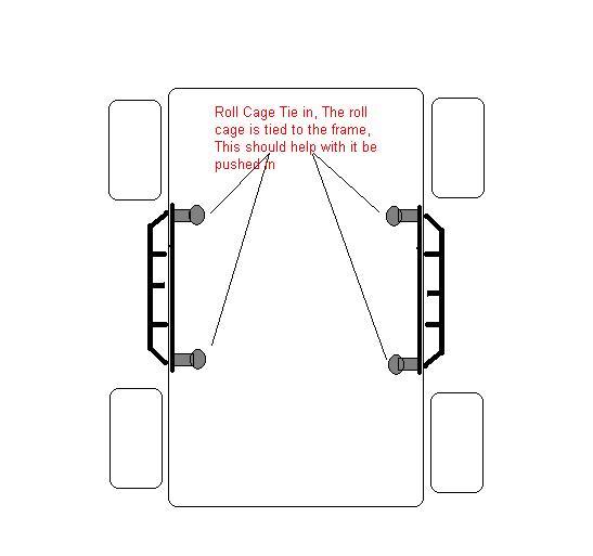

Here is my Idea to tie them in solid. I was considering adding tube to the bottom But I didn't want to add something to get hung up. So here is the Idea
The bottom of the A and B pillars are tied to the frame. The B pillar mount will have the be angled, this should also help by connecting the A and B pillars together front to rear.
Mike hes right on the grip tape.Take it from an old sk8er.Talk with Justin;He or I can find you some grate or something to eliminate that problem.You know I got connections too with other companies.Call me and let me know the length you need and we'll see what we can find.

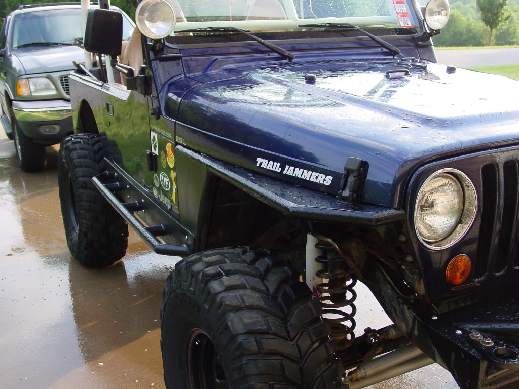

Just got in from Mtn City Yesterday. Had a great time and really enjoyed riding with everyone.

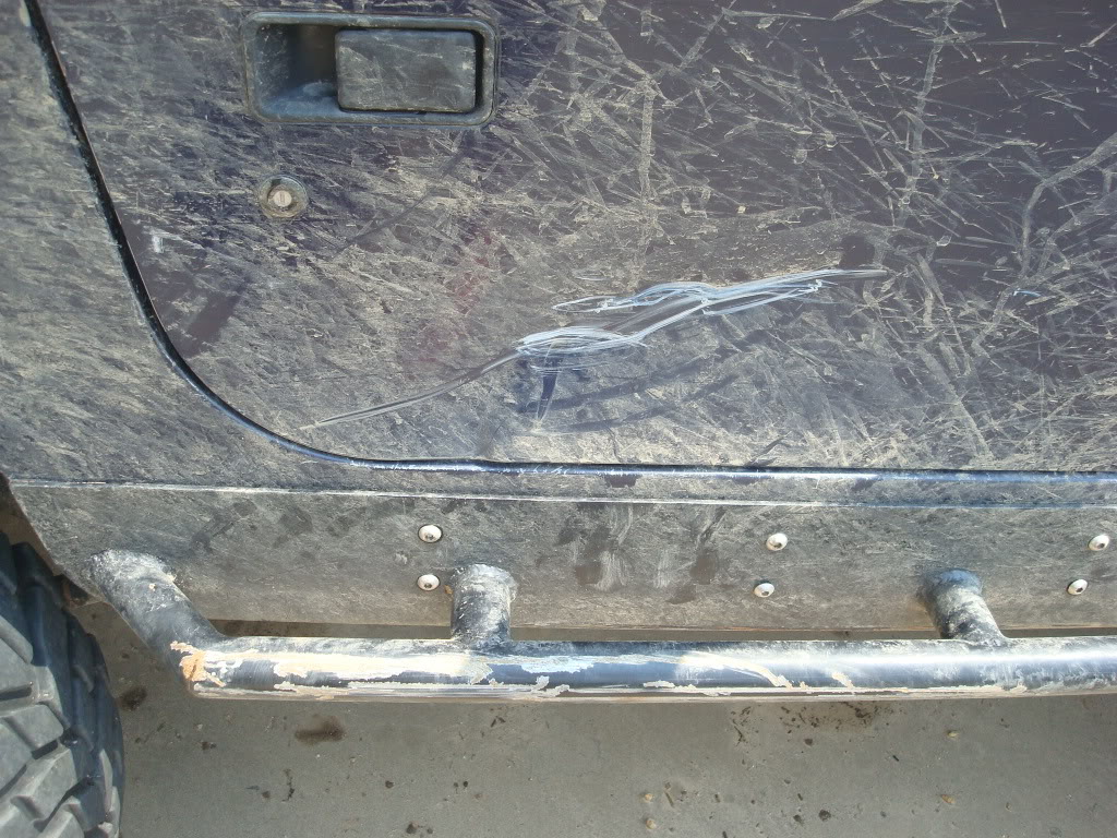

The jeep did everything I tried with it, So I couldn't ask for anything else. I came real close to floping it on "Little Telico", well I got it over enough to hit the door, and add a few more scars to the sliders.

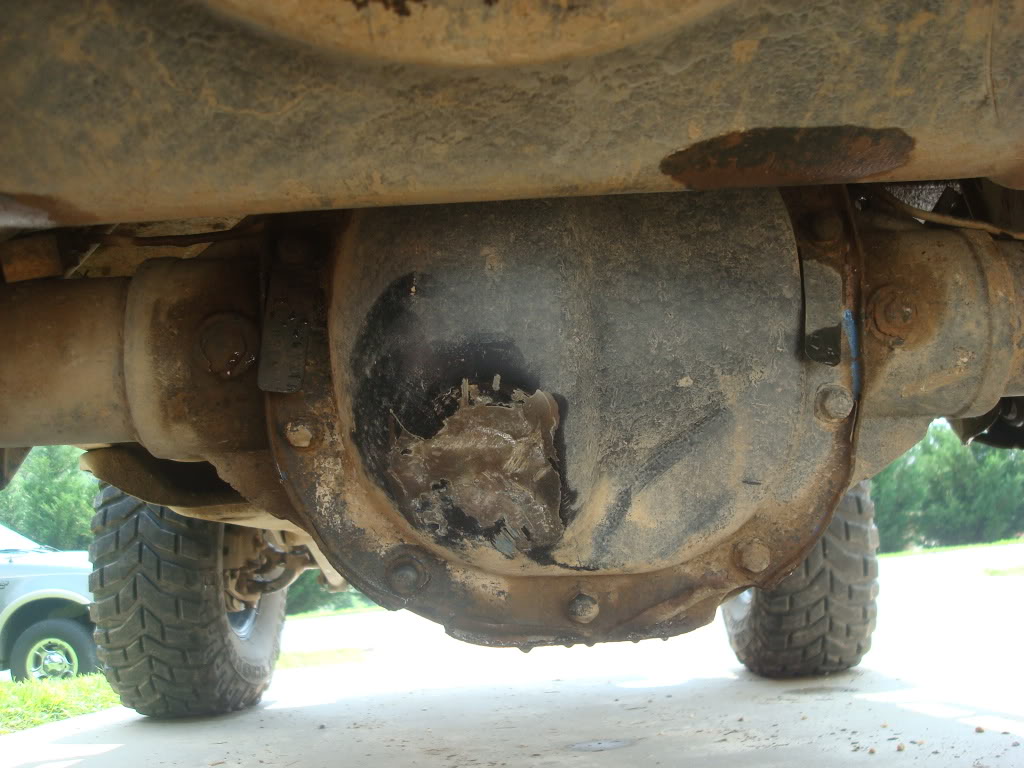

At some point I managed to dent the shit out of my 8.8 diff cover, Time to Call Mud and get a 3/8s one :D
All in all the jeep was great all day, The Family and I had a blast, Can't wait till next time.
