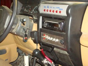

Reworked the dash again, Just tried to make simpler, The wife even helped :flipoff2:

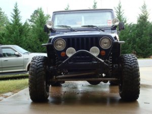

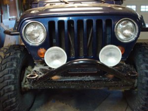

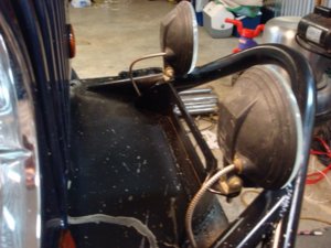

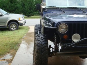

Ever since I made the front bumper she has been on me about adding the lights back, I didn't want to crowd it with to many lights, But I think it turned out ok, I just welded a small tab I got from Mud Pro to the winch fair lead. Worked out great.

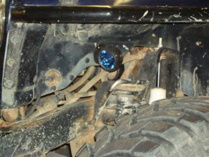

Added a couple cheapo lights in the wheel well to spot in front of the tires in hopes to add a wider light pattern at night.

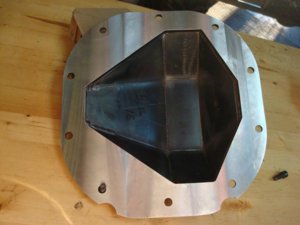

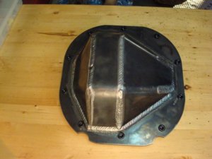

Mud Pro 8.8 Cover Prototype
Here is what Mud has come up with so far on the diff cover, This a prototype that is mocked up in sheet metal, the finale piece will be out of 3/8 material.
Talking with Mud, I don't believe it needs a fill plug in the cover since the 8.8 has a fill plug in the housing. What do you guys think, does it need a fill plug?

it would be nice to have a little higher fill plug especially if youre pinion is high
The 8.8 has a fill plug that is located just above the rib on the pinion side of the housing so its already really high. If you adjust the pinion up it only gets higher.
You can see it here
I feel that if your filling the diff on that side its actually possible to over fill if it tilted to a high degree.

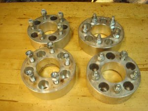

Also I picked up some 2'' wheel spacers to solve a frame, link, coil bucket, steering box rubbing issue I have.
Mud has finished the prototype for the 8.8 diff cover, time for some testing :D, I will post some pictures as soon as I get time to put it on. It looks great and weighs 13 pounds. Once the bugs are worked out it will be offered on his site.

Wheel Spacers I picked up off the site, form marvilusone, Thanks again they are just what I was wanting.

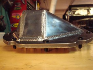

Here are the pictures of the 8.8 Diff Cover from Mud Pro, There not listed for sale yet, I have to finish testing it first :D

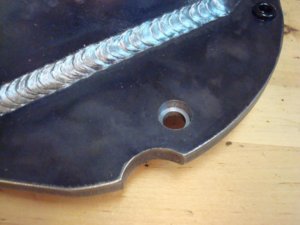

Cover is 3/8 material, PreWelded, and Air Pressure tested for leaks. Hardware is 5/16 - 18 pitch 3/4 in lenght, The holes are counter sunk to help protect the hardware. The mounting surface is machined, but I didn't feel it was needed, but he wanted to see how it would turn out. I compared three non-machined to a this one on a housing and you cant tell the difference, there is less than a 16th of a gap at any point and it pulled tight with no RTV. I am very impressed with his work.
Next thing is to paint it, I will update at that point.

You can't beat his 60 cover for $80, he is local and you can pick it up, I have seen it in person it is beefier than this one.
