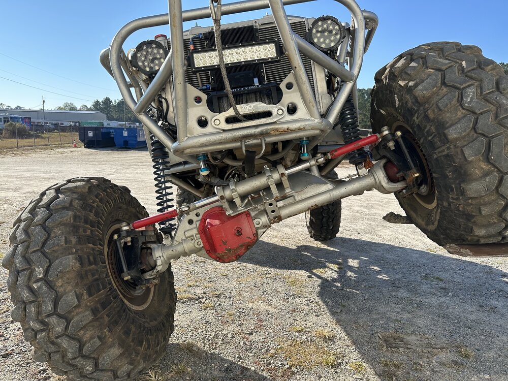

I took the buggy out today for the first time. Just me and my boy. I didn’t take a single picture, oops.

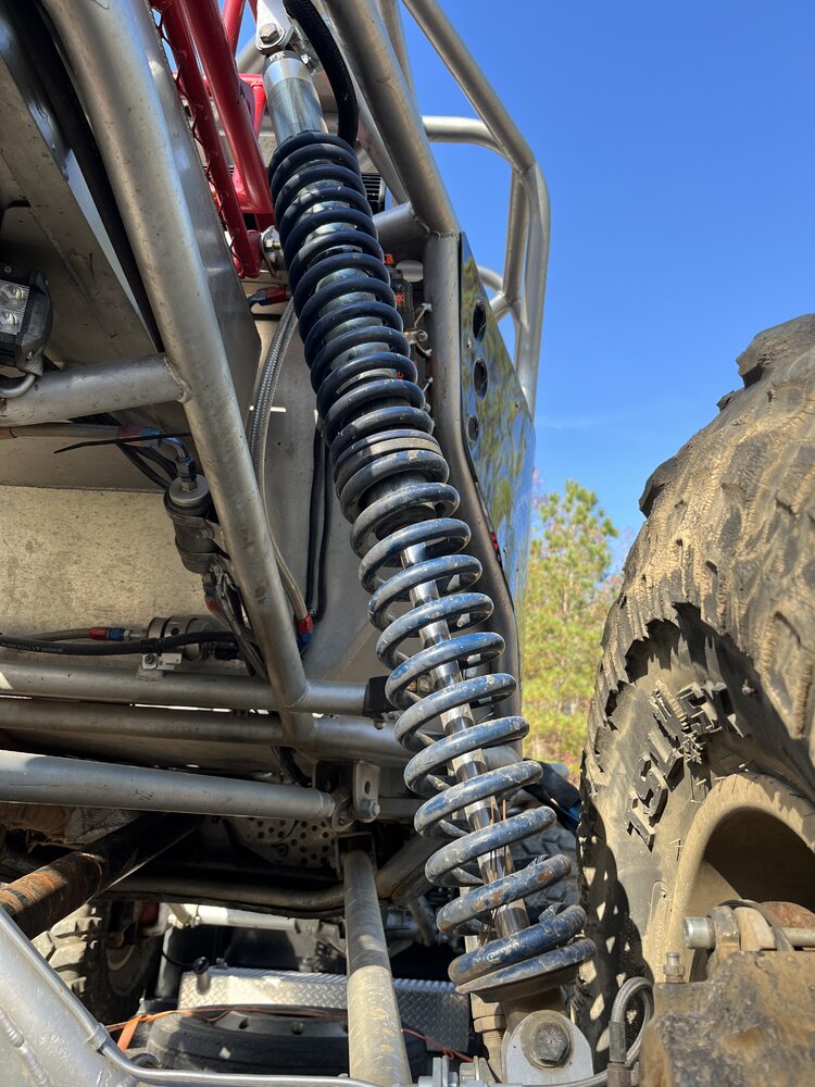

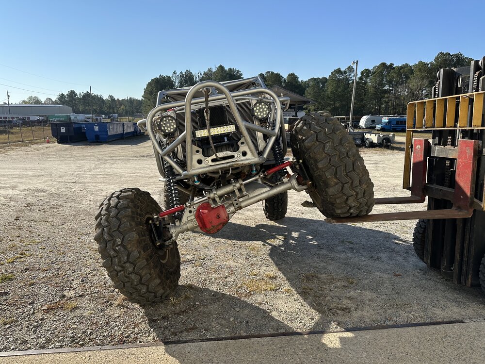

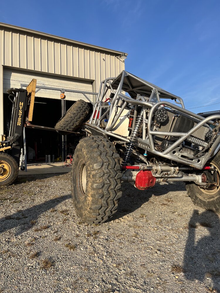

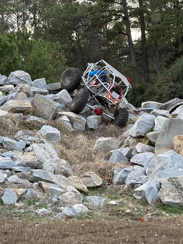

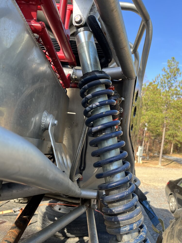

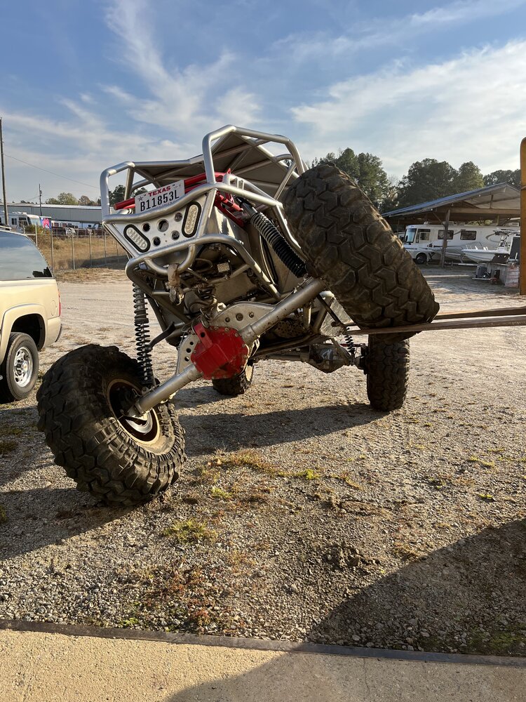

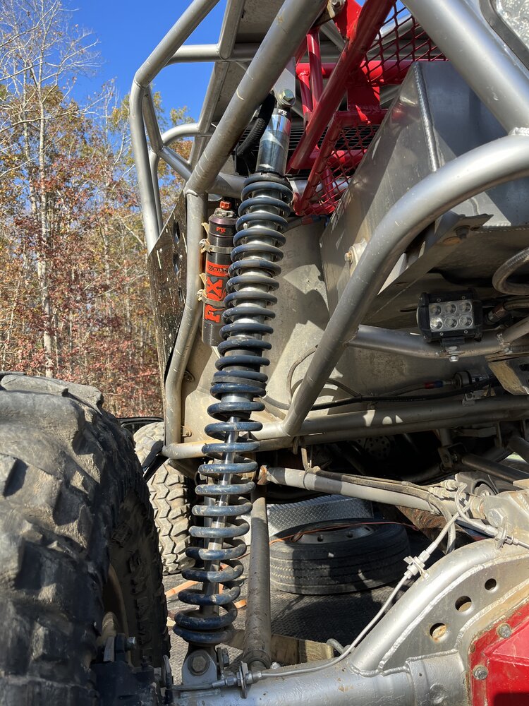

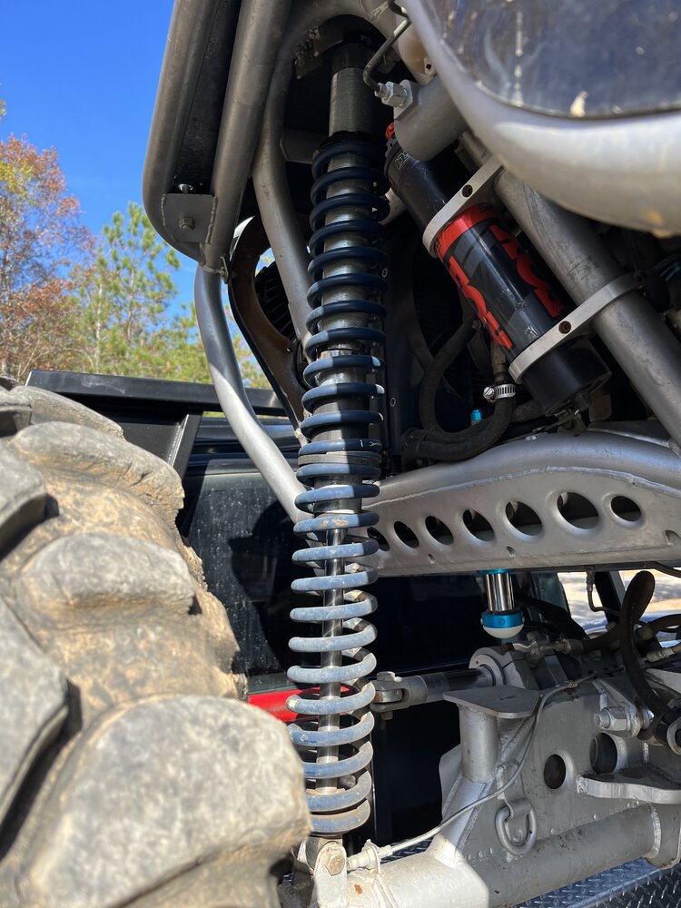

So the buggy done good, no leaks and all temps look good. I’m happy with the gearing options as well. It rides pretty good, however the lack of down travel is a problem. I really need it lowered a bit to try and get more travel. I pulled the front driver tire on a rock and I can’t go very far without it pulling the driver rear, and the lack of down travel makes it feel pretty tippy.

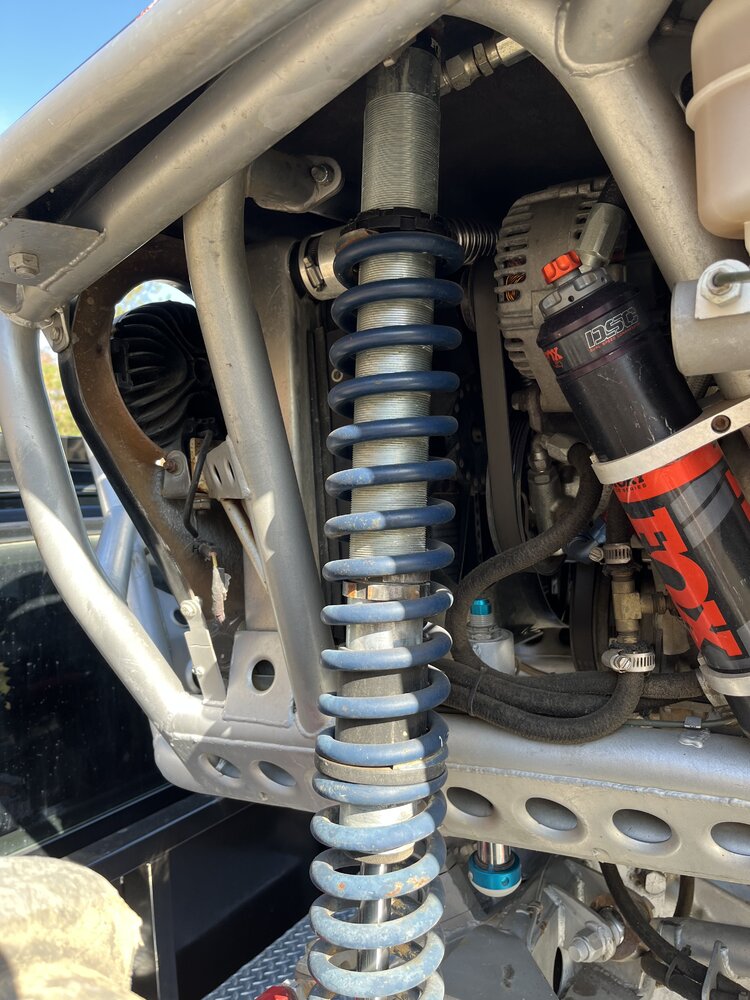

I know the basics of messing with the coilovers but not confident enough to mess with it myself. And living in a camper I obviously lack a cherry picker the the needed things to mess with it.
If there is someone semi close to me that can take the time to look into this I’ll pay for your time. A good start would be making sure the springs on it are correct for the weight and stuff, and simply adjusting the pre load on them. I need to try and make these adjustments this month, so if you know your way around coilovers and have some known spring rates and can help let me know.
