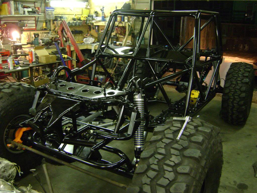

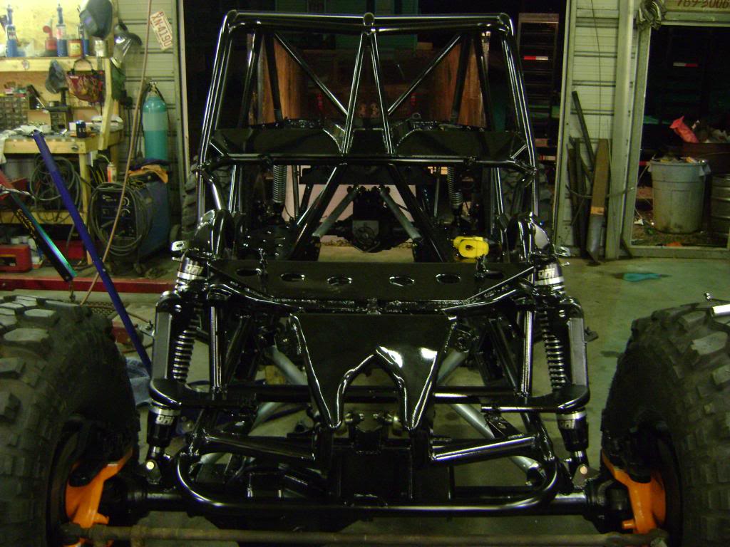

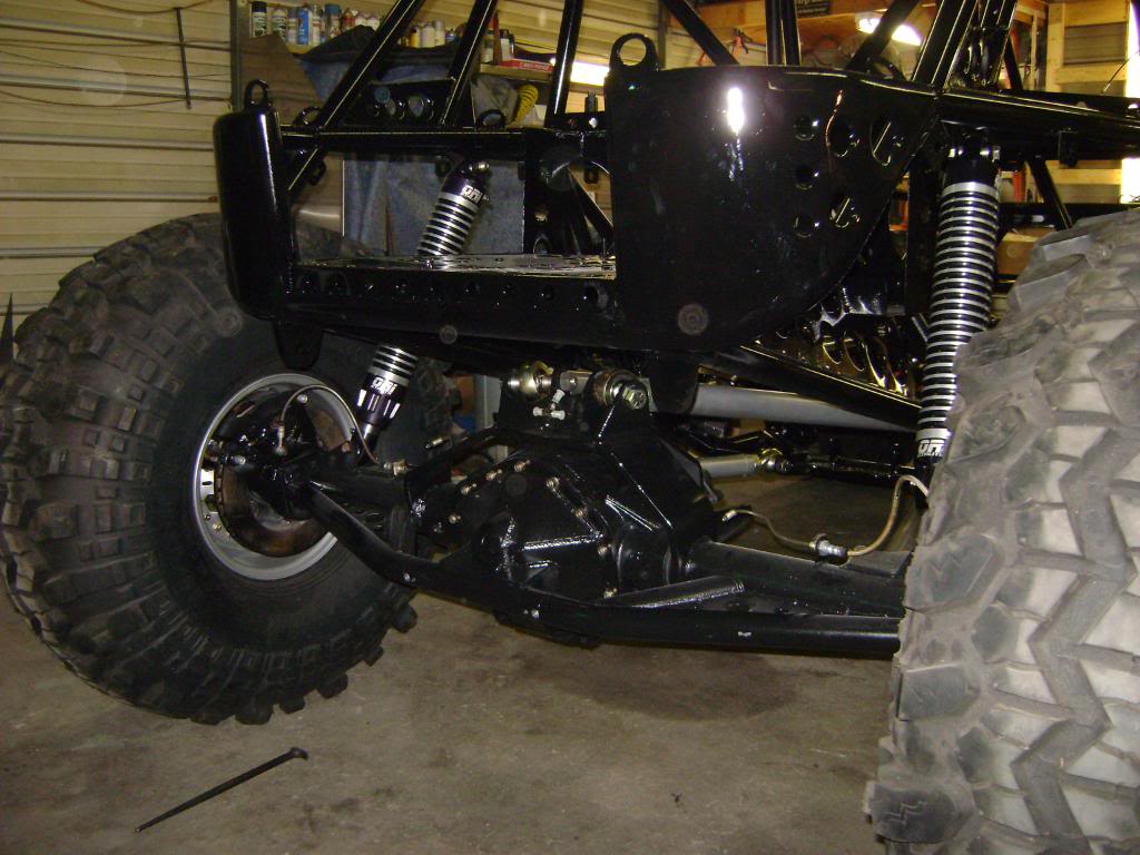

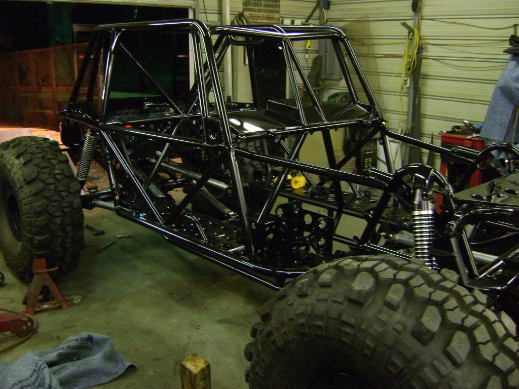

ai1222.photobucket.com_albums_dd489_mcutler1_copper_20crawler_20buggy_paintedchassis_axles032.jpg

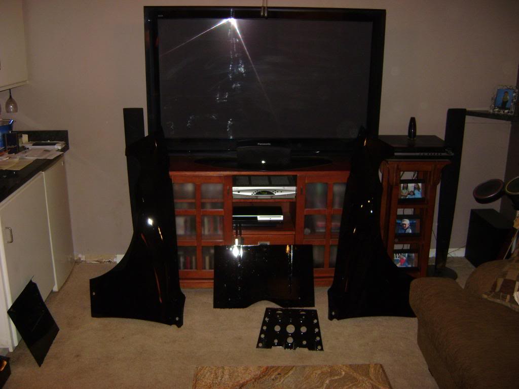

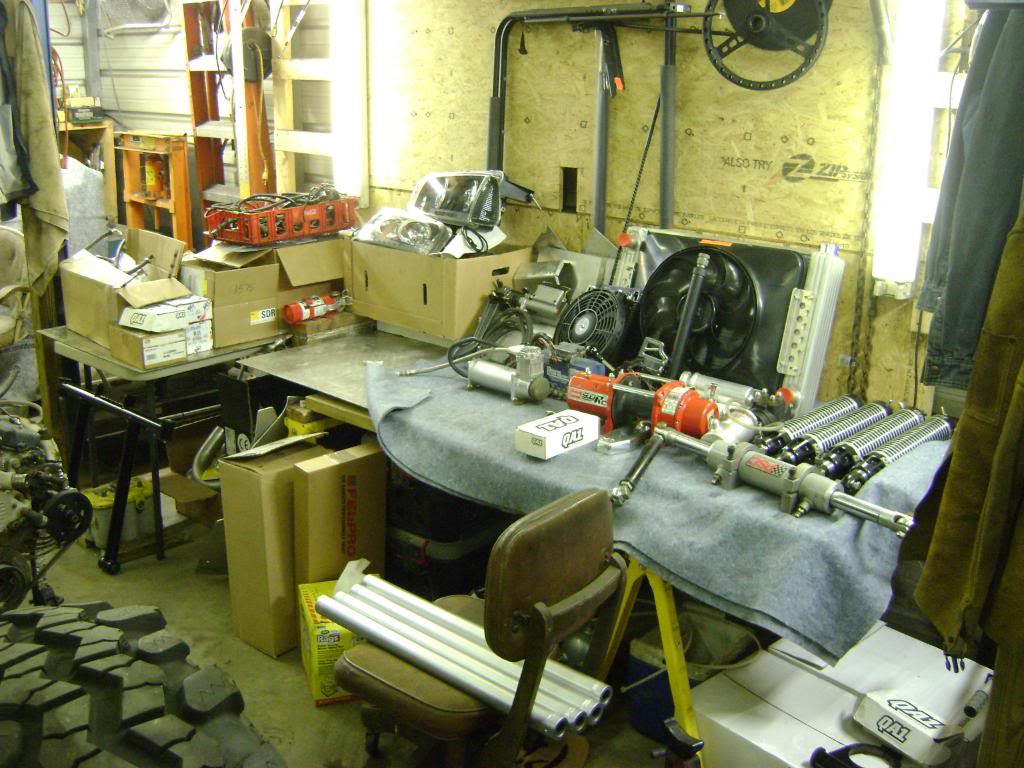

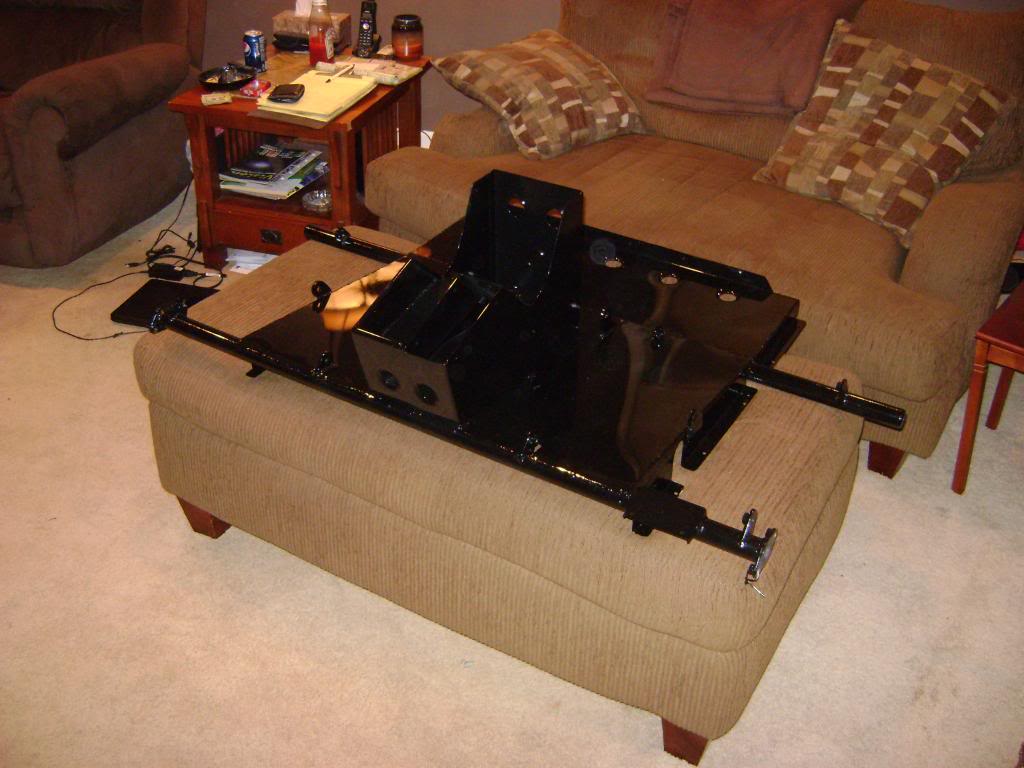

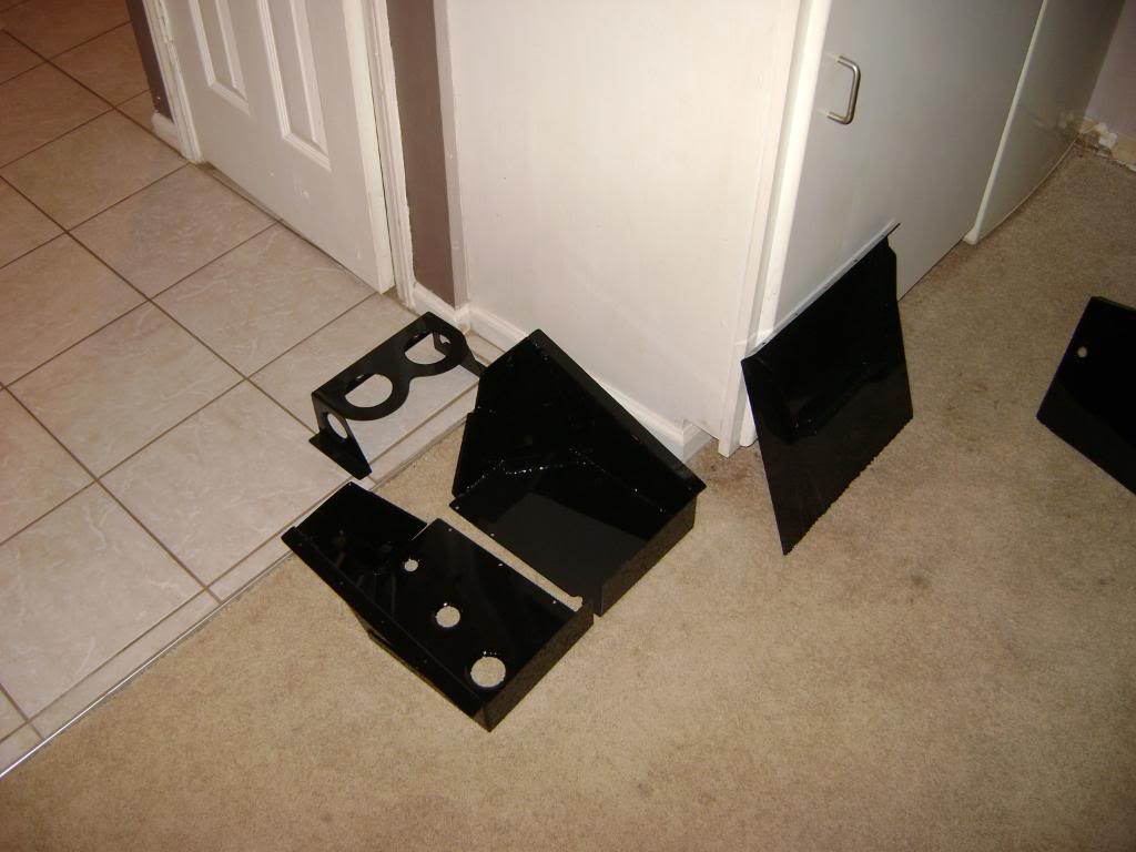

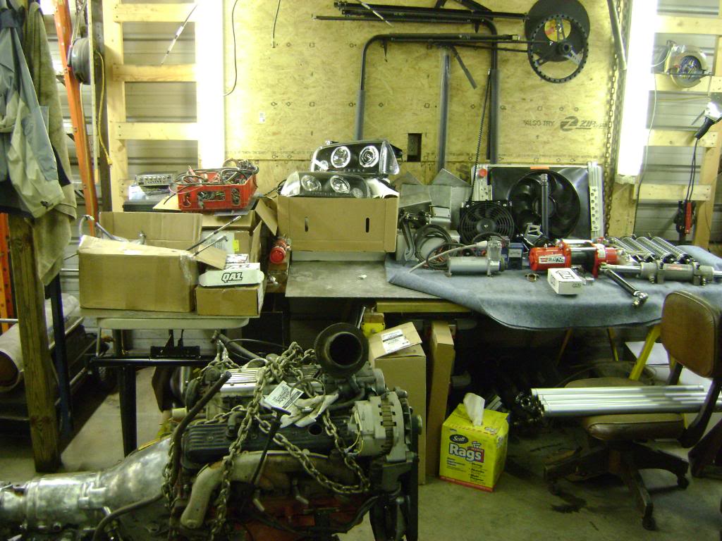

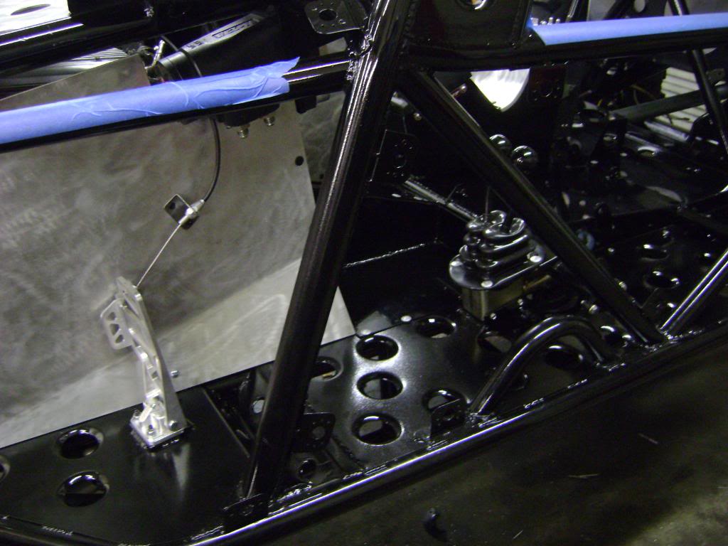

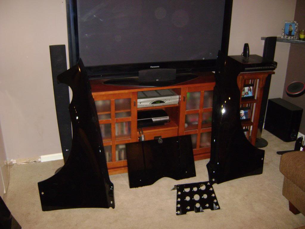

parked all the small painted parts in my living room til time for placement, as you saw, my shop is full

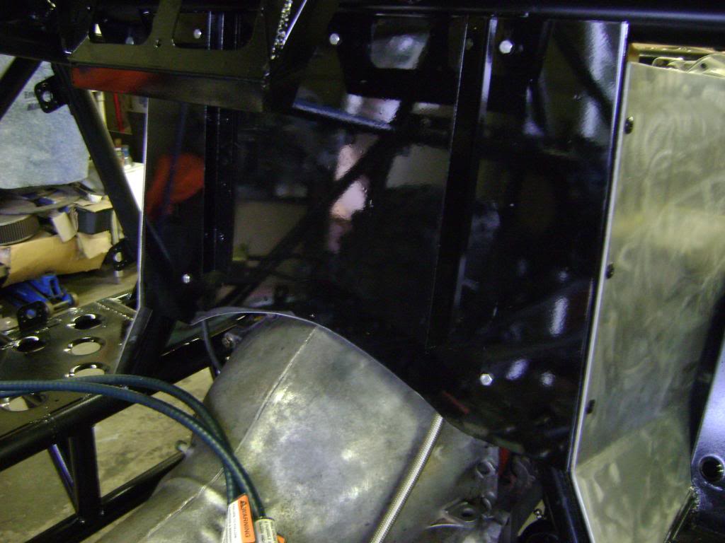

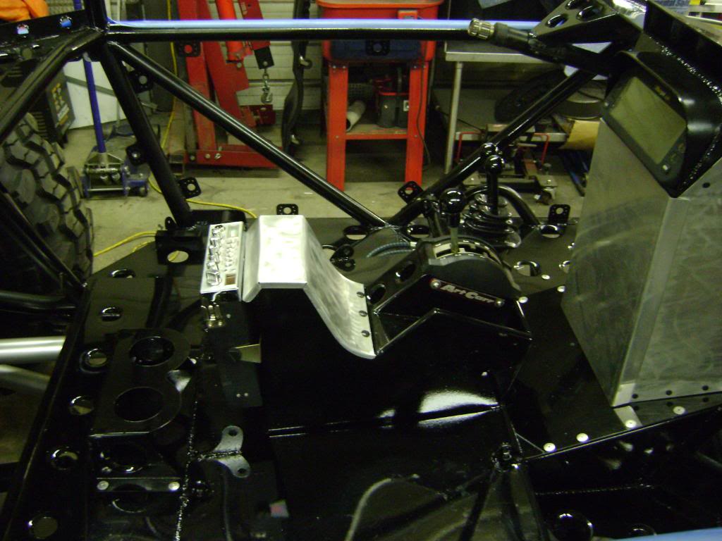

floor pan/seat mounts
ai1222.photobucket.com_albums_dd489_mcutler1_copper_20crawler_20buggy_paintedchassis_axles033.jpg

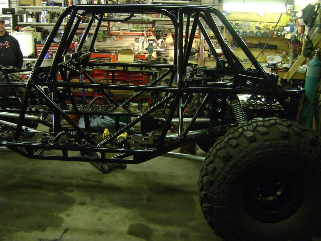

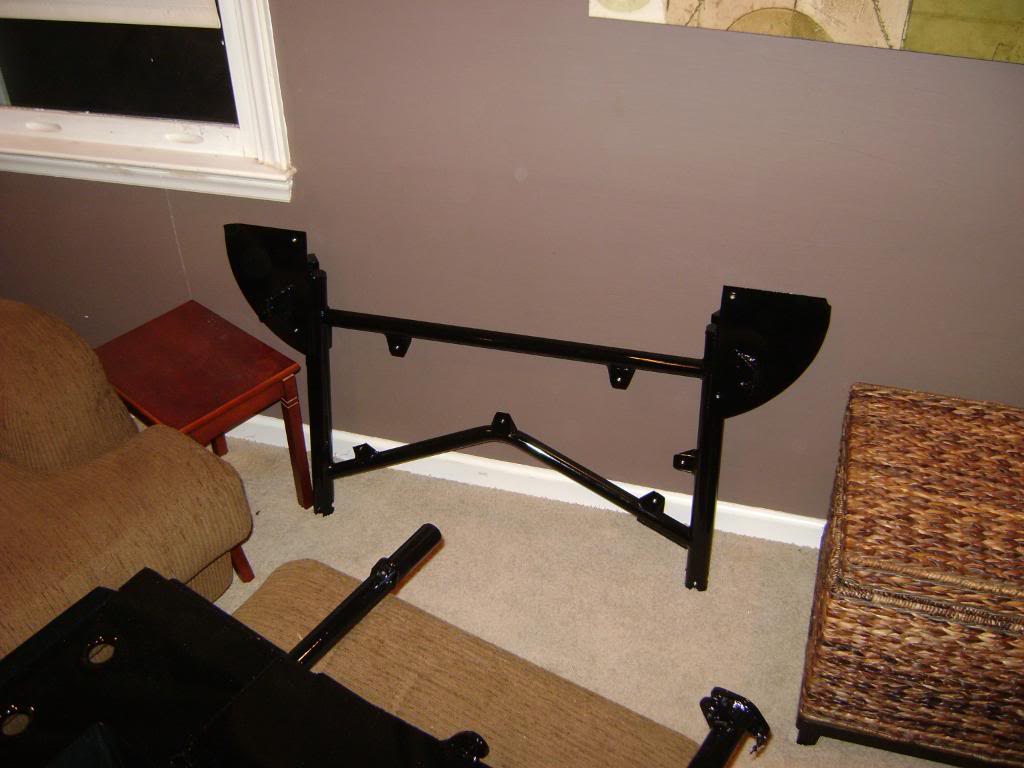

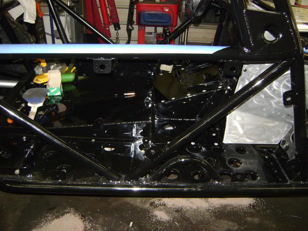

engine cage
ai1222.photobucket.com_albums_dd489_mcutler1_copper_20crawler_20buggy_paintedchassis_axles034.jpg

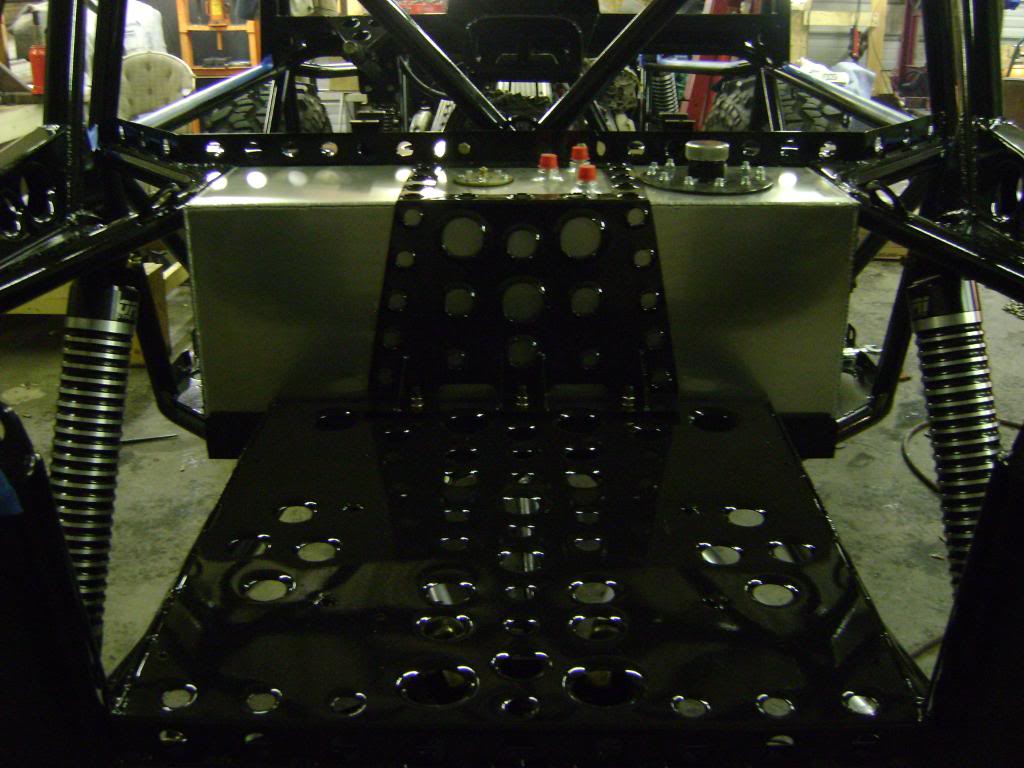

floor pans and cupholder
ai1222.photobucket.com_albums_dd489_mcutler1_copper_20crawler_20buggy_paintedchassis_axles035.jpg

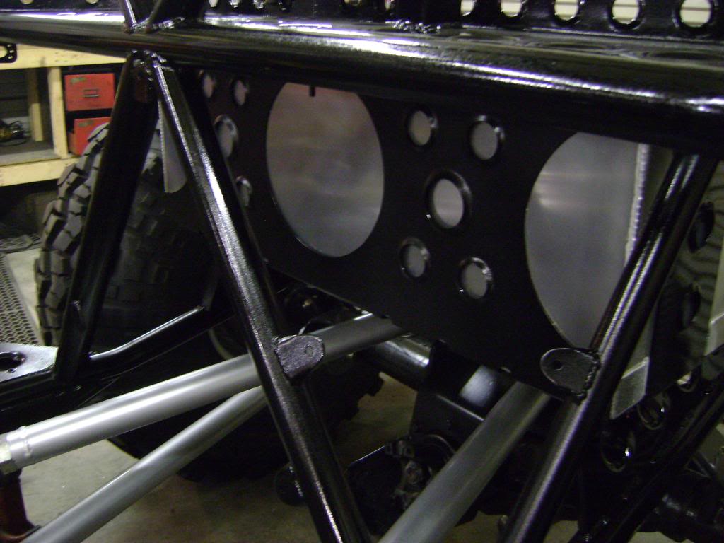

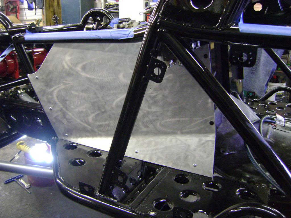

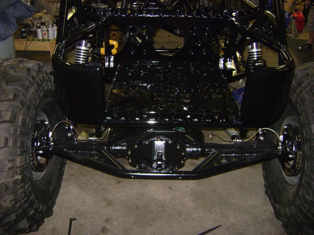

fenders, firewall, and fuel cell strap
ai1222.photobucket.com_albums_dd489_mcutler1_copper_20crawler_20buggy_paintedchassis_axles036.jpg
ai1222.photobucket.com_albums_dd489_mcutler1_copper_20crawler_20buggy_paintedchassis_axles037.jpg
the hood, cowl, and headlight surrounds will be done thursday

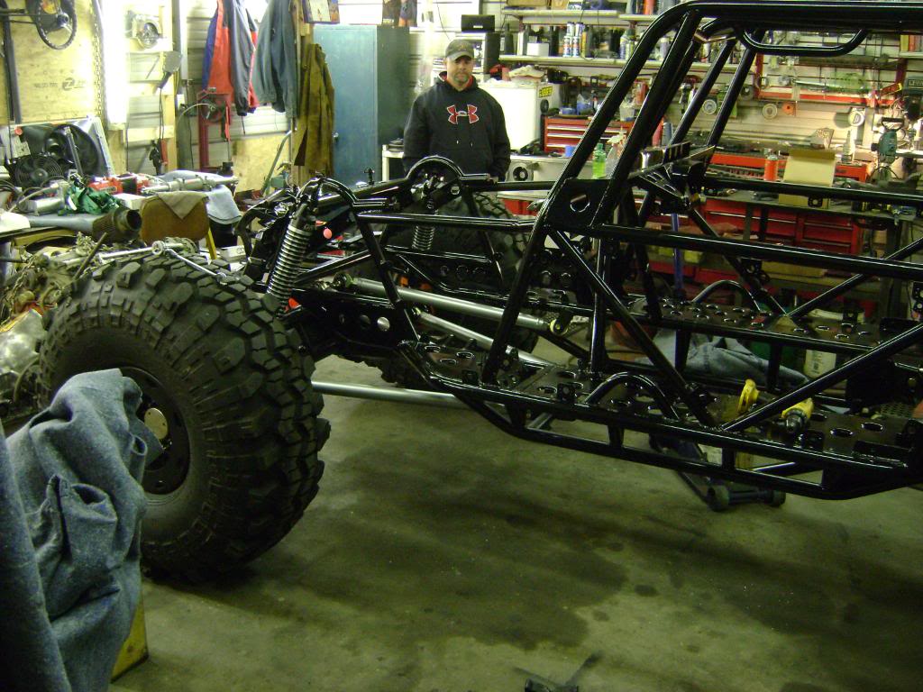

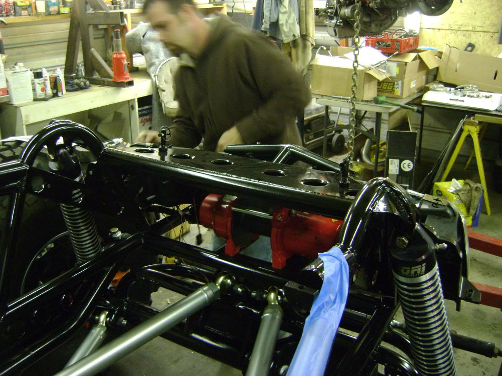

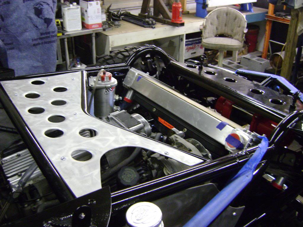

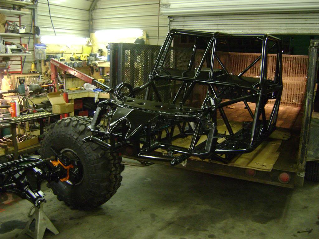

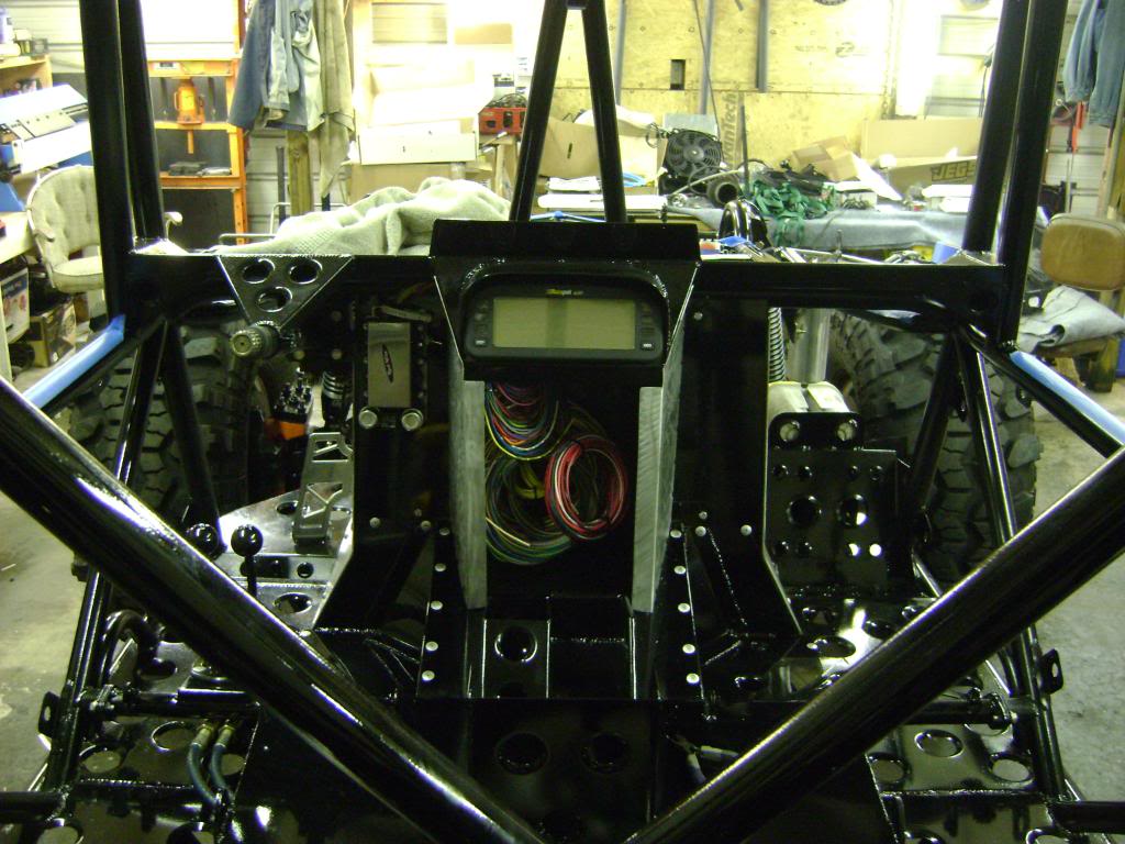

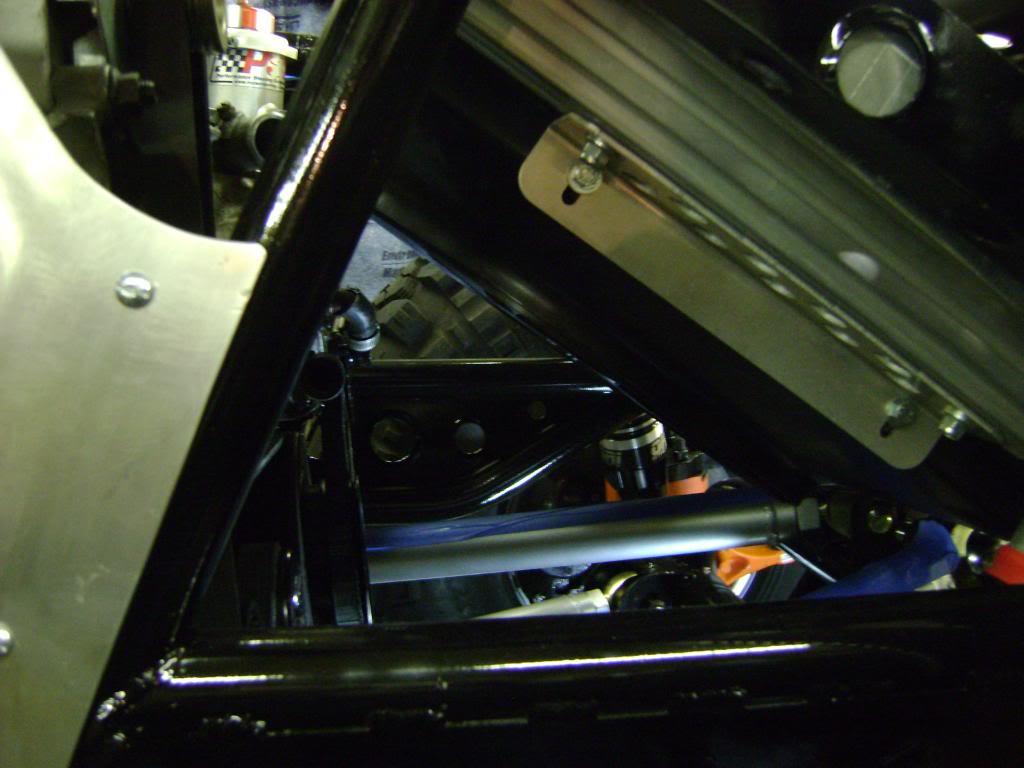

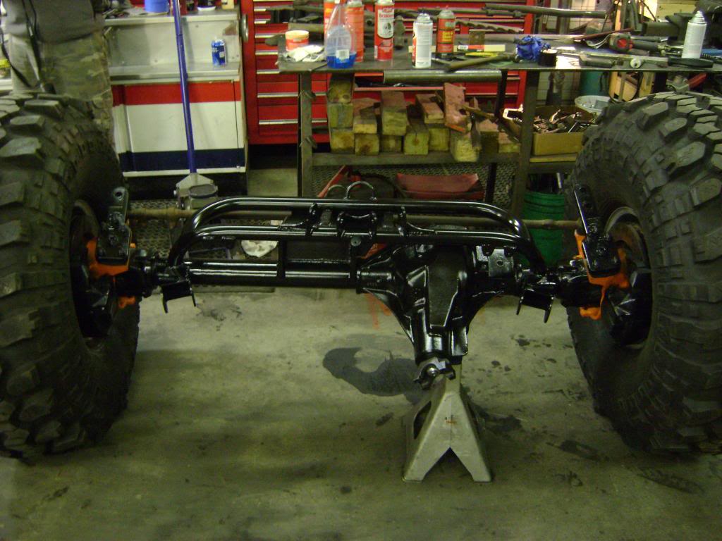

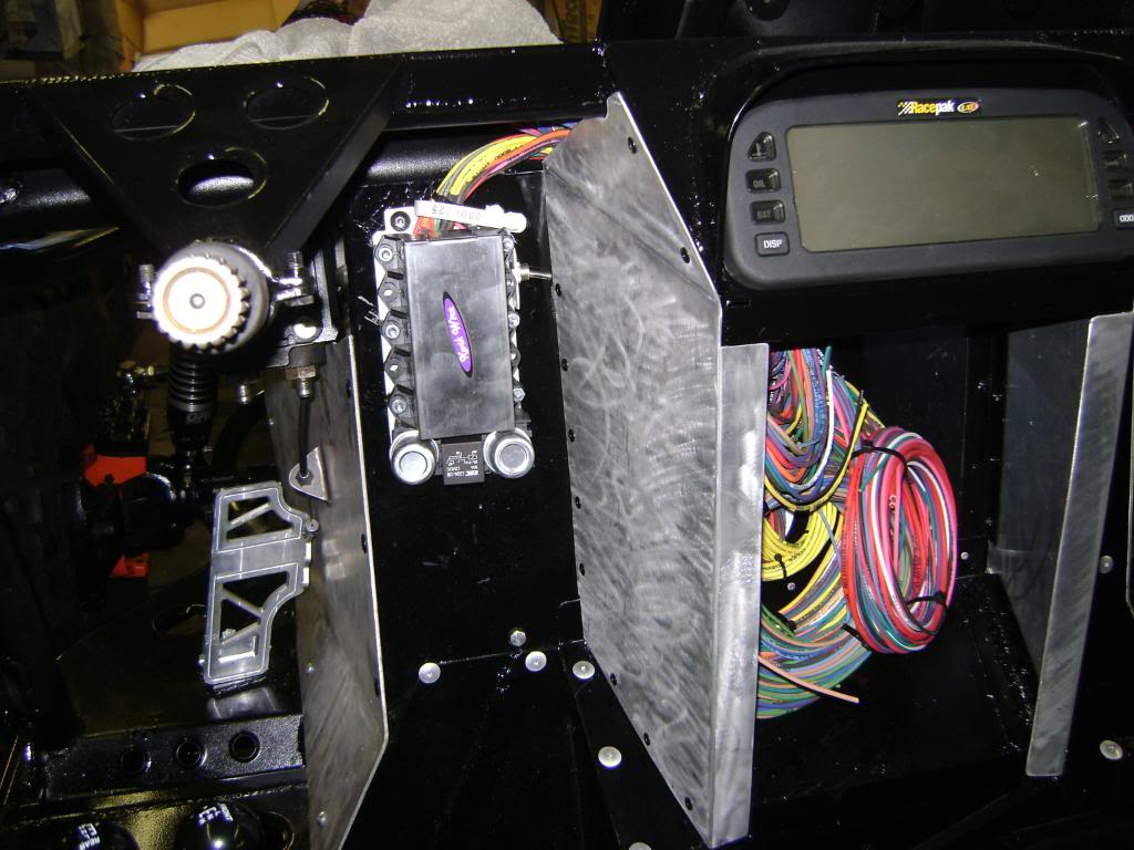

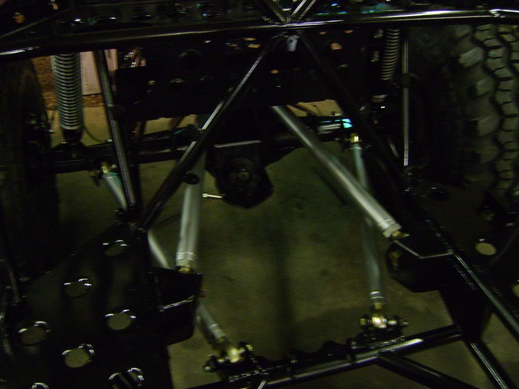

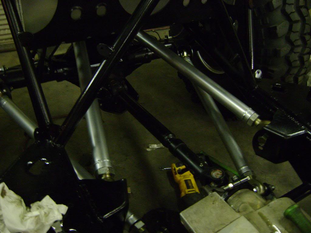

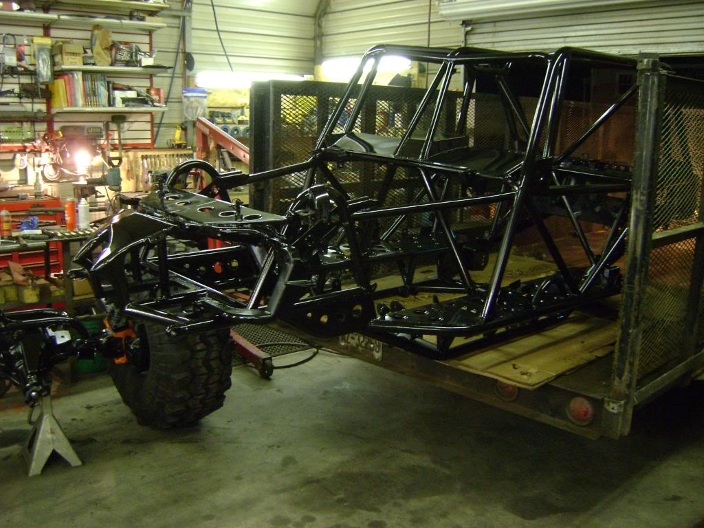

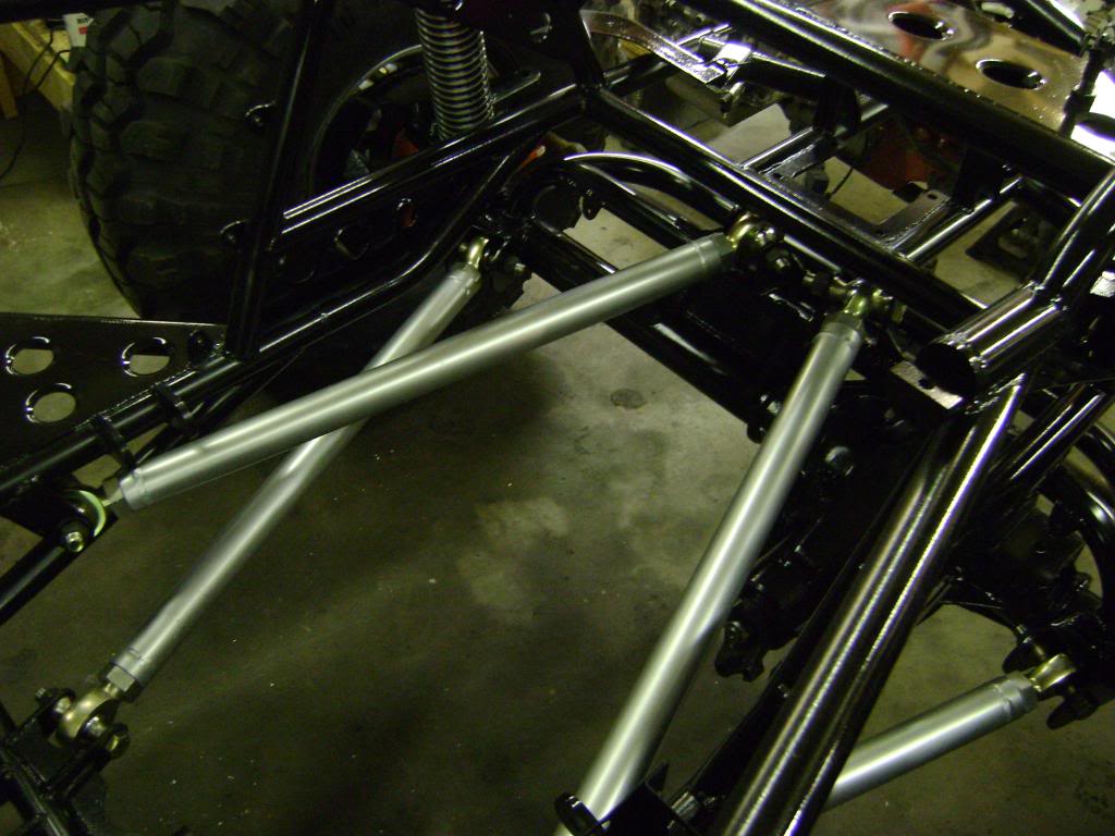

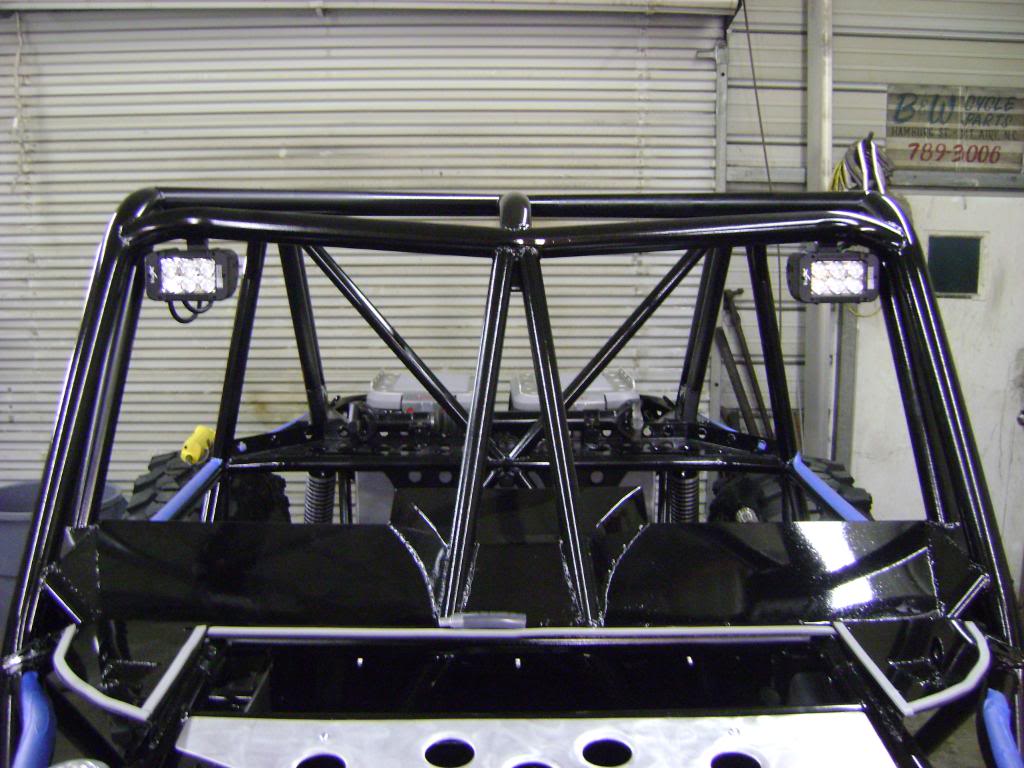

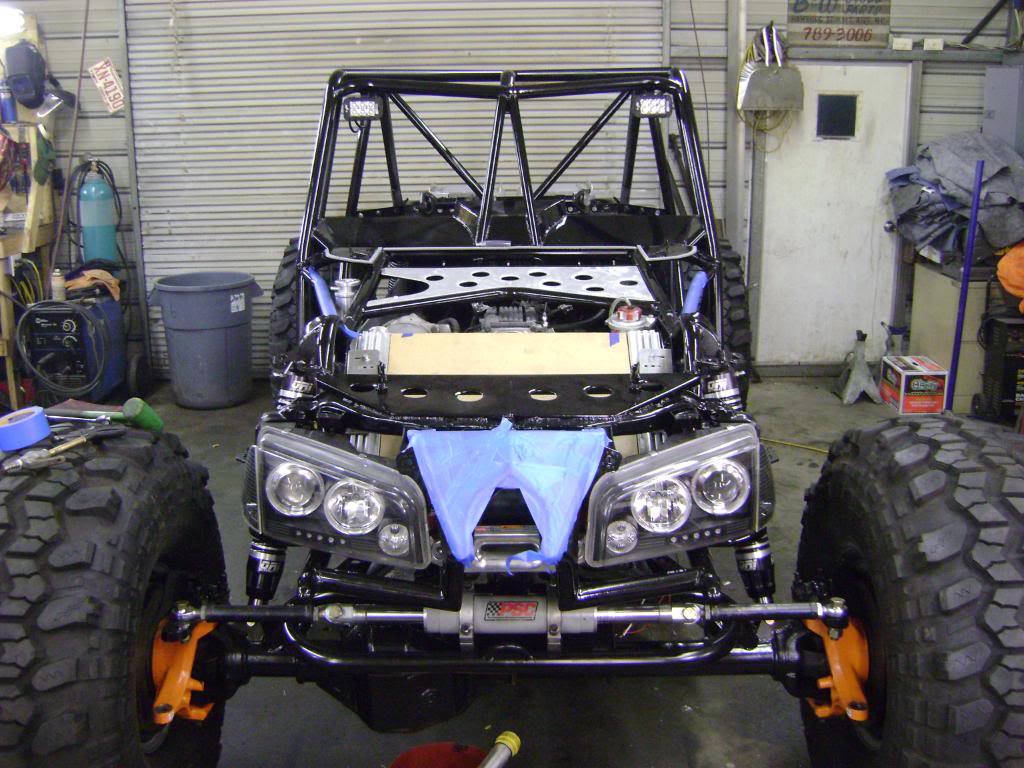

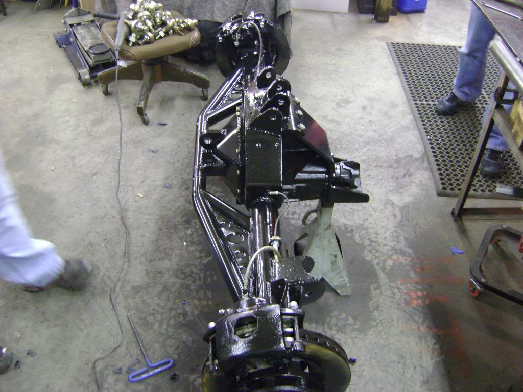

putting her back together!
killed a few hours today at the efird's memorial ride at DPG. jeepn-jason and i stuffed our faces, watched some good wheeling and met some cool peeps. gave me the fever to get er done, so we came home and hammered on it till 1 a.m.

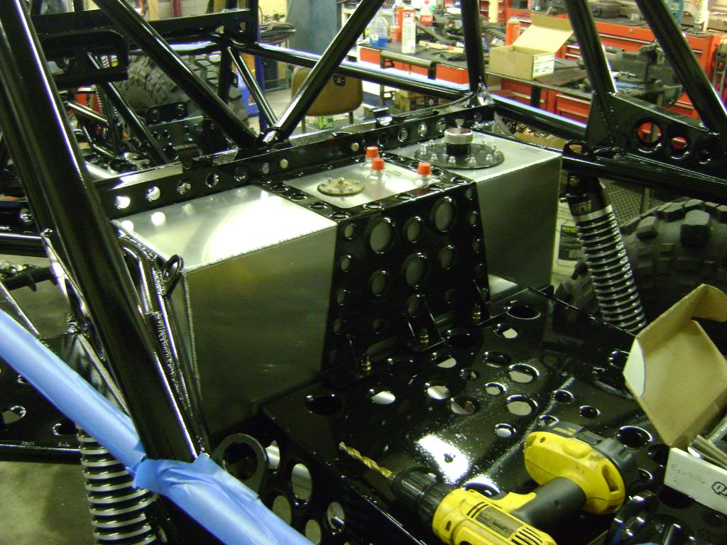

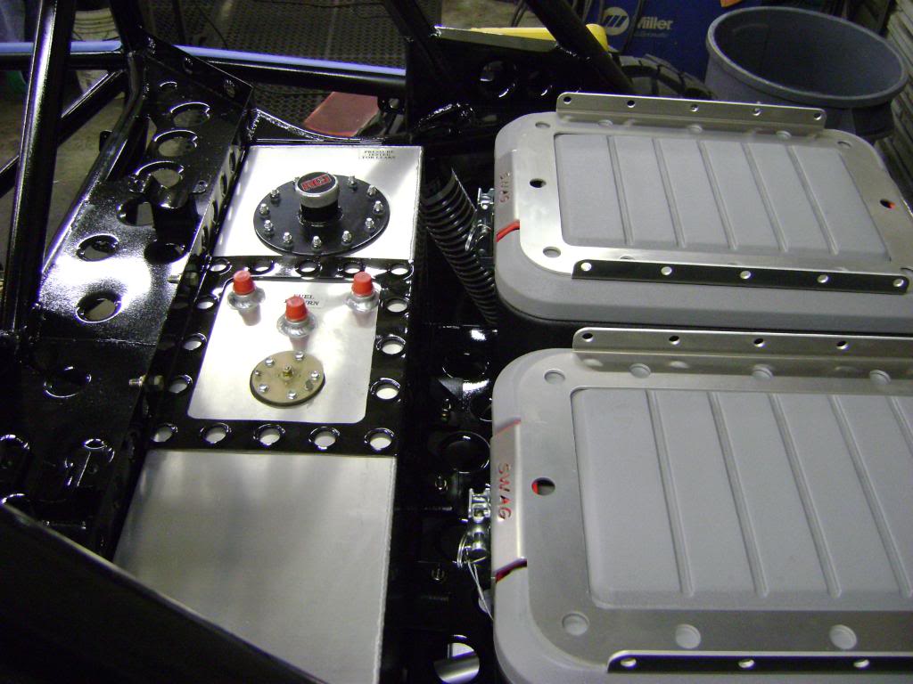

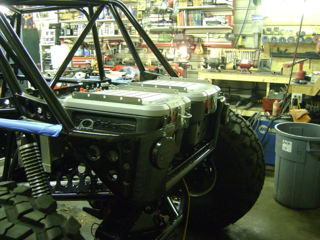

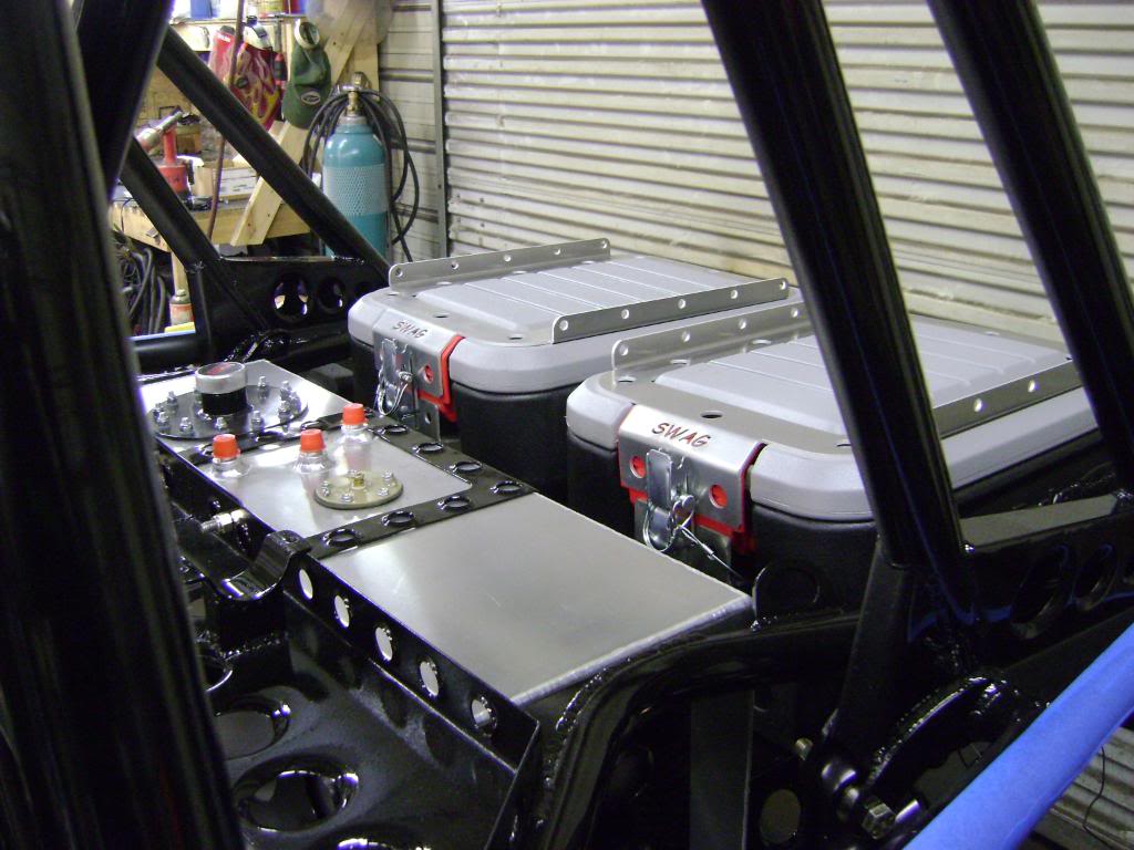

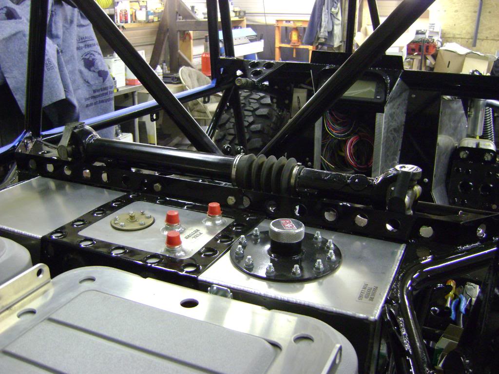

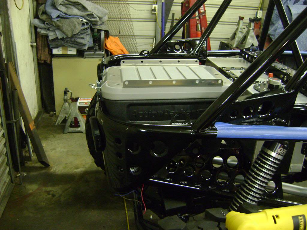

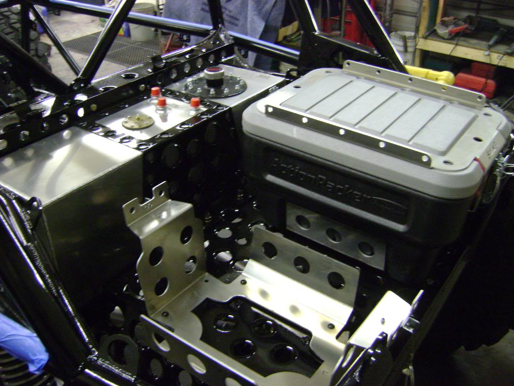

fuel cell in
ai1222.photobucket.com_albums_dd489_mcutler1_copper_20crawler_20buggy_rebuild1010.jpg

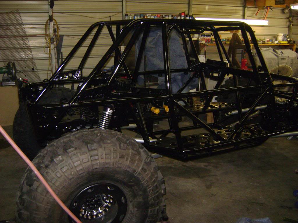

ai1222.photobucket.com_albums_dd489_mcutler1_copper_20crawler_20buggy_rebuild1001.jpg

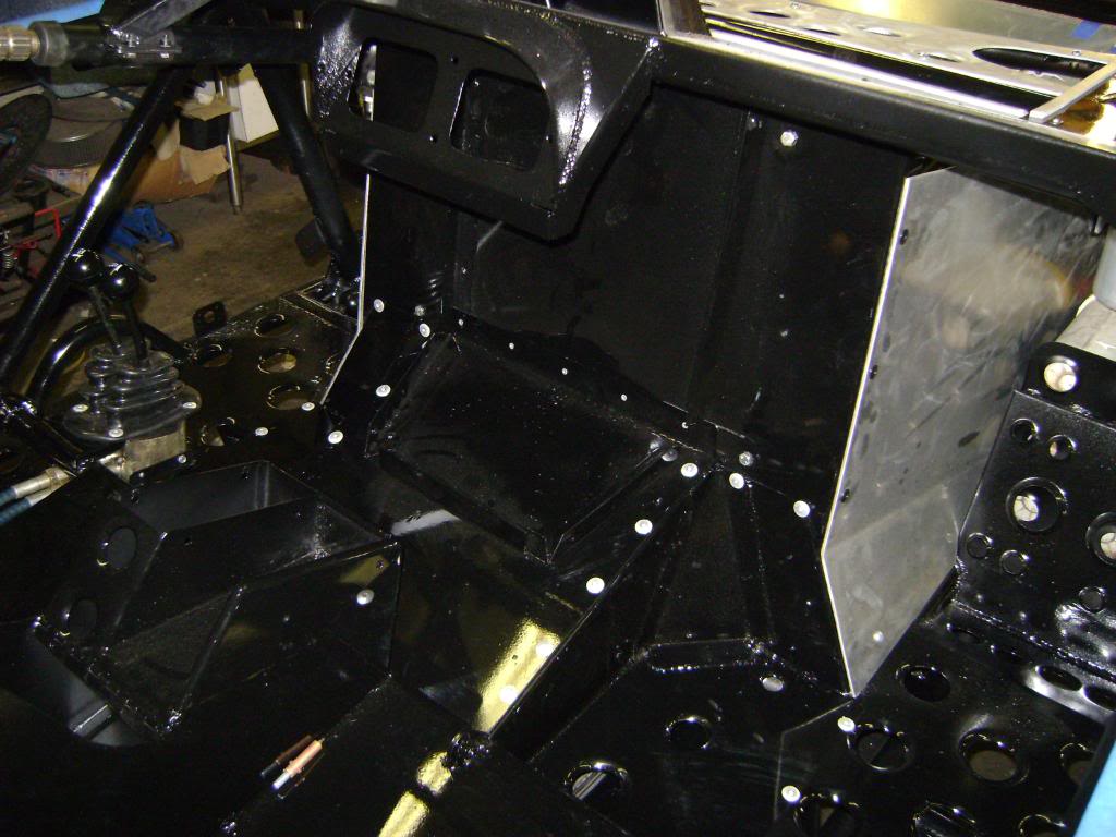

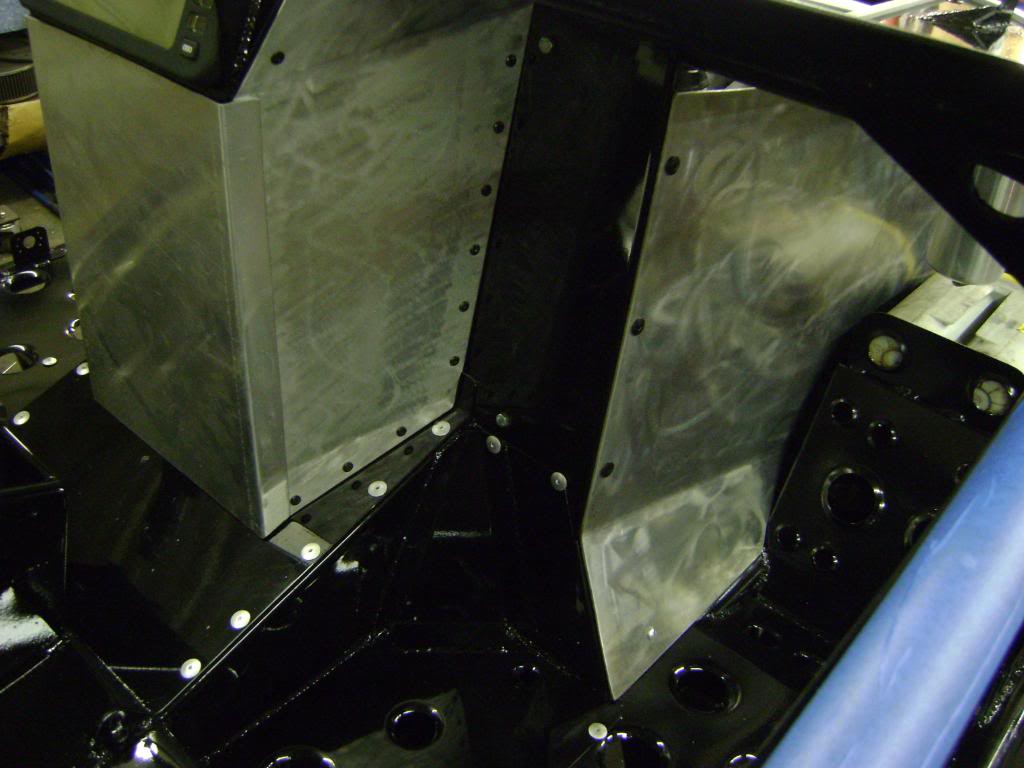

ai1222.photobucket.com_albums_dd489_mcutler1_copper_20crawler_20buggy_rebuild1003.jpg

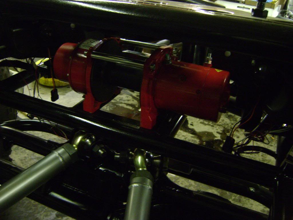

winch back in
ai1222.photobucket.com_albums_dd489_mcutler1_copper_20crawler_20buggy_rebuild1004.jpg

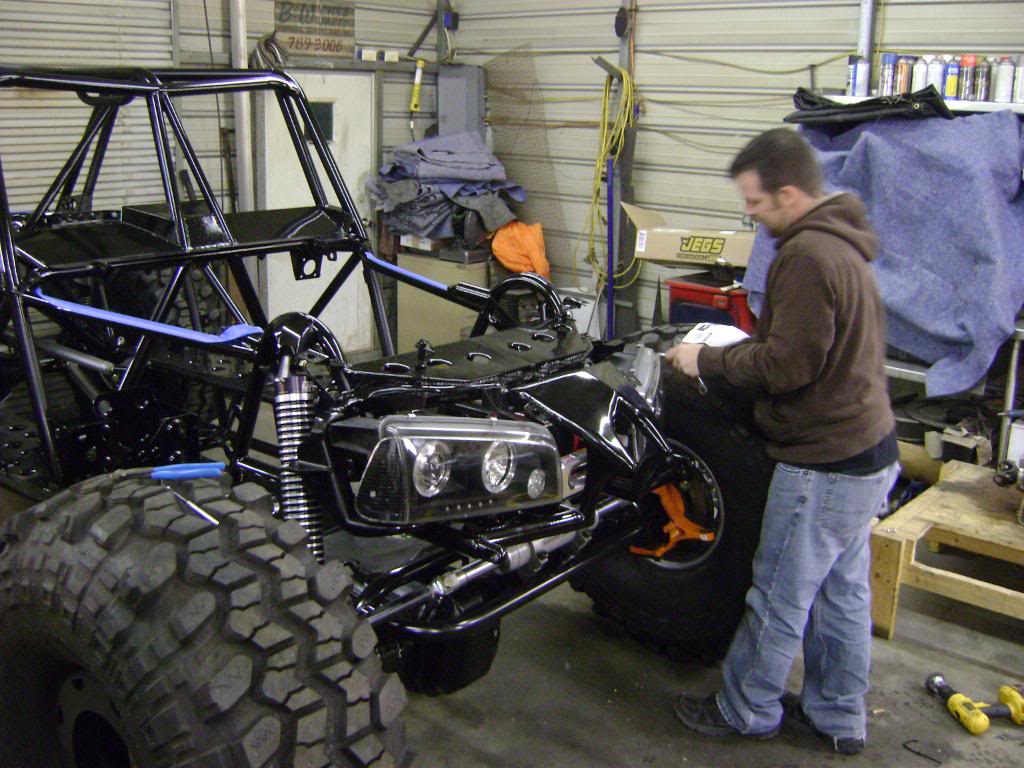

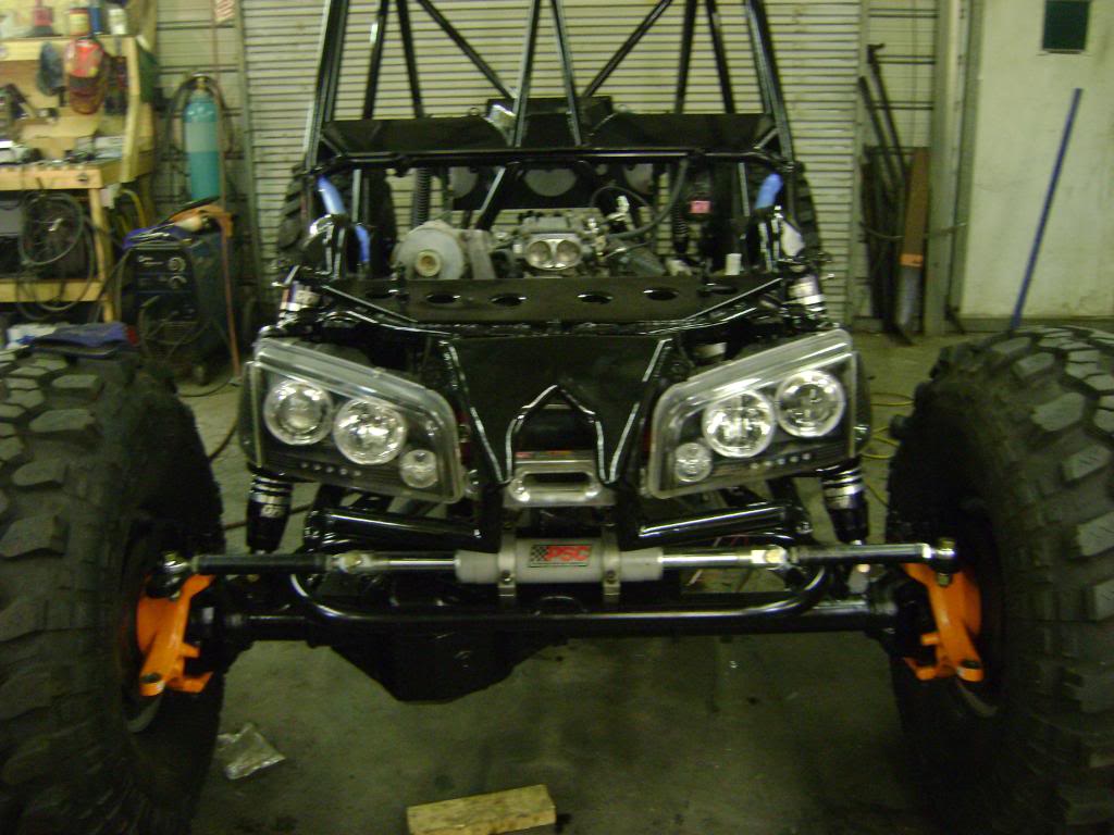

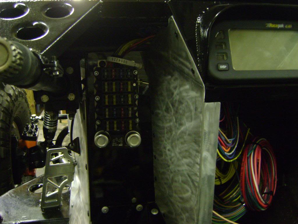

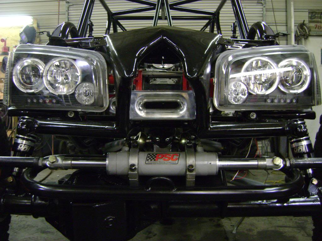

headlights; check
ai1222.photobucket.com_albums_dd489_mcutler1_copper_20crawler_20buggy_rebuild1005.jpg

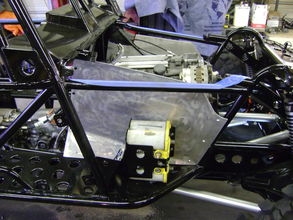

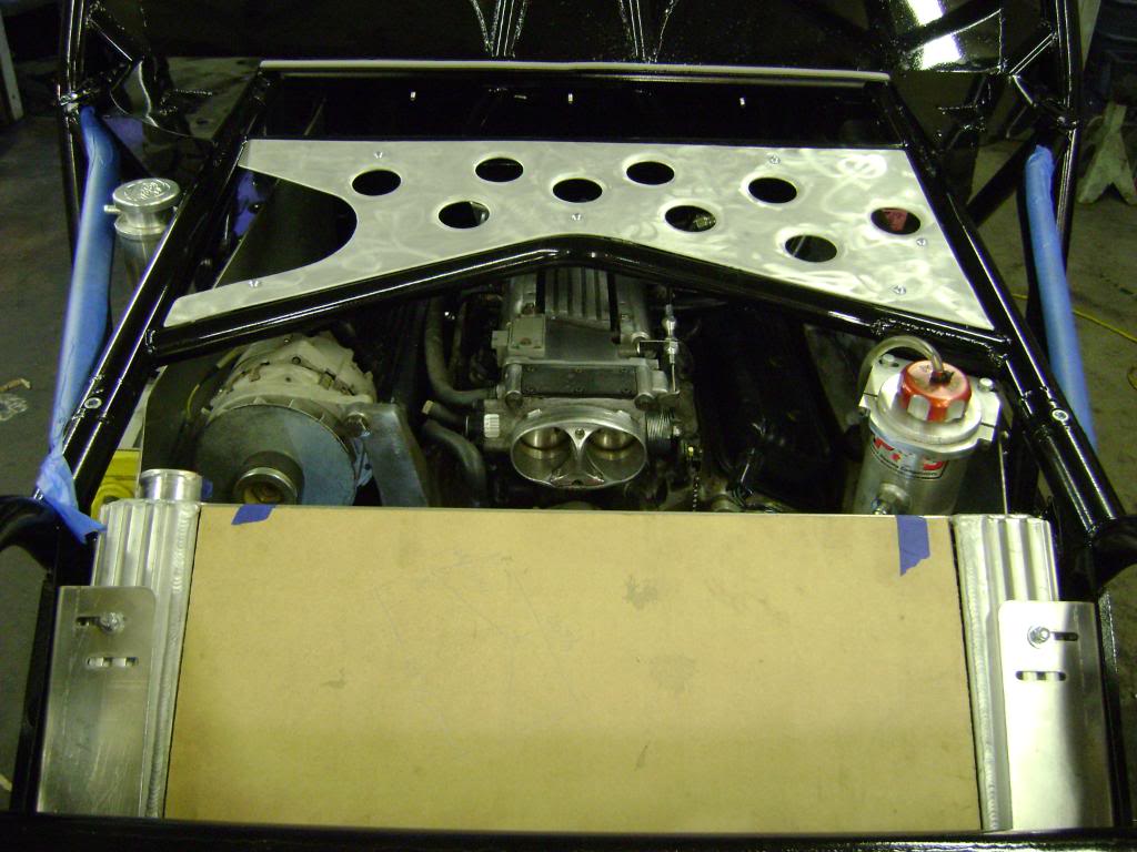

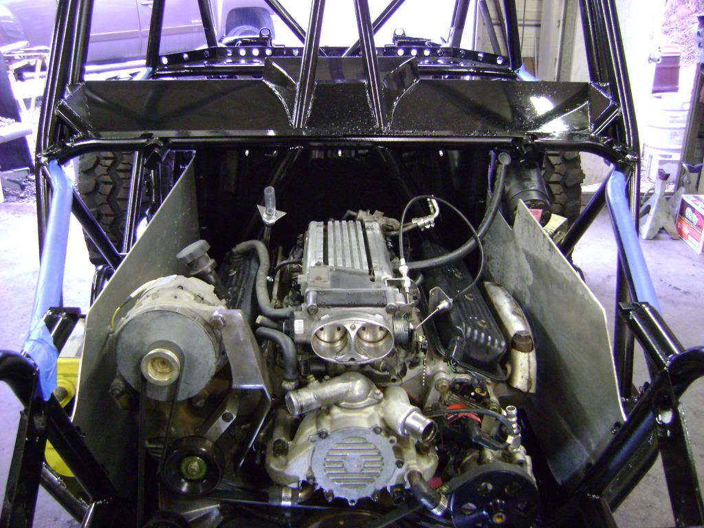

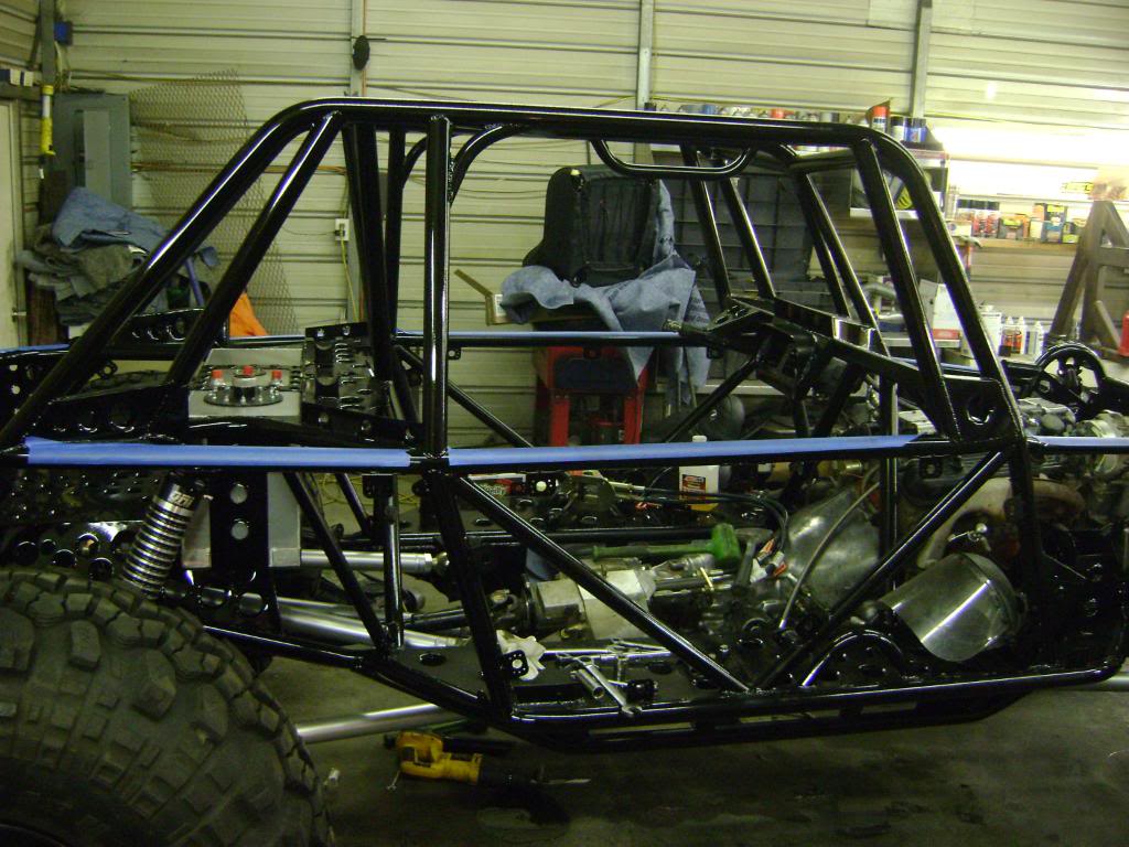

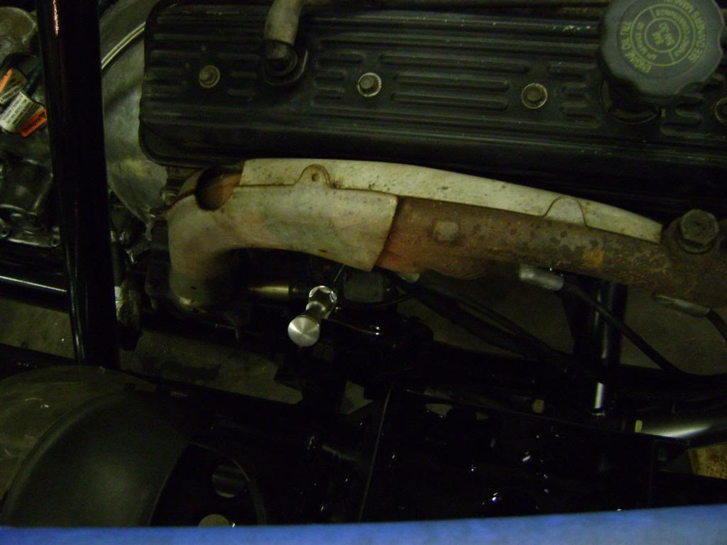

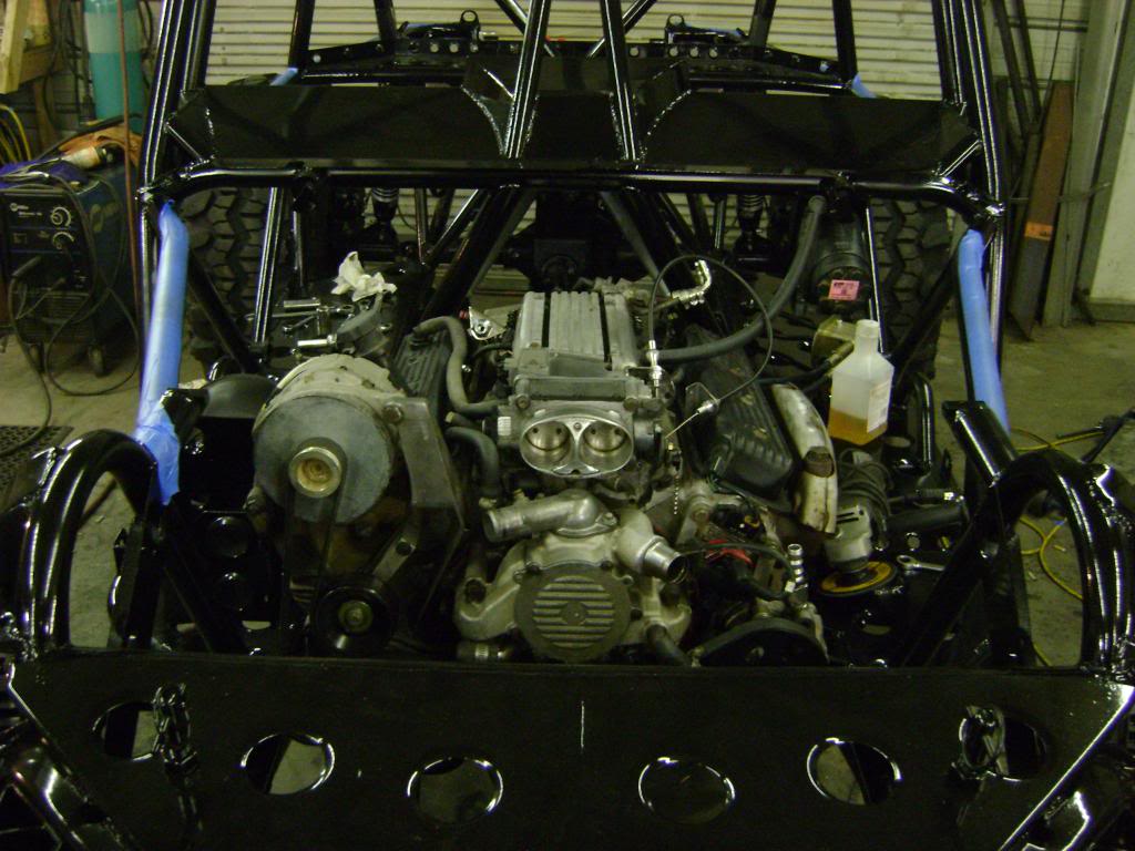

motor in, w/ new oilpan, pump, lokar dipstick
ai1222.photobucket.com_albums_dd489_mcutler1_copper_20crawler_20buggy_rebuild1006.jpg
psc cylinder back in place
ai1222.photobucket.com_albums_dd489_mcutler1_copper_20crawler_20buggy_rebuild1007.jpg

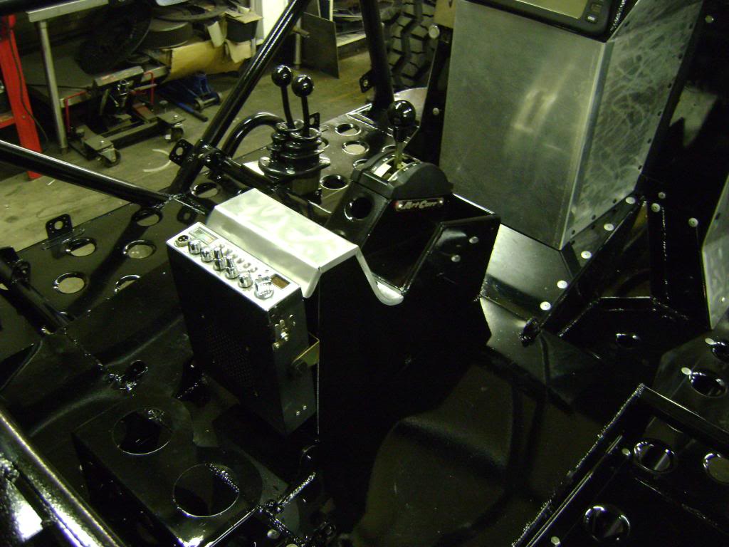

ai1222.photobucket.com_albums_dd489_mcutler1_copper_20crawler_20buggy_rebuild1009.jpg

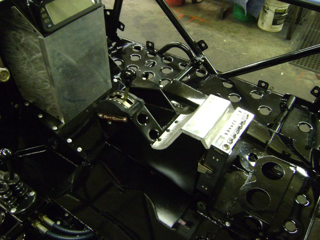

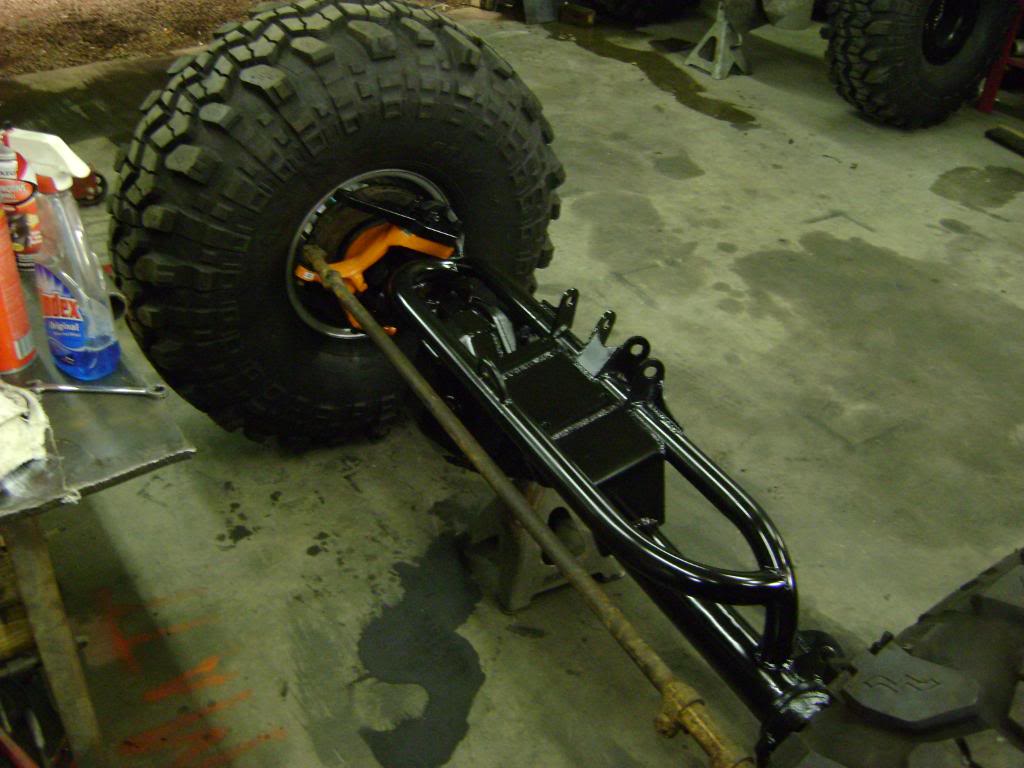

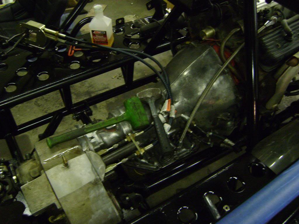

trans and tcase; check
ai1222.photobucket.com_albums_dd489_mcutler1_copper_20crawler_20buggy_rebuild1008.jpg

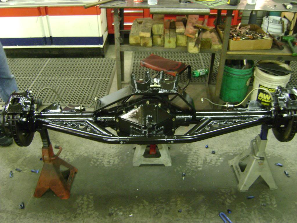

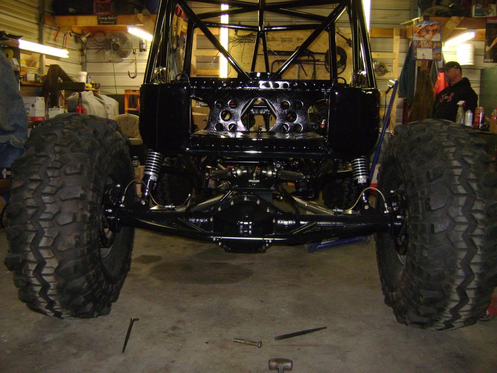

both shafts; check
ai1222.photobucket.com_albums_dd489_mcutler1_copper_20crawler_20buggy_rebuild1011.jpg
