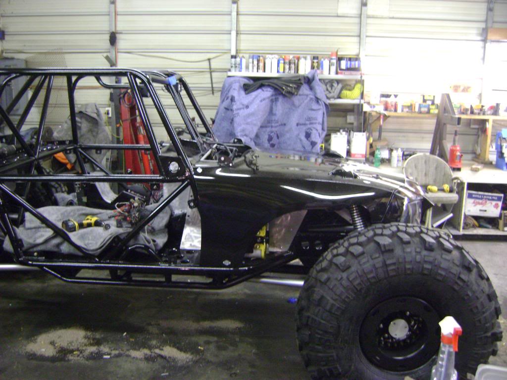

ai1222.photobucket.com_albums_dd489_mcutler1_copper_20crawler_20buggy_COPPERCRAWLERHOOD.jpg
whattya think, yay, nay, adjust, more less?

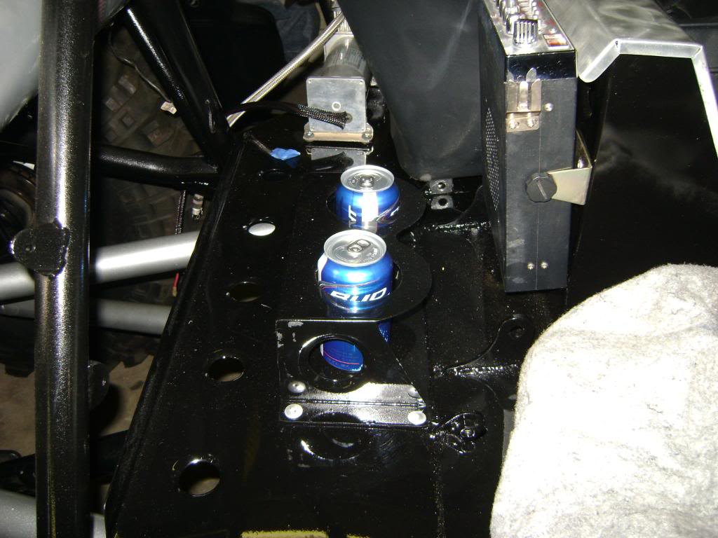

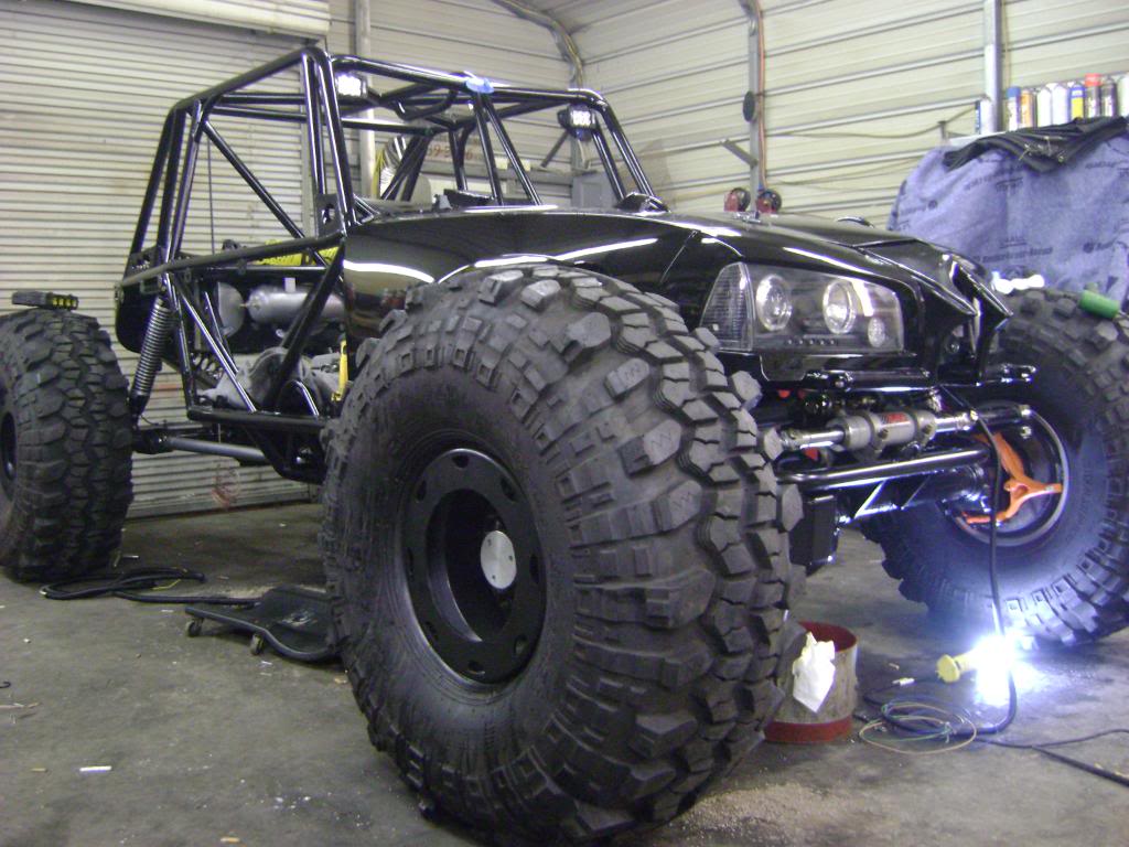

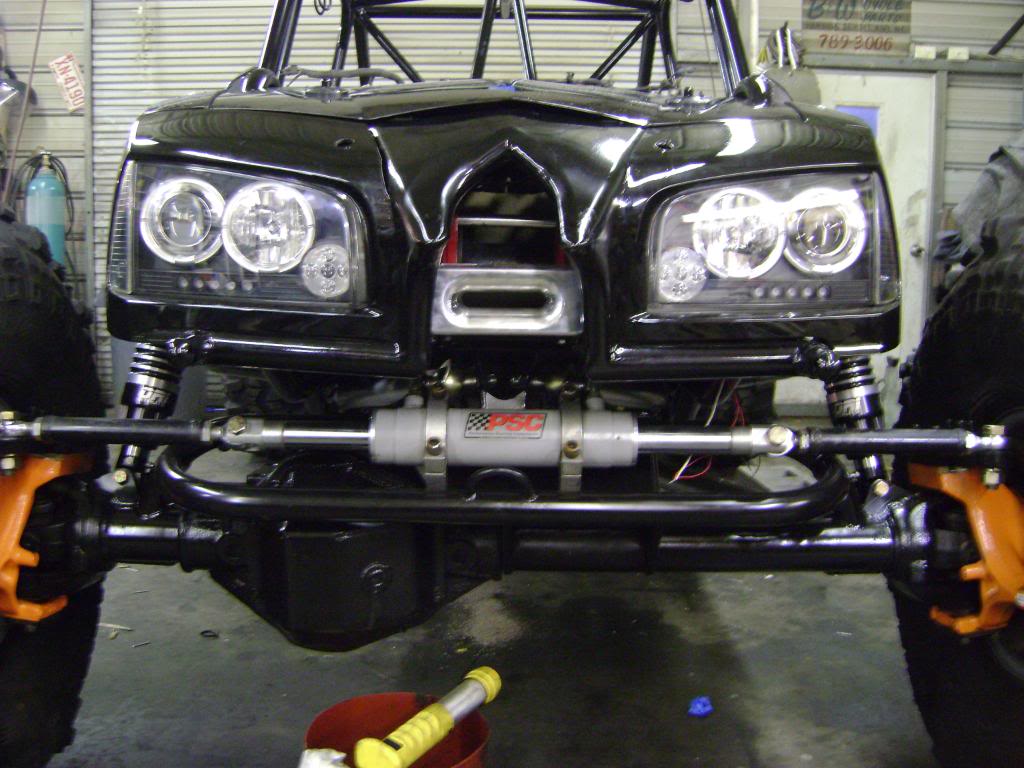

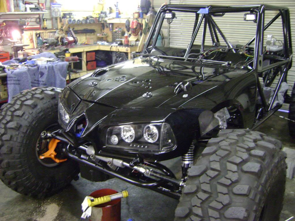

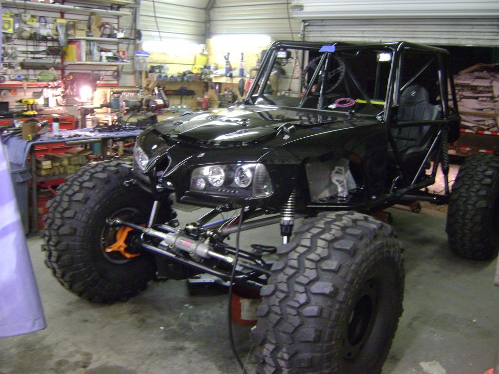

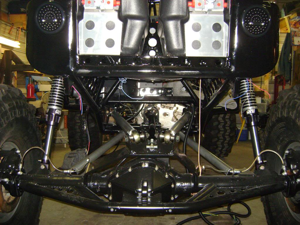

few other odds and ends completed
im glad i have a 12volt miracle worker in jeepn-jason!
ai1222.photobucket.com_albums_dd489_mcutler1_copper_20crawler_20buggy_rebuild3002.jpg
ai1222.photobucket.com_albums_dd489_mcutler1_copper_20crawler_20buggy_rebuild3008.jpg
ai1222.photobucket.com_albums_dd489_mcutler1_copper_20crawler_20buggy_rebuild3011.jpg

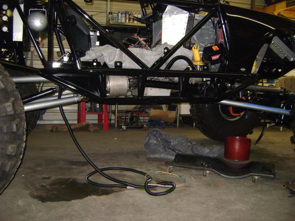

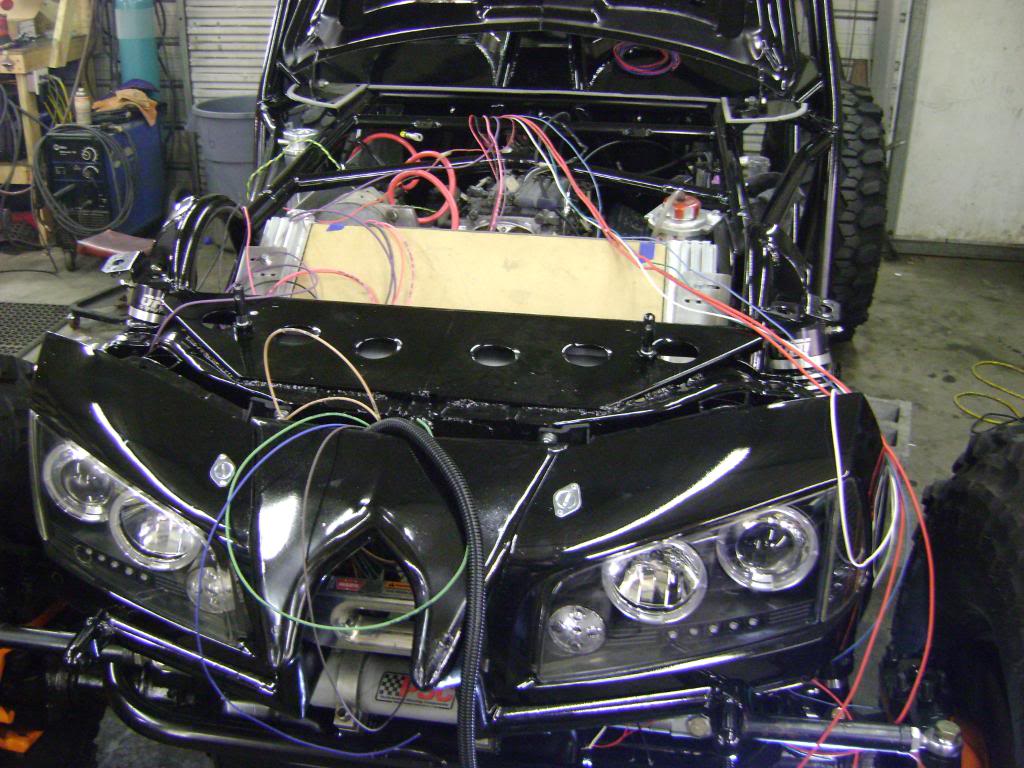

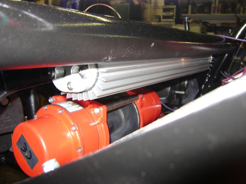

double pass 21" powersteering coolermounted in front of grill for cool air
ai1222.photobucket.com_albums_dd489_mcutler1_copper_20crawler_20buggy_rebuild3006.jpg
ai1222.photobucket.com_albums_dd489_mcutler1_copper_20crawler_20buggy_rebuild3007.jpg

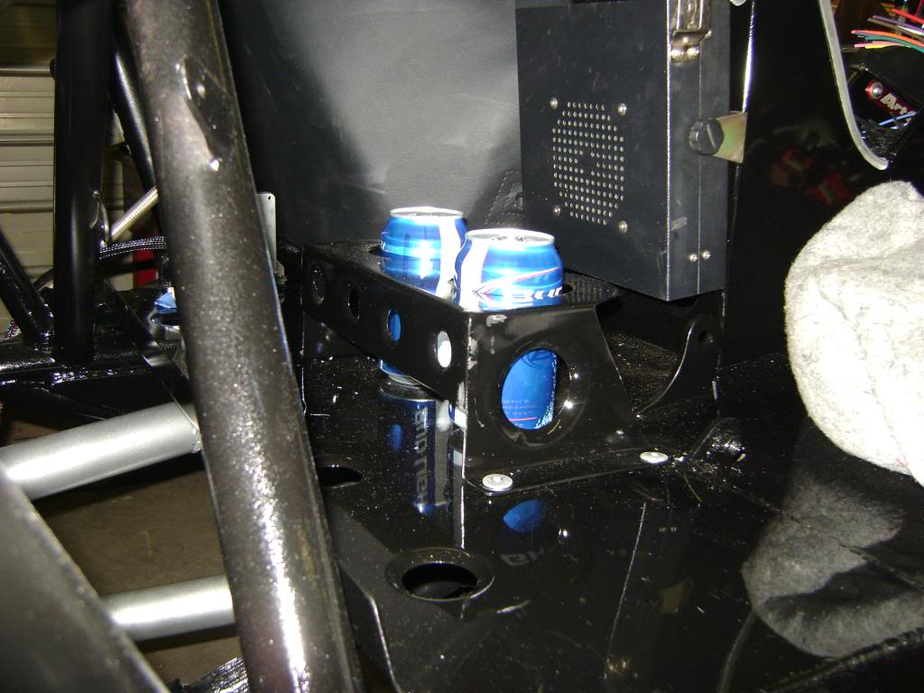

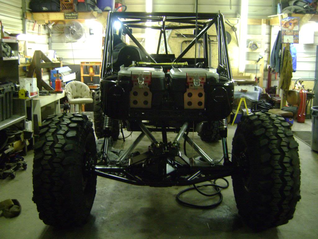

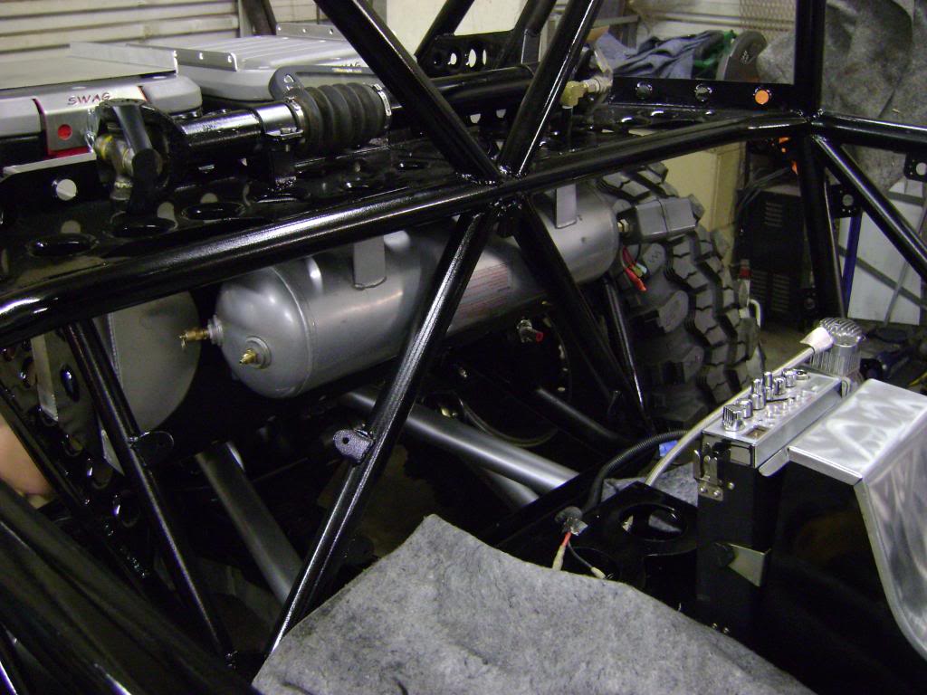

air tank installed
ai1222.photobucket.com_albums_dd489_mcutler1_copper_20crawler_20buggy_rebuild3009.jpg
ai1222.photobucket.com_albums_dd489_mcutler1_copper_20crawler_20buggy_rebuild3010.jpg

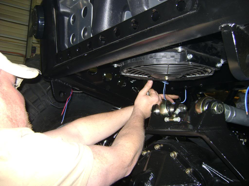

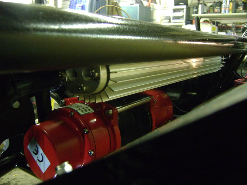

trans cooler
ai1222.photobucket.com_albums_dd489_mcutler1_copper_20crawler_20buggy_rebuild3012.jpg

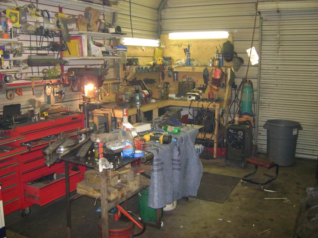

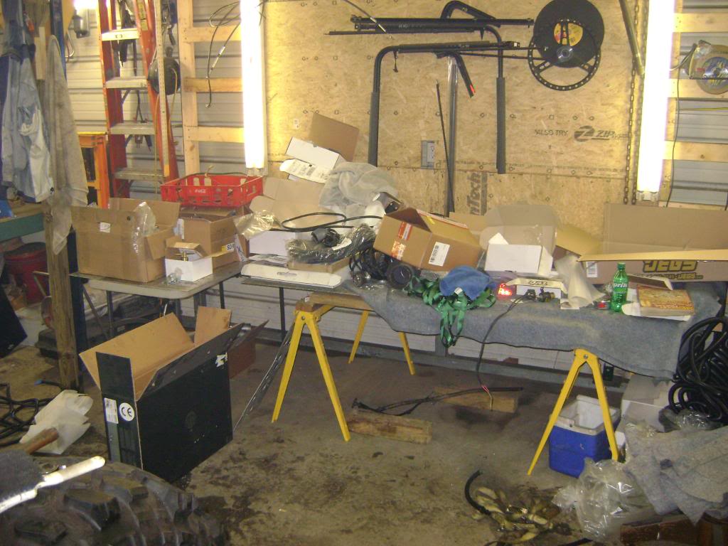

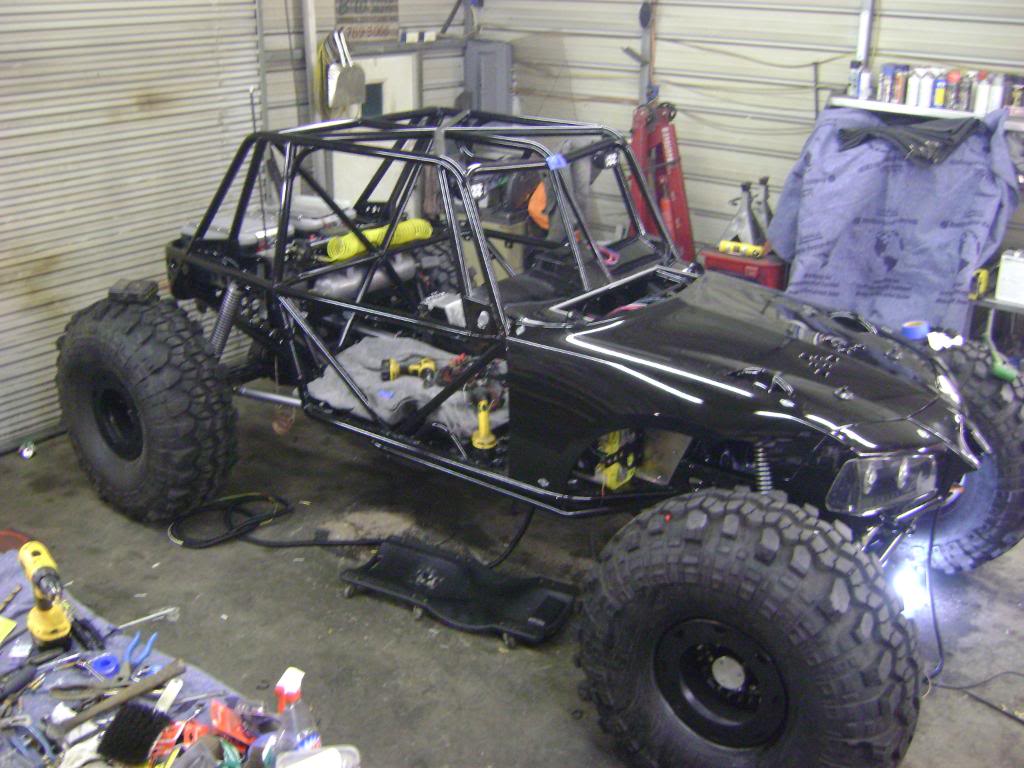

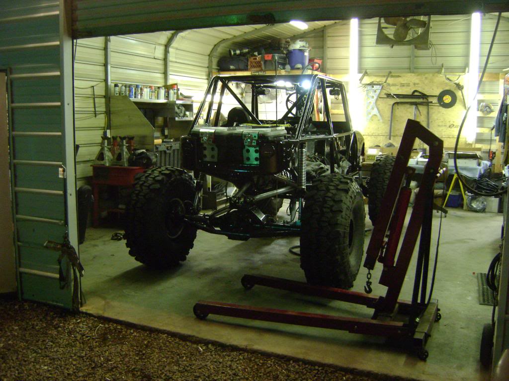

we have trashed this place this week!
ai1222.photobucket.com_albums_dd489_mcutler1_copper_20crawler_20buggy_rebuild3014.jpg
ai1222.photobucket.com_albums_dd489_mcutler1_copper_20crawler_20buggy_rebuild3013.jpg
mucho thanks to jason and billy(lucent) for all the help thru this build. could not have done it without their help.

Which way do you have that fan setup to blow on the trans cooler?
I run the same fan/cooler(if that's from Jegs), and it looks like it should be a puller, but i found it moves A LOT more air set up as a pusher and runs quieter as well. Probably moves 2-3x the air. I actually flipped mine around in the mount once i found that out, so it may be worth looking into on yours.
it is from jegs and the motor is reversible, thanks for the tip, i will check it both ways.

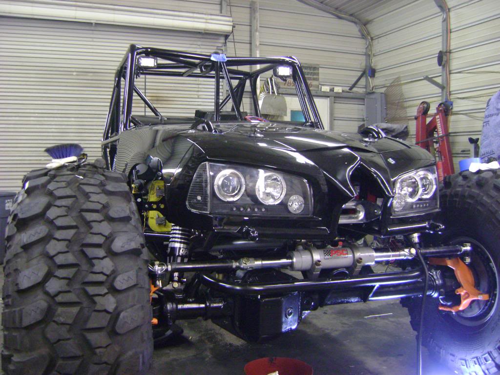

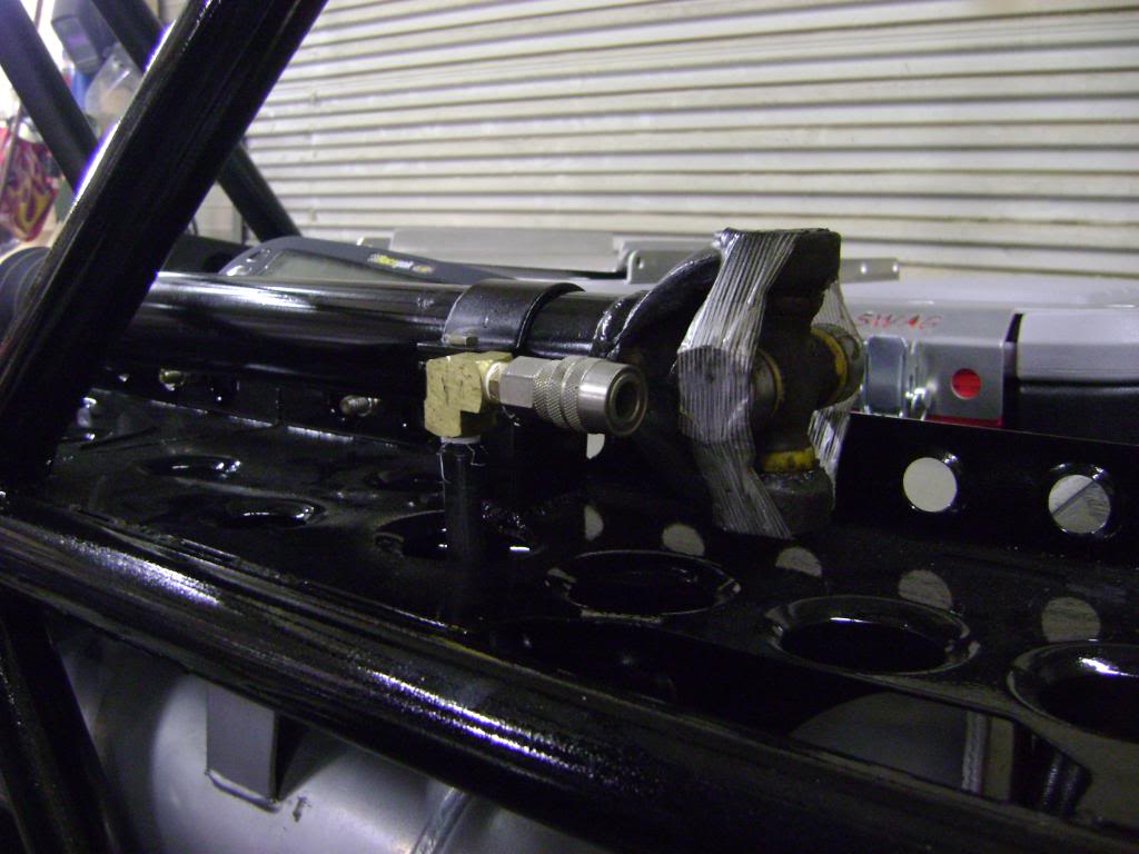

thanks to Will at four wheel parts for the research and help finding the air switch assembly for the Viair/ARB combo! awesome dude!
not much done today but alotta running around grabbind all that miscelaneous bull:poop:. a buggy sure does $200 dollar you to death.

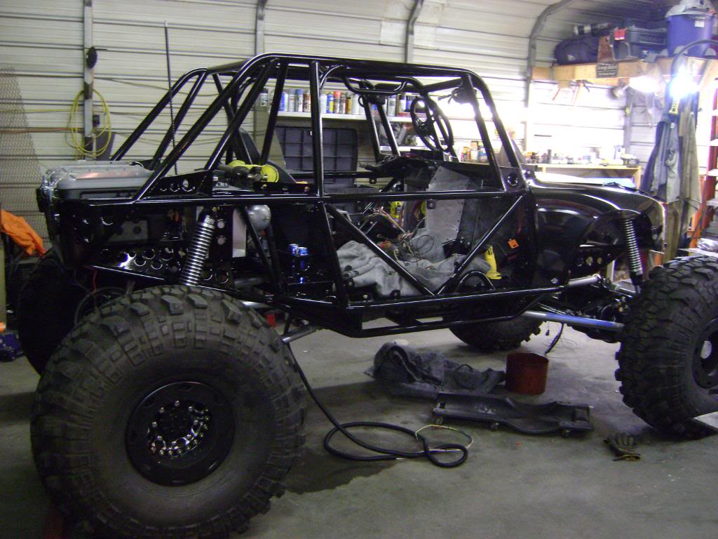

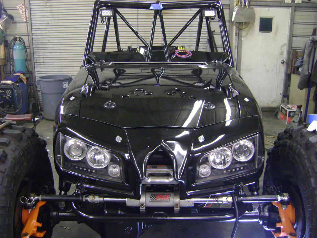

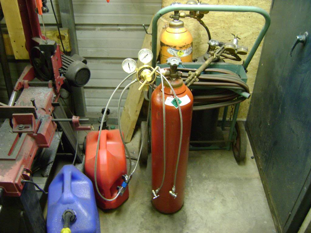

gave myself a crash course on shock charging tonight and got it to ride height. thanks to Brandon and RKBJR for the tips and info.

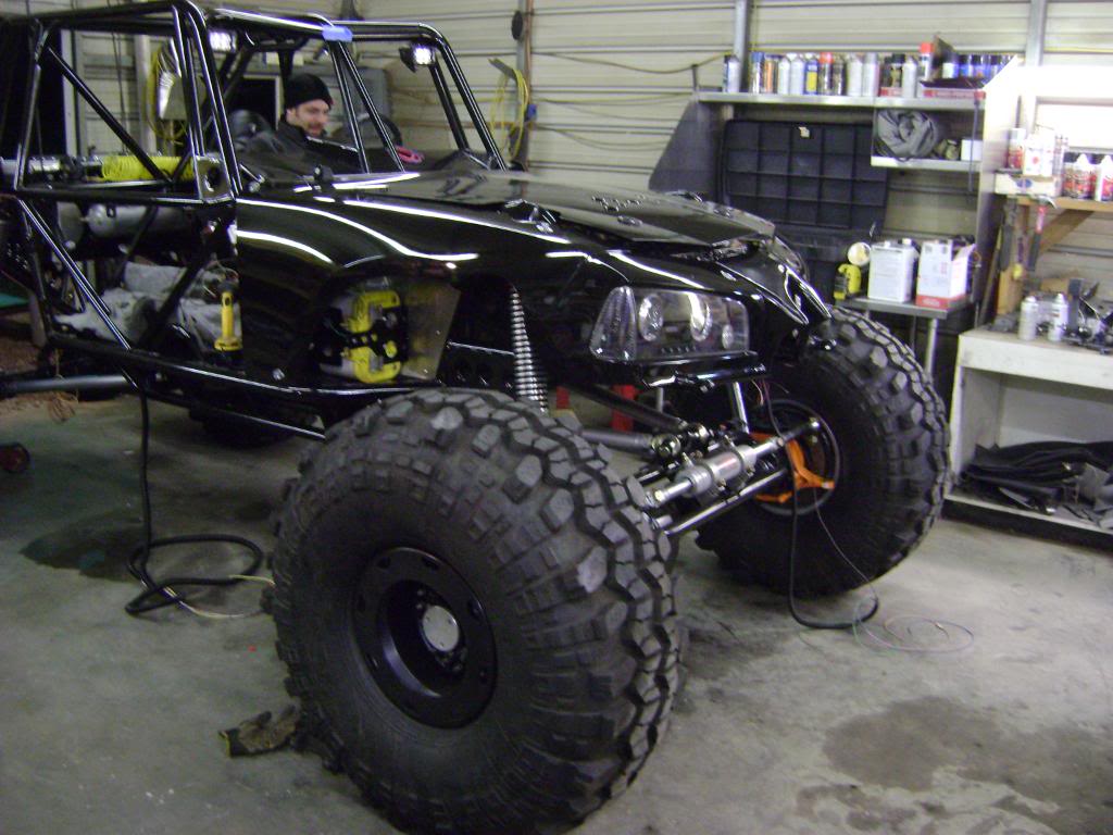

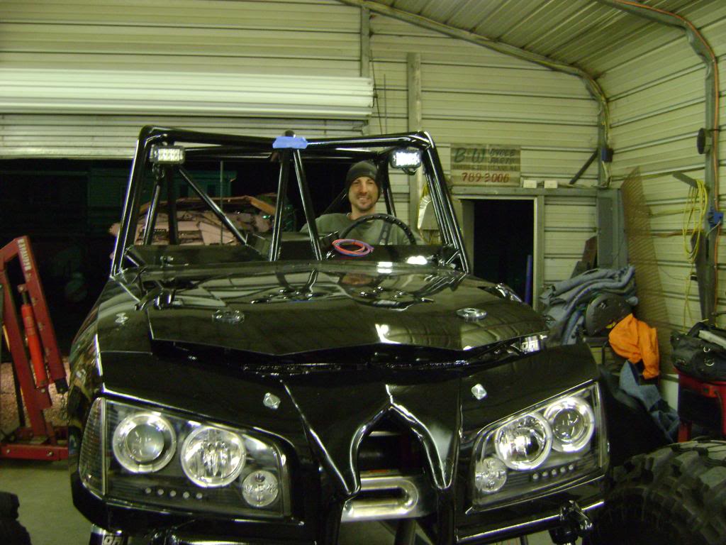

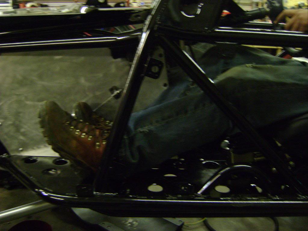

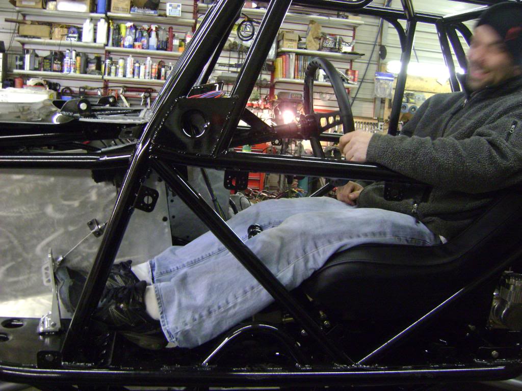

jason couldn't wait to hit the driver's seat; to bad he can't reach the pedals:fuck-you:
my feet
jason's feet
more at ride height; belly 24.5"; roof 77"; wheelbase 117-118"
