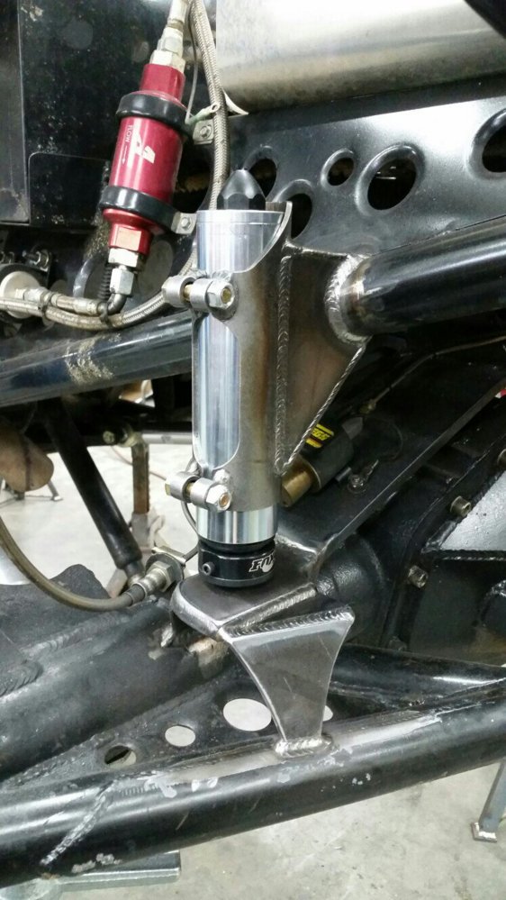

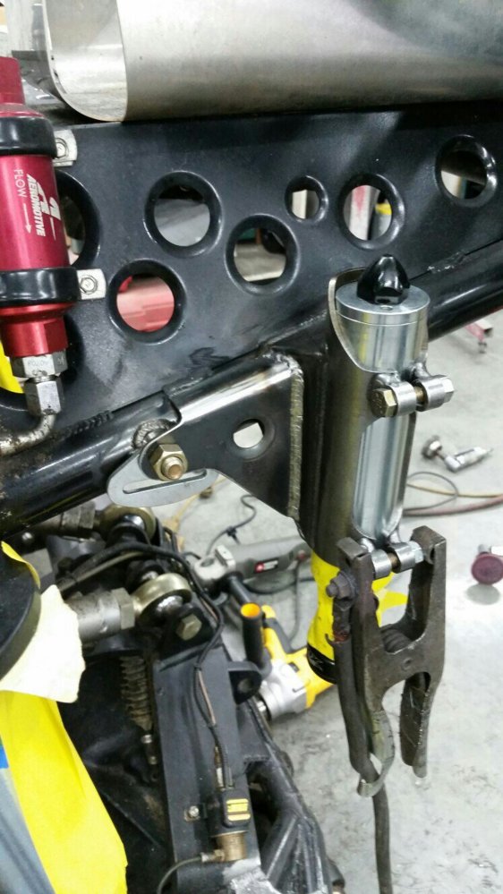

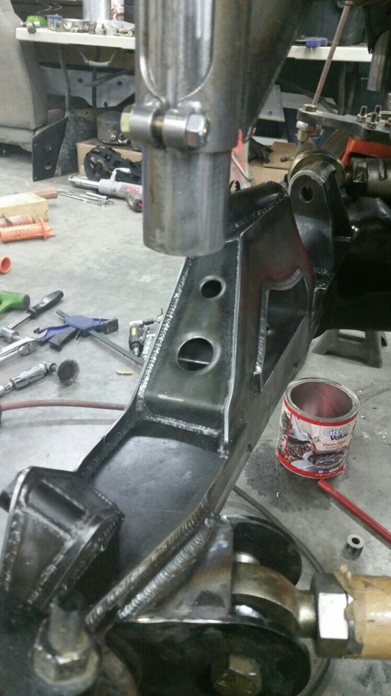

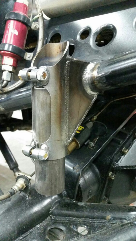

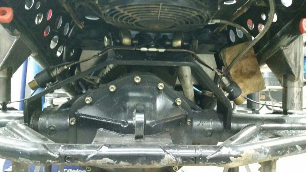

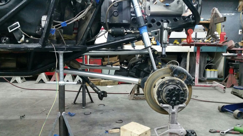

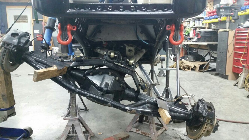

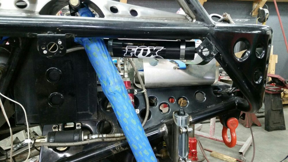

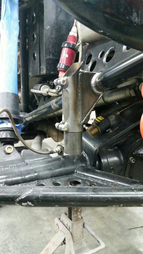

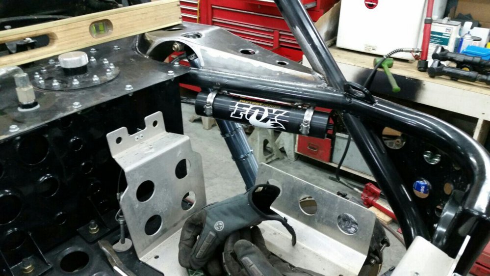

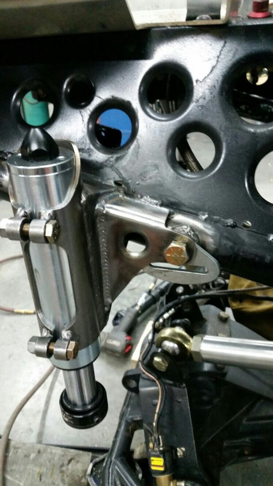

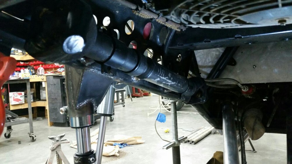

So the back end is done, minus paint and delivery of limit straps. Reservoirs mounted. Drive lines moved out of the rear deck to below cooler and action packer, also to de-clutter back end. Get that weight low and back was the idea. Aluminum links are in and tight.

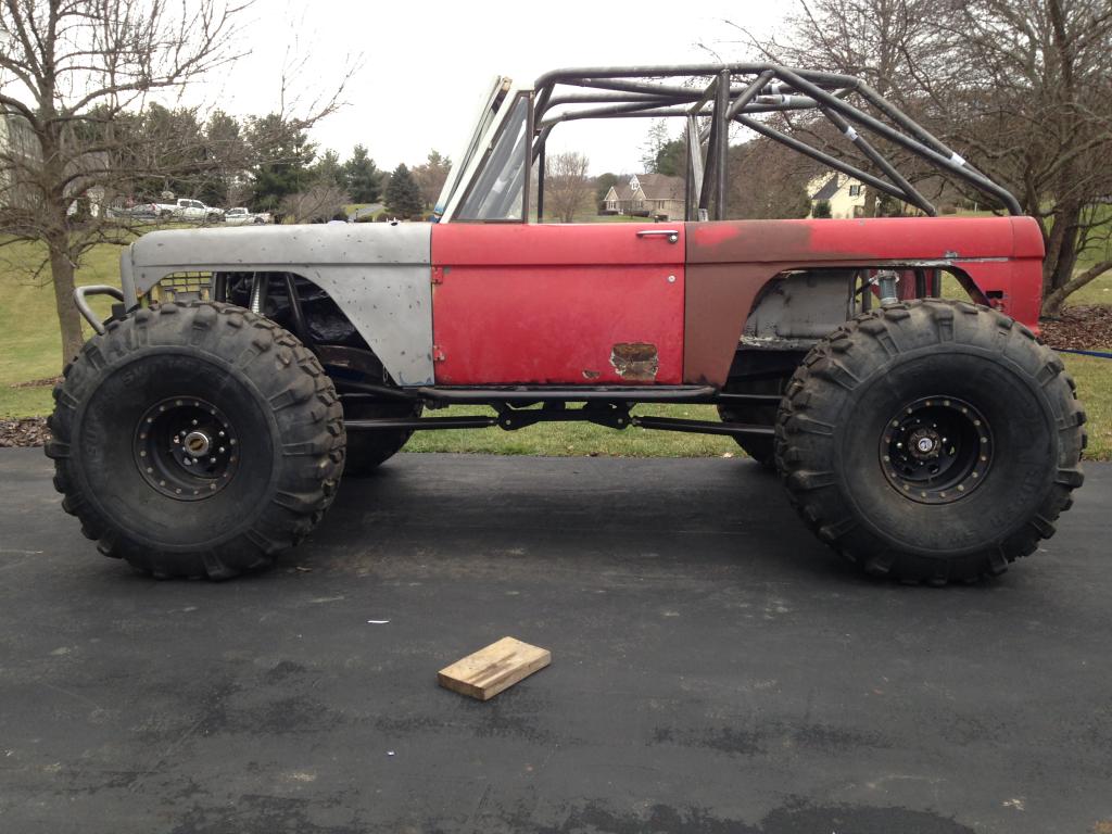

Last pic is ride height with 7 psi in tires and 7.5 " of chrome on shafts. Got the rear upper links dead nuts level, along with 3 " more up travel than previously with the ori's.
Ori's 2" shorter collapsed, plus i just had the extra room in rear to get the extra travel. Overall raised the upper mounts almost 5".

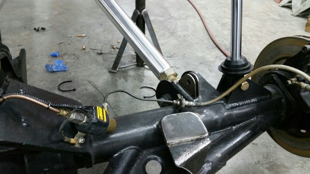

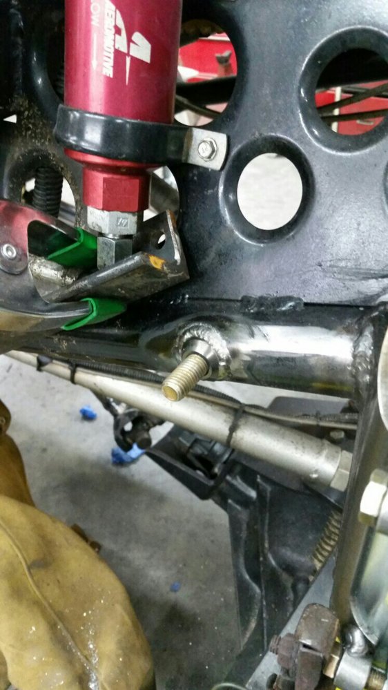

Multiple reasons for locks. Front digs, lock out caliper for broken flex line, set a brake drag on steep down hills, lock out rear brakes all together on steep up hills and of course parking brake. All good in theory but rarely use them for anything other than front digs and parking brakes.
I gotcha. Mainly curious on why 2 vs 1 on the rear.

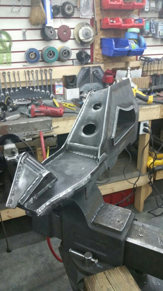

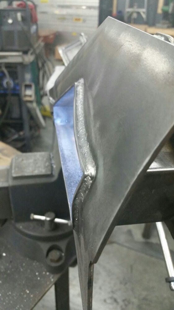

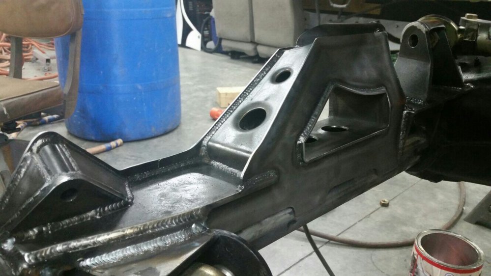

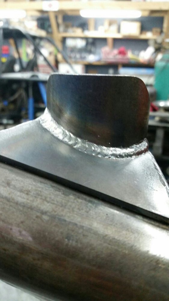

All by hand with a standard plasma and Porta band. No paper or computer drawings-only images in my head and research online, many hours of standing, sitting, staring, cutting, grinding, polishing, welding, cussing, smoking-(pall malls ), drinking-(coffe,mtn dew,Pepsi ).....OCD..it's a damn burden i tell ya.
