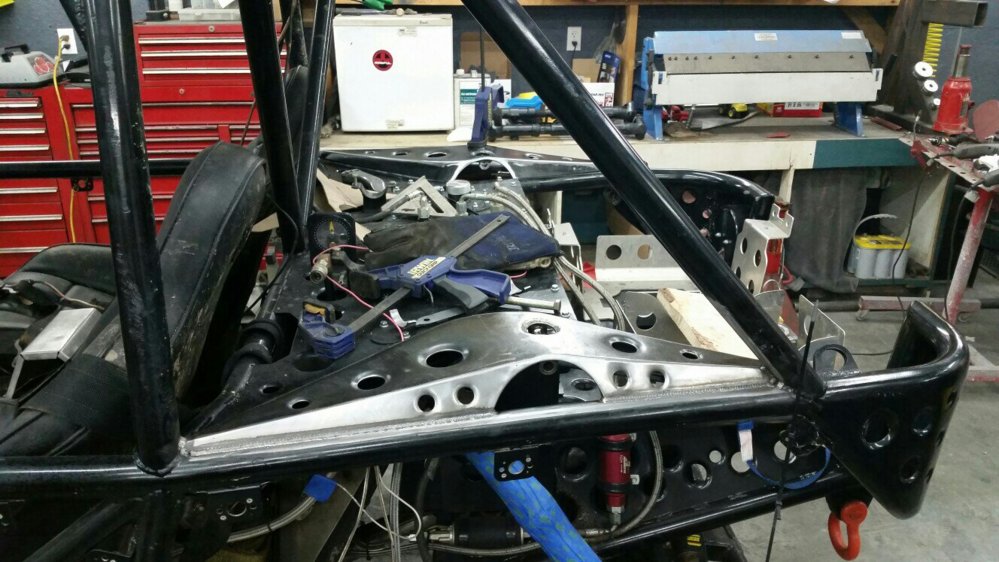

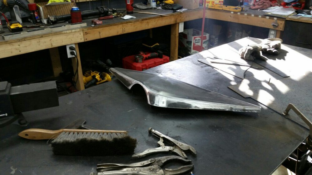

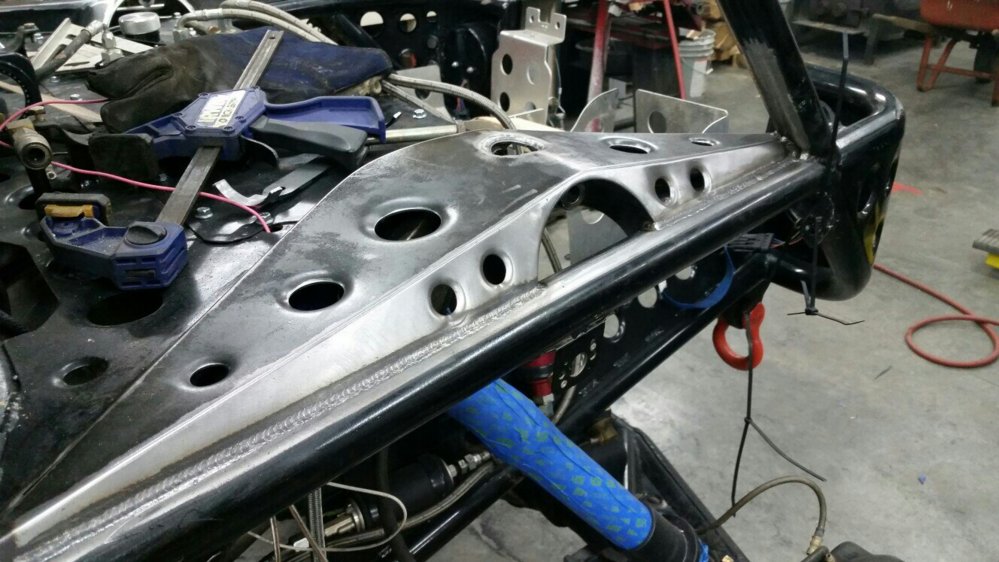

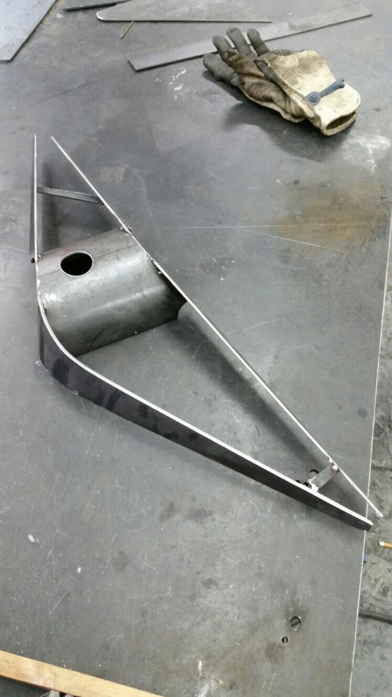

loose cannon Well-Known Member Joined Oct 1, 2007 Location MARION Dec 16, 2014 #726 Nice did you roll that or is it cut down pipe
mcutler Well-Known Member Joined Apr 17, 2010 Location mt.airy nc Dec 16, 2014 #727 No, don't have a slip, on my list of wants. Cut down 6"od pipe roughly .130

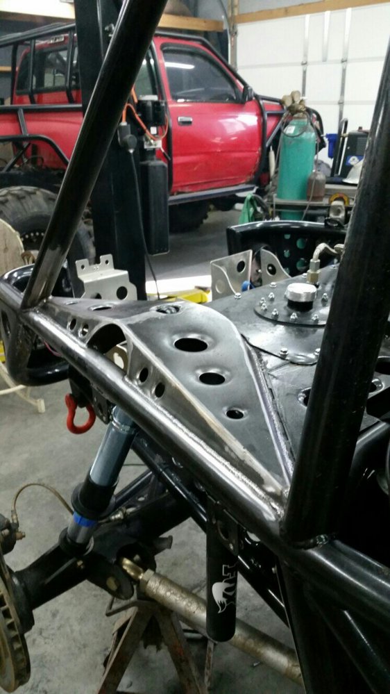

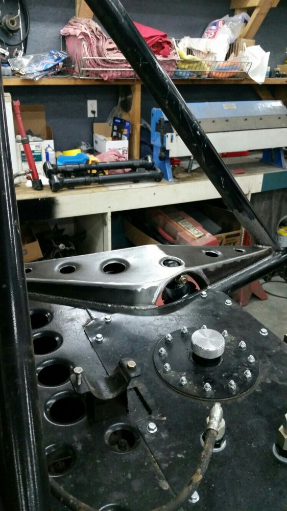

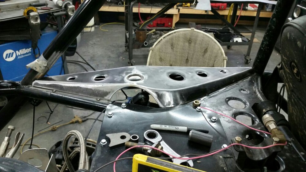

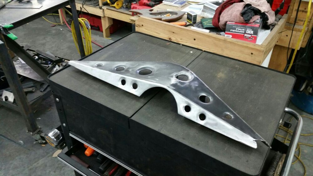

mcutler Well-Known Member Joined Apr 17, 2010 Location mt.airy nc Dec 17, 2014 #729 Finally finished one side, now that all the brainstorming is done and patterns are made, the other will go much faster.

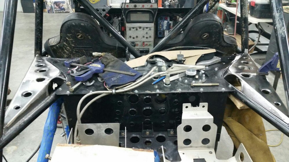

mcutler Well-Known Member Joined Apr 17, 2010 Location mt.airy nc Dec 17, 2014 #730 Someone do you're magic and fix my duplicates please [emoji3]
ol'Jeeps Dirty Jeeps...Done Dirt Cheap! Joined Dec 5, 2006 Location Hickory, NC Dec 17, 2014 #731 LOL!!! Didnt think that thing had 7 shocks on it! But if all seven end up looking like that one, they'll be awesome!
BRUISER silent.. but deadly Moderator Joined Mar 17, 2005 Location Raleigh Dec 17, 2014 #732 all fixed

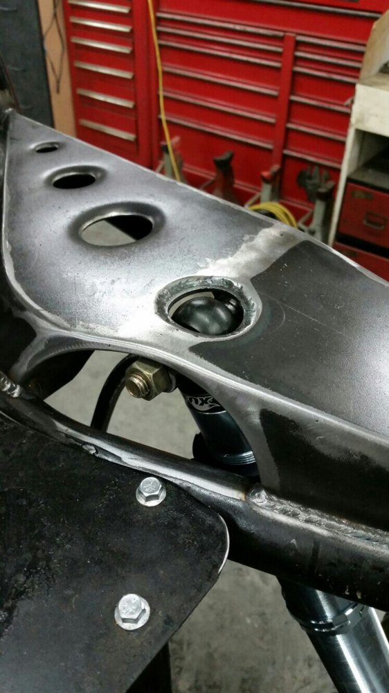

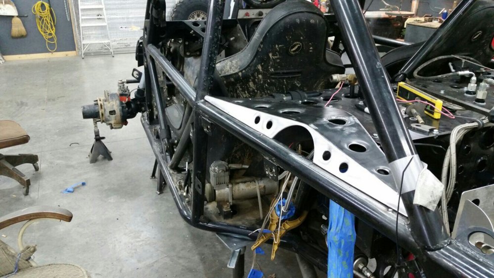

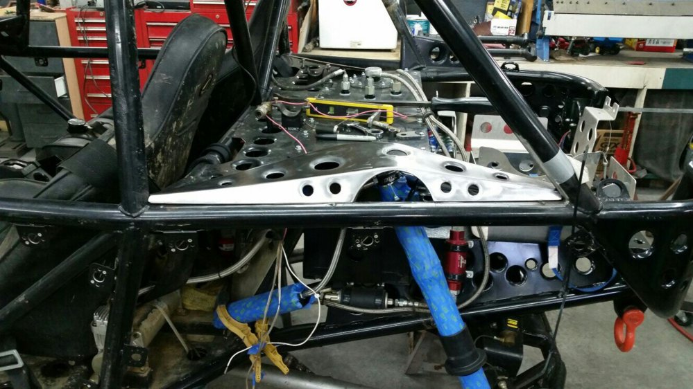

mcutler Well-Known Member Joined Apr 17, 2010 Location mt.airy nc Dec 31, 2014 #743 Got both sides done just need to finish welding in morning. Then get started on the fronts.
Crawler Nut Rock Corp 4X4 Club Joined Mar 15, 2011 Location Hendersonville N.C. Dec 31, 2014 #744 Man you got some mad welding skills.
mcutler Well-Known Member Joined Apr 17, 2010 Location mt.airy nc Dec 31, 2014 #745 I'm sure I'm not technically proficient but i can glue some shit together. I'm still learning everyday, thanks Dustin.

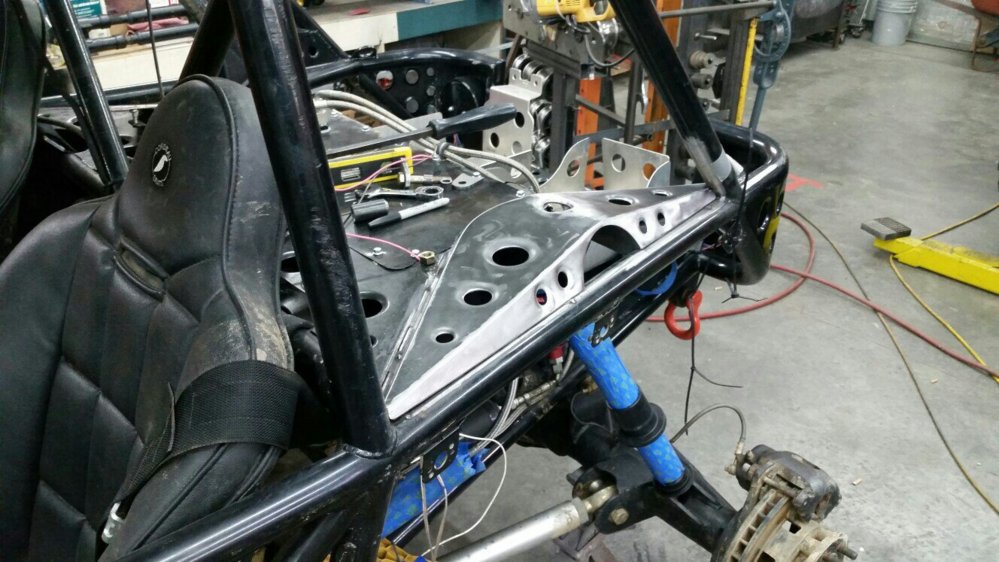

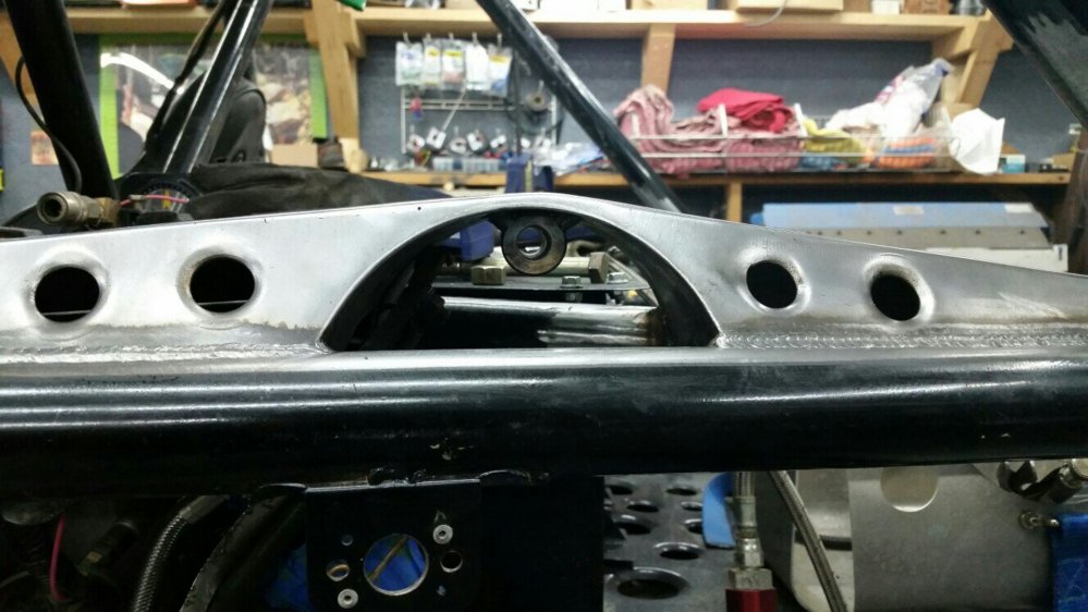

mcutler Well-Known Member Joined Apr 17, 2010 Location mt.airy nc Jan 1, 2015 #748 Got em done today , mount resi brackets and bumps sat, that I'll be picking up tomorrow along with new aluminum links. View attachment 176168 Attachments uploadfromtaptalk1420138010779.jpg 126.9 KB · Views: 412

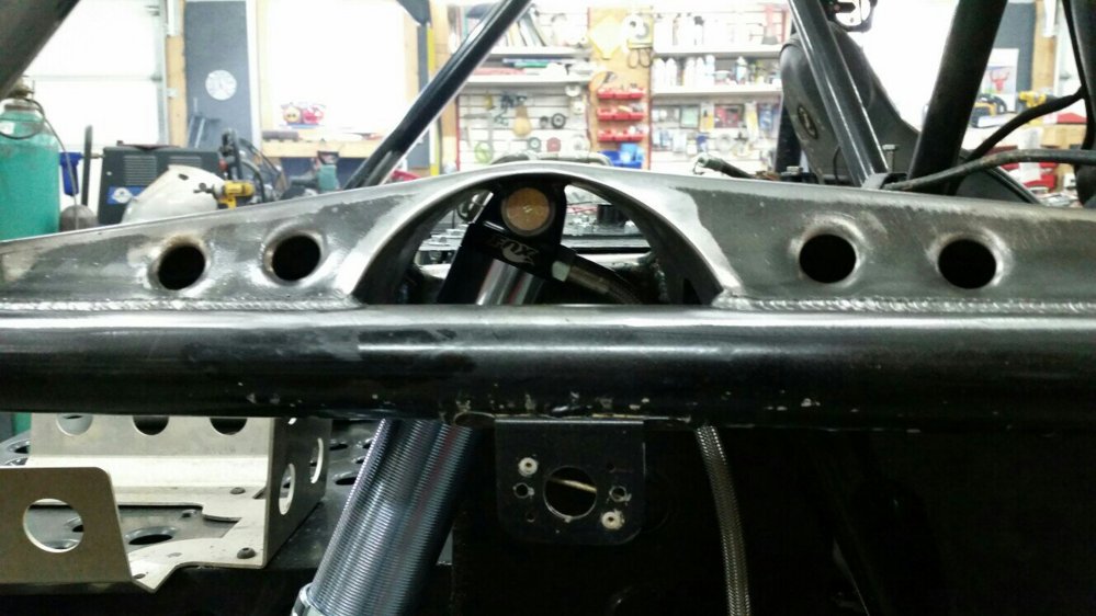

mcutler Well-Known Member Joined Apr 17, 2010 Location mt.airy nc Jan 1, 2015 #749 View attachment 176170 Last edited by a moderator: Jan 7, 2015

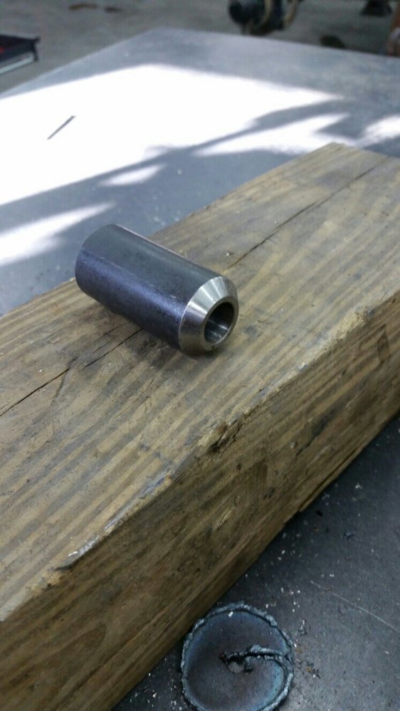

mcutler Well-Known Member Joined Apr 17, 2010 Location mt.airy nc Jan 1, 2015 #750 These are the bungs i used for shock eyelets, and made new spacers for the misalignment to be same width as ori's, so i wouldn't need to redo my lower shock tabs. Plus i can carry an ori as a spare lol. Last edited by a moderator: Jan 7, 2015
