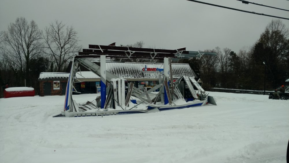

Not a carport but it would suck to be the company that engineered and installed this canopy.
This is a store I buy lots of gas at too. SMH.

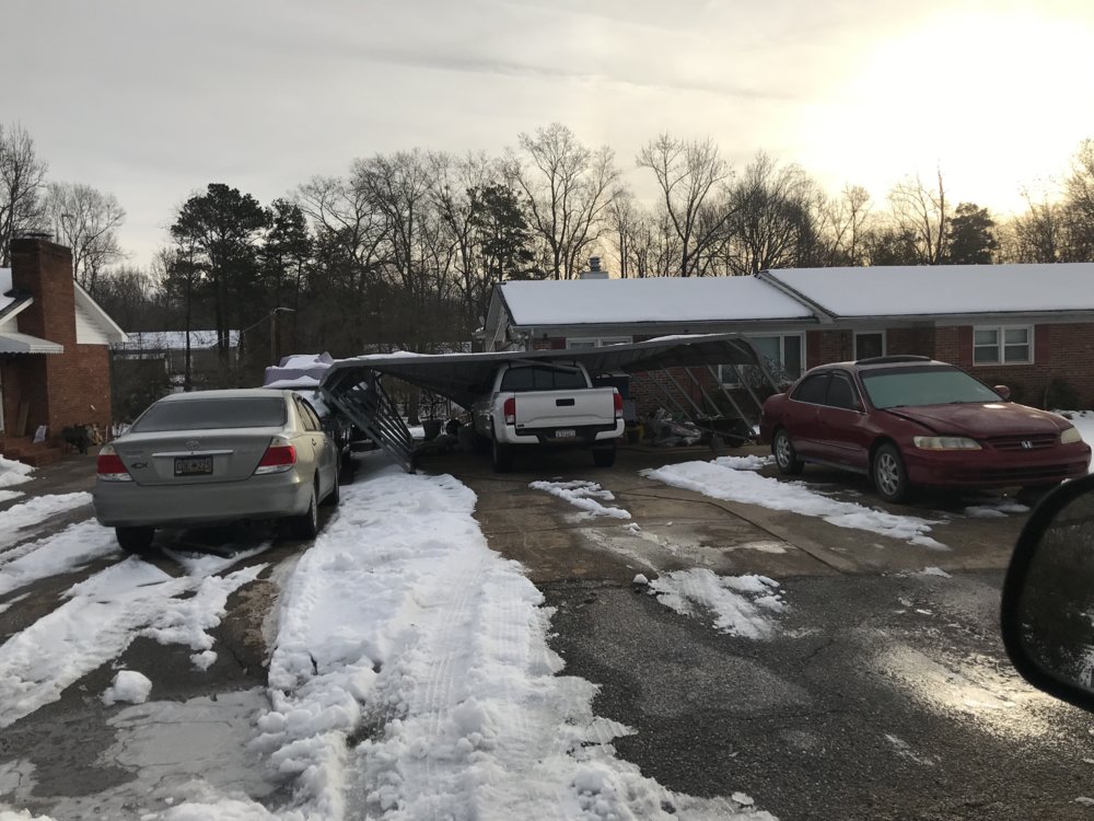

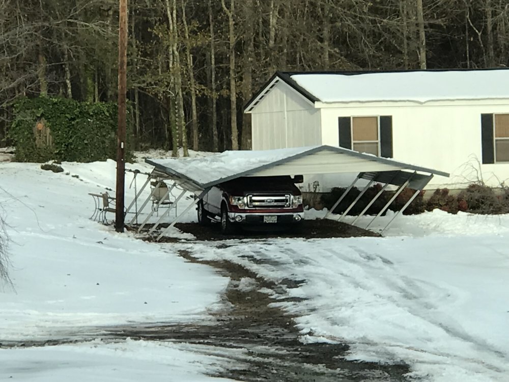

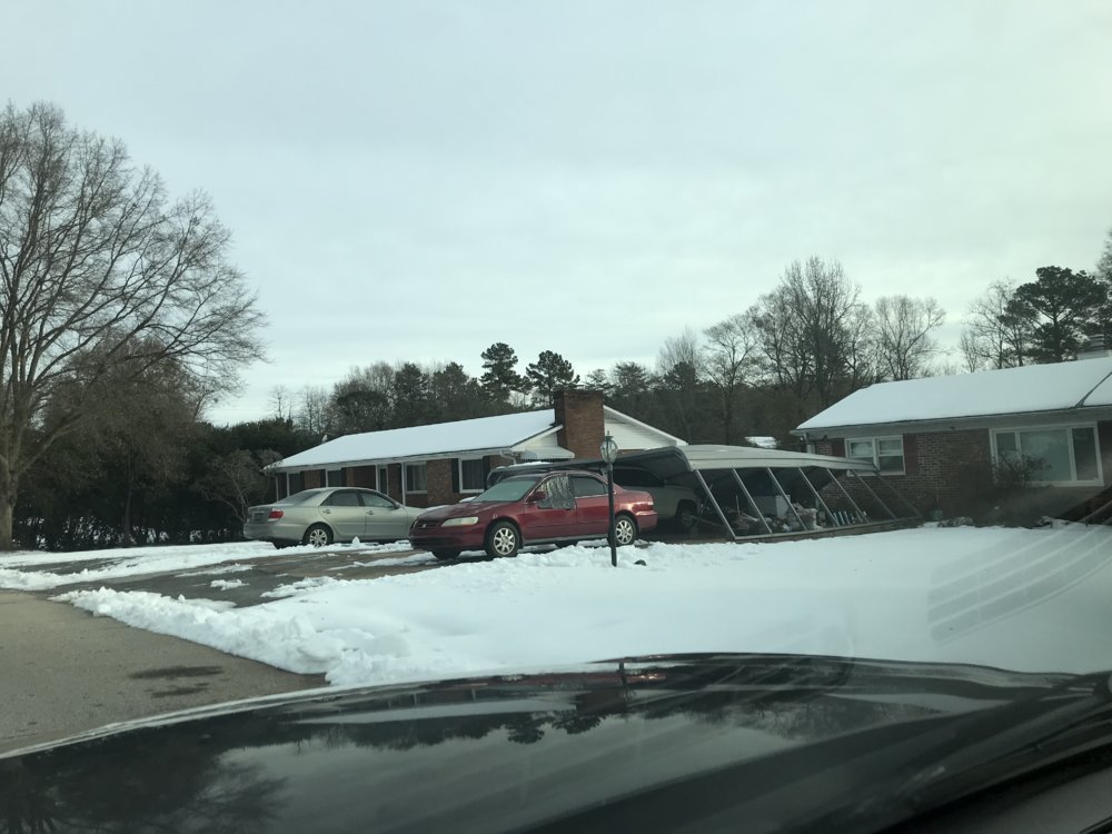

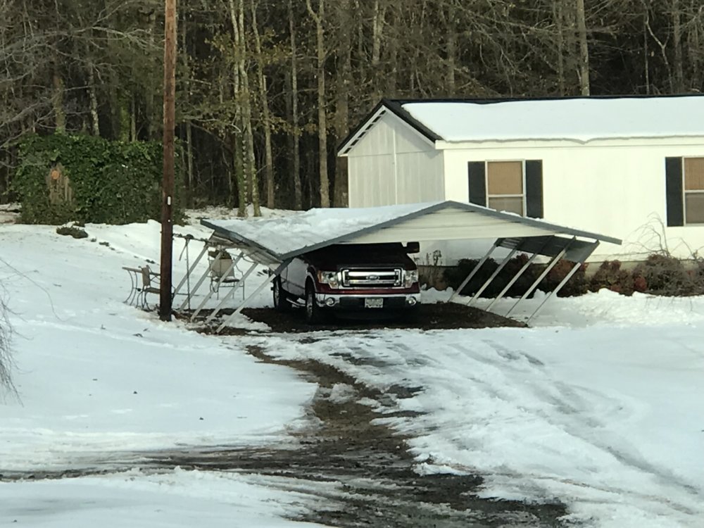

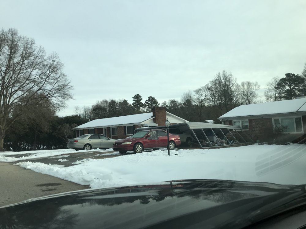

These are just a few that I've seen in Boiling Springs, SC.
I've seen over a dozen that didn't hold up to the weight.
We had 6-10" of snow followed by rain.

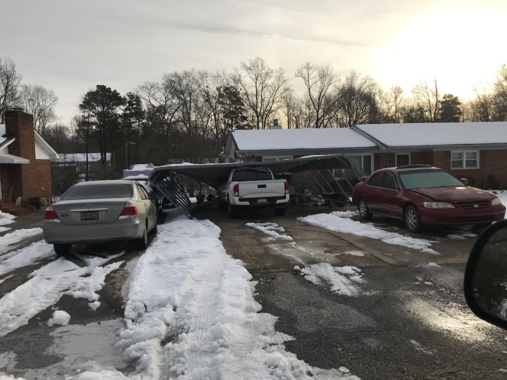

View attachment 281948 View attachment 281949 View attachment 281950
Daiuum that sucks, that's new looking truck under that one. Again people don't have common sense to think about this much forcasted snow on a cheap thin wall building and to trust a new car truck or hot rod under them in a storm like this is kinda stupid..my opinion

So, it’s stupid for the owner to use the product as it was intended? Never mind that it’s a piece of junk and looks like it would fail under a small storm, but why fault the owners who are using it as intended? I mean, if I had a carport and it was snowing, yeah, I’d have my vehicle under it to limit the amount of ice and snow on my vehicle.
Sounds like the manufacturers and installers should be the ones to get the fingers pointed at for selling a product that fails under its intended use.
Nope nope nope that's why his come with engeneered drawings and specs and if people read them, they would see that it makes out at roughly 8-9" of snow load with the total weight. He's got people complaining already but it's in the drawings. That's one thing different he does that others don't is provide those papers.
Oh, so he provides written documentation explaining that the structures don't comply with the North Carolina Building Code? That sounds like it could expose him to substantial liability.
There isn't a manufacturer that sells a "carport" intended for 15"+ of snow. If they claim it they're lying up the sale as a business would to make sales.
These don't fall under the kind of codes you're referring to. The dead load that a carport handles has nothing to do with building codes under the carport permit. They just approve the lot and that it's fastened down properly. The rest is between the manufacturer and customer I assume
It could be, I only know what he's told me and I guess I figured he knows lol but we will see with all these "failures"
I remember now it's because categorized under a natural disaster meaning if they fall over or get damaged by natural disasters are not held liable... according to him
I suppose it's the same principle with if a house gets turned down by a tornado or a hurricane, insurance is all you got but builders and supplier not held liable
Have you ever seen one of those carports that actually looked sturdy...? I haven't. All of those pictures above show them failing in exactly the way that they should, based on the way they are designed and built. Actually, I would expect more twisting, but I guess the bending failure mode occurs before that.
But you know this kind of wisdom would be asking too much from the average everyday person buying these and sticking expensive things under them when there is a major snow storm forcasted lol.
