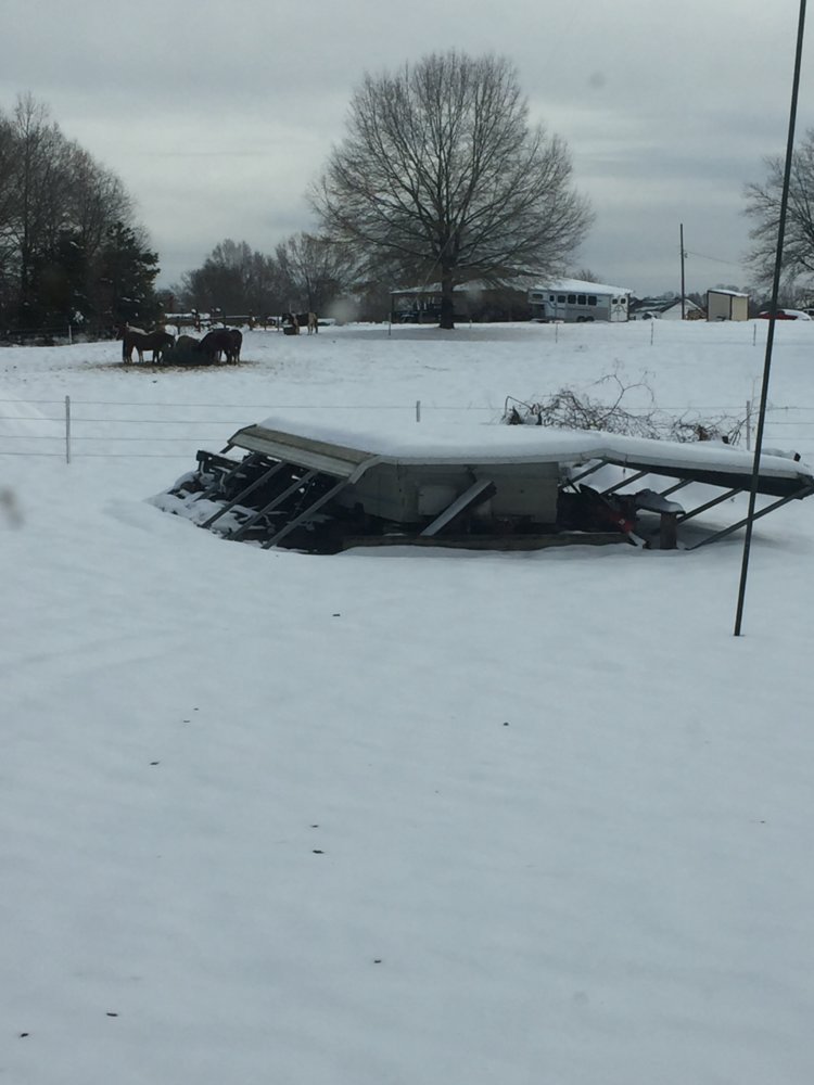

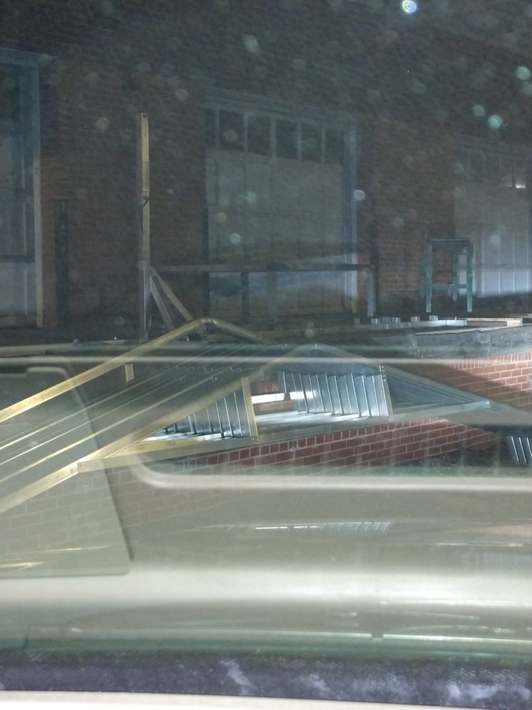

I have a metal carport in the back yard that I used for camper and trailer storage. Unknown age since it was here when we bought the place 14 yrs ago.
This happened sometime Sunday morning.
Looks like the pop-up is ok ..... homeowners is gonna cover the carport minus the deductible.

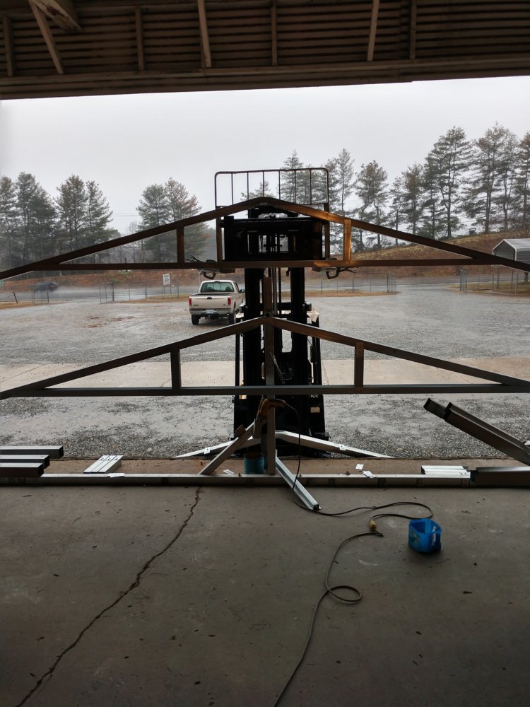

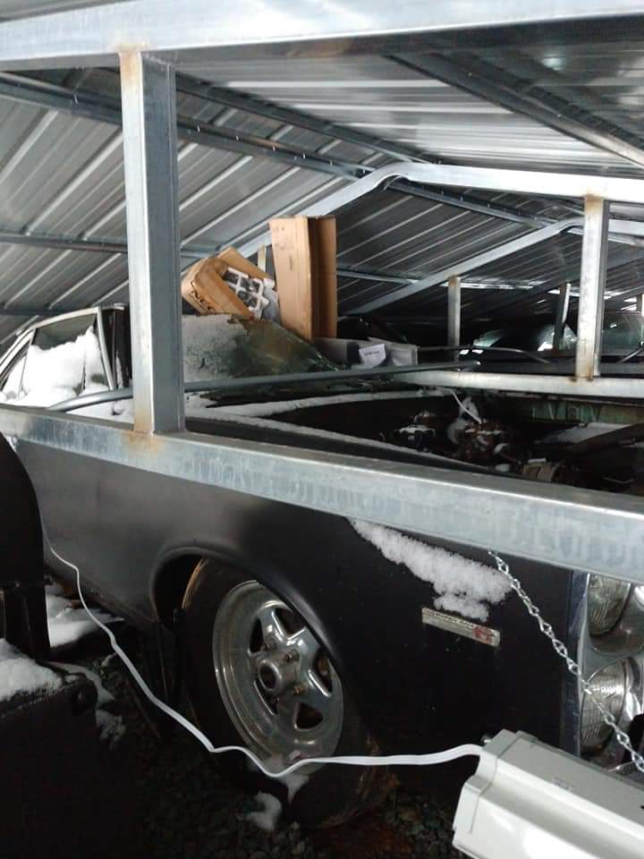

If you're going to get another one under insurance might as well pay a few hundred dollars extra to get all the bows 3 foot on Center that would pretty much hold up along with the center 12ft braces and the corner 3ft bracing. Just a thought if you choose to get another one.
after walking all over the top of these 24 wide buildings to shovel the snow off 5 foot on Center it's no wonder these pieces of junk collapse 5 feet apart is just not enough strength, I just couldn't believe how flimsy it felt when you're in the middle of that five foot section between each bow. If you get this done in the middle of each bow, this would drastically improve the strength also.
For what it's worth, if any building over 18' wide doesn't have this kind of bracing minimum than you need to ask for it. Closed in or open. These A frame on 14g hold up flawless. Just in case for those who might get a metal carport/building in the future

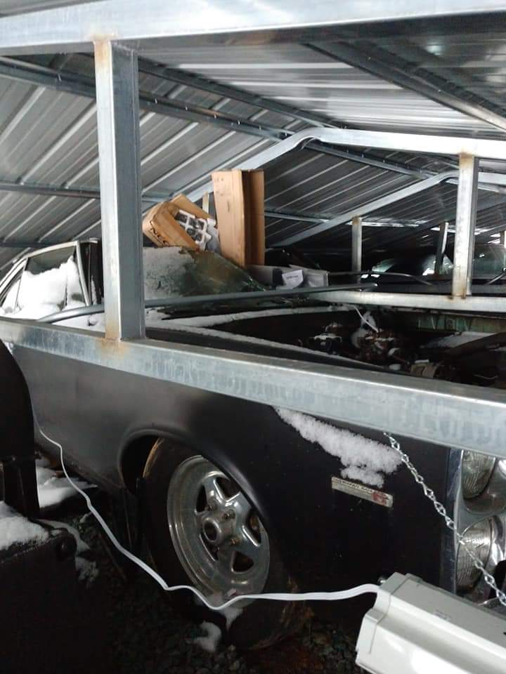

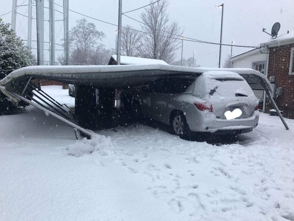

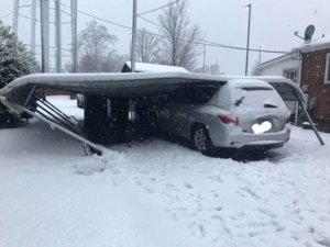

Snow got my girls carport too. Dented up the roof pretty bad on her car.
Makes me want to brace mine up after seeing all these.

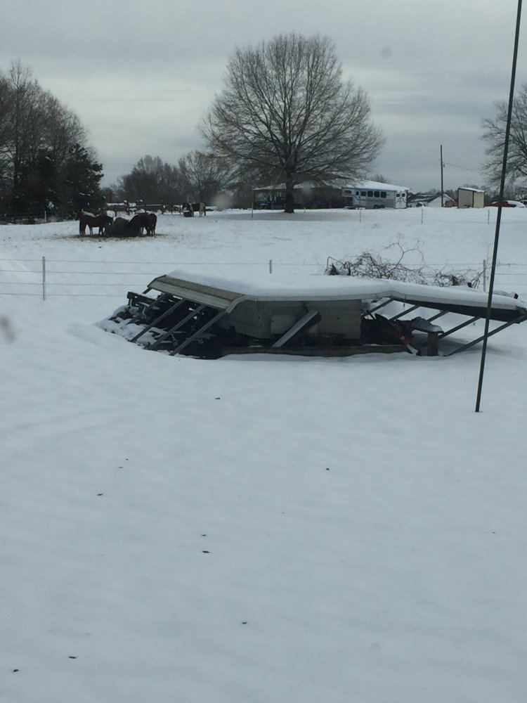

It doesn't matter how bulletproof the roof bracing is. When the legs have no bracing for lateral bending, that's going to be the failure mode. A strong roof with spaghetti legs is still going to collapse.

I will say this for sure. Over half the carports/buildings that failed were 24 wide of the thinner 15g stuff no bracing except a 6ft Uchannel up top (pointless).
The 24 wide Classic that we sell (rounded corners/basic deal) NO U CHANNEL at all with our 14g tubing held up everywhere. Both 5ft OC. So I personally don't know the "science of metals" haha but I do know there is difference in the two and noticeable. I too have been surprised at the weight difference between the two different tubing and surprises me too that there is such a difference so I don't know anything else except what I've personally witnessed. I'm not by any means trying to upscale these buildings or the tubing but since I know people will still buy these things, just trying to shed some light on the subject to help someone be a little more aware maybe of what they buy
