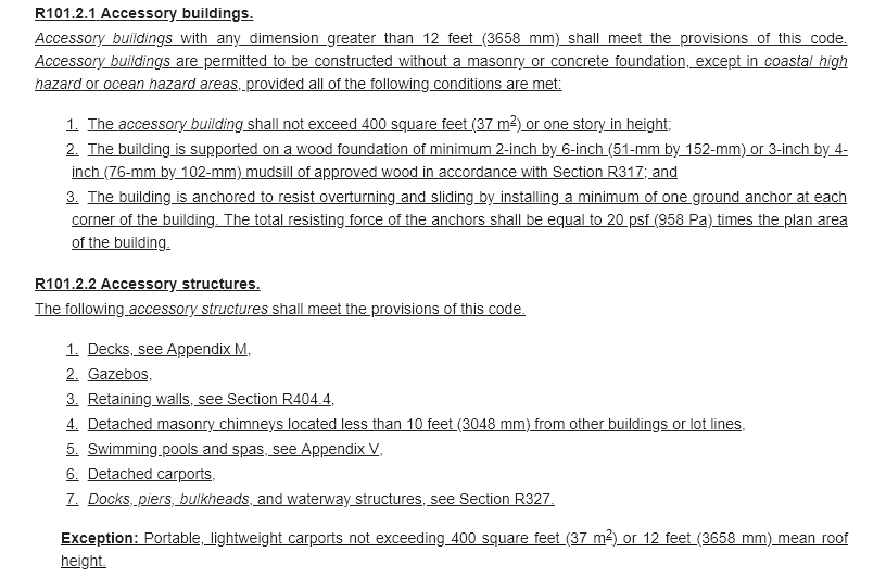

@shawn your refering to the codes... they exist. Apply to dwellings and engineered spaces attached to a residence. Some occupied some not. Maybe even a fancy space engineered and designed for its purpose.
@CasterTroy me thinks your referring to certain; we will call them structures, don't fall into the category of requiring them.
Carports, pole barns, sheds, or otherwise unattached structures.
But you need a permit. Err permission.

Are the metal carports considered portable? I doubt it.
I knew that much.What will happen is insurance won’t cover yhe structure or property parked under it because it’s not built to minimum codes and standards and will deny coverage. Then the homeowners will get smart and put a real structure up next time.

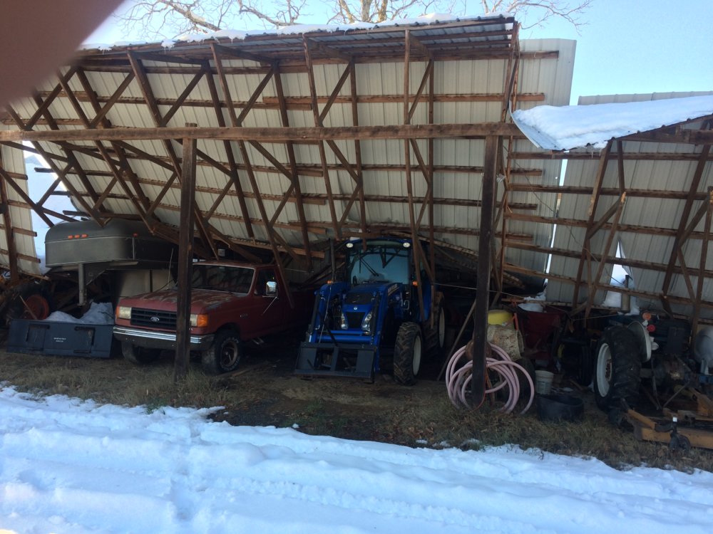

My moms carport did not hold up. 24x20. Took the truck with it, waiting to hear if insurance will pay to fix it or total it. Truck has less than 70k on it and she just paid to have air bags added for towing, replaced the power steering pump and all 4 disc brakes with new tires. Major kick in the face to her if they total it.
