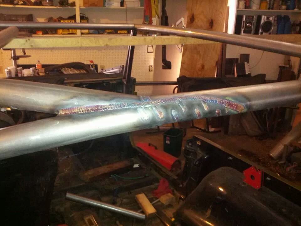

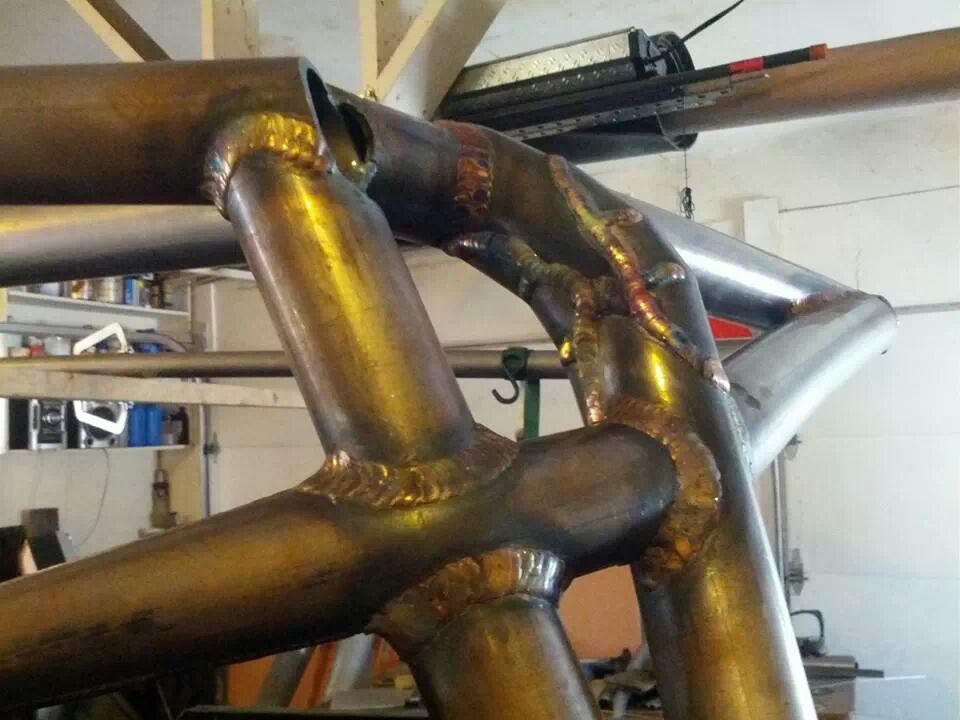

te="jeepmedic, post: 1226438, member: 19279"]The long welds look cool but I have to ask are they as strong as a solid piece of tube? Looks to me like it would add areas that could fail or shear/tear?
The idea is to create a certain attitude within the appearance of the cage. The outer foundation of the cage is already good and strong. The tubes you are talking about are nothing more than reinforcement. Just trying to clear that up, because I know it's been a big question.
As long as you call it what it is--fancy tubework instead of the strongest cage. You can tell by the colors that your cover weave puts a lot of heat into the tubes=bad. Is there any way to keep it looking as nice while only welding small sections at a time? Haters gonna hate, but if the whole thread is about you being the best--expect some criticism.

The cage is interesting, and I know you say the outside is strong, but it looks like dead nodes all over, lots of heat along the tube that will weaken it, and blind spots created where the tubes intersect.
