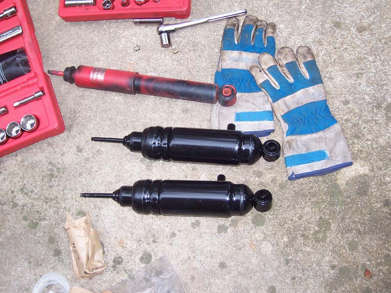

here are some pics of the shocks I got
these are them on the ground..

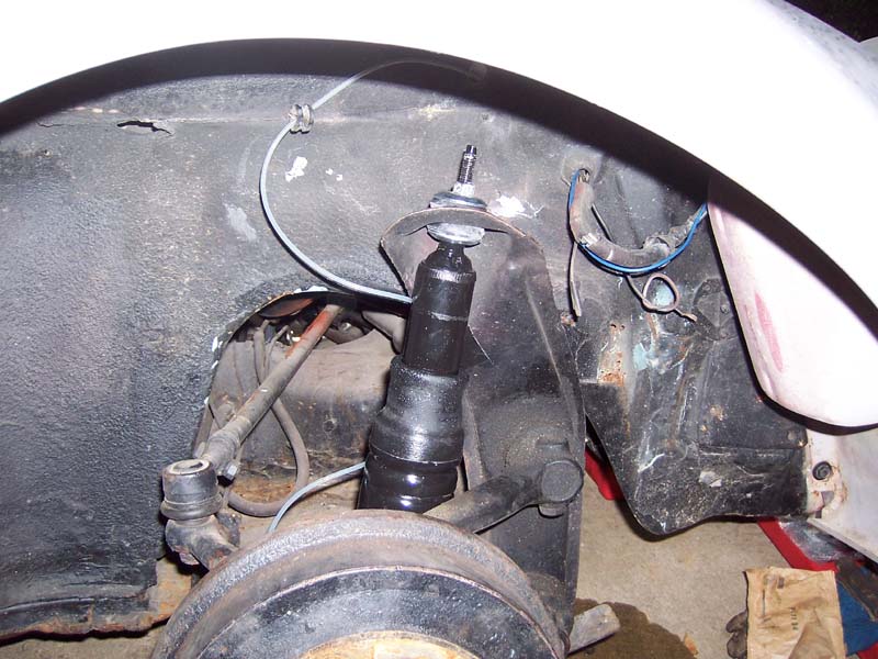

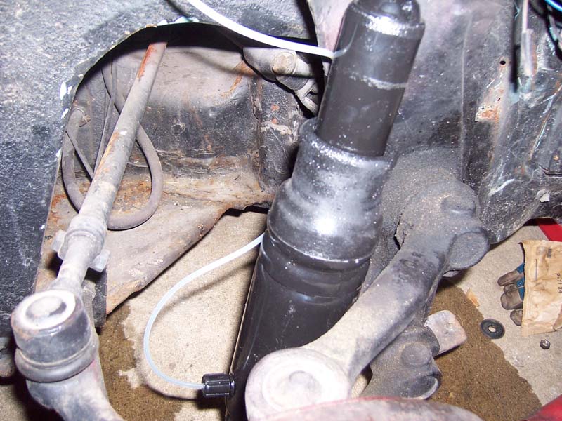

here they are installed and air lines hooked up.
I have not installed my air compressor or air tank that will come when I make some mounts for the rear air bags I have from an old project..
I actually used a bicycle pump to test these and sure as shit they worked..

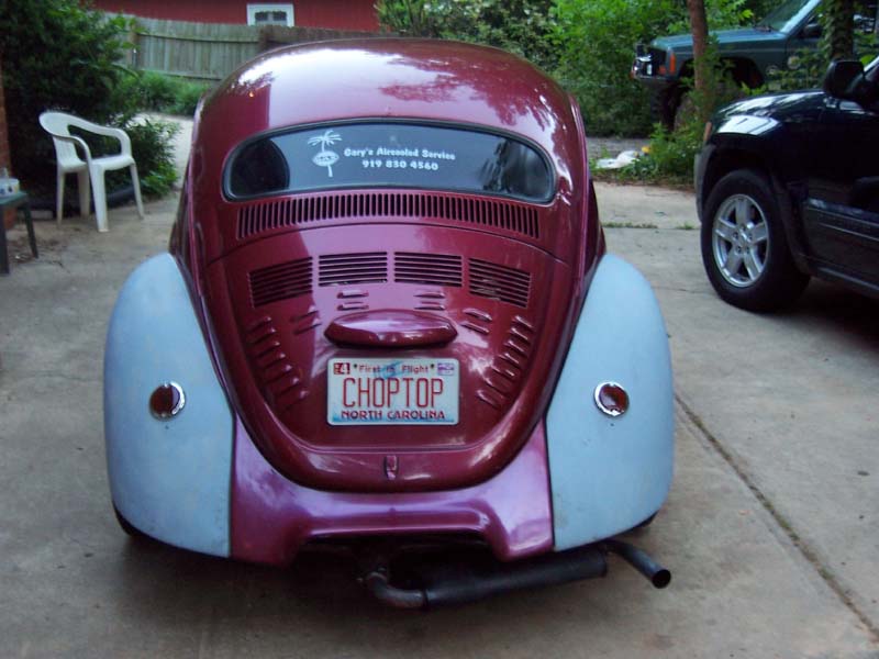

as for the decklid.. I have another one that all I need to do is go pick it up :) so that is taken care of.. but I am not 100% against the louvers on the front.. but I do not like them in the rear.. the 2 things I think I am going to change is the rear lid and the rear apron..
