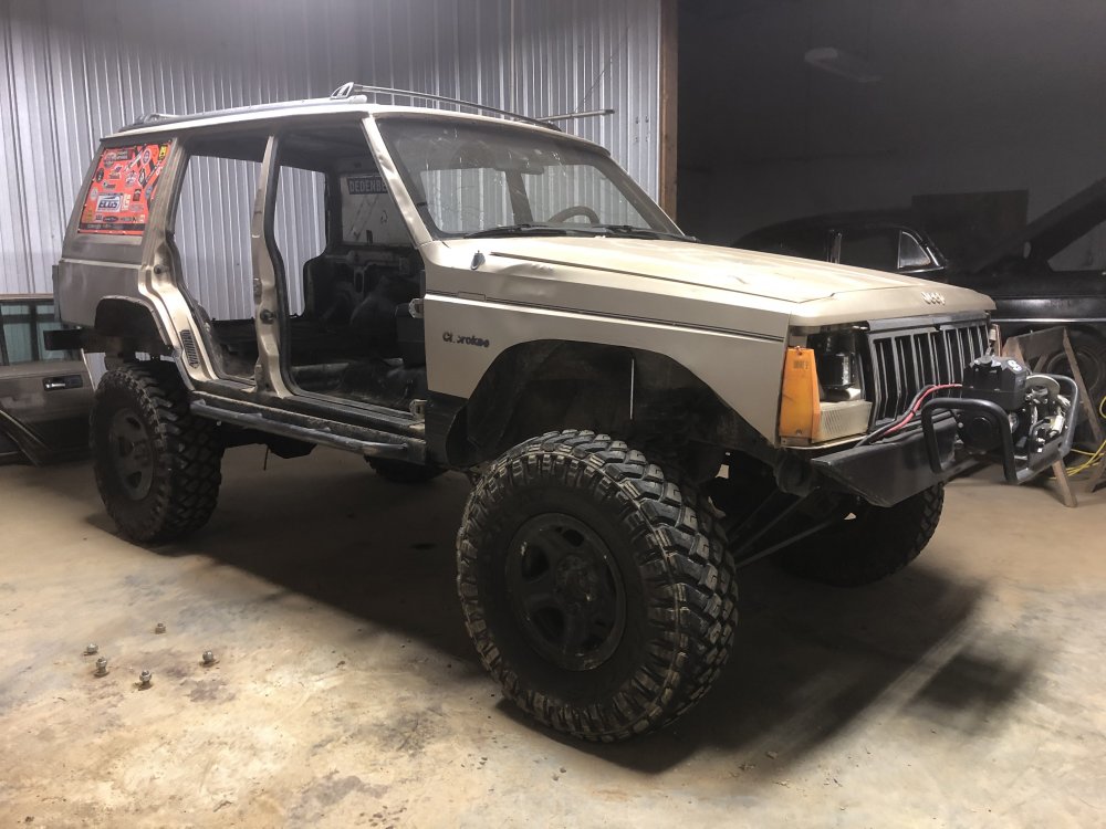

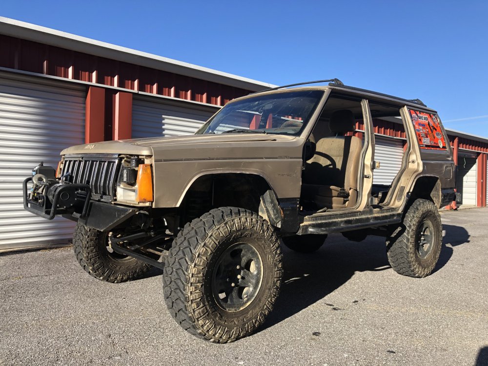

First XJ build

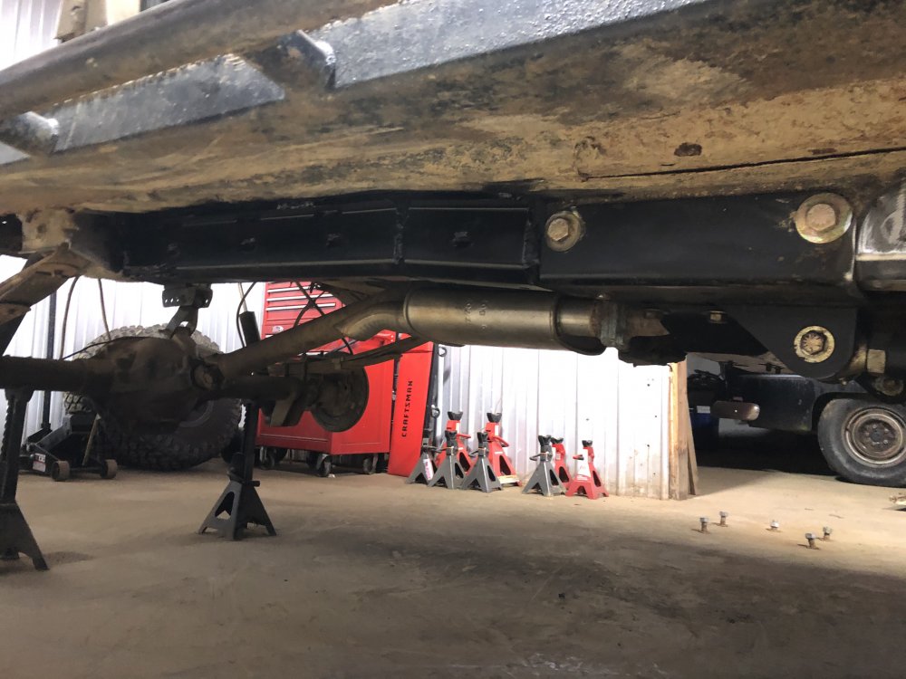

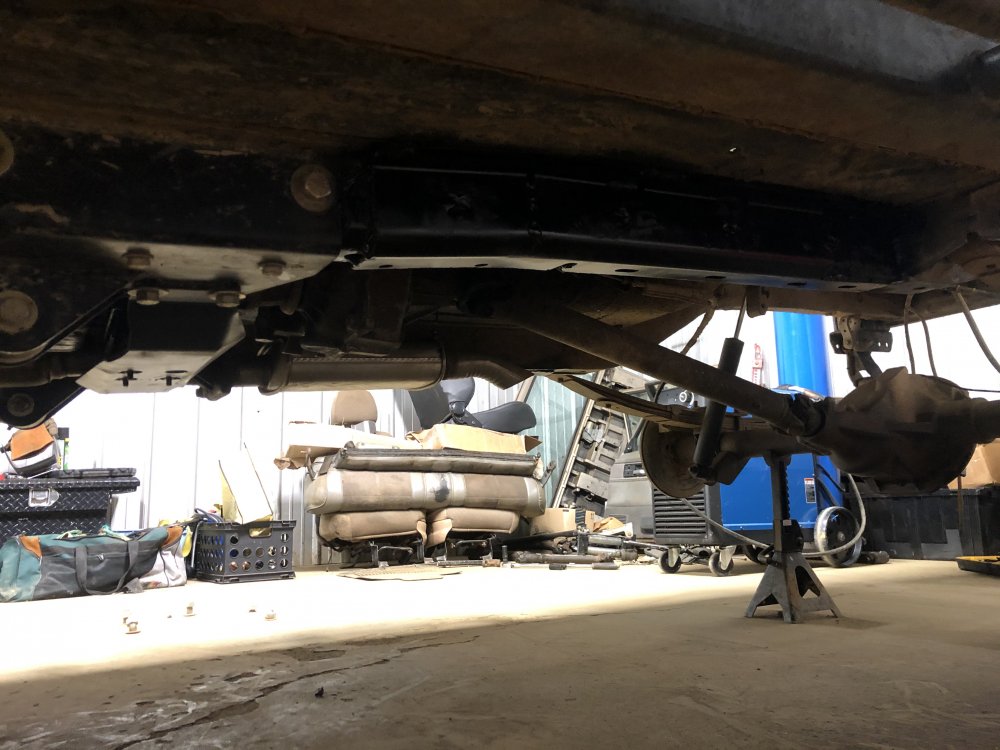

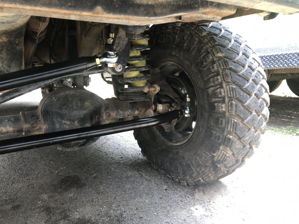

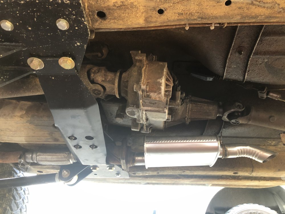

The passenger side link required some exhaust modification - finally got around to finishing the exhaust today

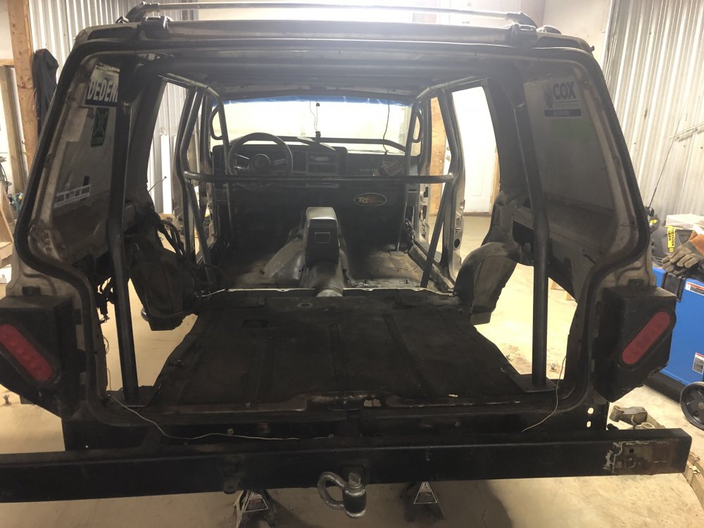

Ordered the D&C 6 pt cage kit, Ruffstuff unibody front and channel stiffeners, Airtex 8248 pump, and RCI2161A cell today.

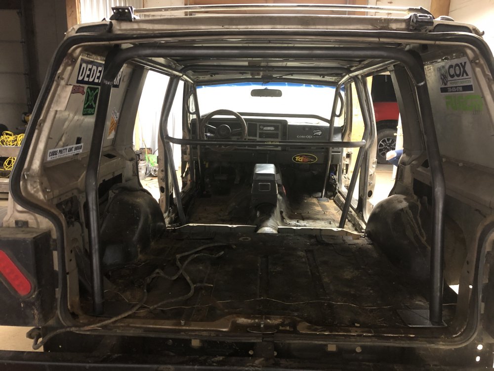

Did you opt for the dom over the hrew? Are you planning to add extra triangles?
When I was looking at a cage for my cherokee those were two things that made it hard for me to find a cage kit that had enough triangulation to suit me and was made out of dom. I personally think the hrew would be strong enough with enough triangulation unless you are planning to launch it off mountains lol.

@Keith1138 I got the HREW version. I really just wanted a good start to a cage and I’ll finish it out how I want. By the time it’s done, it should be way more triangulated/braced/tied into the sub-chassis than D&C ever considered :)

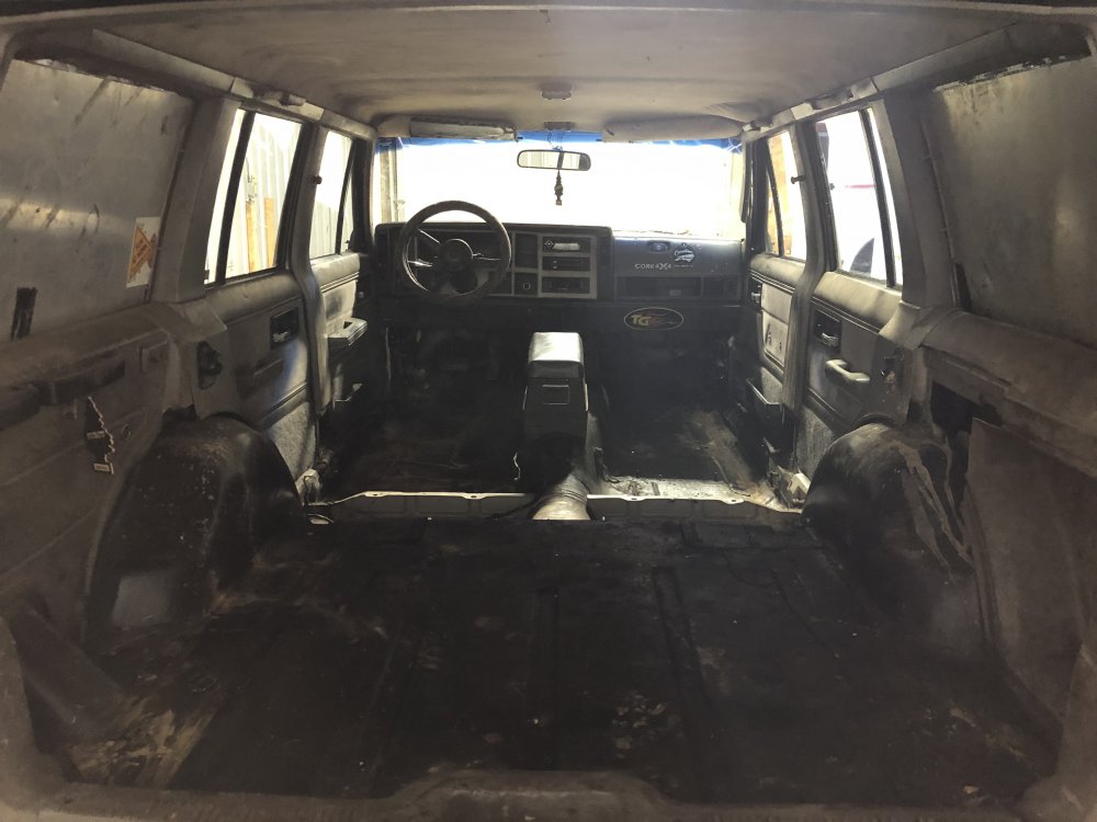

Weight Watchers in action

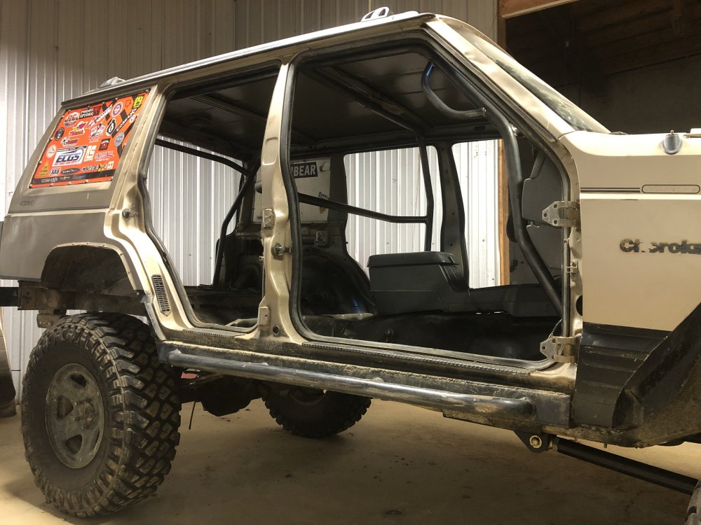

Did some trimming

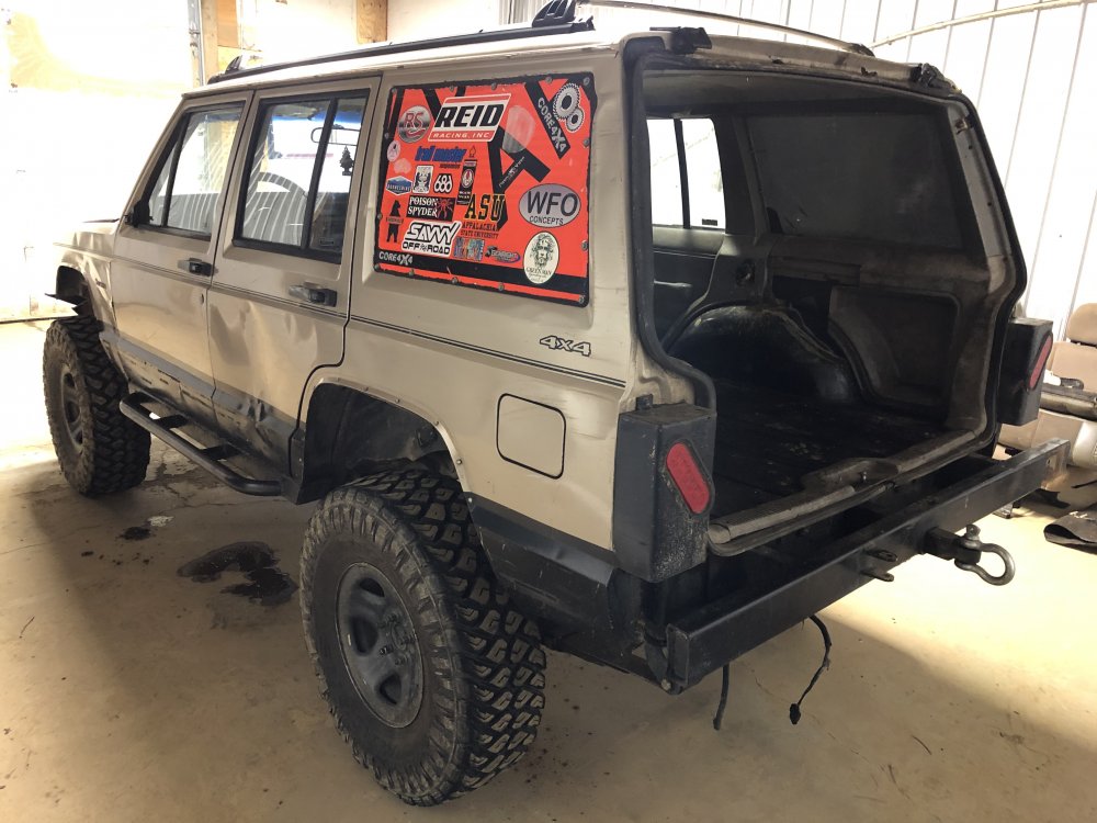

I definitely like the buggy route and entertained that, but I’ve fallen in love with my road signs too much to abandon them. I’m essentially building around them at this point :poop:

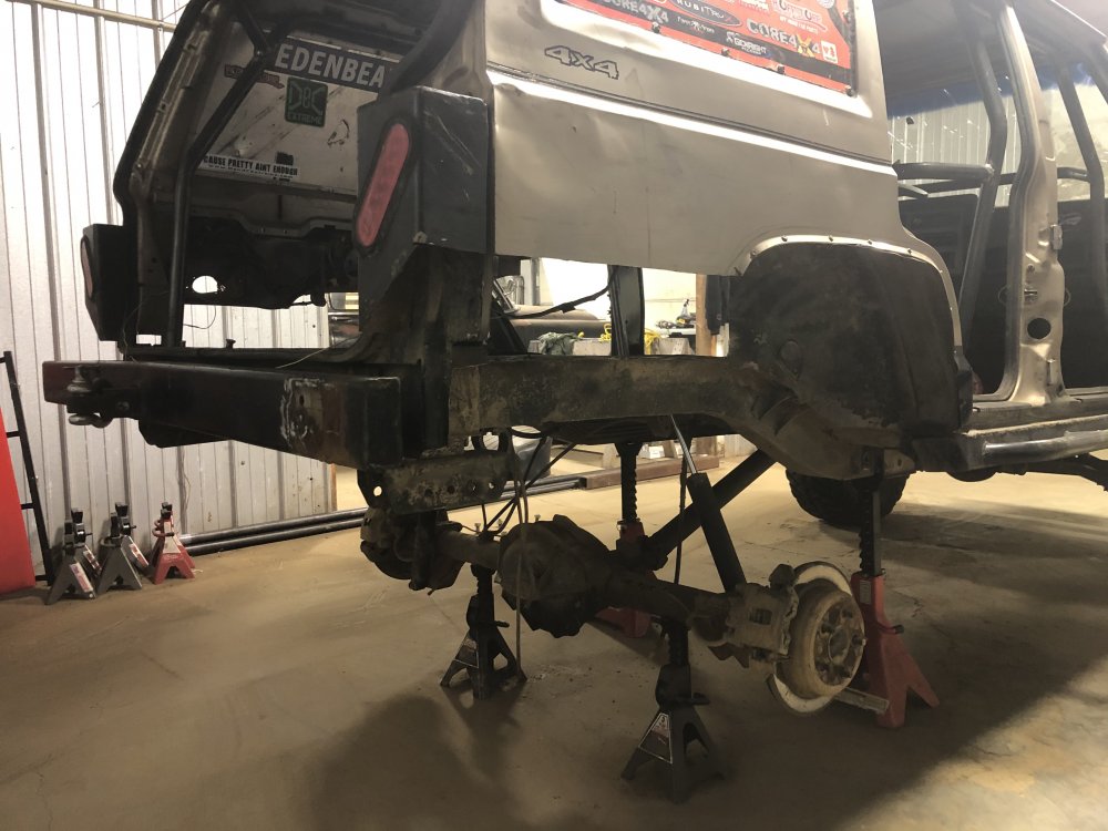

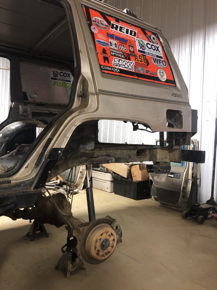

Also the cage kit I got fits a XJ body. It should be arriving via freight this week. The back is cut more than it looks. I cut up to the taillight. It might get a comp cut sort of thing; haven’t decided yet

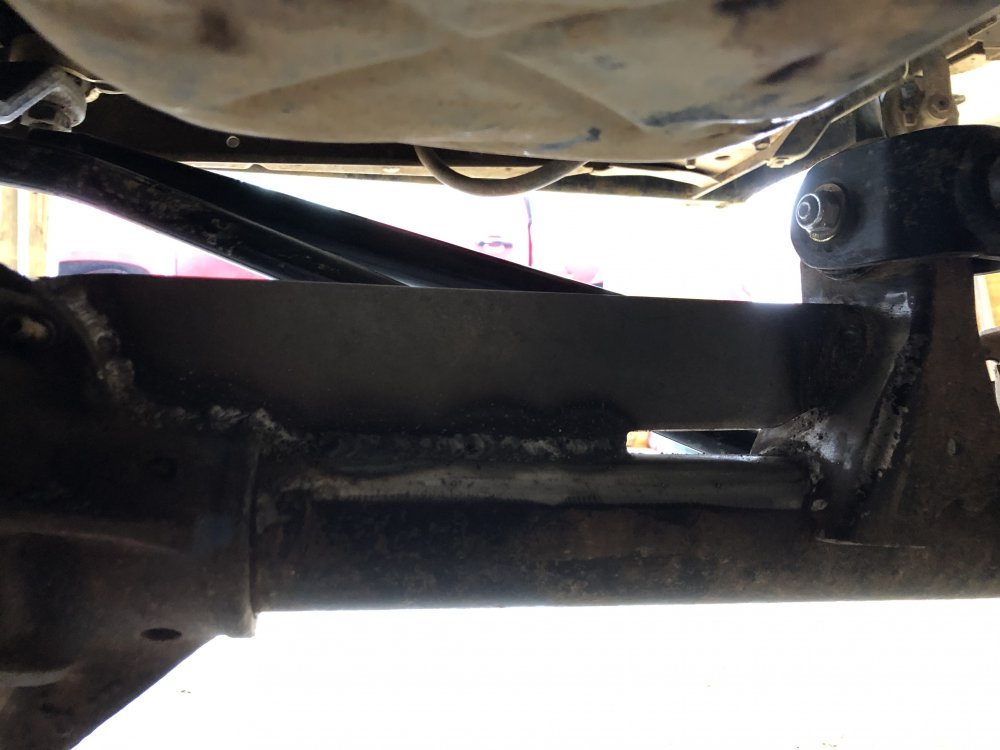

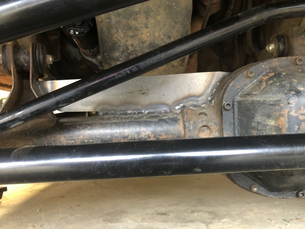

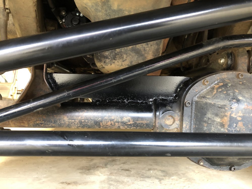

Frame stiffeners are terrible to install. Don’t let anybody fool you otherwise
@NickMaul definitely!! Welding it all back together though - jury is still out on that

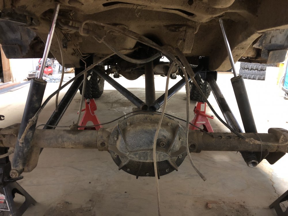

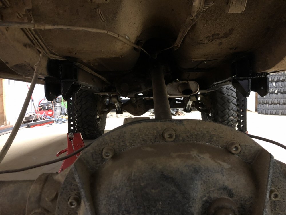

Tonight I got my “frame” side link brackets built and welded to the frame stiffeners, then starting mocking up the rear 4 link geometry. The lowers on the axle end are about 2-3” lower than they’ll actually be; should end up pretty flat.
The rear axle will be about 3-4” back from where it is now once the axle side brackets are on.
