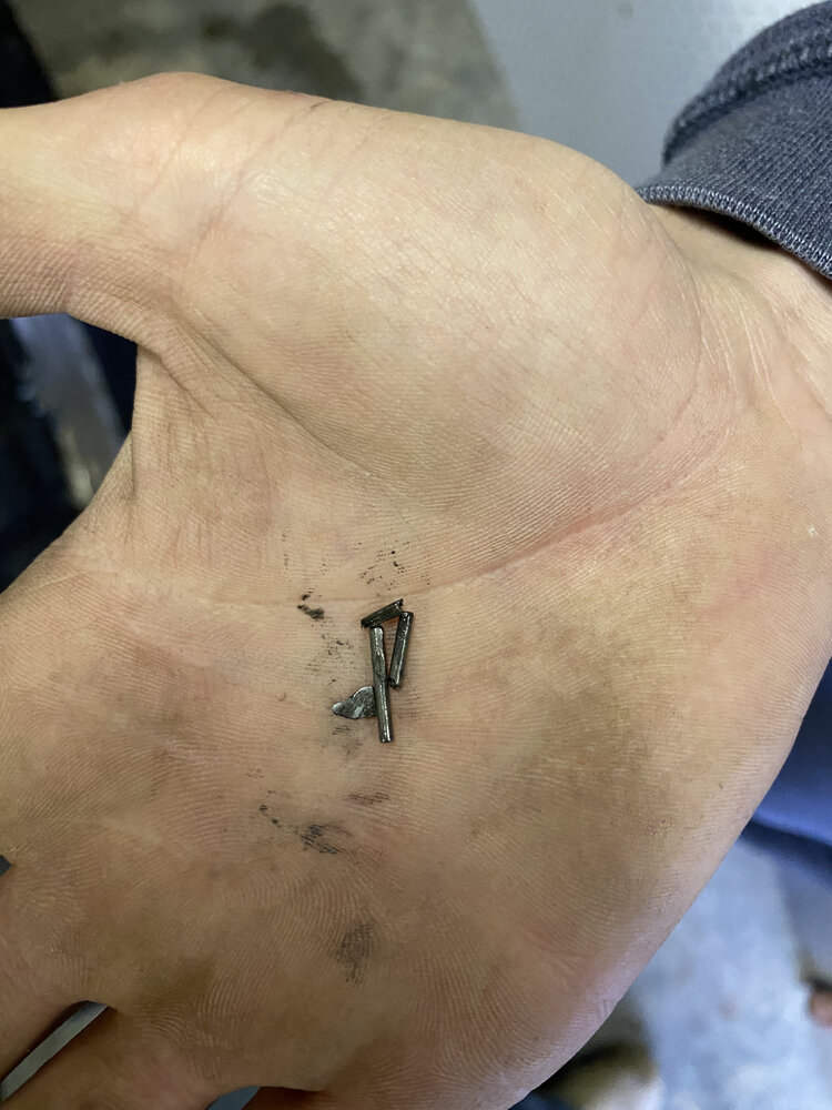

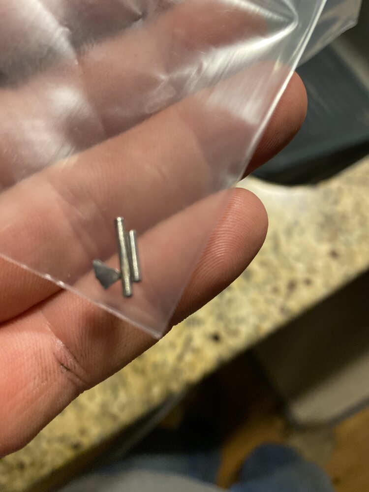

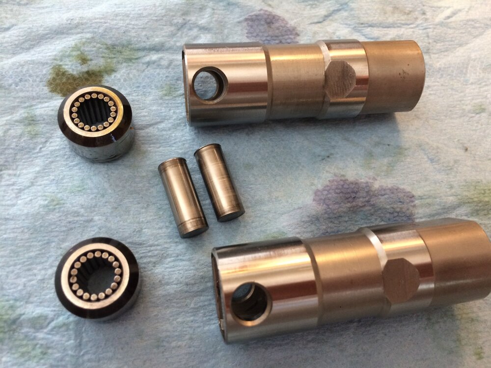

This is an LS motor 6.0. I went to change the oil and found what looks like needle bearings on the drain plug. The longest one measured 12.5mm in length. The others looked broke so I didn’t measure those. I feel this is to long for rocker needle bearings. So I’m thinking it maybe the lifters (which are new LS7 style). There has been no noises that make me think anything would have been wrong. I just don’t want to pull the heads and the lifters be ok. Any advice would be appreciated. 336-688-2071 is my cell if that’s easier.

View attachment 364431View attachment 364430

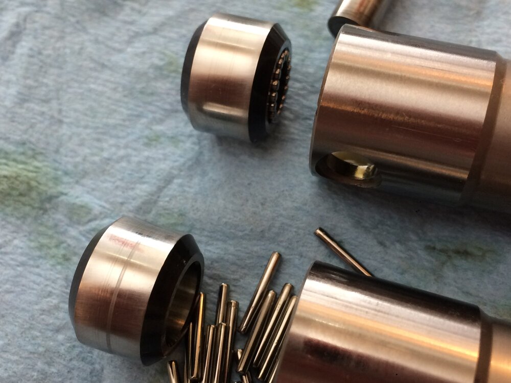

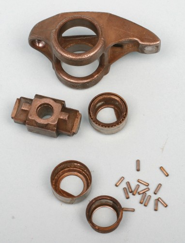

I did the trunnion upgrade on my rockers and I’m pretty sure I might have the old stuff in the shop. I can check in the morning and take a quick measurement for comparison. They look like rocker needles to me.
My first thought is rocker arm needles, but they're only about ¼" long. A ½" long pin is from a lifter. So, have they been replaced before? If so, these were the pins that came out of them and fell in the oil pan. If they've been replaced, they're not noisy, and you have good oil pressure...then you should be good to go.
If they've never been replaced, then I'd pull a head, pull the lifters on that side, and look at the cam lobes.
I gotcha, we’ll the motor was rebuilt, block cleaned and dipped. New bearings, valve job, valve seals, new lifters, trays, springs, cam etc etc. only thing I didn’t do was the trunnion upgrade lol. Are you thinking this was something left over in an oil galley and has just now made its way to the pan? There are no noises indicating an issue. The motor did over heat on the last trip due to me staying in the throttle for way to long on a hill. Cold start up my oil pressure would be around 75 psi and after the over heat it’s at around 50 psi cold start.

Very easy to check is it's a trunion issue or not. Takes not time to pull the rockers.

Yeah I pulled the rockers couldn’t see an issue. I’m going to double check today to make sure I didn’t miss something. So I’m trying to figure out if it’s old parts or a new issue. Really don’t won’t to pull the heads. But if I have to I have to.

Looking like we need to pull the heads.

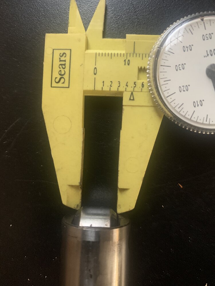

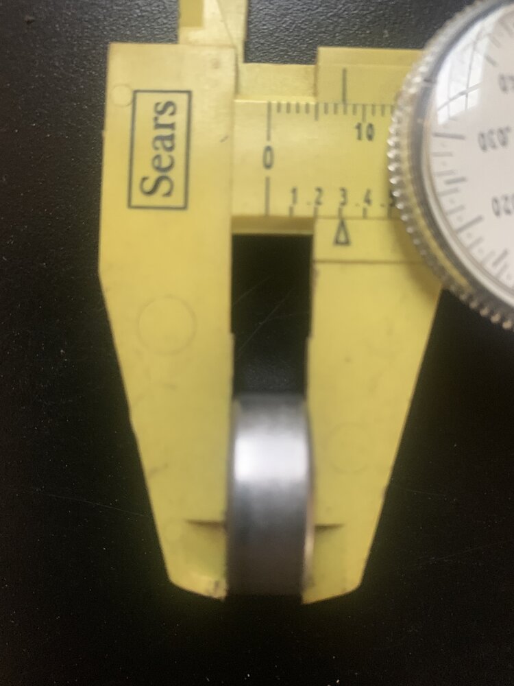

From my old parts, it looks like you’re holding the lifter needles. My roller measures 12ish mm.
And the trunnion needles are quite a bit shorter.
Don't hold me to it, but I "think" some of the guys on the Sloppy Mechanics FB group were talking about having some issues with some of the newer LS7 lifters. Not sure if they were talking about GM or aftermarket ones. Not even 100% sure I'm remembering that correctly.
What brand lifters did you use for the rebuild?

Pretty sure he did LS7 style lifters.

they are BTR LS7 lifters
Since it holds oil pressure, isn't making any noises, and assuming the motor oil didn't look like high end metallic flake paint...I'd feel safe saying it was a leftover that got lodged somewhere.

Not disagreeing, but curious how it could be leftover if the whole motor was torn apart when it was built. Where could the needle bearings have been hiding?

If the block was tanked, but they didn't blow out all the oil passages. Could have been hiding somewhere in the heads. Possibly even already in the oil pan. There's lot of little places it could have sat and been completely out of the way, but the dislodged during assembly or after running it for a while once oil pressure flushed it out. There's no telling. For one of those to have come out now...the lifter axle would have had to have come out or the wheel would be worn in half. He'd have certainly seen lots of metal flake during the oil change, a super fuzzy drain plug magnet, certainly have heard some noises, and likely felt a noticeable loss in power. Or it would have at least been running kinda funny.
