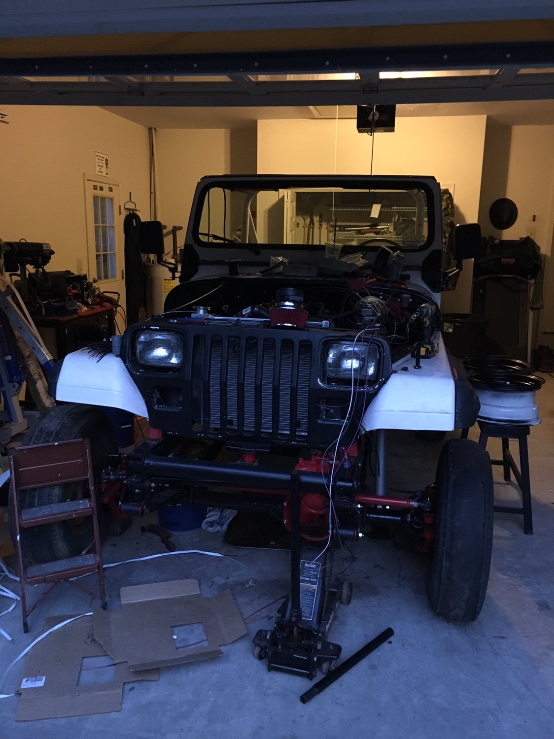

Ugh low motivation today. Got front brake lines hooked up. Had clearance issues with the steering shaft and the rad so temp secured it about an inch higher and when I go put the hoses on I'll finalize its placement.

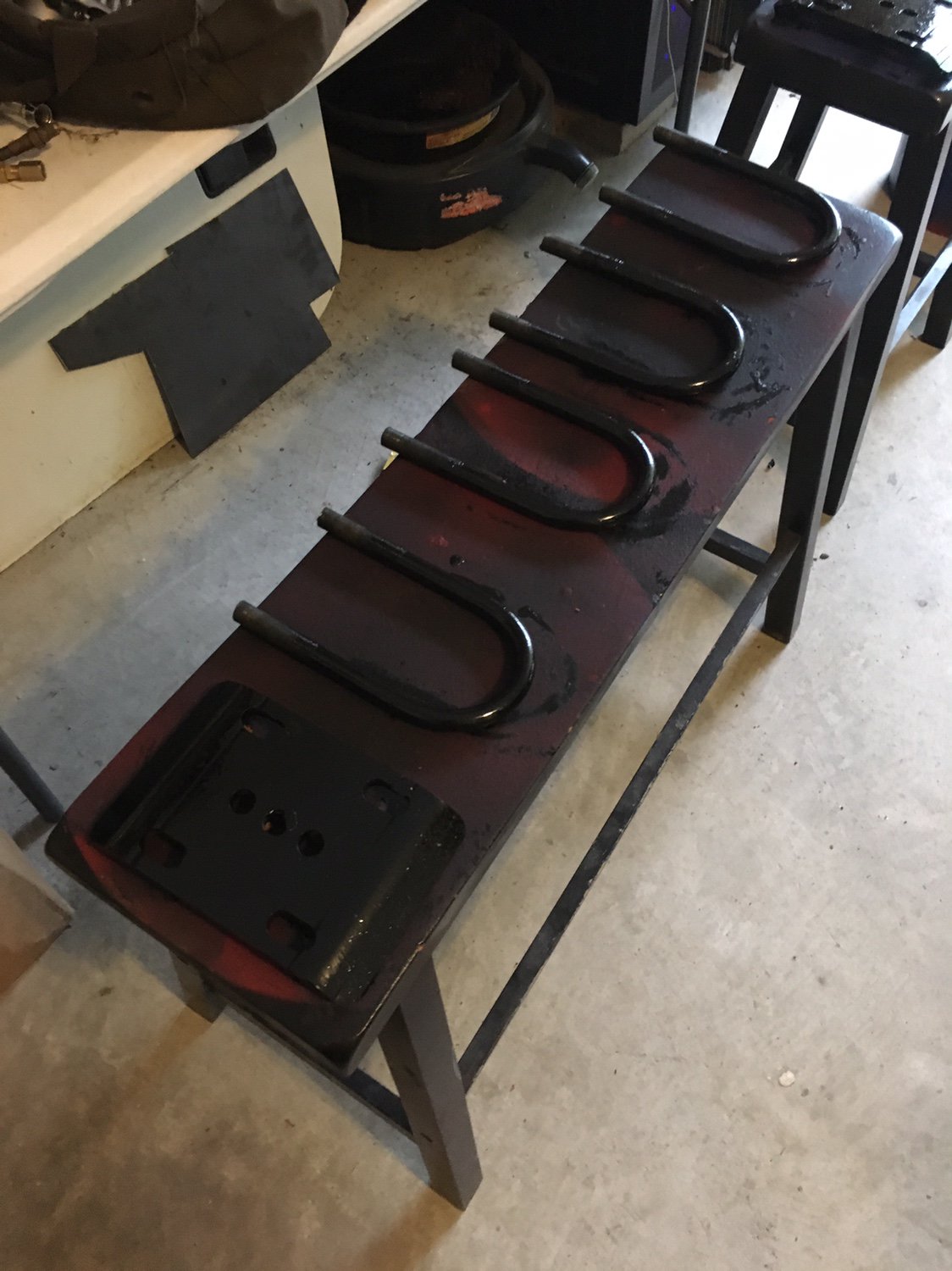

Cut the ubolts.

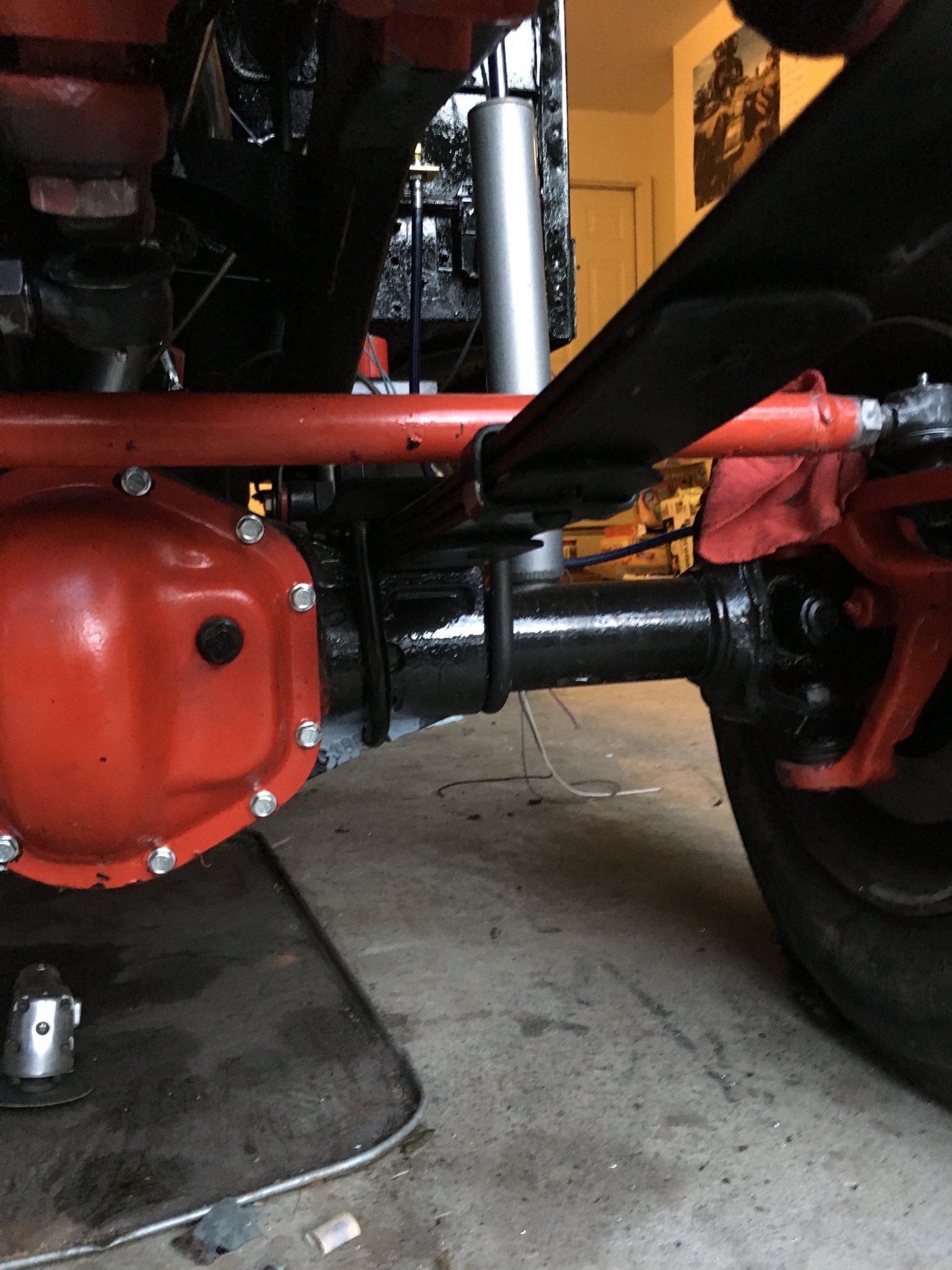

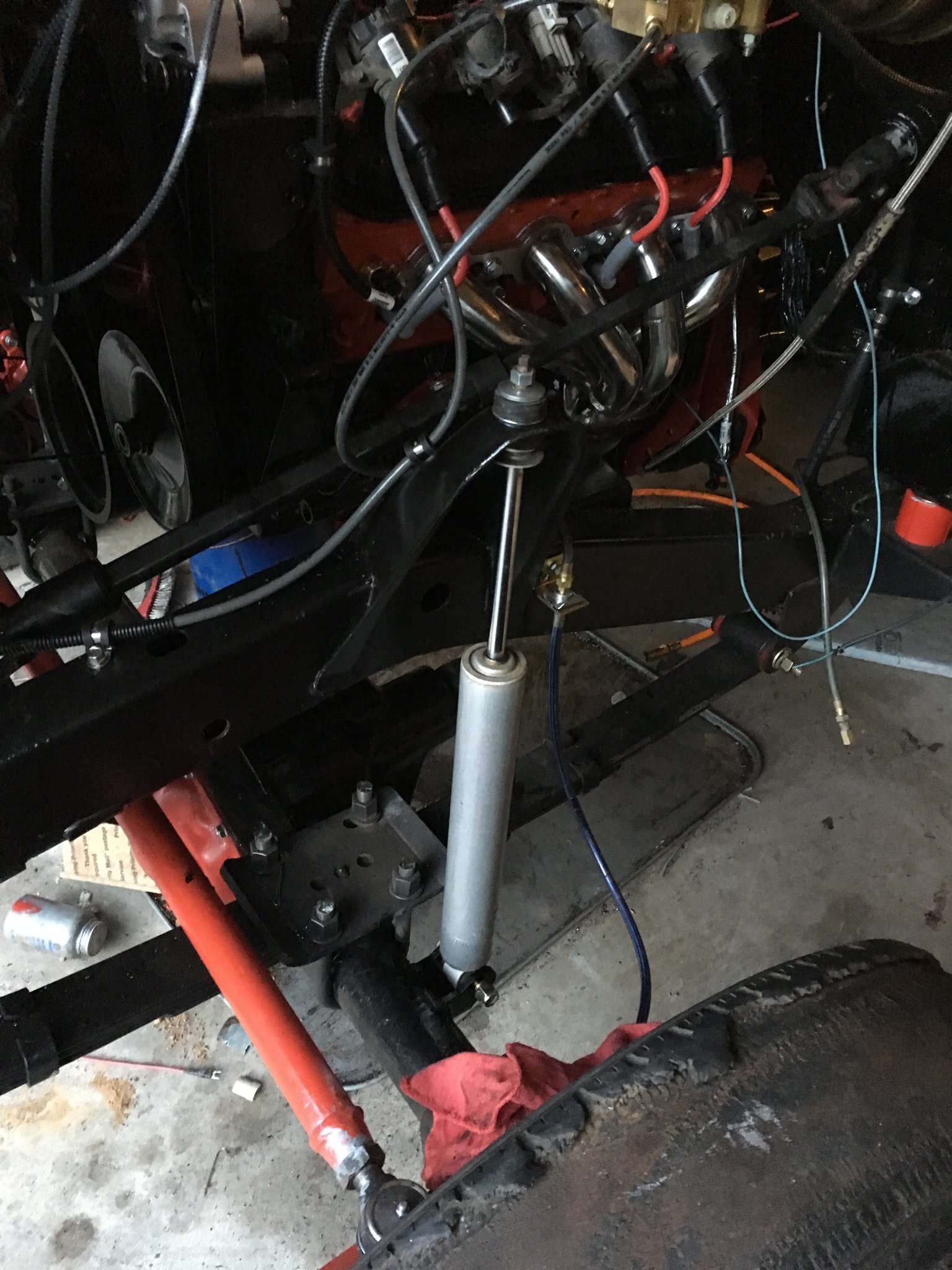

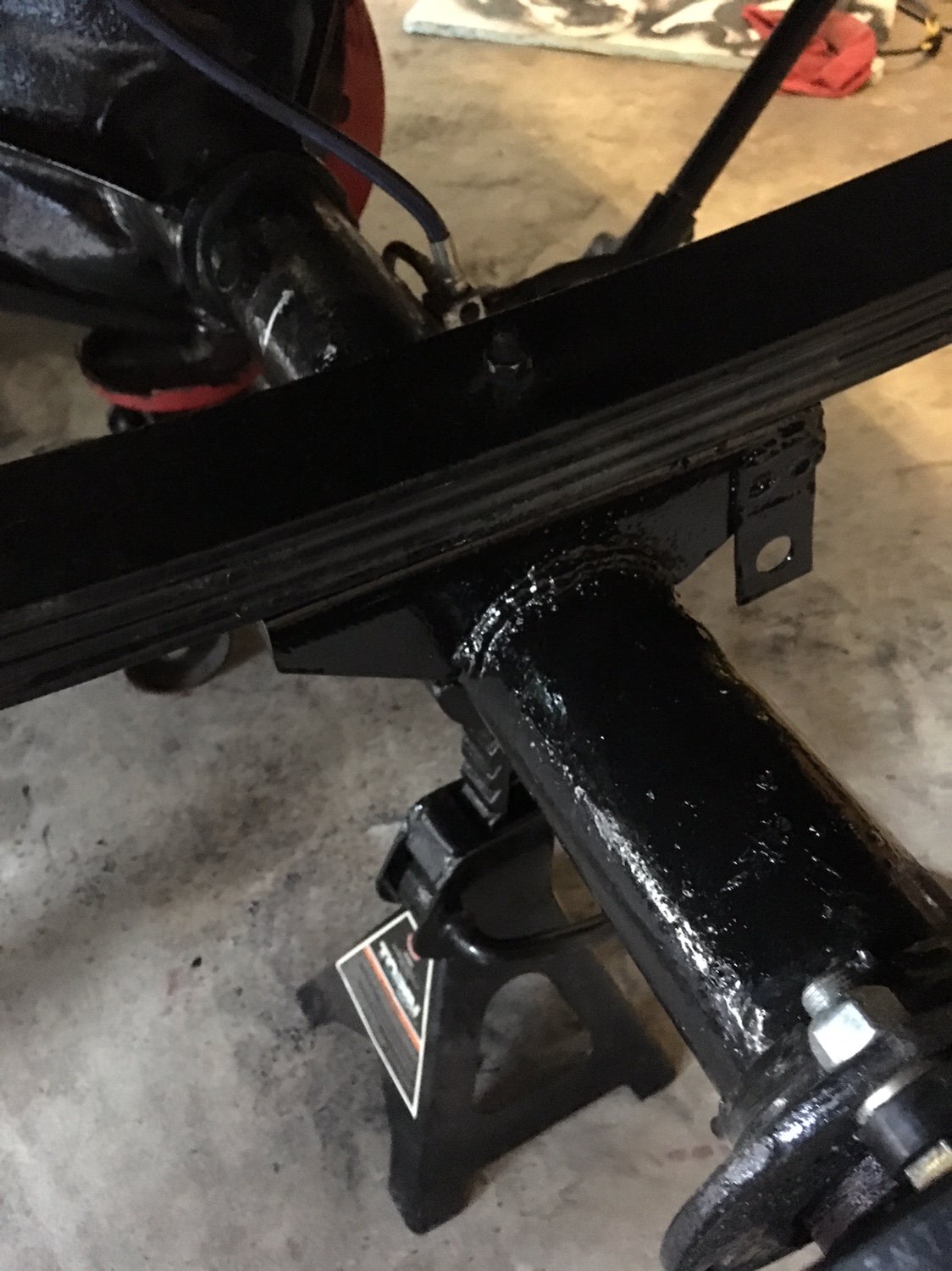

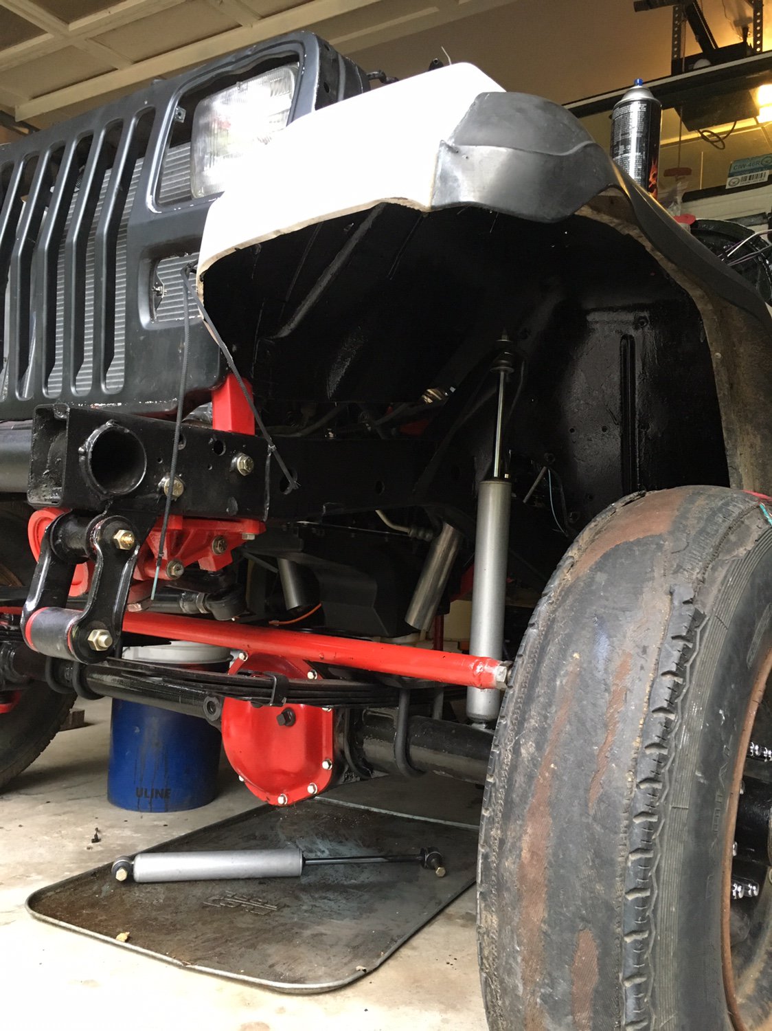

Welded on the front shock brackets and installed the shocks. Exactly as I finished the front I ran out of wire so didn't get to do the rear perches. But I did get to complete the rear brake lines.

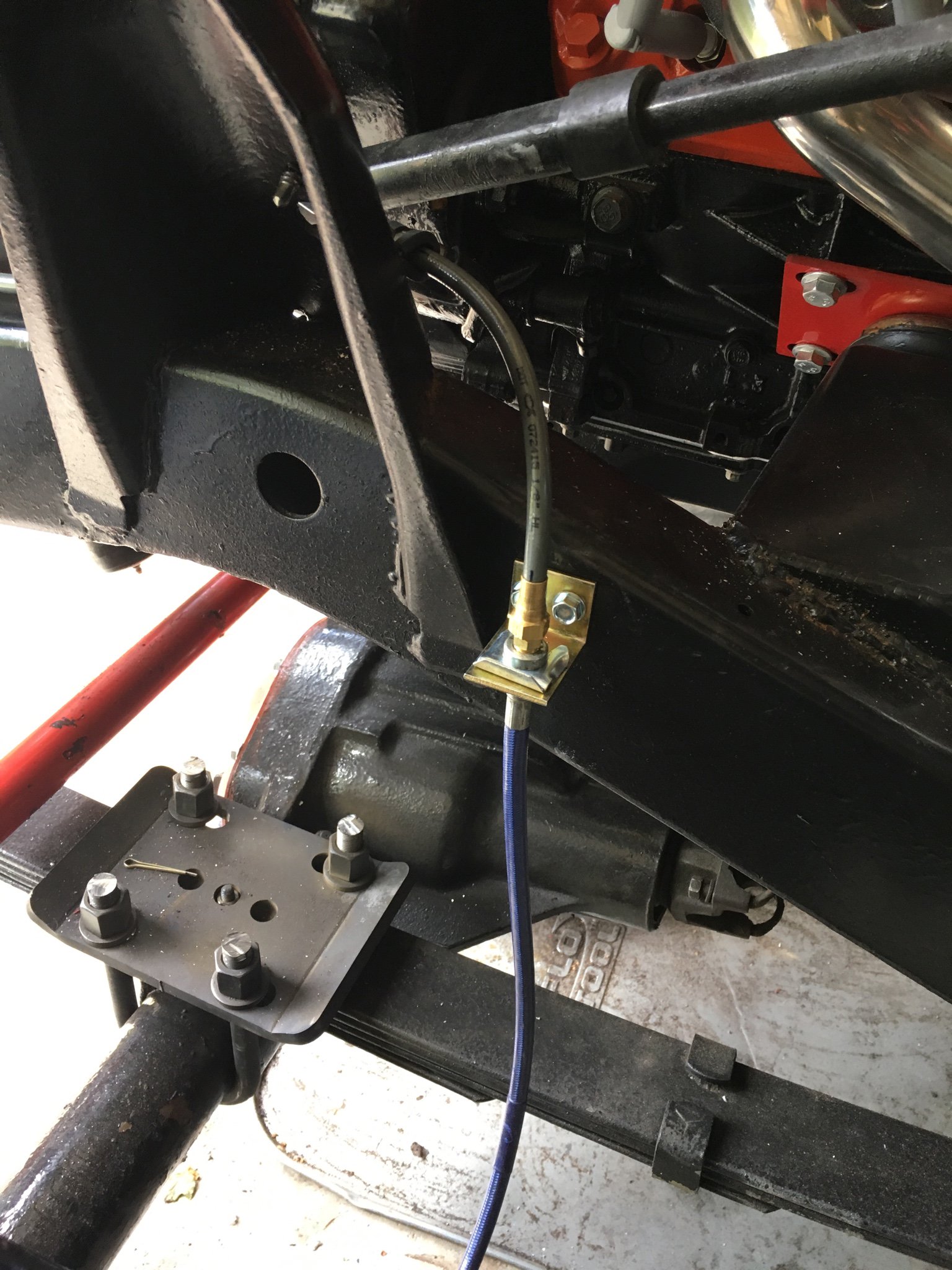

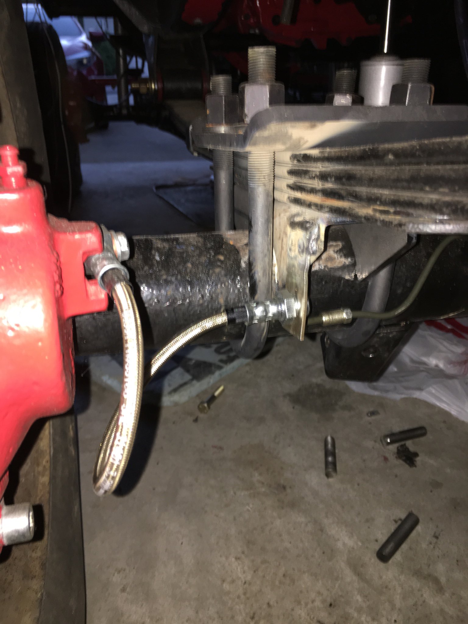

Smashed the L bracket flat and welded to the perches so I can get the rear brake lines secured. Using 3/8 clamps to mount to the diff cover. The only hard line on the whole rig is a 6 inch section for the d side rear to make it from the caliper braided line to the T block.

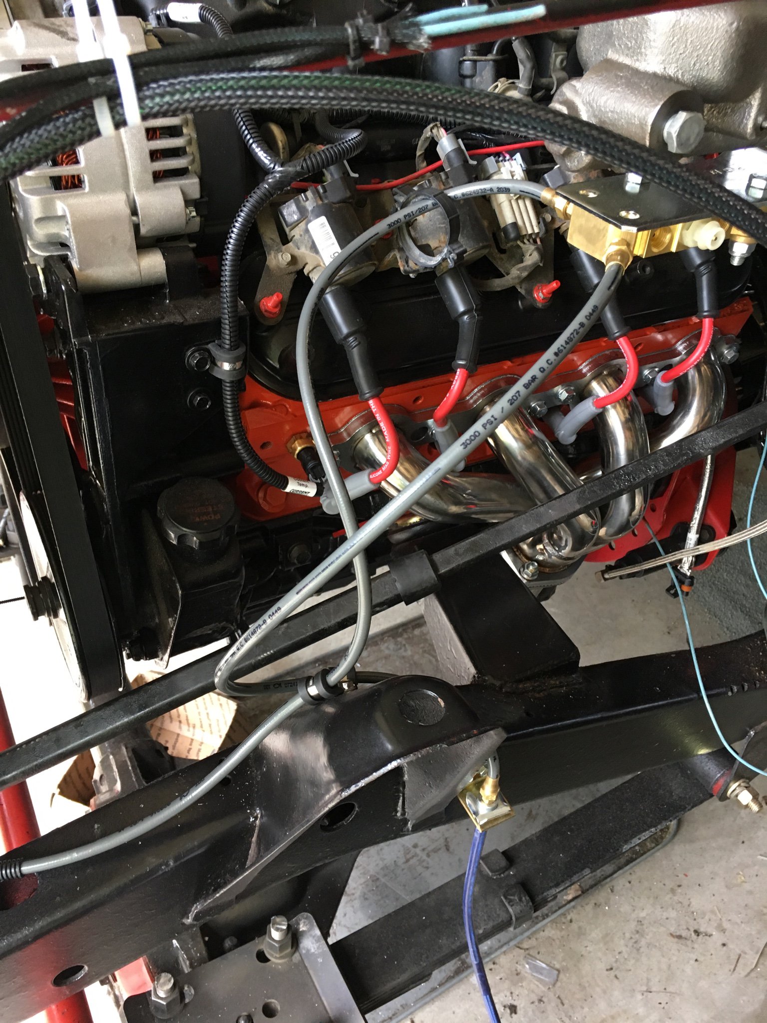

Got the ubolts cut but I think I already said that. Did another start. Sounds much better and more beastly with the MAF sensor installed. Gotta find a good clamp for it and the to be installed air filter.

they might be ok, but id more those tabs above the spring. They will likely get ripped off in that location.

@paradisePWoffrd
I know exactly what you're saying. I was wanting to do that but the caliper is so far and yet too close. Will have to keep eyes open for other options as the future unfolds

installed rad hoses. not excited about the lower hose. the upper works, there was a bend that was ever so slightly restrictive so put a band around it to keep its form. they will work. not happy about the lower (return) but it will work. gunna need to figure out something more permanent as the future unfolds and as i figure out what to do about a fan shroud. only got about an inch to play with but that is only because of the shorty air filter, which is going to get reworked in the near future anyways which will free up another two or three inches.
gunna look into options alt to shroud. like a pusher and puller fan for traffic? dunno.

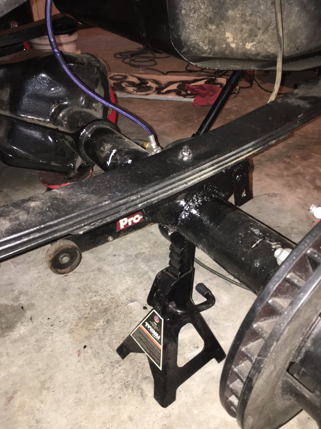

Need to wire in dash indicator lights. When the dshaft arrives all i will need to do is swing by autovance and get a 1310/1330. Then with installed will finalize for sure the pinion angle then weld in the perches. I also noticed this brought the stock shock brackets way up, so may still be able to use these. dont want to weld the shock tabs in case they may interfere with the truss...

Did another start after filling rad. Ran for a bit. Was pretty cool. The autometer temp sensor adapter for the head didn't fit the actual sensor so had to drill it out with a 5/16 bit and then it fit perfectly.

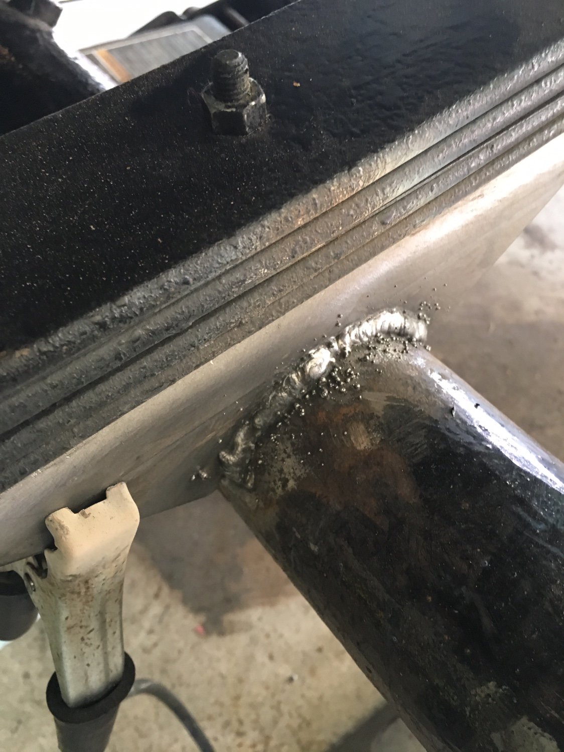

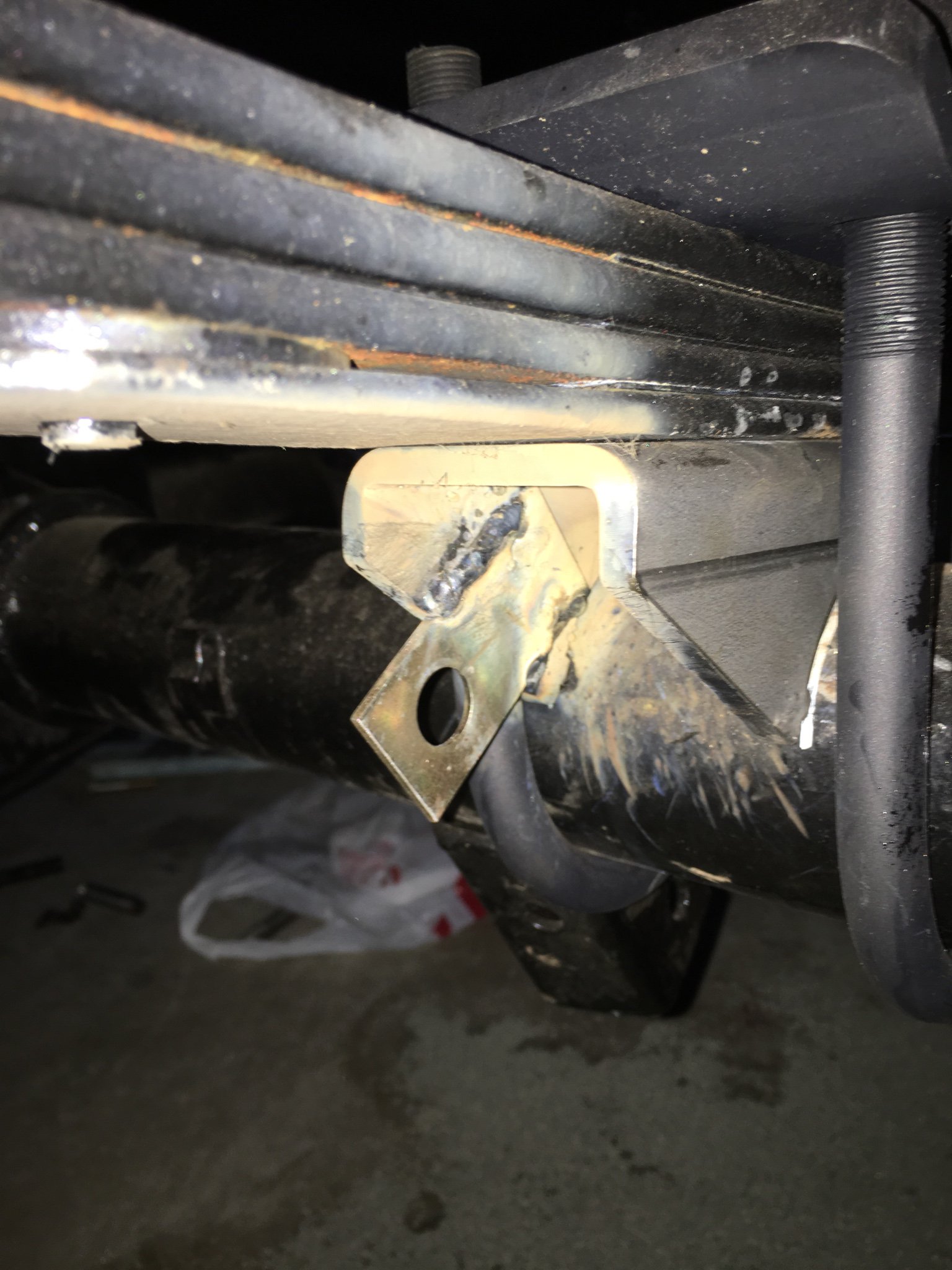

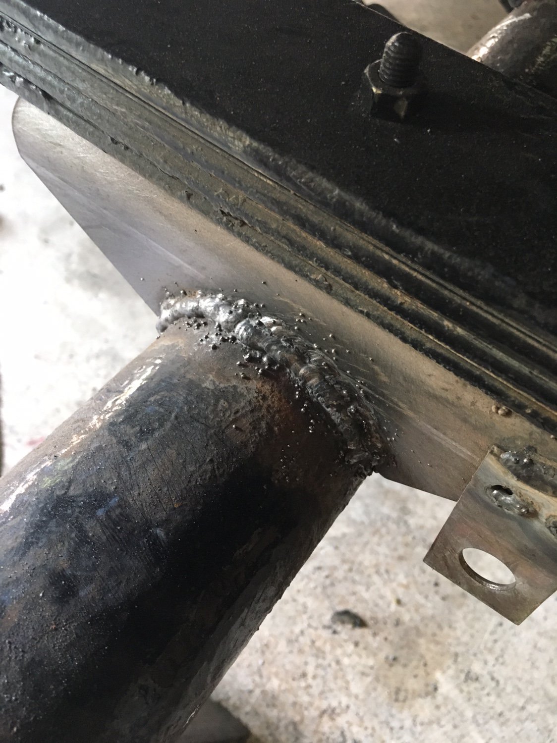

Set pinion angle with some spare tube I had laying around and a angle finder from lowes. Set pinion 2 degrees lower. Welded perches on. I'm happy with the welds but it may be wise to visit the stickman soon and have some better beads laid.

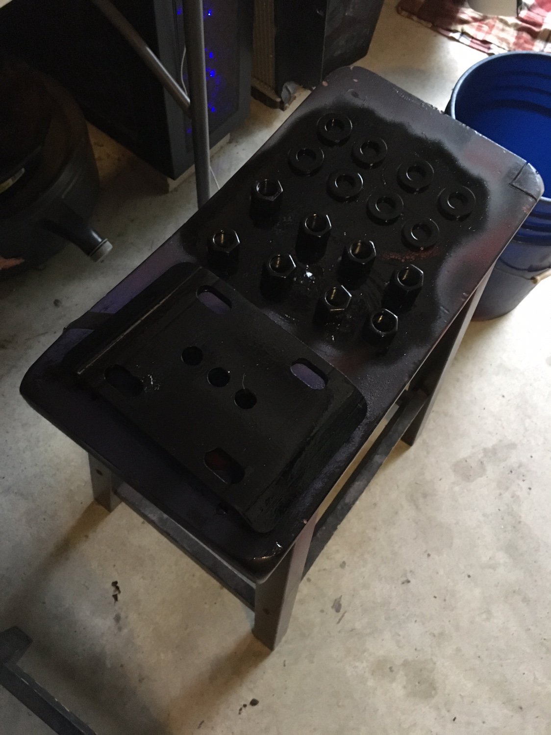

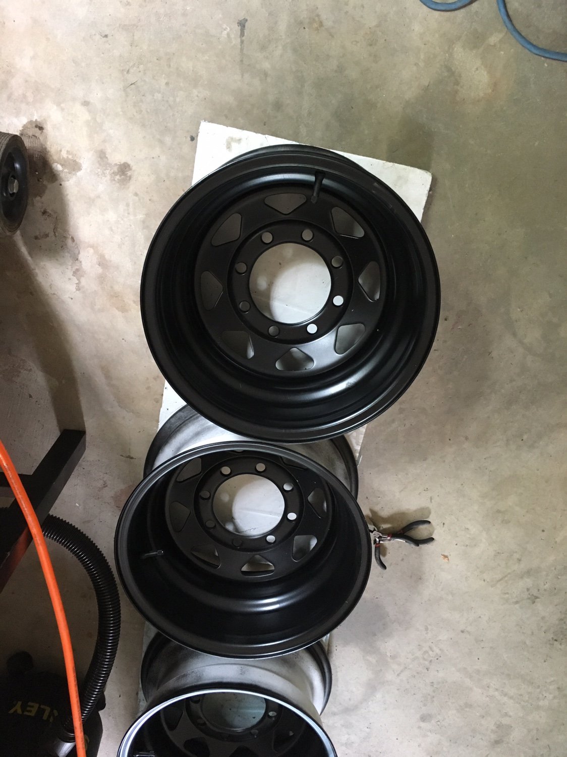

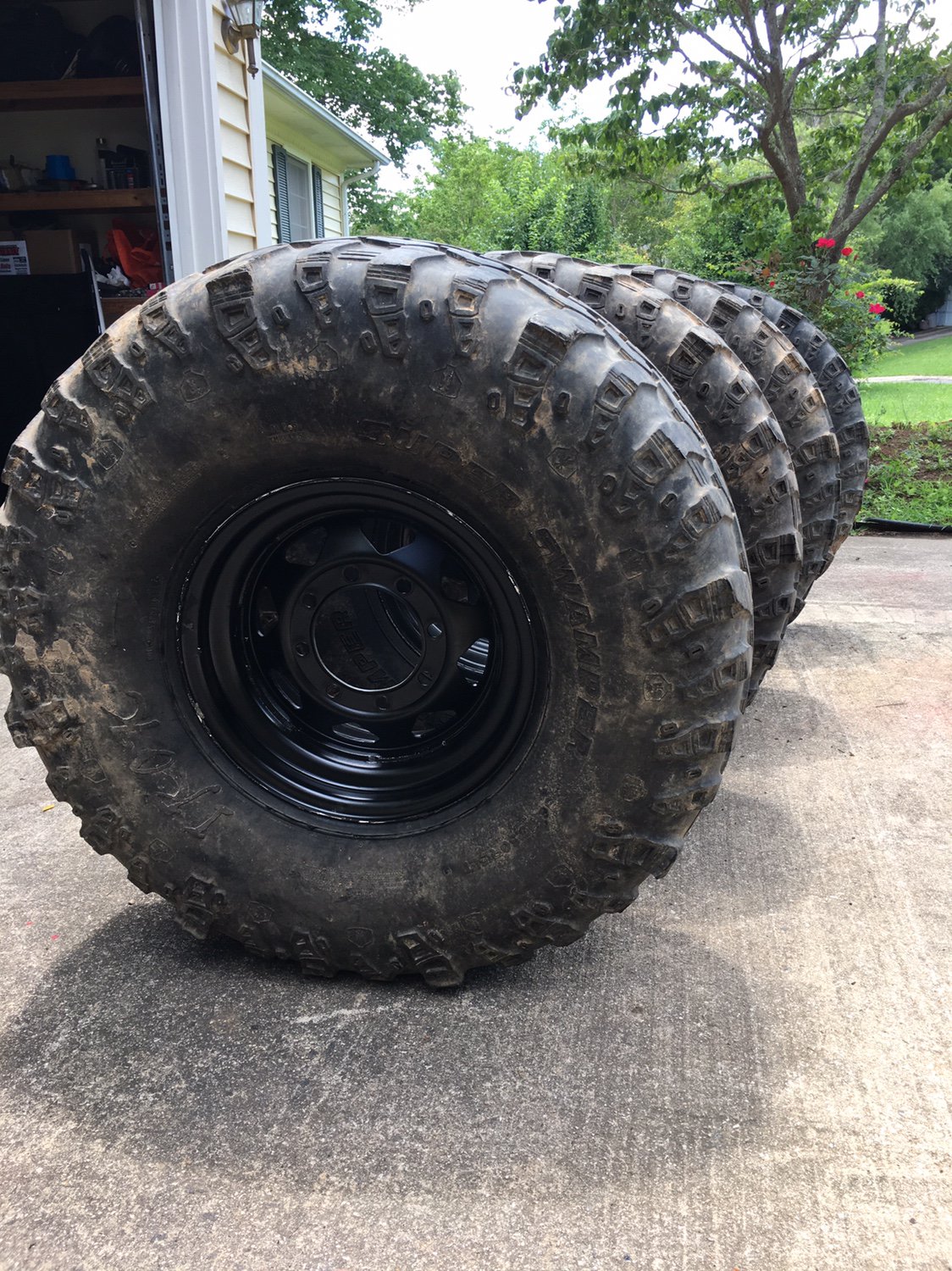

Very little left. Got wheels painted up half assed and got new valve stems in
