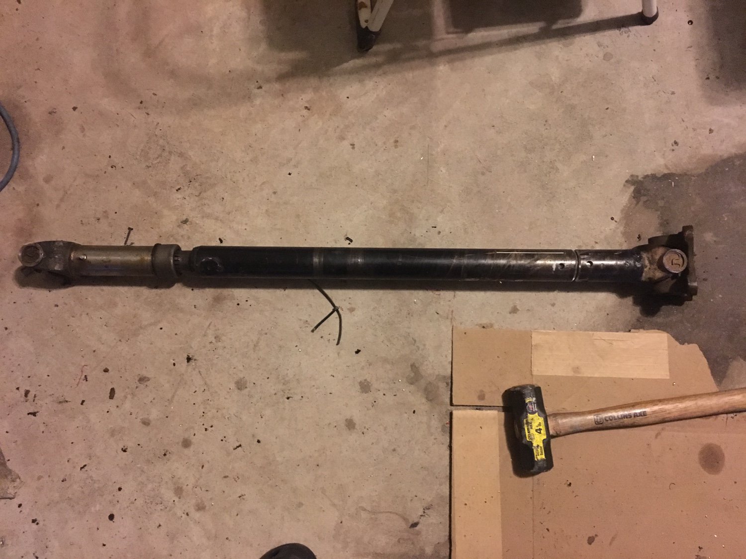

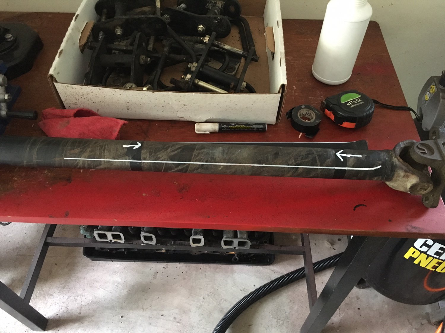

This week my few moments stolen during the day is getting this driveshaft shortened. It's an olivers shaft I believe. Super stought!! Picked it up from a super cool dude I know.

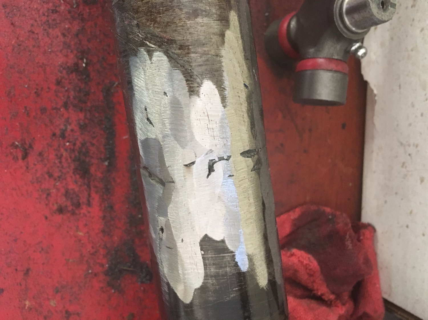

Anywho. Got my measurement transferred to the shaft. I'm really worries about uptravel clearance but nothing I can do until I actually have a front shaft installed. Tonight gunna read up on "how to cut metal like a pro" and also reread "what to do without a band saw". I used some electrical tape for guide lines. And trying to keep the sleeve area towards the Tcase end which has the most space.

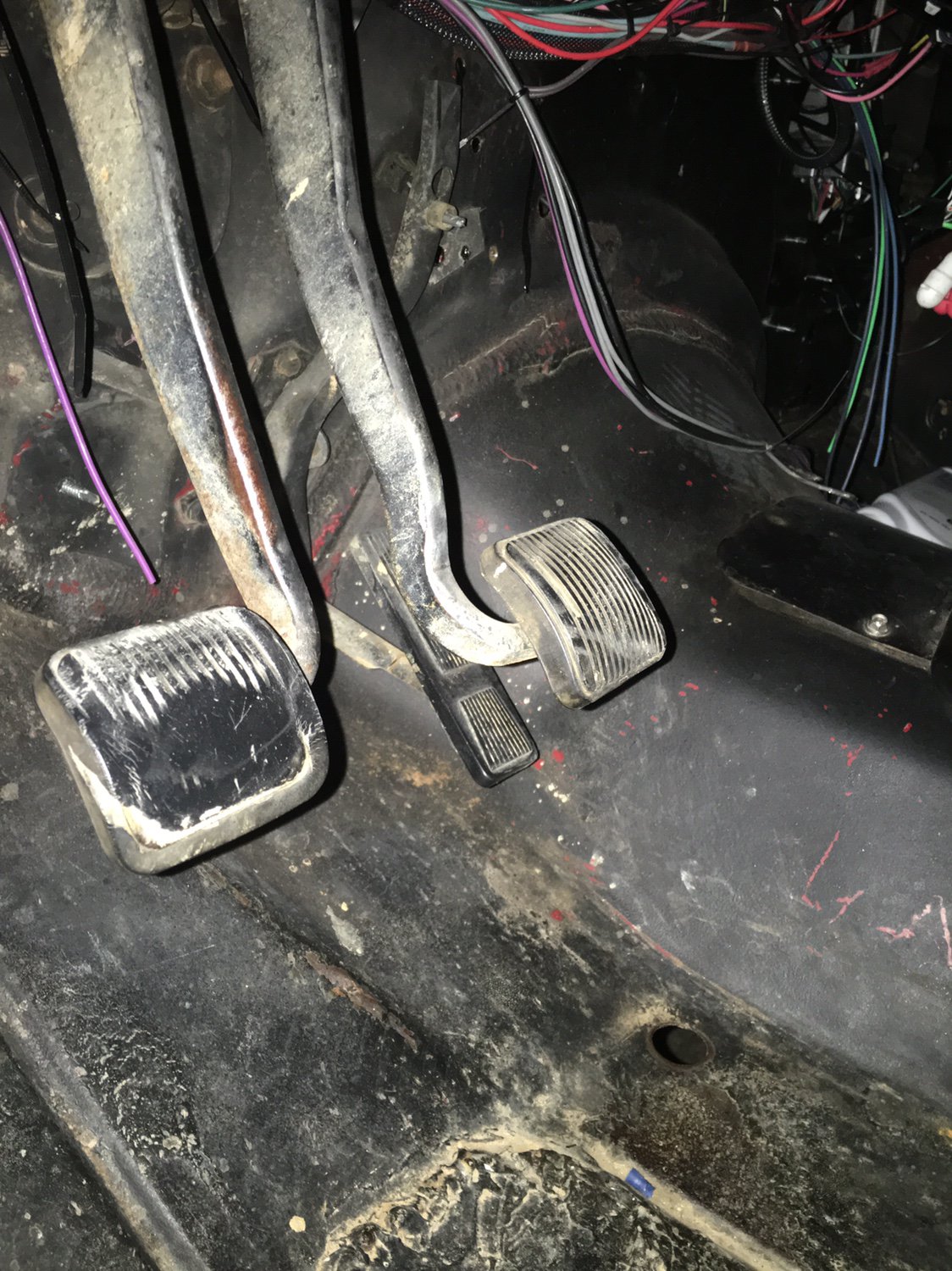

Tried to lengthen the throw of the brake pedal to see if it would solve my inability to lockup my tires. Not even close. And that 3/8 of rod extension placed that pedal as high as the clutch pedal. No go on that. Got to shorten the rod again. I bought a brand new MBM double diaphragm booster, but the master is a stock CJ/YJ - need to look into doing the Dodge 2500 upgrade. If that doesn't work may need to reconsider my flexible brake lines front to back and go hard line.

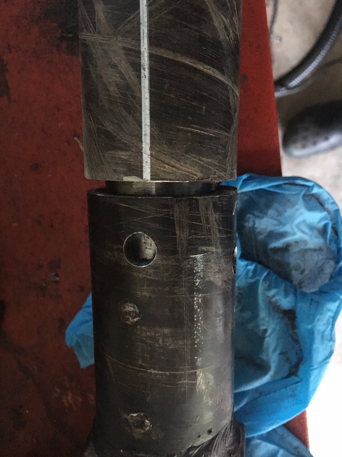

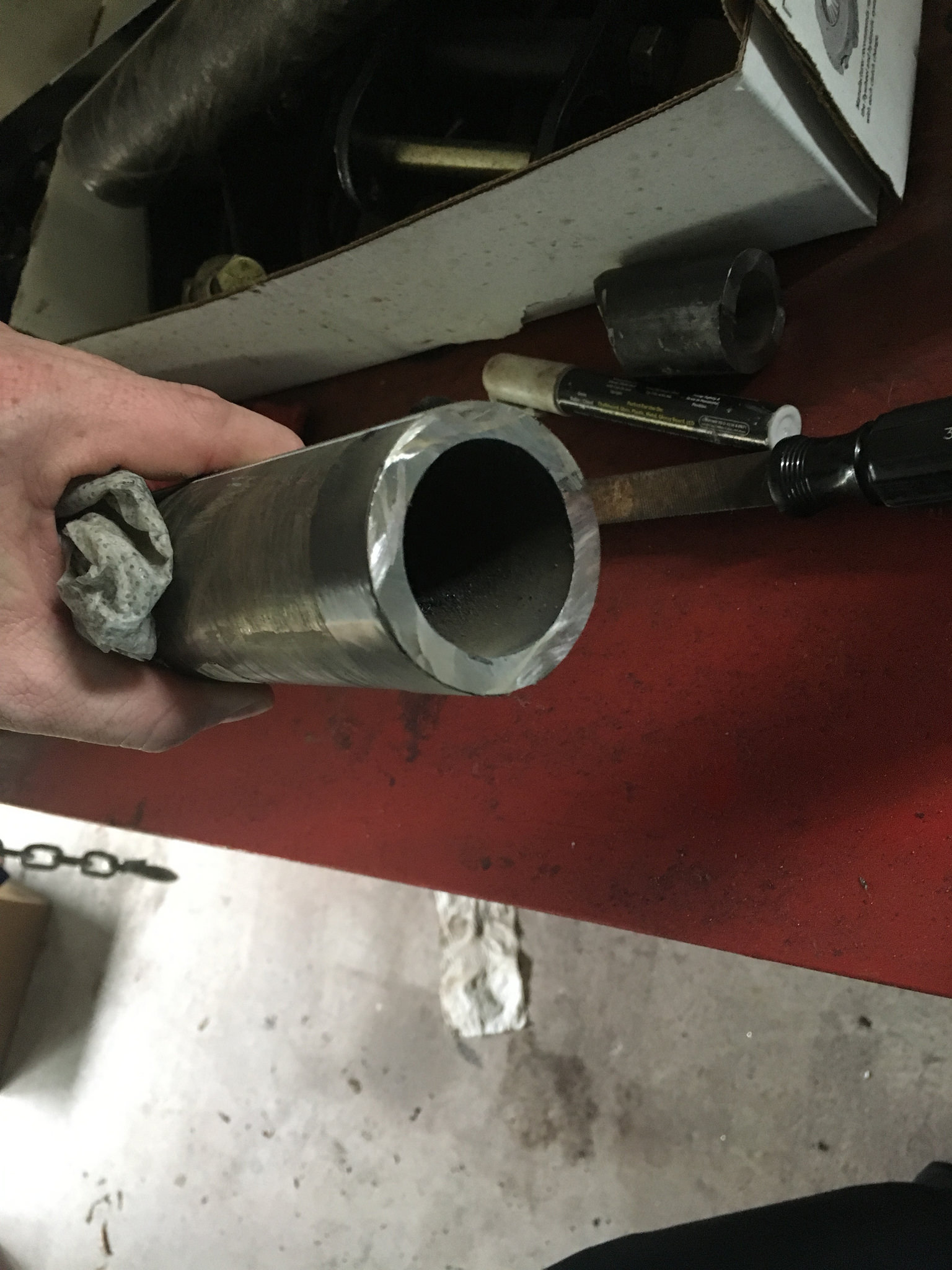

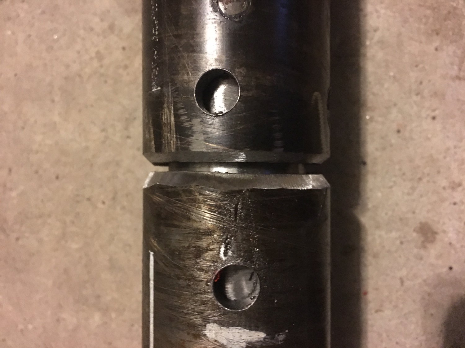

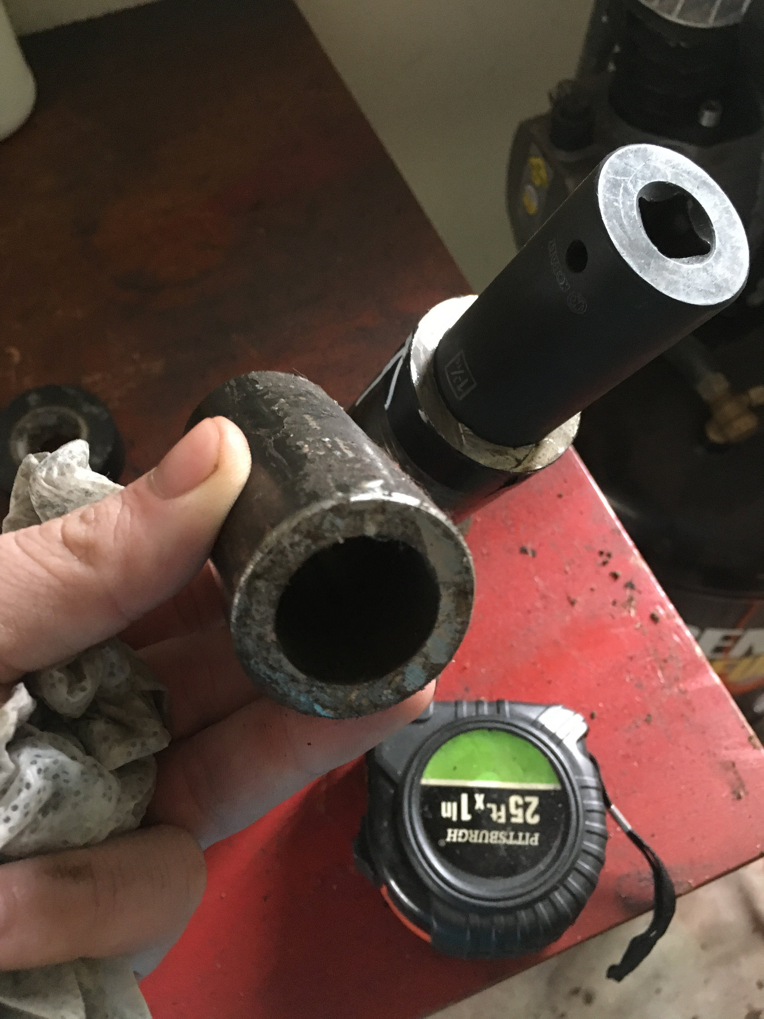

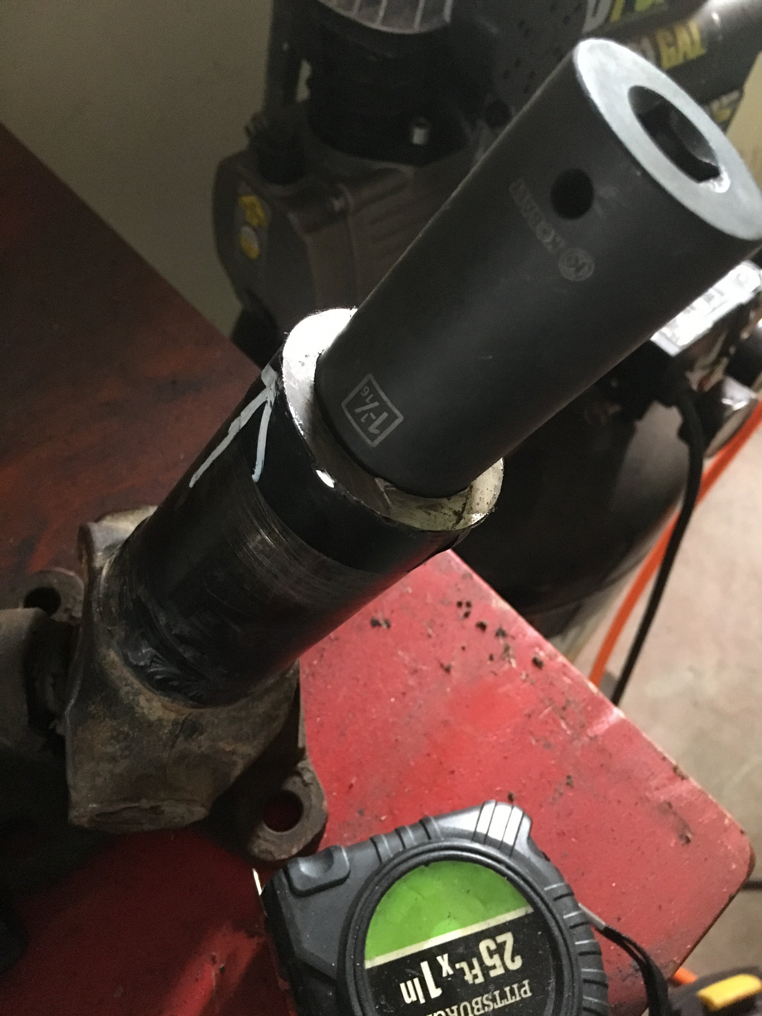

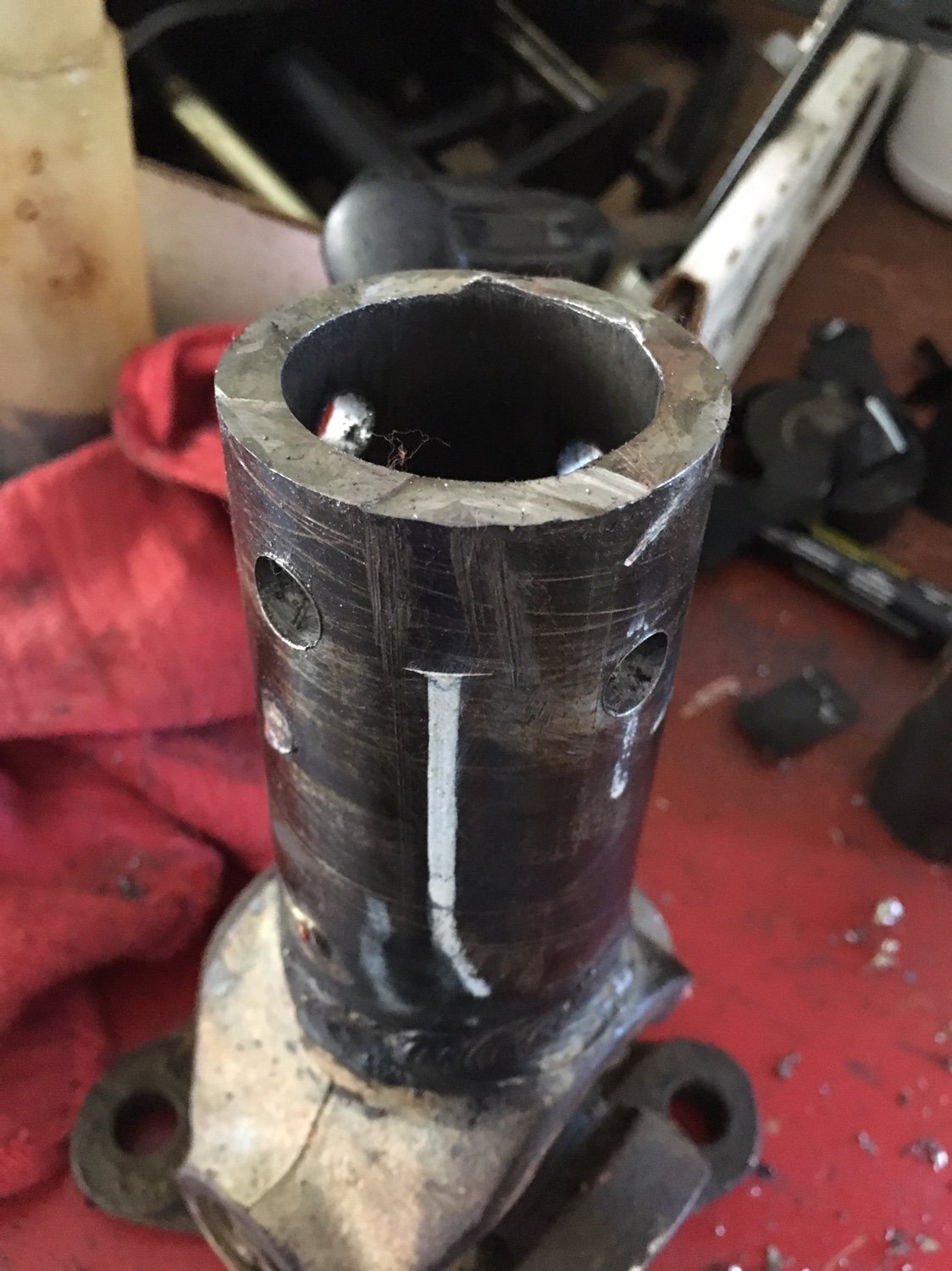

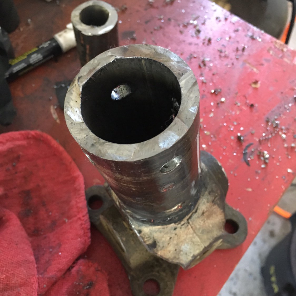

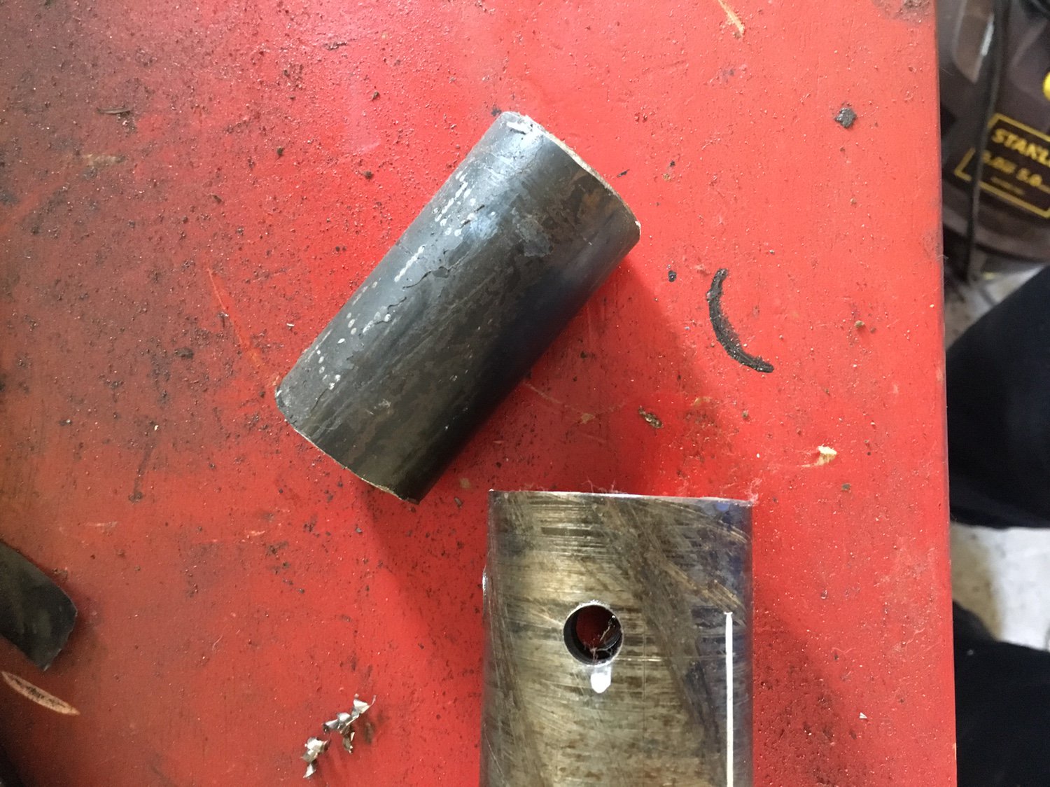

Got it cut. Woot! Now to find a tube that will fit on the inside. The tape for a guide line really helped. Prob should not have gone with black on black... Anywho so the inside ID measures. 1.46875 on the dot. Thats 1/32 shy of 1.5 inches. I tried my 250 wall 1.5 tube and it wont fit. however it does seem easy enough to grind that down a little. On the flip side... my impact socket fits perfectly.... lol.

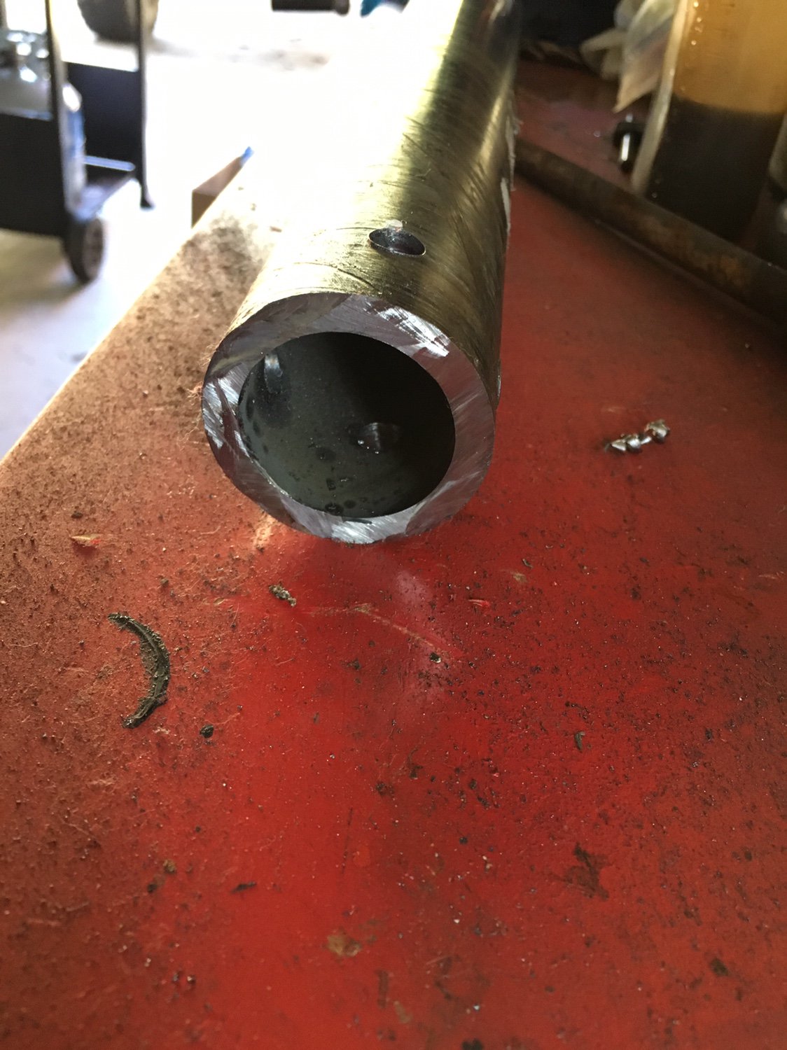

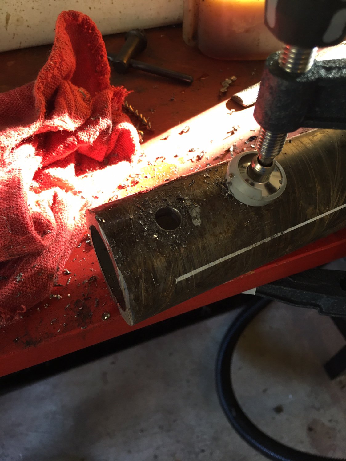

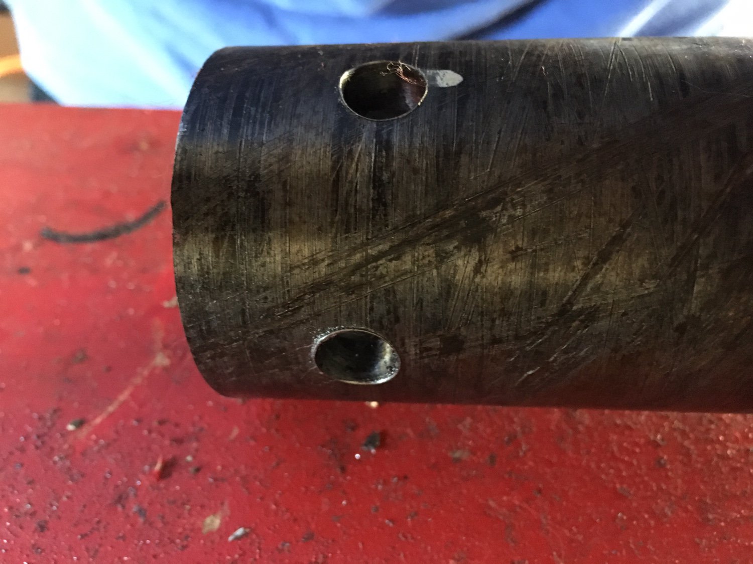

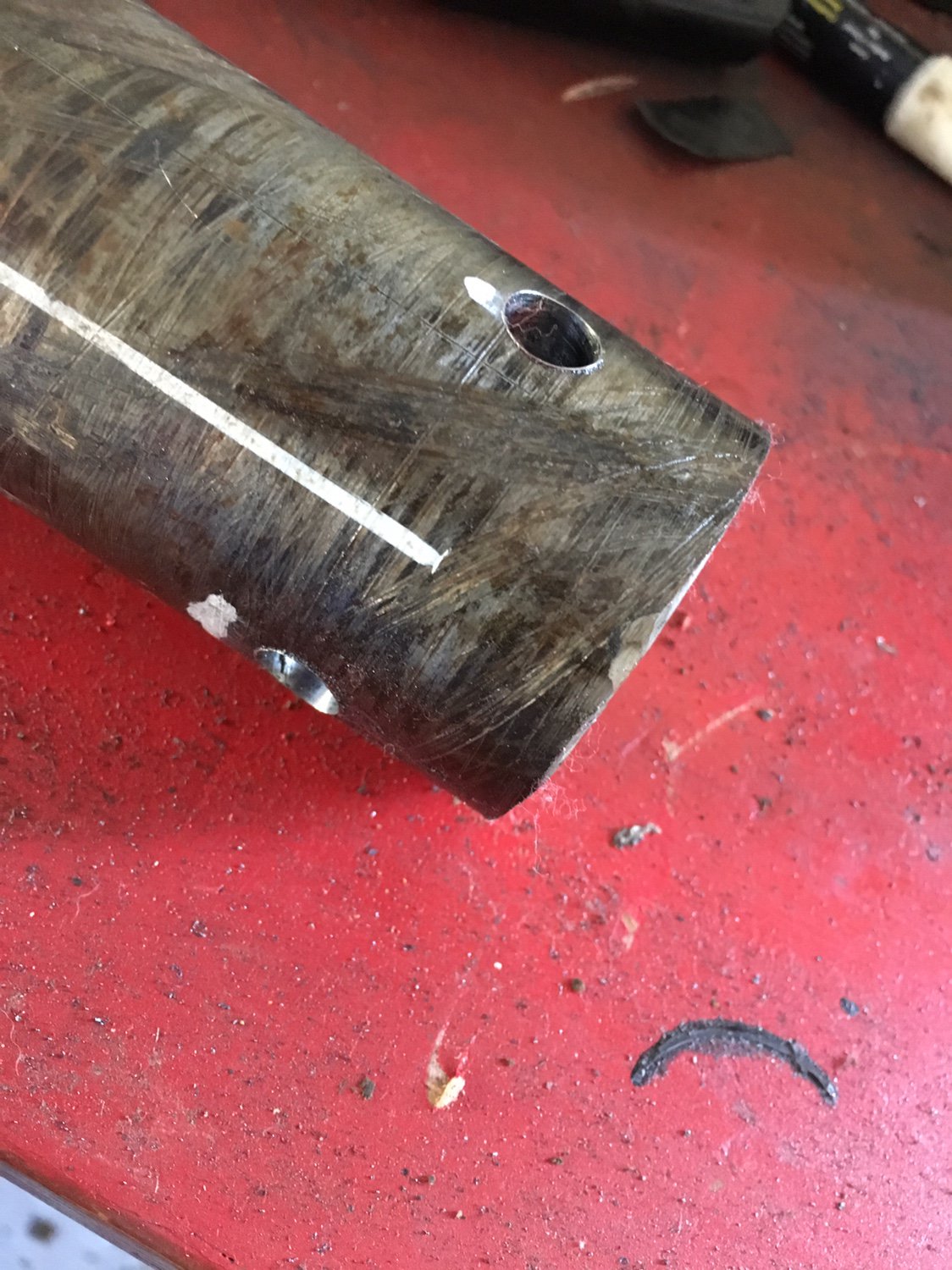

Got one side of the shaft drilled for welds. I tried to stagger them a little as that's what you do with wood... soooo... haha. Thought maybe that might help?
Doing four for each side. Should be able to at least complete the other side of the shaft today and tonight I can shave this inner piece to fit inside.

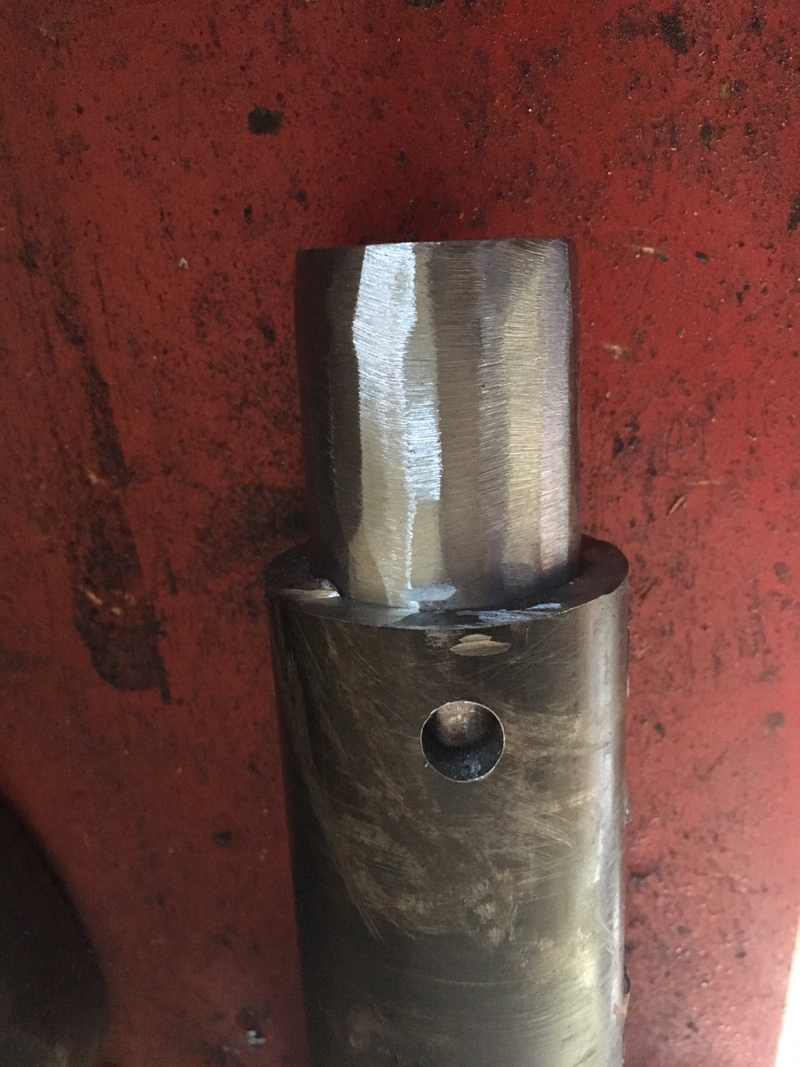

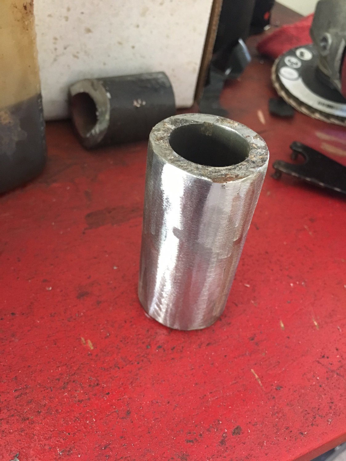

Shaved the "slug" and got it so it was uber tight on one side and needing to be pounded in, and only glove tight on the other side for easy Insertion.

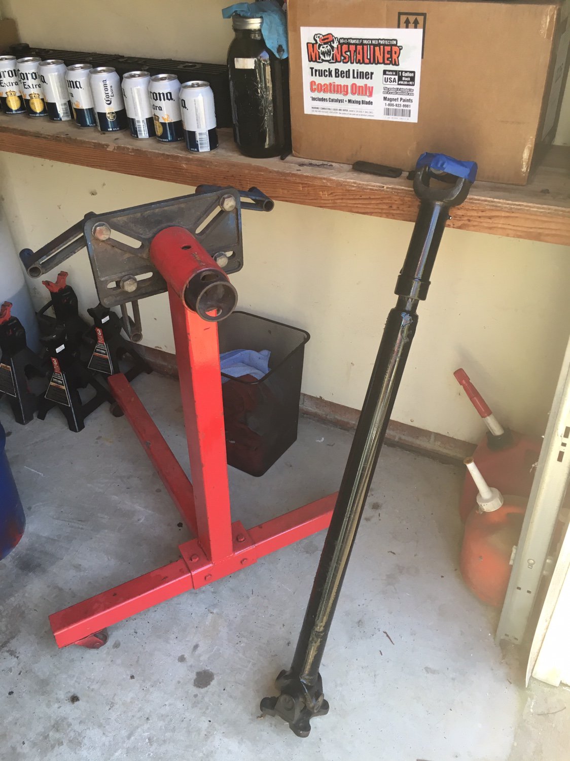

I wanna weld it! I wanna weld it! I wanna weld it! :bounce::smokin:
Seeing that beveled seam ready to roll gives me an erection certain to last longer than 4 hours.

Real question is why are all those Corona not open
