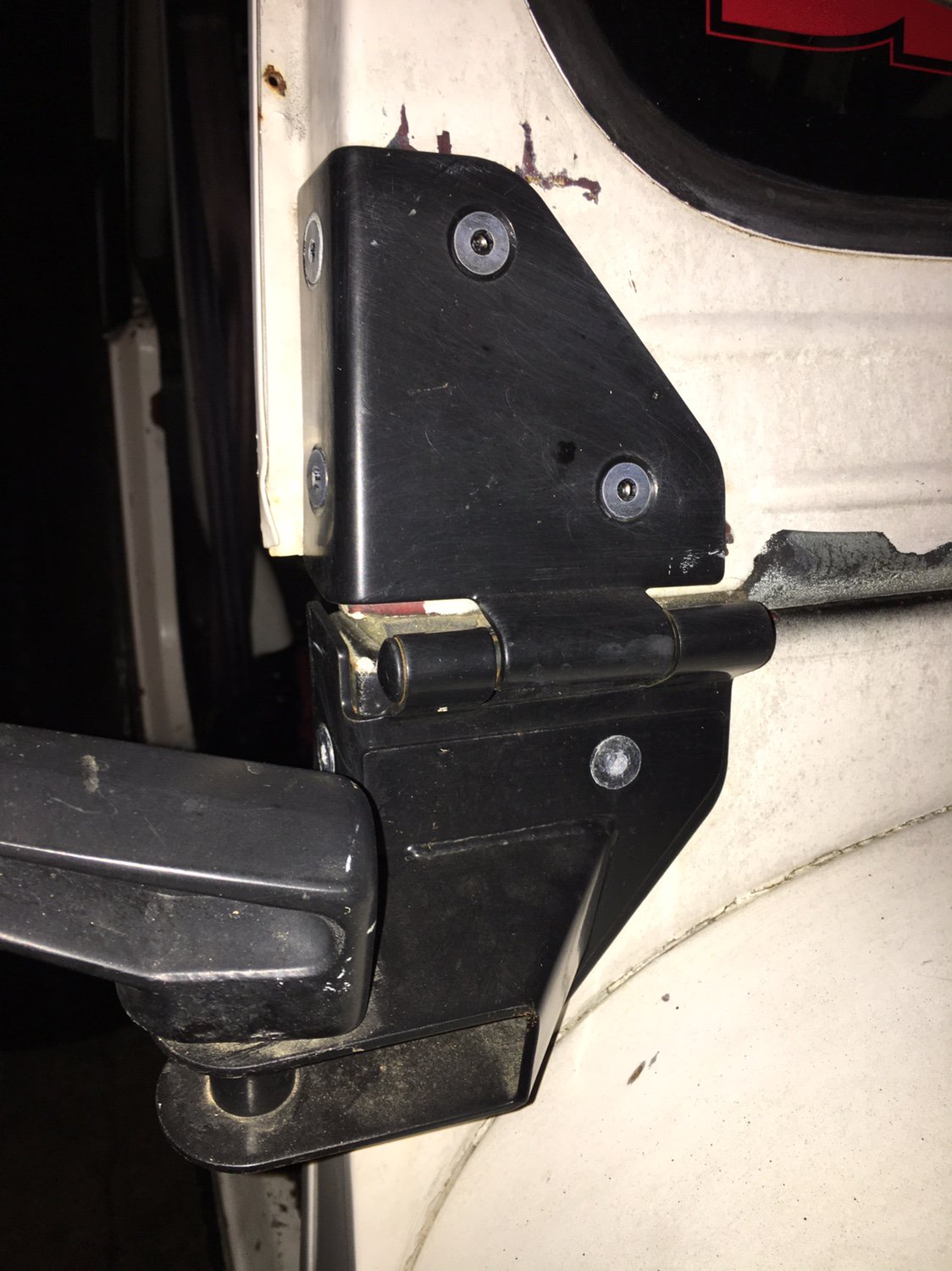

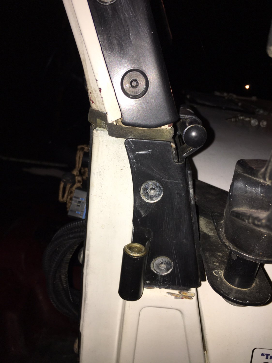

Still can't get the doors to fit right. Always had trouble with half doors too. The culprit seems to be this one piece windshield hinge. Gunna bust out the hammer. And if that's doesn't move it enough I'll have to cut that bracket I guess along side that edge so as to separate the hinge from the other hinge.

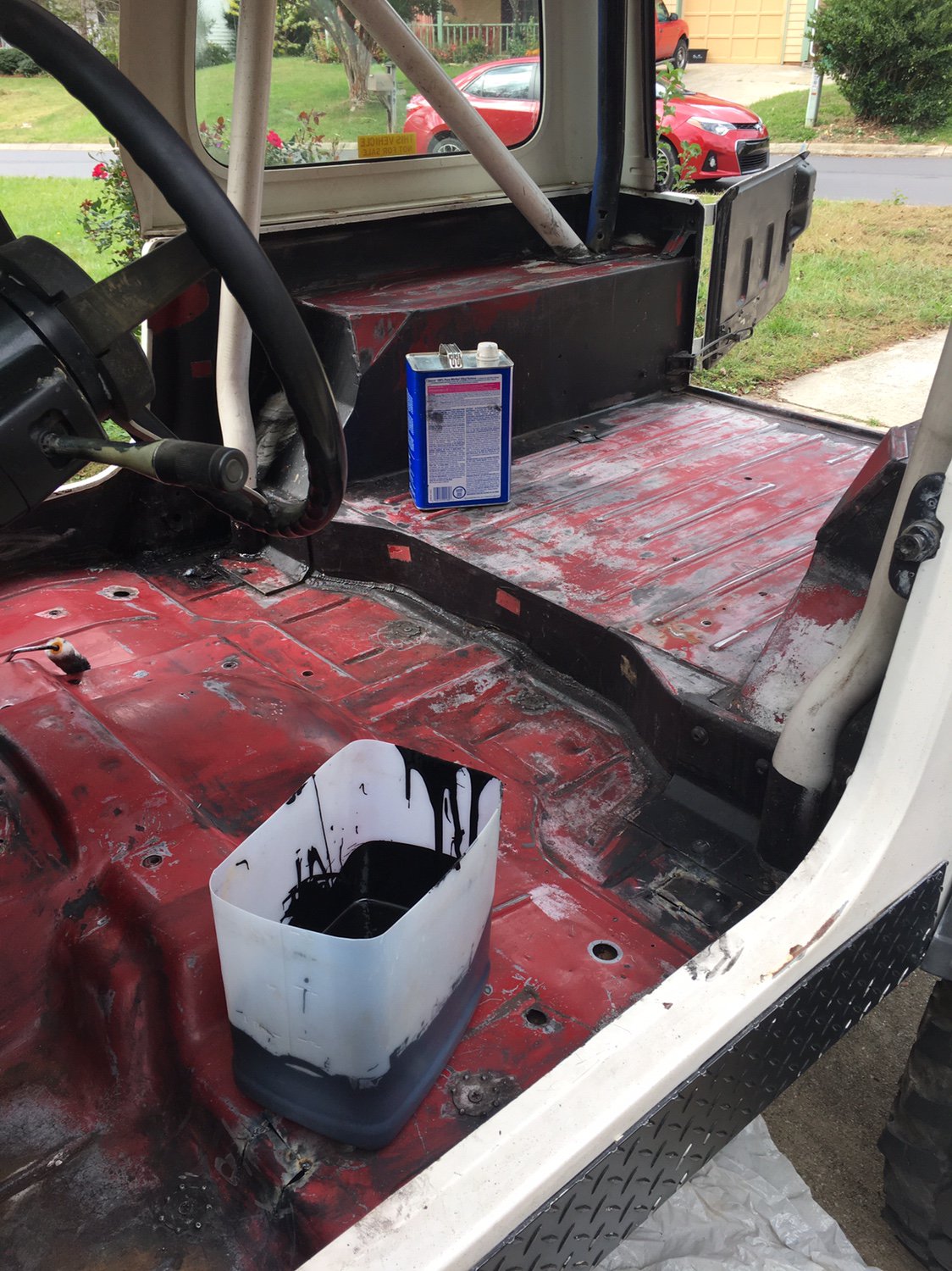

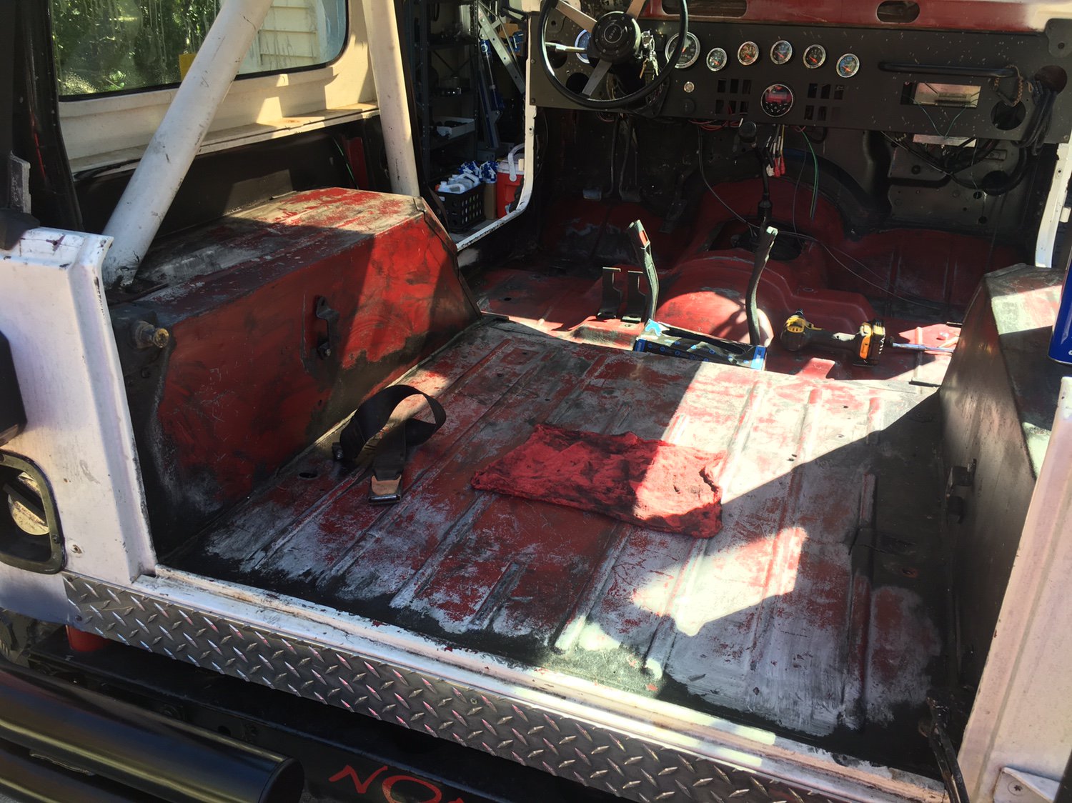

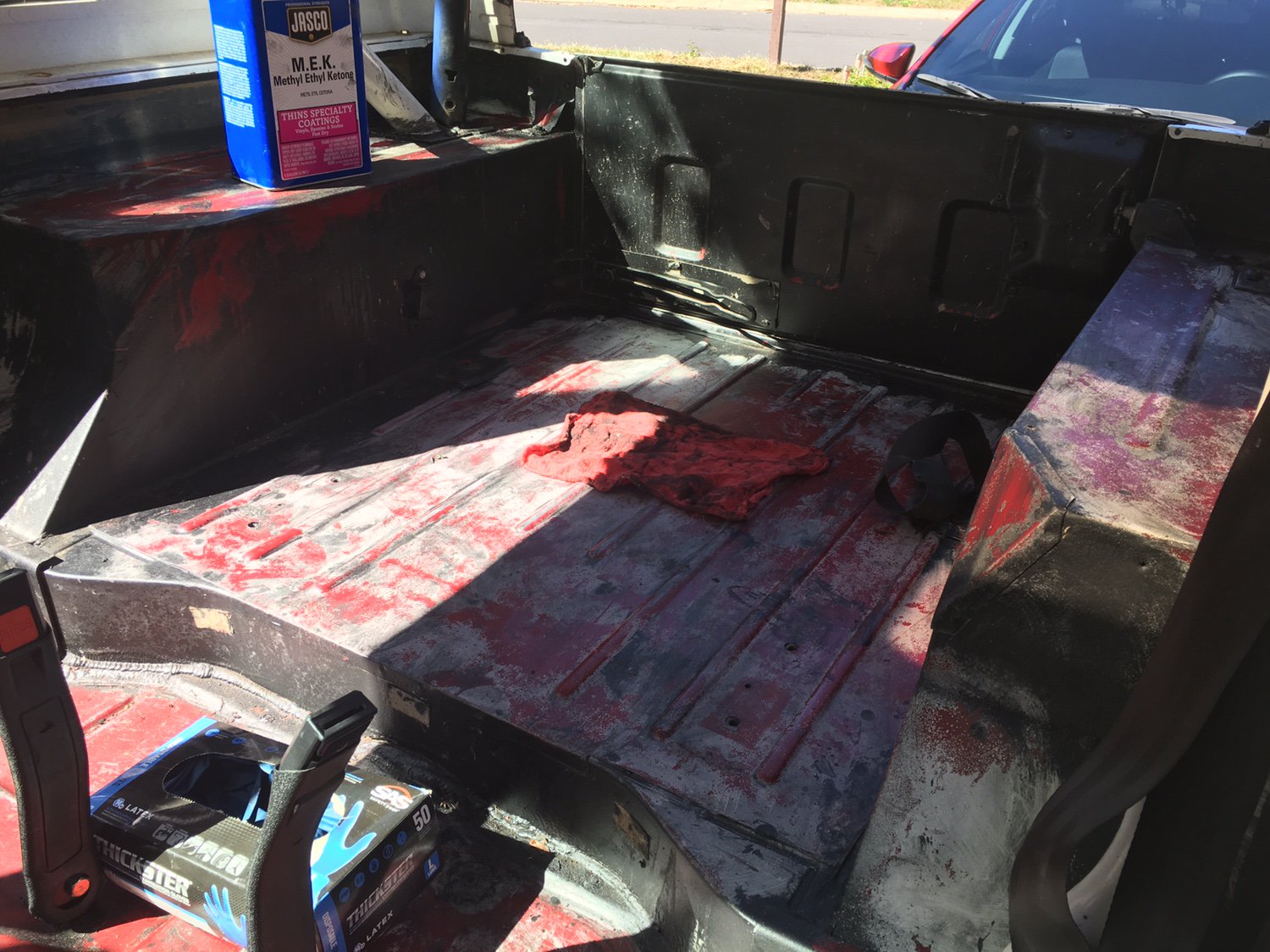

Went out a couple times today and got some more scrubbing in. One or two more times and a quick sanding and I'll be ready to monstaline on Sunday

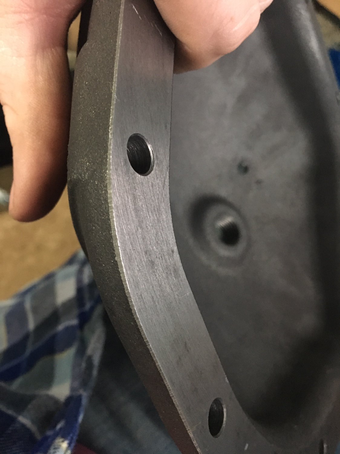

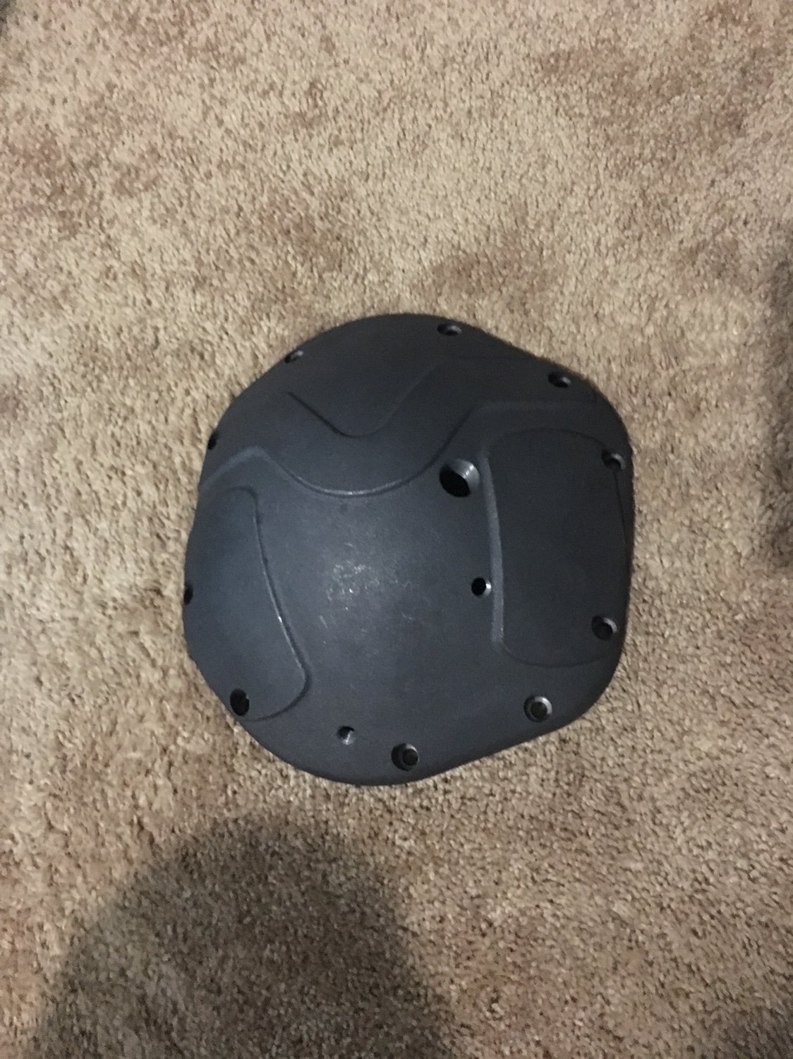

Free front diff cover arrived. From metalcloak. Appears to be slightly under 250 on the dome, but the edges are solid all the way. Half inch at the thickest points.

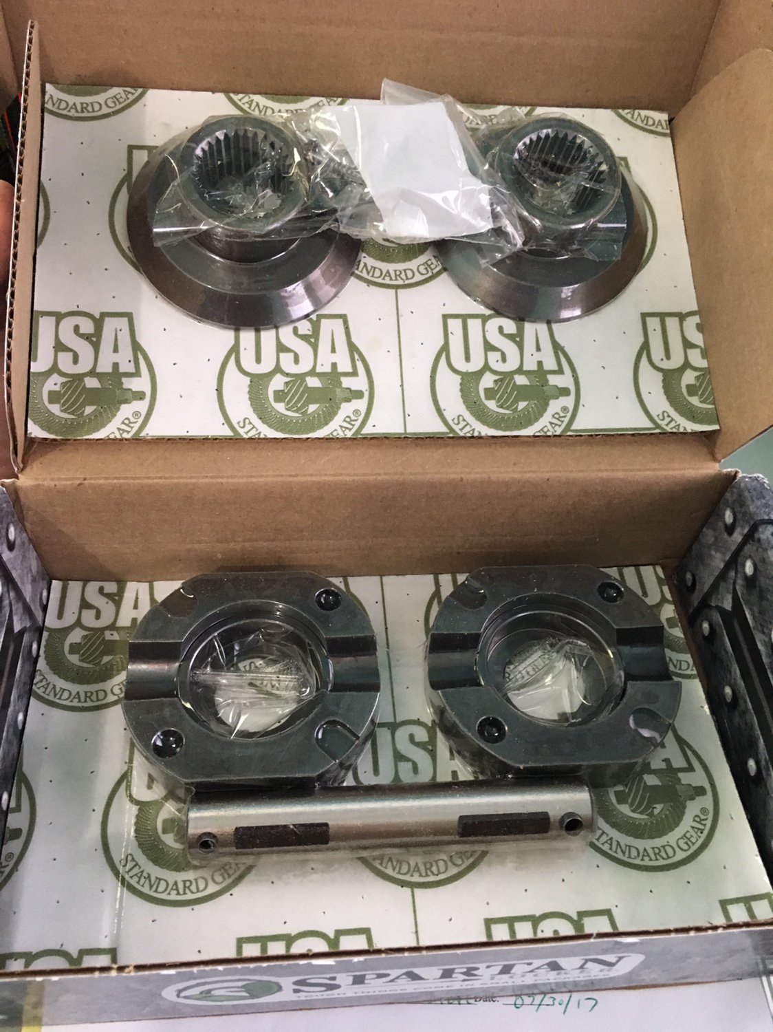

i have positive thoughts for the truetrac when i hit the rocks for the first time. but worried that $500 bones would have been better spent on the e-locker ($900?). Time will tell. After all, its a journey, and a journey without mistakes is just boring.
I do wish i had knew of 35 spline before. one of these days ill have to satisfy my mind with some comparison research into 30 spline chromo vs 35 spline oem.

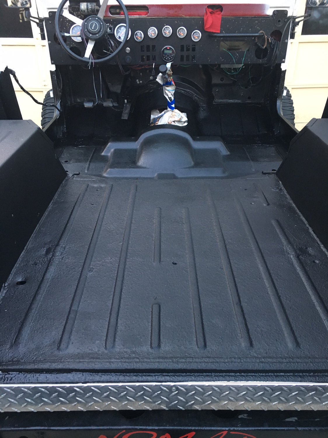

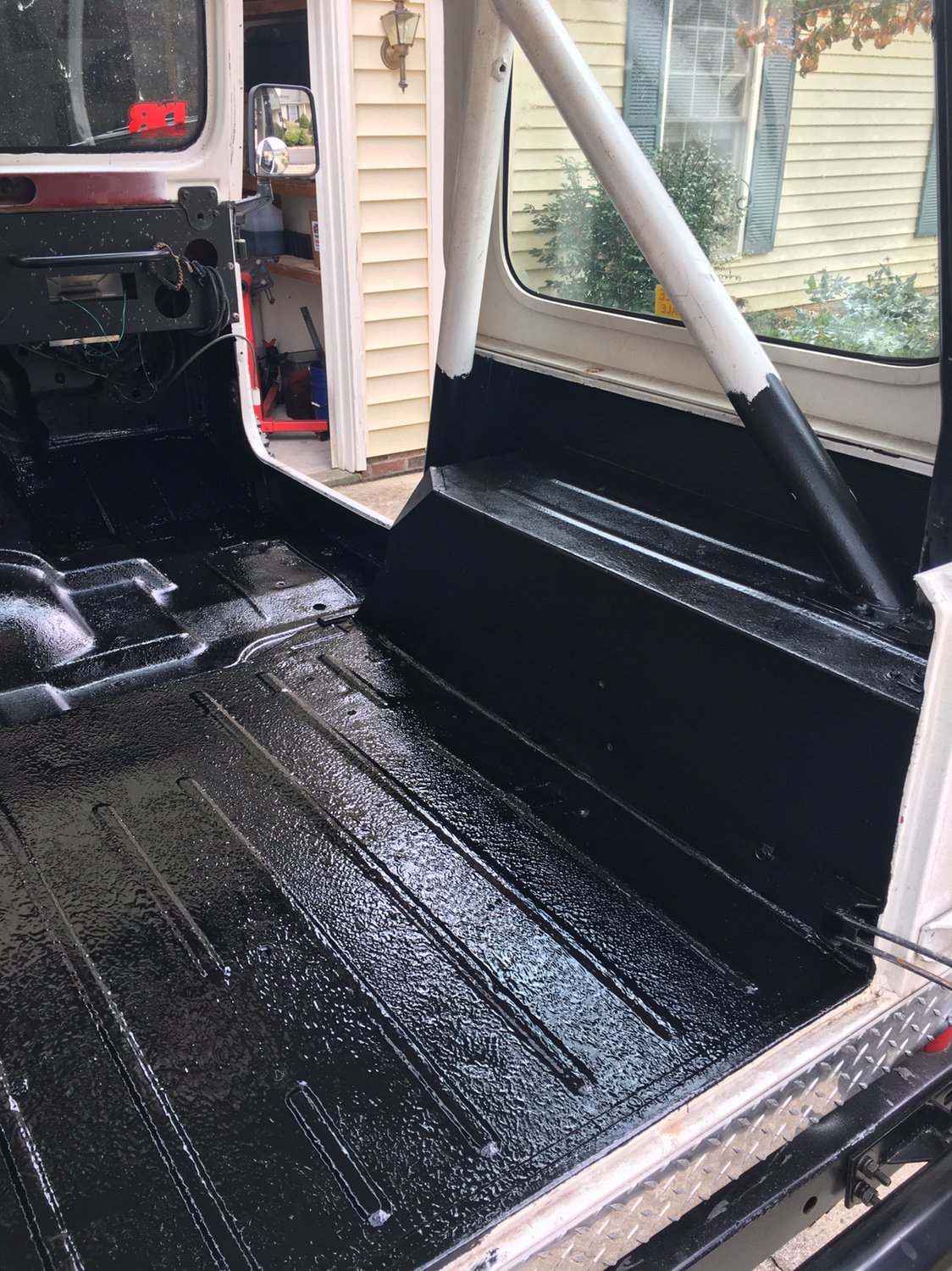

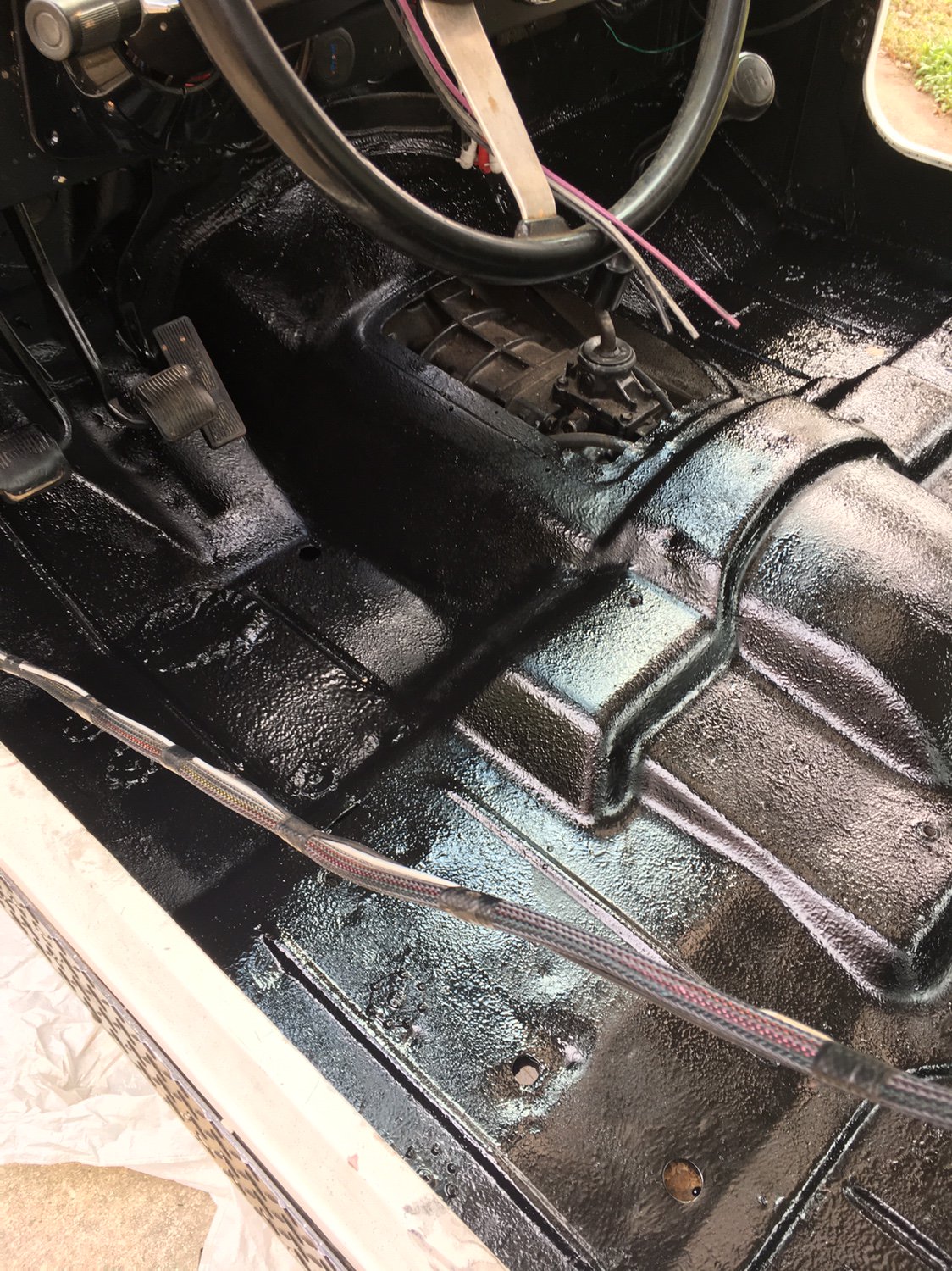

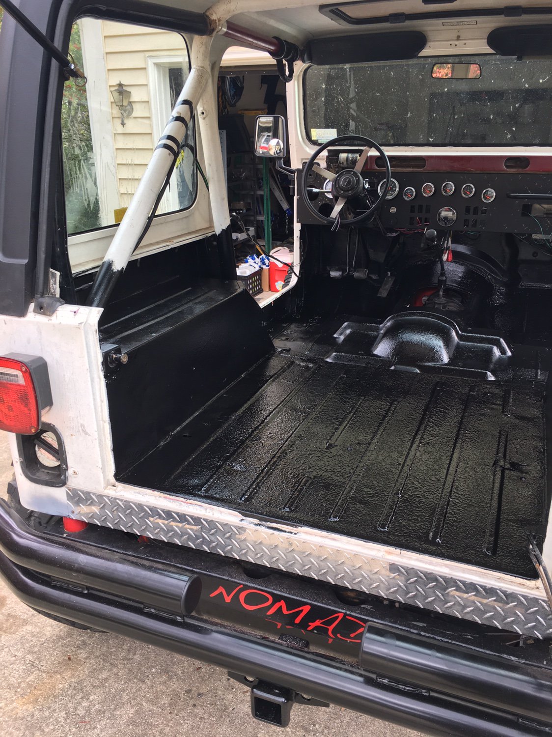

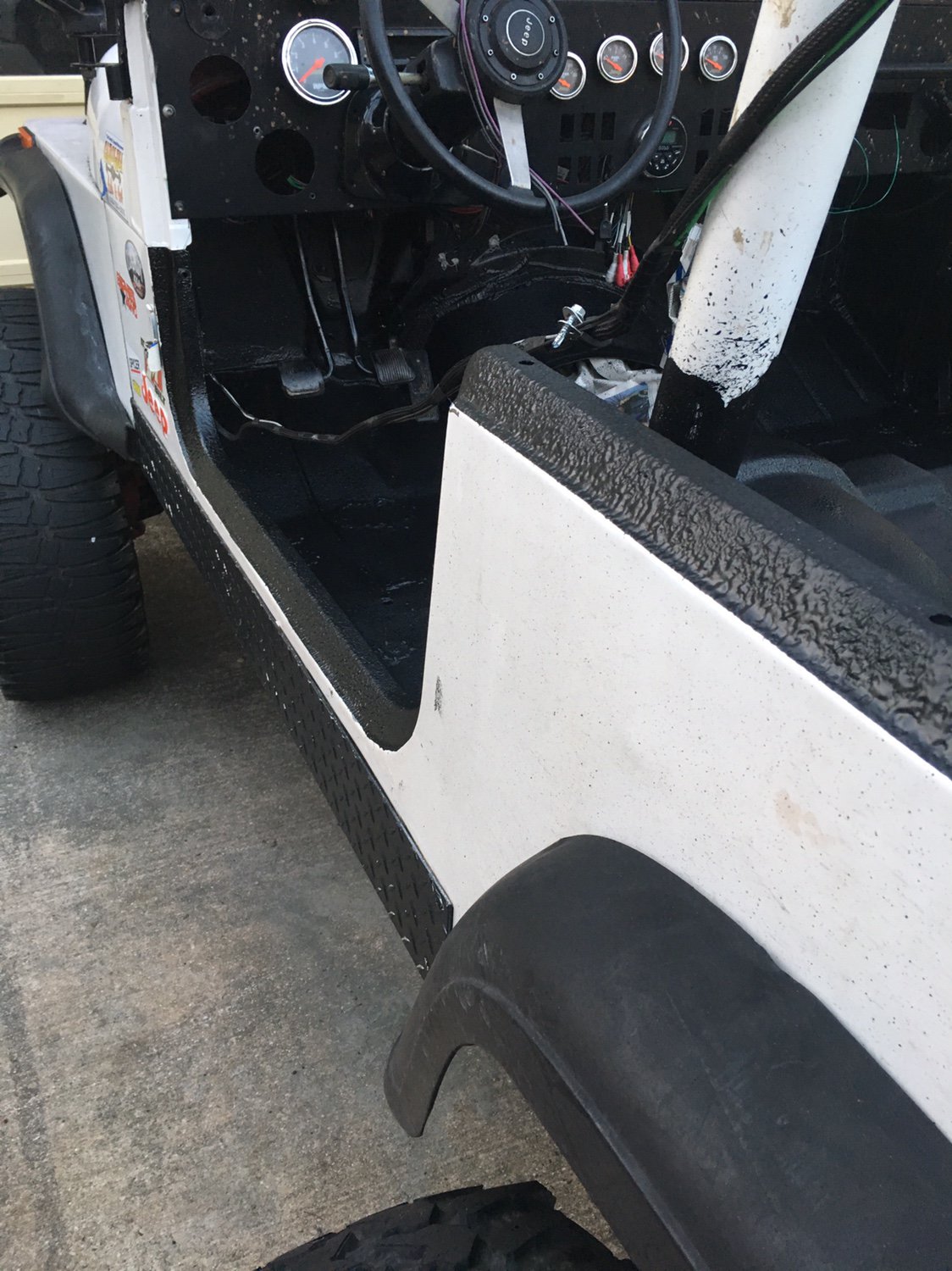

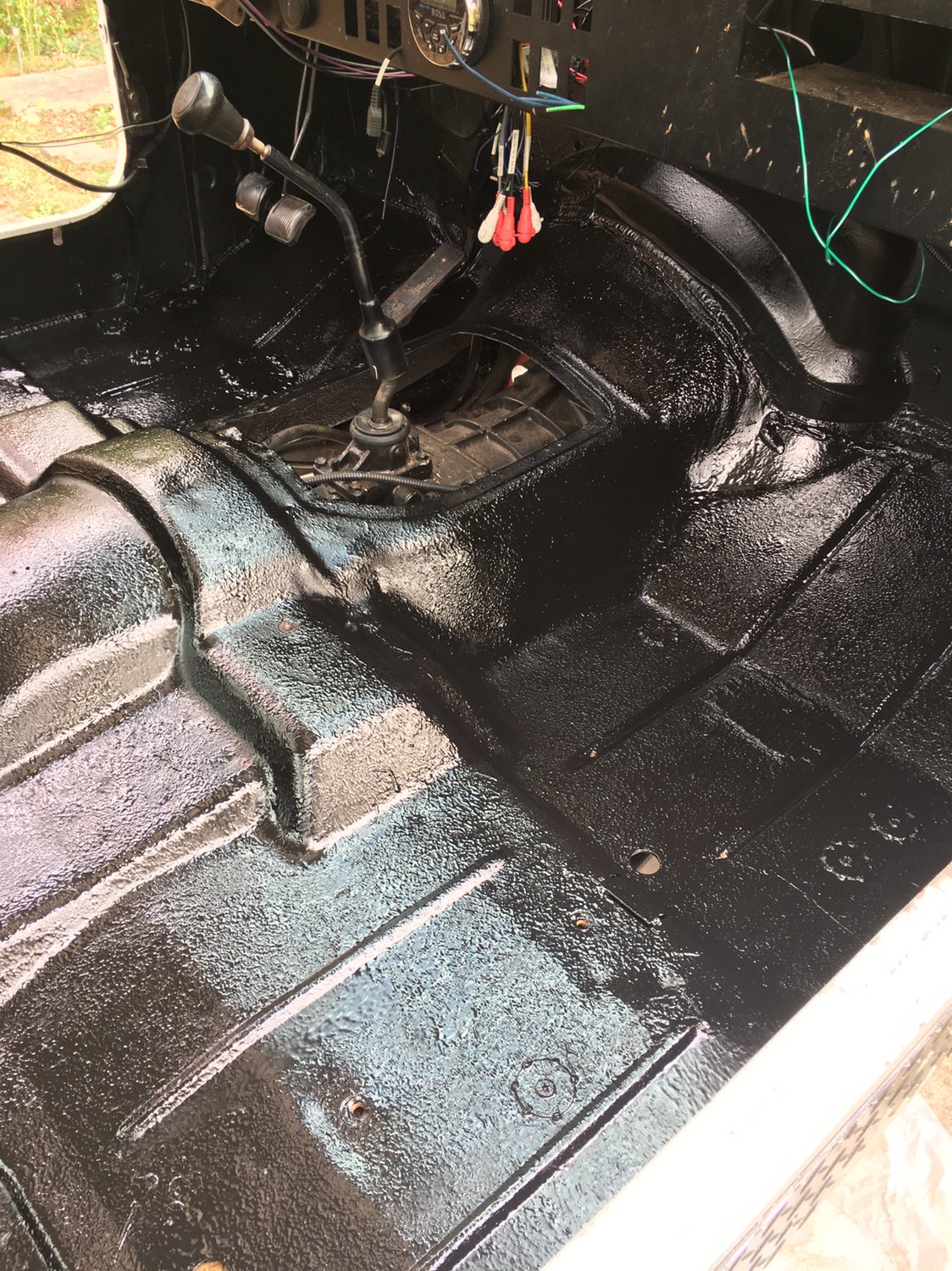

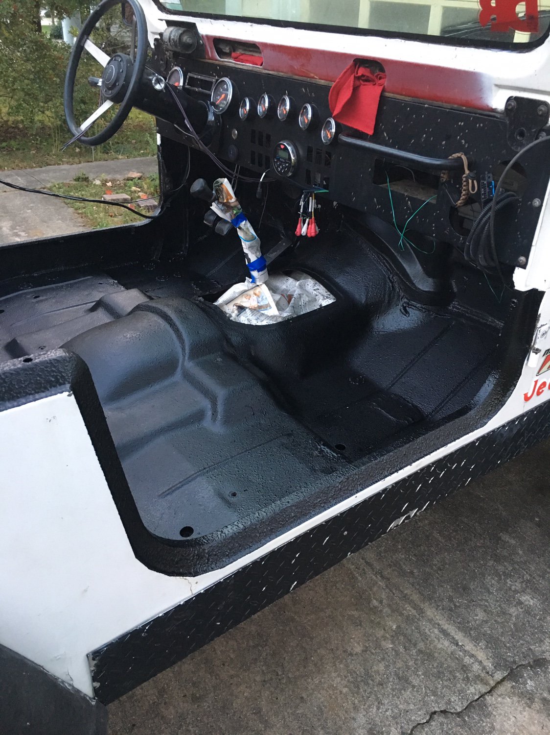

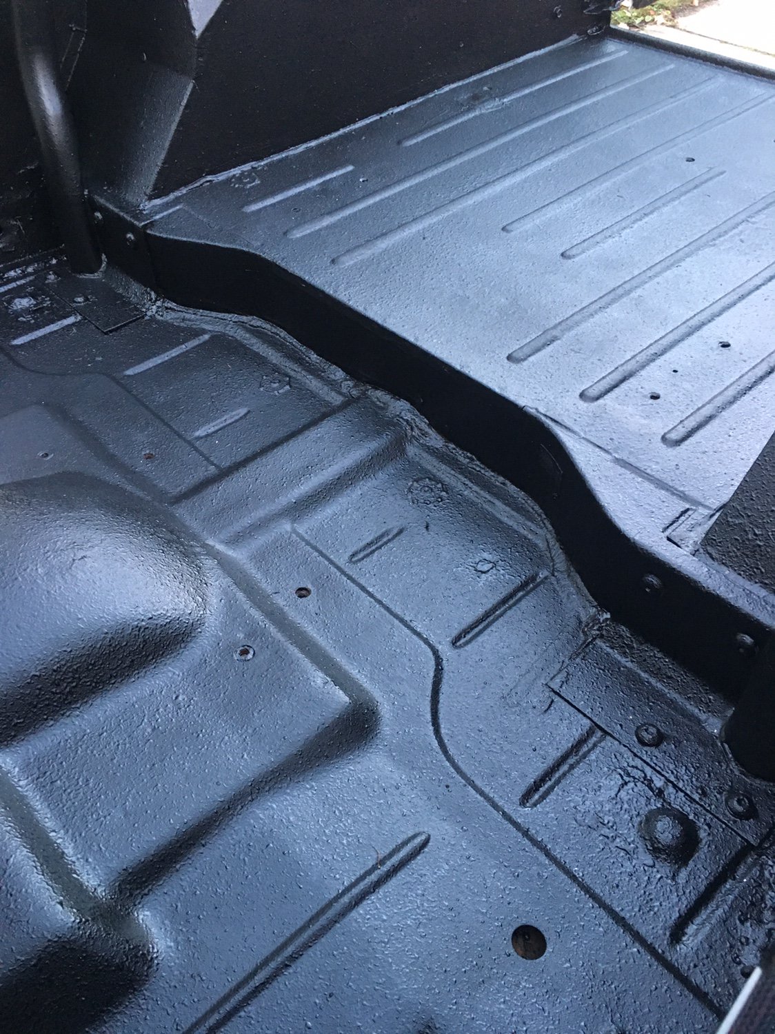

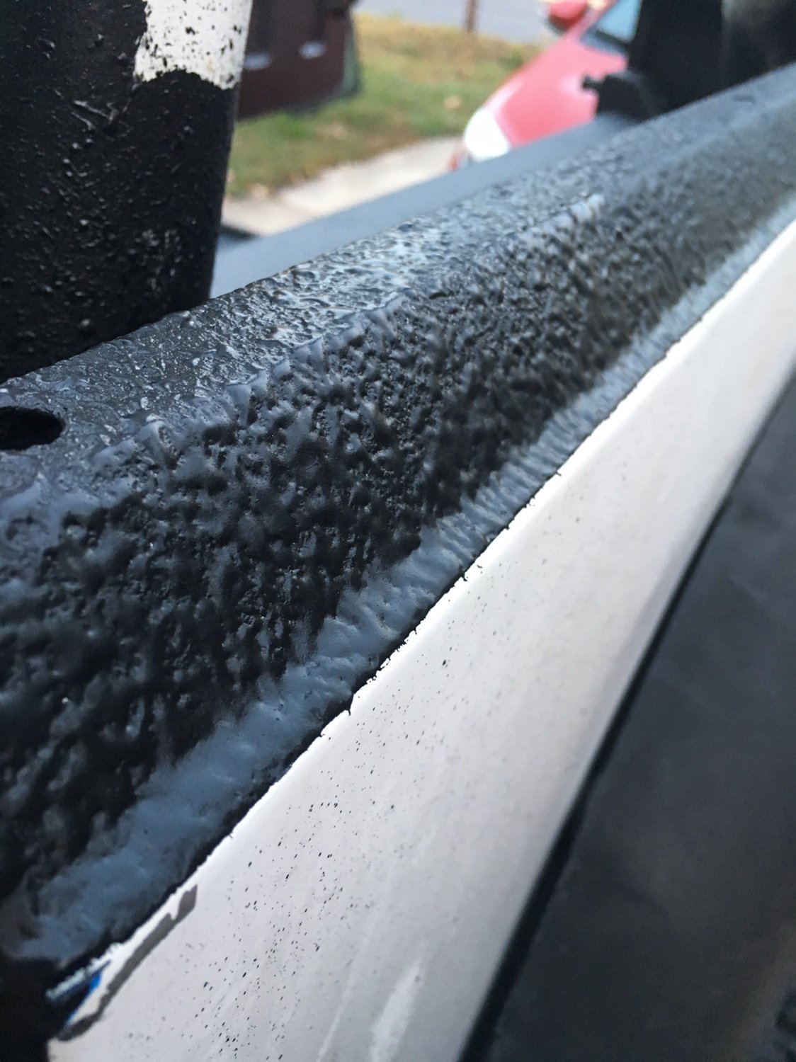

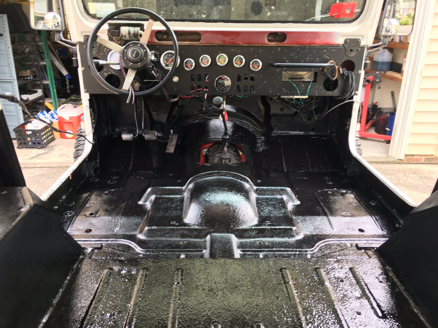

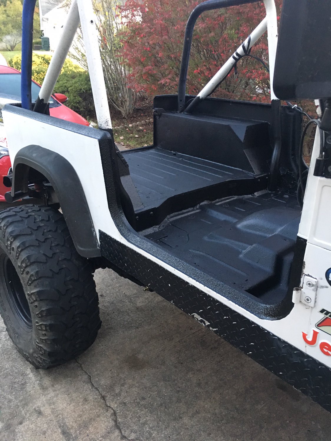

Here is some pics after the sprayed on (rolled first coat) final coat. The texture has much improved I think with the spray. I wasn't as anal this time. So not perfect. Just means i need to do the monstaliner exterior plans or maybe go semi-gloss black.
It's your Jeep, but please dont ruin it by putting bedliner on the outside. Thats a bad choice you cant really come back from.
haha. i agree with you. i had aspirations once of a "hardened" exterior paint job. but it only took one ride along to see the futility of that. if i happen across a free can, maybe i would consider. but No the plan right now is buying a gallon of some color and having fun with the spray gun.
Liner turned out really good! :smokin:

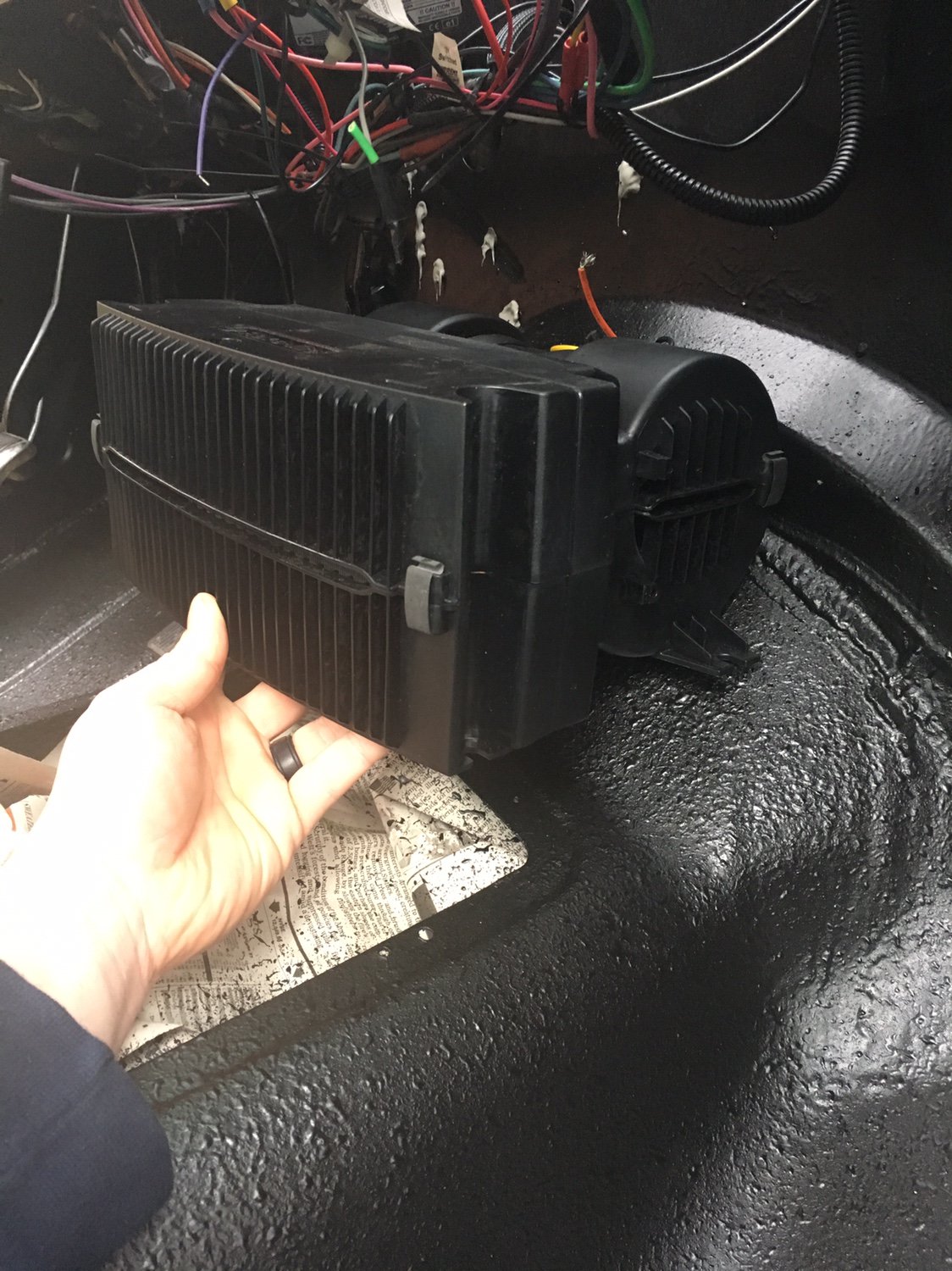

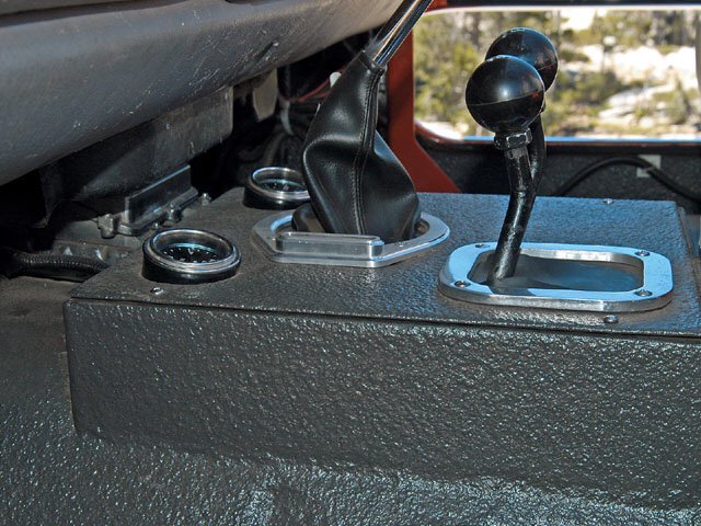

Trying to figure out where to mount this. I may need to build something. Hmmm.
I think I want to build a flat spot like this from the firewall back. It would give me a great place to mount it and far enough away from shifter boots and what not.
And it could go all the way to the rear tub area like this.
Think is this flux core on the lowest setting lowest speed still melts this body panel sheet like butter. So dunno how I would build this or even attach to the floor. Hmm.
Want to try to get a lot done this weekend. Hopefully discover something by then.
I guess it doesn't have to go there either. Just made the most sense because of running heater hoses. But then again, the hoses will be on the P side and the heater ports are on the D side.

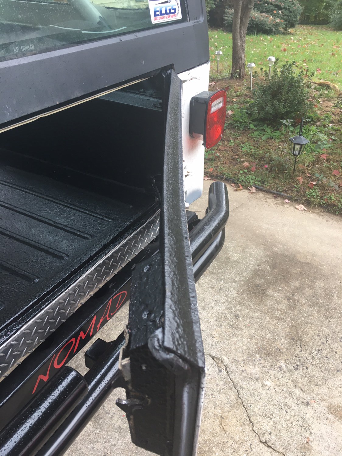

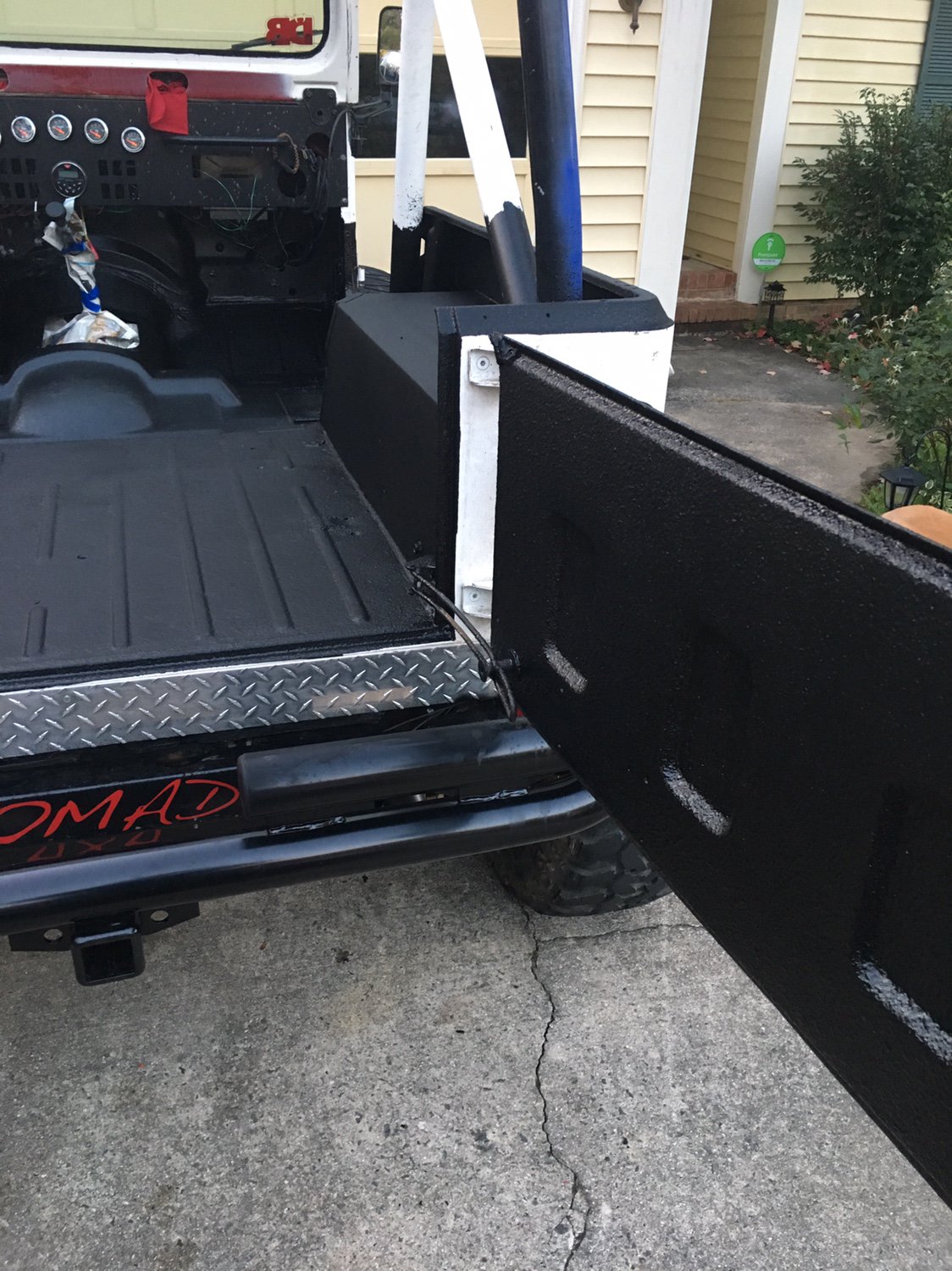

I tried to use the Force to fix this tailgate but couldn't. Not enough clearance with the hardtop lift gate.
