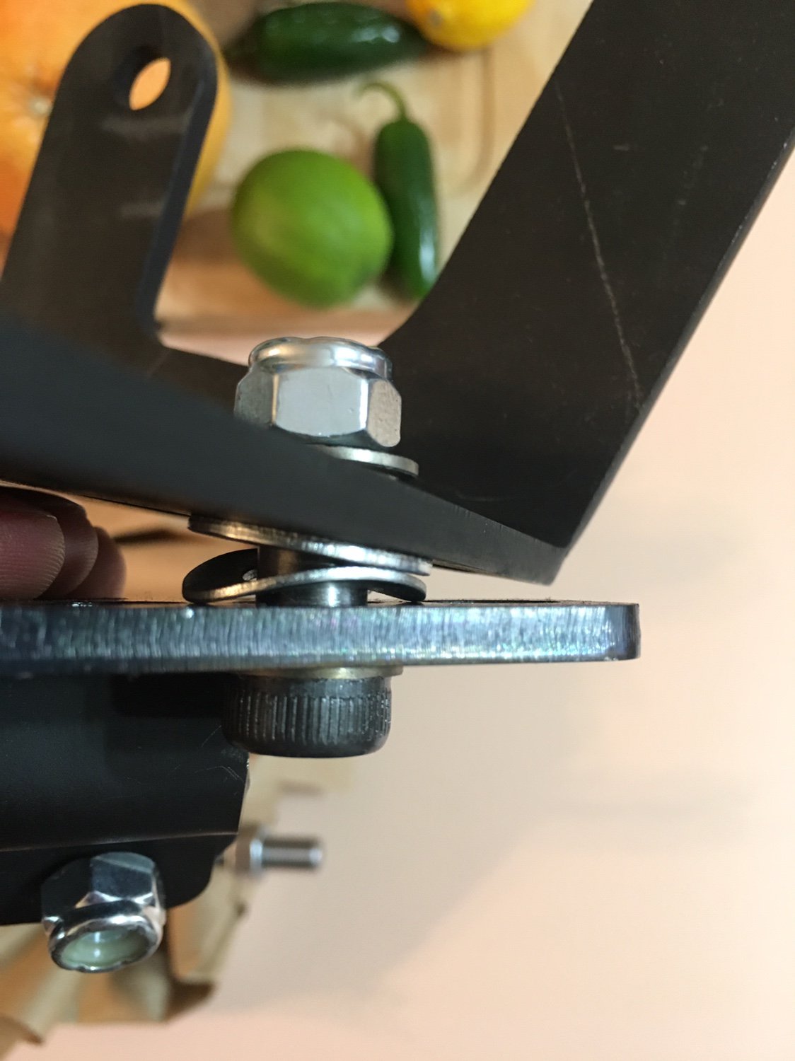

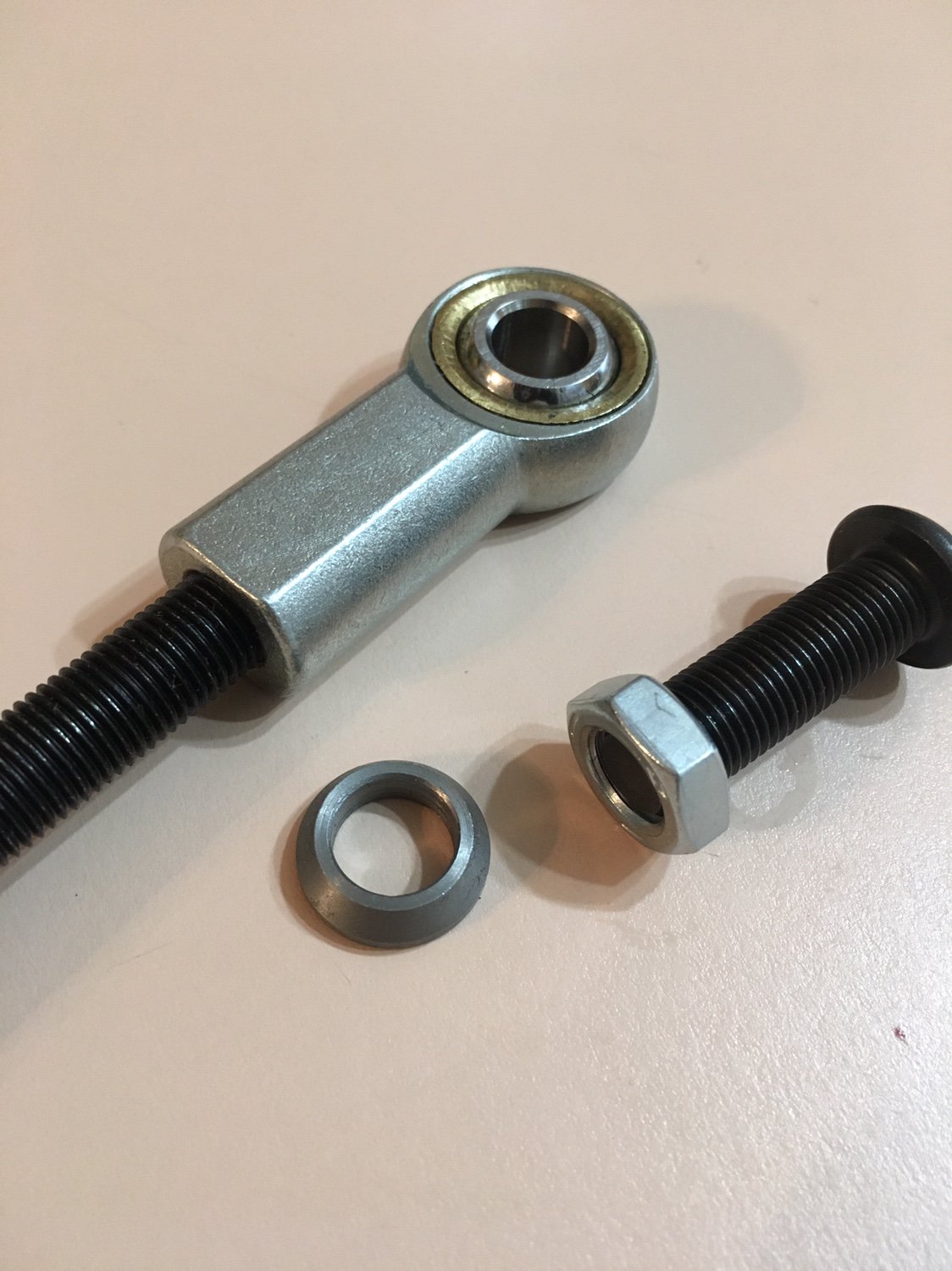

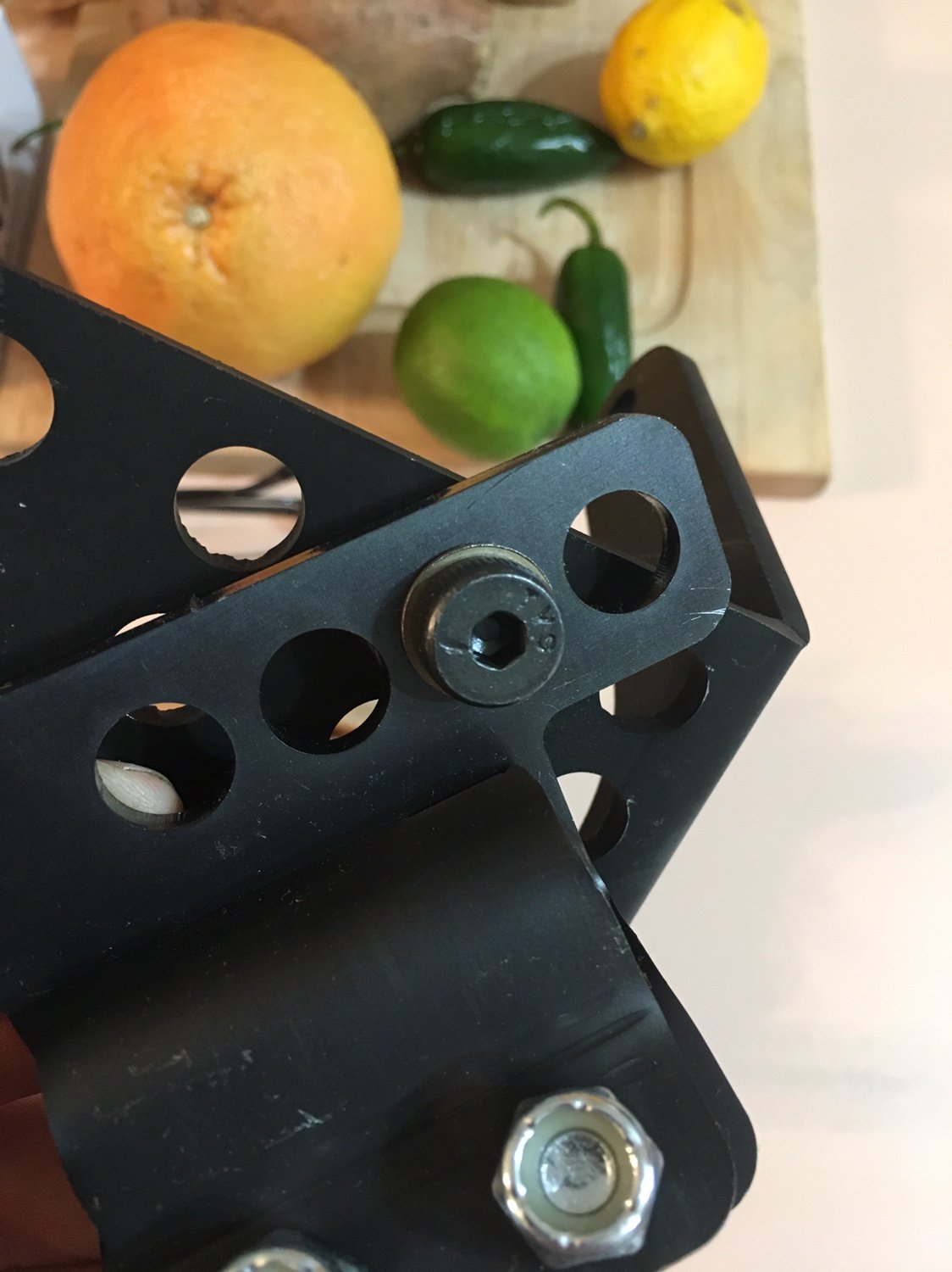

For the amount of R&D Novak has done and made freely available. It is justifiable their prices. However. Was not to impressed with the Allen head bolts, the non locking heim joint nuts and the fact there is metal on metal shifting here. Would have hoped for at least some teflon washers as opposed to SS washers.
So going to update this shifter assembly with some better hardware and get it installed

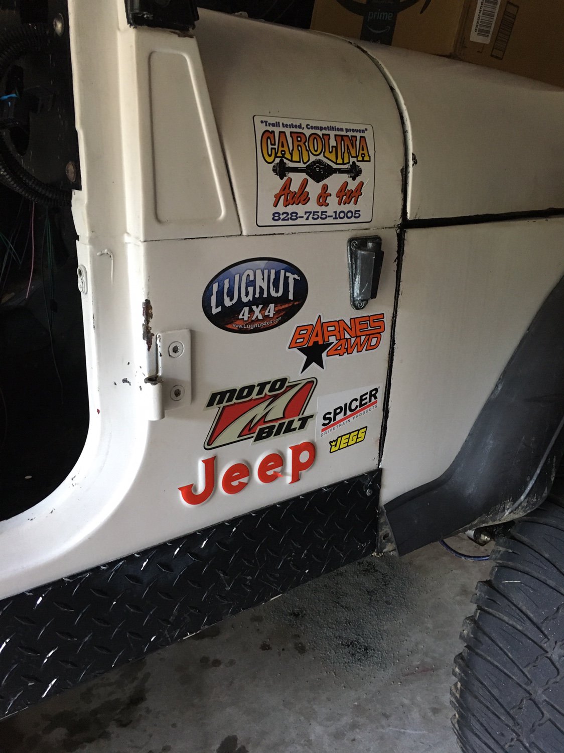

Put some stickies on. Some fab vendors and what not.

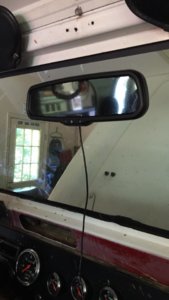

picked up a neato doohicky. hoping it will provide good feedback when doing trails backwards....

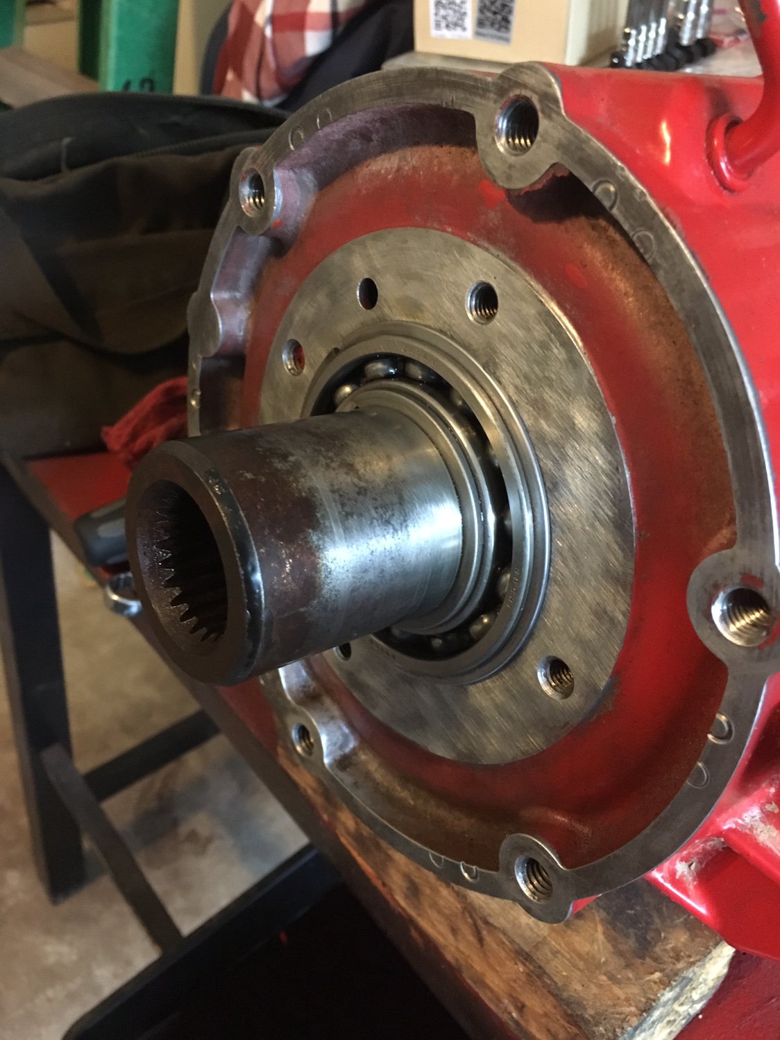

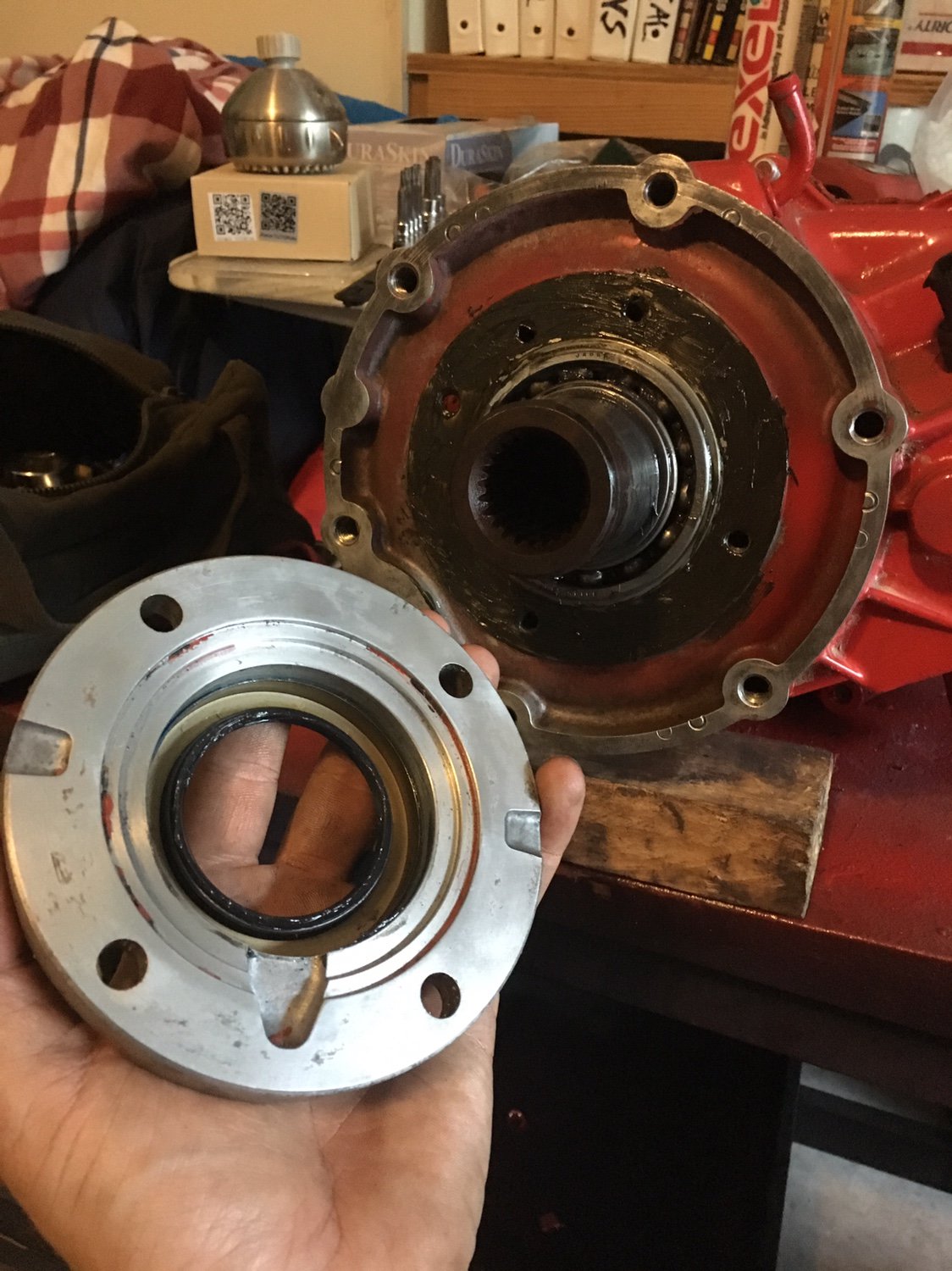

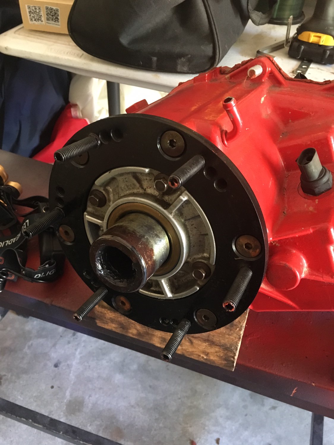

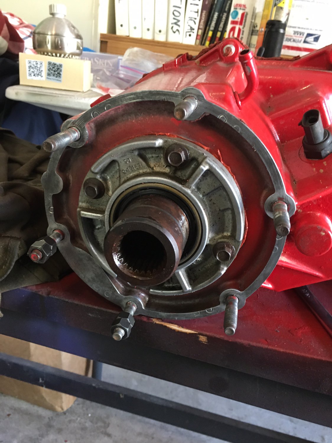

Dropped the transfer case. Changing yoke and trying to figure out where it's leaking (both trans and Tcase).
It appears the only possible explanation for the trans is the output seal. Hopefully that is replaceable as it sits.
The trans is a little more baffling but again only one possible source. The planetary running seal. It's new from the rebuild but I notice a slight "bump" in the surface seal.. so pried away to look for dirt but saw none. The bump stays. Putting fluid in shows this is where it tries to pool and come out. And to my knowledge these seals on on the planetary shaft (trans side and Tcase) should prevent anything getting through??? Otherwise on the trans it would always immediately leak down to the weep hole.

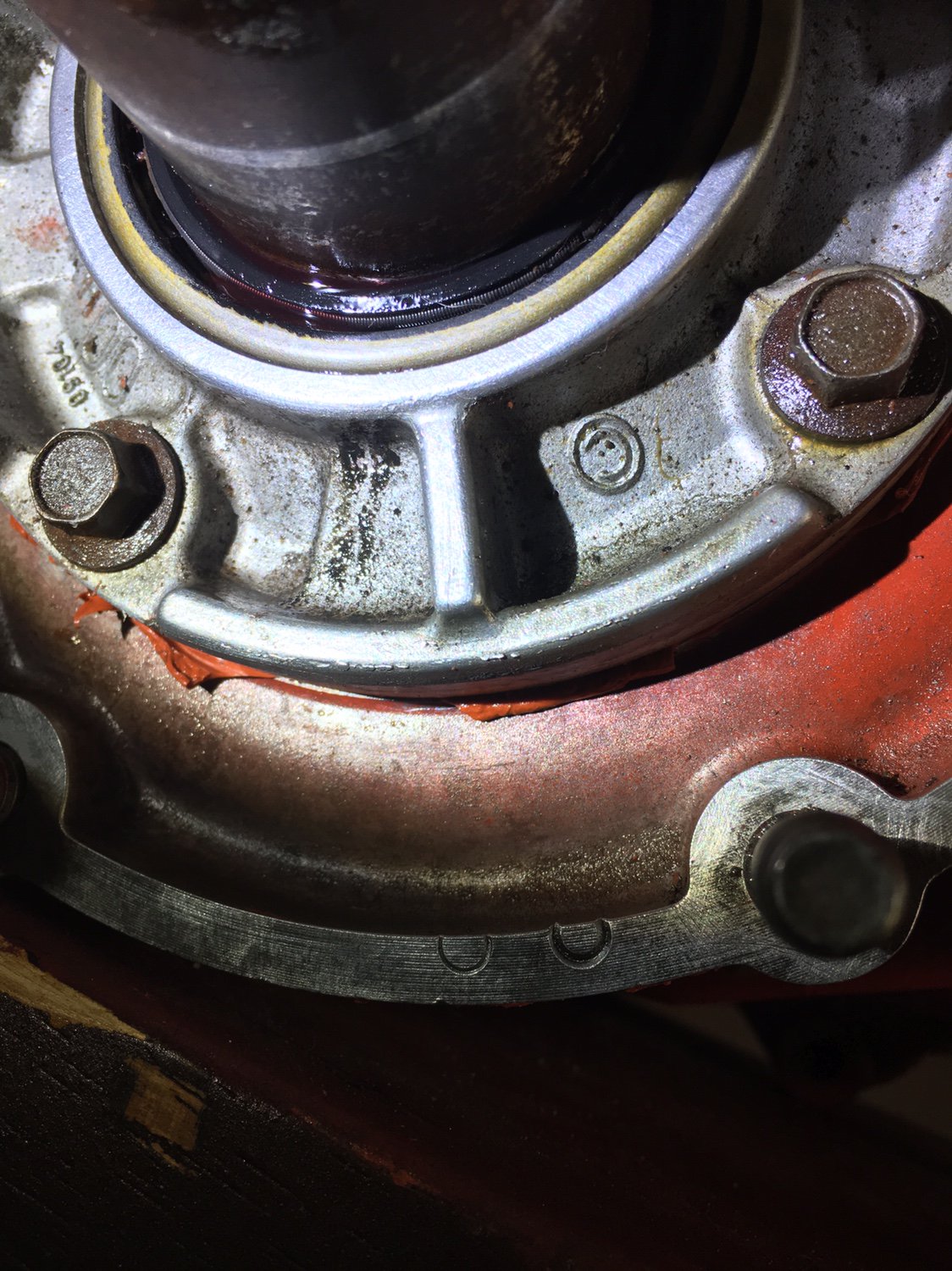

Here you can see how it's wanting to weep out. These seals are supposed to prevent that right?
I bet the seal is just prematurely worn out. Even with it nice and straight, if that shaft is dry, the friction will eat it away really quickly if theirs no lubrication between them. Anytime I install one I usually lube the shaft or seal with whatever liquid it's intended to keep in.
Might that be it? :D
Shit, jody caught it as I was typing mine. . Yeah...that.
So I put the seal on backwards you're saying?
I don't think so. It looks to be the wrong seal all together.
Many times the rebuild kits come with a multitude of seals that may have the correct dimensions, but aren't the actual correct ones.
Yours should have a flat front face and an open back side where the spring goes.

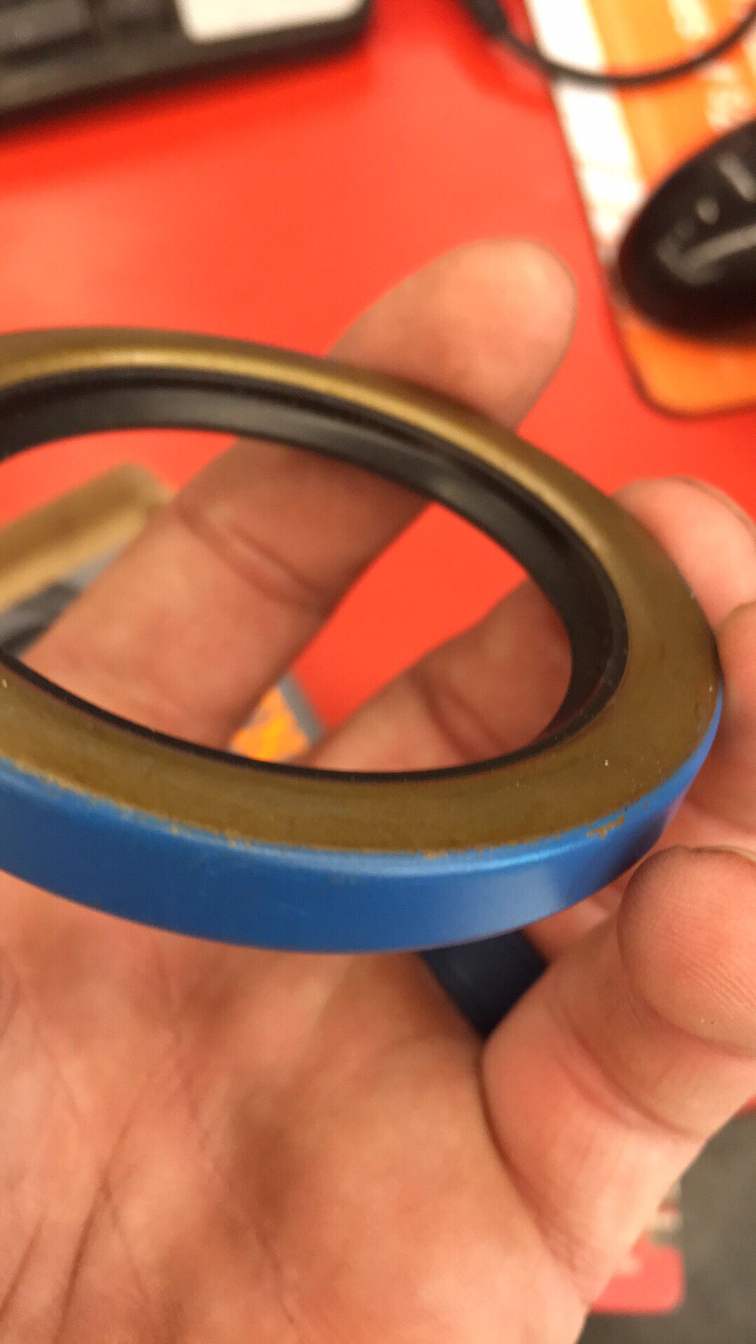

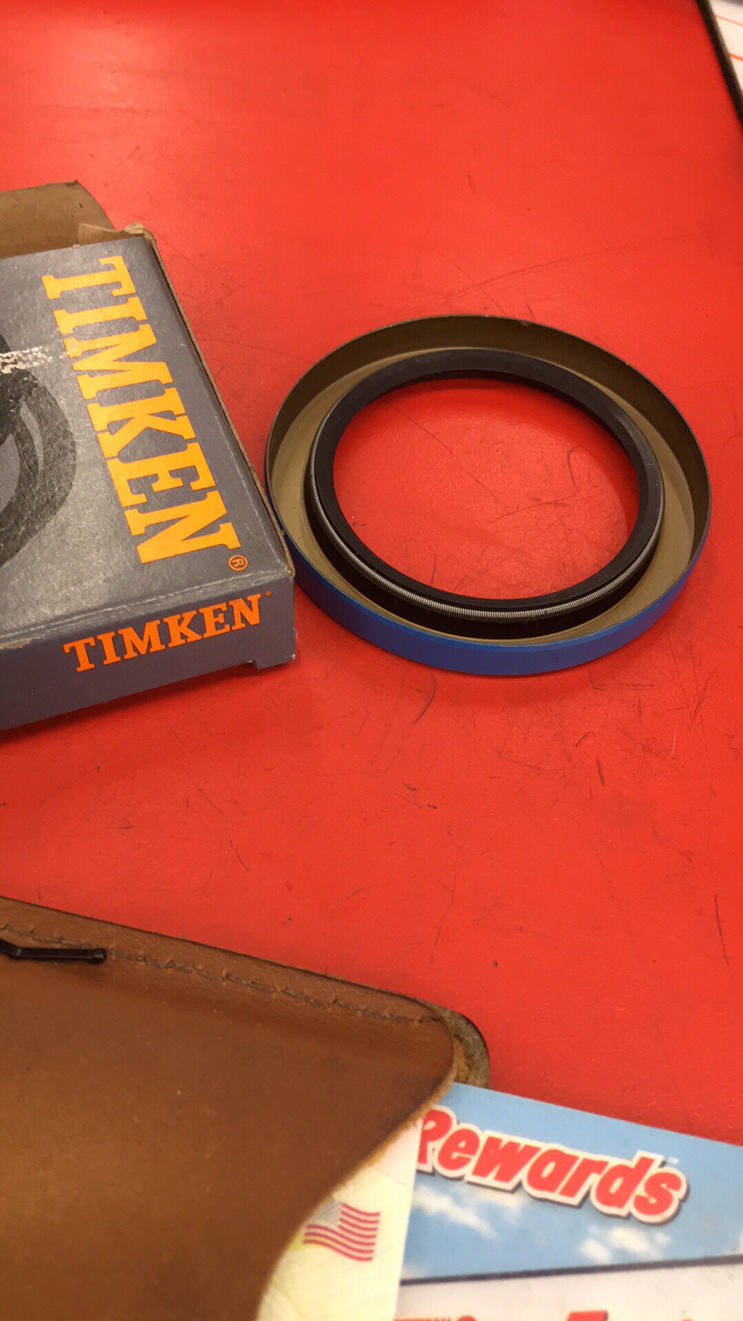

Thanks for the input.
This si the seal for the tcase
Crown Front Retainer Seal
And this is the seal for the trans
http://www.autozone.com/drivetrain/...last-transmission-seal/487308_413056_0_203252
First I cleaned up the shaft. Then realized I need to not skimp so tossed the pad and got the emory cloth. Got it all polished up.
Then located the proper seal. So hopefully better results this time. The rockauto seal is the incorrect one apparently.
Took special care to lube it up real nice. Went in super tight.

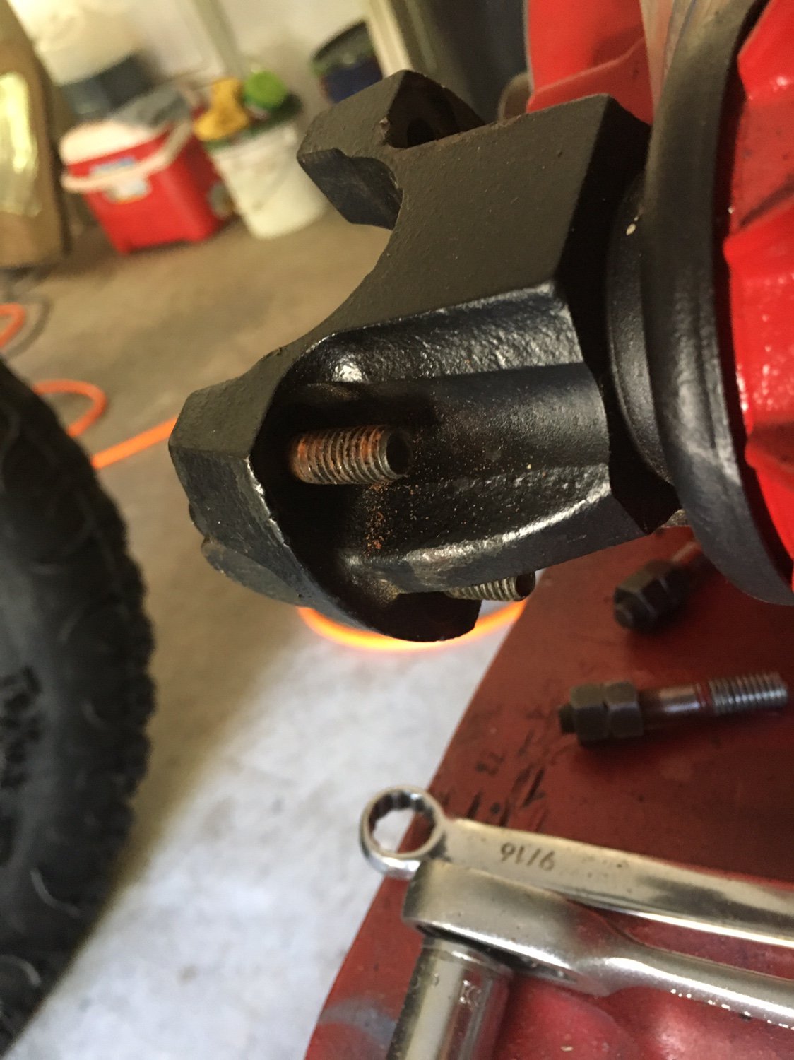

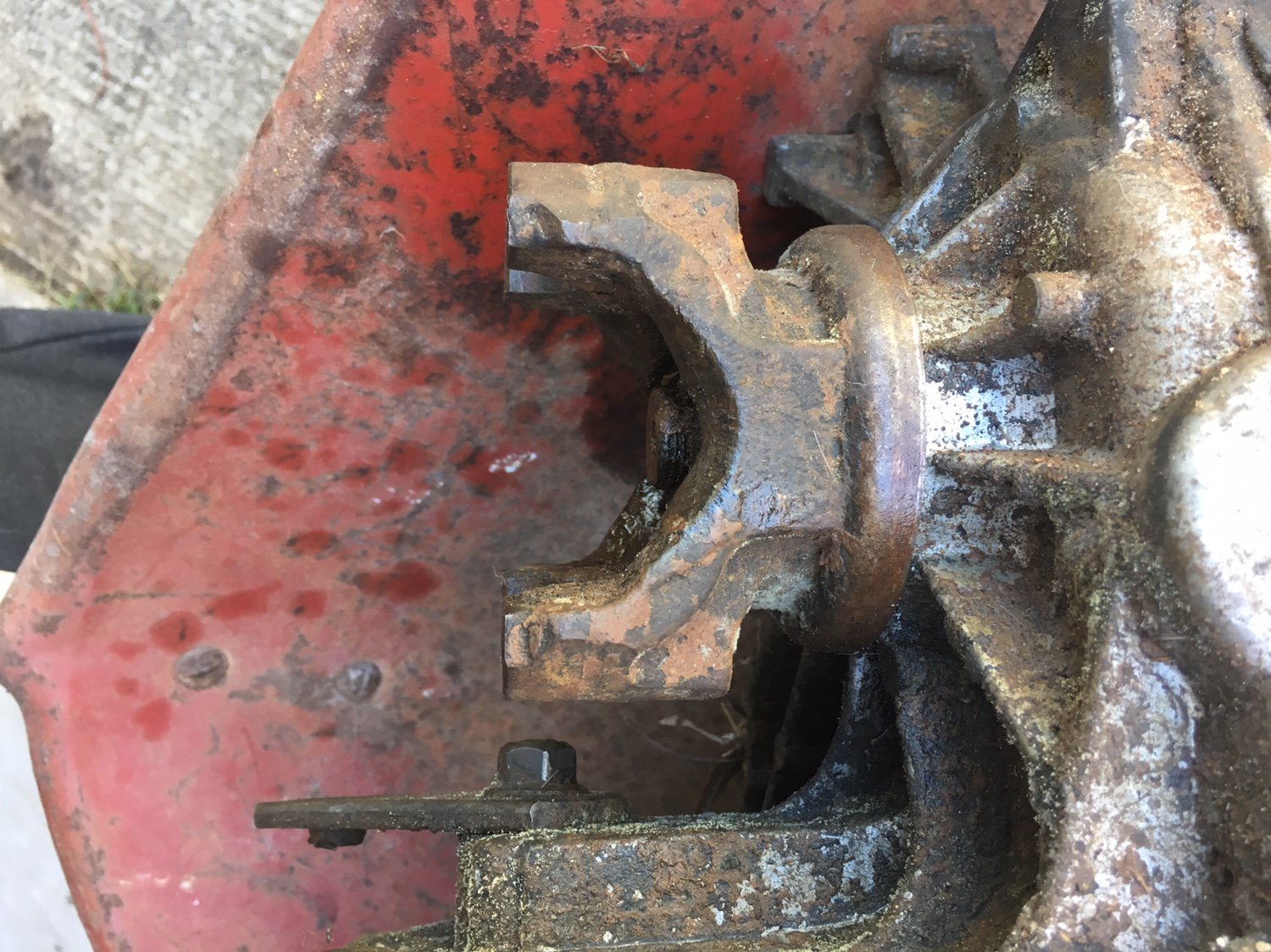

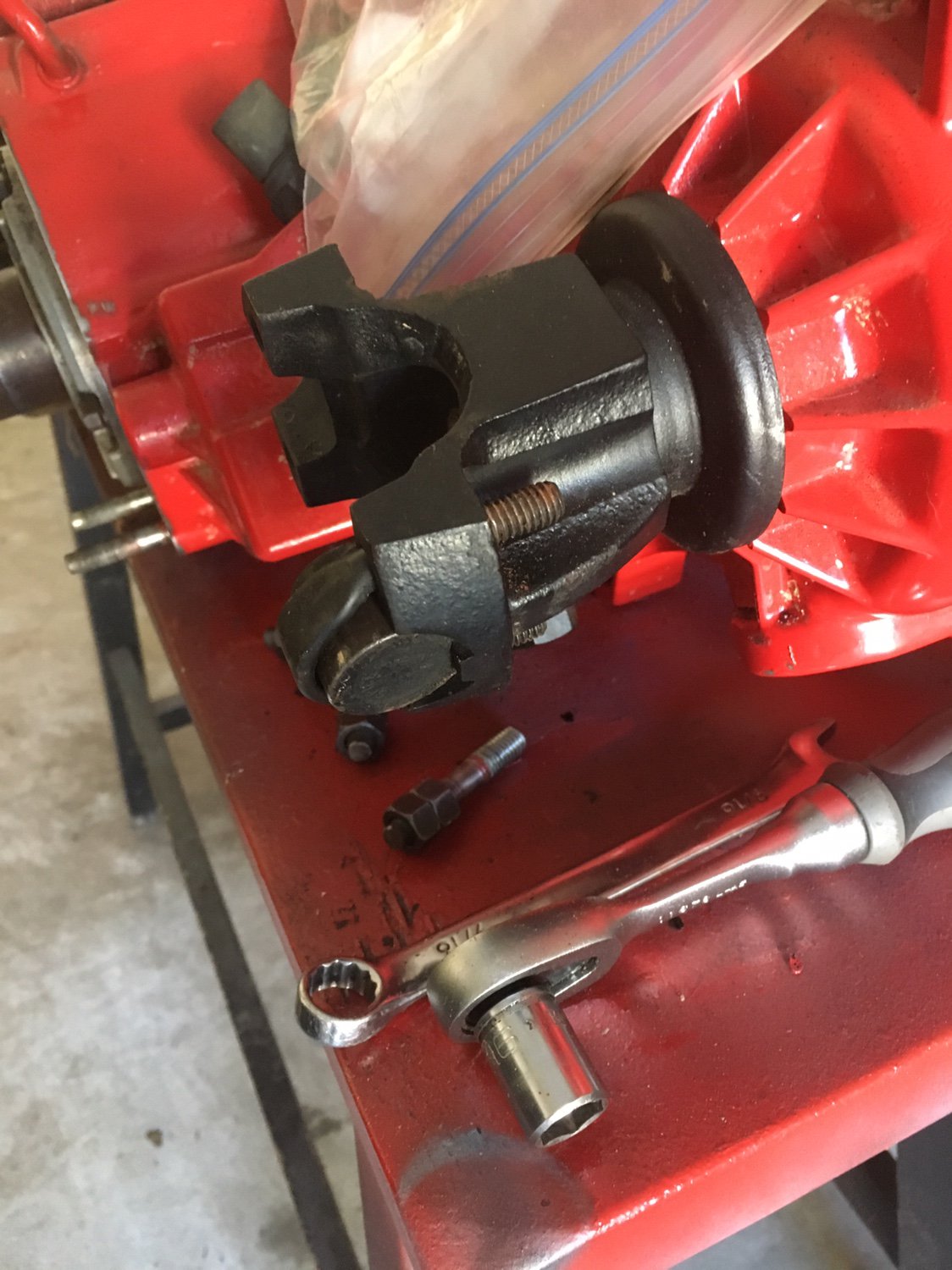

Then moved on to the non CV yoke removal from the old np207. But realized that yoke is way to massive to work with my current crossmember setup. On stroke of ingenuity? I dug into the scrounge bucket and dug up Dana 35 ujoint ubolts which fit exactly perfect into the CV yoke of the np231 (Dana 30 and Dana 44 ubolts do not fit even close). And the nut and washer size fits perfectly within the yoke recess. So gunna run this route and see how it goes.
Oh yeah...that should do it!
:driver:

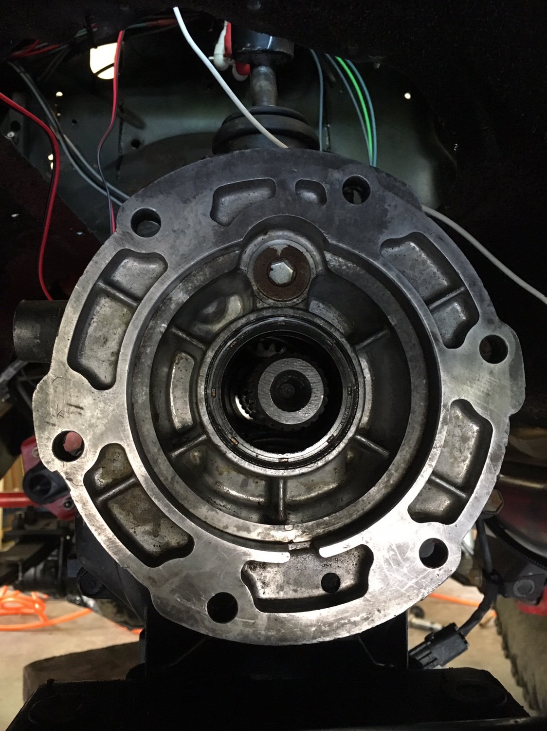

So Tcase installed with shaft. Drives great! Still got a small ever slow drip coming from BH area. Don't know if its front trans or engine rear or pan. Over pas 4 weeks no drop in oil dipstick so maybe trans. Dunno.
