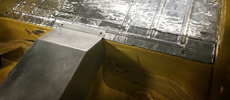

I think I want to build a flat spot like this from the firewall back. It would give me a great place to mount it and far enough away from shifter boots and what not.
And it could go all the way to the rear tub area like this.
Think is this flux core on the lowest setting lowest speed still melts this body panel sheet like butter. So dunno how I would build this or even attach to the floor. Hmm.

You could rivet/screw your box/tunnel down to the floor. With some rtv/seam sealer down first it'll seal up to the floor fine.

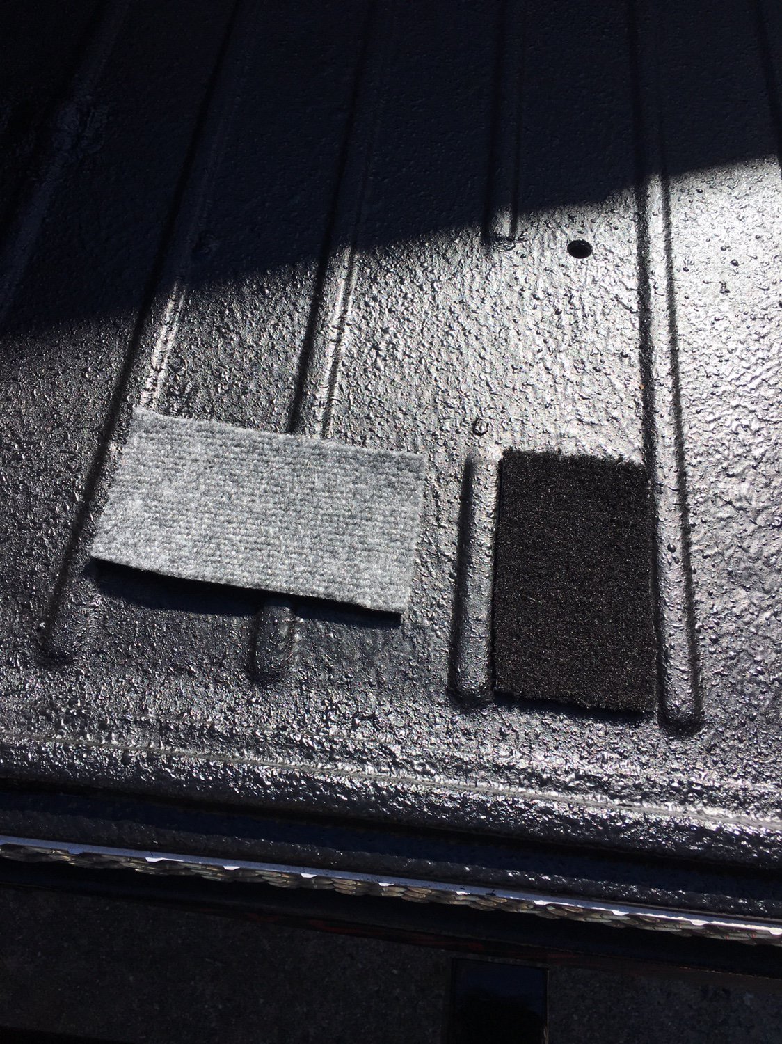

I'm hesitant to waste time special ordering boat carpets. So playing around with what Lowes has for outdoor carpeting. The grey seems to me the best choice to be combined with a 1/8 or 3/16 butyl horse mat.
I don't think I have the skills to mold stuff for "molded mat" like appearance on the floor. So this may be reduced to the rear area only and the floor pans in the front.
The idea is to provide some insulation against hot floors (I love driving barefoot) and some comfort in the rear on the wheel wells to reduce "hot to the touch" when topless and also to provide grip for the dog when he is riding co-pilot(rear).

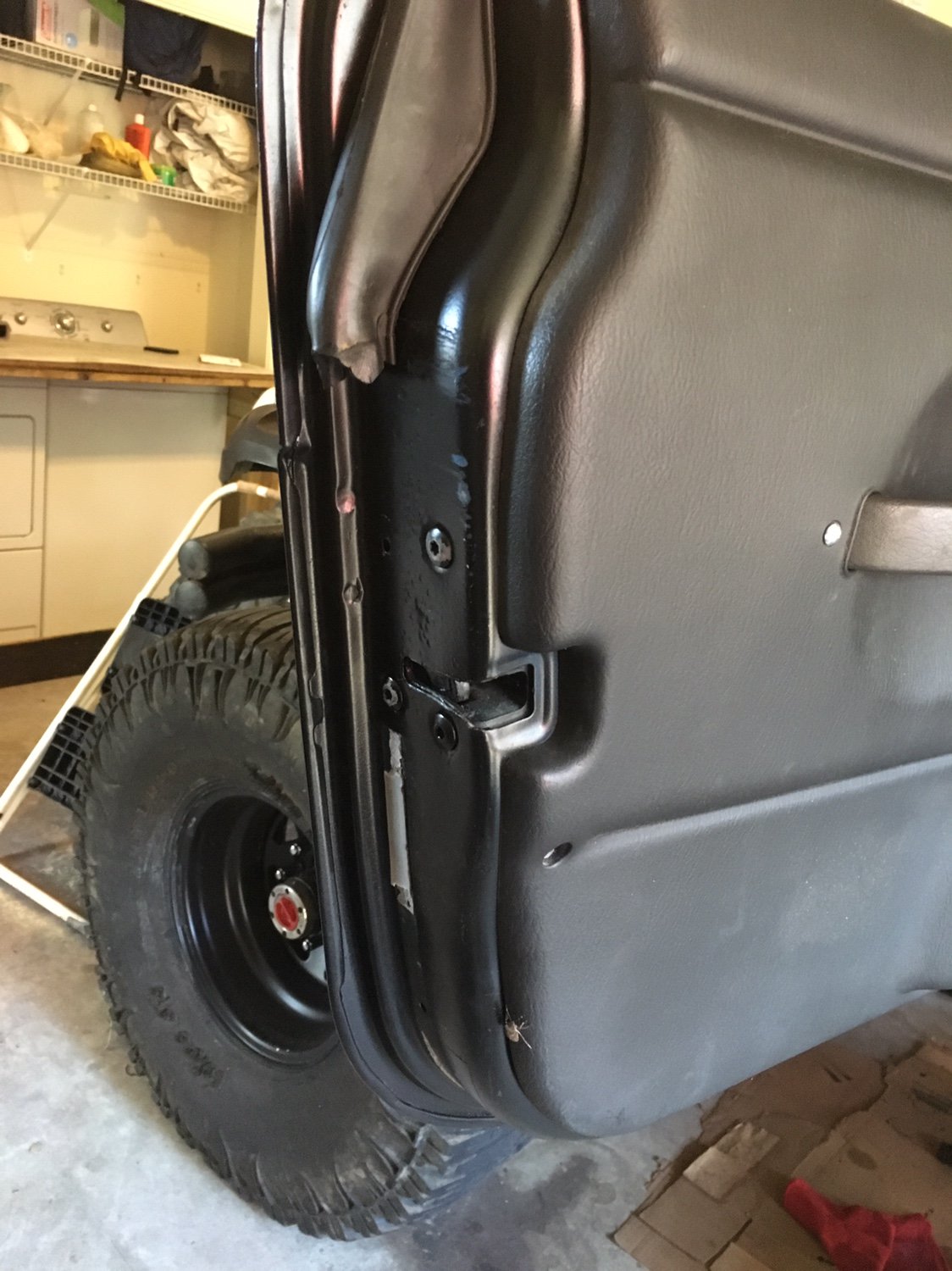

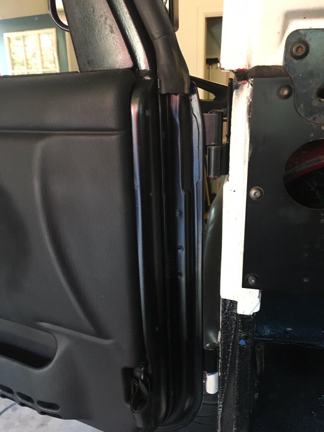

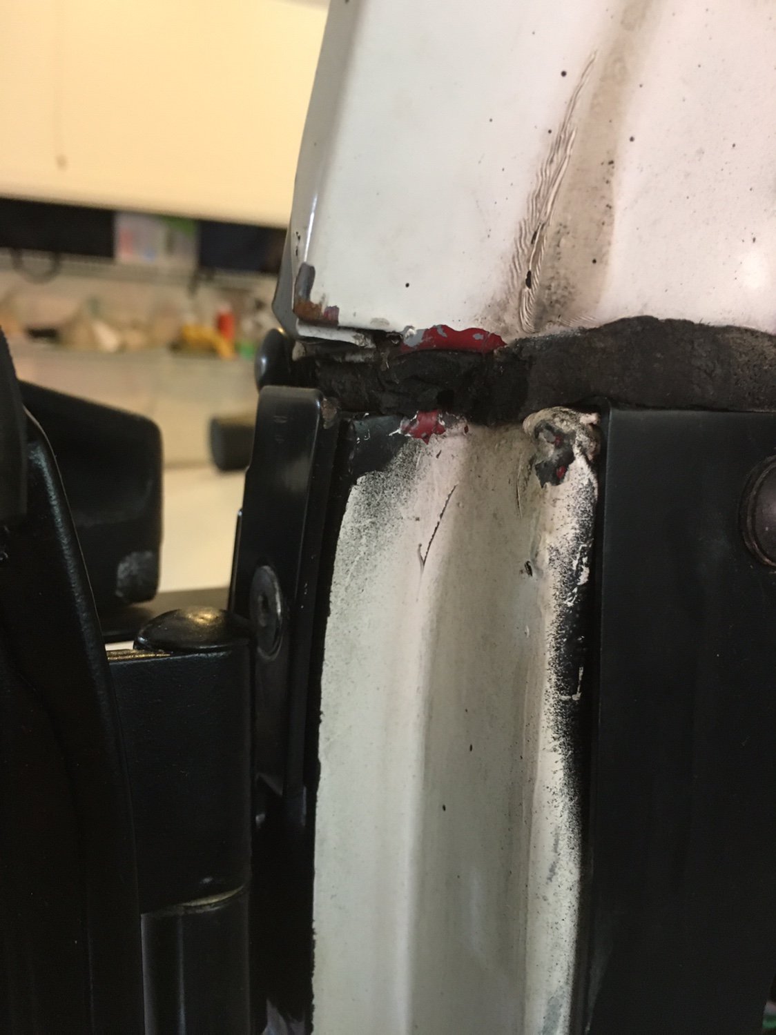

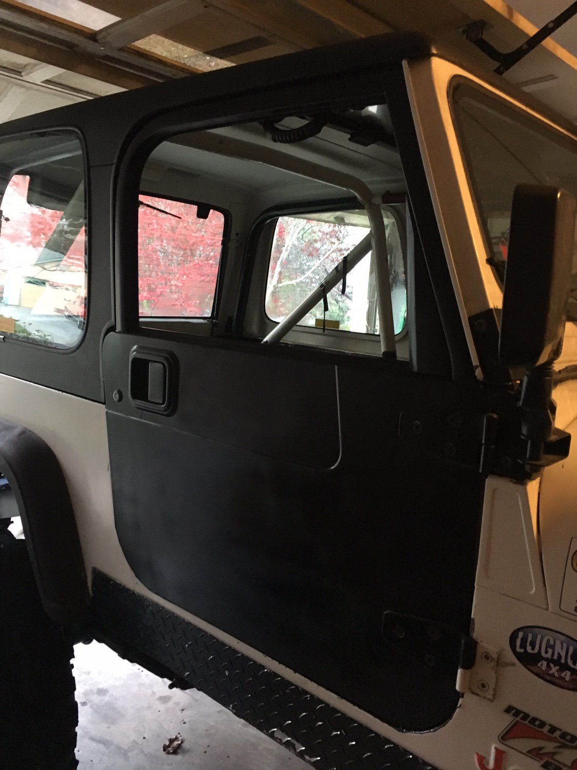

Got these doors aligned and working. Just need to bolt up the hardtop now. This tub has always had wonky fitment issues with doors. It was a good half day of man hours getting this worked out. Was able to keep the upper half of the weather stripping. I plan on using some strip to help seal up the lower half.

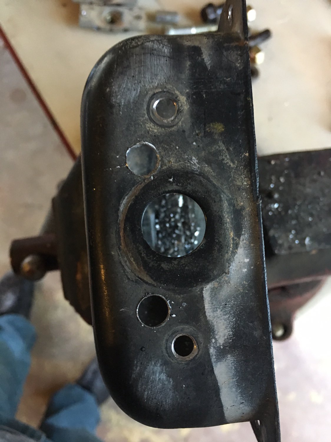

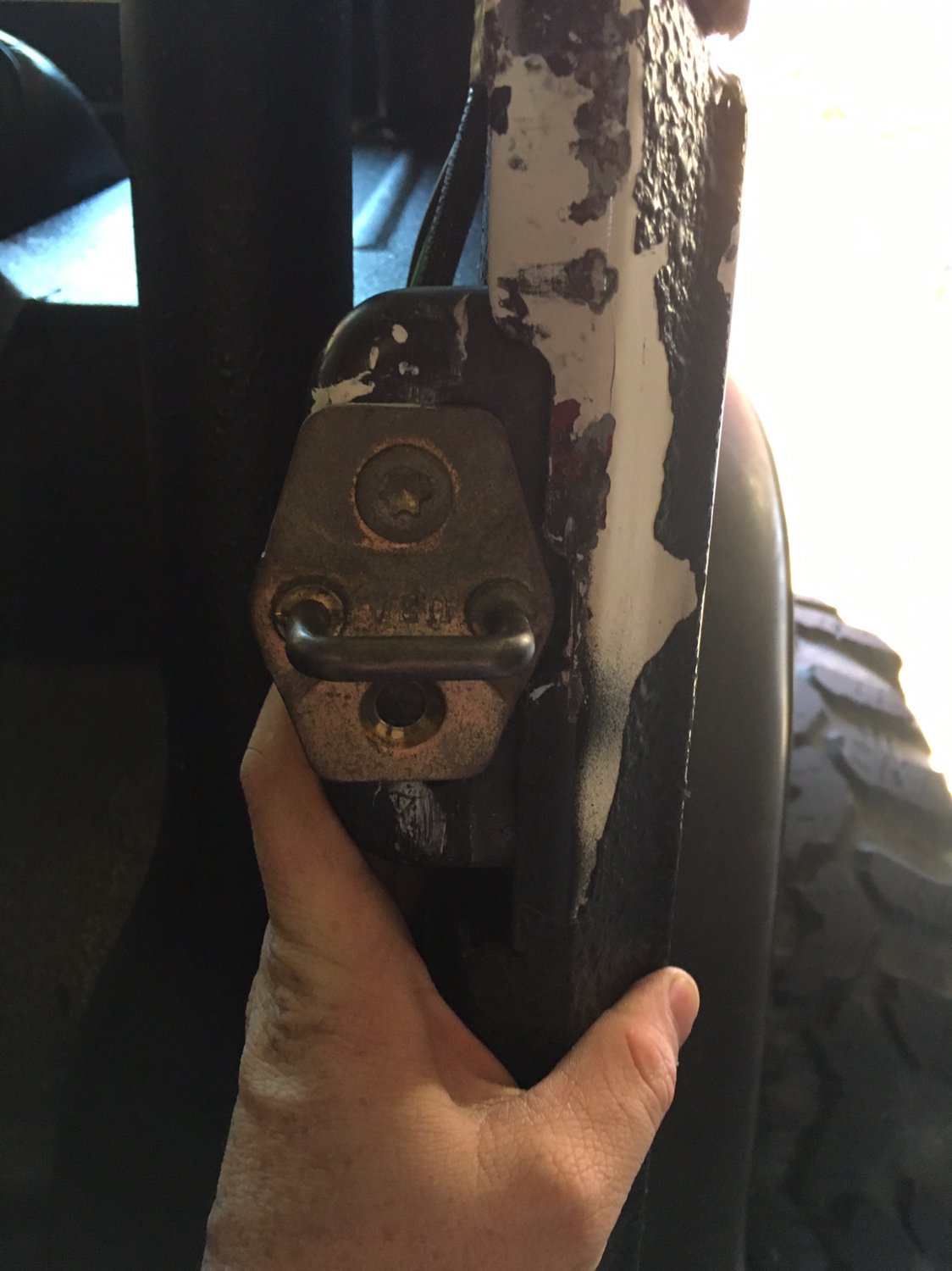

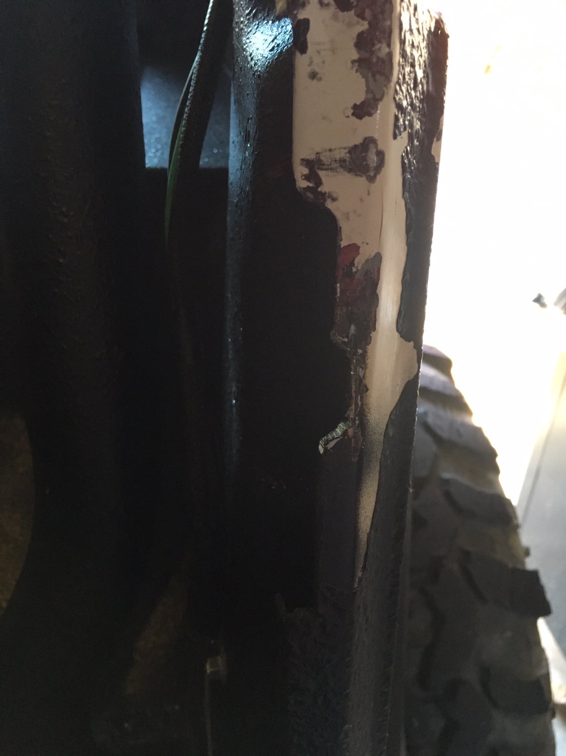

Drilled the stock striker mounts here. This is afar as you can go to allow the TJ stock backing plate to work for the TJ strikers.
Then you need to trim the body a bit here and then notch for the striker some.
Using self rappers I can now mount the assembly where it needs to go
Here i stopped trimming the weather stripping to allow this piece to seal against the hardtop notch
Here I stopped just short of the corner gap to allow some semblance of seal at that large gap. Also had to pull the tube insert out of their upper corner section to allow the stripping to collapse enough.
Also had to notch the windshield cowl seal here, where the square corner would normally protrude.
Doors fit and latch good!

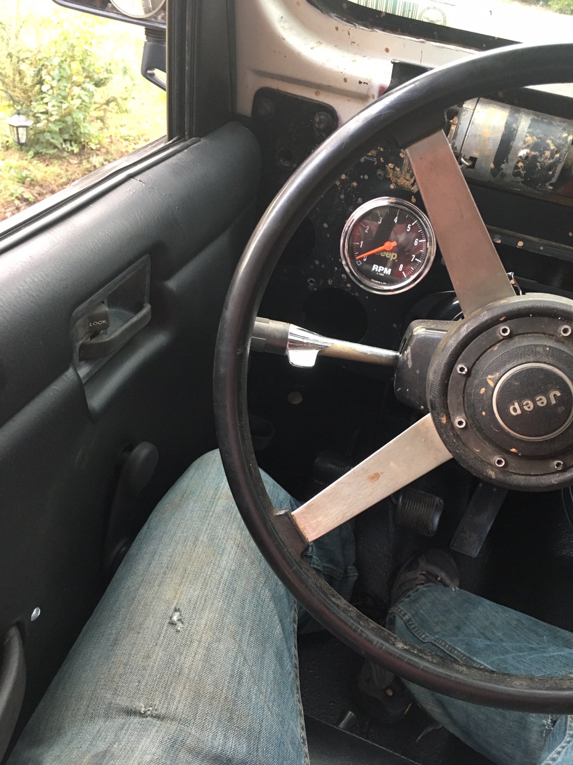

I guess I've never owned a YJ with doors because I never remember being this crammed. Or... I've hung around @Loganwayne too much and gained some sympathy weight. Lol
Not diggin it, but it's just for the winter.
You can go soft doors, but you loose that annoying insulation and roll up windows
Sent from my SM-G955U using Tapatalk
Sitting there I was like "people were satisfied with this in a brand new vehicle????" The door is so close to the steering wheel it could be dangerous
