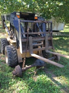

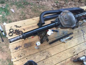

Got the d60 loaded up in the truck. Got it onto the deck and now ready to clean it up. This one will go so much faster as i hope to keep the perches as they are and use a small wedge, and reusing the stock shock locations. So just needs a dismantle and clean up

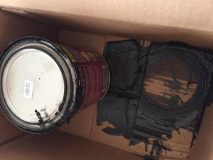

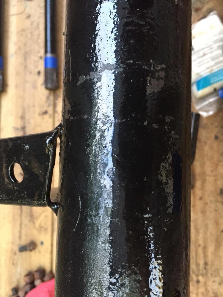

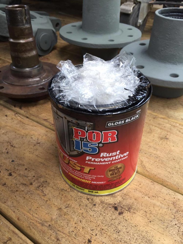

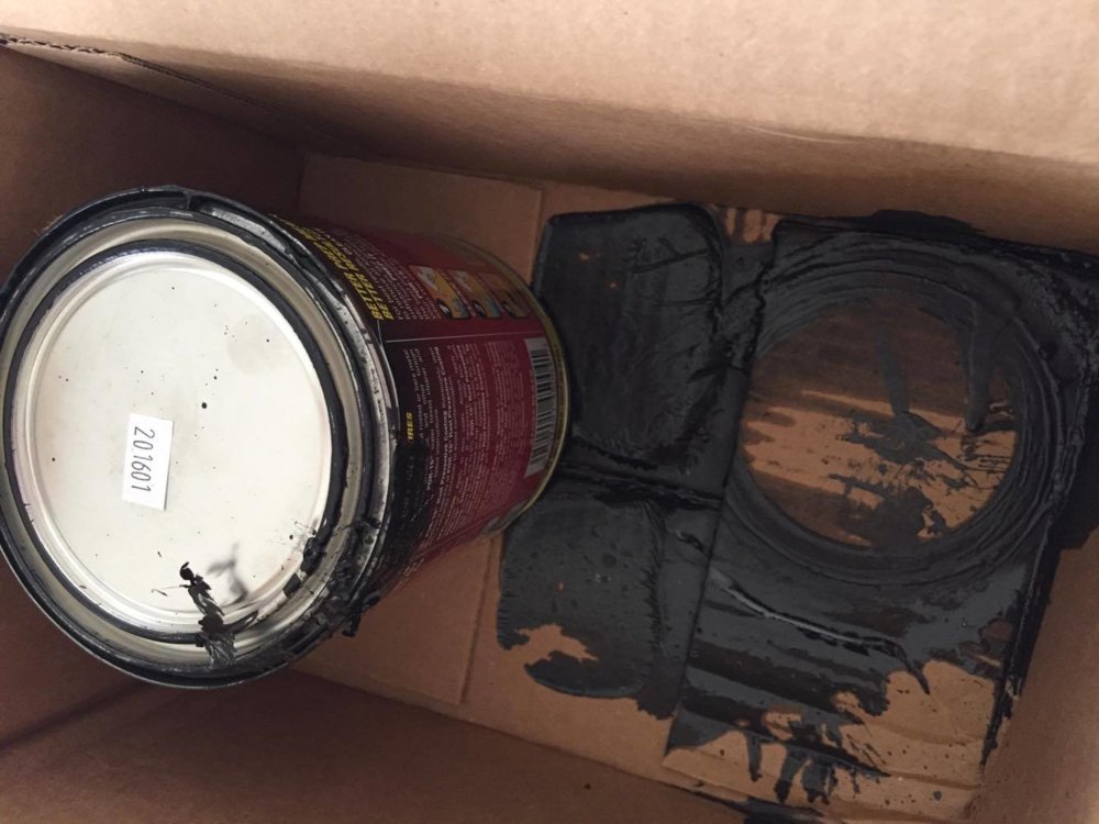

POR15 arrived. Leaking. So amazon was kind to send me a whole another new quart. I covered this up best i could and sealed. Going to paint some tonight or tomorrow. Hopefully some will still be good and Ill be able to make the new quart last that much longer. :)

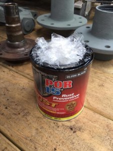

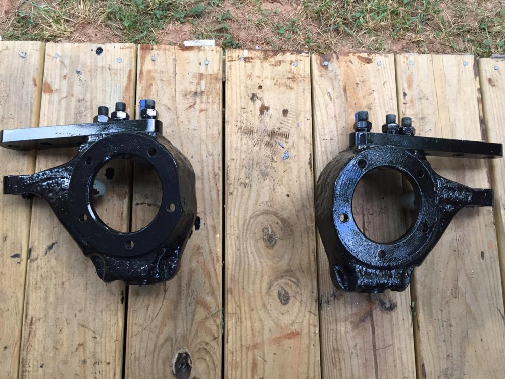

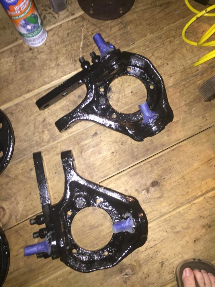

Decided to use what por15 i can in case it spoils overnight. The lid is warped and not sealing 100%. Well either way free liquid gold for me! Got some slapped on. Plan on satin black everything when its all dried.

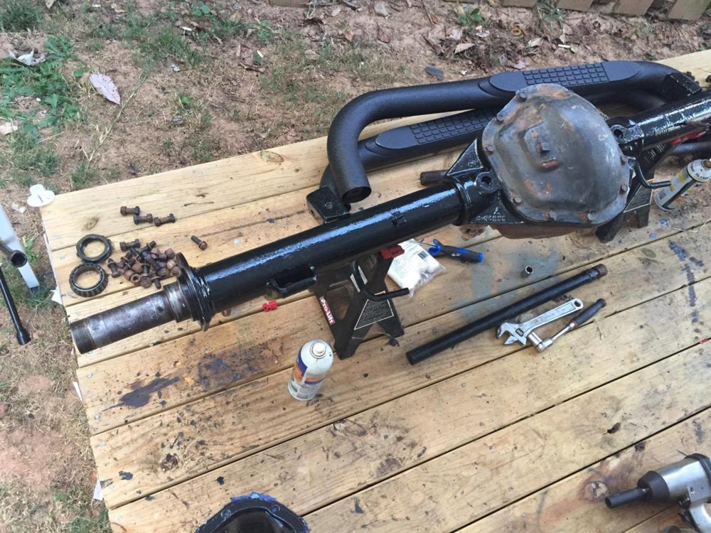

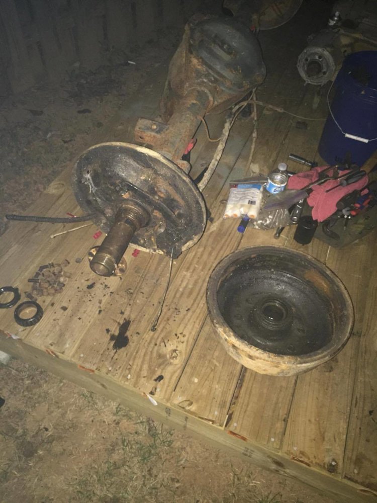

Started the d60 dismantle. ran out of light. boo. didnt have a locknut socket, so used an adustable wrench and a hammer :) will need to get one tho for install

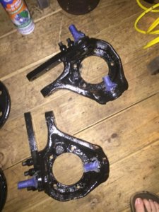

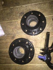

got the other sides of the knuckles and hubs painted. the underside of the axle as well

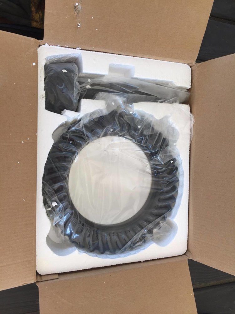

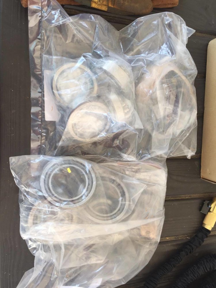

D44 r/p and master bearing kits for d44 and d60 arrived. excited.

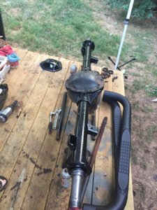

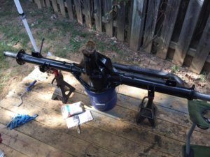

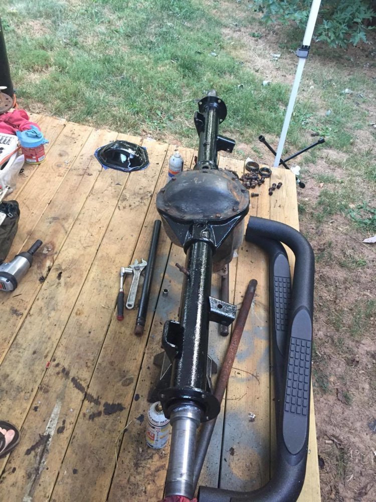

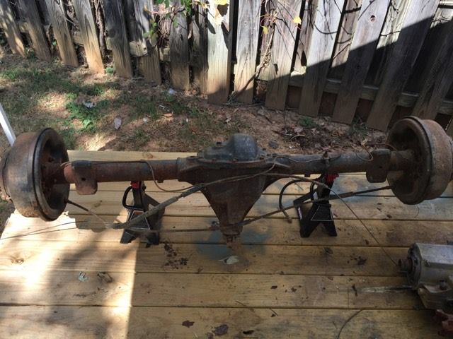

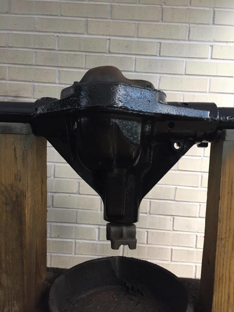

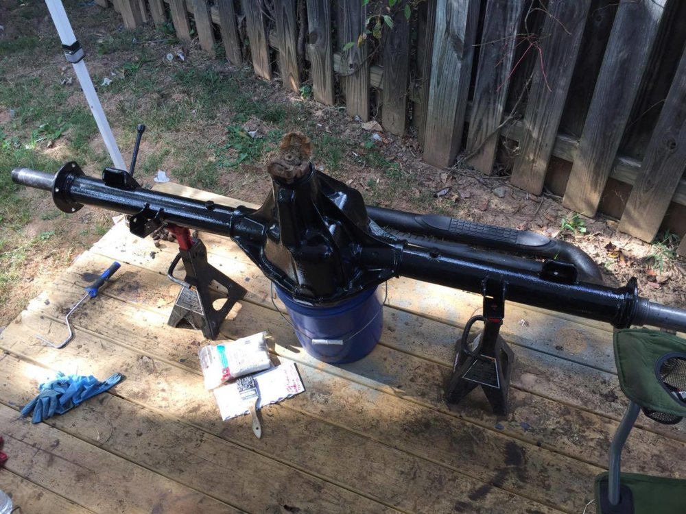

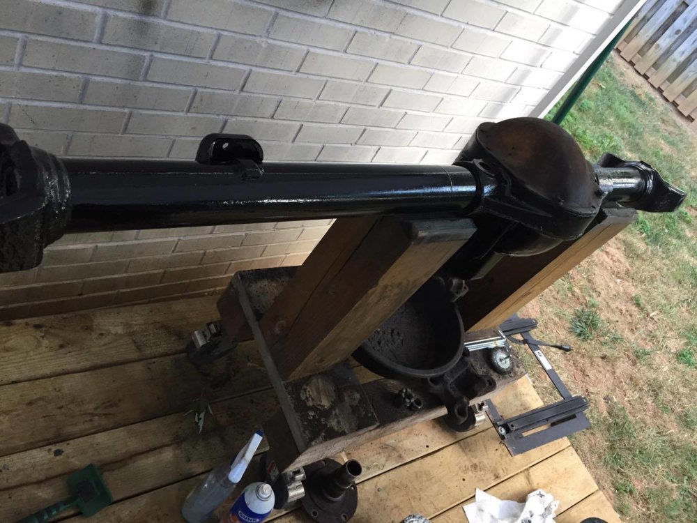

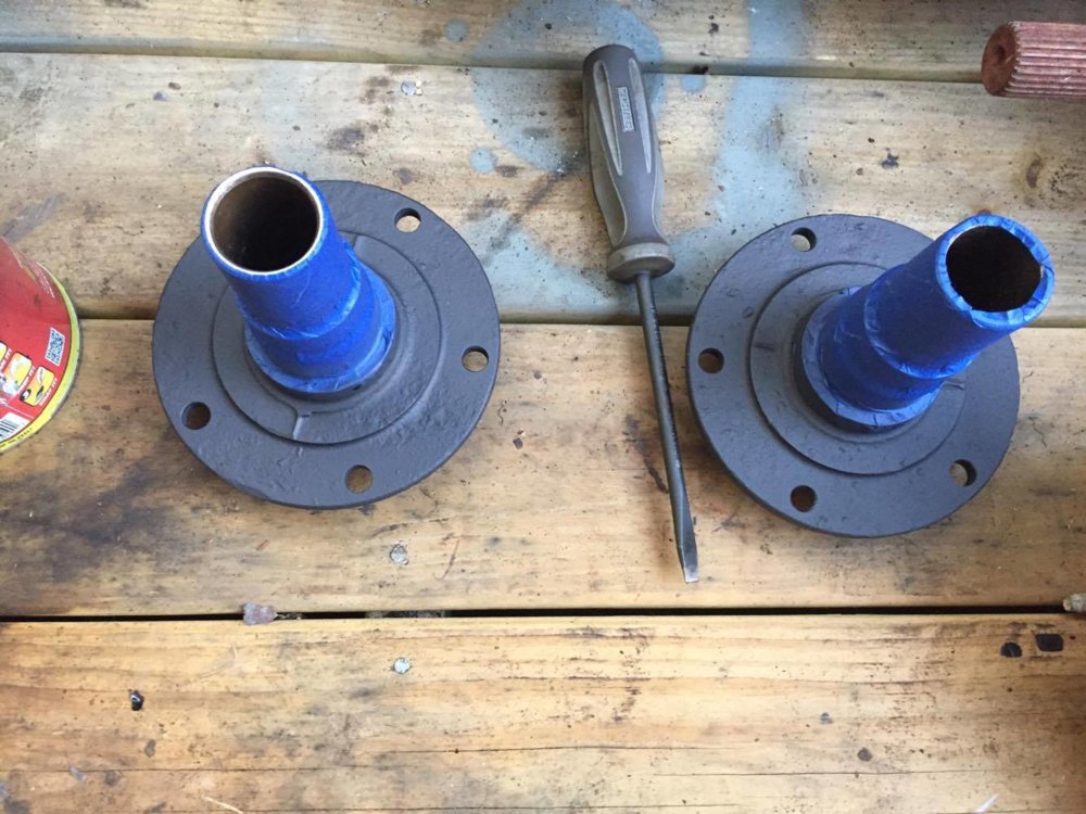

Got part of the d60 painted with por15. D60 is fully dismantled. Got spindles cleaned and treated with picklex20. Painted d44 diff cover and treated underside with rust inhibitor primer. Started to remove d44 gears.

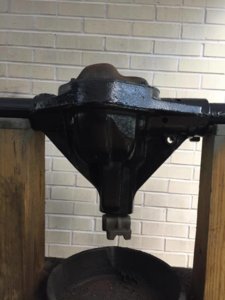

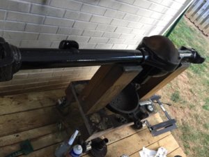

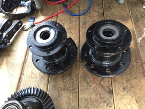

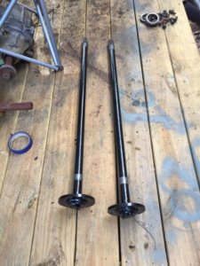

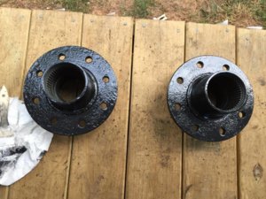

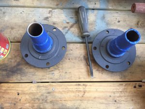

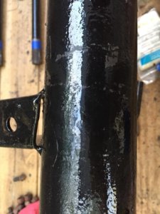

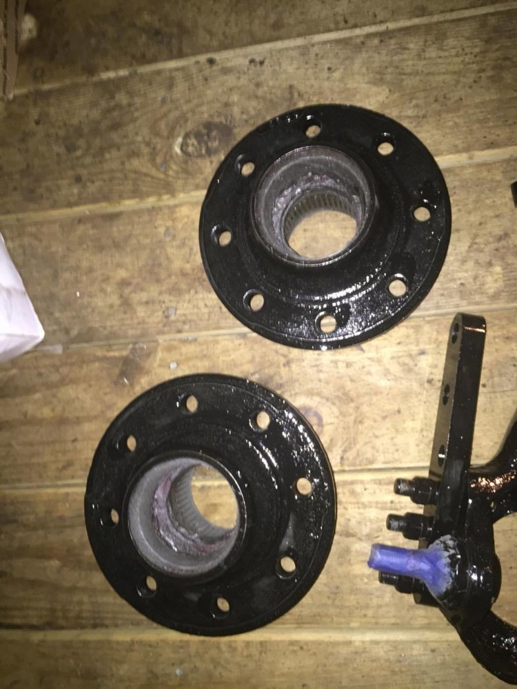

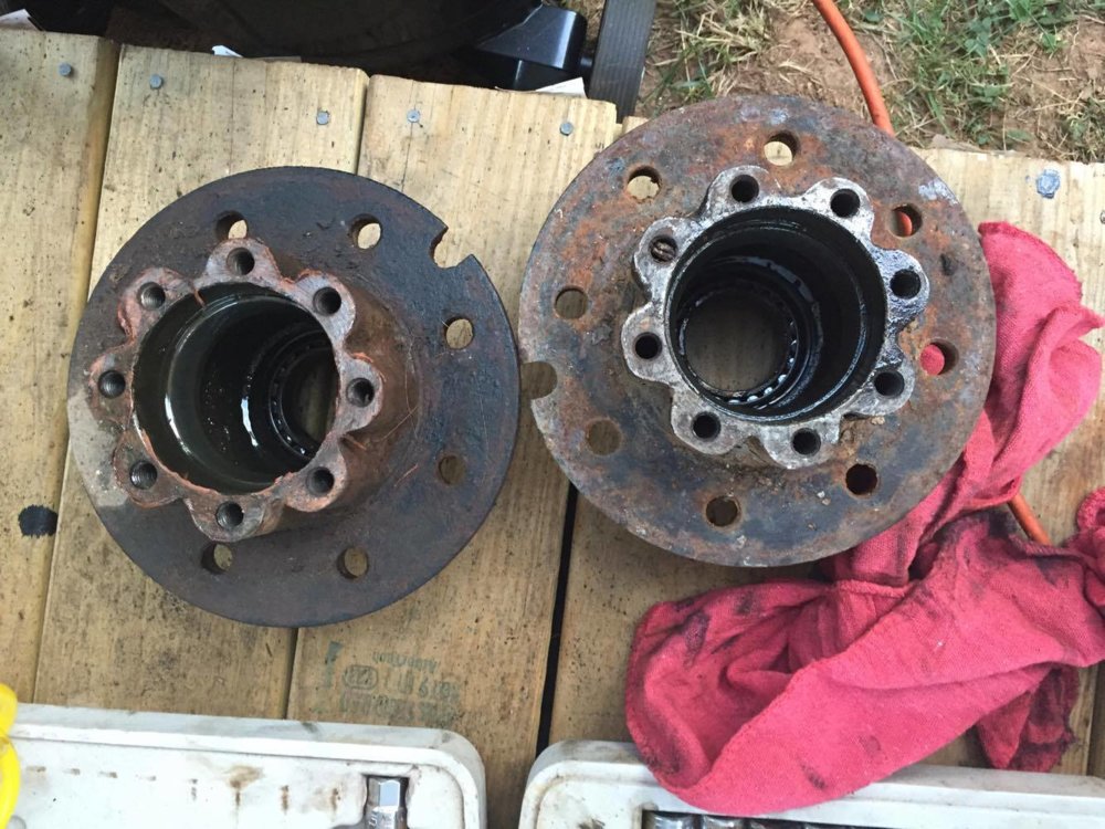

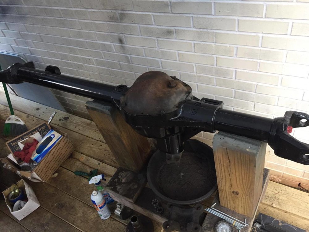

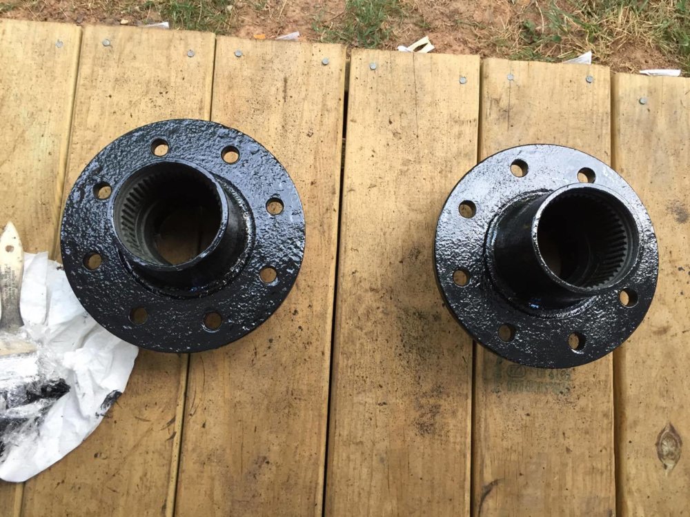

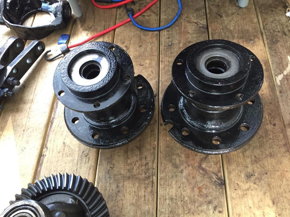

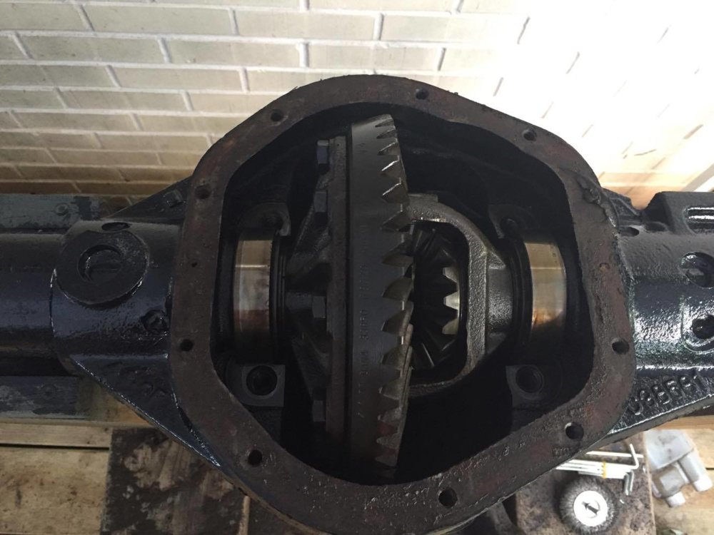

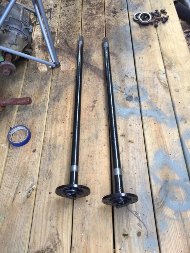

Got the d44 gears pulled. Was pleased to find perfect condition seals. Won't have to replace those. Excellent condition on the inside. No repaint necessary. Got d60 finished cleaned and finished painting with por15. Got d60 hubs and d44 spindles cleaned and painted with por15. Got d60 shafts cleaned and painted. I have the d44 spindles stacked on the d60 hubs to dry. Worked really well.
Now just need to go buy sandpaper for the spindle journals. And some UV protecting farm equipment paint to top off the por15 with a satin black.

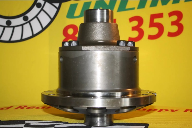

Picked up this display model truetrac for the d60! For 580!!! So excited.

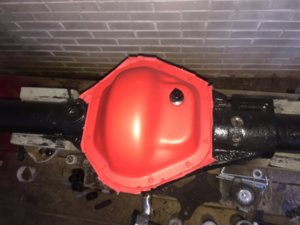

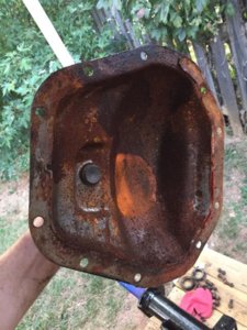

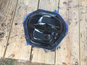

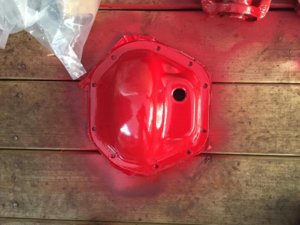

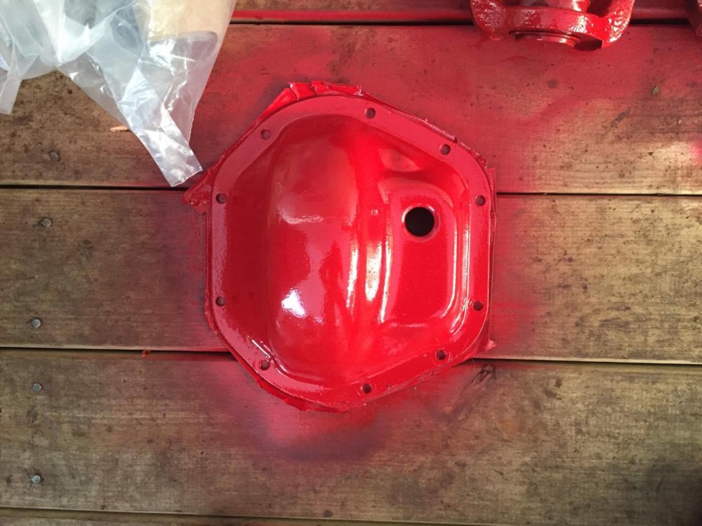

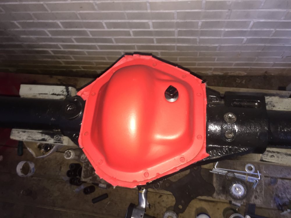

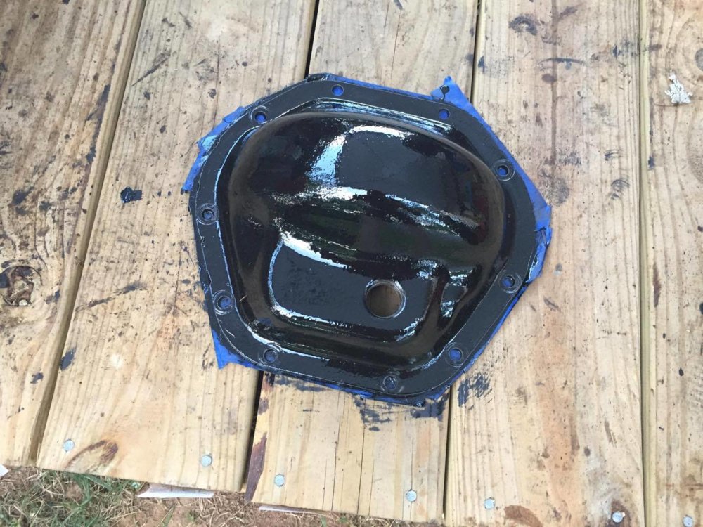

Painted the d44 diff cover. Did a coat of rust inhibiting primer, por15, 2 coats of red caliper paint, a UV protecting clear matte paint. Guess all I need to do is stencil ARB in it? Lol

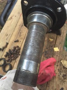

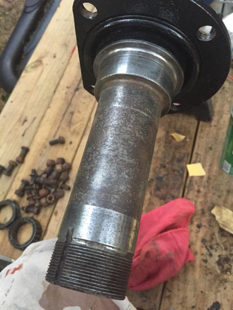

Didnt get much done today, but got the d60 spindles sanded clean

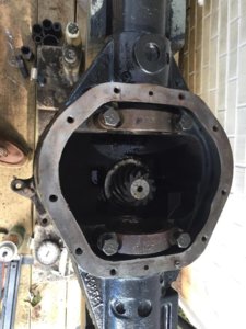

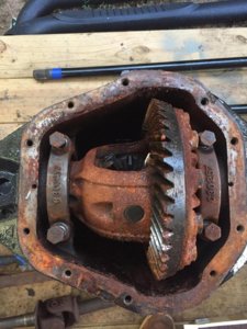

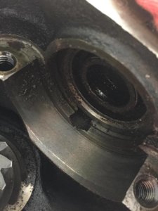

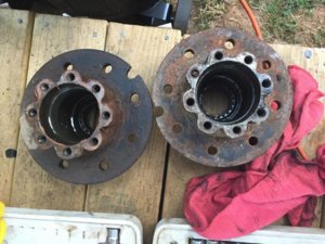

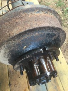

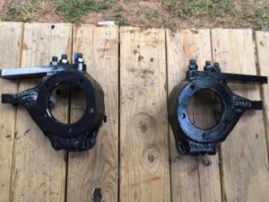

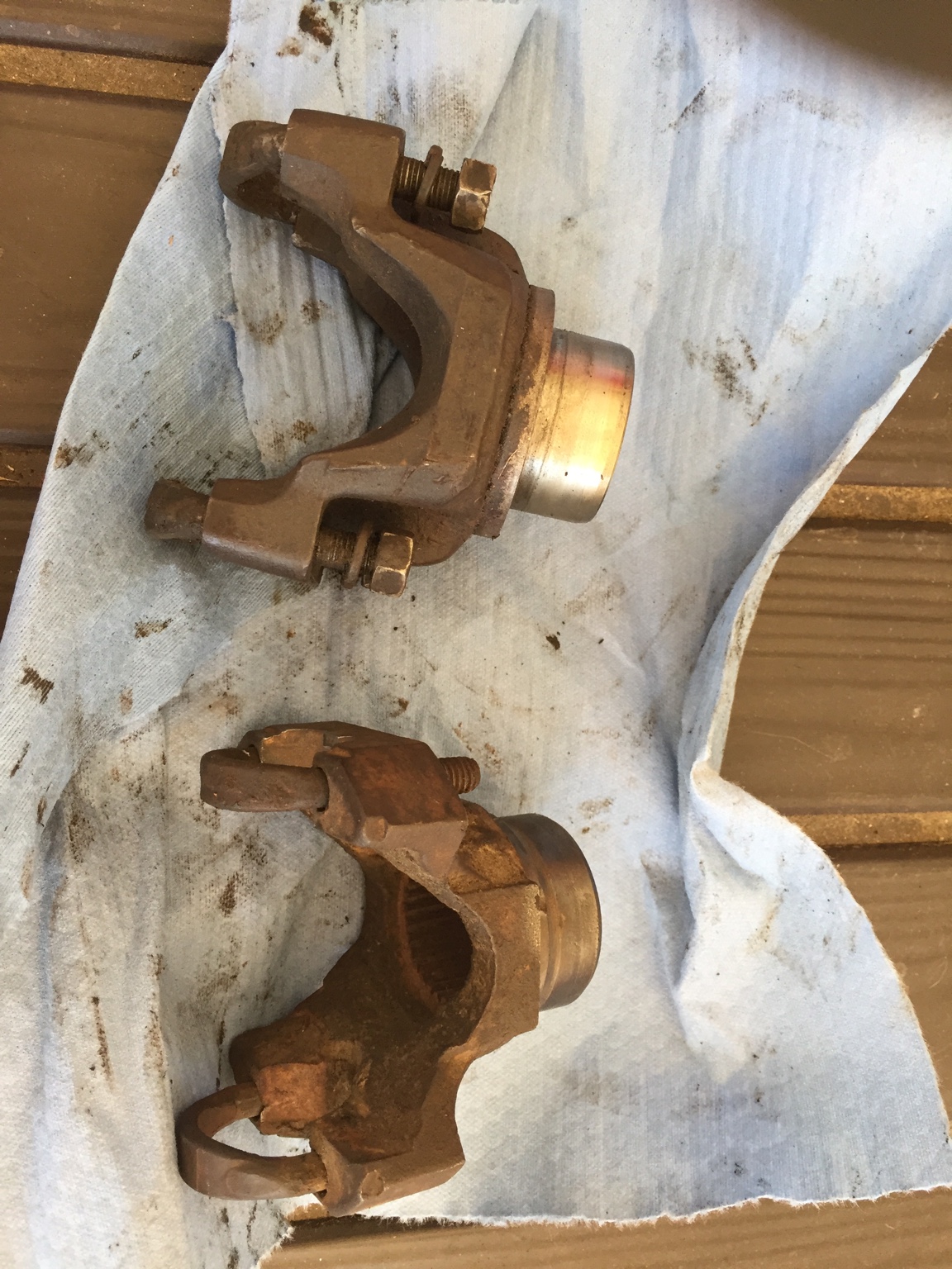

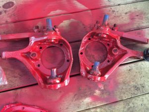

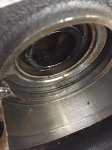

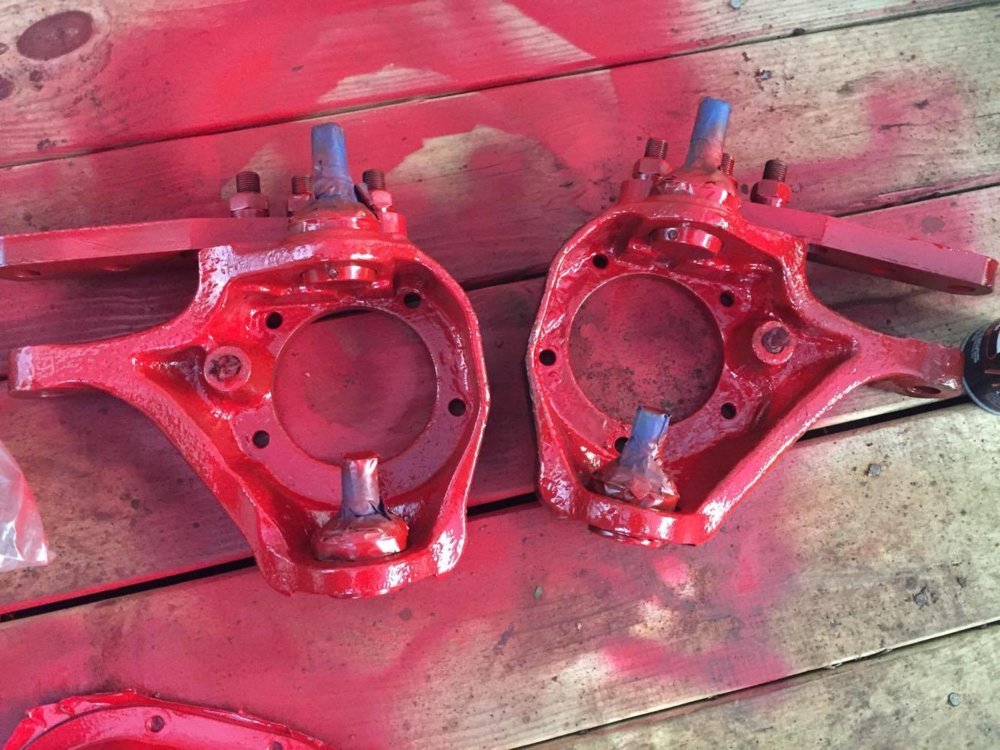

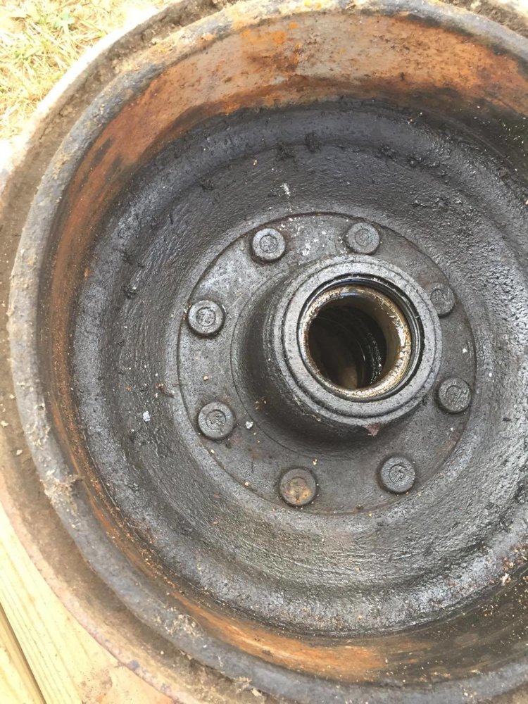

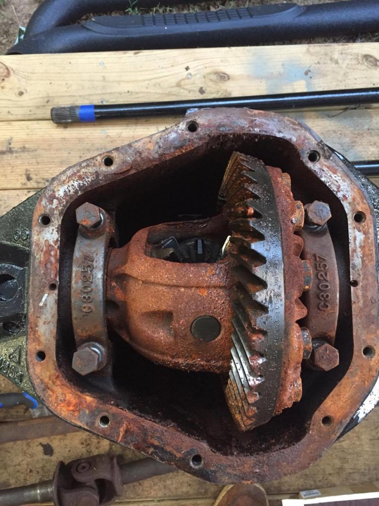

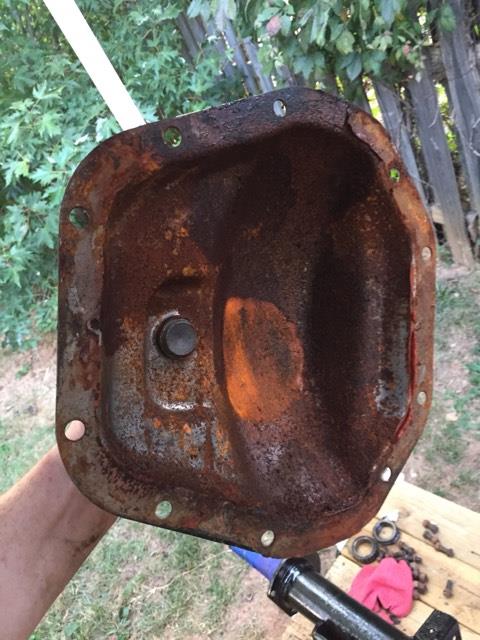

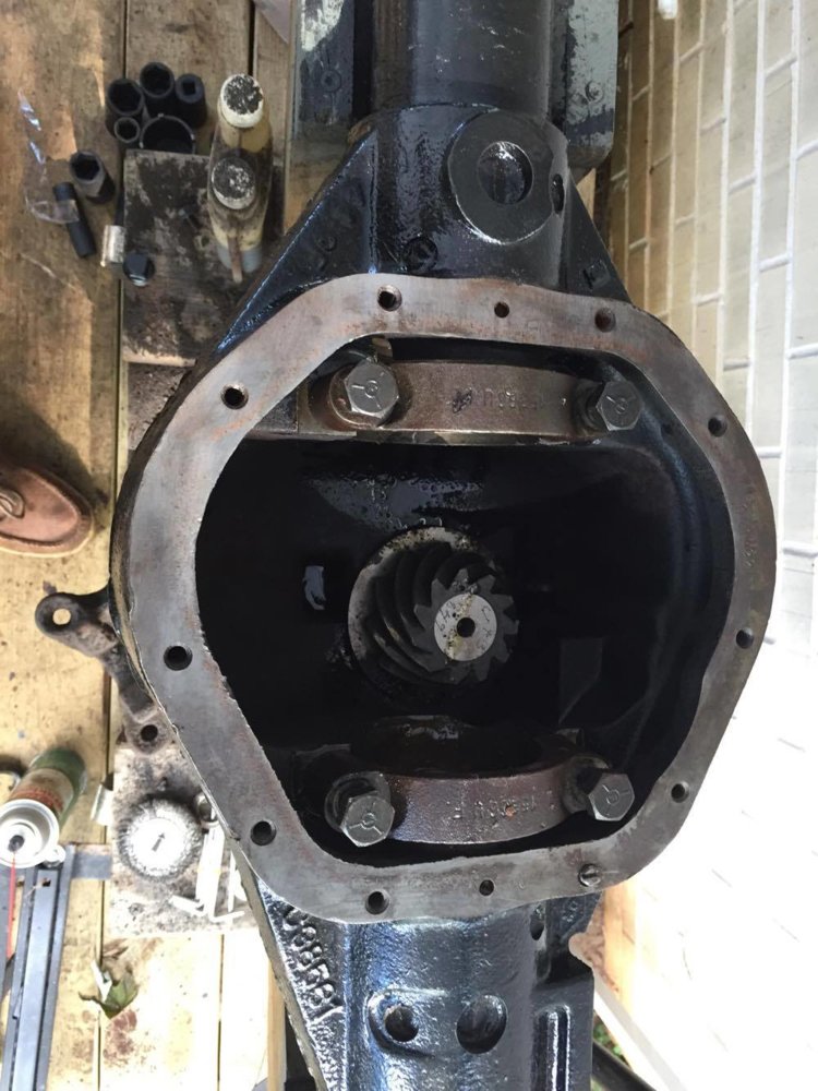

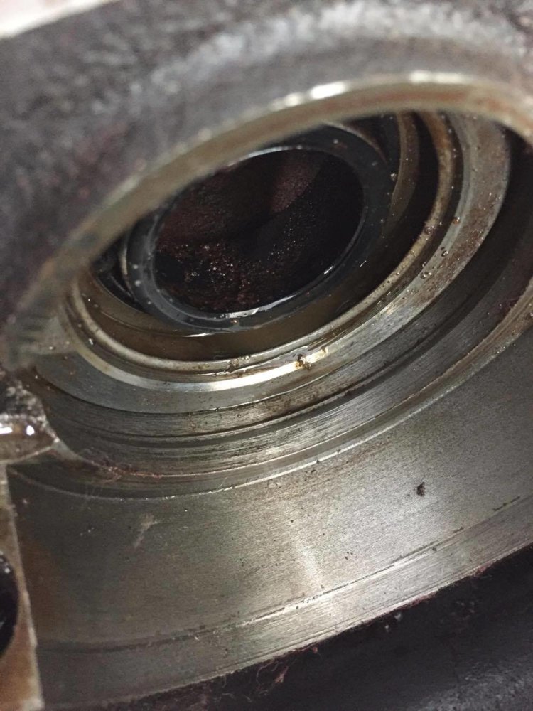

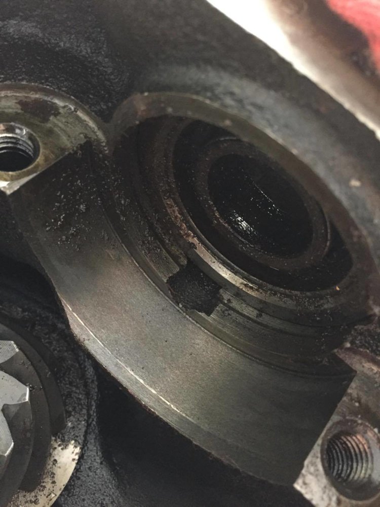

Okay. So found that dside of d44, part of the housing cast the carrier pinion bearing seats against on the bearing journal is holey. my local guru says were good to go, so moving onward! As you can see, the d60 had a nasty surprise for me when i opened her up. yum, this will be fun elbow work. Put to light coats of red on the knuckles, taking it slow so i can get a thick coat. Put another coat on the d44 diff cover because i didnt care for the matte look from the clear coat. I sanded down the d44 spindles with emry cloth. forgot to take a pic before wrapping so oxidation doesnt undo my work. lol. i noticed that i have put too light a coat of por15 on the axles, so prob going to go get some sponge brushes and try that way to get a thicker coat. just rotating the axle on the jack stands took it off. no go for gravel protection! i also shot the d44 spindles with some satin black over the por15. dont care for it, so going to return the paints and get semi-gloss.

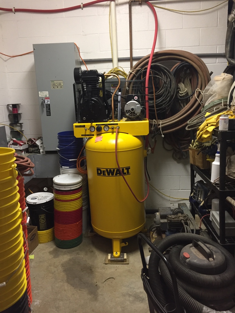

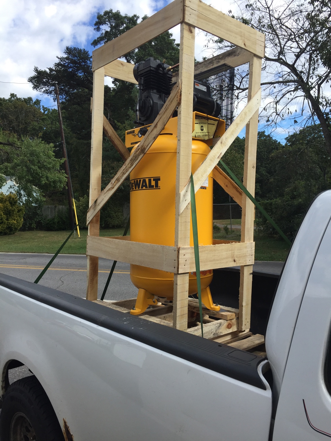

Massive Builds require Massive Tools :) :) :) Now to make room in the YJ engine bay for it....

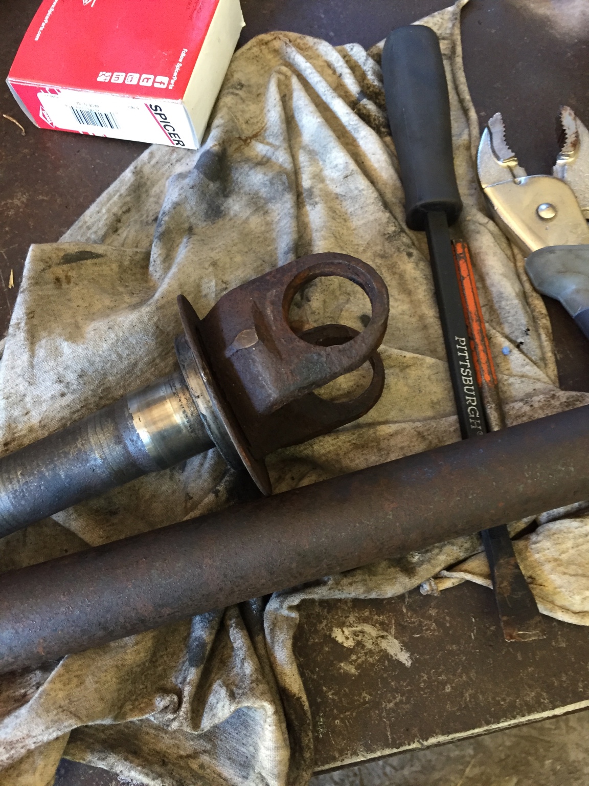

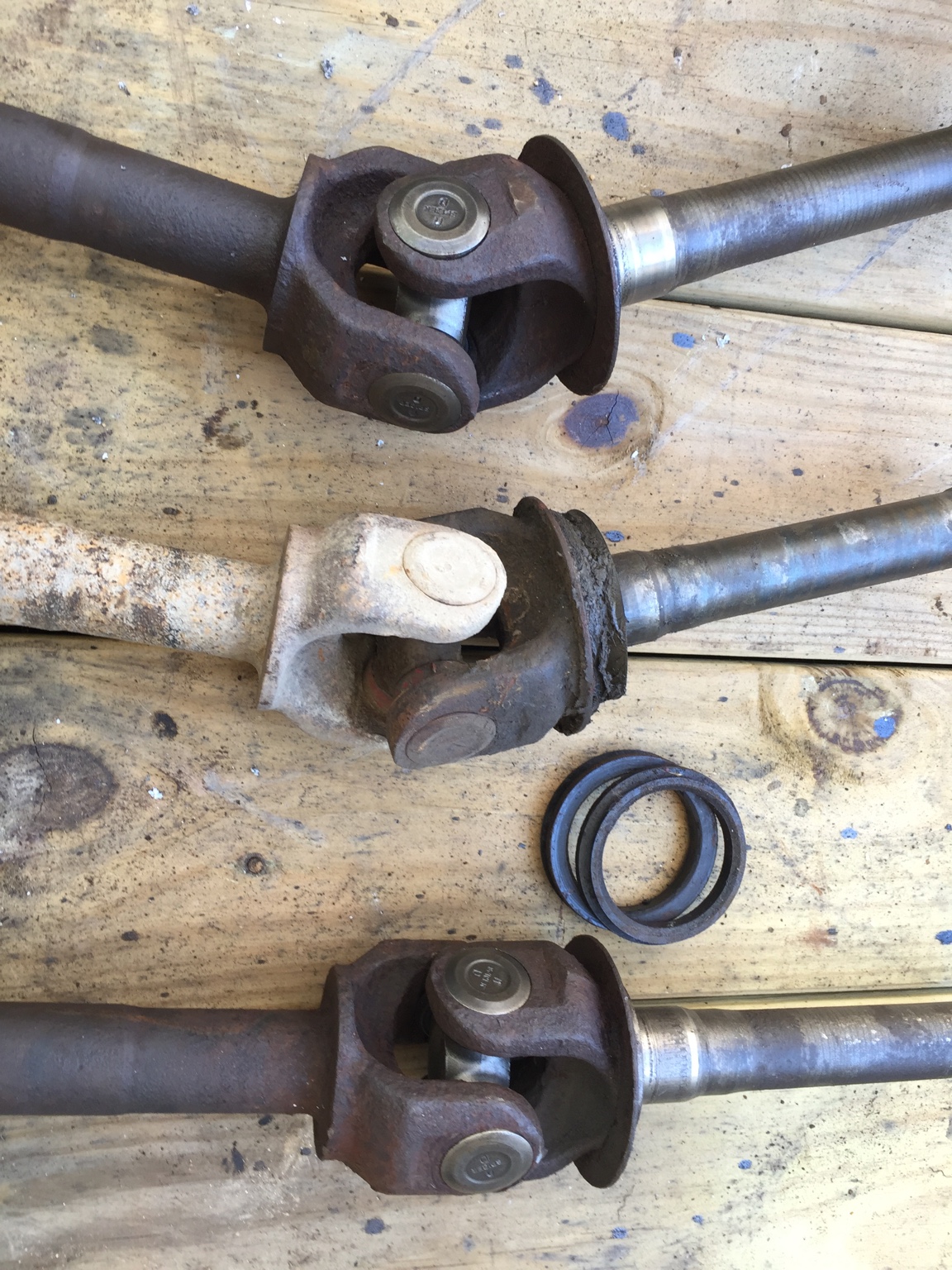

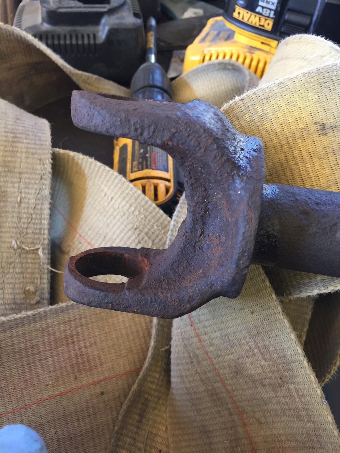

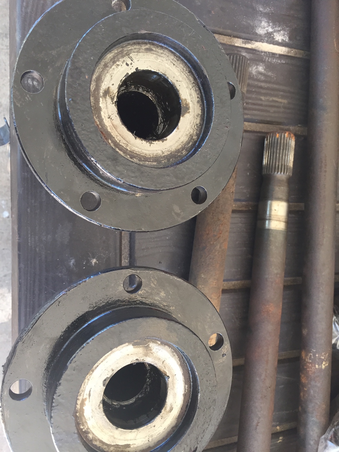

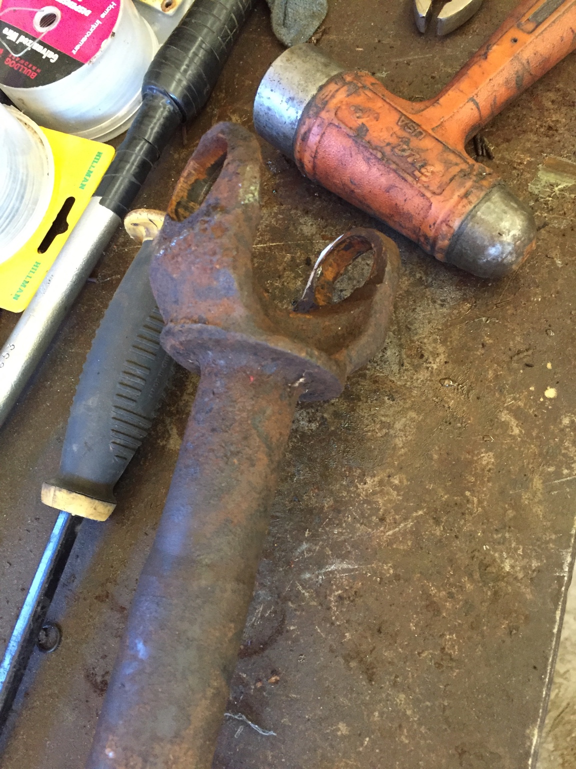

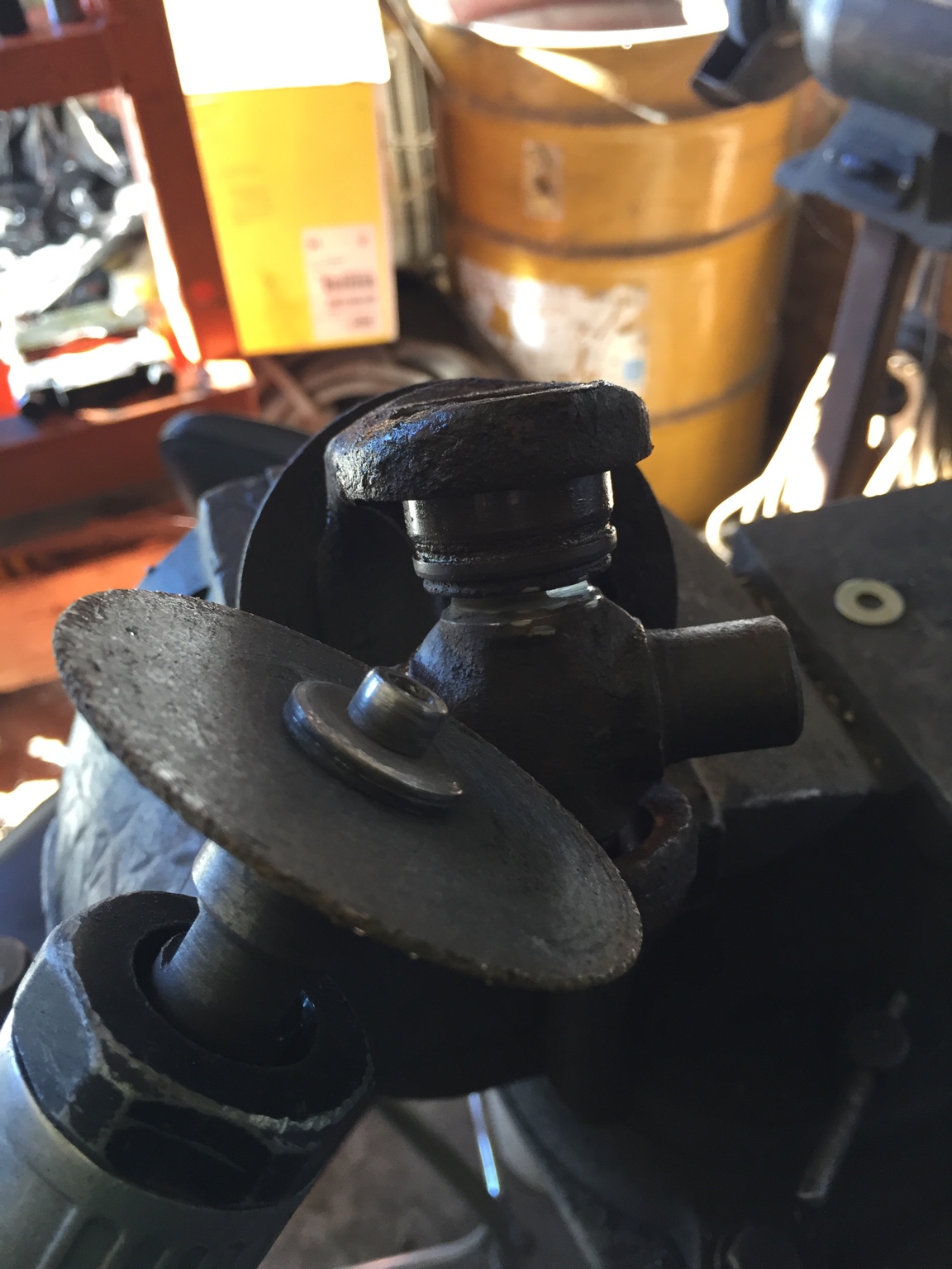

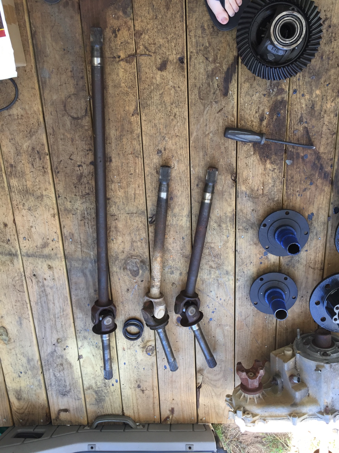

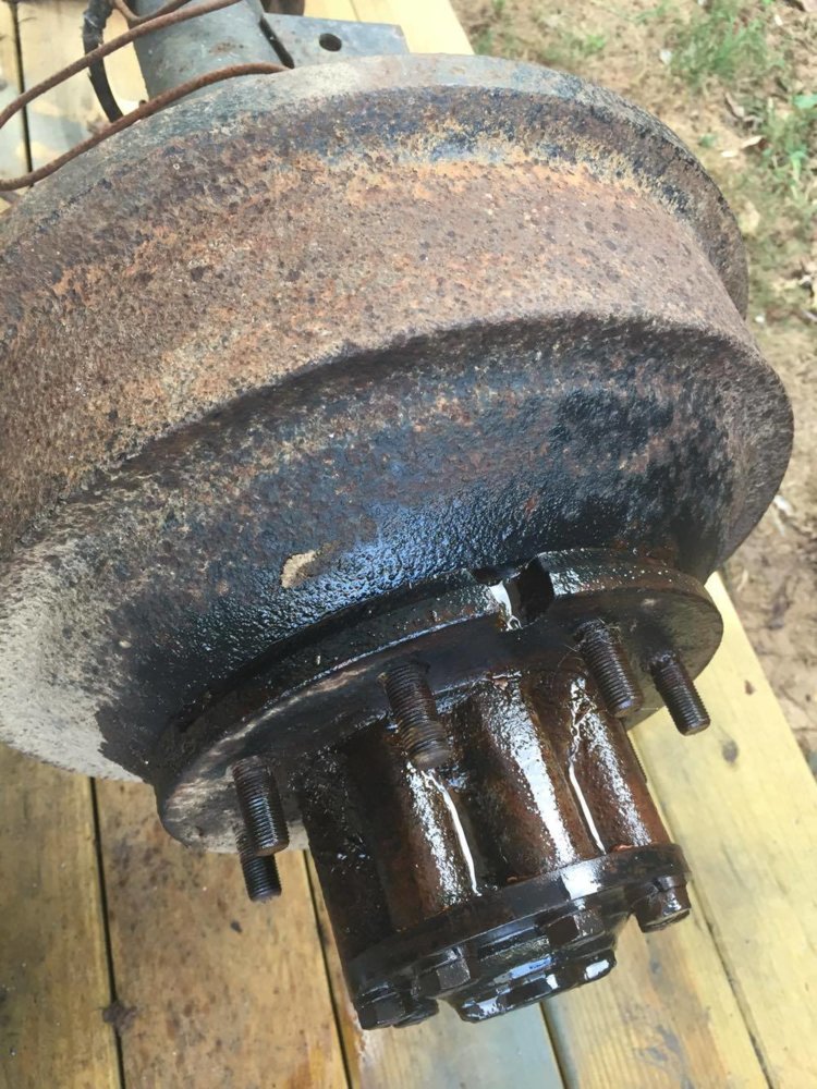

This rusted junk gave lots of trouble getting axle shaft ujoints pressed out. Well, some less than desirable discoveries but gunna run em. Praying they last five years. Haha.
Here's some more pics :) pulled the spindle bearings and got the new ujoints pressed in. And picked up a spare drivers side shaft with new ujoint in case mine with the odd ears breaks on me. Also picked up 1310 ujoints for the pinions so that my dshaft ujoints are the weak links.

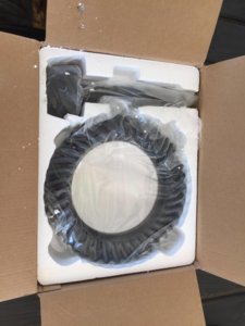

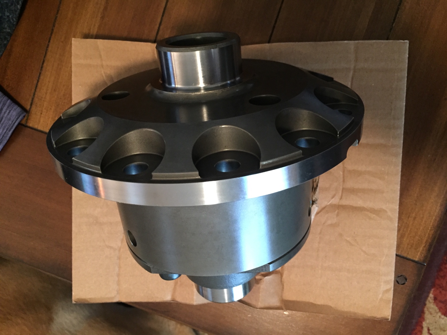

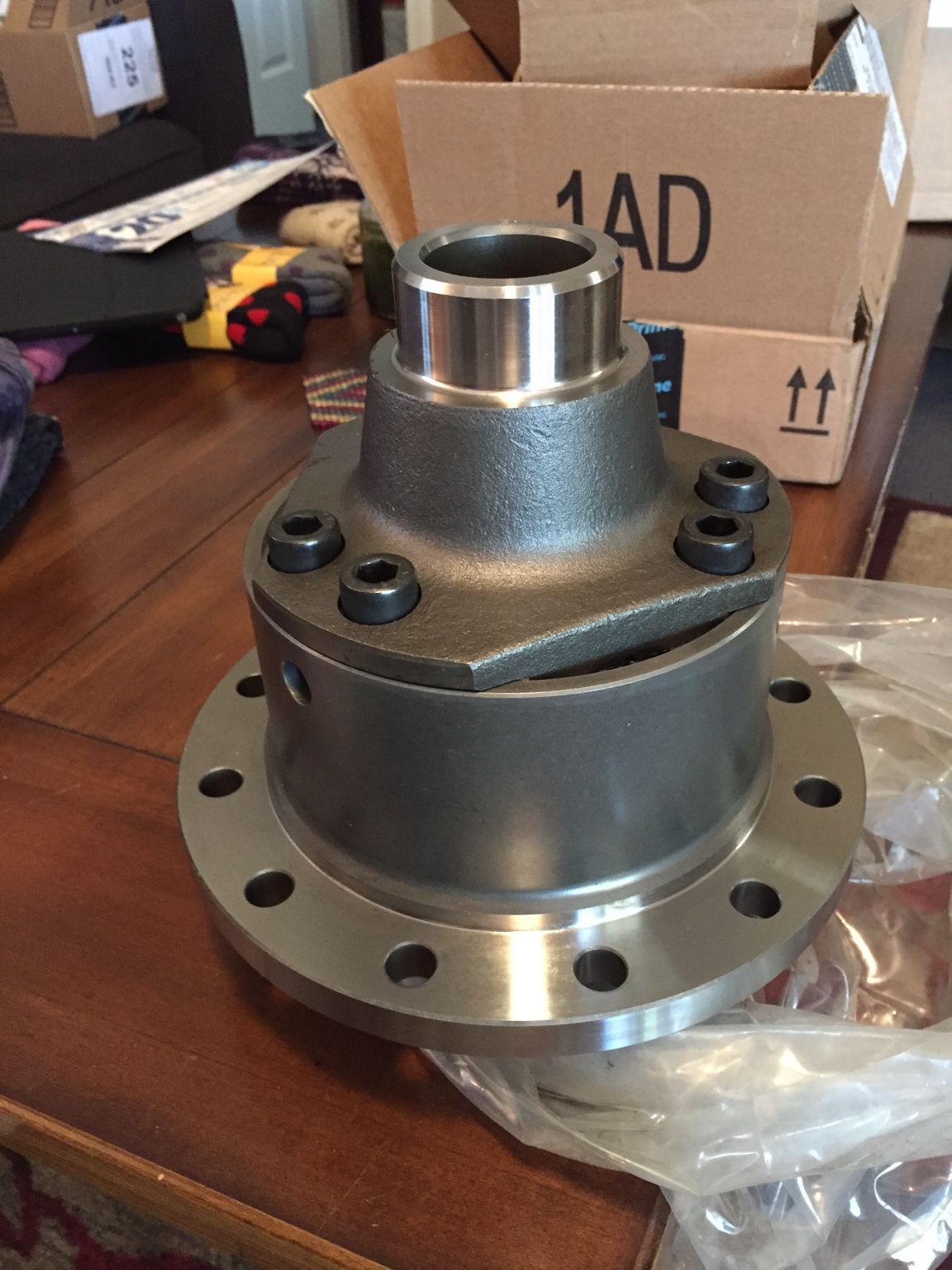

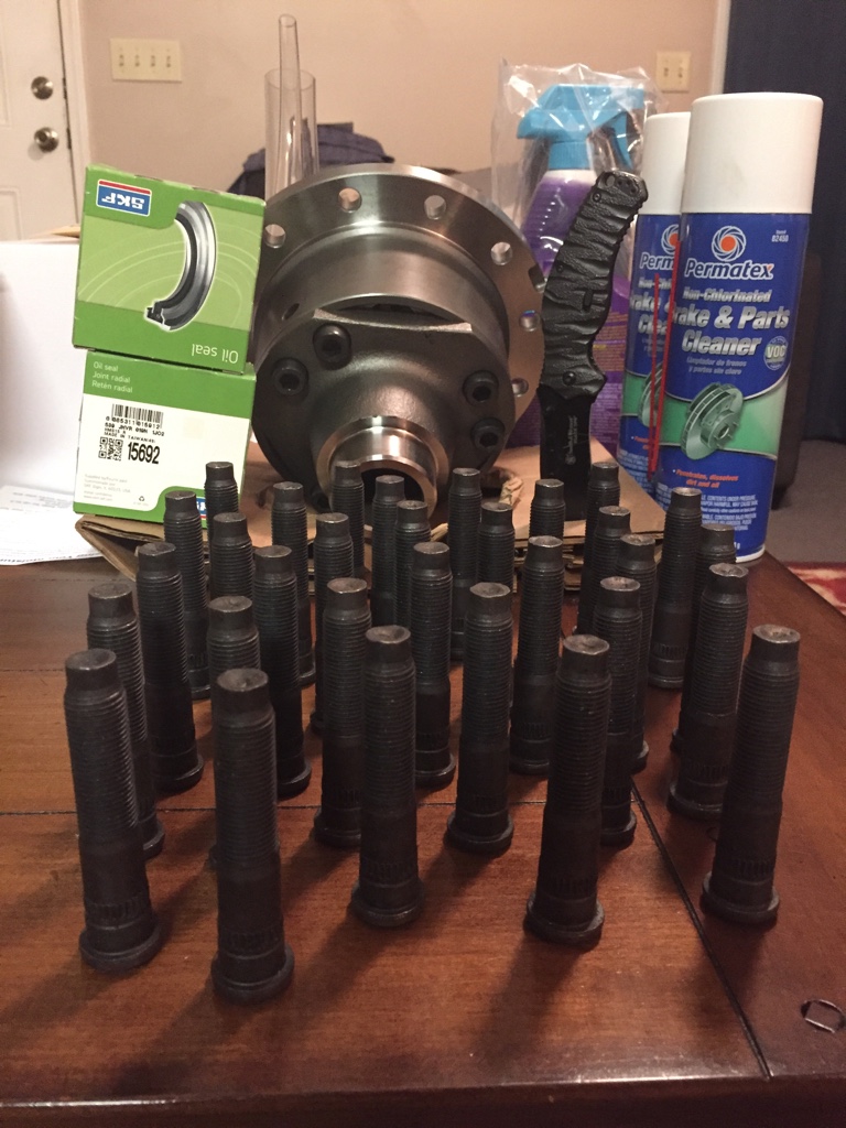

Problems with the D60 display model truetrac. So ordered direct from Eaton. A couple days to build me a new one, and now this beauty arrived!!!

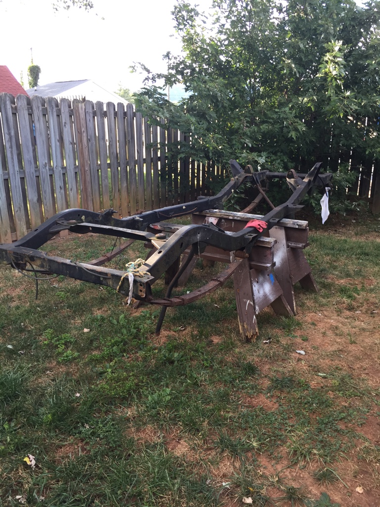

Picked up the YJ frame from the farm today. It's been sitting outside for two years and looks as good as the day I bought it. The best rust free frame I've seen in a long time. Very excited to get stuff cutoff and get motor mounts tacked in and this puppy on the axles!
