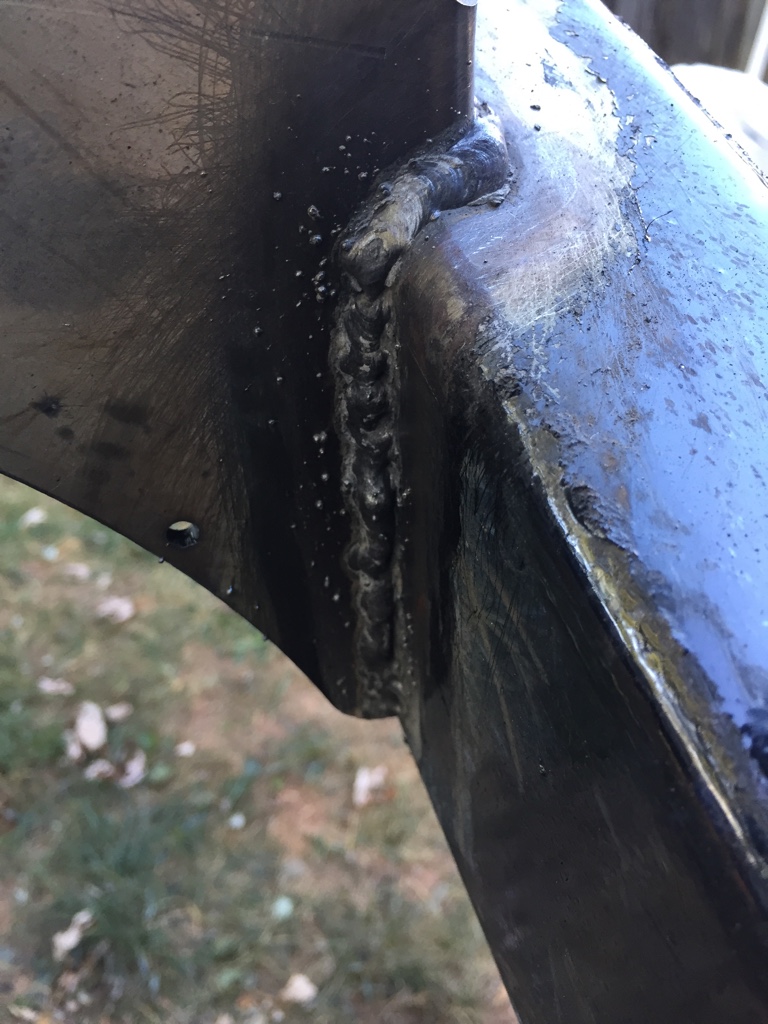

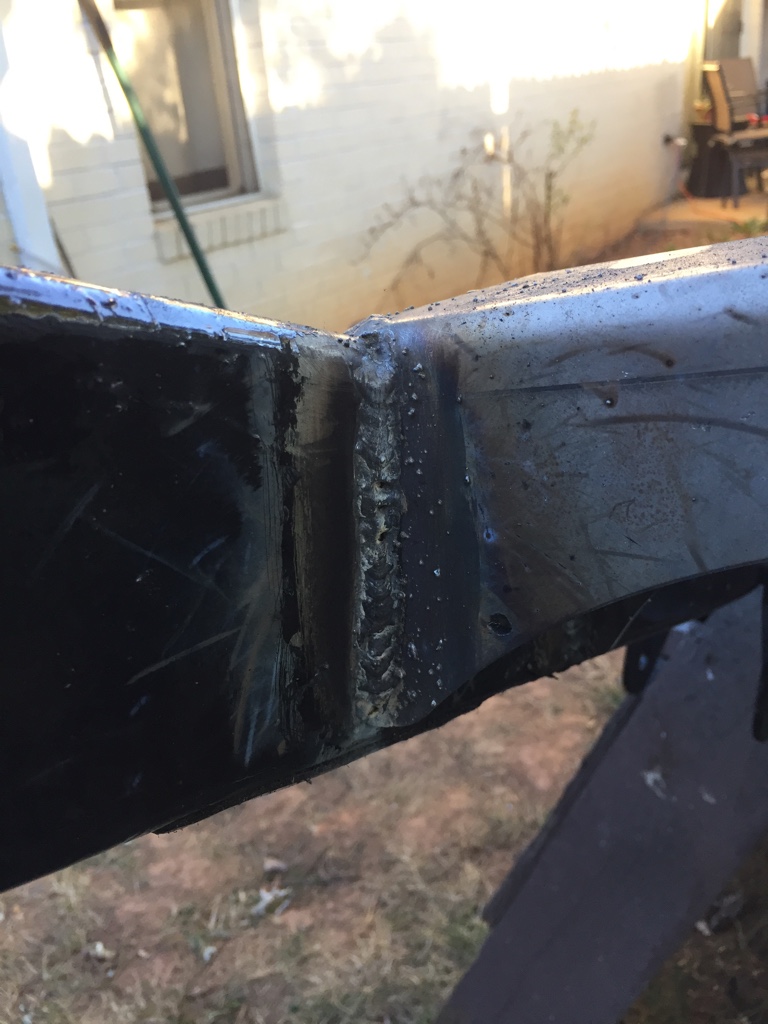

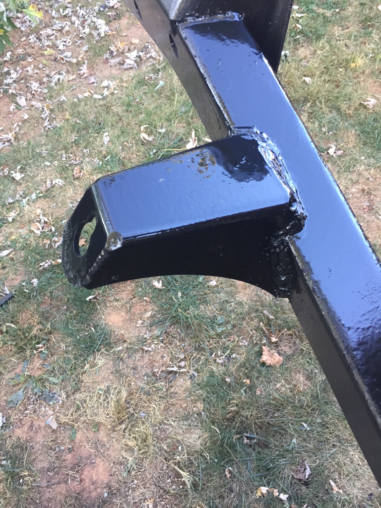

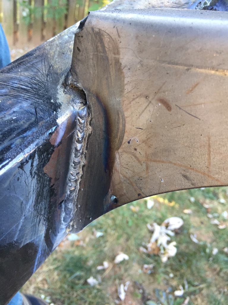

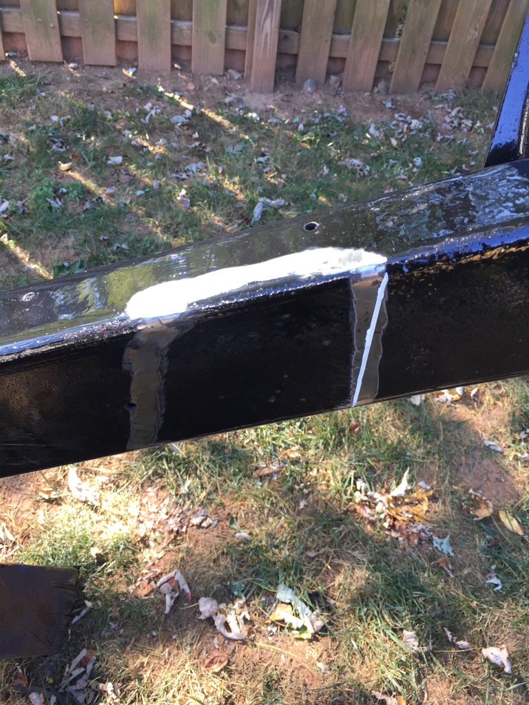

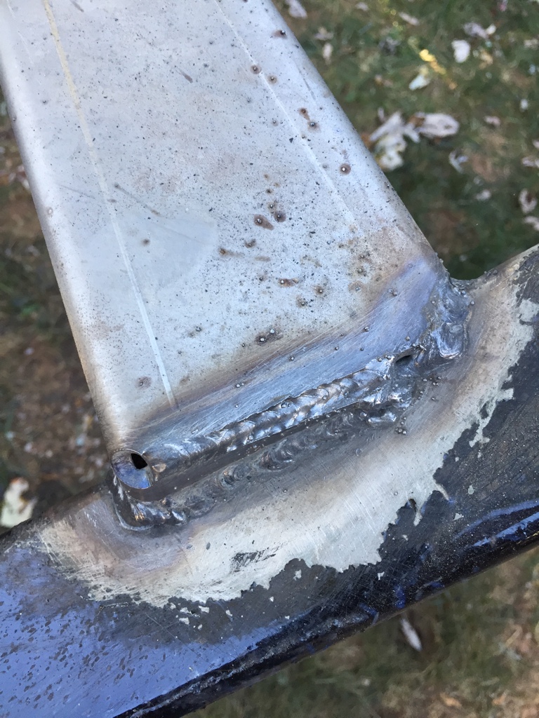

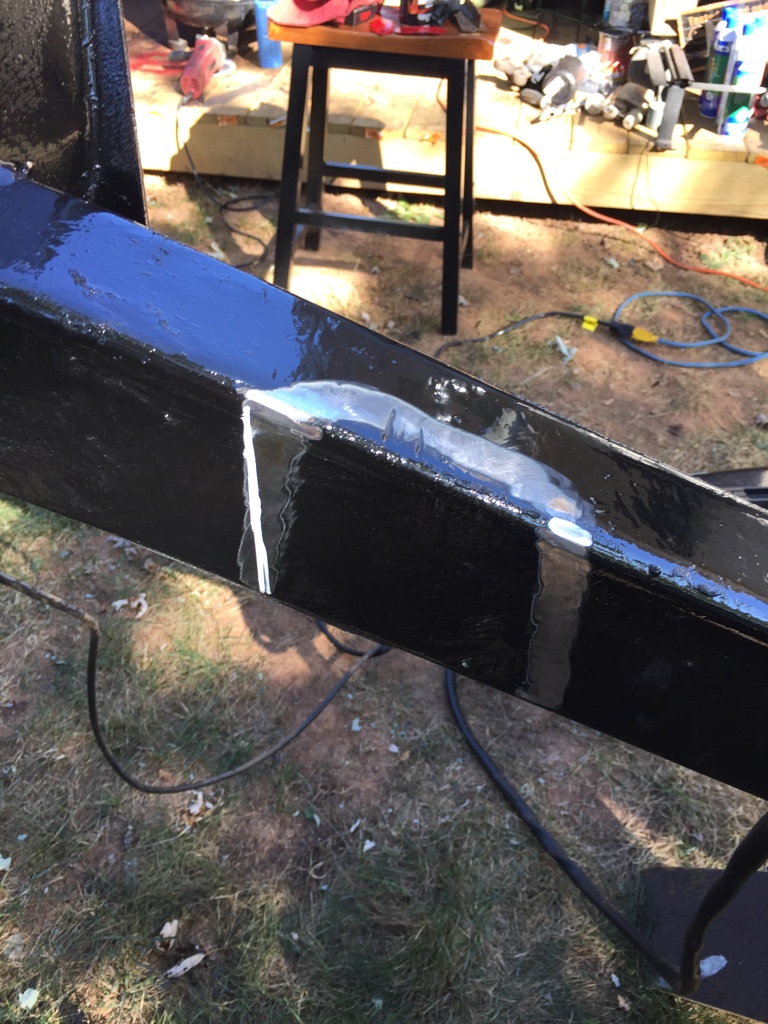

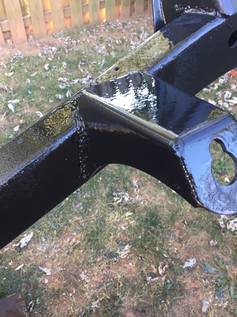

Welded up the Novak mounts and then coated the mounts and frame in por15 topcoat. Frame officially done!!!

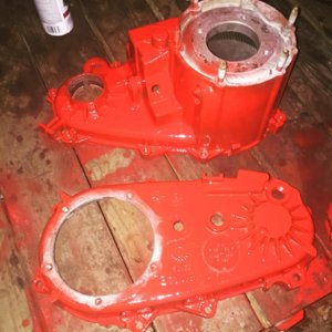

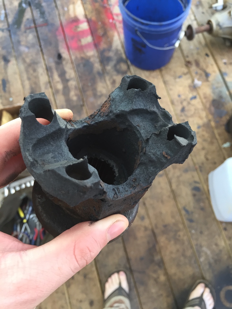

Left the Tcase parts in the acid dip too long. Looks like the yoke did not appreciate it. Haha
What the hell kind of acid are you using ?
BUCKEYE PERFORMANCE INC.
828-779-2242
a proprietary acid the family company makes. It is 0.0 pH, non caustic < yes, non caustic. Super cool stuff. Left it in for a couple nights. (forgot i put them in, lol). Never seen it eat a metal that fast. It dissolves rocks pretty fast.... Makes you wonder what the yoke is made of?

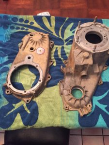

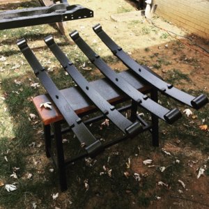

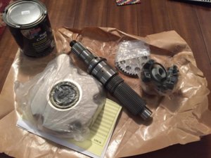

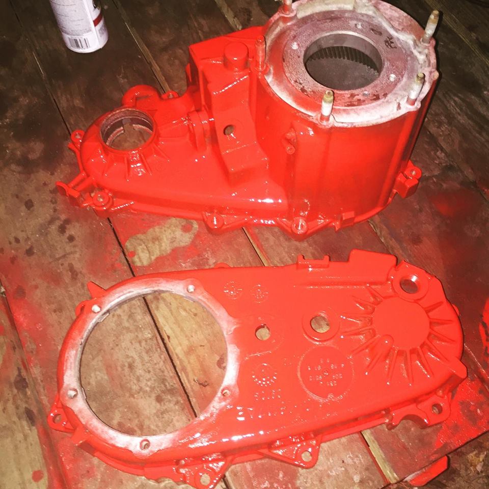

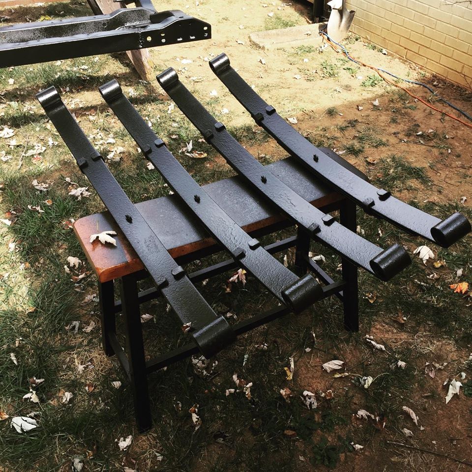

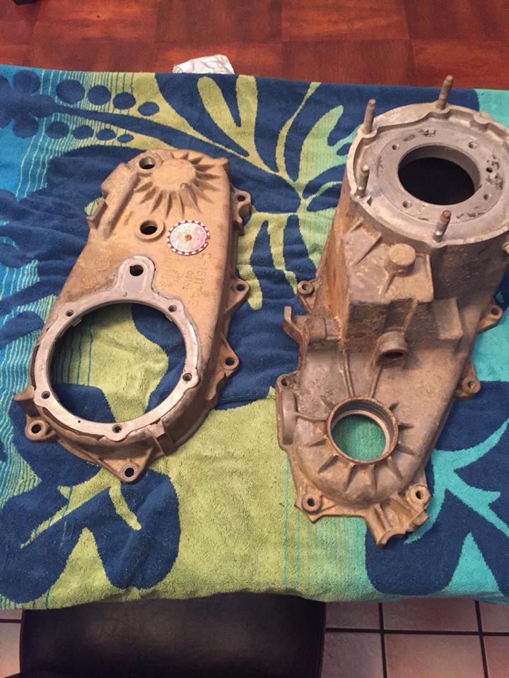

POR15 topcoat on the new YJ leafs. I also flipped the bolt to run SOA. I tried washing the tcase in the dish washer (poor mans parts cleaner, haha). Didnt work. So took a wire wheel to it and put a coat of tractor paint on it. also got the frame coated with POR15 topcoat (not featured, lazy). 5.3 Engine is officially enroute. Woot! Obviously, got tcase torn apart. Need to get better snap ring pliers before doing the other one, to preserve the snap rings, as i demolished them and the rebuild kit didnt come with snap rings. Ordered the JB Conversions SYE (old news?) for a chevy np231, which will mount to my 231j so i can use a S10 VSS with the 5.3 engine.

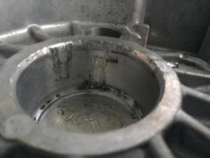

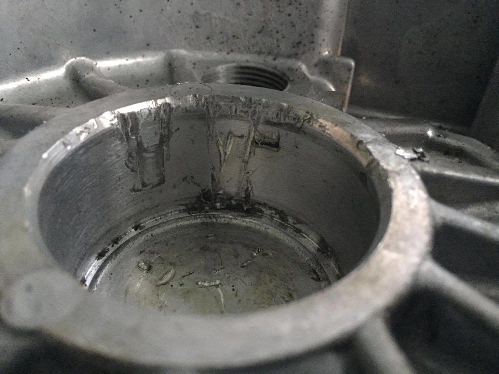

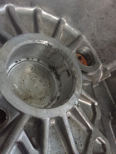

Out of order. Oops. But when tearing down the tcase the rear bearing on the front output shaft was a &@%^&@^#$&@$% to get out. I sanded with emry cloth and its pretty smooth. So hopeful. I may run it, or may use the other tcase back half and use the oem bearing in it. Not sure.

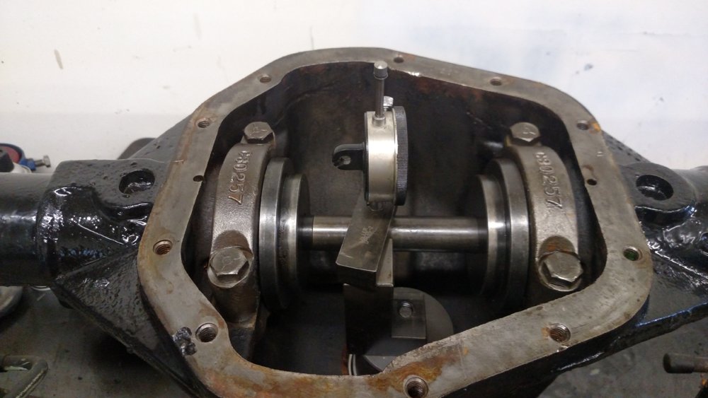

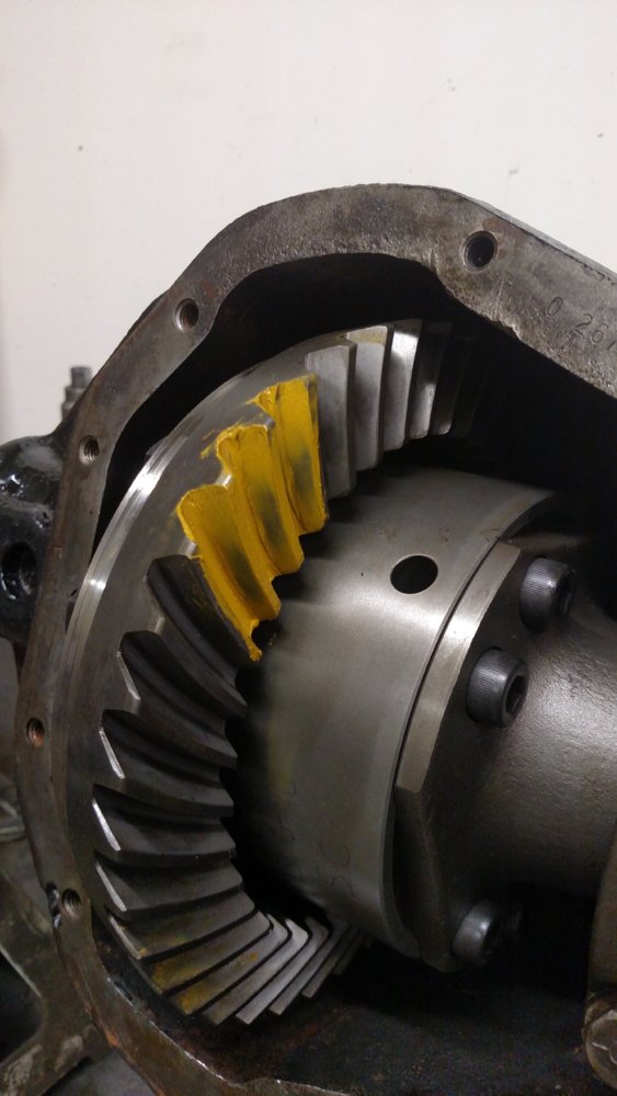

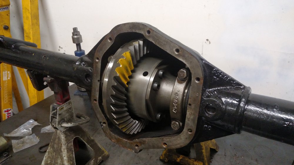

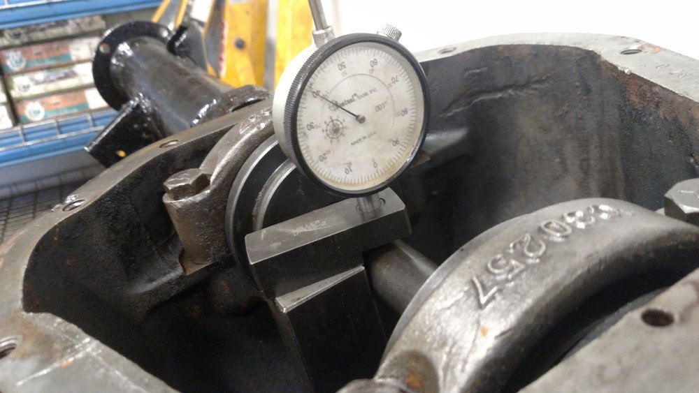

I love when a customer drops off an empty axle housing. It gives me an opportunity to drag out my old Miller Tools pinion depth kit.
Fast forward an hour and a half and @ckruzer's invoice is halfway written. I'll try to get to your front end Friday sometime.
I know you're a pic posting machine, so here you go.
Setting up the pinion depth kit
Pinion depth measures 0.040"

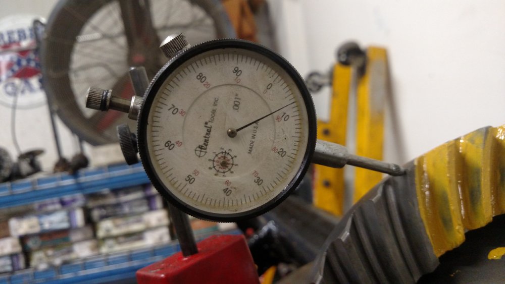

First pattern, not bad at all
Backlash set at 0.007"
All buttoned up and ret' to go
You are too awesome man. Thanks for the pics! Love the data share too. Good info to record in my work log.

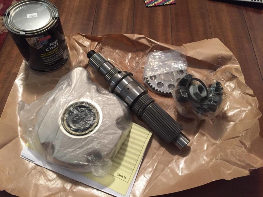

JB Conversions super short SYE came in today! Woot! Time to finish this tcase rebuild (but need to get better snap ring pliers first).
