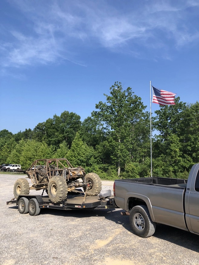

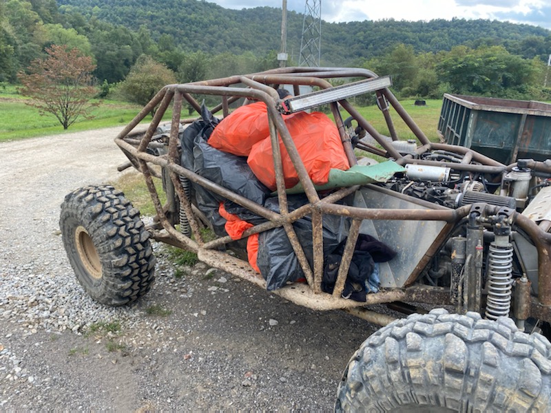

Clean up day at Tackett Creek this Saturday with the FlexRocks and Rollovers team.
Unreal the amount of shit people toss on the trail. Truly sickening.

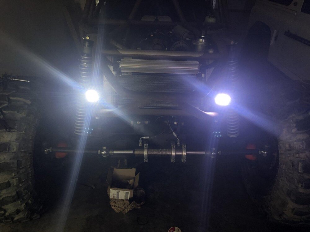

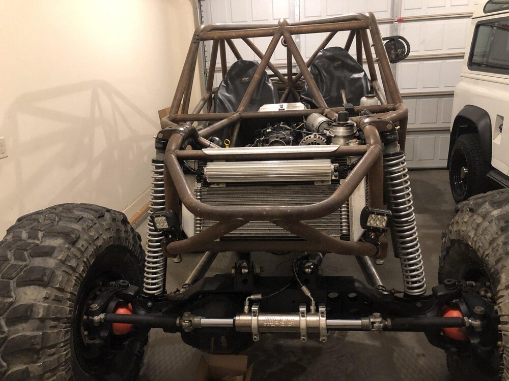

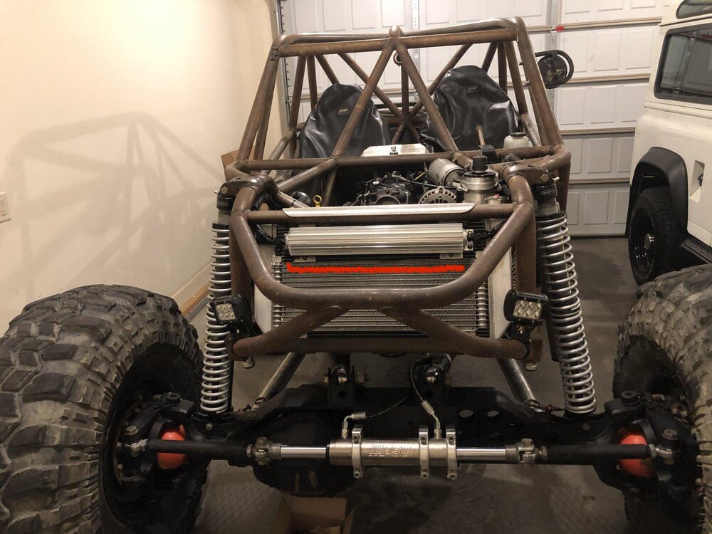

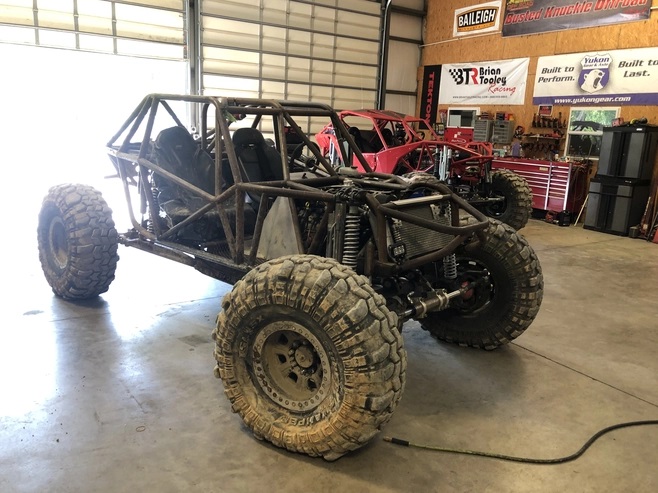

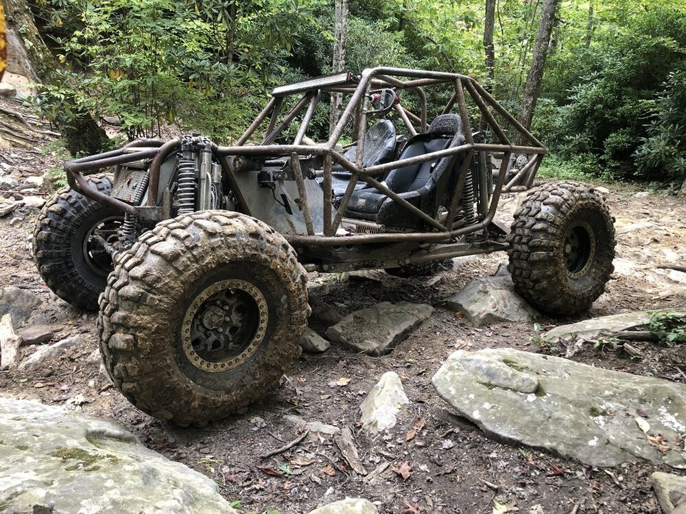

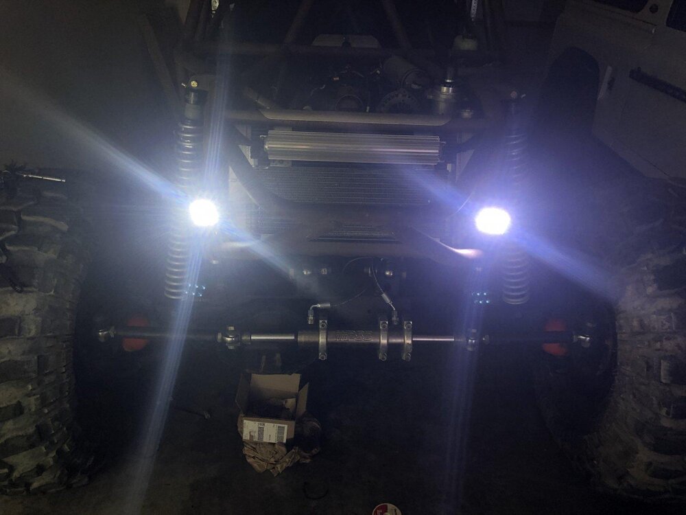

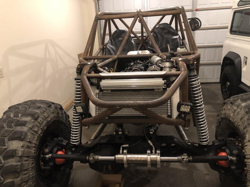

I’ve always considered the lightbar the equivalent of a princesses tiara. Big improvement if you ask me.Bent the light bar a few rides ago. Had to drive out of Tackett Creek with no light which was a lil sketch.
Removed it and swapped it for some pods. As much as I loved the big bar and the look it gave the buggy, it also turned me into “that asshole” every time I’d turn it on and blind everybody around.
I’m hoping the pods will be more protected and the light output will be enough for what we do around here.
Everything is done with half decent wire and Deutsch connectors as usual.
I am a princess.I’ve always considered the lightbar the equivalent of a princesses tiara. Big improvement if you ask me.![]()
I have some pods like that basically in the same spot and height on my Tacoma and they light up the trail like daylight while not being a complete prick. I think you will like them a lot better there.Bent the light bar a few rides ago. Had to drive out of Tackett Creek with no light which was a lil sketch.

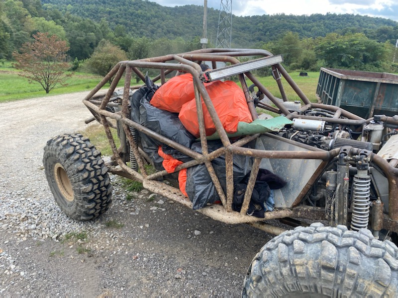

Man I was wanting to make it out to that ride and clean up day. I'm going to be looking out for more of them since Marvin said he's going to start doing more.Clean up day at Tackett Creek this Saturday with the FlexRocks and Rollovers team.

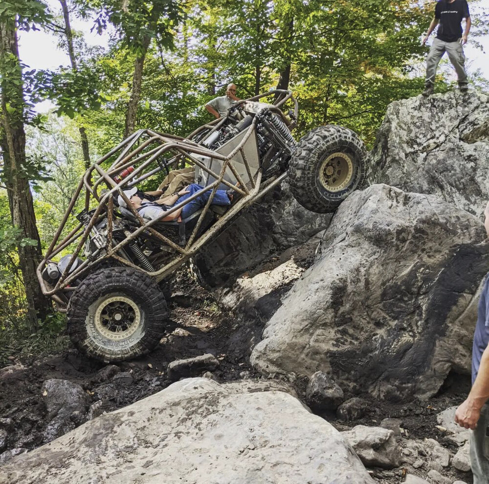

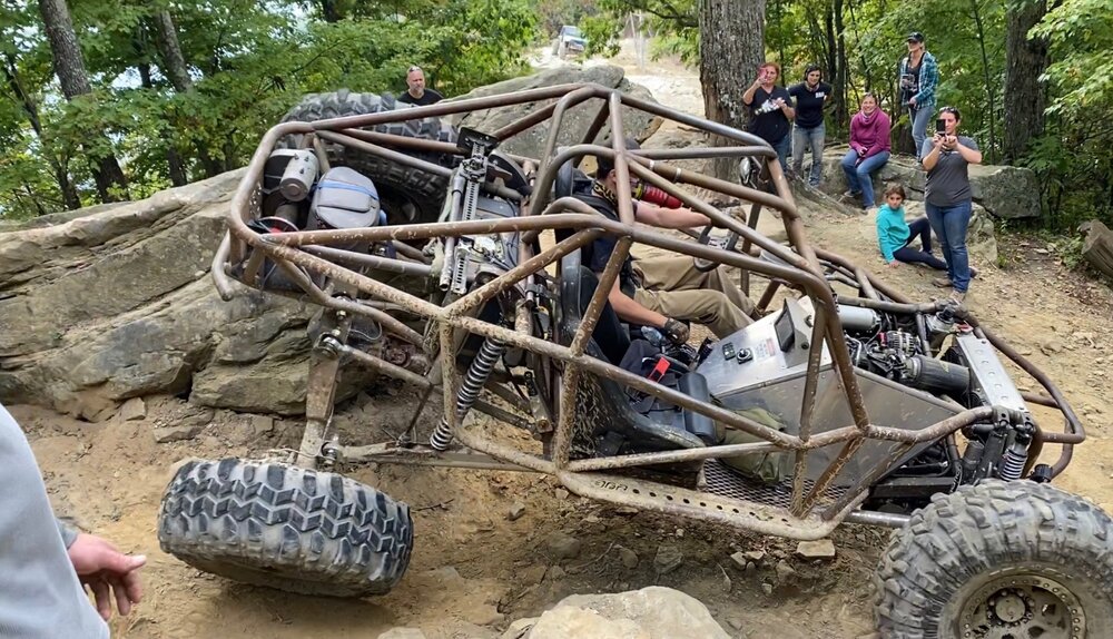

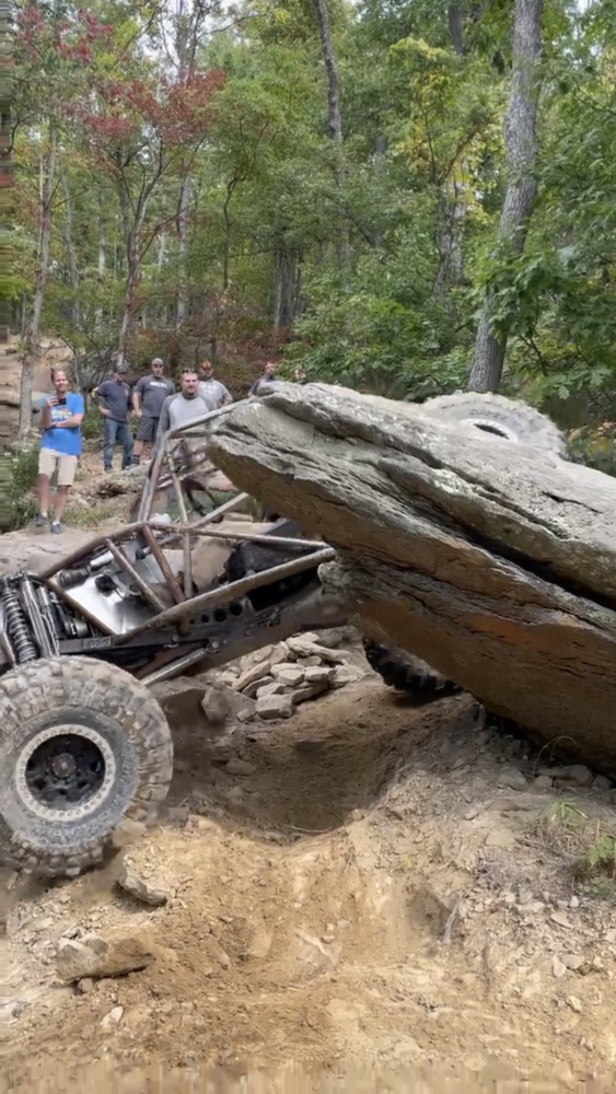

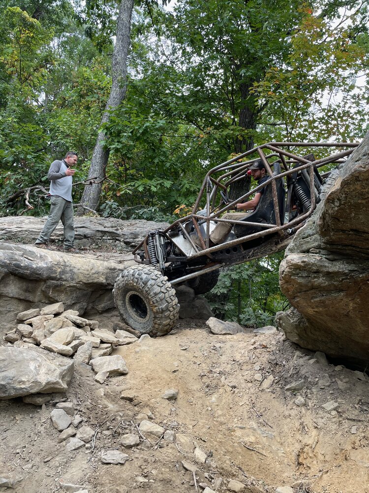

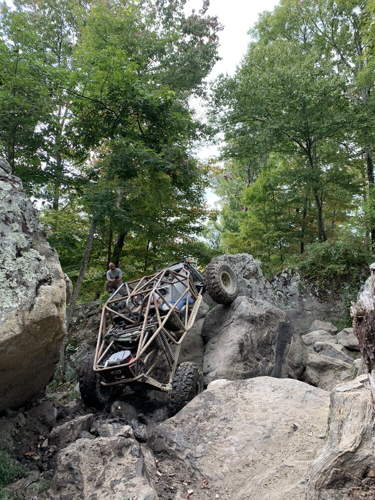

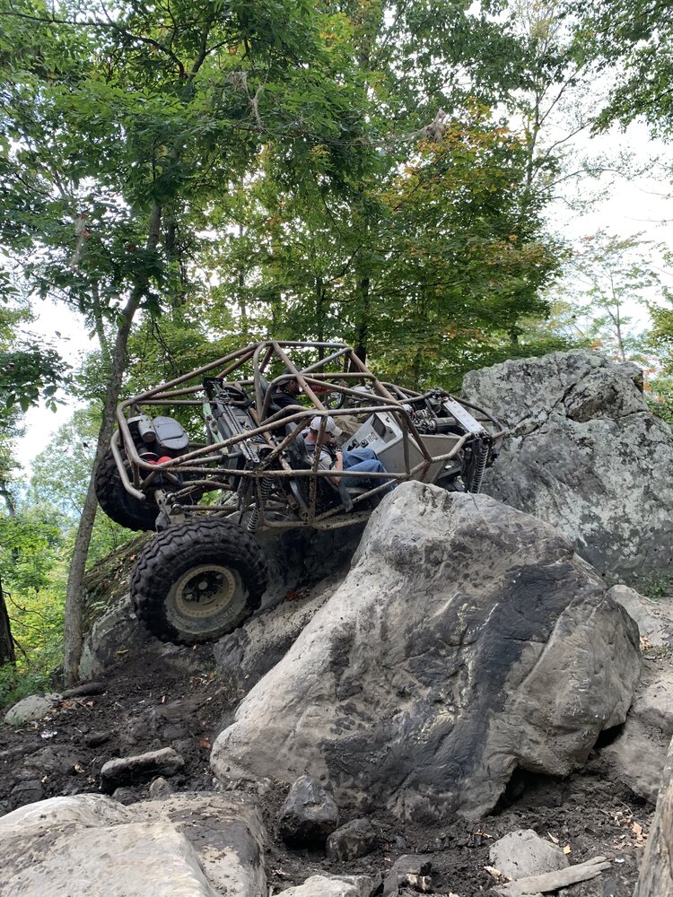

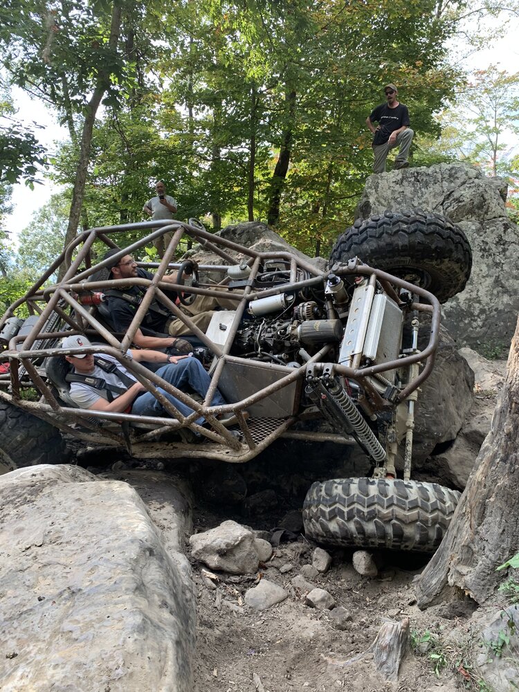

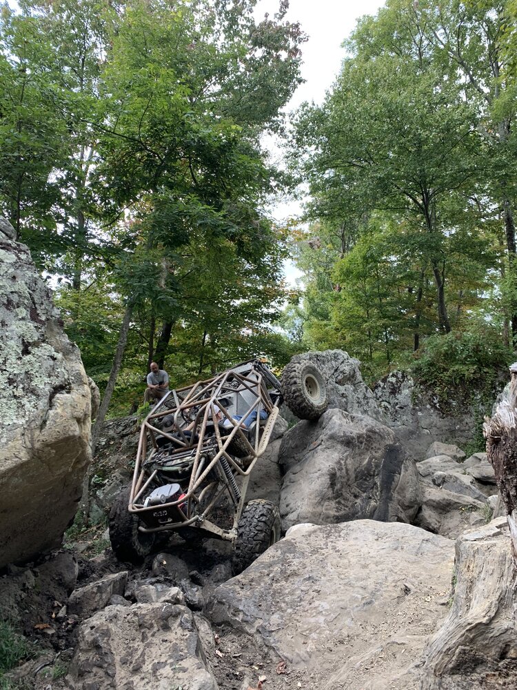

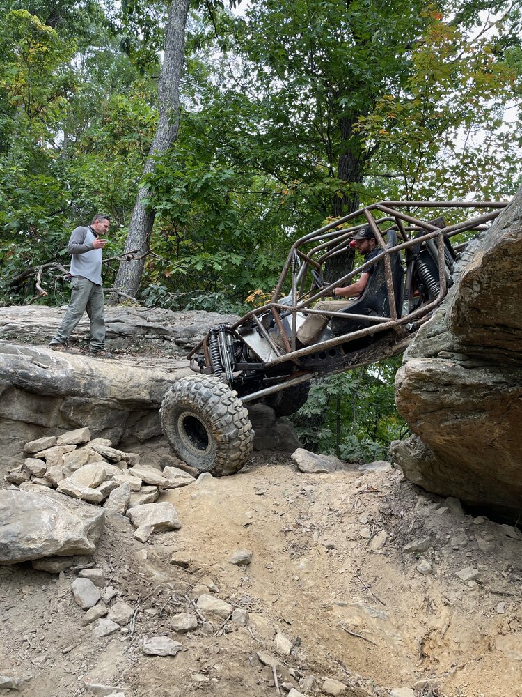

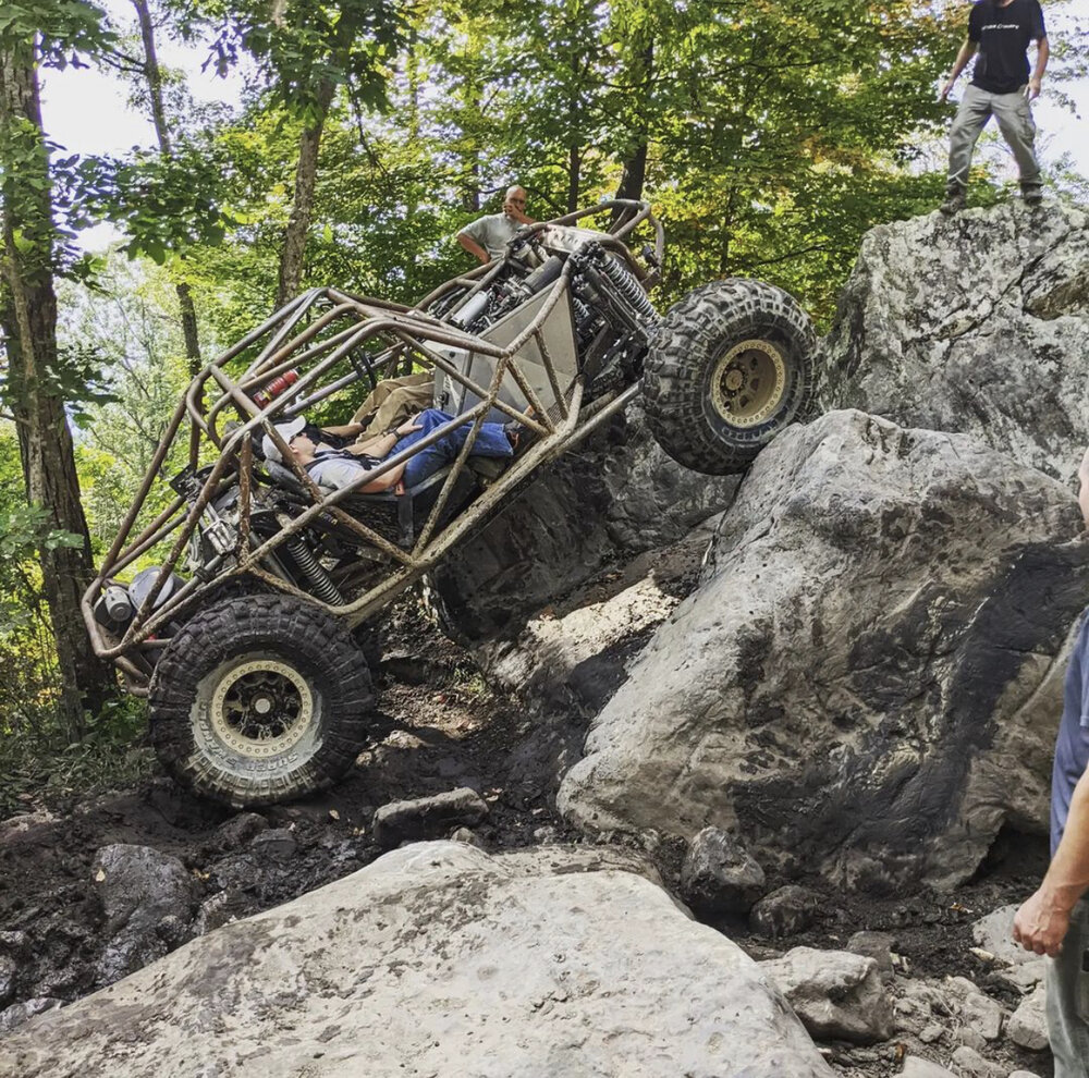

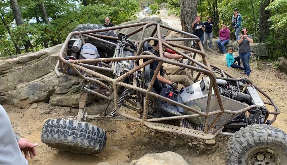

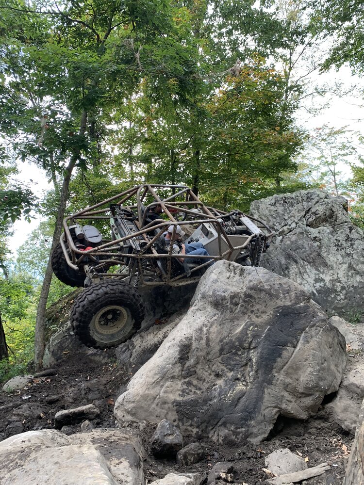

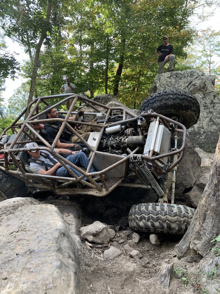

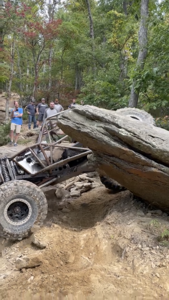

You got real twisted up there on Mason Jar! Looks like you were pointed down the line I come upLeft line on Lion'sDen
Gave it hell, caved the rocker, didn't work.
So I turned around and made it through the normal line, just all the way up the rock.
Took the right line up the boulders on Mason Jar.
Didn't work so I front dug my way out of there and got it real twisted in the process. Tires never left the ground. She got long legs.
View attachment 358581View attachment 358582
The Lions Den one is very hard.
I need to study the line better. But I’m pretty sure my wb/width makes the smooth approach impossible.I made and entire thread about that line because it really intrigues me. I would love to be able to do it one day.

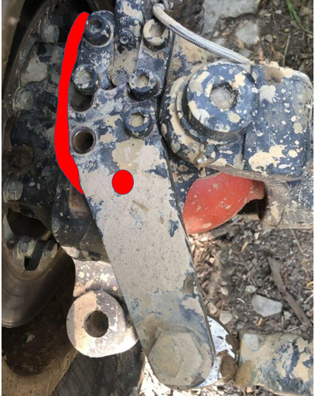

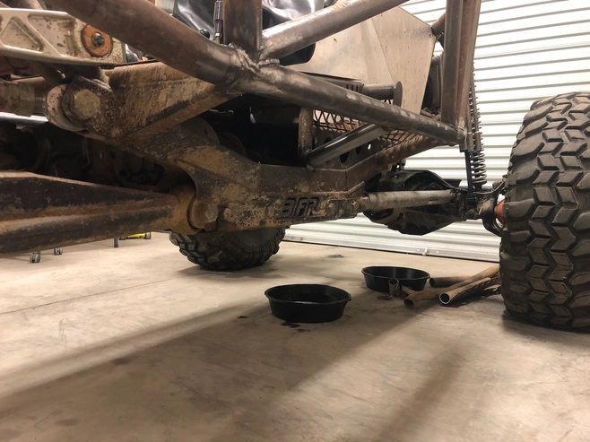

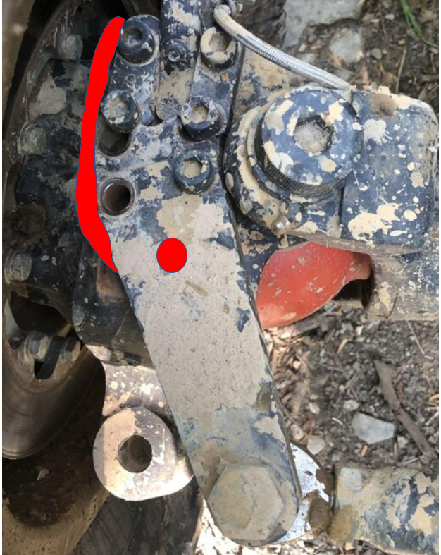

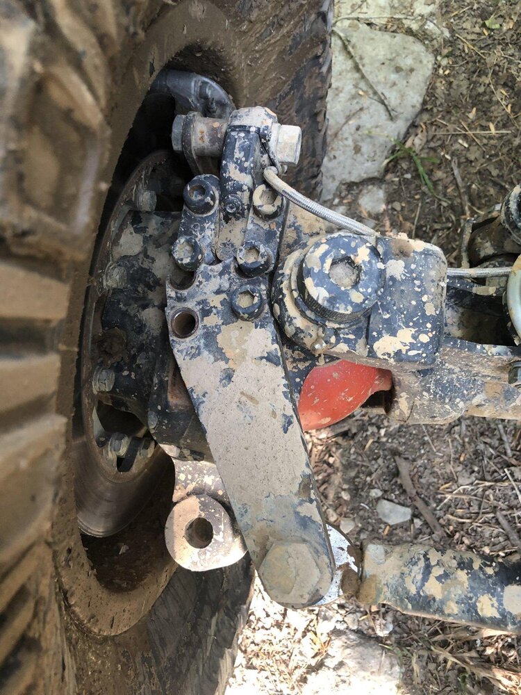

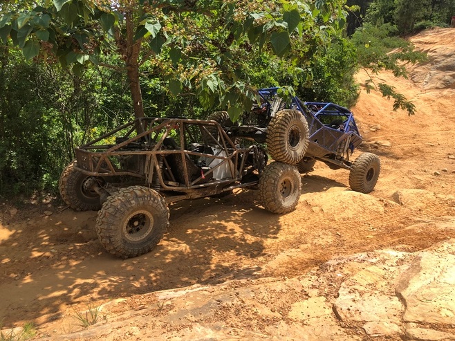

Or the driver should avoid hitting trees

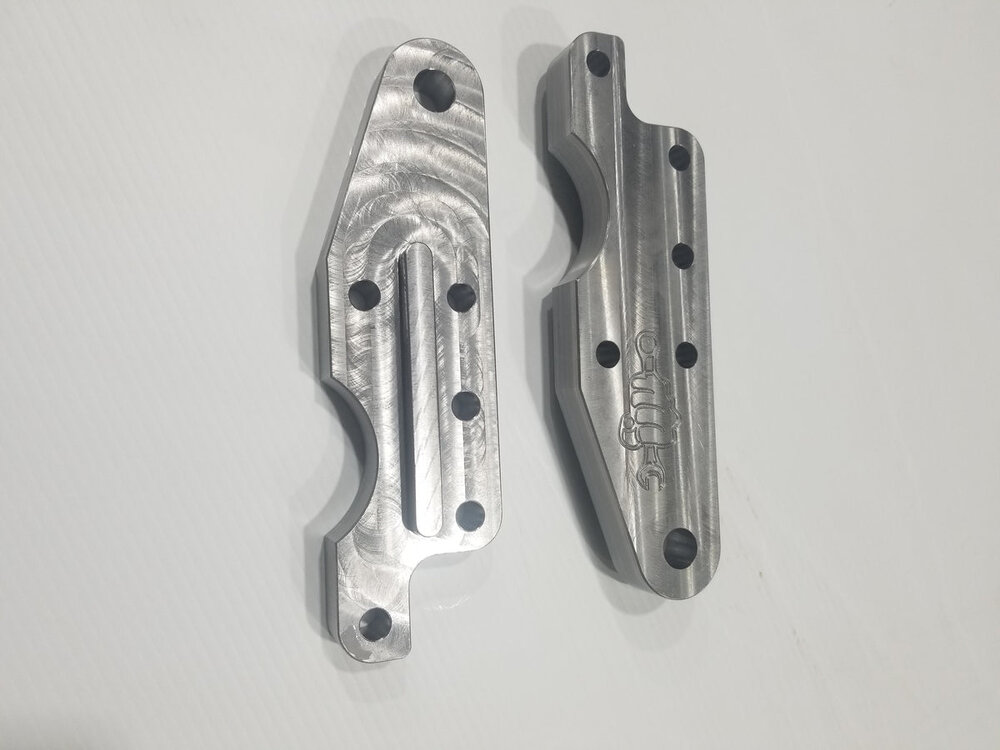

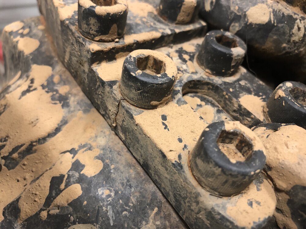

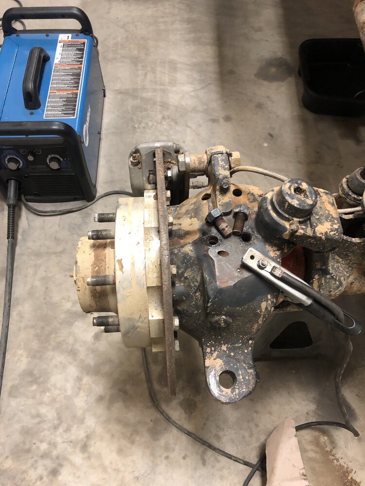

Did that front bolt on the arm shear off or had it come out/loose at some point?
Would be interesting to see how a welded arm would hold up in that situation. My guess is broke with a broke knuckle.
Dang. Are you using a 4x8 double ended ram?
Or the driver should avoid hitting trees![]()

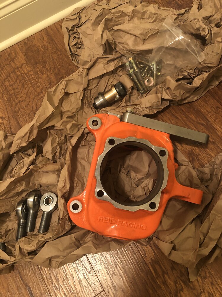

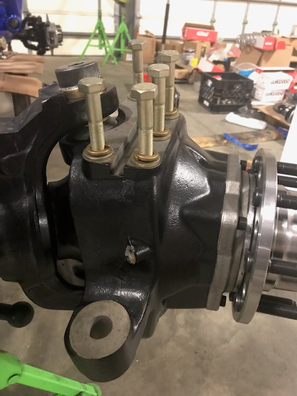

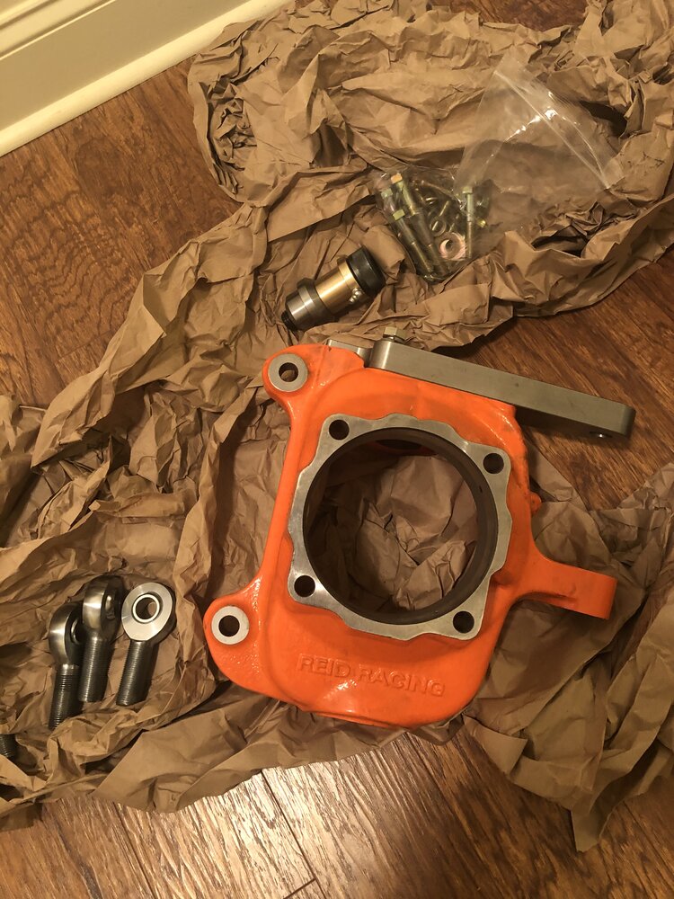

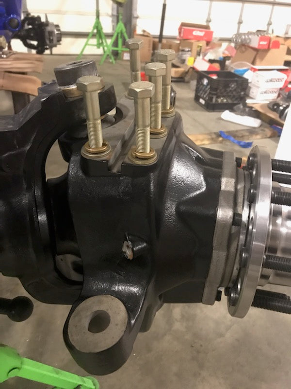

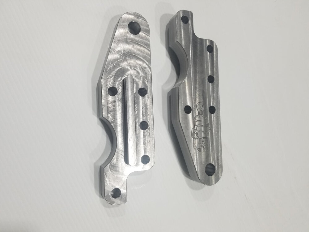

Wait a sec! Did you paint them black?!?!?!? Now how are people going to know how much money you spent!?!?!?!Because I hate money and I didn't want to wait forever on a shop that could cut me some arms.
Also, I found 1 stripped hole in the factory knuckle that hit the tree so that helped make the decision easier.
I had to get new ball joint eliminators too, and new heims since the others ones became kinda sloppy. Yeayyy...
Those are Reid 05+ knuckles that have been machined by BKOR for the RCV Big Bells. They also add a custom keyway and their arms key into the knuckle.
