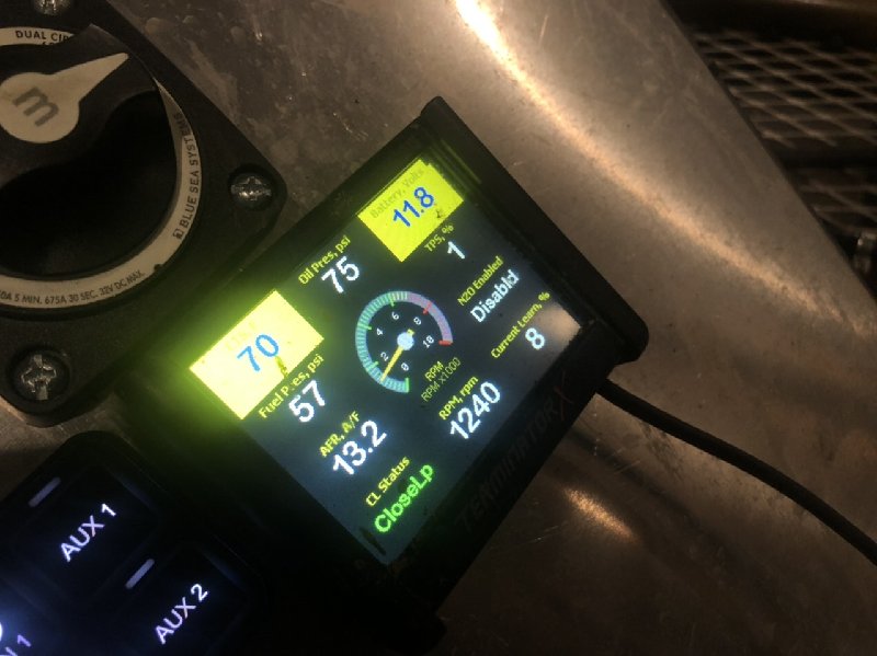

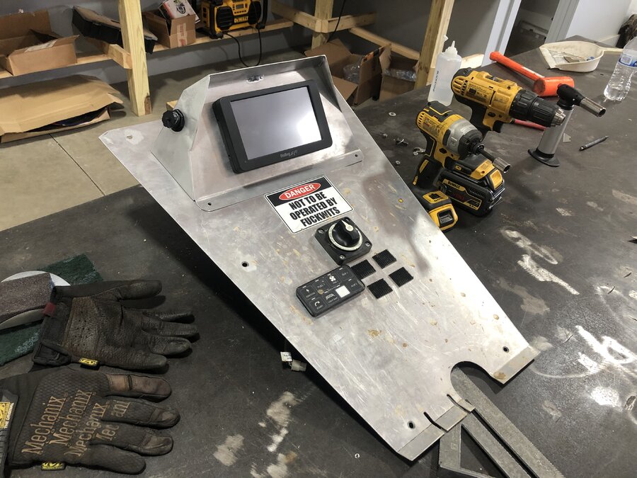

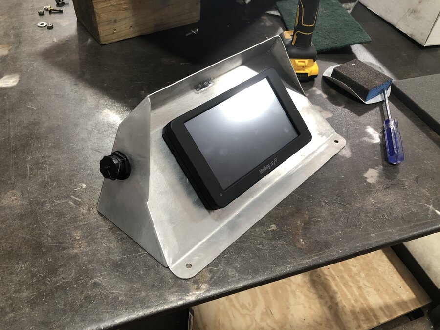

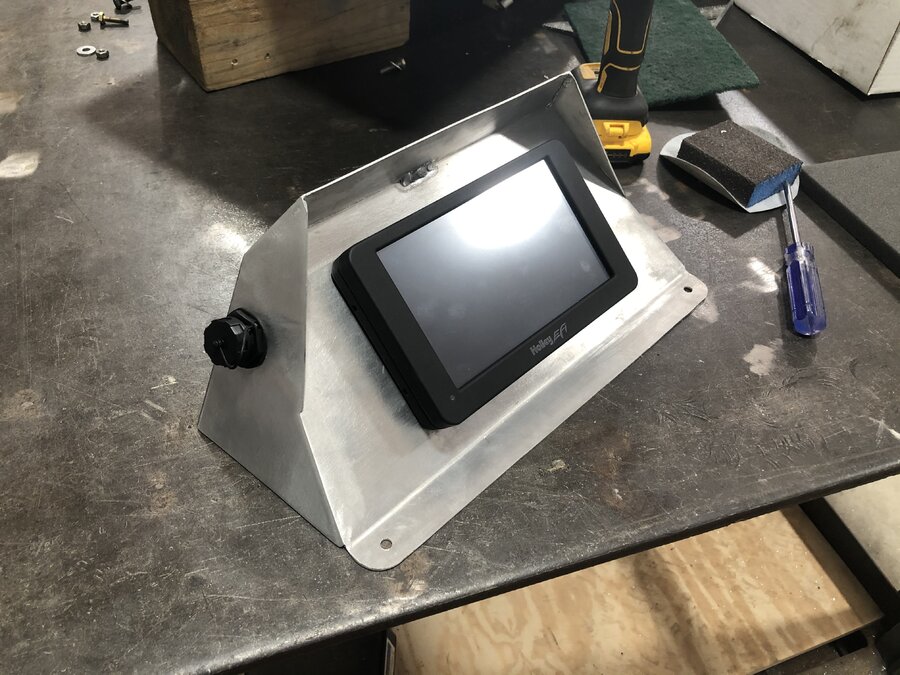

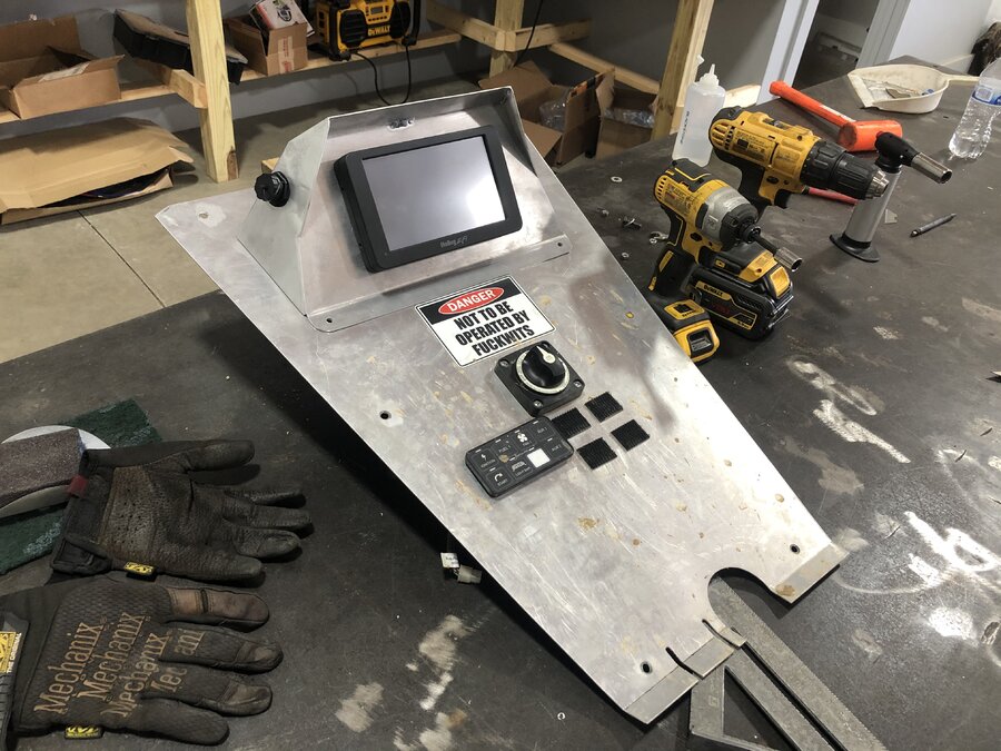

Also replaced the little 3.5" screen that took a shit on me by a 7" with custom layout
fetch

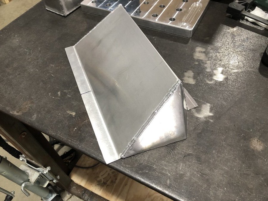

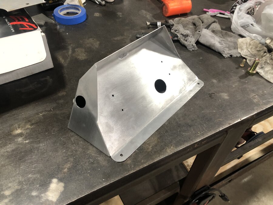

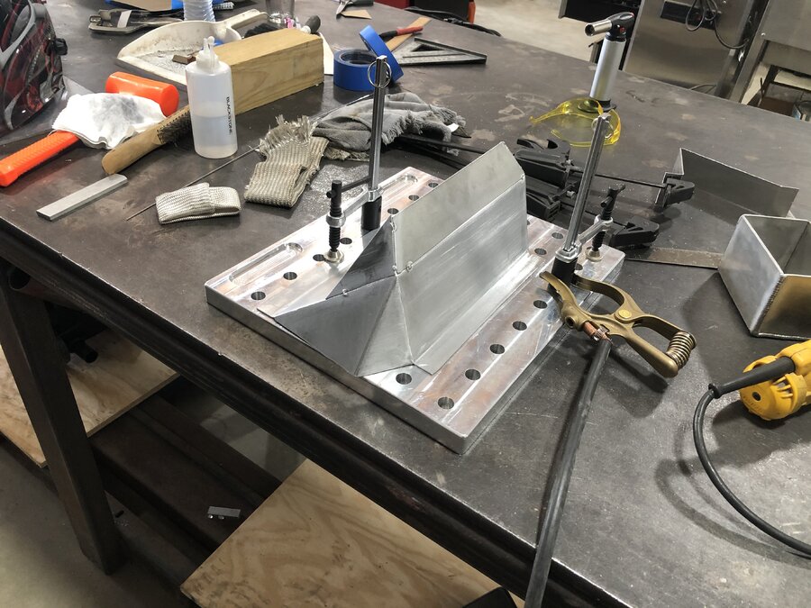

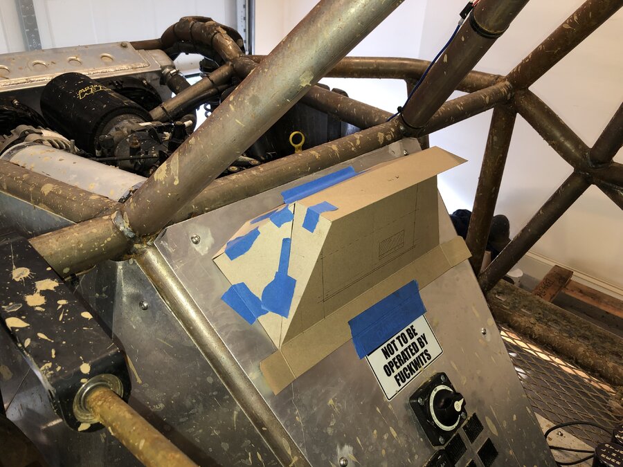

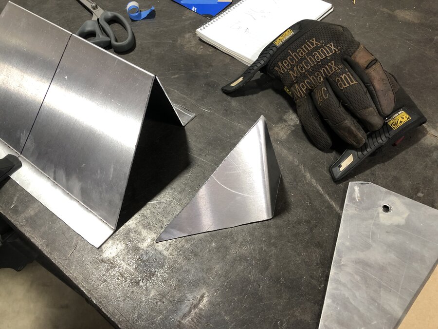

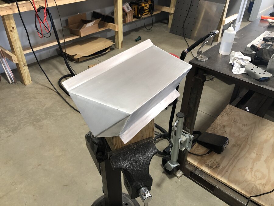

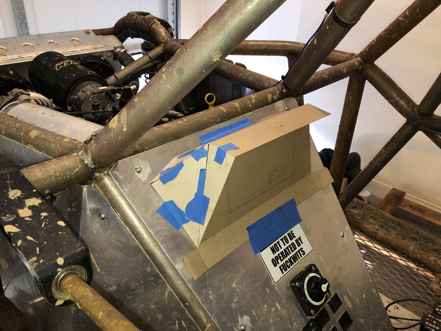

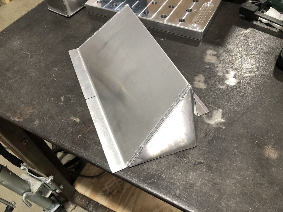

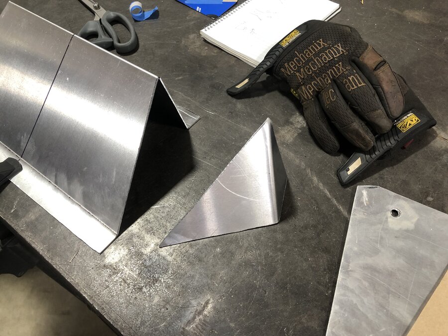

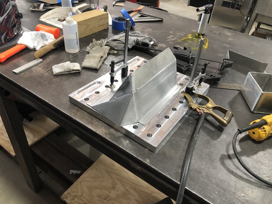

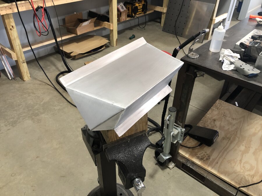

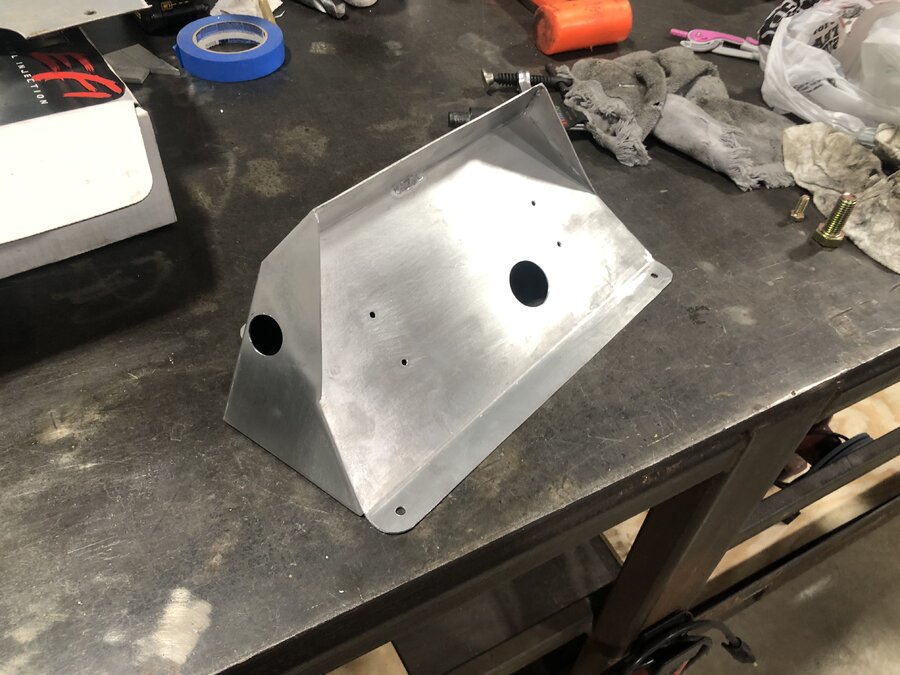

I made a mount for it this weekend. Massive thanks to my buddy Donny who's the AL TIG master and handled all the welding on the unit.
Fit-up, blending and keeping everything looking good is hard as shit. The pictures look good but I'll just say it was a learning process haha.
Huuuuge respect to those who make it look easy, like the WOD guys, Chris @MarsFab or Matt Cutler. BTW, Matt is cool as shit and gave plenty of pointers and feedback to help. Thanks a million @mcutler !

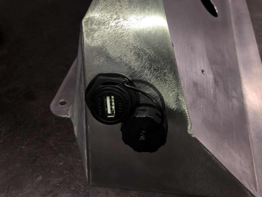

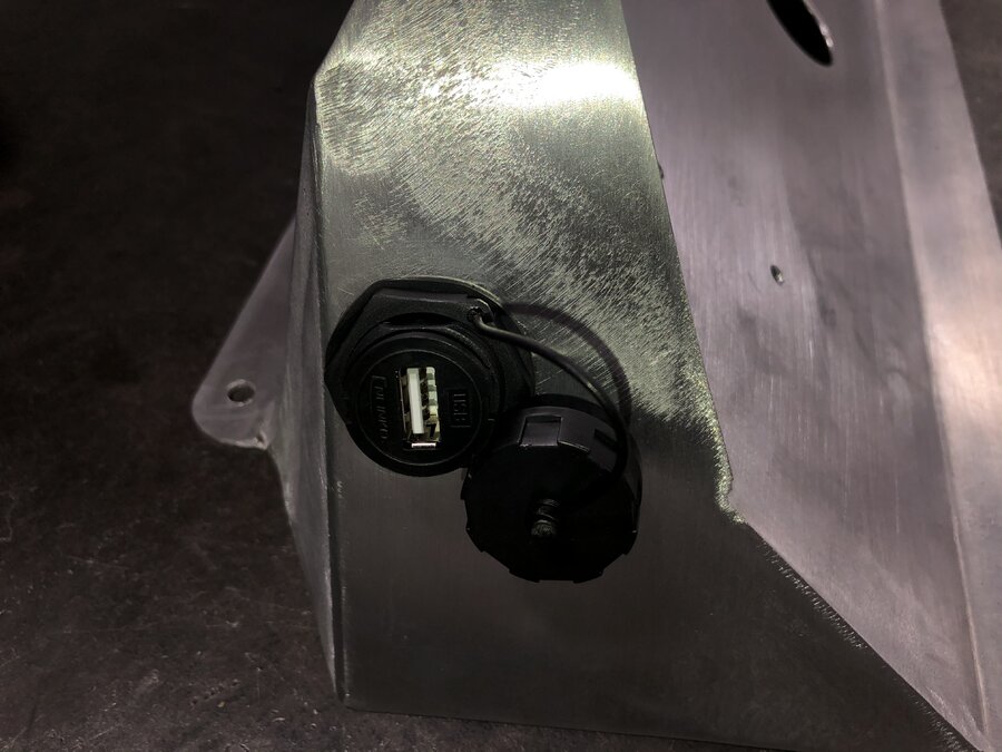

The 2 "knobs" on the side are waterproof USB ports that are wired as pass through, one goes to the screen to retrieve the datalog files and the other one goes to the ECU for laptop hook up / tuning.

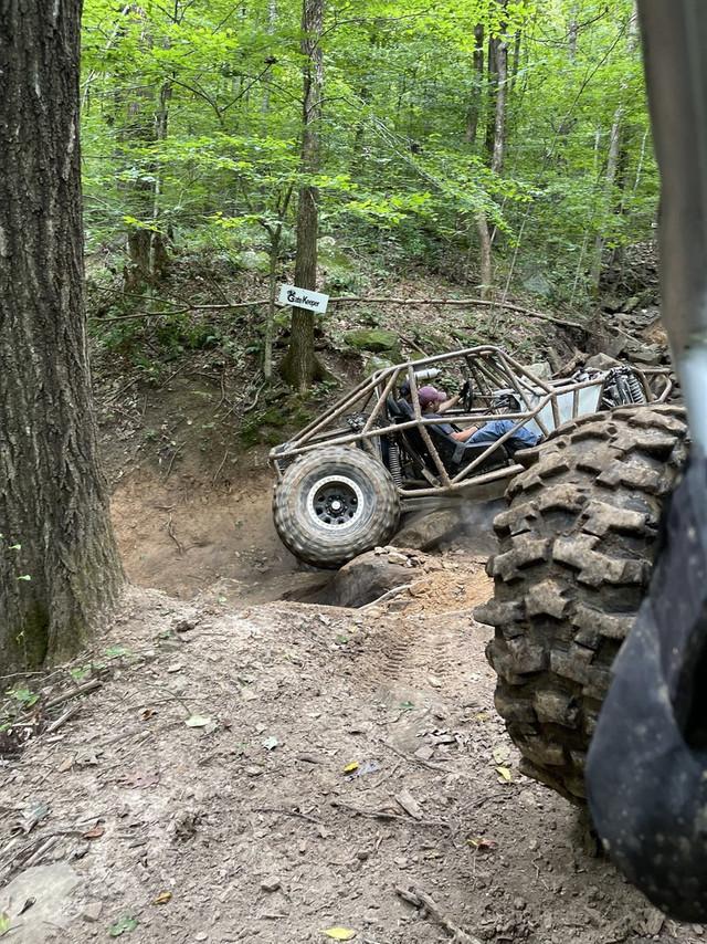

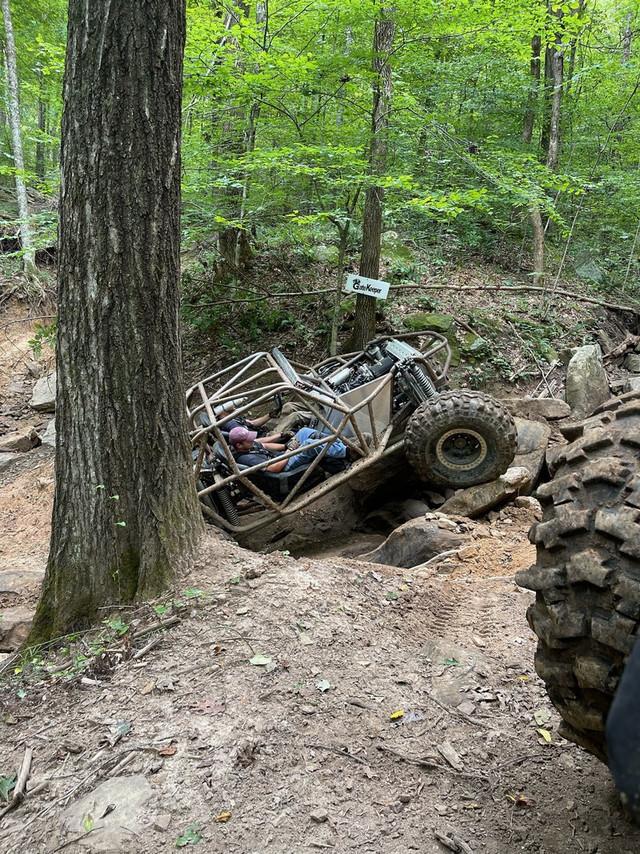

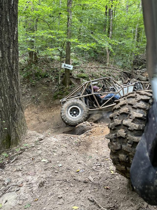

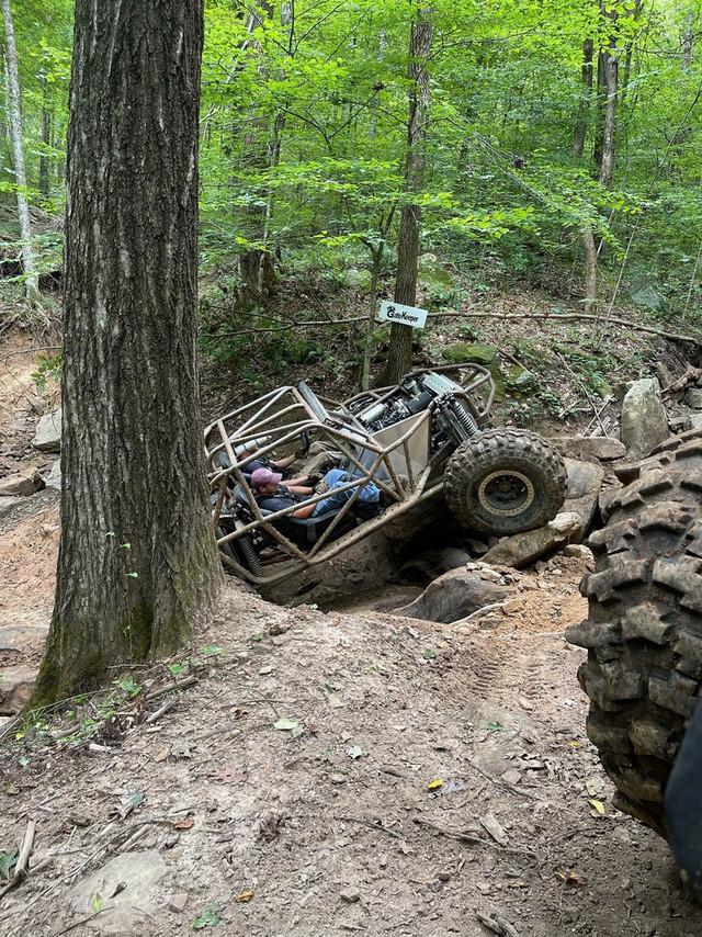

Took the buggy out for a ride at Windrock with friends. Killed it all weekend.
We rode all the hard shit and had a major blast.
My favorite moments were climbing up the big hill on the side of trail 2. I need more juice but 5.3 pinned to the floor FTW !!!!
Also climbed the left exit of Cadillac Hill (Trail39). Videos of course don't do it justice, but that ledge is 6ft tall and undercut.

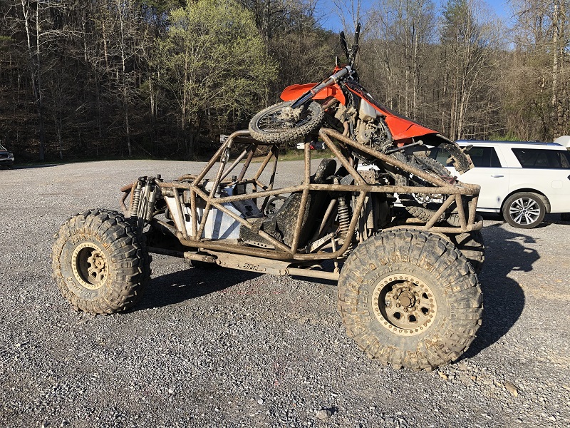

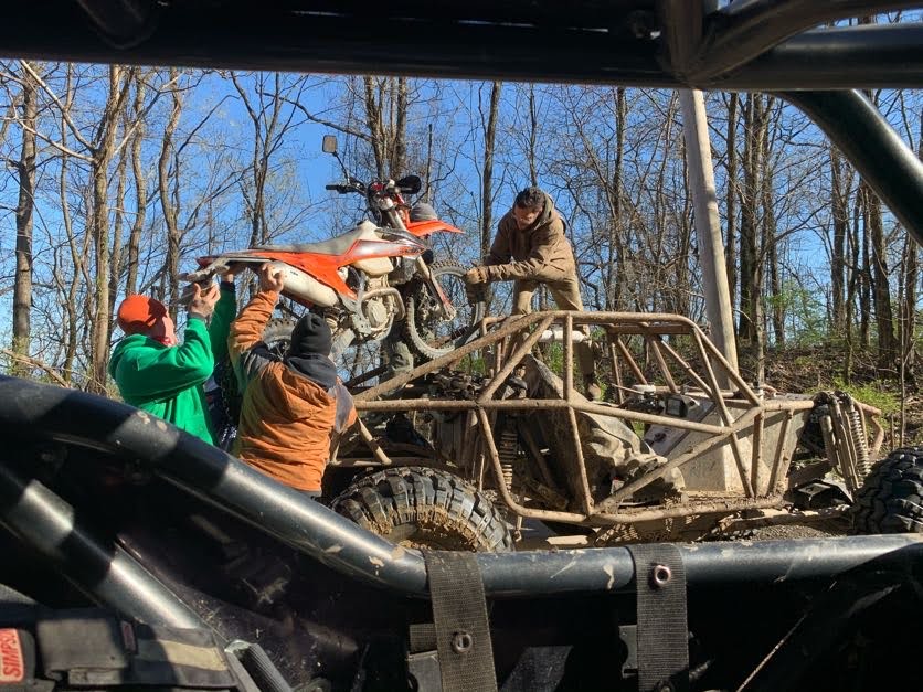

Then we helped a random stranger and his son that got stranded with their bike.
Nothing a few hands and a buggy could fix. Drove them back 1h or so to their trailer at the entrance and made some new friends.

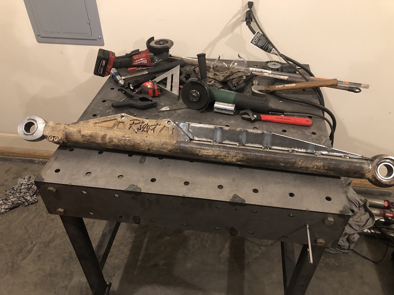

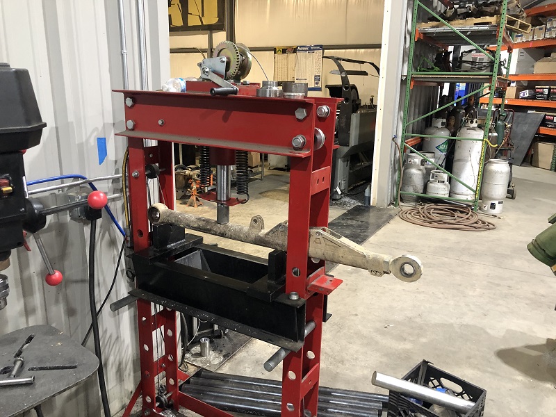

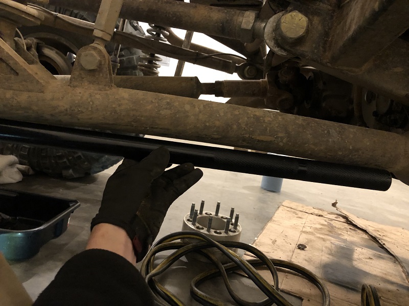

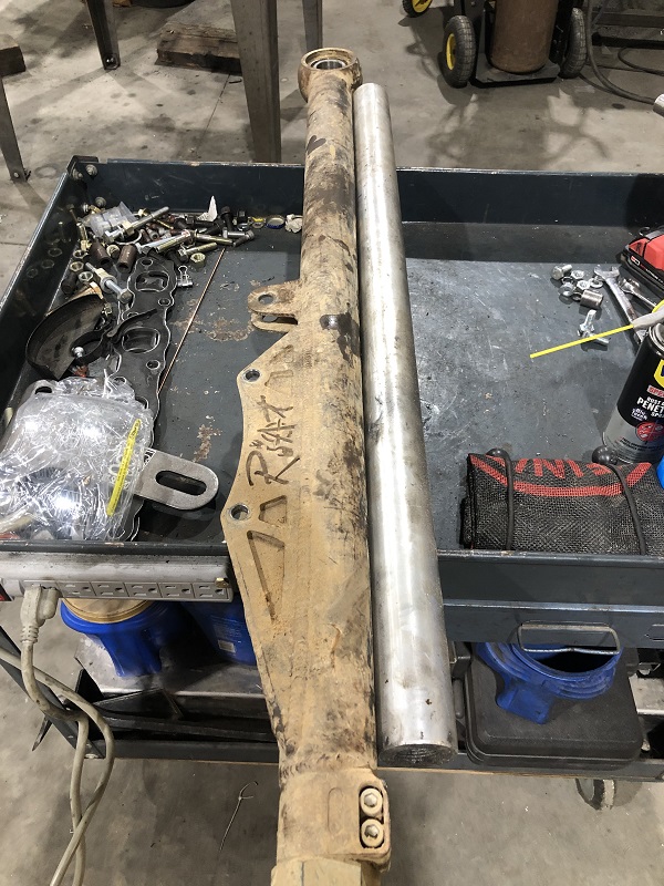

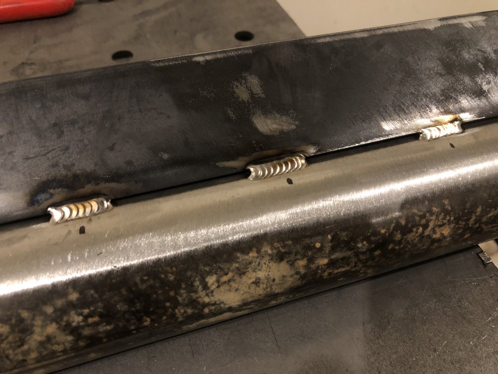

When going over everything after the last ride, I realized my fancy trailing arm weren't real happy...

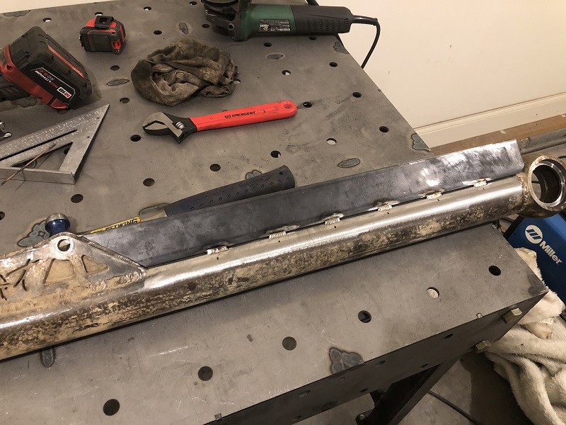

Turns out I managed to bend both of them, which I think is pretty impressive... They are 2.5x.250 DOM with a full 2" 7075 AL slug inside.
Oops...
BKOR let me borrow the big press to try to straighten them back and it took all she had to do so.
I did as good of a job as I could.
Massive thanks to Jake to let me use his equipment, I couldn't have done it with the stuff I have at home.

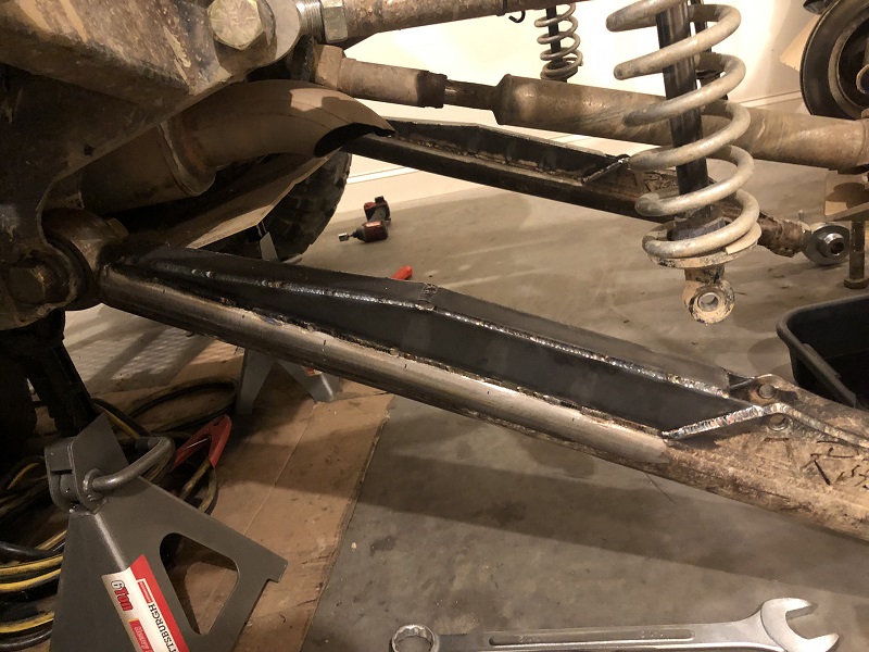

Then I started trussing/boxing so I don't have the same problem again.
TIG welded everything for the heck of it. Took me wayyyyy too long but I enjoy the process.
What the arm looks like after reinforcement. You can see the HAZ from the inside welds of the structure.
Done and installed.

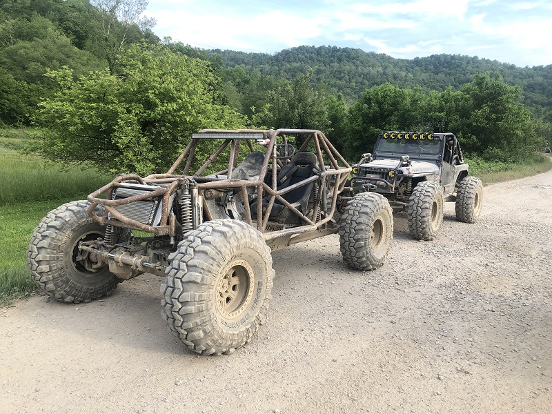

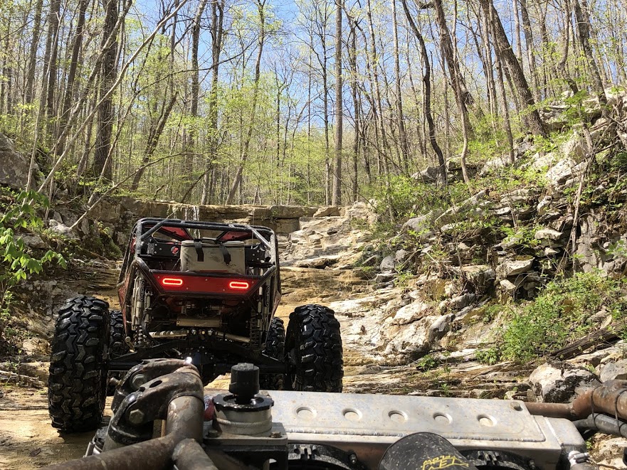

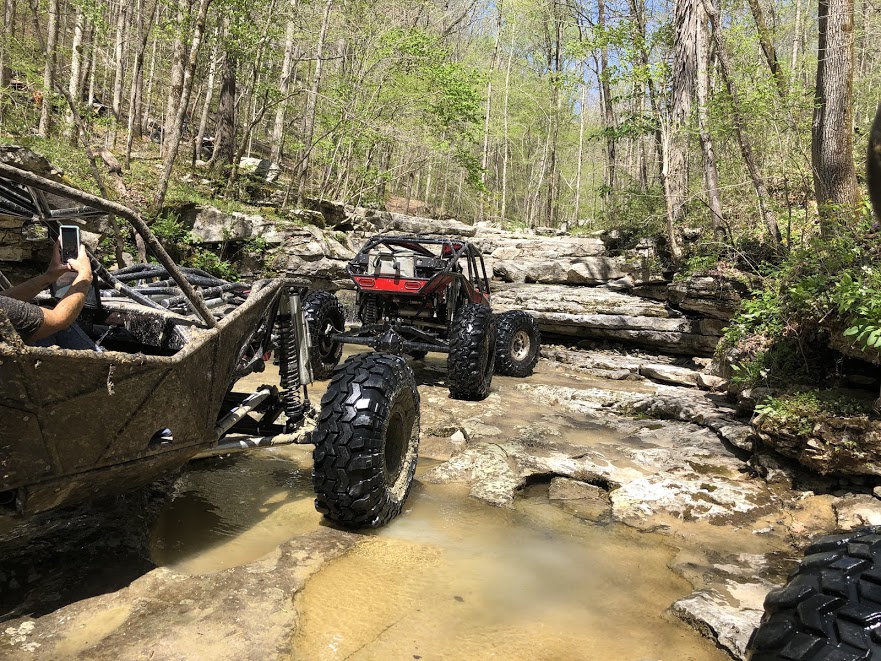

Last week, my buddy Marvin (who owns the Youtube channel Flex, Rocks and Rollovers) hit me up. He was going for a day ride up to Tackett Creek on Saturday and offered me to go with him. Since I wanted an easy test day and just to get back in the woods, this was the perfect opportunity. Plus Marvin is a great dude and it has been a moment since spending time with him.
He picked me up on the way.
And we had a great day out in the woods. So good that I didn't even take my phone out of my pocket all day and didn't take any pics except this one at the very end of the day when we were done.

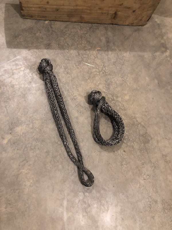

And made some more soft shackles, it's a good time burner and a very useful thing to have.
Send me some rope if you want me to build some for you.

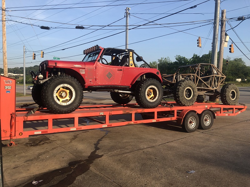

This Jeepster is as nice of a custom Jeep build as you can get IMO. It may not look like that but literally nothing of the stock Jeepster was left untouched, outside of the grill. Everything else is custom made in some sort of way. And the damn thing works and racks miles on and off the road.
I put a fair bit of sweat equity in it when it was built and must say it was probably one of the most rewarding experiences of my life when we took it to Moab for a shakedown run.
