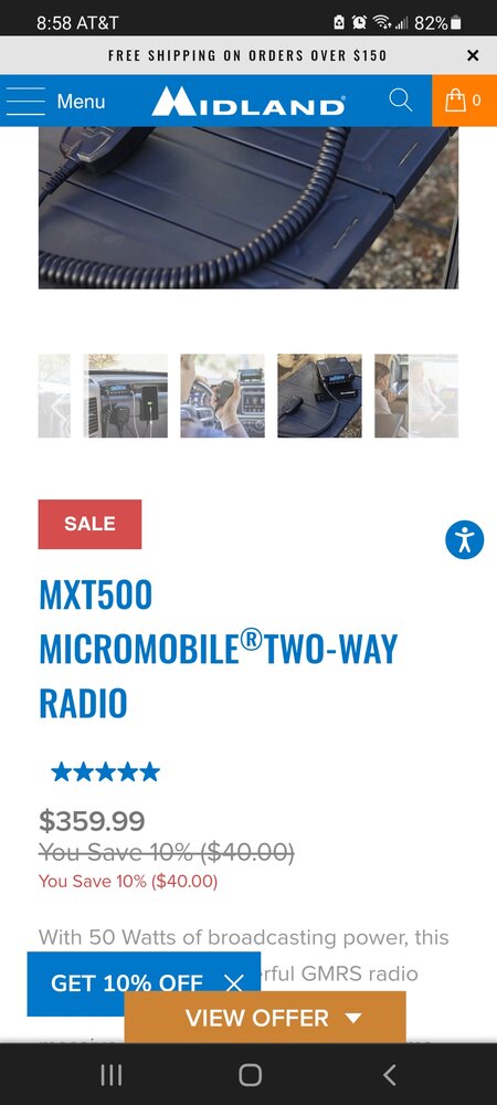

They do want a pretty penny for them.

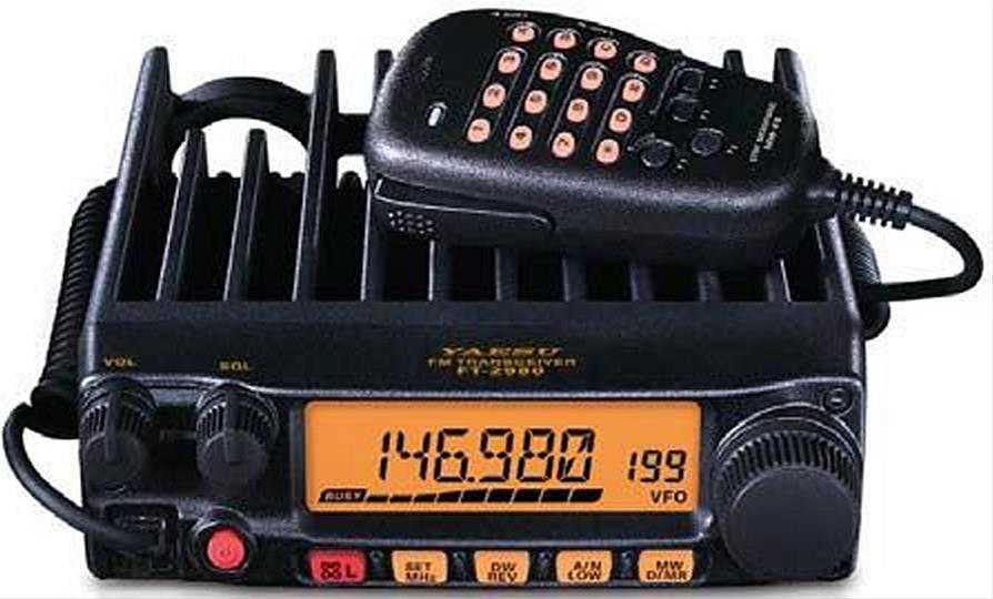

A 50W radio capable of GMRS isn't going to be a $100 radio. The Yaesu's Shawn mentioned are not UHF radios, only VHF so those won't work. The TH-9800 can be programmed for GMRS thru the TYT programming software and will run you about $220. A Yaesu FT8900, a Kenwood TM-V71a or other similar 40/50W radios are going to run about the same as the Midland but are more capable radio's and with a little bit of work can run GMRS (as well as ham frequencies).
If going GMRS only and if you want 50W, buy the Midland. It's ready to go out of the box. The ham radio solution isn't and may require some sort of modification and will require programming.
That's all true, but not my point. If you have a 15W GMRS mobile and a good antenna located high on the vehicle but you think you need more power, don't go wasting money on a high-powered GMRS radio. The cost on them is stupid for one, but you'll get better performance out of a VHF radio of the same wattage for a lot less money. Plus you can use real repeaters.

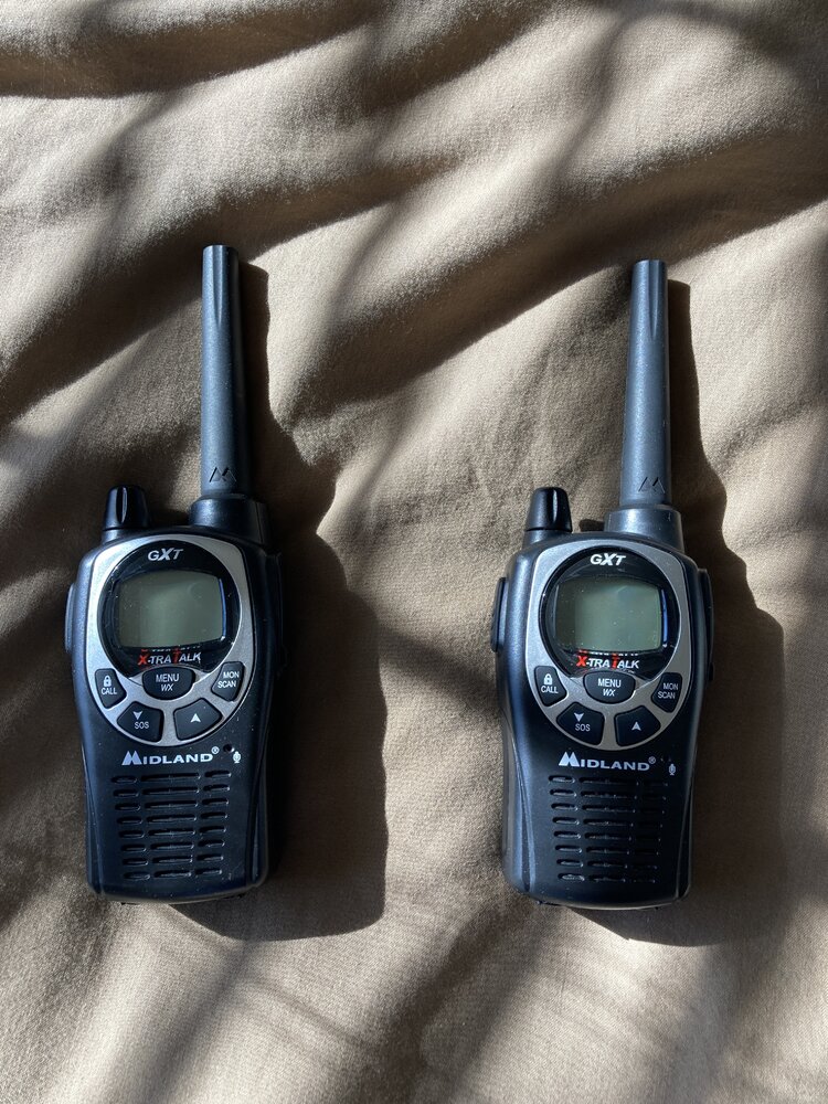

I stick with GMRS cause a 5 year old can figure it out. Plug it in, select a channel (with no decimals) and rock out.
That other stuff is so confusing it’s over my head. Lord forbid I go wheeling with someone else and gotta change channels or something lol.
I can keep it simple, and if someone doesn’t have one we toss them an extra handheld that’s cheap to replace if something happens and it’s all good.
