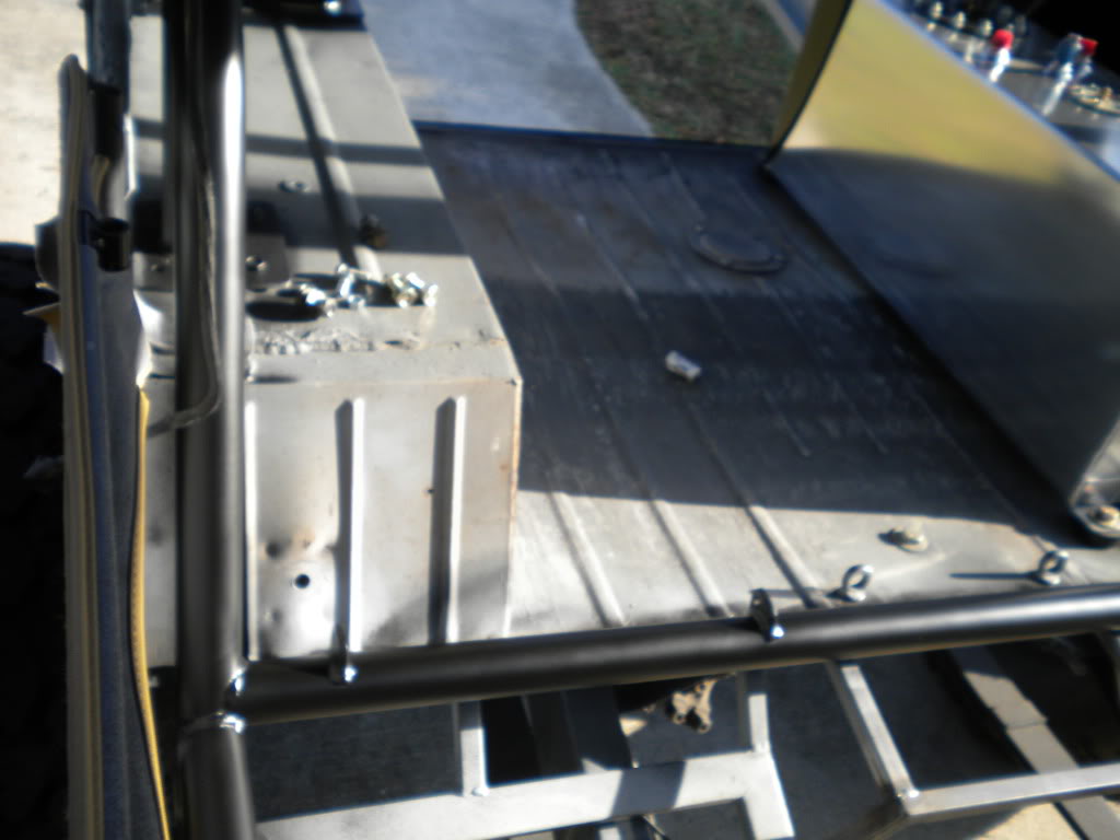

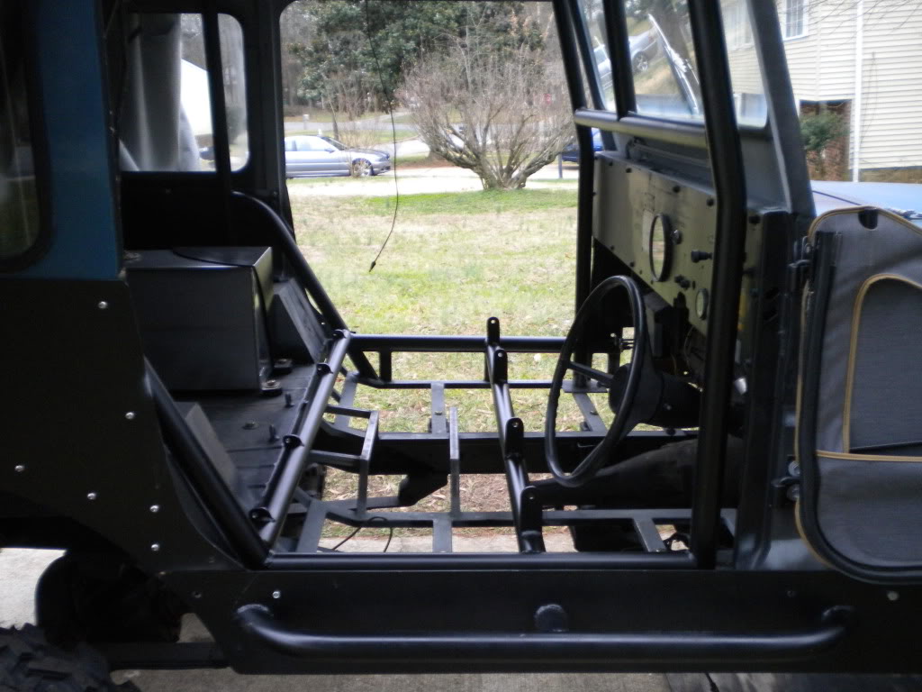

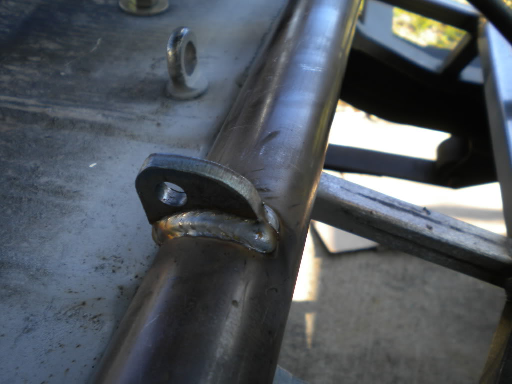

Upclose of rear seat mounts welded up.
I got the other floor crossbar in. I still have to make the front seat tabs.
Wide shot.

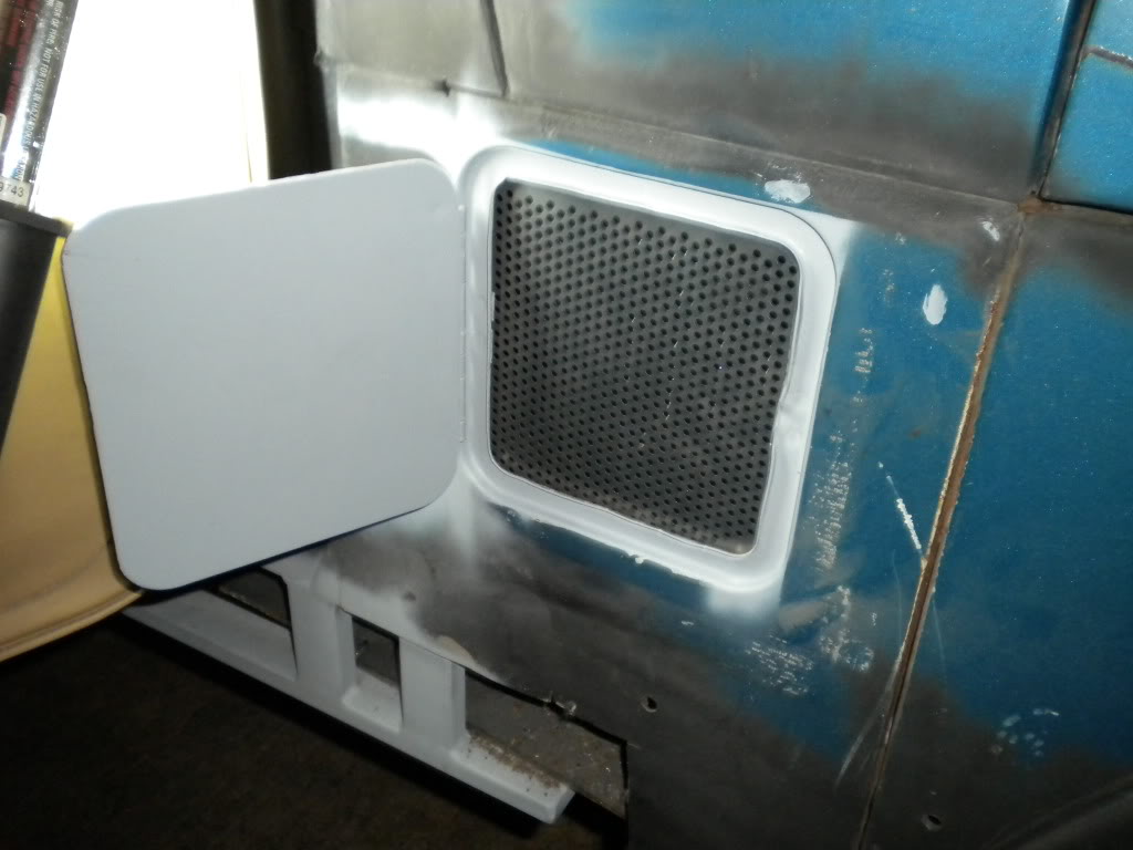

I also started fabricating the air vents that I am re-doing. The stainless steel pieces are from Genright Offroad. They're actually for their tube fenders and they were on a closeout so I figured that they would work for what I was planning. I think it looks pretty good. I still have to make a stop and a latch so I can shut the doors when it's cold.

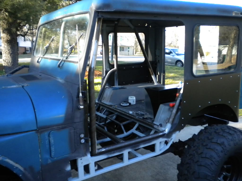

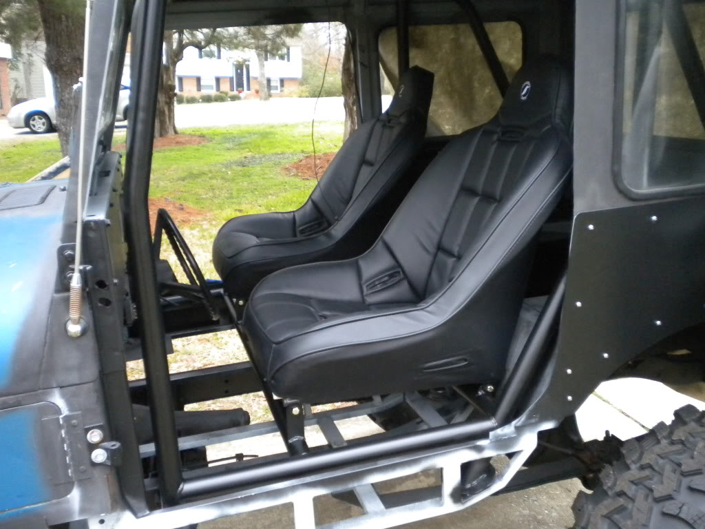

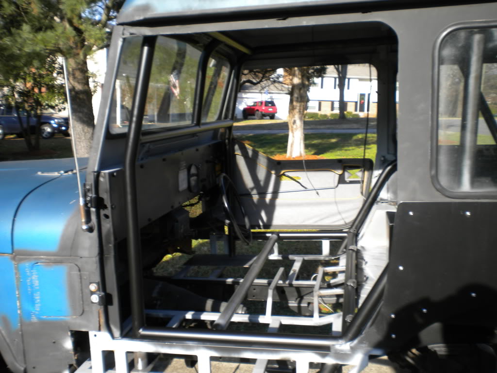

I got the whole cage painted except for the floor tubing where I have to add the front seat mounts.

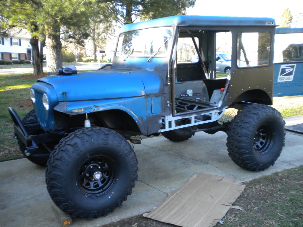

This shot is from the driver side showing the room between the cage and the soft door.
Driver side cage floor / seat mounts.
Passenger side ready for the seats to be put in.

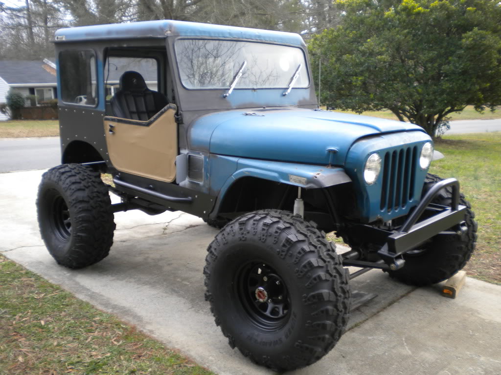

Front shot with painted cage and seats installed (kinda).

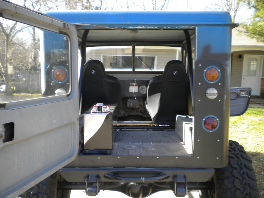

Rear shot.
Passenger.

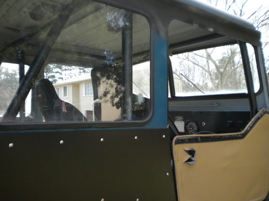

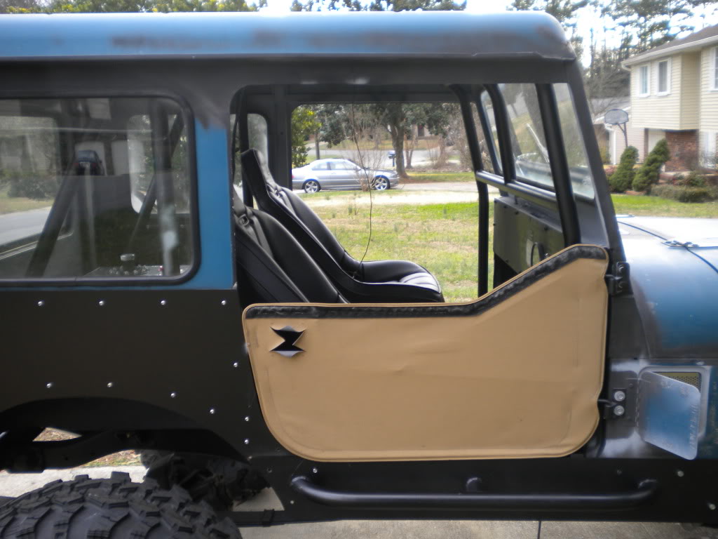

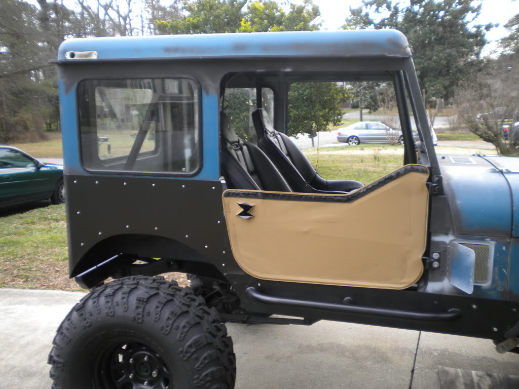

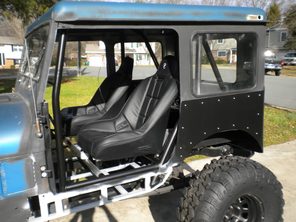

Here are a few more pics with everything mocked up (door, sliders and seats). Again, that ugly tan door will be sheeted with steel and painted black (I'll fabricate them like the Poison Spyder door skins but with thicker steel probably).

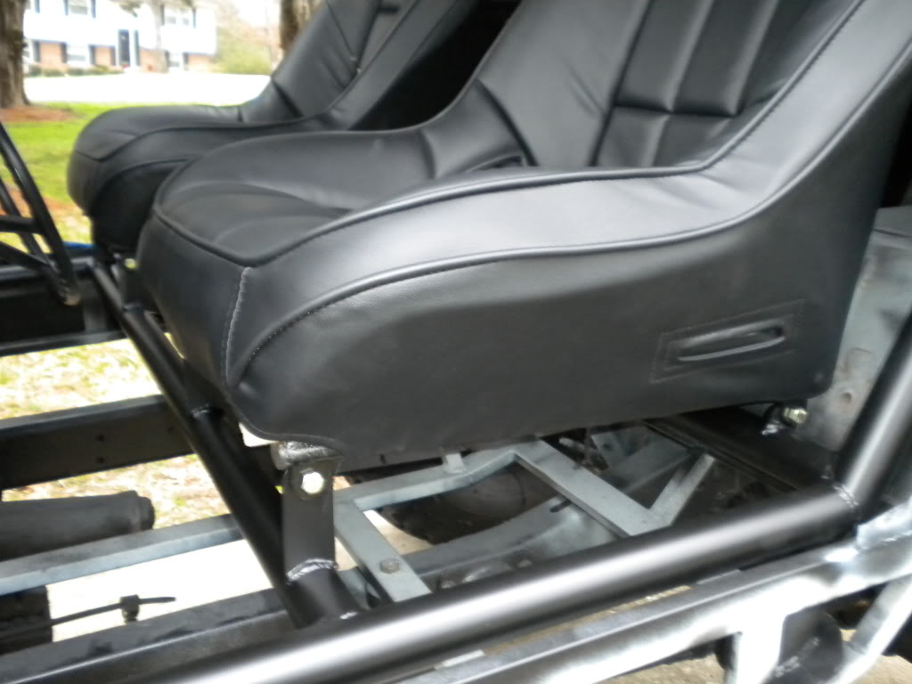

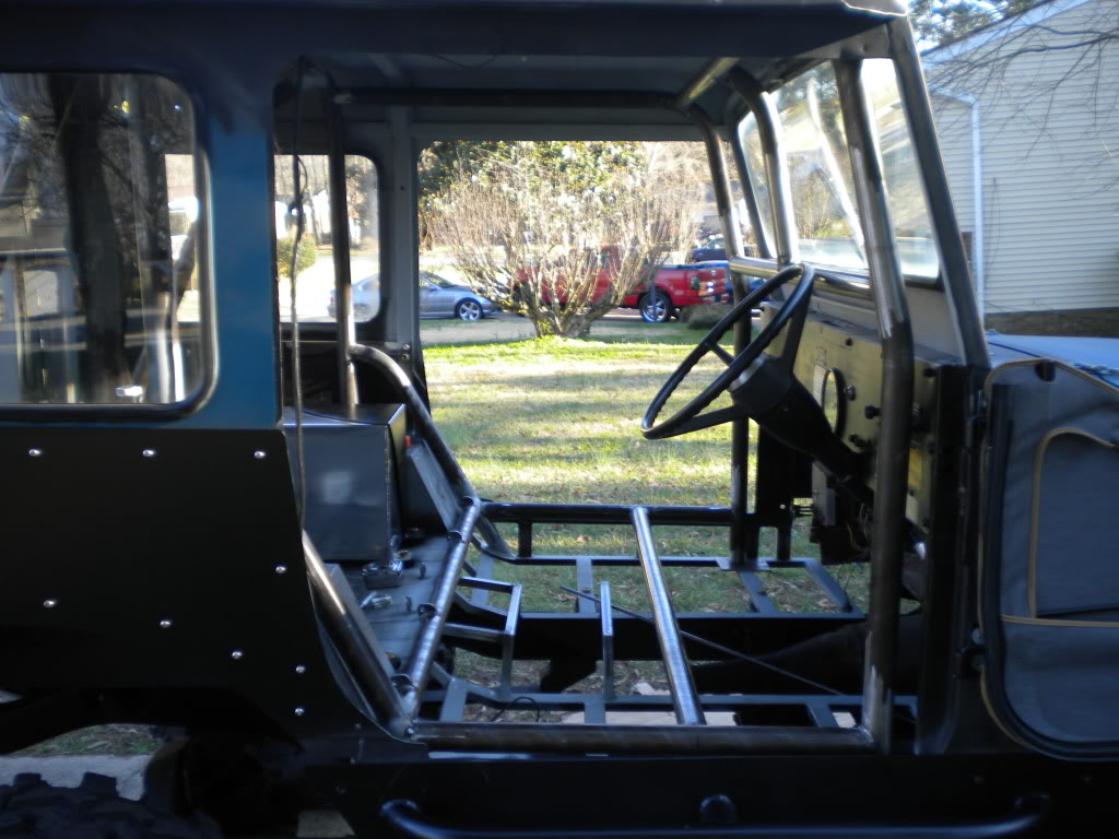

I finished up the seat mounts today. I fab'd the seat mounts, welded them on and painted the rest of the cage. The only thing I lack, is the b-pillar top side. I'll have to cut the roof to finish it.

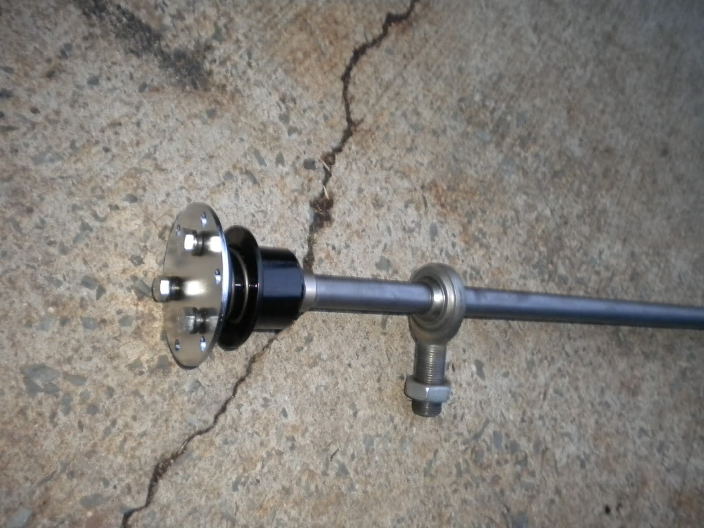

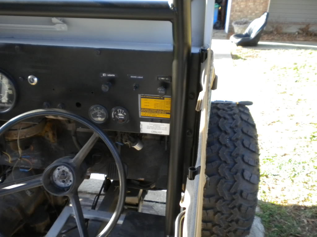

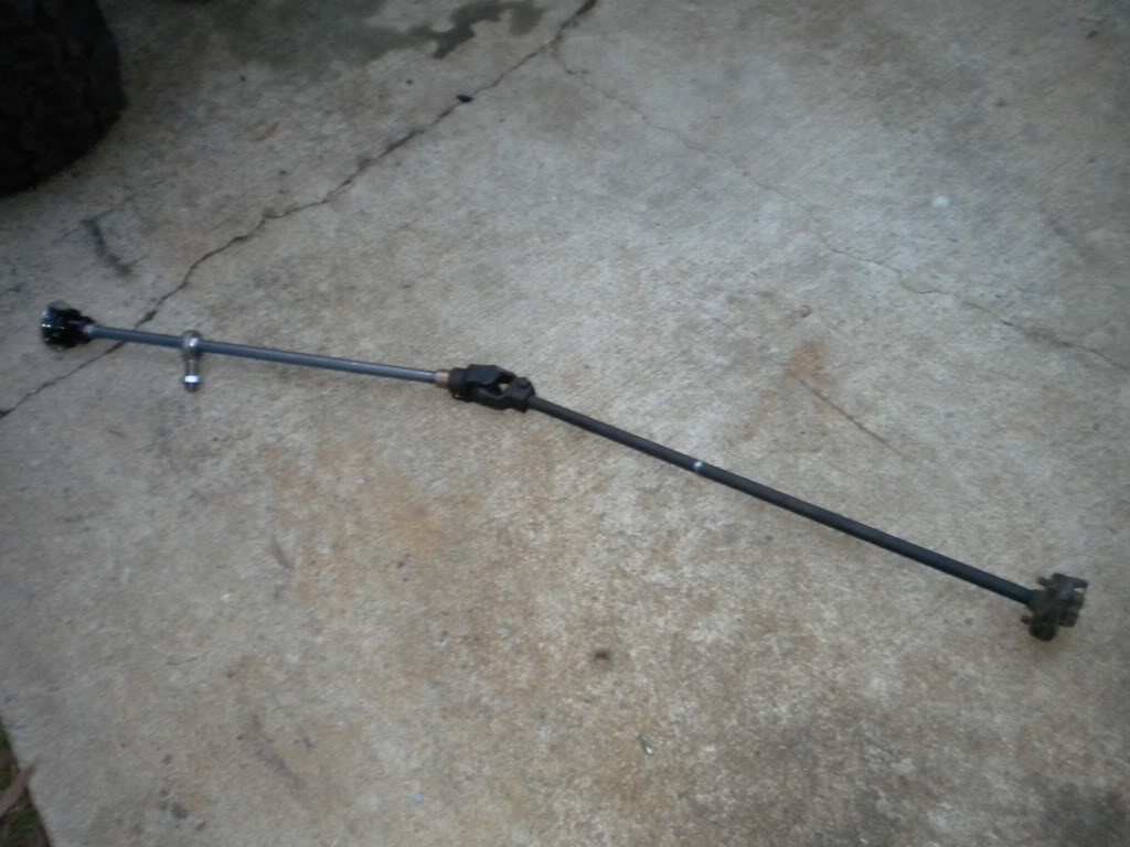

I also removed the old steering column and cut it apart and scraped what I didn't need and re-used the steering shaft that was inside of the column. The steering shaft will be mounted to a heim joint that will connected to the roll cage.
Mocked up with my removable steering wheel hub.

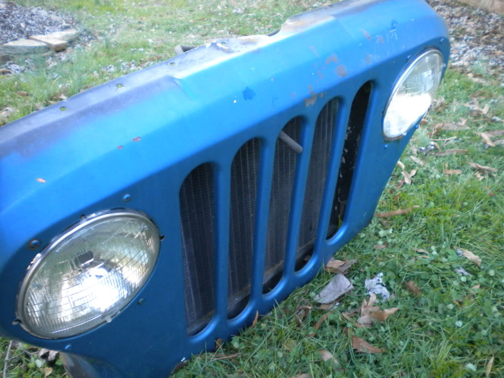

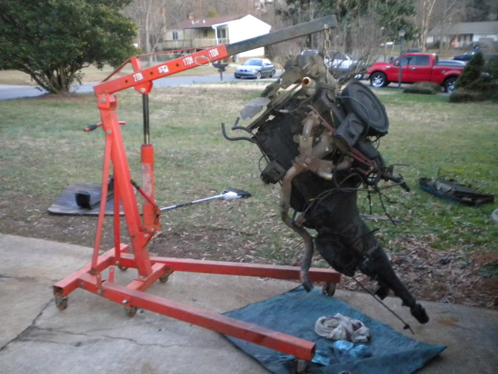

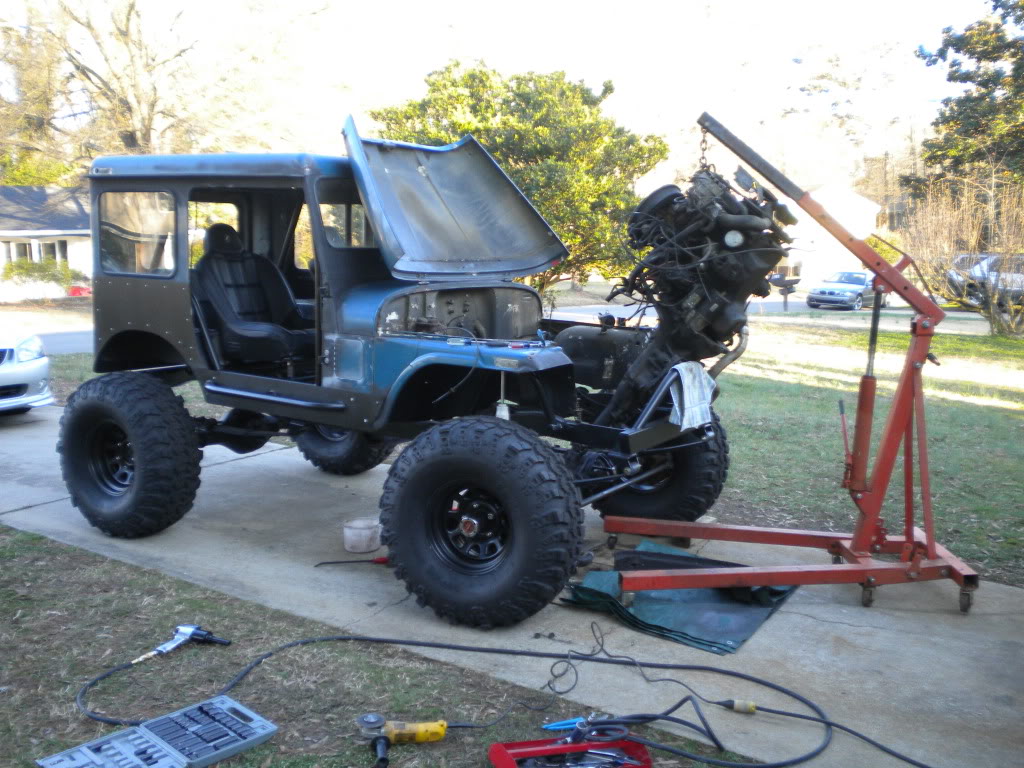

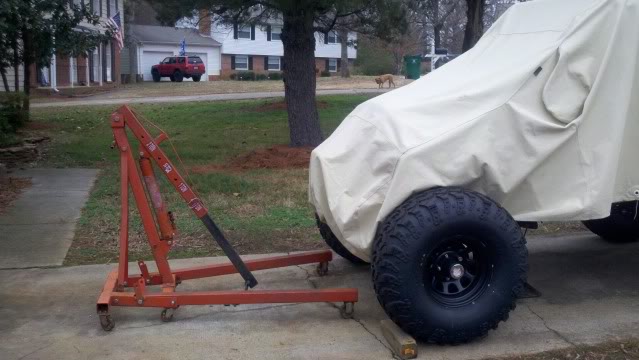

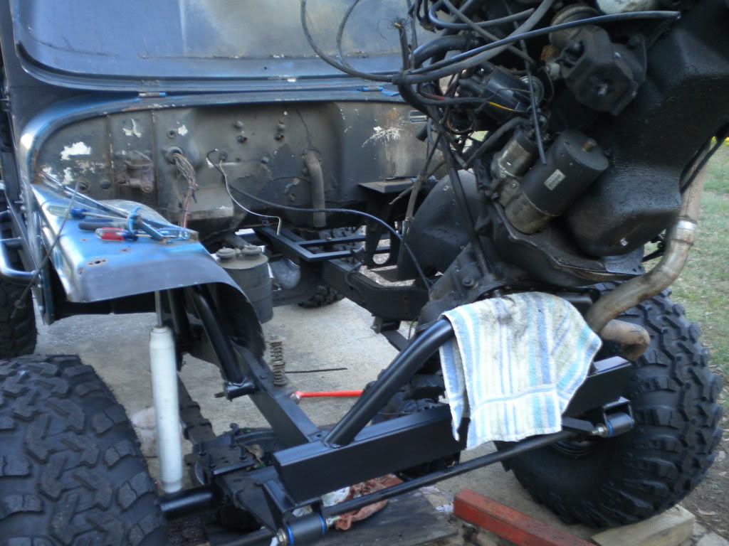

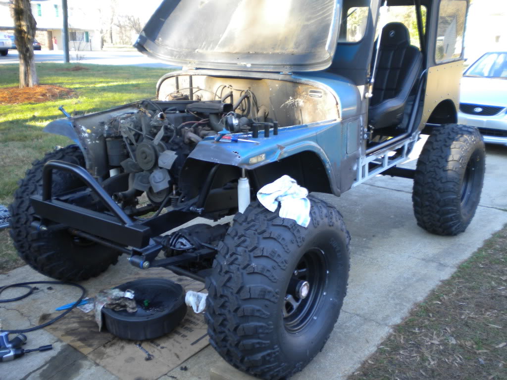

I got the motor and transmission pulled today. Good riddens! I pulled the grill to make it easier to get the motor out.
Feel free to cut a notch in that handle so you can raise and lower the boom with it. The original handle got lost and that is one out of an old jack. I keep meaning to cut it but keep forgetting to.
