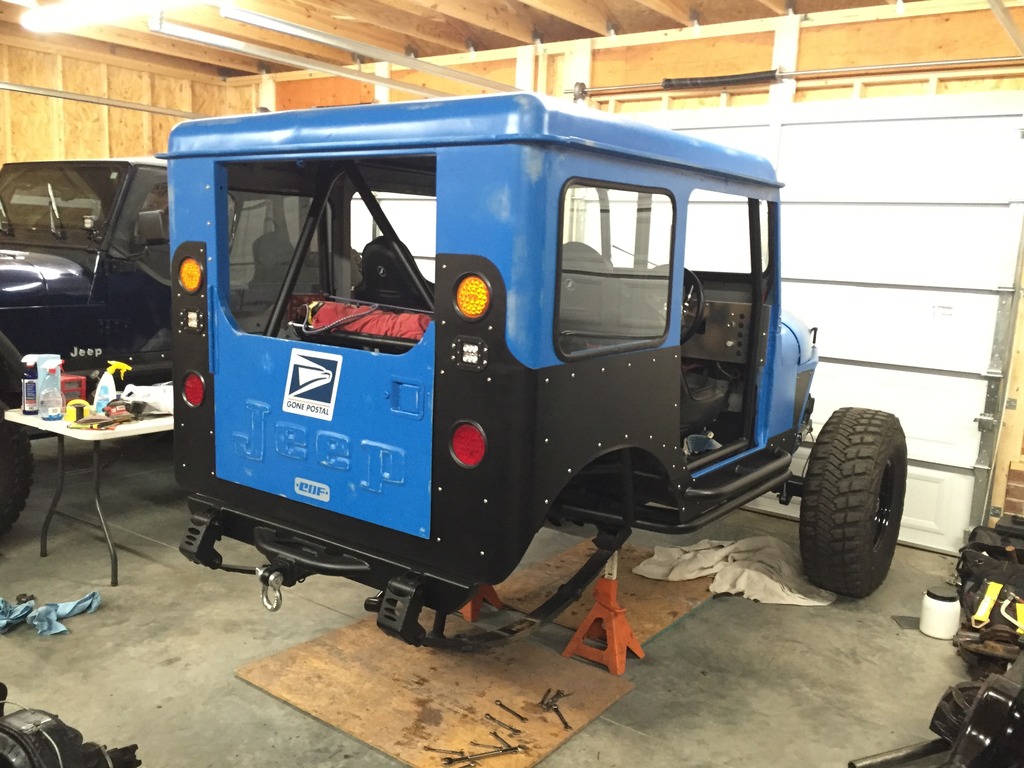

Had a great time with you guys, John and Crawl Mag - Crawl Accross America and our LKNC's in URE last weekend. Your craftsmanship with the postal is awesome. Well done!
Awesome work as always Chad!
Bad ass!
Nice touch on the paint, most likely my favorite build on the forum. Clean purpose built and not killed by throwing a huge budget and ego at it.
Or worthless parts thAt doesn't serve a purpose. So clean and yet over the top
How do you like the lizard skin? Hows it holding up to you having your feet on it and such? I have been looking at it for the interior of my truck but not sure if it really works and how it holds up.
Dang right can't wait to that build thread
!Next time I get to Corey's Transmission I will have to show him the pics. I can't believe I nearly bought that Jeep for a tool truck LOL
That interior color reminds me of the stock cj that use to sit inside of tarheel 4wd. It still may be there been years since I was there always liked that color. brother it looks bad ass
Awesome job. I love this thing. You do some nice work.
Off topic, who's tan LJ is that? I've seen it at the Lowe's in Concord and wondered if those were your tires and wheels you had for sale a while back.
Loved this thing since the first time I saw you out at URE. This thing gets better and better. Looks Awesome!
Commented on your build over at pirate, andrew05ljr... Tell me more about LJ cages?! Carolina Rockrunner bought those Foxs off me, not sure if you were with him. But Id be in for cage details and thanks for info on the lizardskin

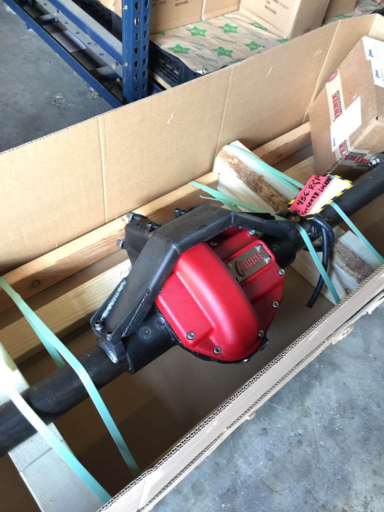

It is already setup for a dual triangulated 4-link so I'm weighing the pros and cons of going to a 4-link rear with coilovers and air bumps. I'm thinking 10" coilovers, mid-arm link lengths and air bumps for the rear. What do you guys think?
If the decision comes down to money, I highly recommend linking it with coil springs and good shocks. Its much more budget friendly and works great, especially if your only looking at 10" coilovers.
I also think air bumps are a waste of money if your rig doesn't see air time. I like a good progressive bump or timbren. My own personal rig has cheap energy suspension bumps and I have no problem with them crawling with good shocks.
If you do go with coils used jk take off progressive springs work really well
You guys are wearing out coil springs? My brain hurtsThese are a great temporary spring when your building to get a feel for ride height (also cause there cheep to free). I know several guys that have run thoes in the past and they work well, they just tend not to last. Both of the guys I wheel with that run thoes have replaced them with a quality lift coil spring. One went through two sets a season before buying springs. I run and love rubicon express springs.
I just like to get rid of rear leaf springs cause I've found them to be consumable.
