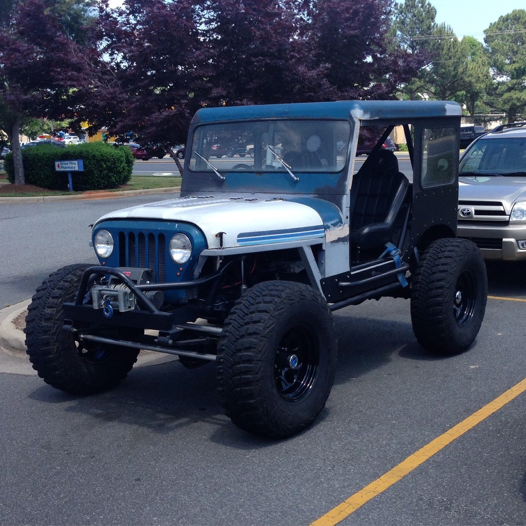

Hey guys. Sorry my updates have been few and far in between. I have been working on my postal again. Just last weekend I finished up the front bump stops. I got the PCM re-tuned and it made a huge difference. I still have a check engine light for a high idle so I need to figure that out. After the trip I found that my Advance Adapters transfer case crossmember bushing mount lost the bolts that bolted it together, so I swapped out bolts with nylon locknuts and a little bit of locktite. Other than that, it's running pretty good.
Getting busy!
ai1024.photobucket.com_albums_y309_95builtjeep_gone_20postal_IMG_3068_zps366542ec.jpg
They are simple Daystar bumps I picked up from Liquid Iron and I fabricated some mounts on the frame for them. I still have to add a bump stop piece for them to hit on the spring plates but that will come in a few weeks. I still have to fabricate some rear bumpstops too.

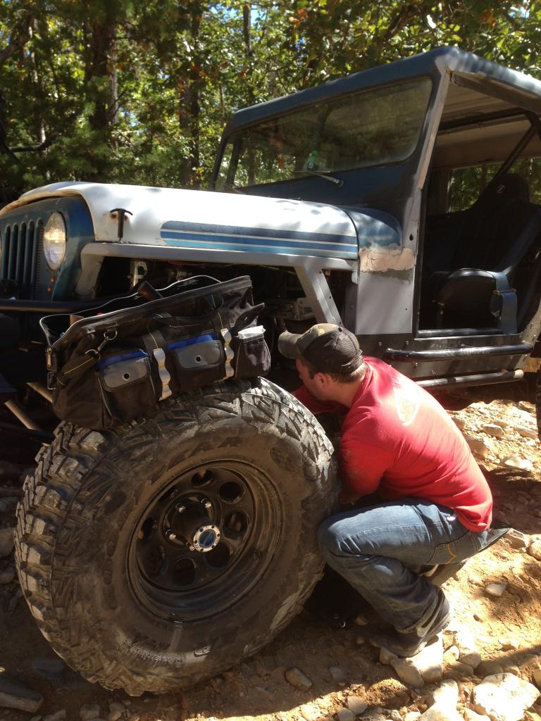

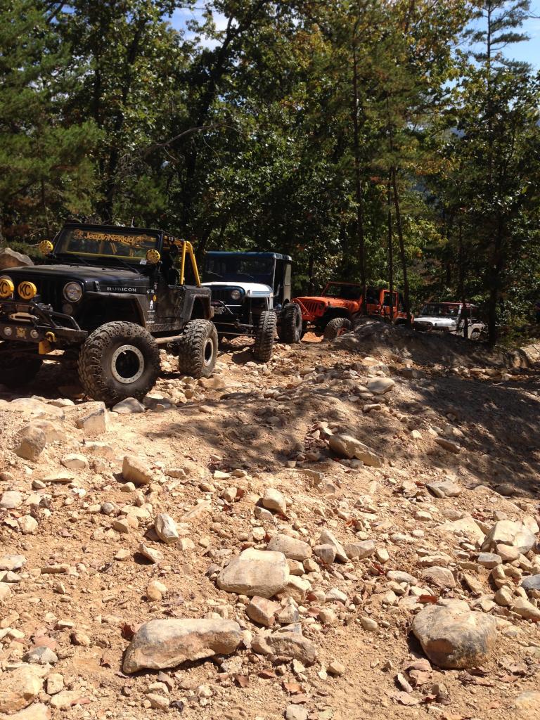

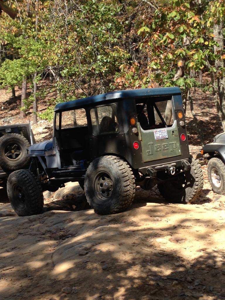

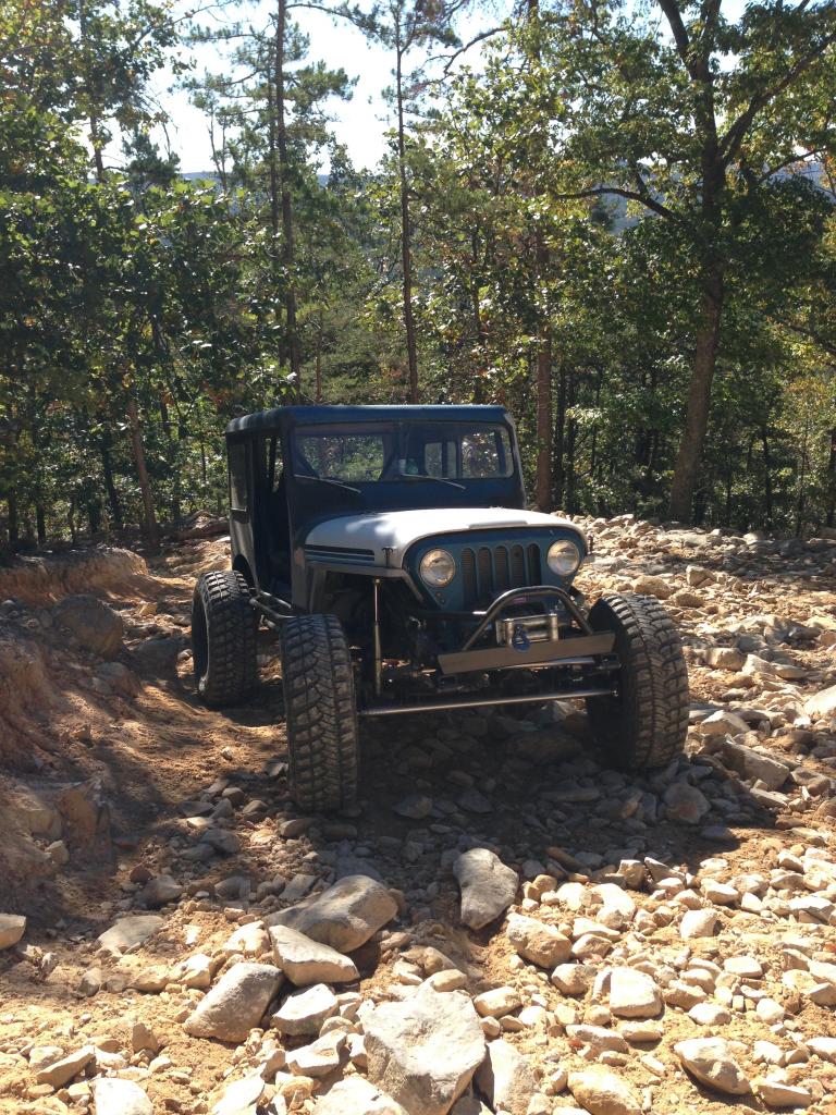

Okay to the fun stuff. I got the jeep out for the Uwharrie Fall Jamboree. Pics are of the event. I had a great time. The weather was perfect. "Daniel" trail was tough again and I actually broke a front driveline on the far right hill climb. Onto some more photos from the weekend. I'll be out there again this weekend then headed to The Gulches in early November with some friends.
ai1024.photobucket.com_albums_y309_95builtjeep_gone_20postal_IMG_3149_zps5f01571a.jpg

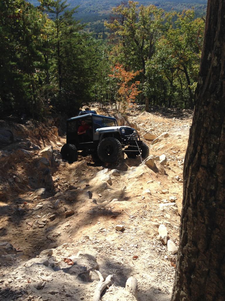

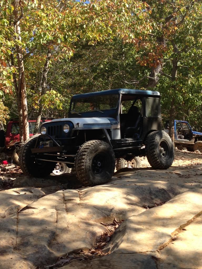

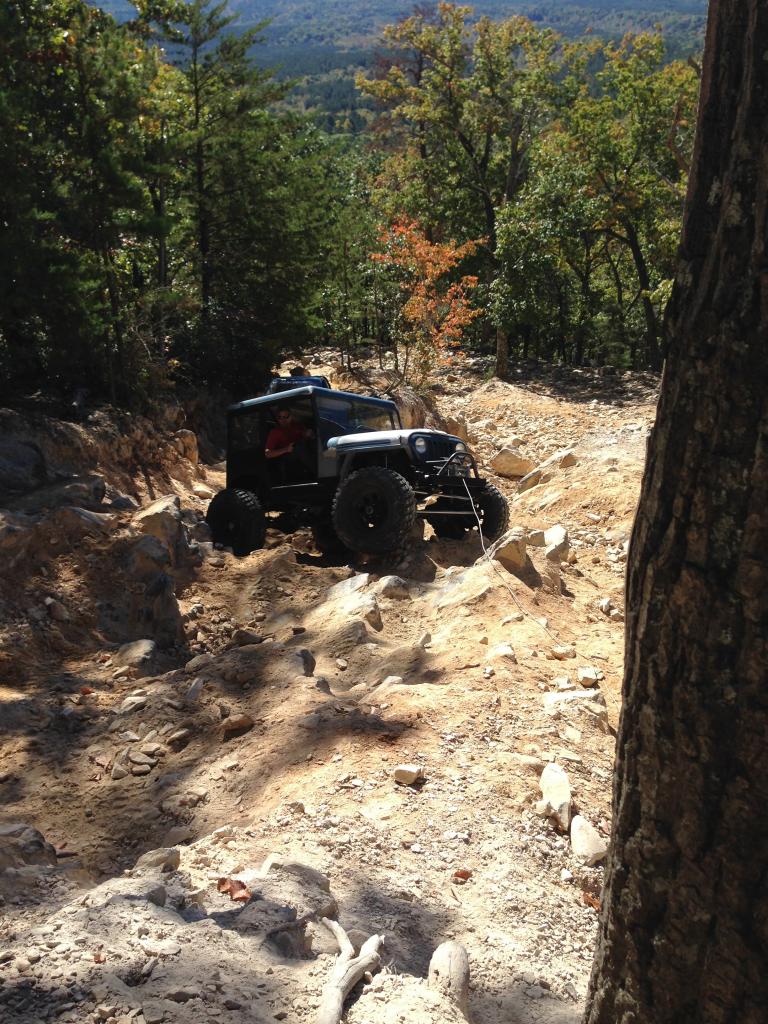

Going up Daniel trail in URE.
ai1024.photobucket.com_albums_y309_95builtjeep_gone_20postal_IMG_3156_zps8d781ab3.jpg

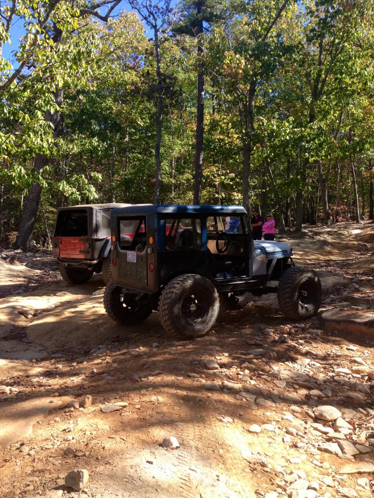

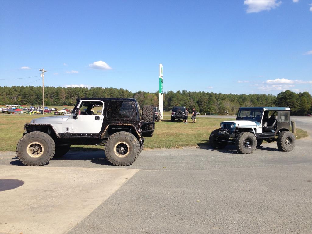

I just thought this photo was funny. It puts my jeep into a size perspective. My buddy's TJ has 41.5" rockers. My postal 37s. It looks like I'm following my big brother around. Hahah!
ai1024.photobucket.com_albums_y309_95builtjeep_gone_20postal_IMG_3197_zpscb05cf79.jpg

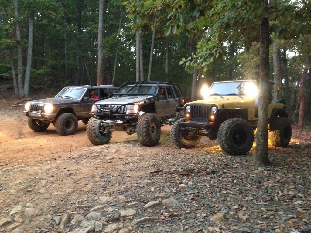

Continued photos. I rode around in my buddy's TJ on 37s for part of the trip too. It felt good to rest and relax every once in a while.
ai1024.photobucket.com_albums_y309_95builtjeep_gone_20postal_IMG_3228_zpsc8d944f4.jpg

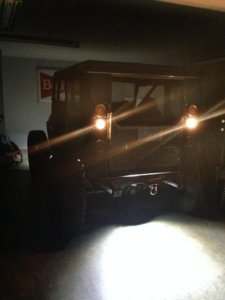

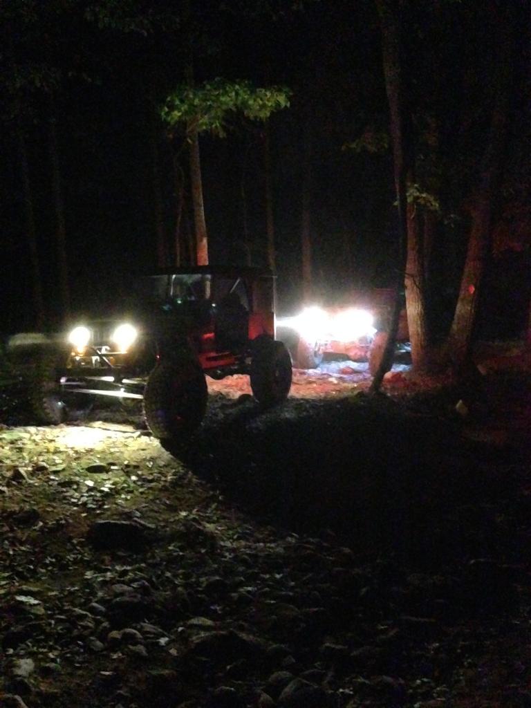

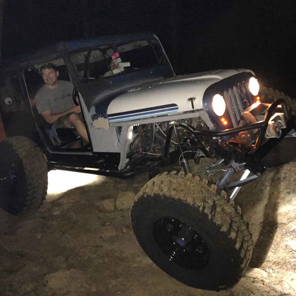

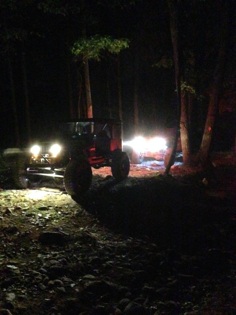

Night wheelin'. I definitely needed more lights underneath so I ordered up some 7" LED lights from baby hulk on the site. They made a huge difference. I'm going to add the little square rock lights in each fender well also so I have more visibility on each tire also.
ai1024.photobucket.com_albums_y309_95builtjeep_gone_20postal_IMG_3256_zpsb1b17389.jpg

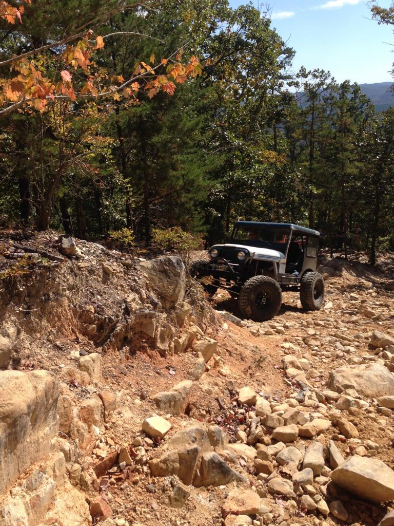

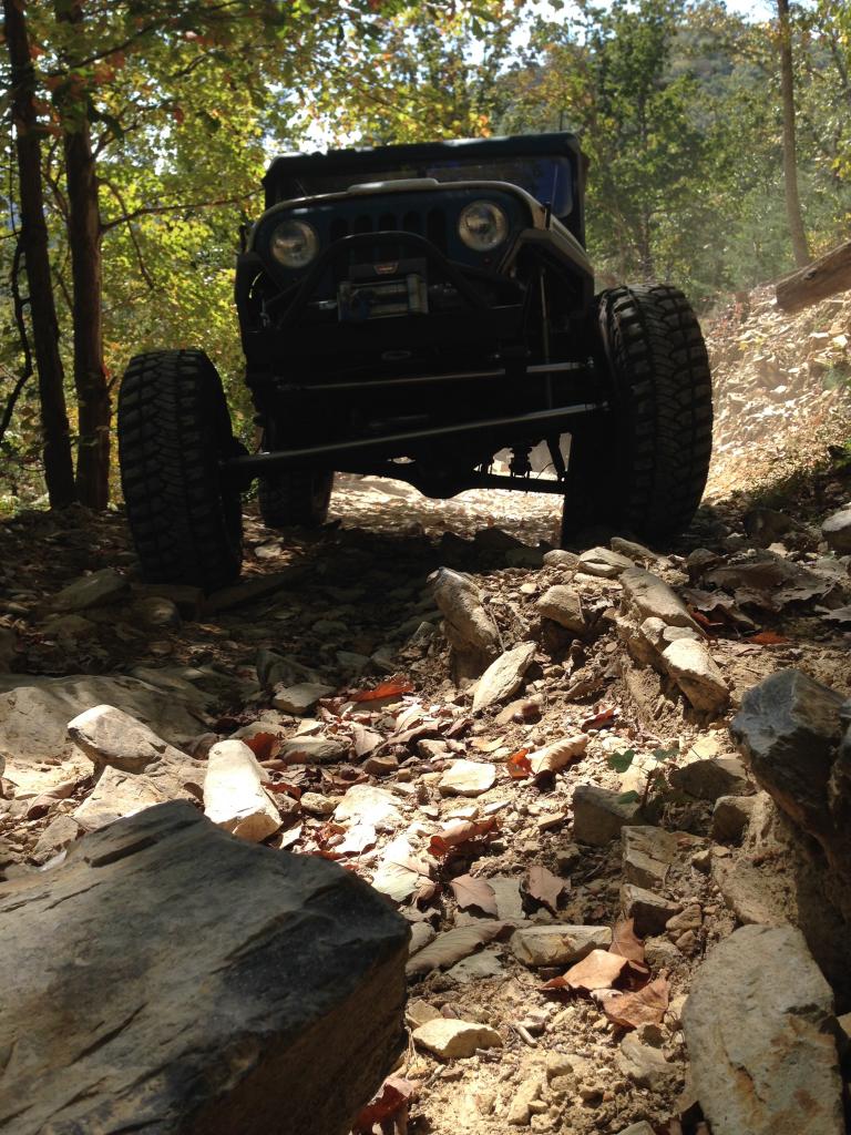

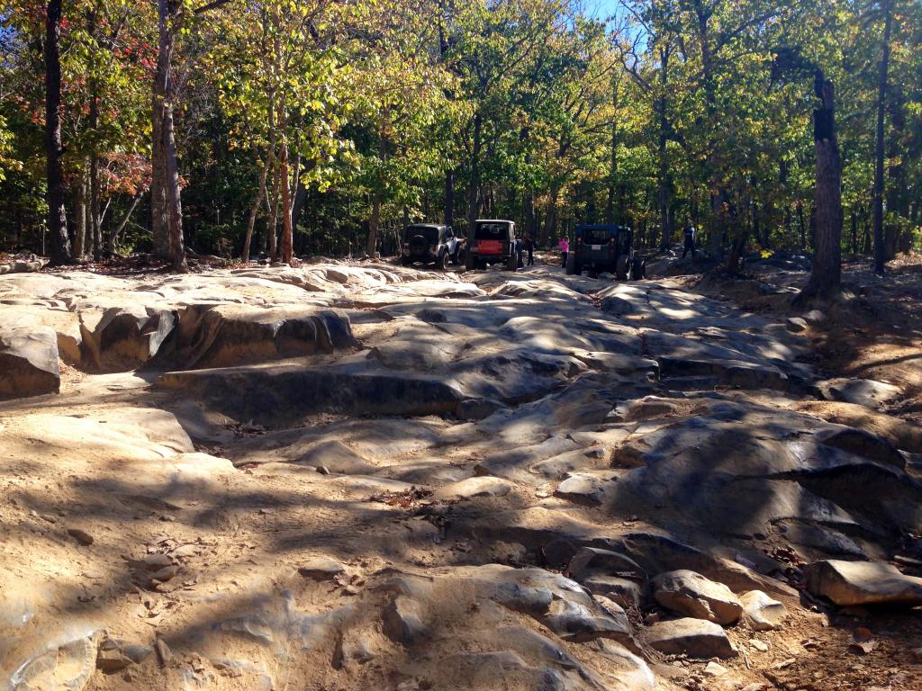

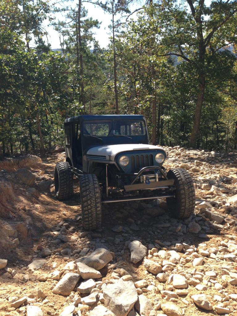

Sunday going up Daniel.
ai1024.photobucket.com_albums_y309_95builtjeep_gone_20postal_IMG_3388_zps69bdc2bd.jpg

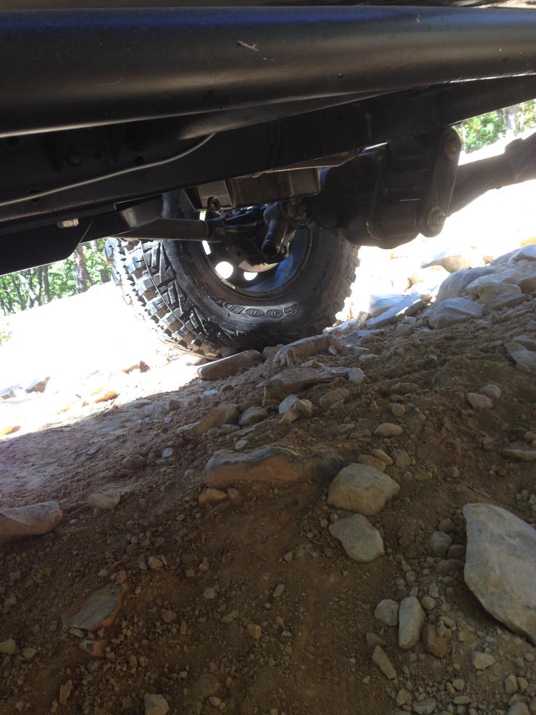

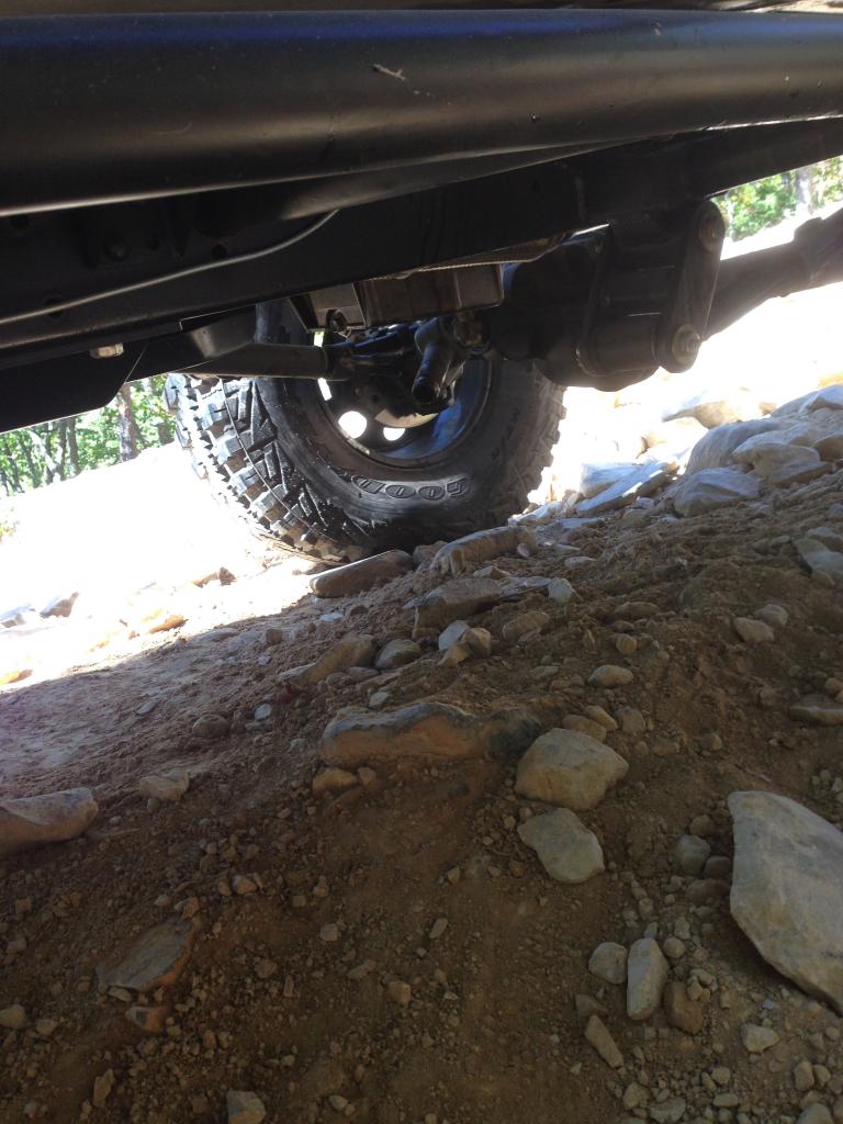

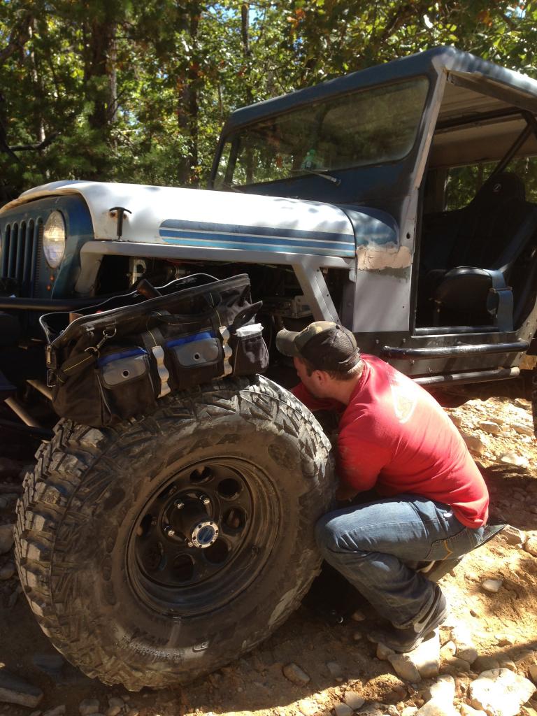

Getting sketchy right before I broke the front driveshaft. Pictures never do anything justice.
ai1024.photobucket.com_albums_y309_95builtjeep_gone_20postal_IMG_3392_zps592357f6.jpg
Broken front shaft. It's okay. It was a junkyard YJ shaft I had laying around. I'll trim the twisted splines and use it as a trail spare.
ai1024.photobucket.com_albums_y309_95builtjeep_gone_20postal_IMG_3395_zpsf6b4c2bc.jpg
ai1024.photobucket.com_albums_y309_95builtjeep_gone_20postal_IMG_3396_zps274cc808.jpg

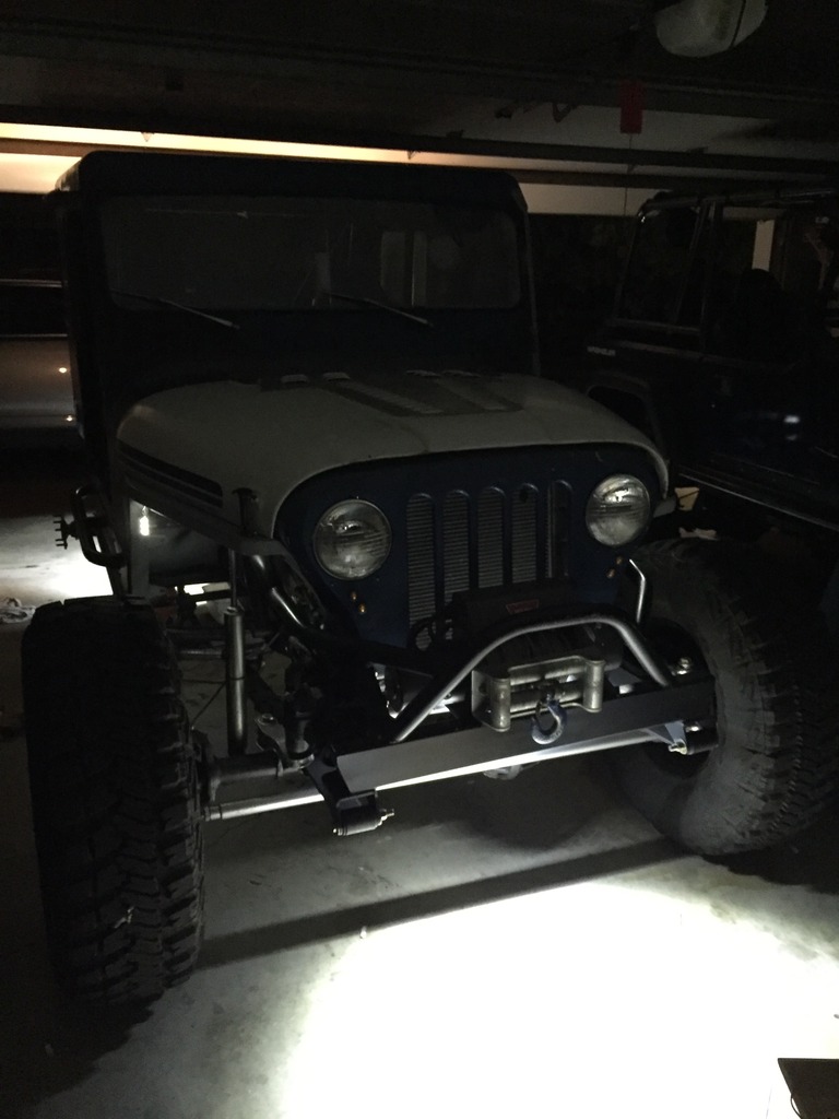

Upgraded rock lights for entry and departure lighting. I still have to get the little square rock lights installed. I'll do that next week. FYI. The garage was 100% dark until the lights came on for the photo. I plan to swap out the reverse rock lights with some white LEDs also.

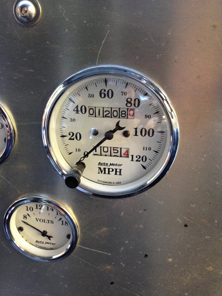

Officially put 1208mi on the jeep so far.
ai1024.photobucket.com_albums_y309_95builtjeep_gone_20postal_IMG_3487_zpse379810b.jpg

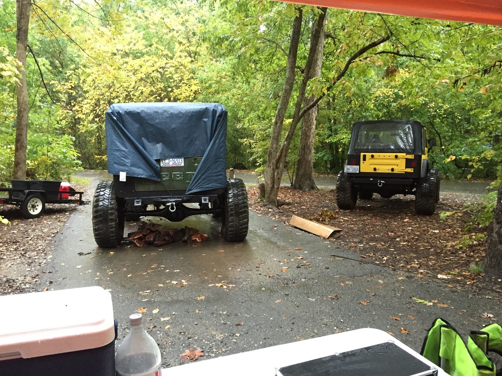

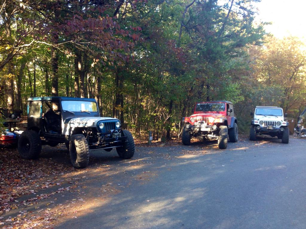

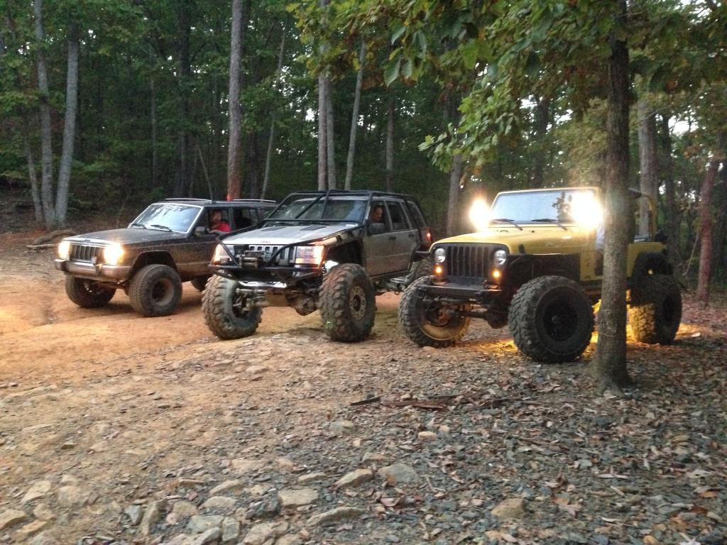

Campsite next to my new friends' jeeps...Stephen and Will.
ai1024.photobucket.com_albums_y309_95builtjeep_gone_20postal_IMG_3480_zps6533f779.jpg

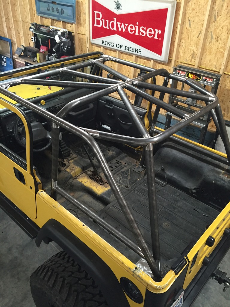

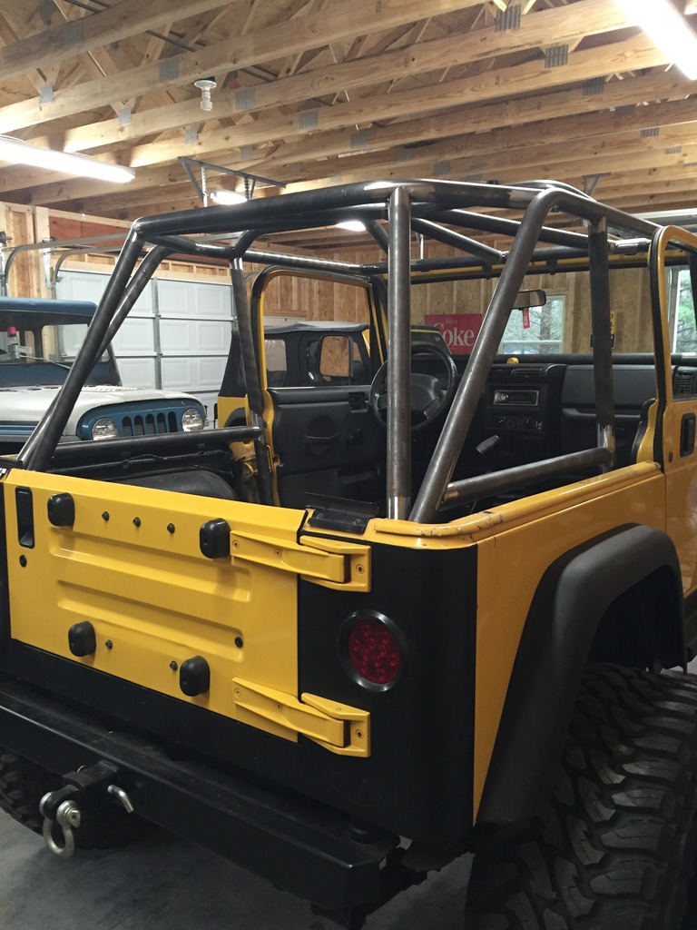

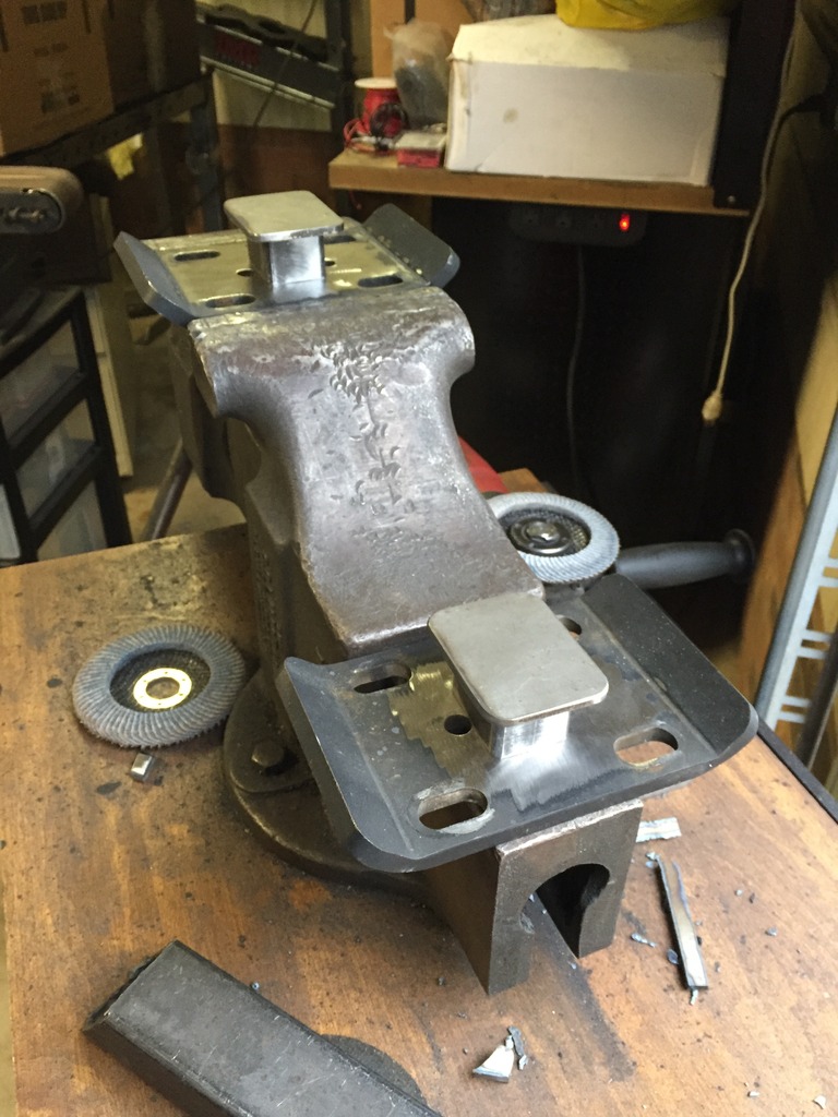

I haven't worked on my Postal in a while. Been busy with other fab work and it even got a vacation from our spring URE trip. I bought the rear brakes I'm swapping over, just have to make time to get it finished up! I just finished a cage for my YJ. Also working on my buddy's shitbox XJ and bumpers, etc for my buddy's TJ. AND building a bitchin' coffee table for another friend. Busy busy!

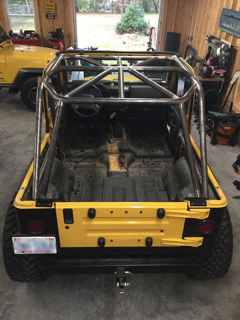

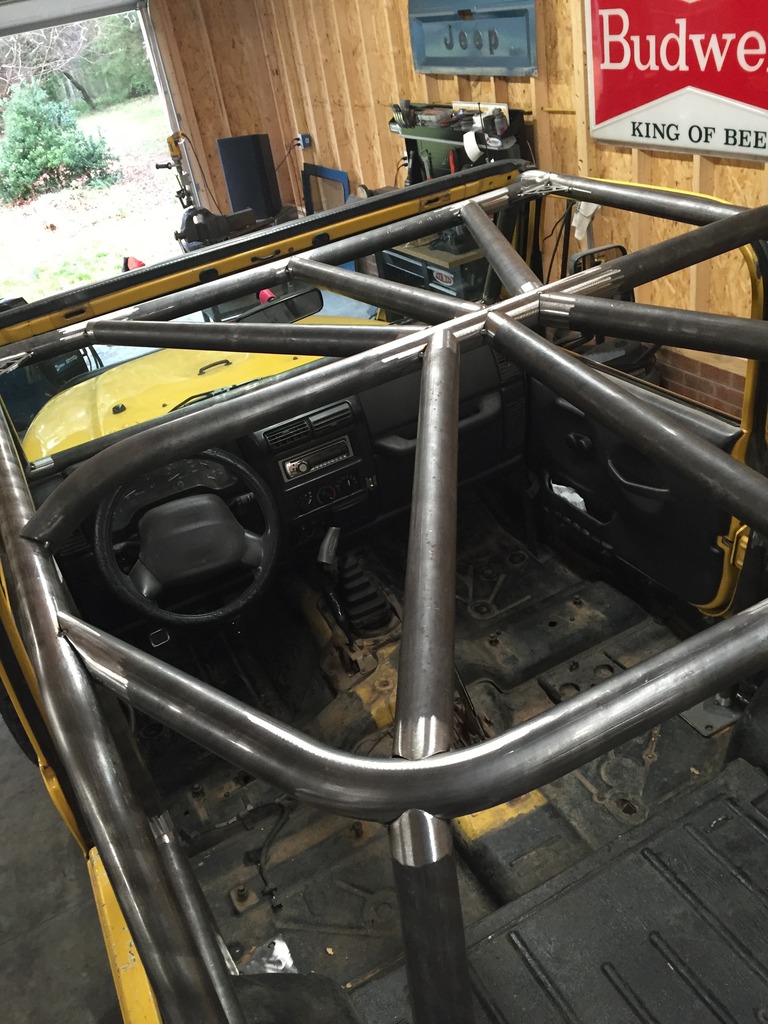

My YJ cage I just finished...
ai1024.photobucket.com_albums_y309_95builtjeep_jeep_20build_202010_IMG_4650_zpsockg8a6z.jpg

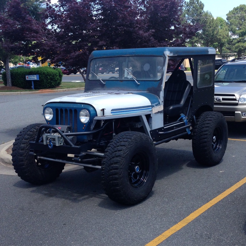

Got the old postal out on Saturday and took her for a ride. Doing a little grocery getting! I think it's about time I start working on this old turd again! I did get an automotive airbrush kit for my birthday from my parents. :smokin:
ai1024.photobucket.com_albums_y309_95builtjeep_gone_20postal_IMG_4948_zps03z6r58i.jpg

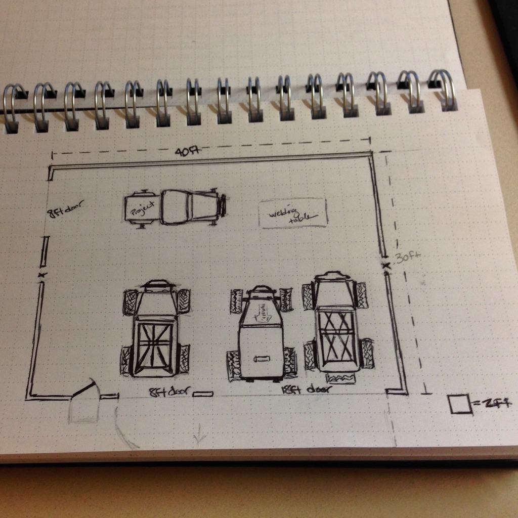

So it's been a while since I've updated this build. Lots of changes again. I sold my house and bought another one with the sole intention of building a nice shop in the backyard. Been in the house only 2 months and the garage is already well underway.
My initial rendering for idea and size purposes.
ai1024.photobucket.com_albums_y309_95builtjeep_gone_20postal_IMG_5432_zpscmdxe2ui.jpg

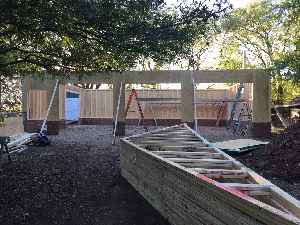

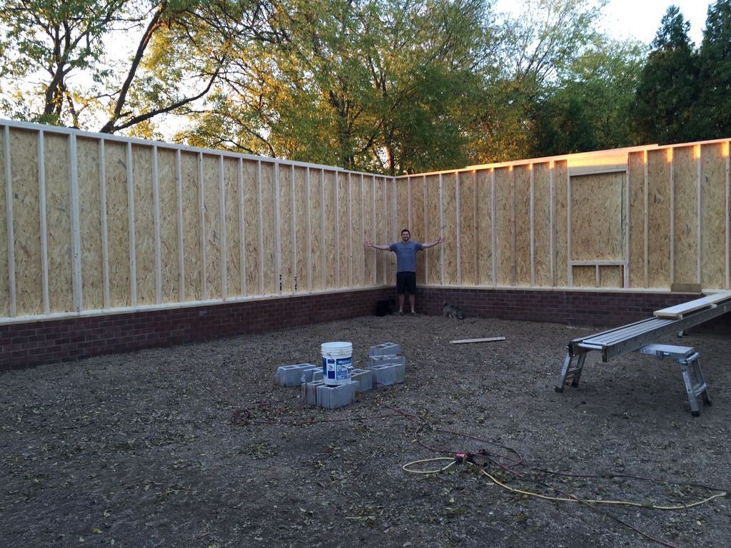

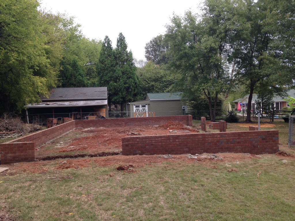

Some photos of the real deal. So happy it's all happening. I've been dreaming of a dedicated shop to build jeeps for a long time. I built the largest size I could build in my neighborhood (and largest I could afford). Plans are for 8ft tall doors (9ft wide) across the front. Tall enough ceilings to add a lift inside eventually. 220v wiring, lots of lighting and all of the other standard goodies as well.
ai1024.photobucket.com_albums_y309_95builtjeep_gone_20postal_IMG_0100_zpspqldytvx.jpg
The side garage door will be 9ft high just in case I have something larger than the 8ft doors can accommodate. I'll have a awning off the full back of the garage also for hiding "projects" from my neighbors. Haha!
ai1024.photobucket.com_albums_y309_95builtjeep_gone_20postal_IMG_0101_zpselin3nax.jpg
As for the postal. It's been busy getting the space ready for it's new home.

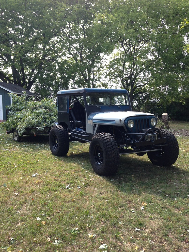

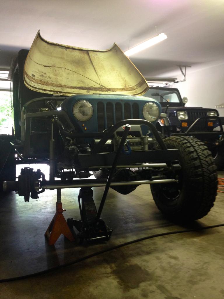

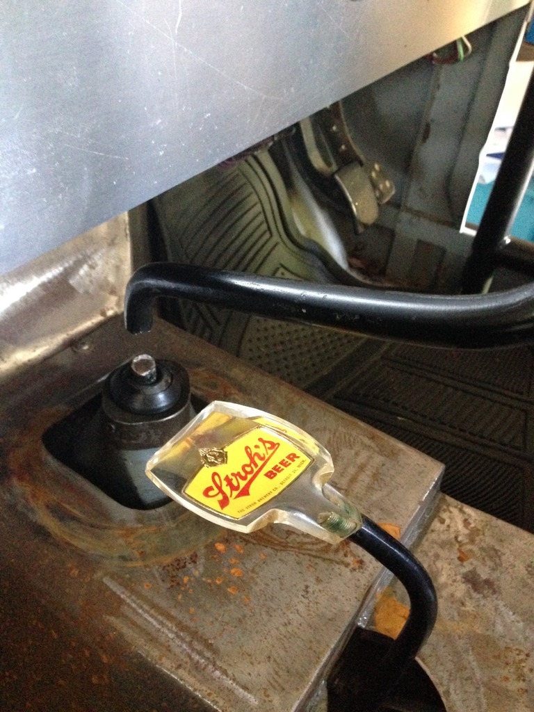

I did break the dang SM465 shifter in half while driving it around my yard hauling limbs from the tree I had to cut down to get the garage underway. I don't know how this happened. I told my gf, I must have Superman strength! HAHA! I'll weld it back together and it should be good to go another 30yrs I guess.
ai1024.photobucket.com_albums_y309_95builtjeep_gone_20postal_IMG_5493_zpsaxqwbqfu.jpg

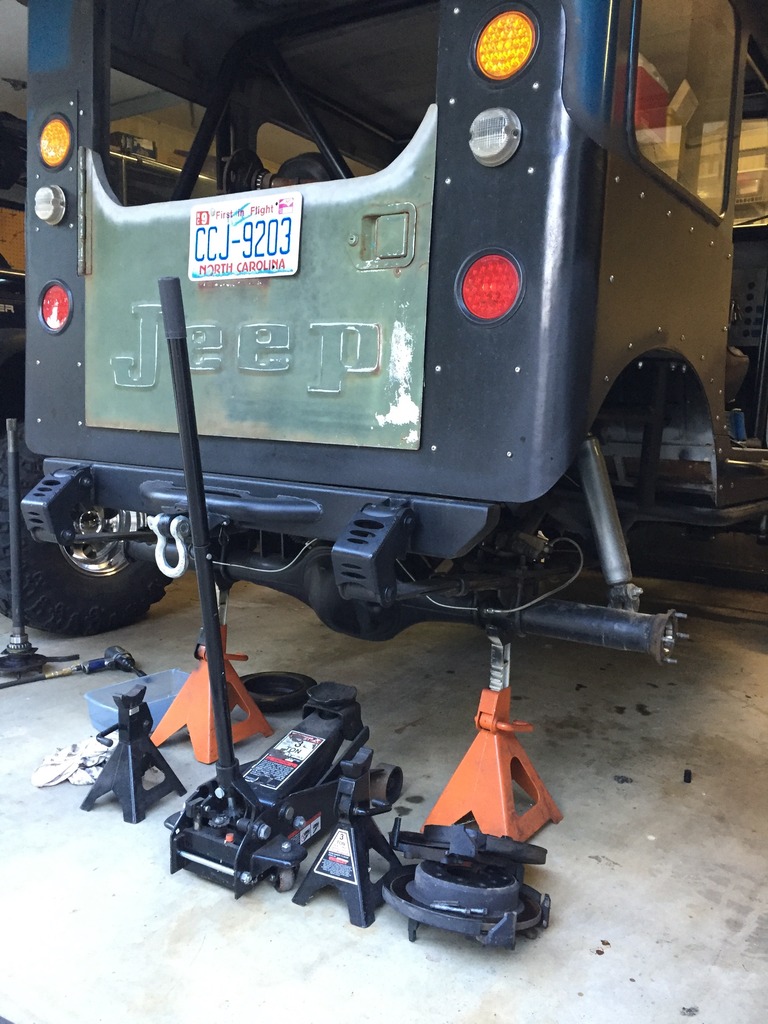

Busy weekend in the garage. Main focus was to tweak some things that I've been wanting to change for a while.

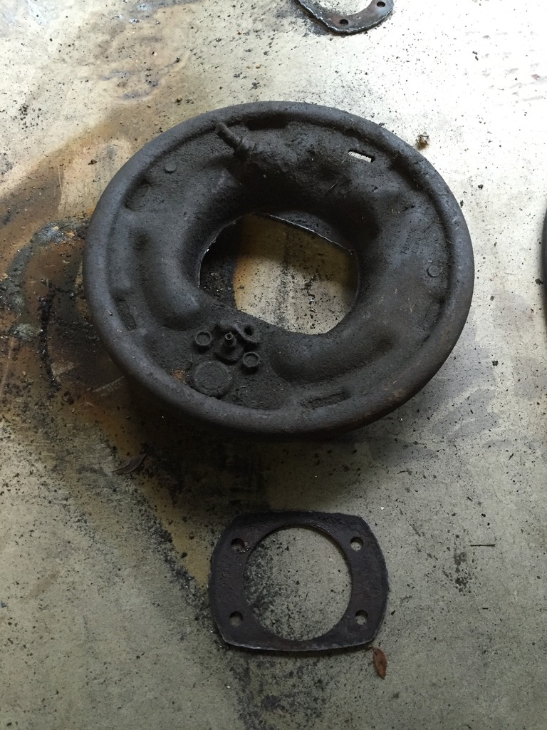

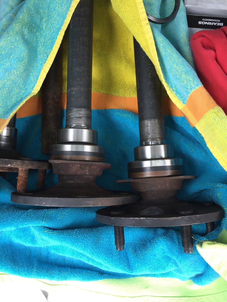

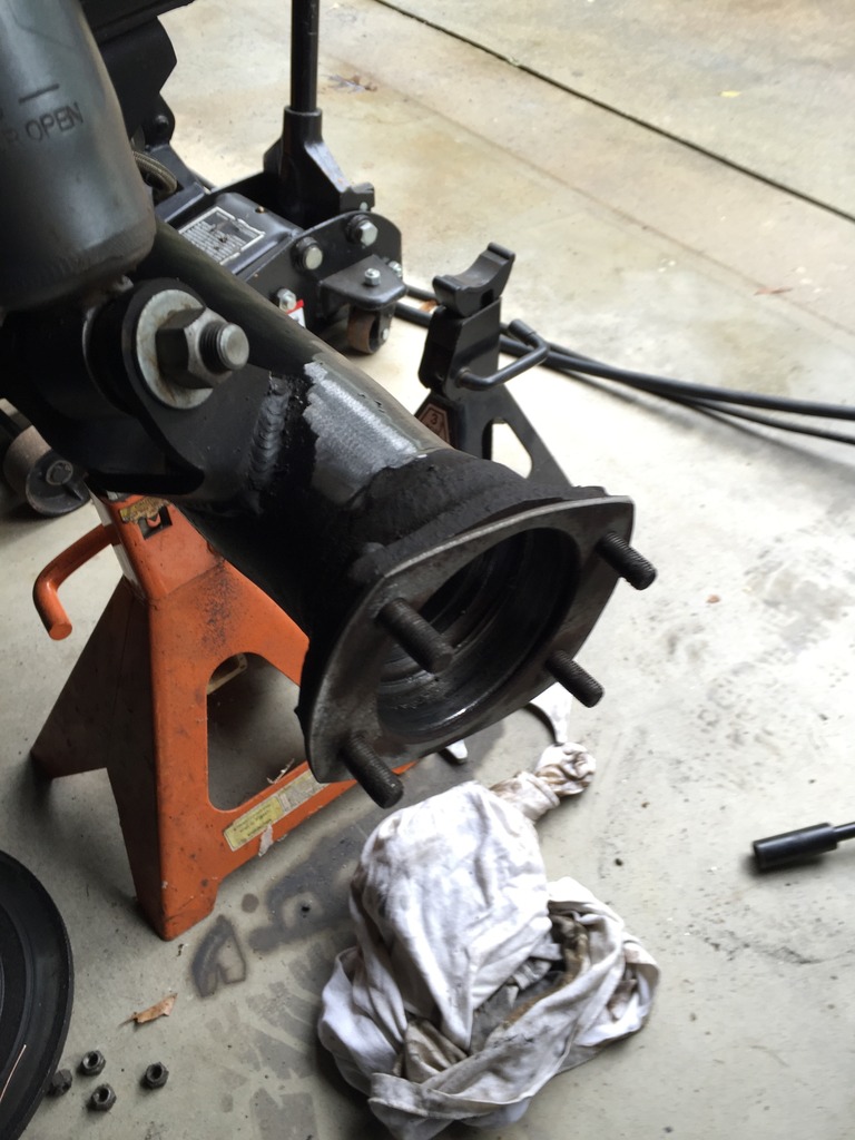

First was the brakes and leaky rear axle bearings.
New bearing and seal without those stupid Currie spacers that leaked so bad with my axle.
ai1024.photobucket.com_albums_y309_95builtjeep_gone_20postal_IMG_0173_zpshxvzsnkw.jpg
To use the correct spacing for the axle bearings and seals, I cut the center out of the original Ford " drum brake center so the spacing is exactly to factory spec.
ai1024.photobucket.com_albums_y309_95builtjeep_gone_20postal_IMG_0184_zpslhk2vz8g.jpg
Cut out drum brake spacer I make in place.
ai1024.photobucket.com_albums_y309_95builtjeep_gone_20postal_IMG_0186_zpsiartj2yj.jpg

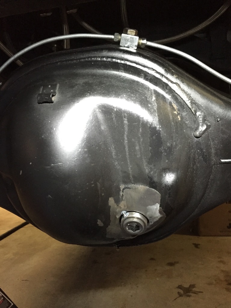

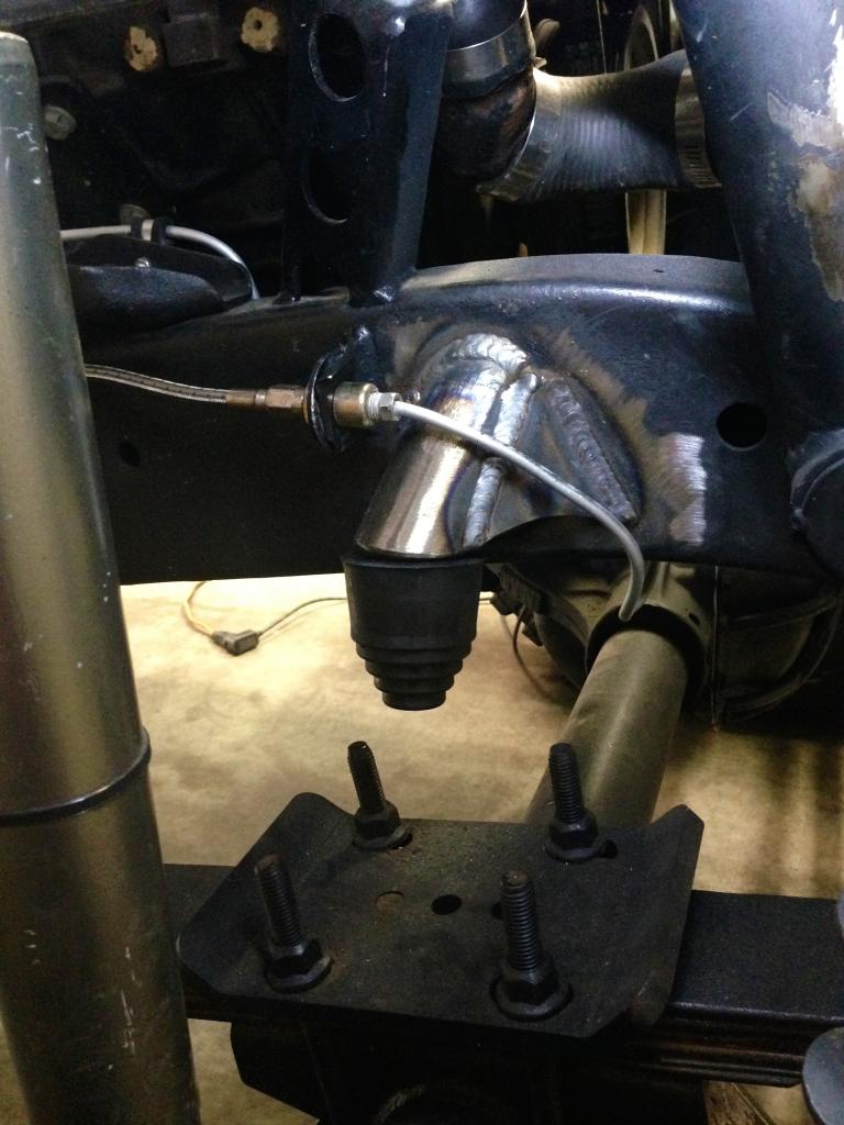

Also wanted to make the axle serviceable without removing the third member so I welded in a drain plug.
ai1024.photobucket.com_albums_y309_95builtjeep_gone_20postal_IMG_0190_zpsalhkwgtt.jpg

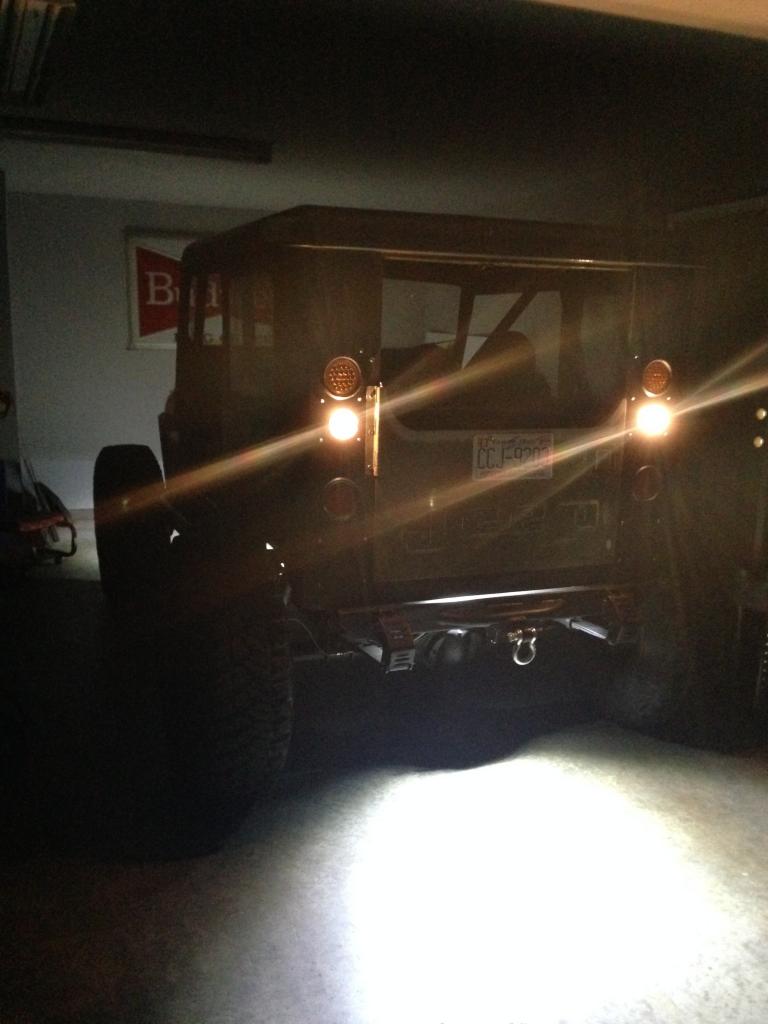

Added some more LED rock lights for night wheelin'. Simply because everyone knows night wheelin' is the best! These are little 3M 3 LED pods that I placed in every wheel well and in front of the rear tire.

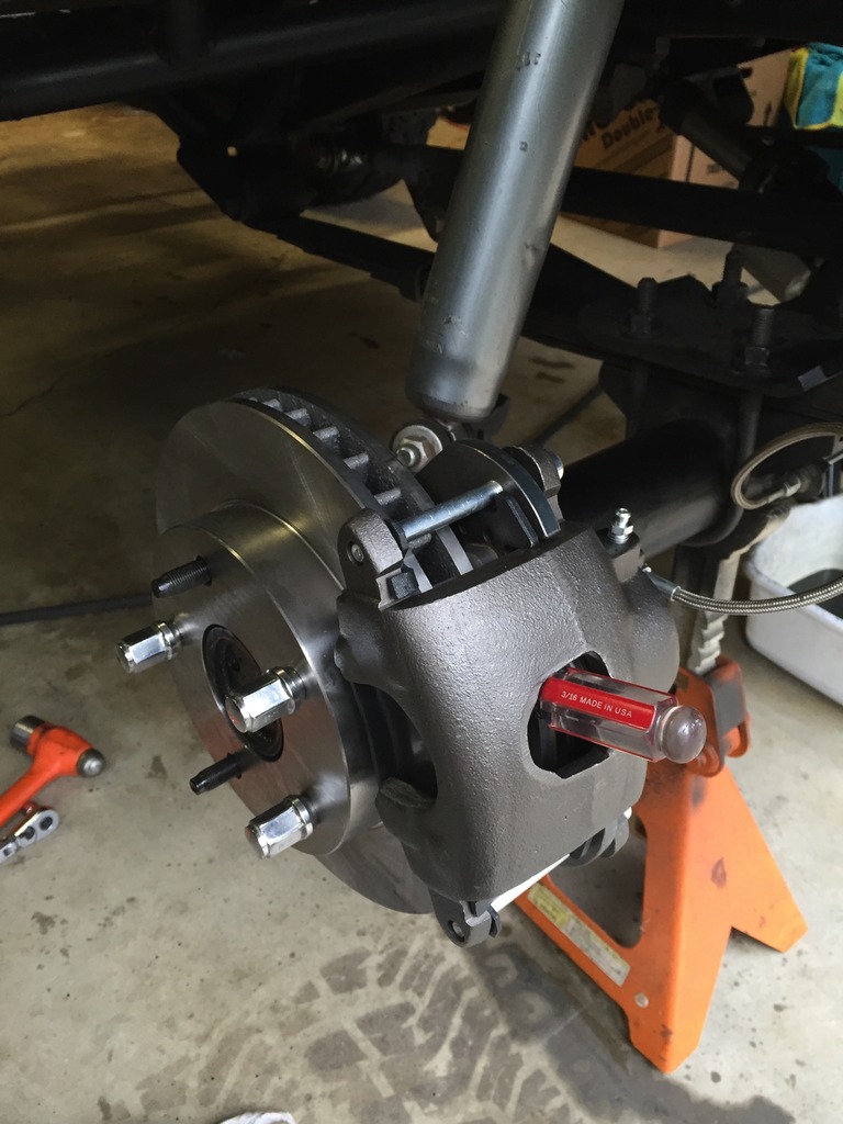

Finally got the rear brakes mocked up. This was a '97 Dodge Ram rear rotor (for 12" rotor with 5 on 5.5 wheel), K10 Front 4wd truck caliper and pads, on a Ruffstuff weld-on brake caliper bracket. Their bracket needed lots of tweaking to make it work but after a few hours of fitment, it fits tight like it should.

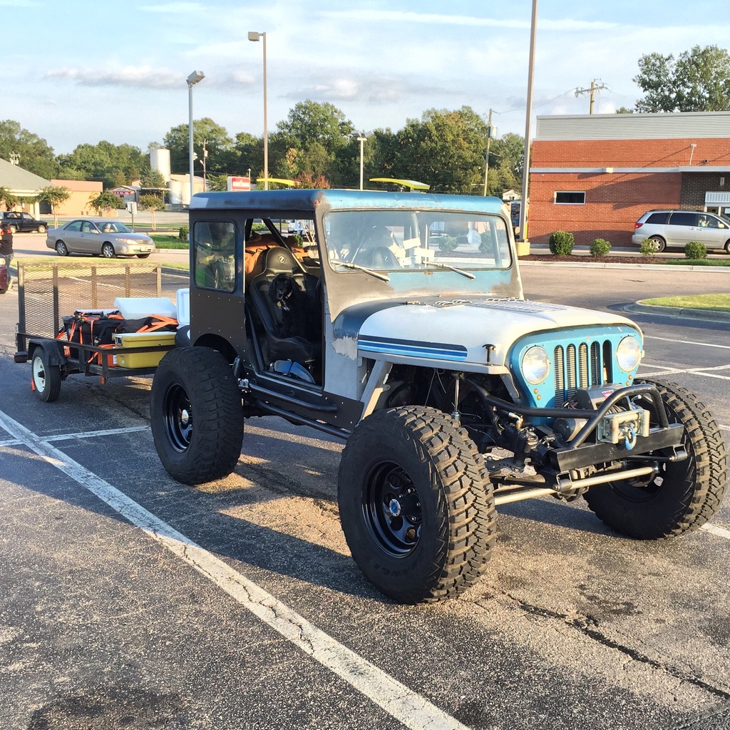

Getting groceries on the way to URE. Haha!
ai1024.photobucket.com_albums_y309_95builtjeep_gone_20postal_IMG_0256_zpspk52snjv.jpg

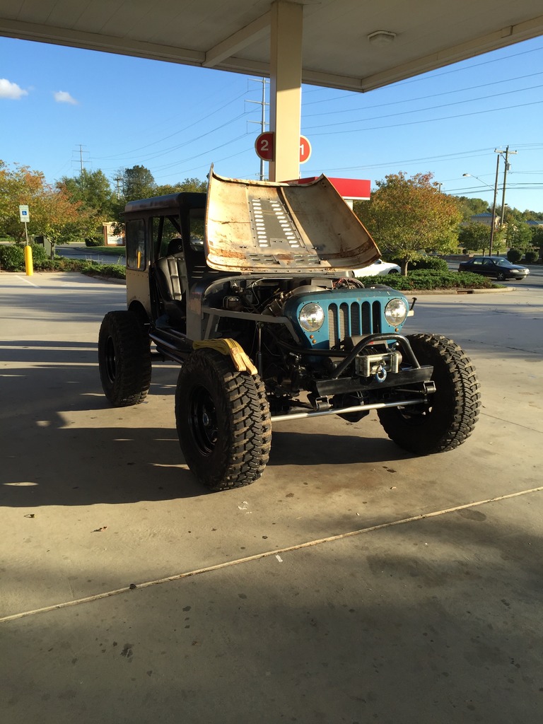

Then got all the way home, cleaned the jeep, took it to the gas station and it broke down. Looks like junk in the gas tank got into the fuel filter.
ai1024.photobucket.com_albums_y309_95builtjeep_gone_20postal_IMG_0295_zps2v4tuf28.jpg

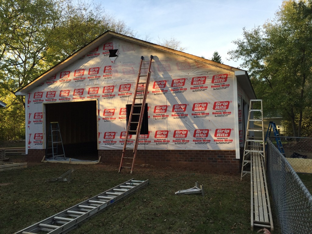

Then onto some updated garage shots. It's almost ready for me to move into it.
ai1024.photobucket.com_albums_y309_95builtjeep_gone_20postal_IMG_0317_zpsw8cf8mwt.jpg
ai1024.photobucket.com_albums_y309_95builtjeep_gone_20postal_IMG_0327_zpsdkkzqo8z.jpg

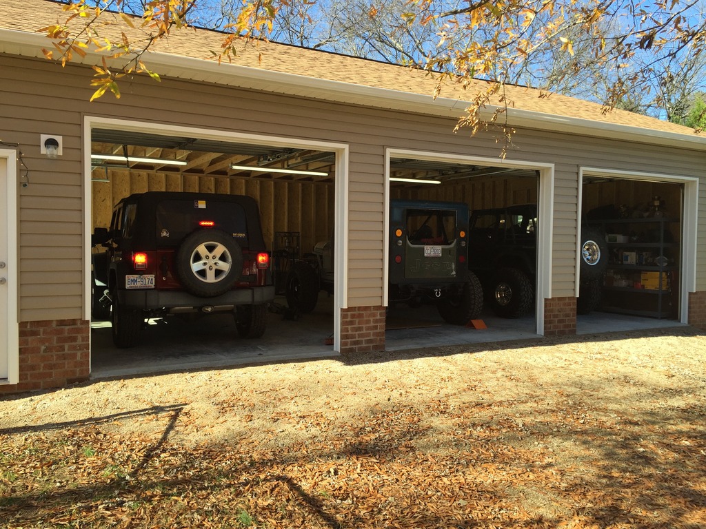

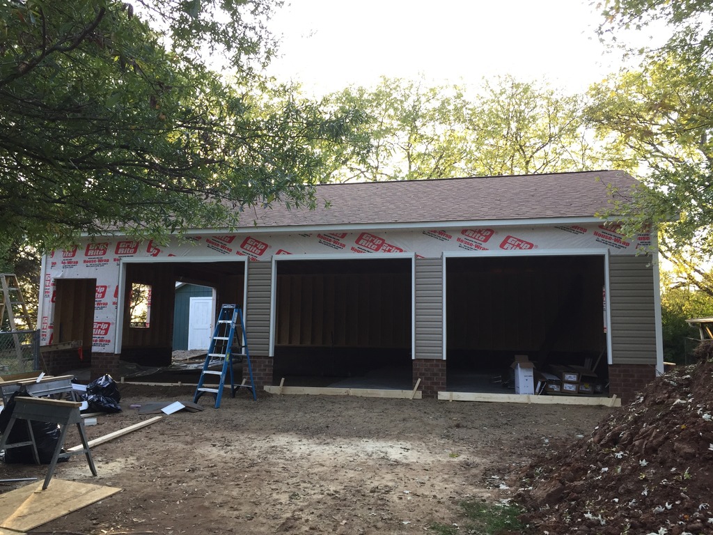

Front. It's actually fully sided now w/ all of the garage doors hung. Just haven't taken an updated photo.
ai1024.photobucket.com_albums_y309_95builtjeep_gone_20postal_IMG_0405_zpsbzvnx3yr.jpg

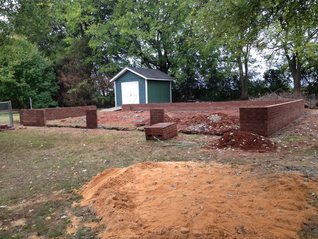

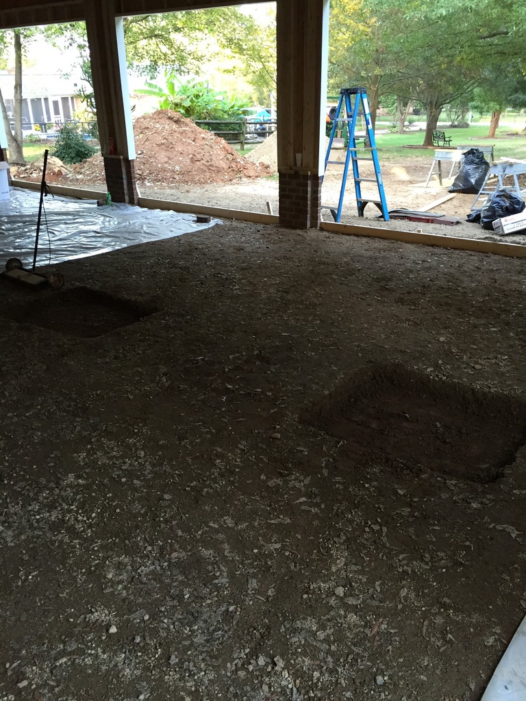

Footers for an eventual car lift.
ai1024.photobucket.com_albums_y309_95builtjeep_gone_20postal_IMG_0411_zps6vmxerip.jpg

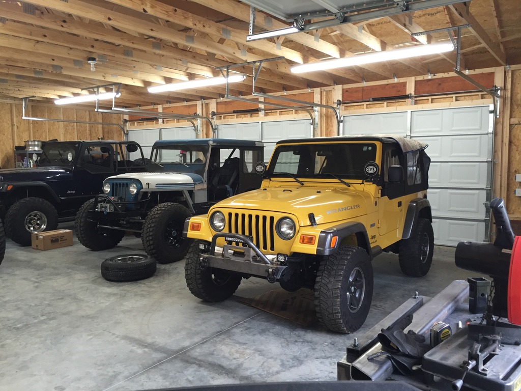

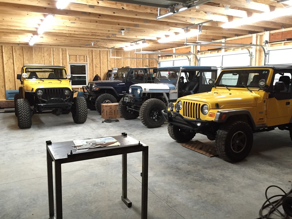

Just a photo I put up on Instagram the other day of the transformation. :beer: Still a lot to do but it's cool to see a before and after.
ai1024.photobucket.com_albums_y309_95builtjeep_gone_20postal_IMG_1093_zpsptt6q8ml.jpg
No real work on my postal. My garage is done to the point of utilizing it so I've been working on some other projects.
I just finished fabbing this cage for a buddy's TJ. We will be adding a harness bar behind the seats and seat mounts next. The basic cage construction is done though. All 1.75" DOM .120" wall tubing. main side A-C pillar tubes are one piece of tube per side, no splicing anywhere on this one. Simple and strong.
ai1024.photobucket.com_albums_y309_95builtjeep_b8bea5f6_47a7_4ebf_9a53_079c86c8b87d_zpsavjn2wqc.jpg
Hey Bruiser, here you go. Here are some more photos of my new garage. I still plan to add more wiring, additional overhead lights, additional 220v receptacles throughout the shop and some more outside lighting. It's to the point of "usable" so I'm taking full advantage!
ai1024.photobucket.com_albums_y309_95builtjeep_gone_20postal_IMG_1053_zpsd8mpizei.jpg
ai1024.photobucket.com_albums_y309_95builtjeep_gone_20postal_IMG_1058_zpsaehl4p7l.jpg
ai1024.photobucket.com_albums_y309_95builtjeep_gone_20postal_IMG_1234_zpsclihtns1.jpg
