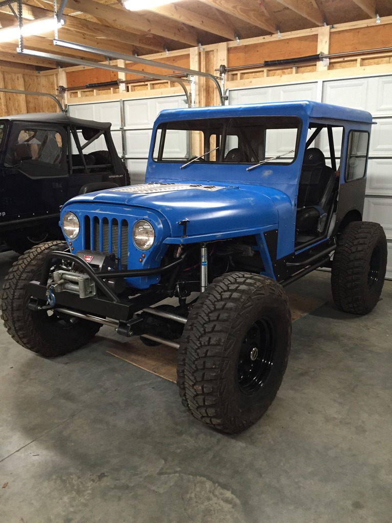

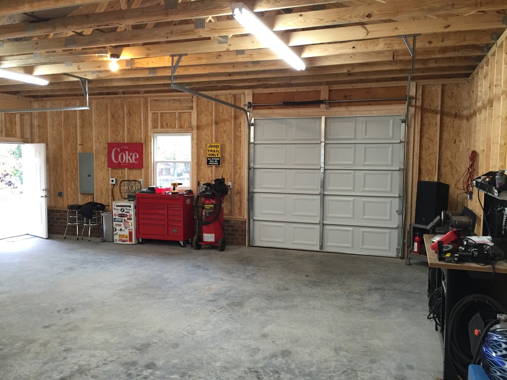

One more. Here is the other wall that isn't pictured above. I added the 4th garage door on the side. Best decision ever!

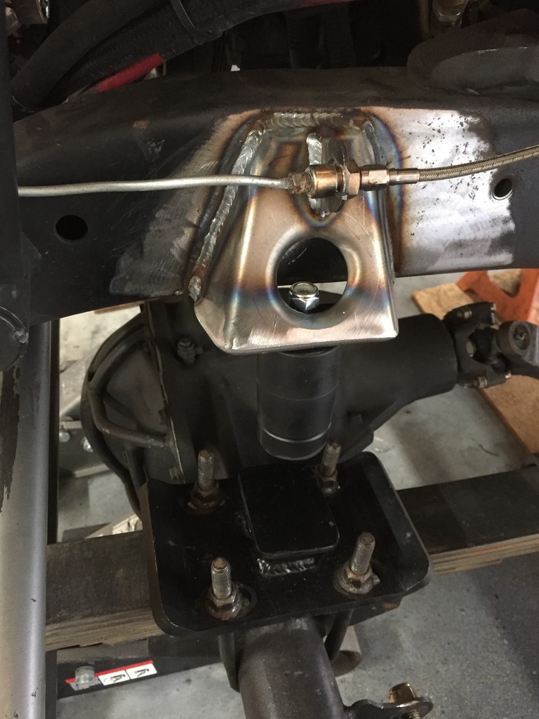

Did a few things to my postal before the first URE trip of the year. I cut the old bump stop mounts off and I made some new ones.

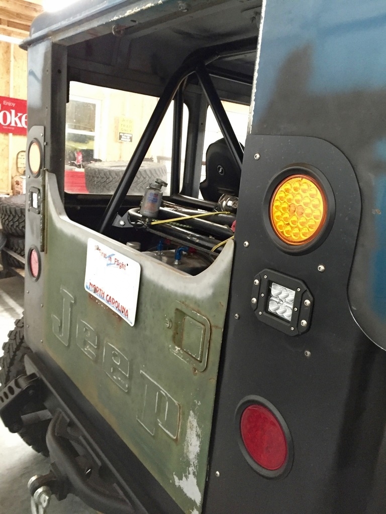

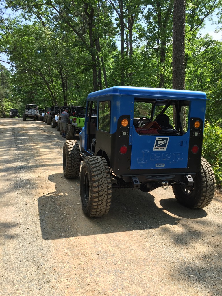

I did add some LED light pods for my reverse lights. They are stupid bright so I should probably build a mount to angle them downward so they don't blind anyone behind me on the trail.
ai1024.photobucket.com_albums_y309_95builtjeep_gone_20postal_284db703fb6845d4ad9954e486dc87f8e.jpg

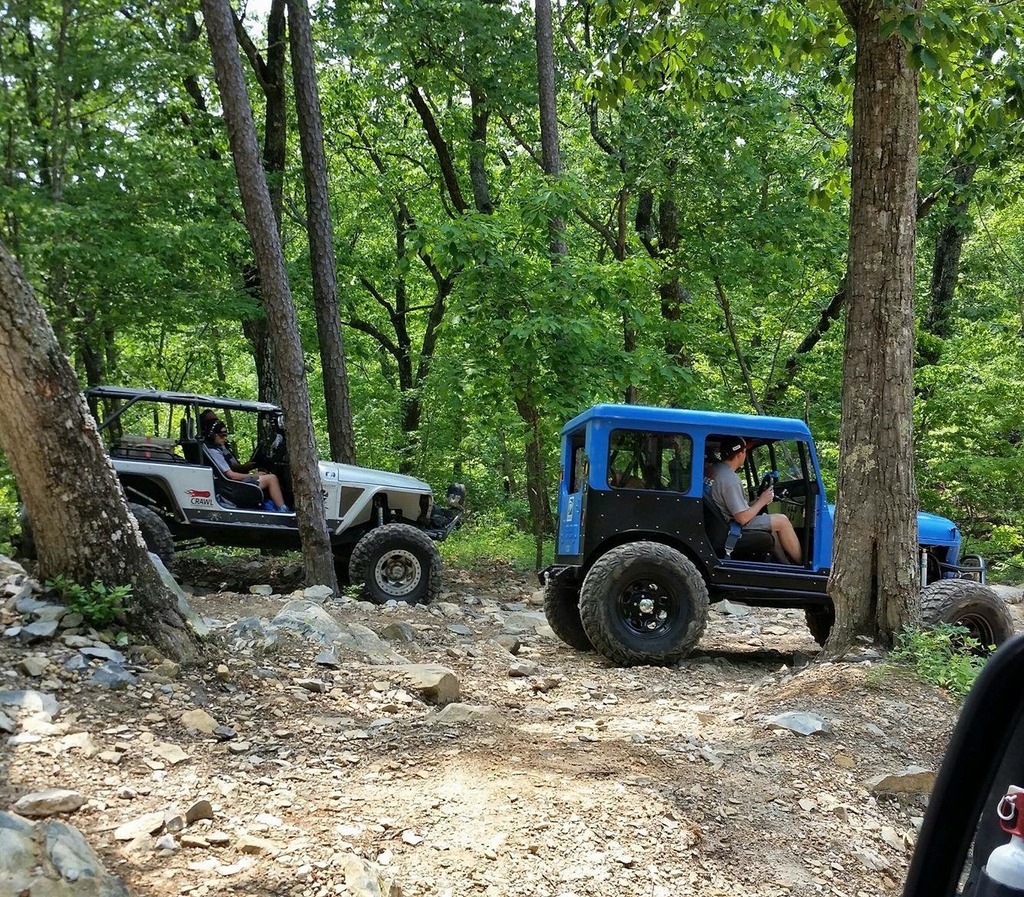

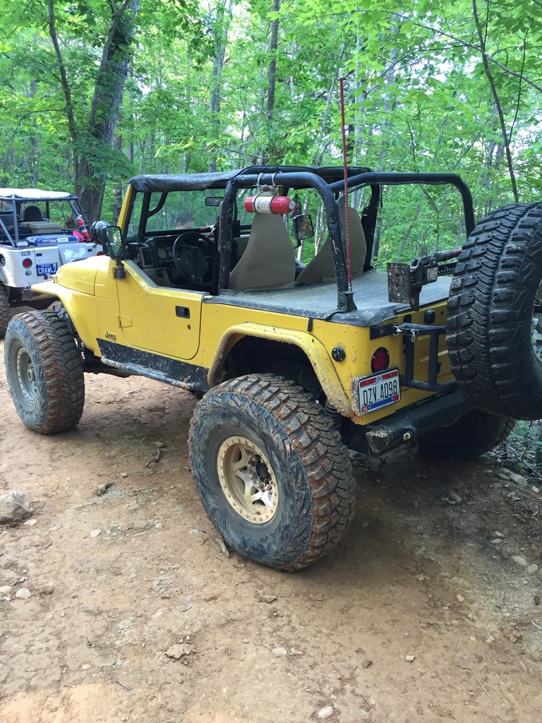

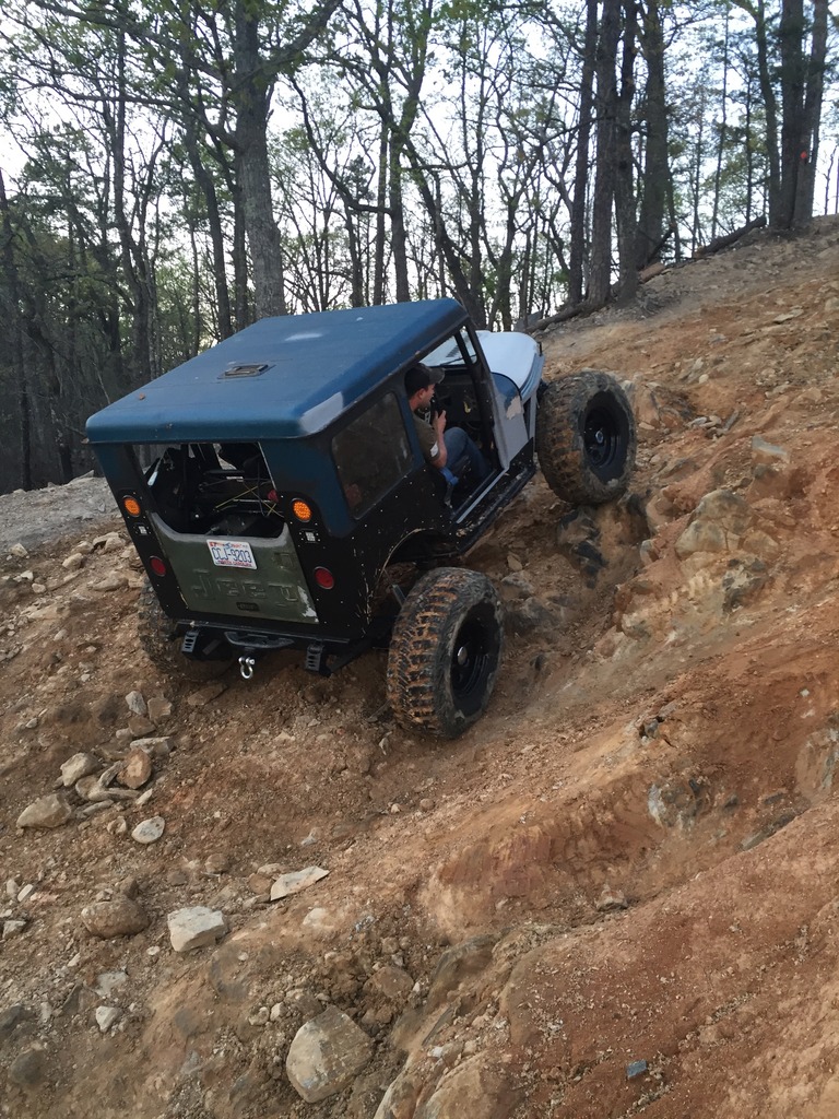

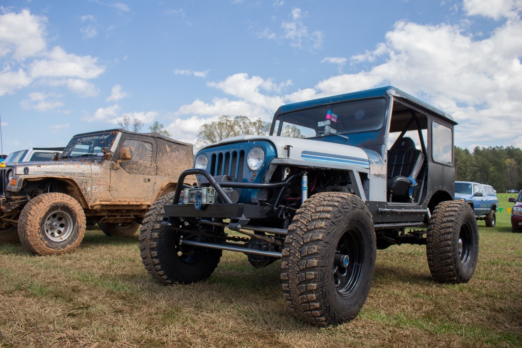

Only photo I got wheeling'.
ai1024.photobucket.com_albums_y309_95builtjeep_gone_20postal_IMG_2279_zpsaxtmyu6e.jpg

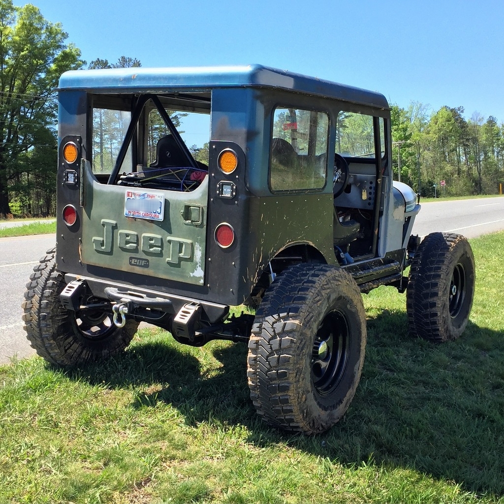

My rear driveshaft blew on my ride home. I think I am in need of some changes for my rear axle. I'm thinking of swapping to a Dana 60 rear for a not-so-dramatic rear driveshaft angle.
ai1024.photobucket.com_albums_y309_95builtjeep_gone_20postal_IMG_2286_zpsn4njdgvn.jpg

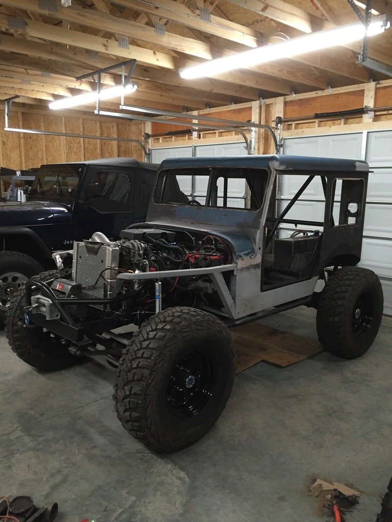

AND the BIG news! I'm painting my postal. Here is some prep work...

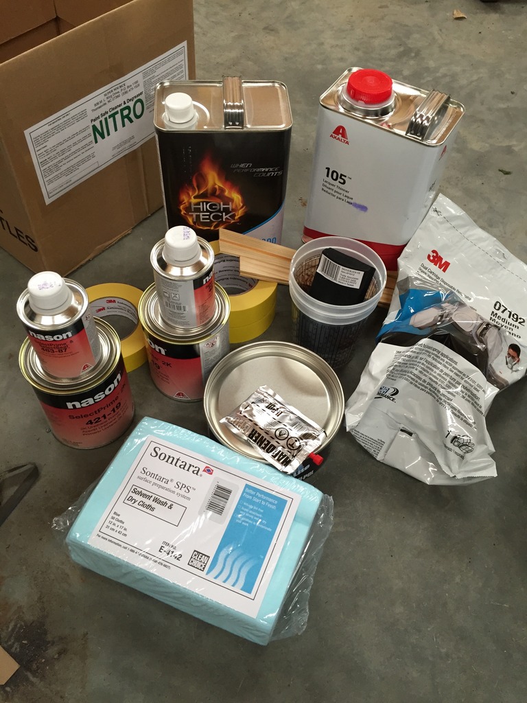

Initial paint supplies!

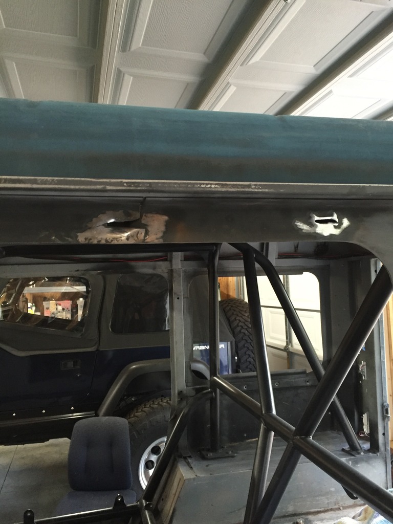

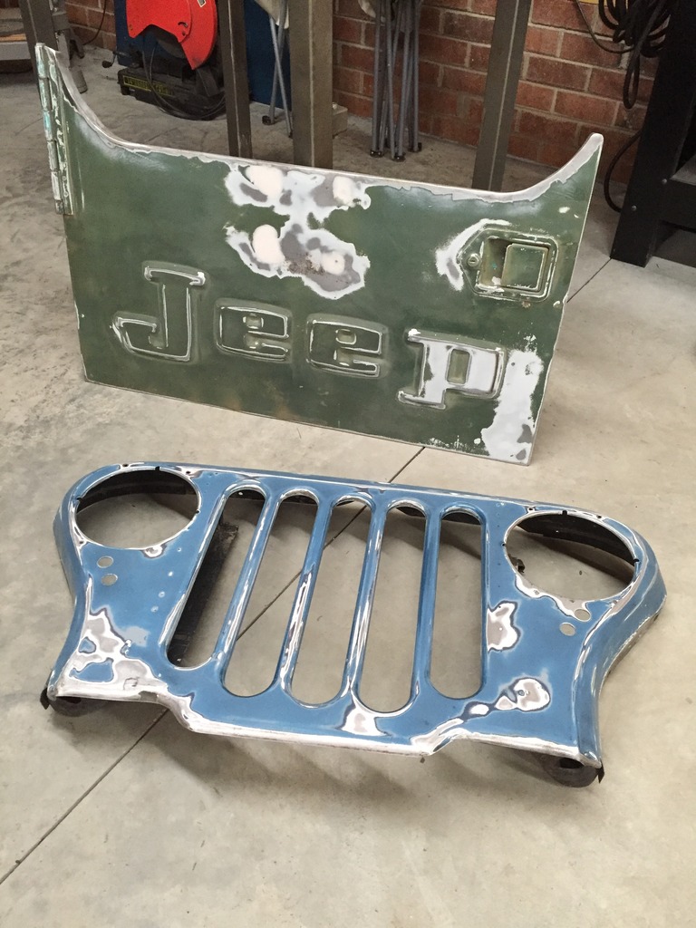

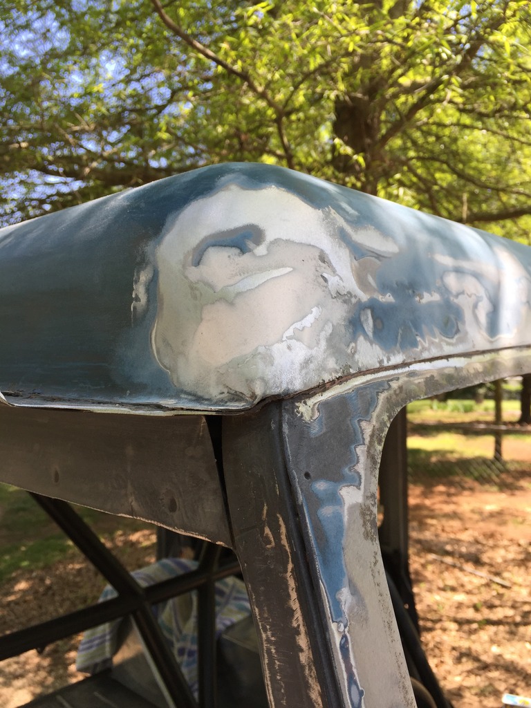

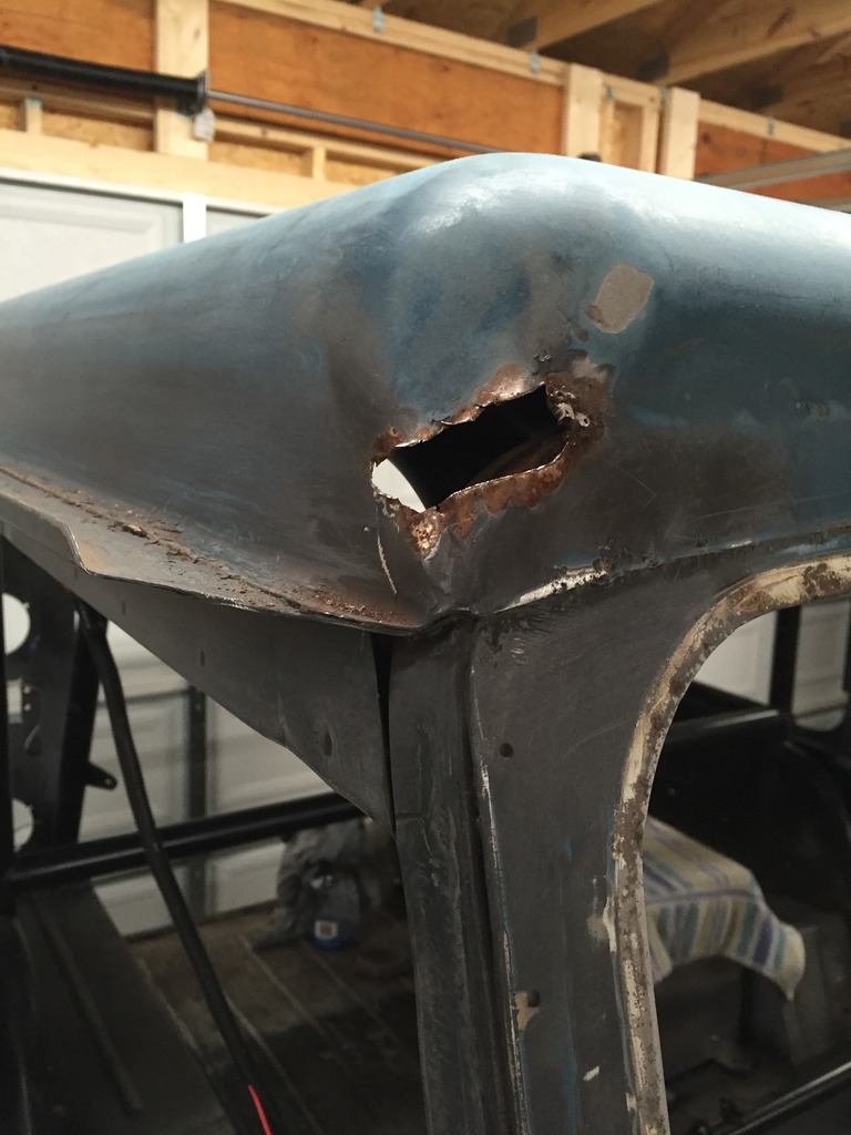

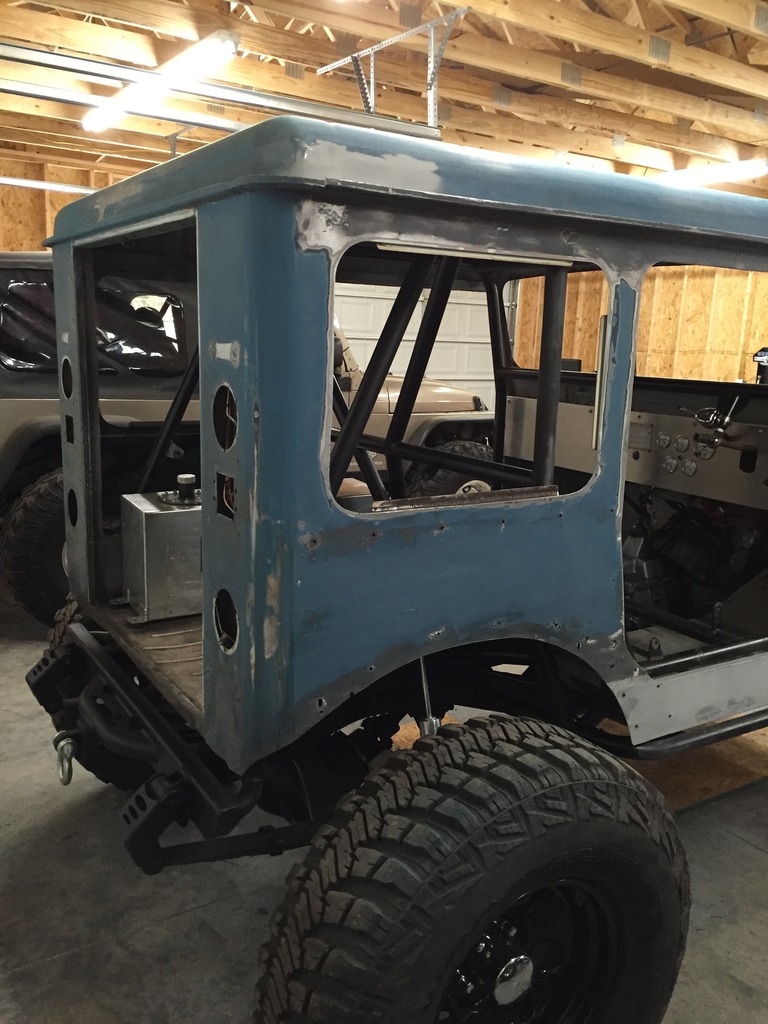

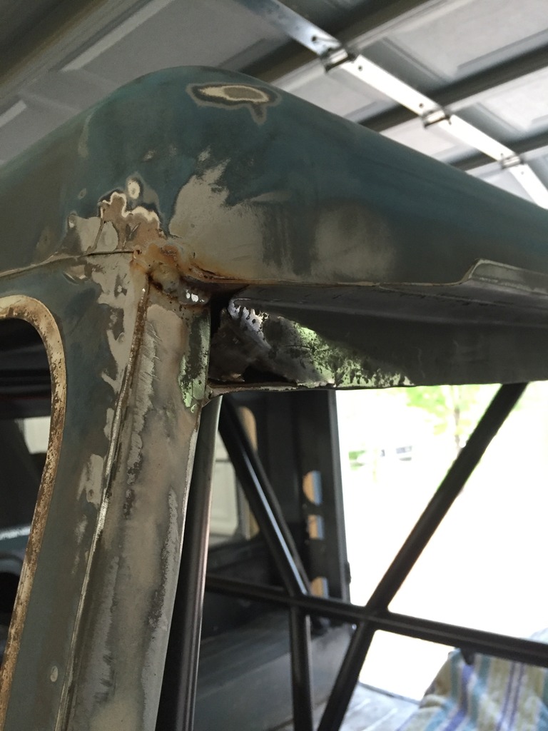

Rust repair needed in numerous spots. I opened up the areas more so I could be sure to replace the rotten material and have solid metal to weld to. Some of the areas were extremely thin around the roof/windshield and side door overhead openings.

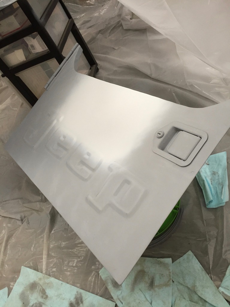

Sanded the body and hood/grille/tailgate and filled holes where needed so all the lines were smooth.

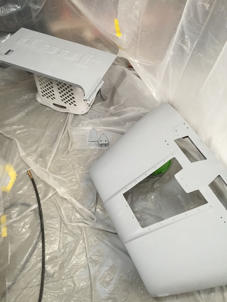

Primer.

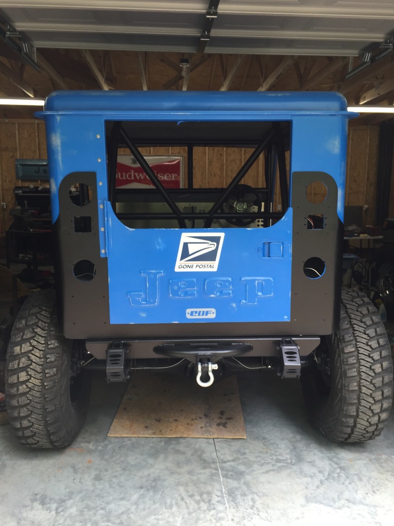

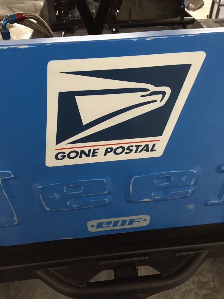

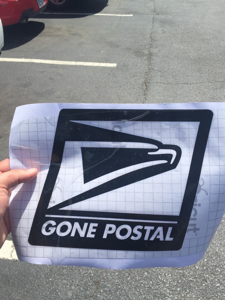

I custom designed a new logo for the tailgate and my buddy, Mitch, got it cut out for me.
ai1024.photobucket.com_albums_y309_95builtjeep_gone_20postal_IMG_2551_zpsmdbcpdoo.jpg

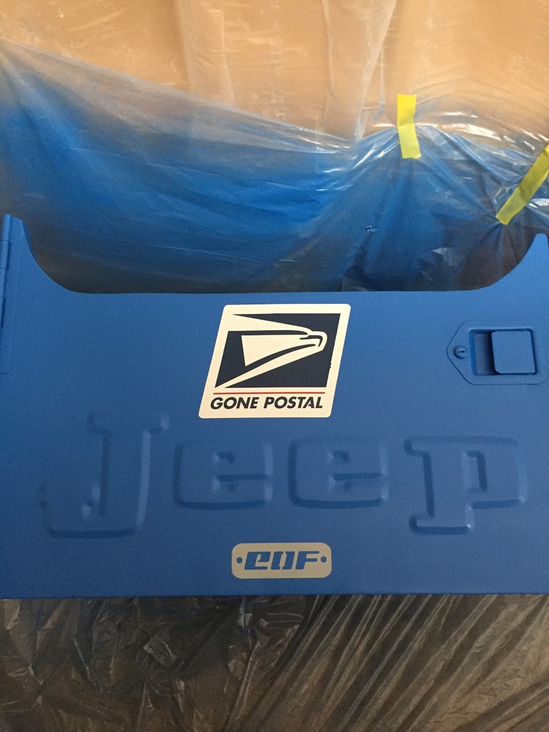

For the decal, I did an inverted layout so I could lay down the white paint first for the logo background, then put the decal on, and paint the detail colors in the middle. Time consuming, but well worth the extra time so the decal is painted and clear coated into the jeep paint. Extra pimp hat needed!
ai1024.photobucket.com_albums_y309_95builtjeep_gone_20postal_IMG_2561_zpsmcw4bpnm.jpg

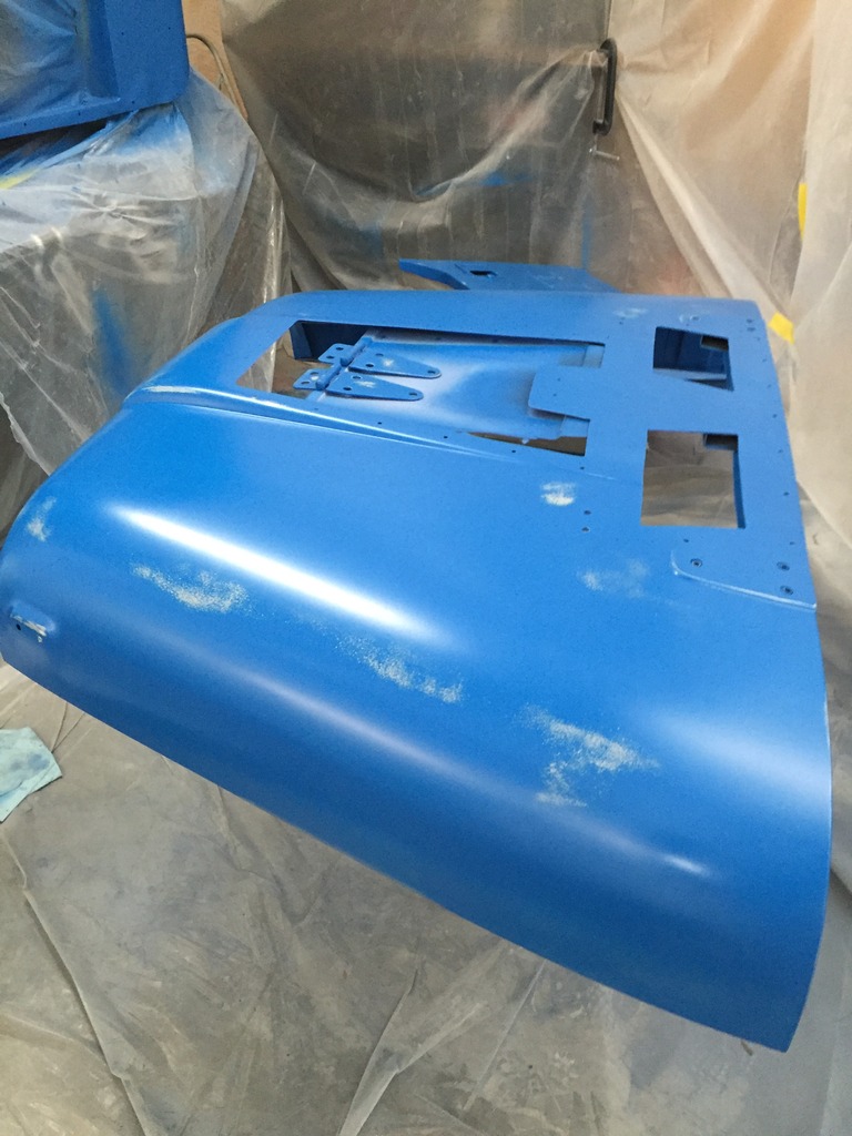

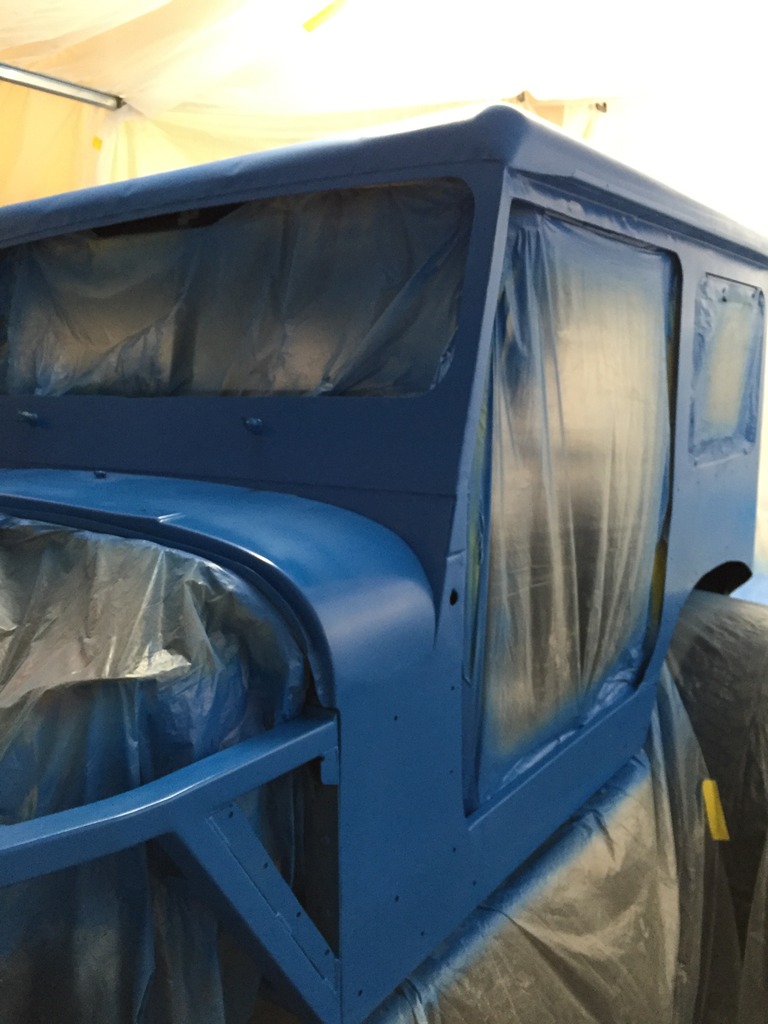

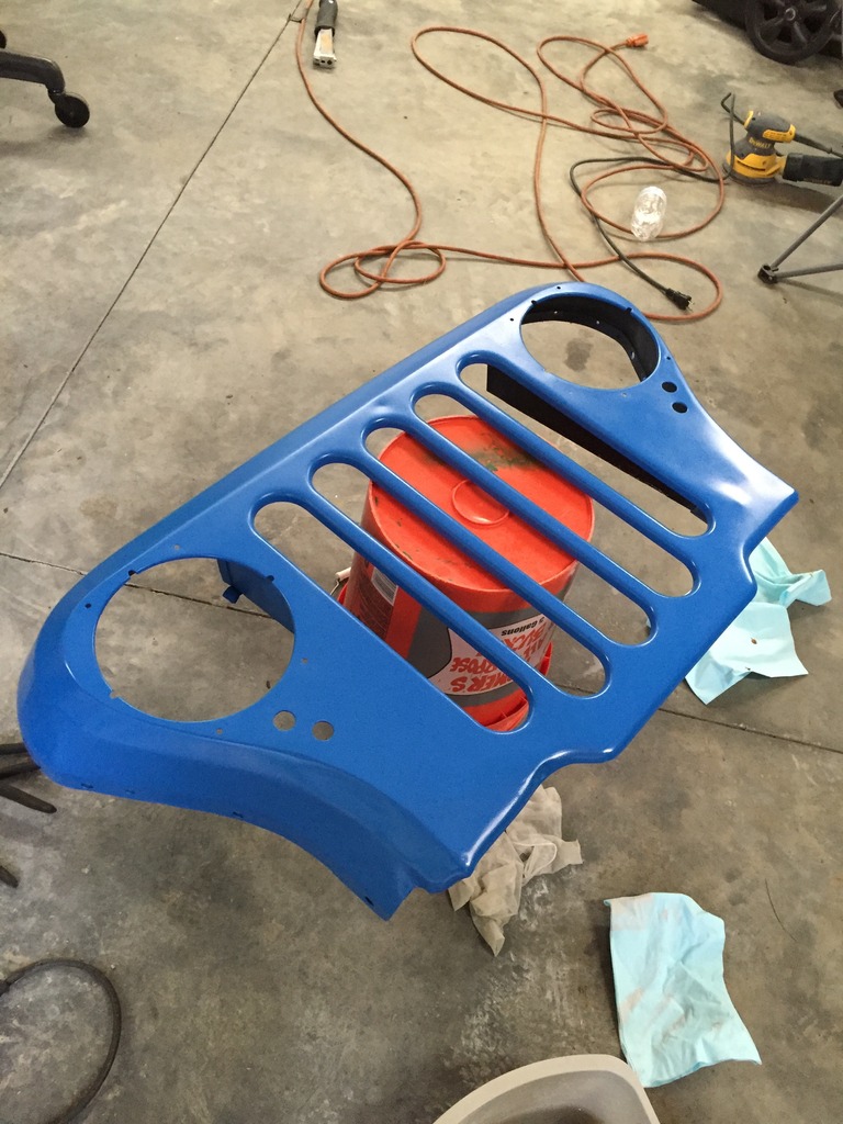

Initial fresh blue color.
ai1024.photobucket.com_albums_y309_95builtjeep_gone_20postal_IMG_2564_zps8p7f0d58.jpg
Decal painted! And "EOF" is my logo for anything I build (Edmonson Offroad Fab). Having a logo elevates your fab/skill level, right?! Haha!

Fresh blue.

The blue was so fresh, I sanded all the color off of the parts and body. I wanted an older "patina'd" look so I wanted it to not look new. This was all prepped and ready for clear coat.

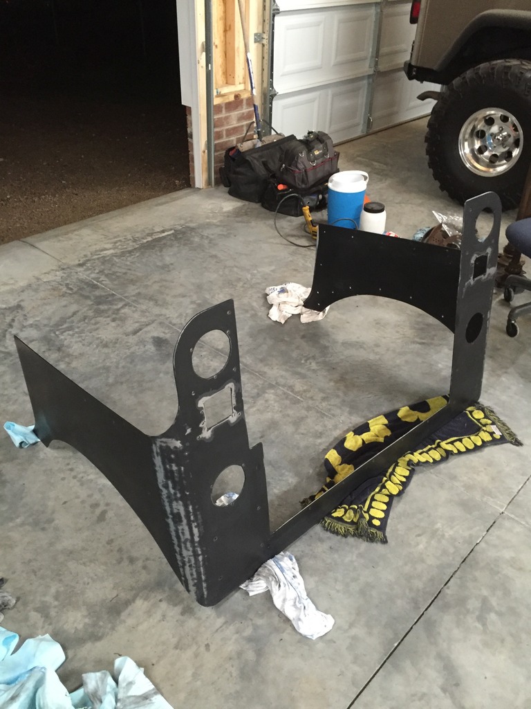

Body armor also sanded and prepped for fresh black paint.
ai1024.photobucket.com_albums_y309_95builtjeep_gone_20postal_IMG_2581_zpsllix7uox.jpg

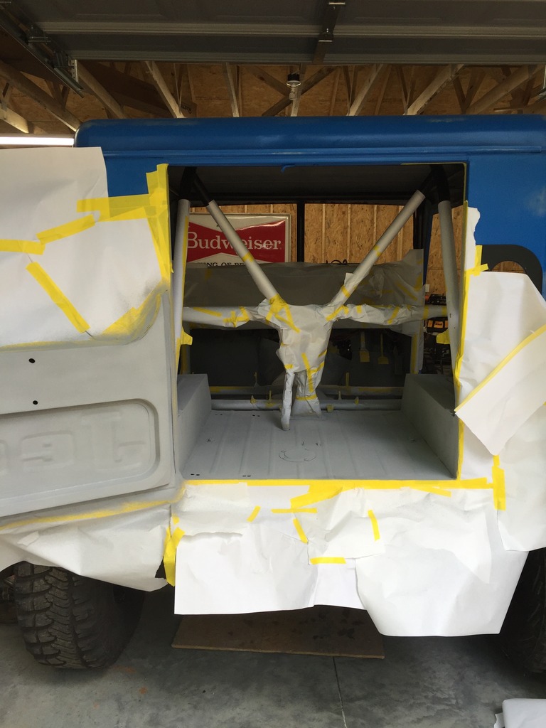

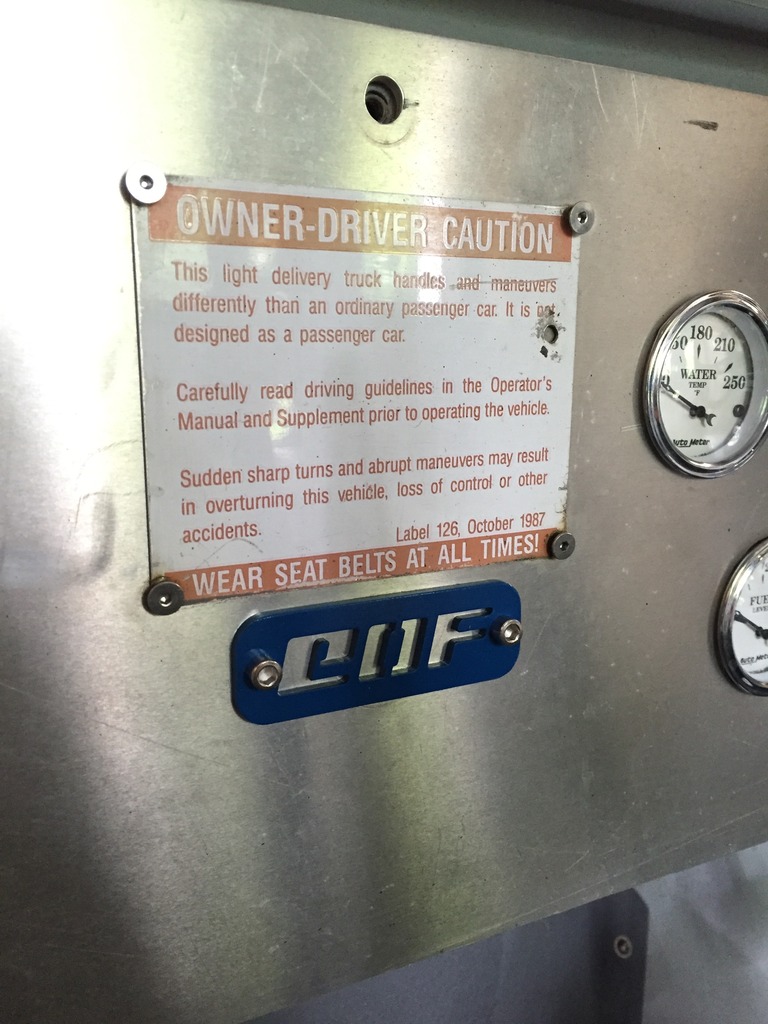

Once the paint was done, I taped it all off and sprayed LizardSkin on the interior to help with heat on the floorboards and the transmission tunnel.
ai1024.photobucket.com_albums_y309_95builtjeep_gone_20postal_IMG_2608_zps9exoj8ty.jpg

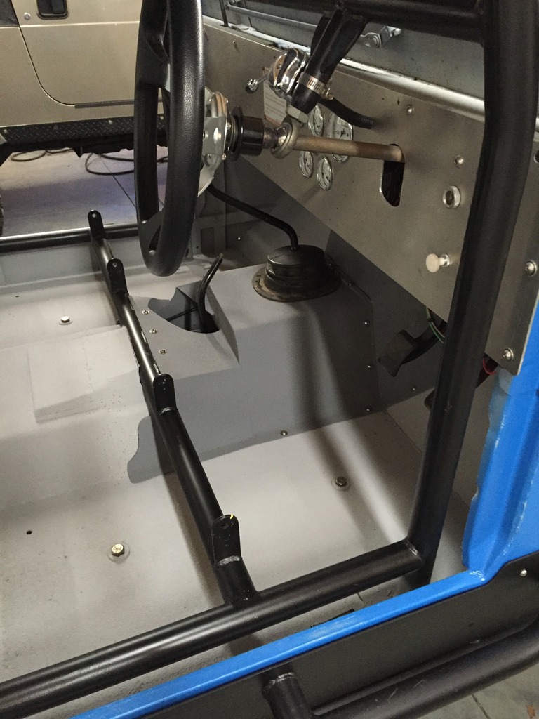

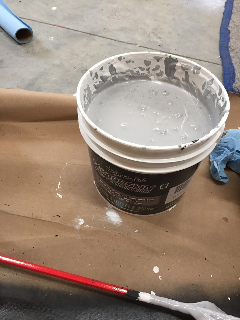

And again, thinking of keeping the original look and feel, I custom mixed my own color of Lizardskin using their white and black base material. I wanted a primer grey look. Finished product.
ai1024.photobucket.com_albums_y309_95builtjeep_gone_20postal_IMG_2611_zpsceeo0ql6.jpg

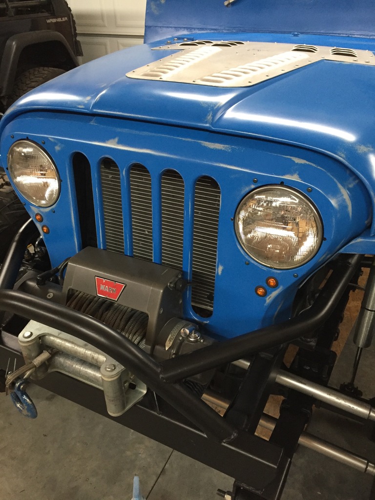

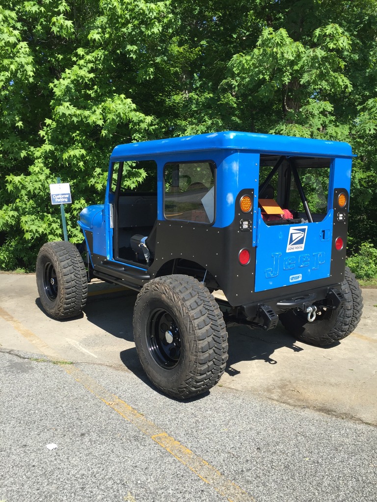

Front end painted and put back together.
ai1024.photobucket.com_albums_y309_95builtjeep_gone_20postal_IMG_2623_zpslrcr8hdu.jpg
Ready for URE.

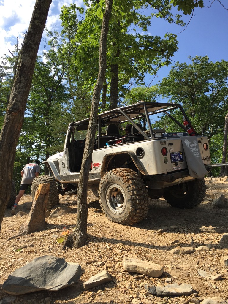

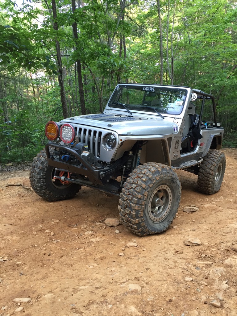

I even got to drive John Herrick's Crawl Mag project "Long John Silver LJ" on the trails. What an incredibly built jeep! #lifegoals
ai1024.photobucket.com_albums_y309_95builtjeep_gone_20postal_IMG_2707_zps2xtrm9k5.jpg

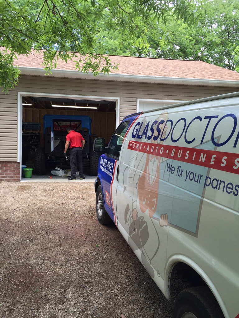

My buddy, Mike, who helped me with the engine wiring installed the new windshield for me.

Unclose of the custom painted on graphics I painted. I designed the logo and made it in Adobe Illustrator. Then my buddy, Mitch, had it cut out for me. I'm very happy with this part of the paint job! The best part is that a lot of people who have seen the paint finished, didn't realize the text said "Gone Postal" instead of "United States Postal Service".

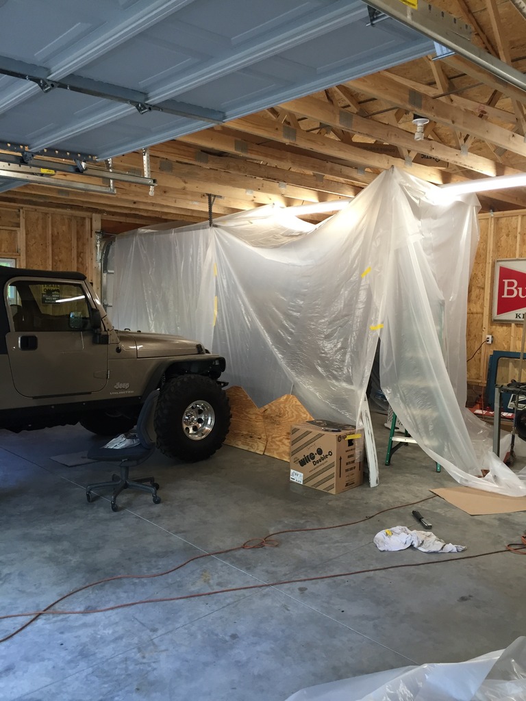

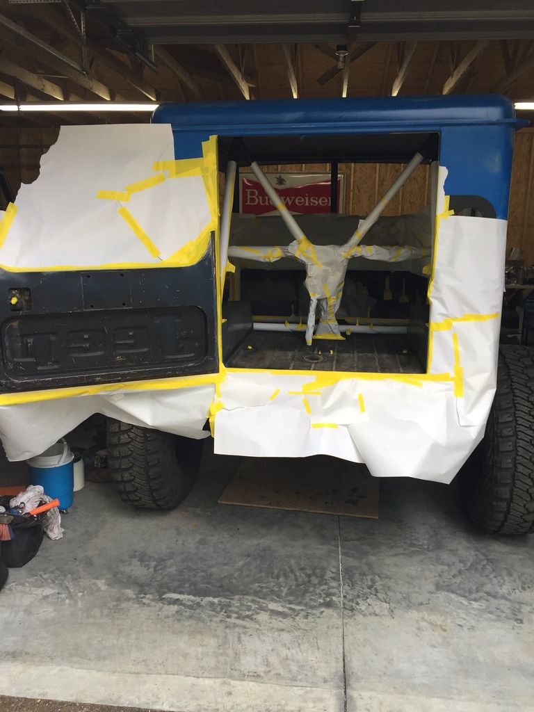

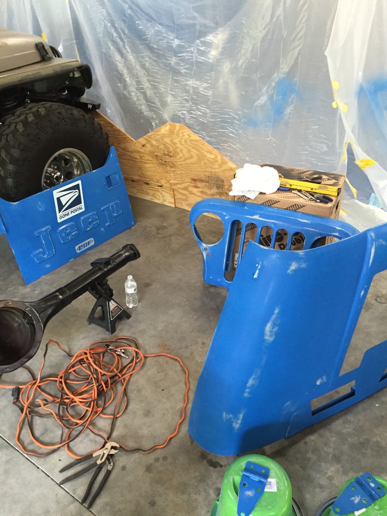

And lastly, what my garage looked like with my "custom" paint booth. It looked like I was going to murder some people!
ai1024.photobucket.com_albums_y309_95builtjeep_gone_20postal_IMG_2524_zpslo7fkqxc.jpg
