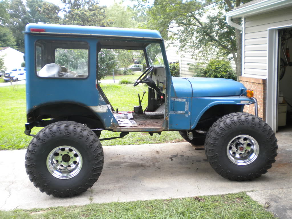

A dauntless v6 w a ford t-18/eb dana20 would be a sweet drivetrain swap for it. Provided the ford trans would work behind the dauntless.
I like this thing, but I fail to see why it needs to be higher. Looks like you have plenty of room for rear uptravel and if you just do tube fenders in the front or trim the ones you have, there's room in the front for 2-4" uptravel. Should be plenty, just bump stop it. Its got a nice stance now , id like to see you keep it there. Remember too, its gonna have some body roll w those springs in so close. Combine that with a torquey new engine and a couple inches more height, could end up tippy, or atleast have a pucker factor. The axle width is helping you a lot, but...
Check your front shackle angle too, those springs are flat or as long as they'll ever be through the suspension cycle. If its not too late, I might would cheat the shackle hangers forward a bit. Especially if you do go to a lift spring.
Definitely agree with you.
Another thing, you flap disked and cleaned up the shackle hangers so well, but you didn't close off the gussets on the DOM?
I also keep my rear up another 1" than the front to account for the weight of trailer gear, parts, tools, ect.
Just my $.02

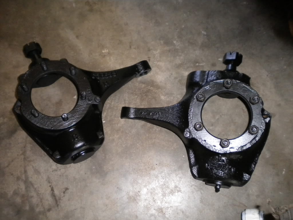

i've decided i am going to do right hand drive. i'm thinking i could do a psc single ended ram that is attached from the axle tube to 1 high steer arm then a tie rod that connects the 2 knuckles. it will be like a crossover steering setup but without a standard steering box connecting to a draglink. OR i can try to locate a yj or tj right hand drive power steering box and go that route. i'll go with whatever i find. what do you guys think? is hydraulic steering okay for the road? if hydro doesn't work i'll contact a mail jeep conversion company and buy a steering box for a wrangler.

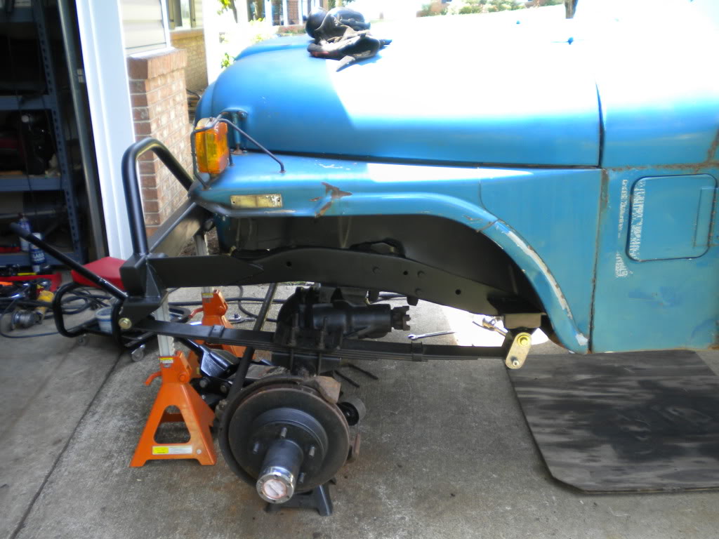

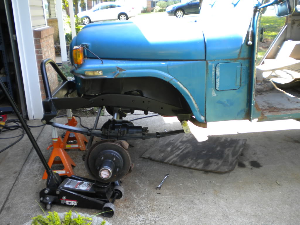

front spring / shackle solution.
i am going to use a wagoneer front 5 leaf spring from a 74-92 wagoneer or j-10. the measurements are 24.5" & 22.5" instead of the 22.5" & 22.5" like i have up front now. it will give me a little stronger spring so it doesn't go to a negative arch at its resting weight and will have enough strength to support a heavier drivetrain that i'll be running. the stock 5 leaf spring is rated for 960lb instead of ~840lb. the 2" offset spring will also get my shackle angle to the desired angle. lets hope it works out like i think it will.

If you're gonna go right hand drive use a yota ifs box mounted inside the passenger frame rail or for an even longer drag link use a standard saginaw box outside the rail. With the plating you've already done on the outside of the frame it should be pretty easy to mount up. If you need either box give me a shout I've got a couple laying around
I've also got a pair of old 3.5" lift yj springs layin around if they'd help. Give me a should if you need anything.
You may end up running into problems with the Passenger tire hitting it at full lock left but it's worth a try.
