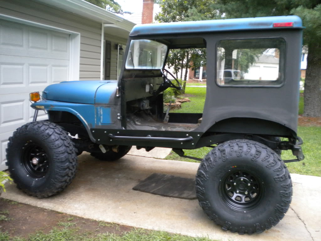

Hey Chad, great work man! Looks awesome, sorry I have been at the beach all week on vacation. See if you didn't have an awesome jeep build like this you could go on real vacations haha.
I'll bee switching my days off this weekend so I'll come and help you out some if you need it.
So badass man.....
That thing is sick!! One of my favorite builds! Great work man!
i want this jeep. lol
Thats some motivation right there. Looking good. :beer:
Thanks Guys! I appreciate the good words. i am definitely motivated to get this this done now that it's got tires on it.
wow man you do great work i would give my tj up for that jeep any day lol and its my dd
i might trade it. then i could actually have one that runs. haha. :driver:

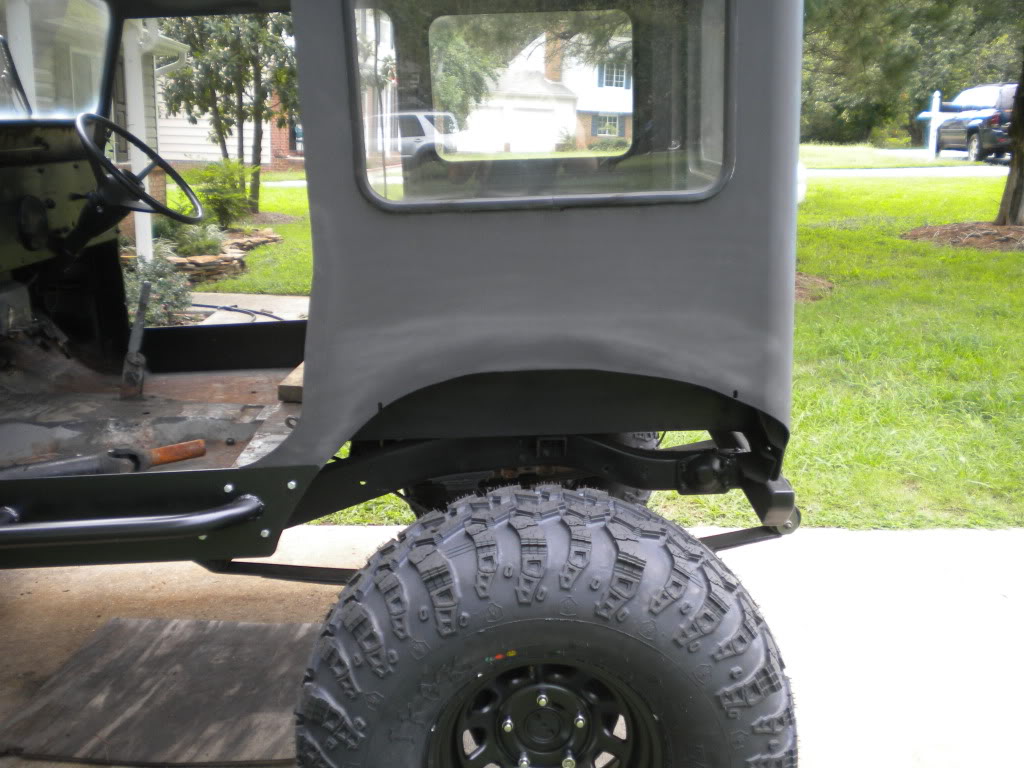

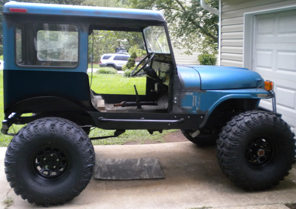

Hey man I just noticed something. In the pic that you took from the rear, it looks like your driver side (right side in picture) is missing a U bolt on the leaf springs for the rear axle. Are my eyes decieving me?
I think you should sell the blue prints on this build to the postal service. That would be a sweet mail jeep........
dang you're good! i am missing one. i have to get one that fits a wider axle since the springs are into the housing. i still have to weld up the rear so it shouldn't be a problem until i wana drive it. haha. thanks for the heads up tho!

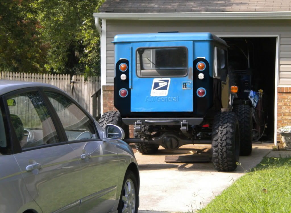

How ironic. There's a Postal vehicle in the background.

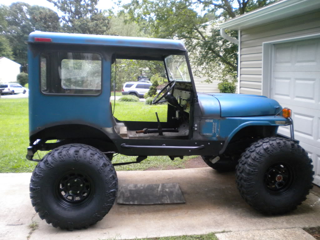

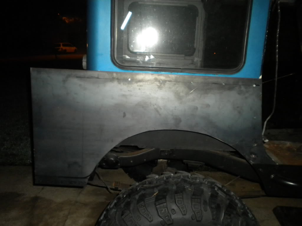

i fixed the passenger (left side) rear fender today.
driver side shot.
passenger side shot.

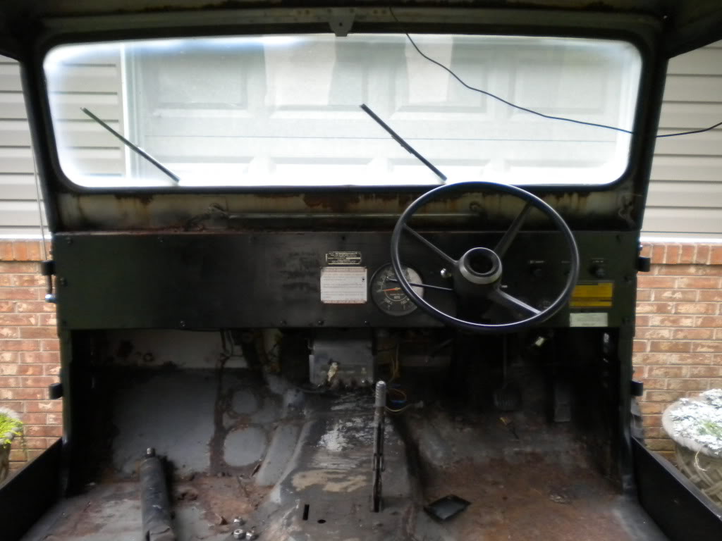

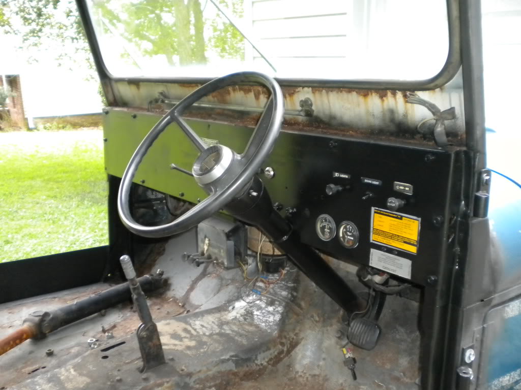

i got the dash painted today oo. i still have to work on the area where the windshield wipers are.
another.
random shot.

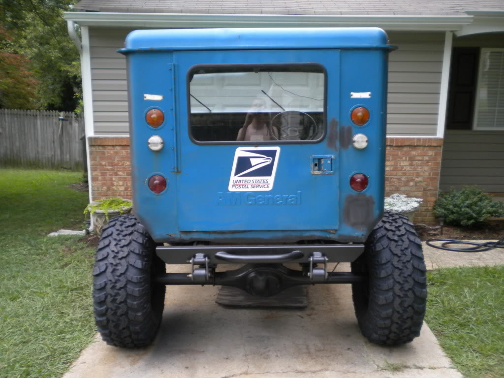

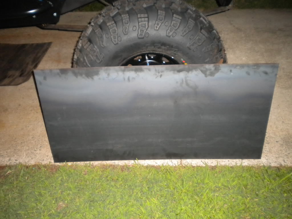

trying to see what you guys think about this. i photoshopped a side and back view of body armor i'm planning on building. i think i like it and i'm planning on fabricating it this weekend. it will be one piece that wraps the sides, lower back (tramp stamp area) and up thru the light mounts. what do you think?
#1
ai1024.photobucket.com_albums_y309_95builtjeep_gone_20postal_chad_jeep_8_10_back2.jpg
#2
ai1024.photobucket.com_albums_y309_95builtjeep_gone_20postal_chad_jeep_8_10_back_1.jpg
#3 (circle shape matches the same shape as the top lights.
side.
How thick is the plate steal? And how do you plan on rolling it/ shaping it around the radius corners??? I to am building body armor for my cj5 this week and I still haven't decided on the best way to shape the plate steel to the radius corners....
i'm using 11ga (= 1/8"). i used 1/8" on the rocksliders because it's much easier to work with and it was cheaper (since this is a budget build). 3/16" is nearly impossible to work with. If i had a torch i'd just heat it to form the radius (i'm not worried about hurting the paint below because it's garbage anyways and will get a full paint job when this project is done).
MY PLAN: cutting the front sides to their shape around the door opening, then drilling and bolting them up all the way up the the side where the radius begins, then use a cut off wheel and do filet cuts every 1/2" or less all the way along the radius, then bend the metal, drill the mounting holes for the body and bolt it in. then i'll weld the filet cuts back closed and sand the welds smooth then for the back portion, i'll weld the pieces on both sides that go up around the lights and along the bottom (tramp stamp below the door) , sand the welds smooth and paint the whole piece. it's ALOT of work for the difference it will have but it'll look cool i guess. :)
1/8" is def. Alot easier to work with than 1/4" or 3/16".... I picked up my steal yesterday, 1/4", had it sheered to the Ruff dimensions and ill use my plasma cutter to cut out the shape around the doors... the rear corners are a concern for me.. im contemplating getting a torch assembly, heating it up and bending it around the corner, bolting it to the body and then quenching it with water... but a good torch assembly ain't cheep.... my buddy is trying to talk me into squaring the corners, and building a rear exo cage with gas can mounts to hide the squared corners... On a side note, you've heard it before, but I Realy never thought a dj-5 could look cool...I stand corrected... good work so far,

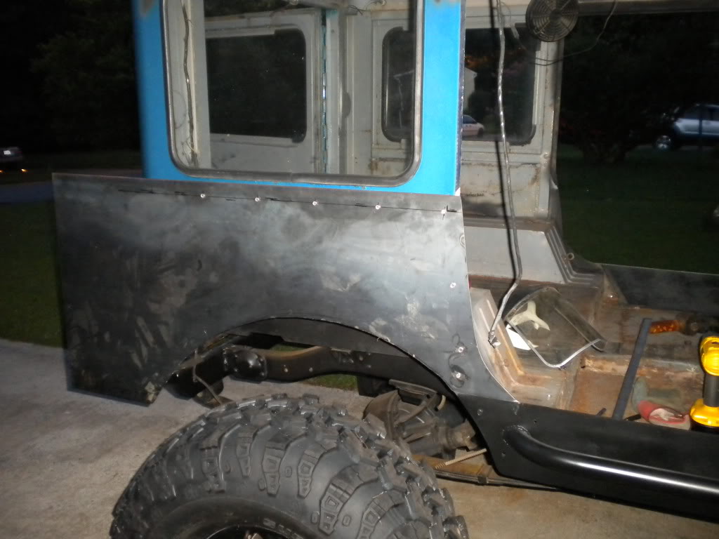

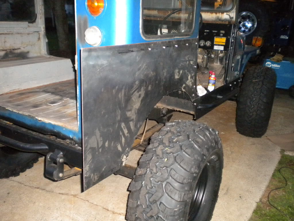

let my next mini project begin: rear corner armor.
lots to do to make this look good.
front side cut to the shape and my first rough cut of the wheel opening. i still have to open the rear wheelwell quite a bit but i'll get it there.
top holes drilled. still a lot to do but that is all for tonight.

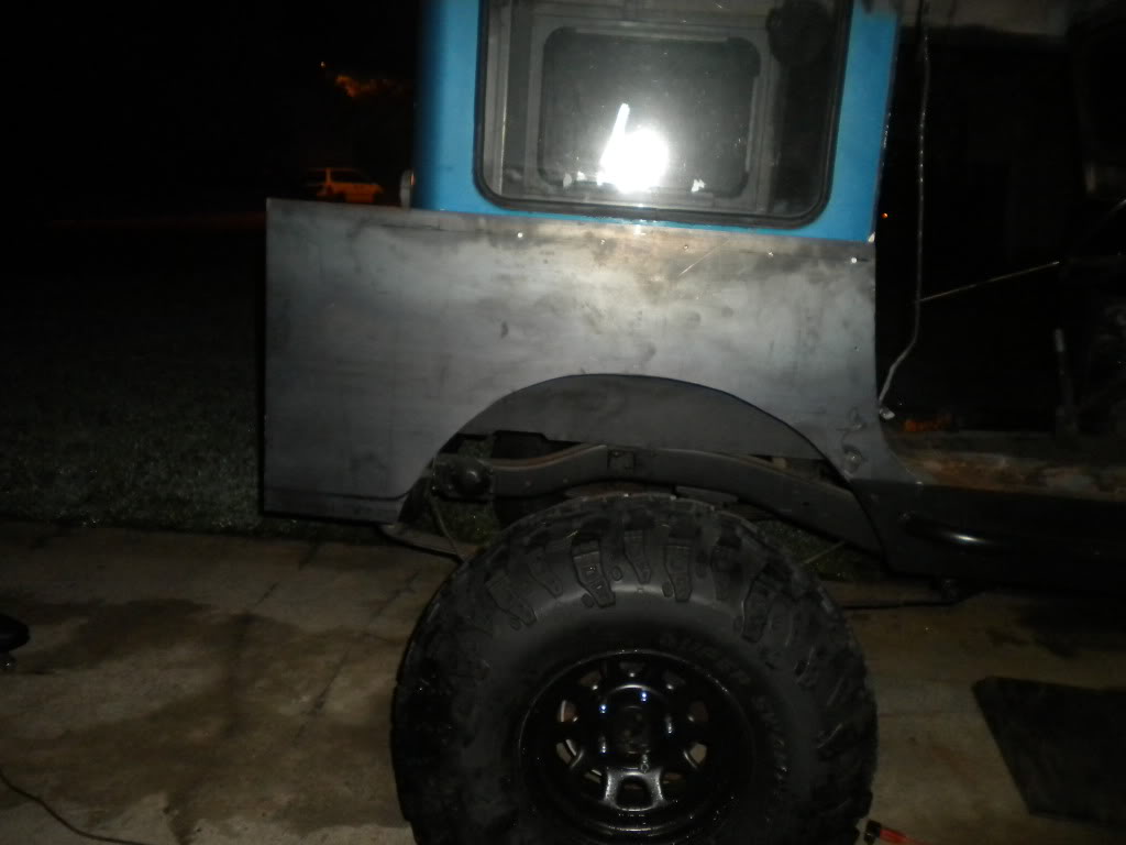

i got my first corner wheel opening pretty close to how i want it. i had to stop early tonight 'cause of the friggin' rain. sucks working in your driveway.
you can see in the pics where the black sharpie line shows where the bottom will be cut off.
