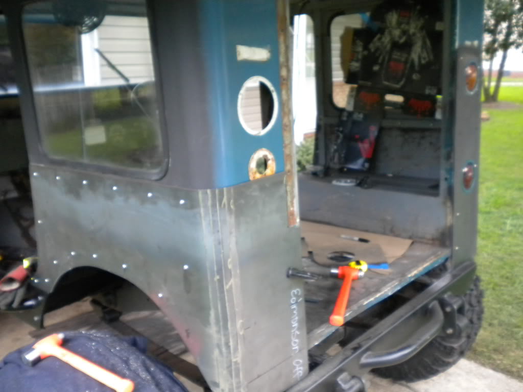

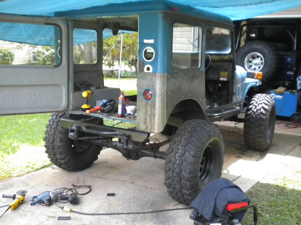

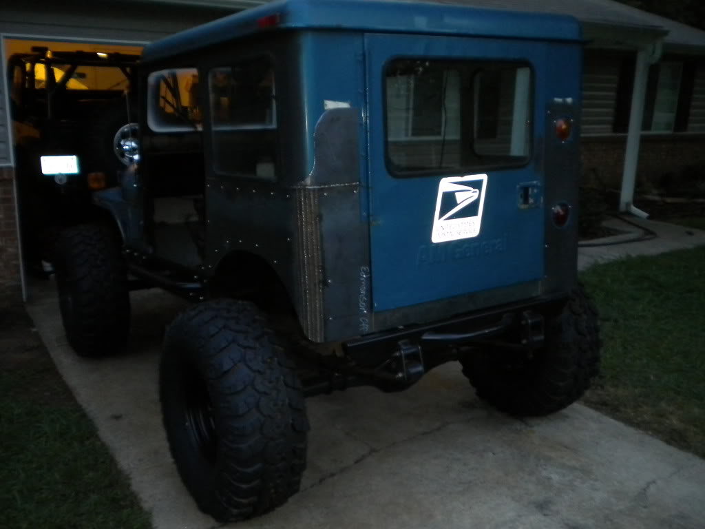

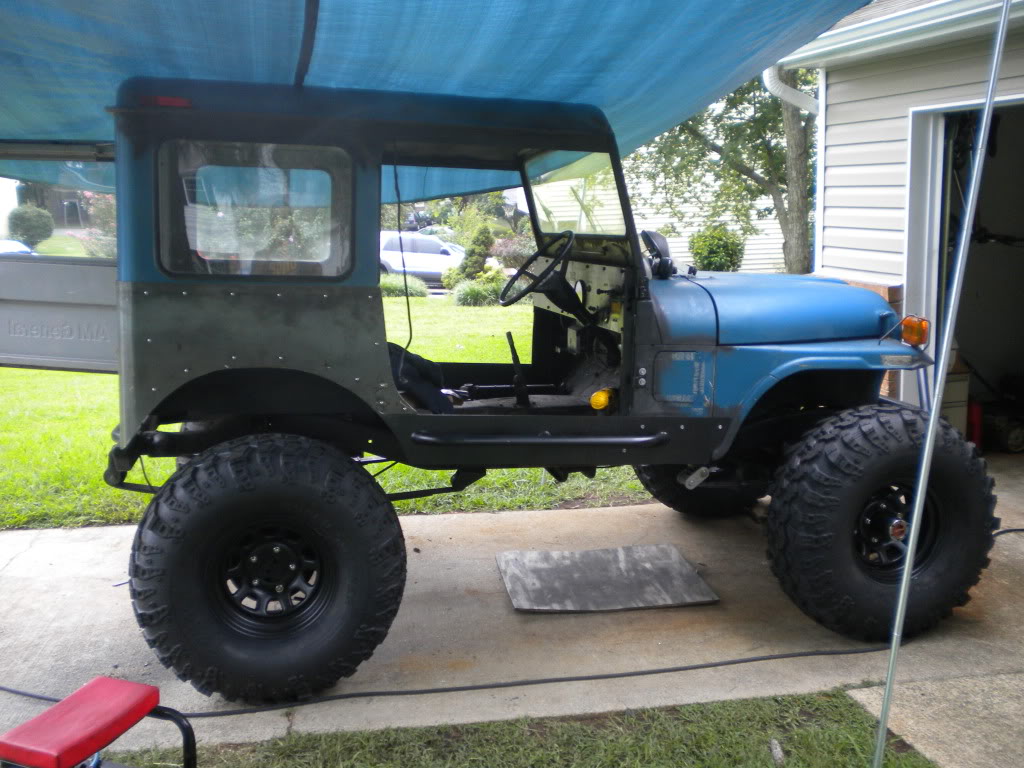

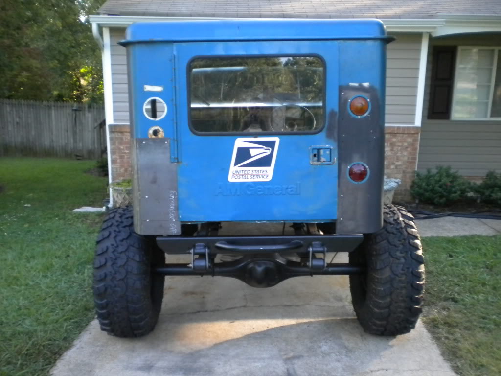

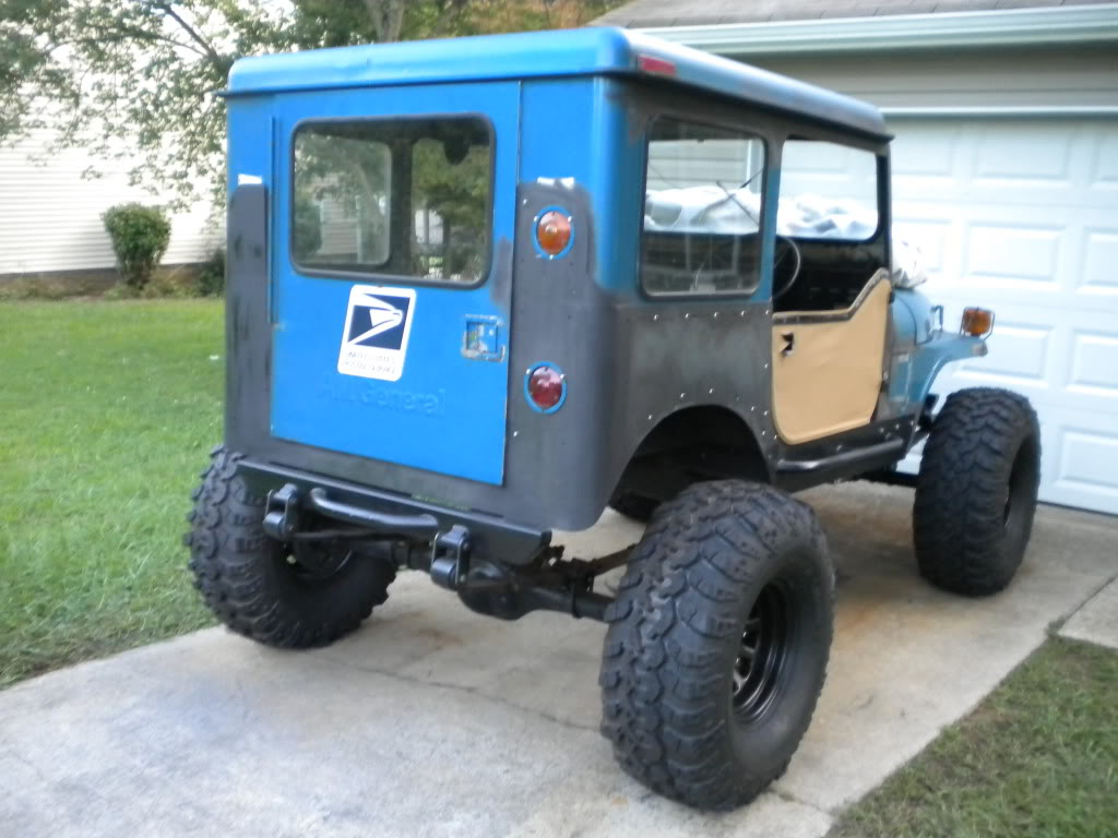

saturday progress. i got side one basically done. i just need to paint it and re-install tomorrow. then on to side two tomorrow. alot of work for the change but i think it's worth it.

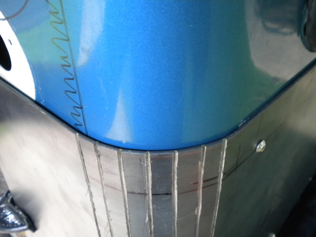

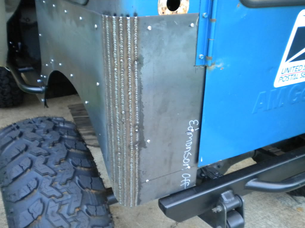

you can see where i did thin cuts along the side. it actually worked really well. it just too forever to weld it back up and sand it smooth. pics to follow.

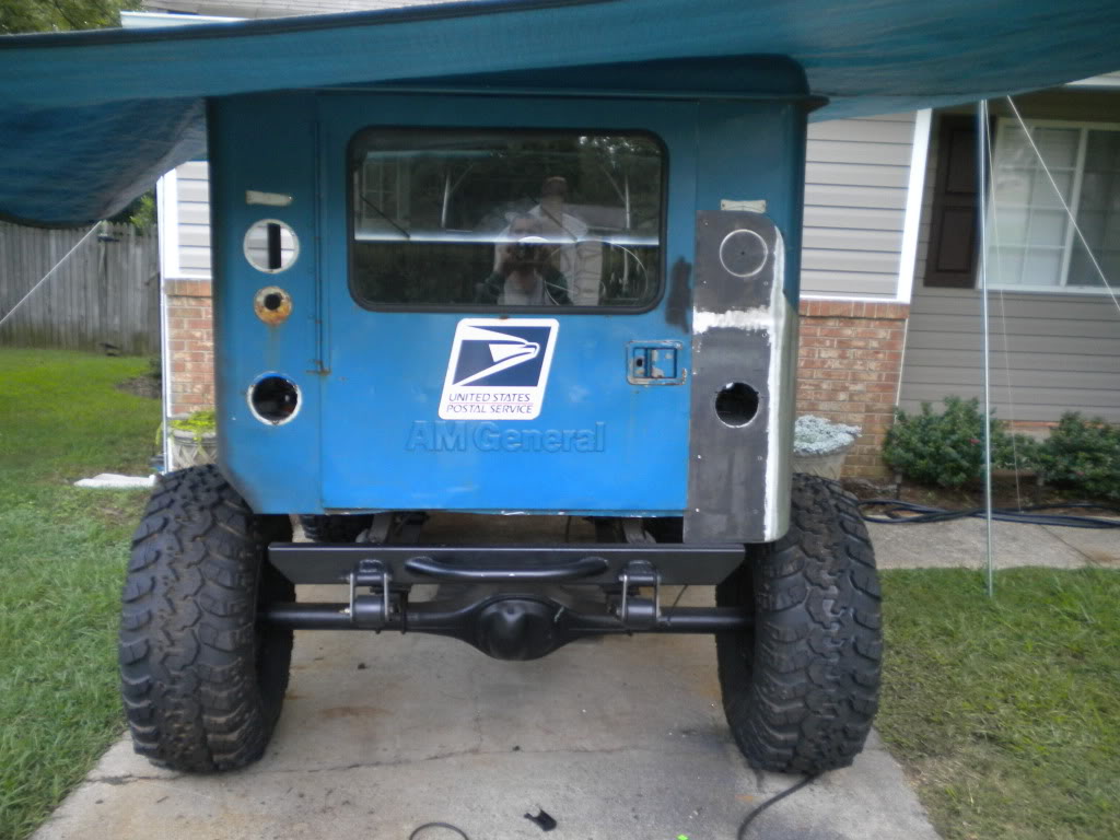

i changed the rear wheel opening. i think i like it better. it's similar to redlyner's tnt zyro fenders he used to run. i like that look.
another.

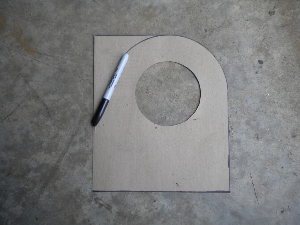

here's one of my templates for the final upper mount.
i did alot more work than i took pics of. i'll update more pics tomorrow.
Good idea cutting the grooves in the sheet to help put a bend in it, but just curious, why not put the grooves on the inside so that it left the outside smooth (less grinding and welding) and you could hide the not so perfect inside. Maybe just an idea for when you do the other side. Looks great though. Nice work.
thanks! it worked out great. it was just very time consuming. the only problem with doing it backwards is it would have looked like an octagon shape on the frontside if i'd cut and welded up the backside.

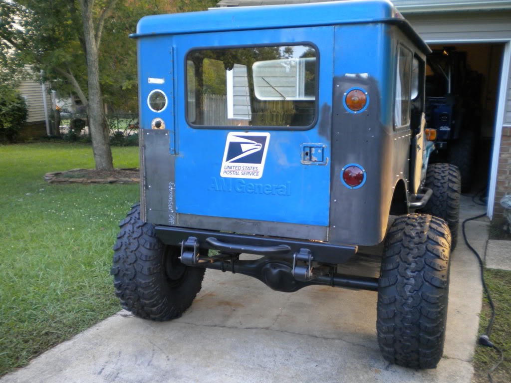

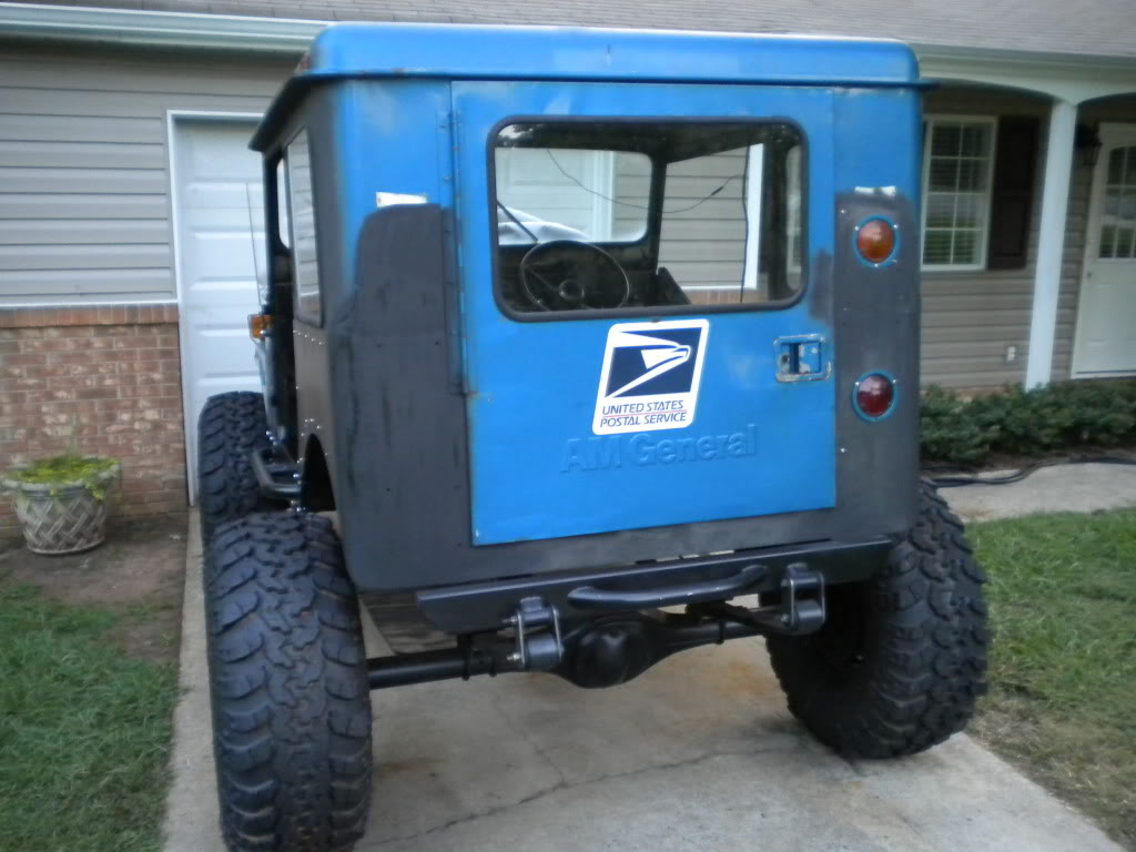

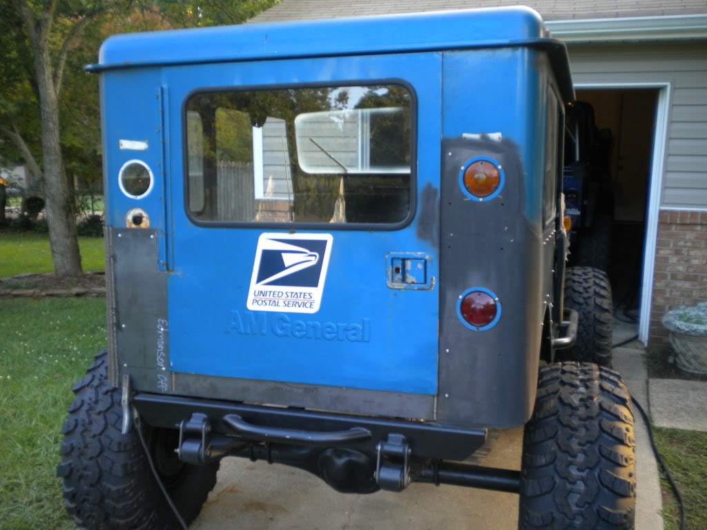

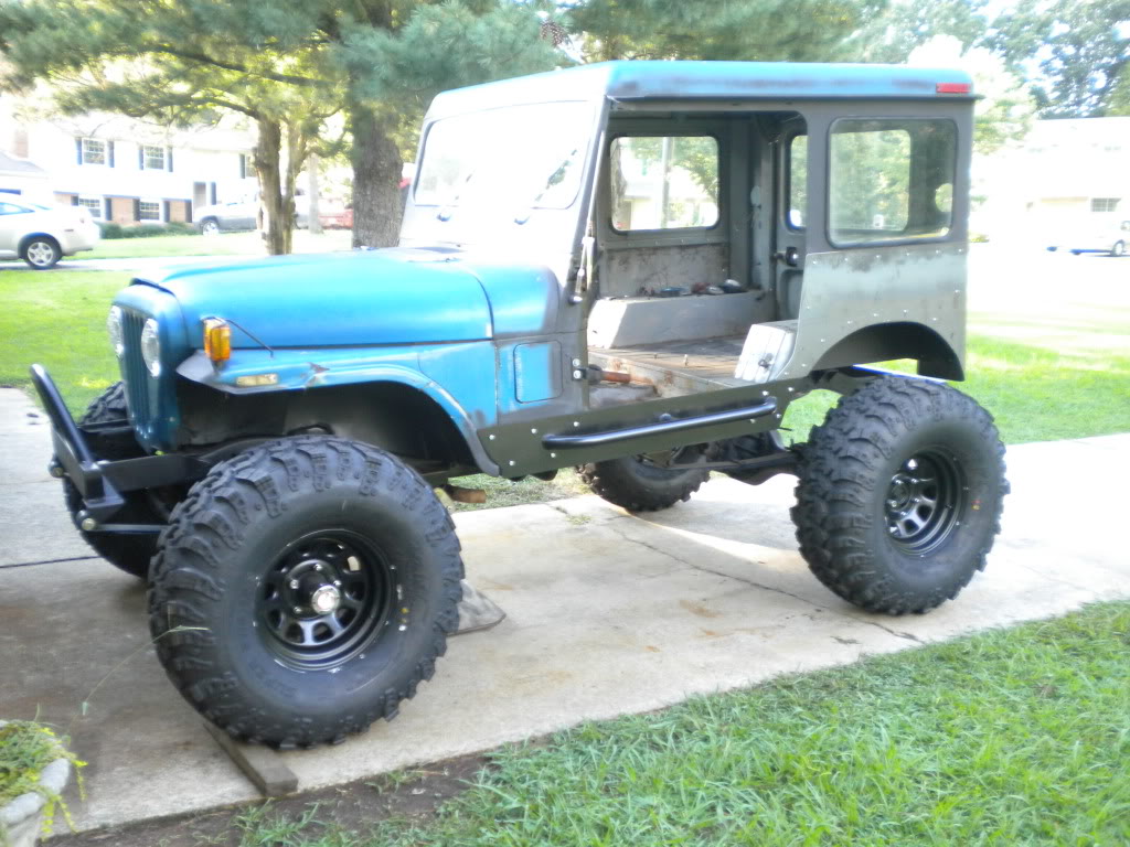

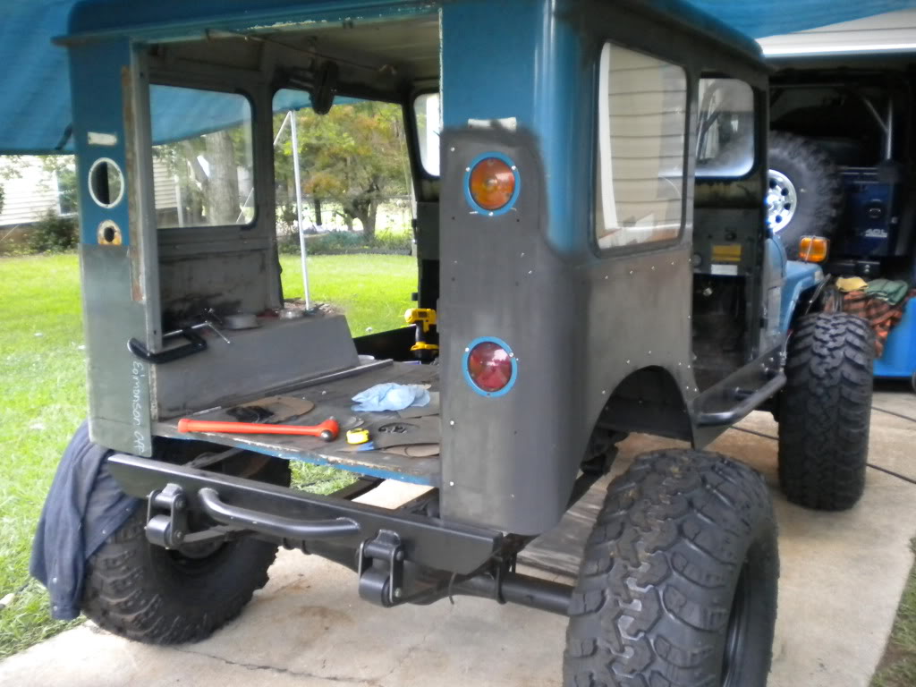

back at it again.
cuts made to bend the side, door off to get the alignment right and ready to drill some holes.
wide shots from the end of the day. i cleaned up the inside because it was filthy from all the cutting, drilling and grinding.
i still have to finish cutting out the top piece for the left hand side, weld it all up, cut out the light holes for the left side, cut out the tramp stamp and weld it on, do a final once over with the grinder and hit it with some paint. alot of work for body armor but i guess that's what i get for building something that has no aftermarket support. :) it really stiffened up the body which i'm really happy about.

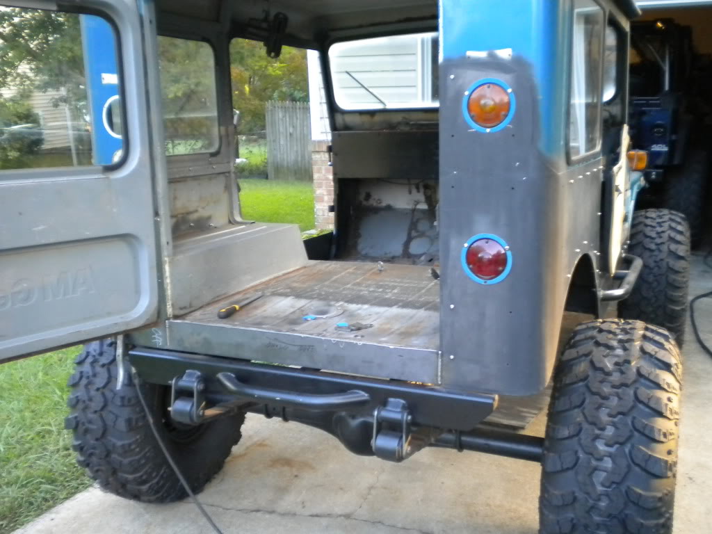

pics from tonight.

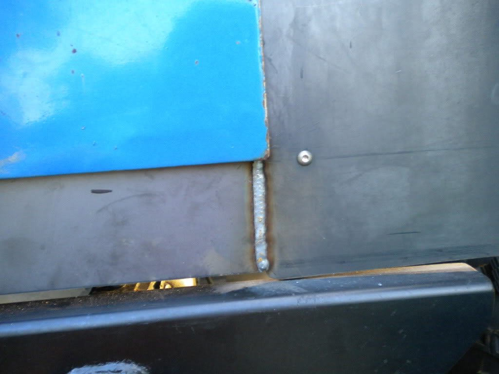

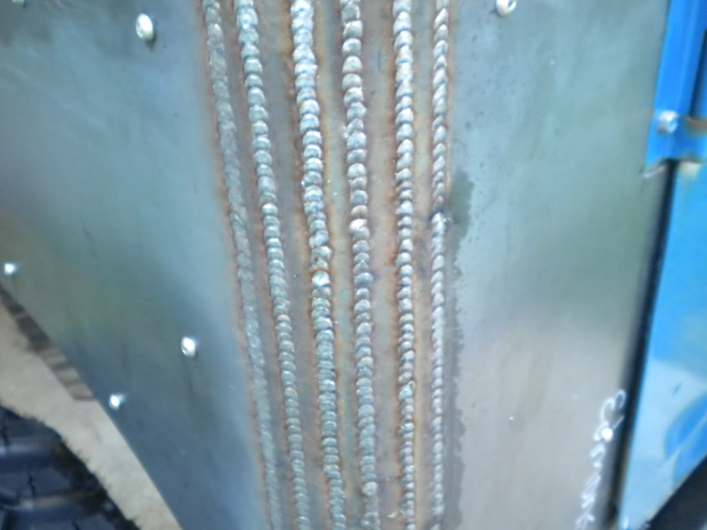

pic of the million triggered welds on the left side corner. i triggered the welds since i was really only trying to fill in the fillet cuts with material.

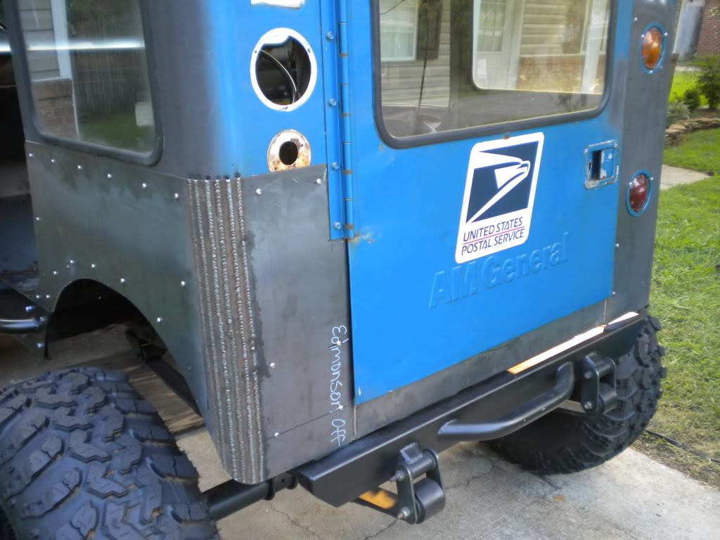

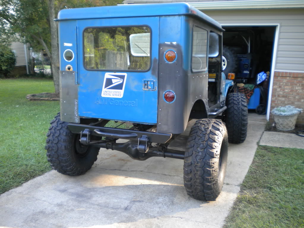

got my tramp stamp welded up. now the corners and lower back piece are one piece. i'm likin' it. new metal is so nice. i just have to add the 1/4" holes for the stainless hardware.
i'll grind the welds smooth so it's one slick piece.

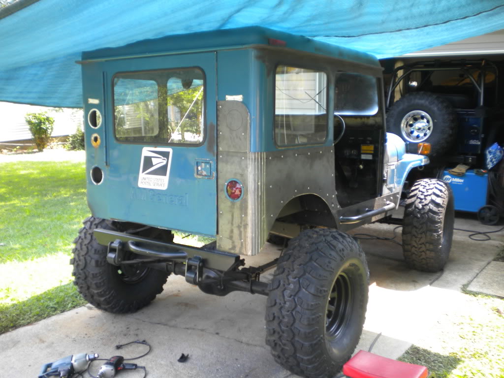

i got the other upper corner cut out and welded in place. now i just have to go back thru and sand all the welds smooth, clean everything up, add about 10 more 1/4" holes for hardware and then throw some paint on it.
those corner gaurds make all the difference . just wondering if the body armor is going to be the same color as the jeep or black :bling: also have you figured out if you will be able to keep it rhd or not .
all the body armor will be black. the jeep is going to be similar to the blue it was when i got it but a little bit brighter (kind of like miller welder blue). i plan on getting some low back corbeau seats for the interior (black vinyl), roll cage will be black or deep silver and the floors with be cheapo spray bedliner black.

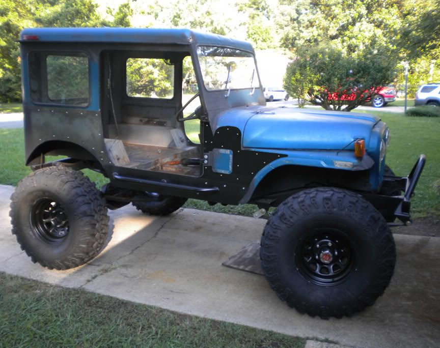

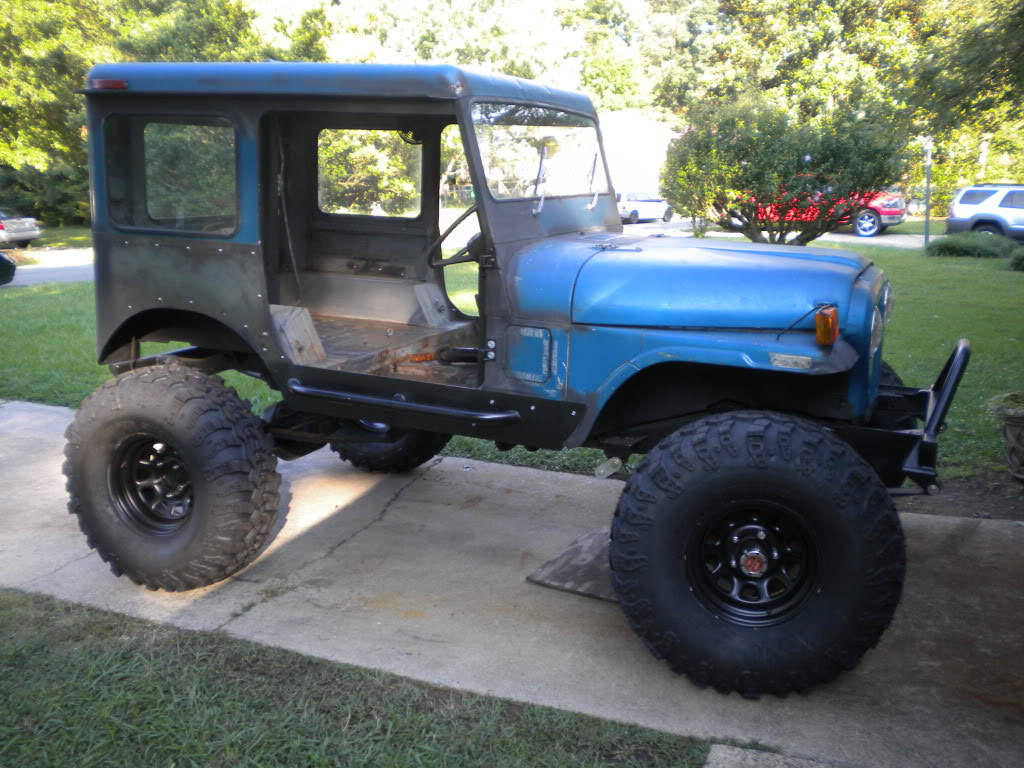

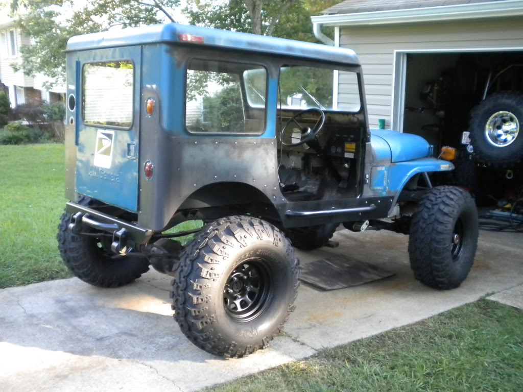

well tonight i was going to hit the weights and mow the grass....i did neither. instead i grinded the corners smooth and threw a little primer on them.

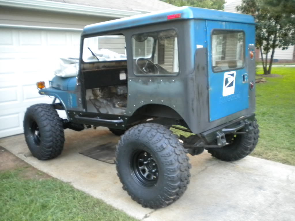

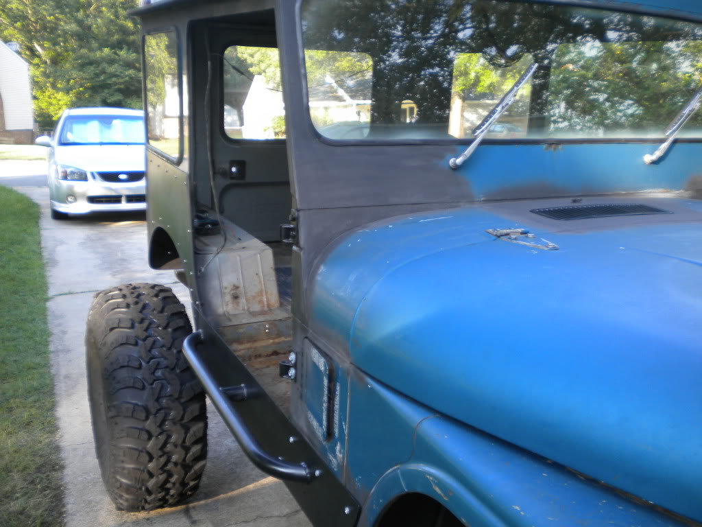

well another lunch break and more ideas. i am thinking about this idea for body armor in front of the doors. it will be welded to the rock slider and sanded smooth so it appears as one piece. what do you guys think?

#1 i like #1 because the part right in front of the windshield is a vulnerable spot for trail damage.
#2
#2. But either way it'll look VERY nice! Great job man.

I think you are adding a lot of weight to the Jeep with all the exterior metal. How thick is the steel you are plating the exterior with? Is this going to be a trail rig or more of an around town toy? I think it is a cool project, and I think it looks good, but I am a believer in shedding as much weight as possible for wheeling.
I he racing it or wheeling it? Personally I would build mine like tanks, more plating the less body work you have to do later....

i definitely agree. i do not want to add too much weight or it defeats the purpose of a small rig like this. this is definitely going to be a trail rig but i do want to to be drivable to and from the trails since i don't have a tow rig. it's going to get beat up some but i'm a pretty reasonable driver in whatever i'm driving. all the body plating is 11ga (or 1/8") plate. the DOM tubing is all 1.75" .120 wall. the bumpers are .25 wall and the suspension brackets are 1/4".
