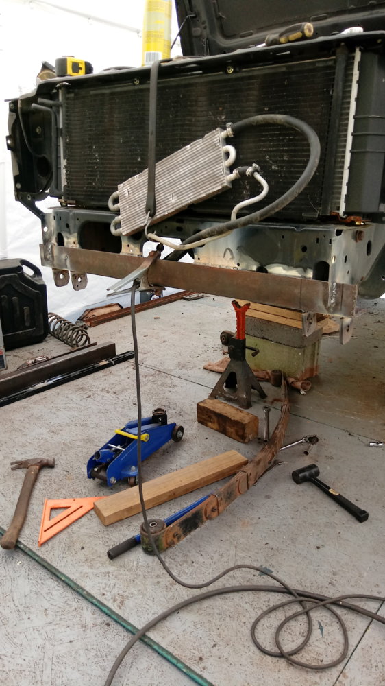

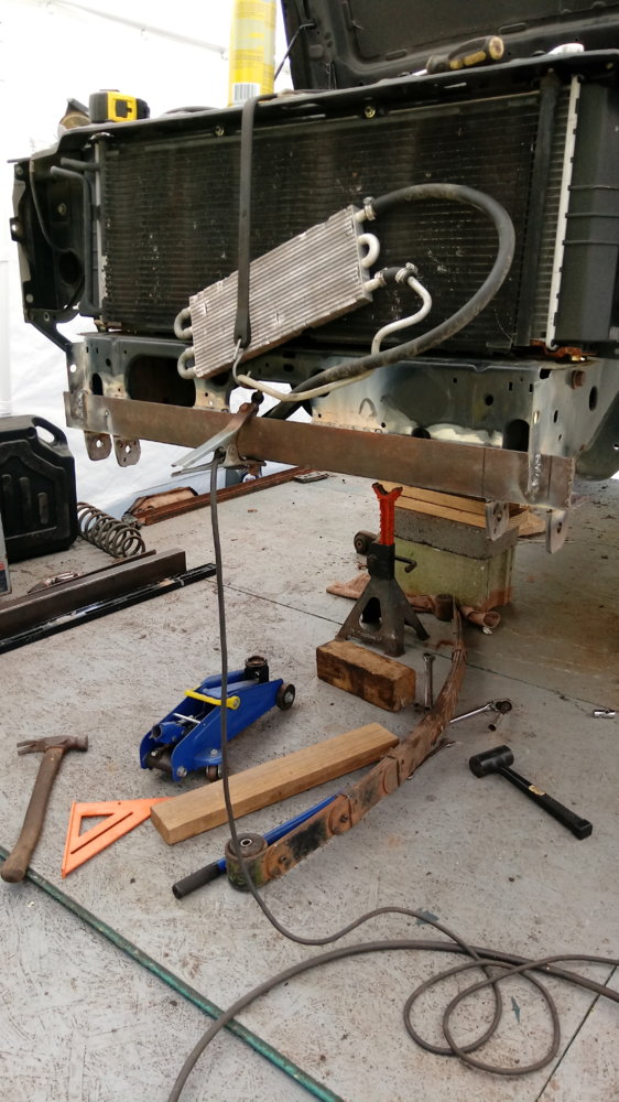

Well got a little work done today..front cross member with shackle mounts welded in and got my 2x4cross member ready to be made with brackets for the rear. Those front hangers will be more braced/boxed in once all setup with shackles..
so much shaking head. #1 is that smoke goo from a flux core on the center welds? #2 whats up with the infinitely variable height 'wood spacers'. #4 hammers speak volumes #5 is that a toy jack or what? #6 is that 1/8" angle iron your front crossmember that your life depends upon?
The hammer made me lol

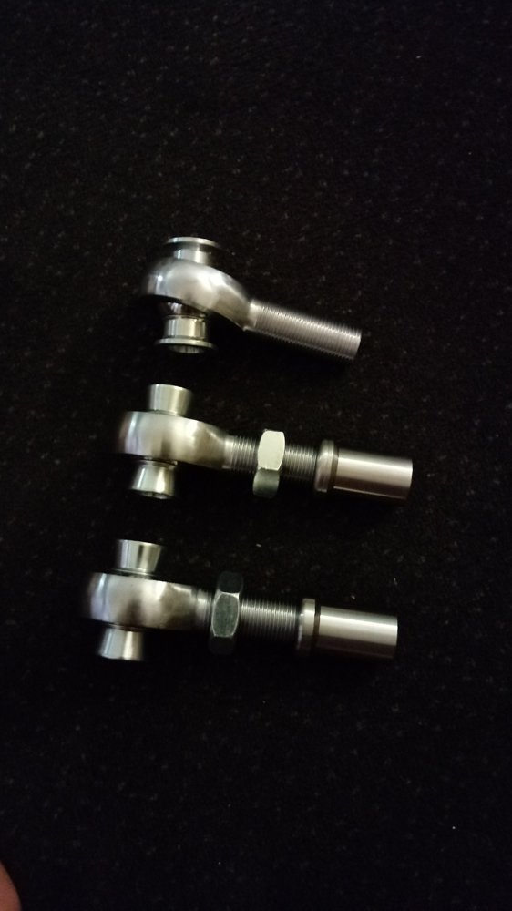

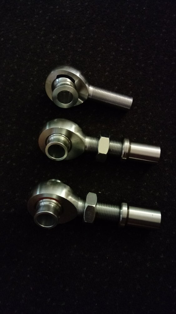

Ok guys this is what I got..3 chromolly 7/8joints. Can someone tell me what I'm missing or need..I know that one none reds a nut and tube fitting but what else..thank u
How are you setting up the steering?
There is really no need for high misalignment spacers on the tie rod, (assuming you are running it knuckle to knuckle) as its operating angle won't change. You do however need them for the drag link usually as it's angle changes as the suspension cycles.

Looks like your spacers have different diameters? Are u missing a 4th?
No they're all the same inner diameter 3/4bolt...that one set of spacers just has bigger lip on it

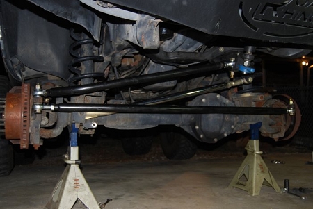

What about this

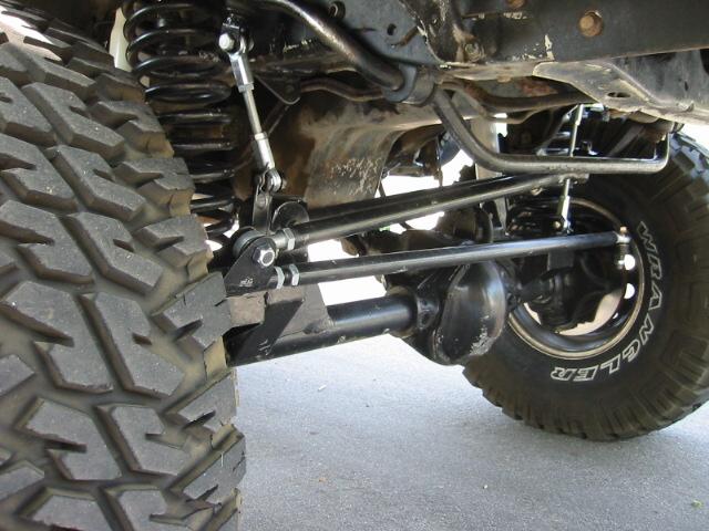

Would the above pic be better
You are saying to do this then
Either will work.
The first pic will have a lot of slack in the steering. The slack in the drag link will have to used up, then the slack in the tie rod and then the wheels will turn. For a trail rig it'll be fine.
The second pic is what I would do if it were me personally.
