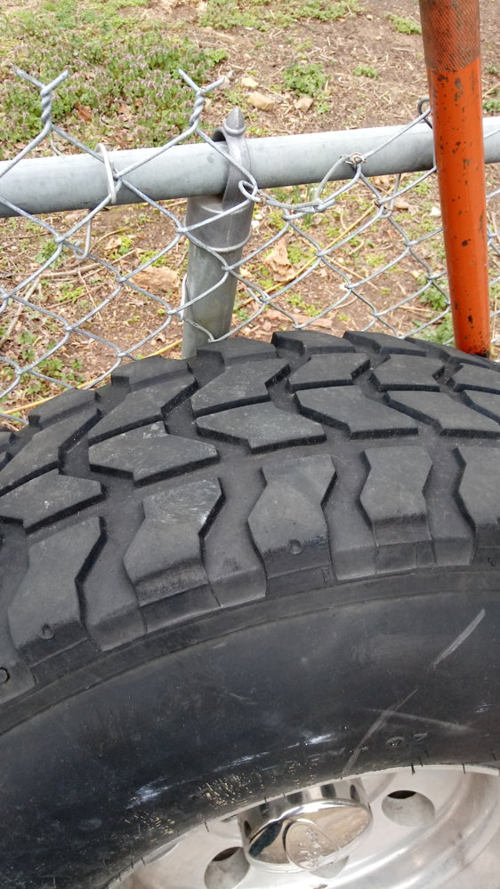

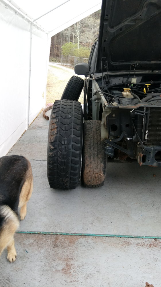

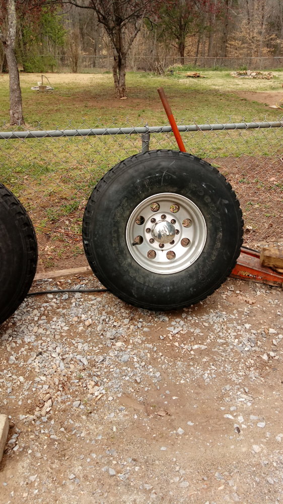

thanks for all the input guys....just got back form picking up some pretty awesome 16.5x8 with 37x13.50x16.5 military humvee tires in great shape for stupid good deal so now I have my tires and wheels BUT .....now I got bigger problems and more serious...freaking 4L60 crapped out on us 2hrs down there and barely made it home after lucas treatment but by the time we got off highway in Gastonia, only 1and barely 2 so now onto that stupid crap....can't really take in any of this advise on the jeep right now as I'm stuck dealing with that...thanks and hope to soon be back at this build.....

Not bad for 5 of them with aluminum rims for 300...worth 2hr drive and losing my transmission? No lol, but got it done! But new Tahoe trans is being put in so that's that
Be aware that those wheels do not have a safety bead on them... therefore, if you air down, the tire will come off the wheel.
Just keep an eye out for some cheap hummer wheels Recenter those rascals and rock out. and sell these if you do.
So u can't air down at all
