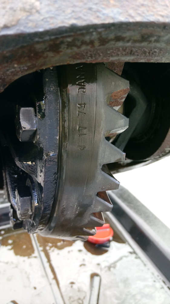

Isn't this the gear ratio guys..its the front

That's not ratio stamped.
Look for other numbers just past those or count the teeth on the ring gear and divide by the number of teeth on the pinion.
Last set of #s was 41-11...is that it..I'm getting lost on counting lollol
It reads...4 17 74 DANA 18515 A3D15 41-11..then go around half way and there's a 757
Well dang..little step from stock 3:55 but not what I was hoping to find..dang it
Ill check rear tomorrow and hope its the same
